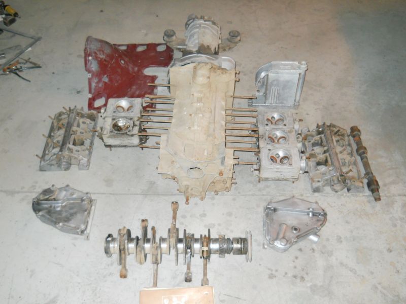

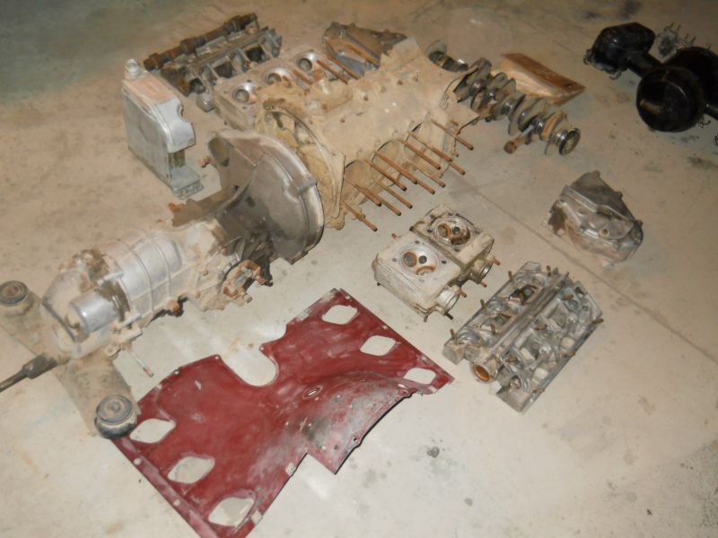

                Yesterday I made the two-hour trip out to my parents old place to round-up and rescue the original engine and components to this car. While this stuff still belongs to him, one day it will eventually end up being mine but I hope not too soon! Realistically at 75 he will never get around to working on his car again and he's at a point now where he doesn't care enough to take steps to safeguard it. So, I took it upon myself to begin protecting what's left from the elements and the wolves! The place has been abandoned for better than 15 years now. We had a good run and our old neighbor watches as much as she can but in the last several years there has been a series of break-ins. So even though I really don't have room for this stuff I am finding a place because I would kick myself squarely in the ass when the day came that this too got swiped!
                Luckily I was able to find and locate ALL the basic parts to this motor but my main objective was to get that block! This is the Number's matching motor to this car!
                All the basic items are the original to this motor. three of the heads are date correct but the last two are not. The missing ones may have been used in the motor that is in the car now. I had already washed the smaller components off by this photo but everything looked like that block when I brought it in.

                Original transmission I grabbed several months ago.

                The cam towers, chain boxes etc. all had the correct '65 date code on them. Again I was so relieved to see this stuff still there!

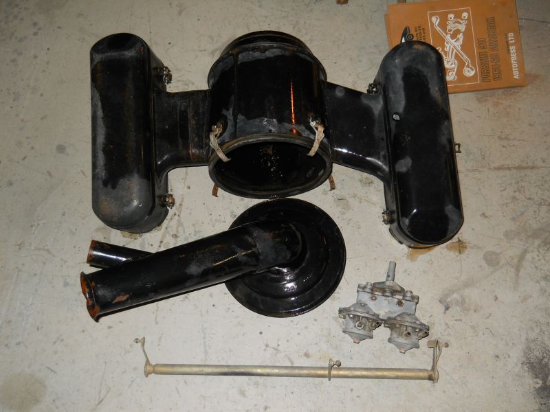

                The Wolves: during one of the break-ins the original triple throat solex's were were taken along with another spare pair of webers. The police officer taking the report said it was most likely drug addict tweekers. "they love things like carburators and were most likely already taken apart on their living room table". Anyway they left the airbox and I found the old cross linkage bar and the pumps. He put webers on it in the early 70's and I'll run those but I wanted the old correct parts for completion so I grabbed what was left.

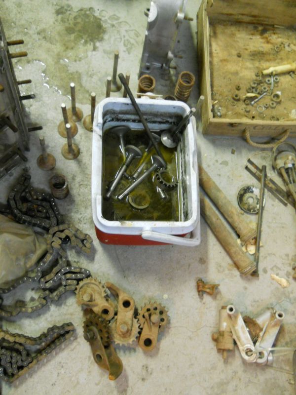

                The elements: found a lot of Misc. hardware but was full of blow sand and beginning to rust. Acid cleaning them here.

                The rest of this motor like the super early version fan shroud etc. is on the engine currently in the car which happens to be the numbers matching motor and transmission to that 67 soft window targa. After my dad gave up on it, it became his "parts car". (bumper trim too are from it) Anyway this is where it will rest for a while longer. Will go back for more but I'm just relieved the original drive train is safe at my shop now. Thanks for reading this! Justin
