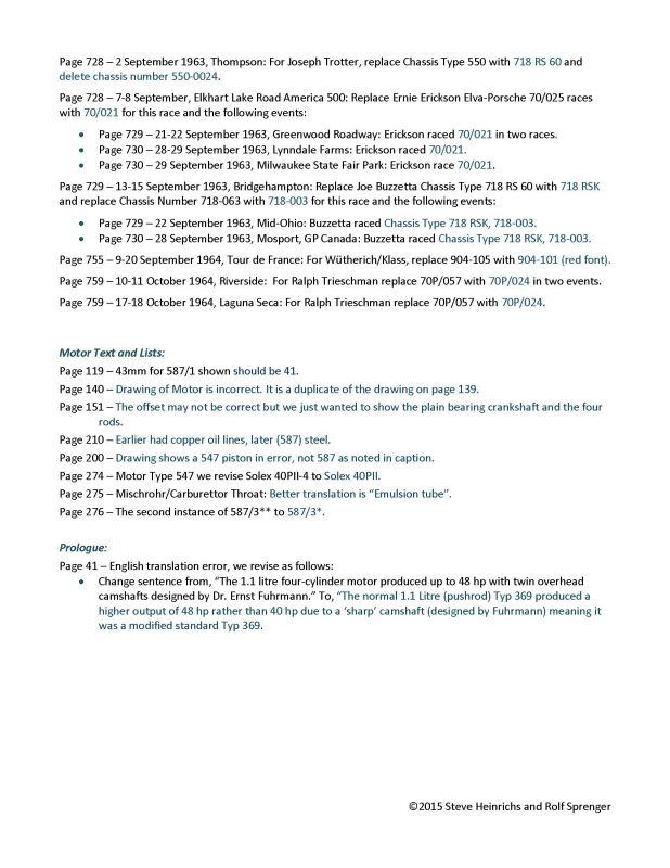

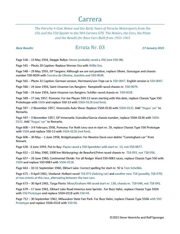

    • Hello Everyone,
      We have a new Errata sheet. It does not include items that have come to our attention in the last few hours.
      Page 1
      Page 2

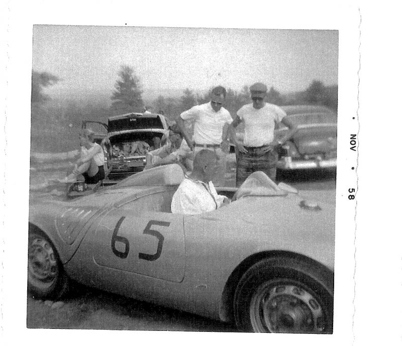

      • Hi Steve,
        what entries do you have for Dave Wolin in his 550, RSK and RS61? There seems to be a few missing...
        • What is missing?
          • He raced 550-0081 at Marlboro around 1961 - can't find a listing (haven't done a full search yet though)

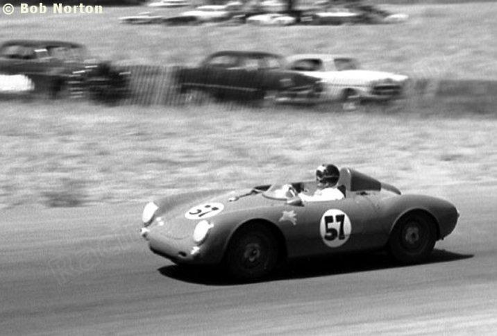

            • Hi Steve/Vietta,
              On P586 @ Paramount, you have McAfee driving 550A-0116. From the photo, it looks like a 550RS

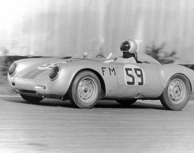

              • I should stop - it is getting late downunder...
                Paul Sagan had 2 Porsches 550-0073 and also a 550A (not sure the number, but his daughter has sent me photos over the years)
                You currently have him listed (plus drivers like Denise McCluggage) only racing 550-0073. Here are some photos of the 550A
