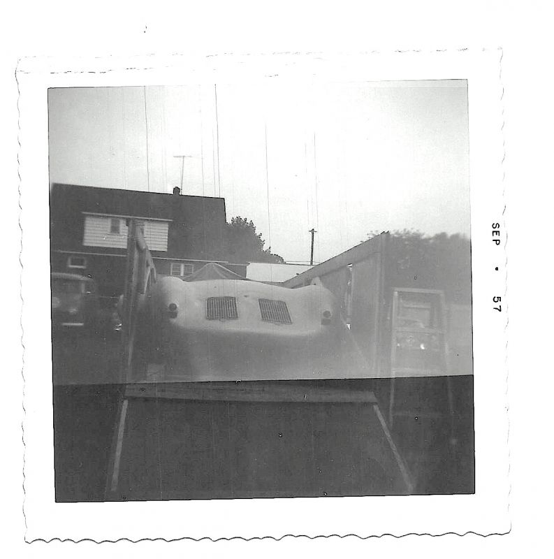

              • Hi Vietta,
                I agree with the changes as this photo shows the 550A new in the crate around September 1957.

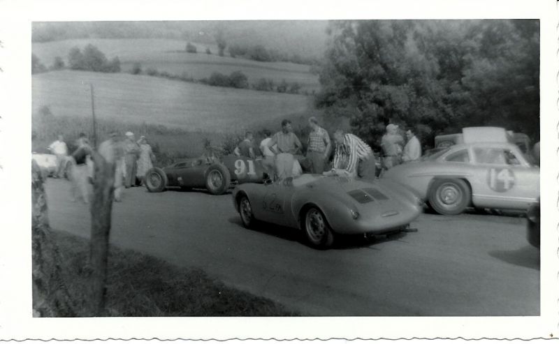

                Do you have any record of him in 550-0073 with race # 62? (possible hill climb?)
                thanks Andrew
                • Based on timing of races and the photo of it in the crate, I would think his race at Montgomery would be in the new 550A
