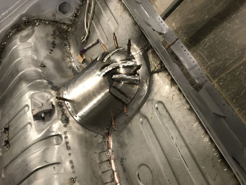

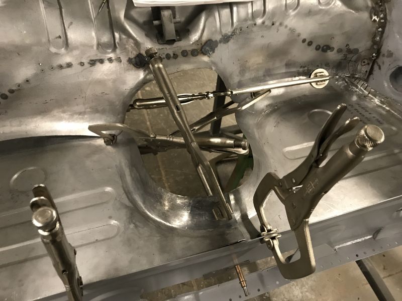

    • Transmission cover in position and burned in. On to parcel shelf.

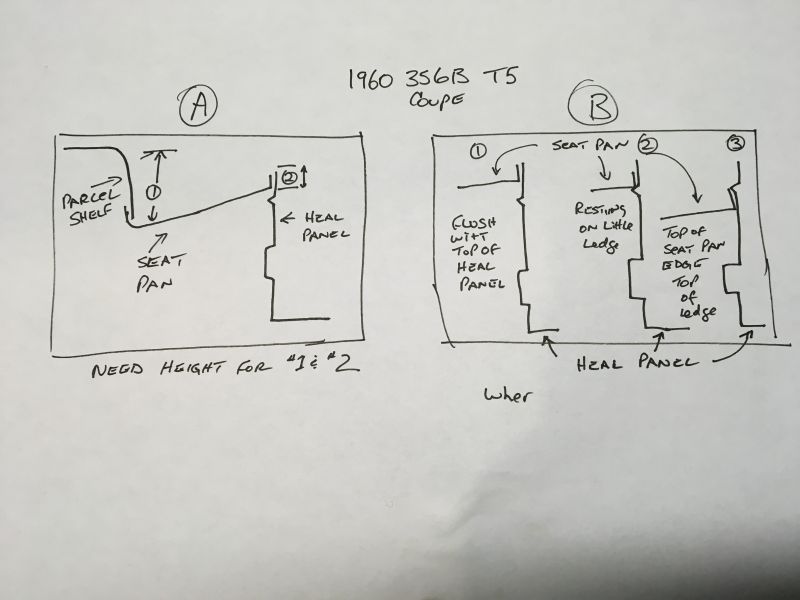

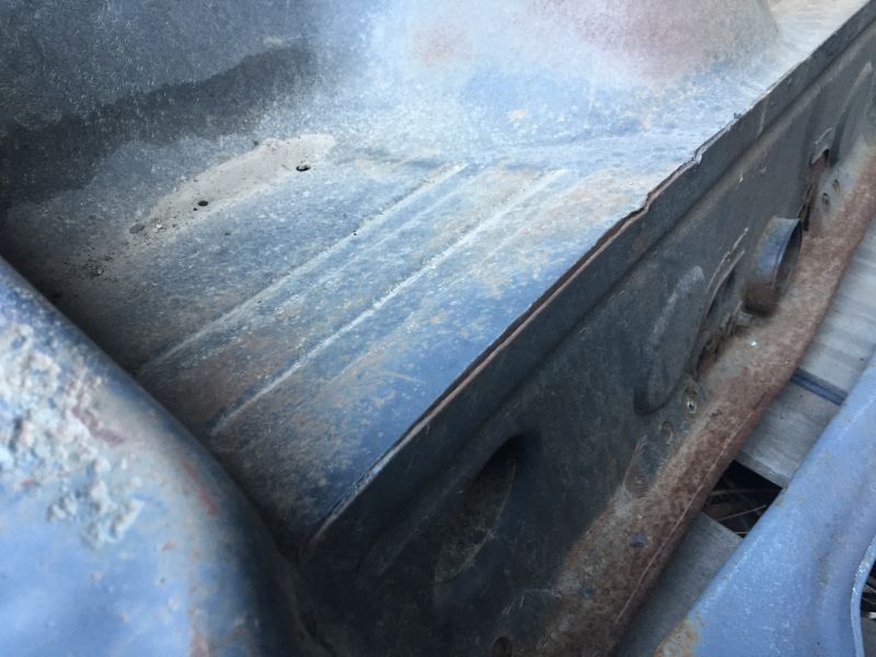

      • Hoping members can help me position my seat pan for my 1960 coupe 356b t5
        Want to position for the proper height and angle.
        Hoping for image box A I can obtain the height of the front of the heal pan from the top of the heal pan to bottom of seat. This is measurement #1 and height of seat pan from top off parcel shelf to bottom of seat pan measurement #2
        As well for the front of the seat pan does it rest on the little ledge as shown in image box B? Any help appreciated.

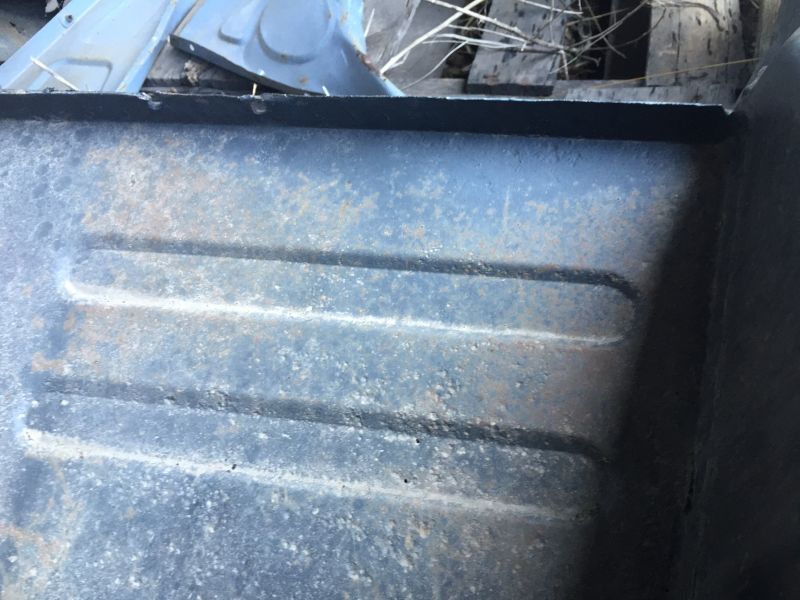

        • I believe the winner is #1.
          Although the pictures below are from a T-6B, I believe that is the same. I have no bare T-5 to check.I looked in the factory books and see no clear dimensions.
          I hope this helps.

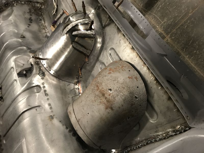

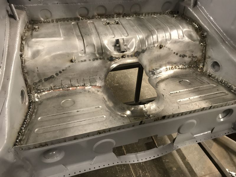

          • 1960 356B T5 - under major resurrection.
            356 Registry main thread;
            • Parcel shelf burned in and drivers side seat pan starting to get shaped and formed.

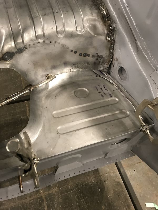

              • Seat pans are getting closer to proper placement.

                  • Thanks for the words of encouragement. All of these pieces with so many curves and compound shapes are a real PITA. But, the encouraging aspect is it is nice to fill in the empty spaces - it is startling to look like a car!!! Got both seat seat pans all burned in and in good shape. Got a whole night of grinding to come.

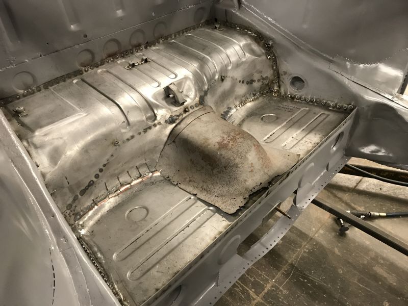

                        • Thanks JP. A good feeling for sure. Have to do this one mini project at a time so it doesn't become overwhelming. Anyone got a good hunk of tunnel hump cover? This one is roaches.
                          • Congratulations Scott, its really shaping up nicely!

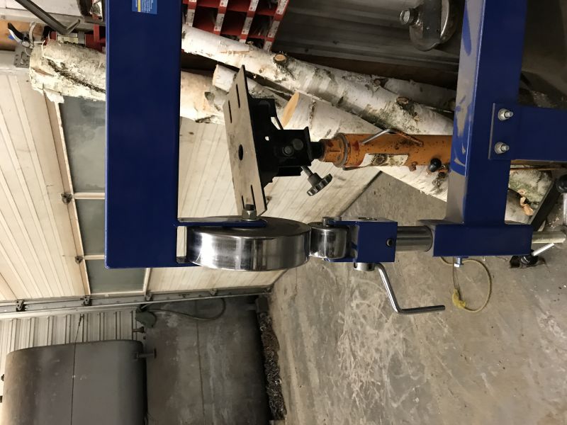

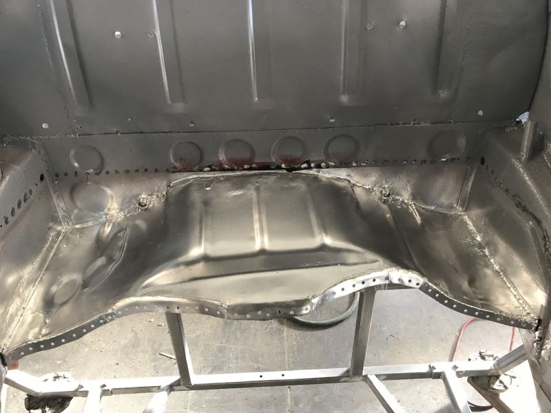

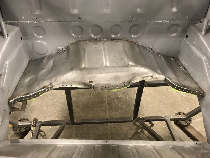

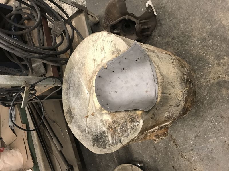

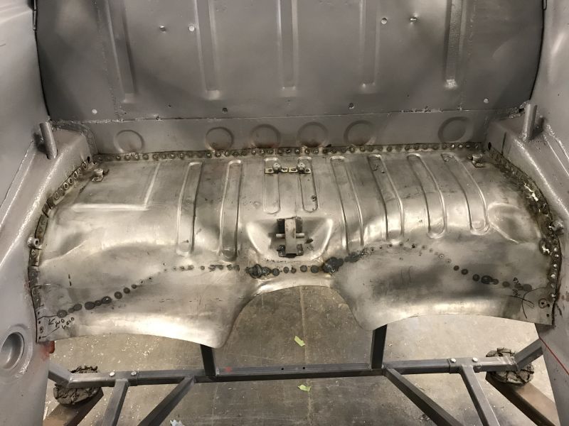

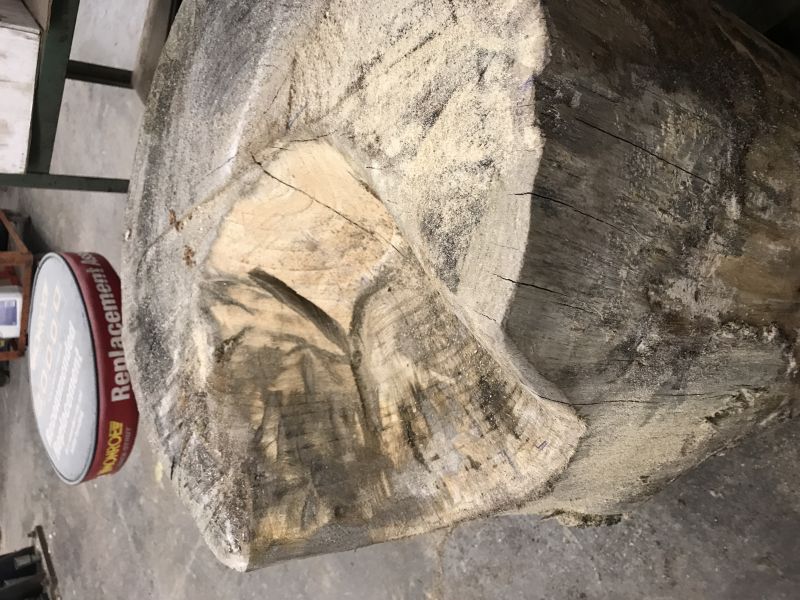

                            • A large stump carved out, an English wheel, a hammer and a dolly, a few tiny silts and welding to cox the final curve
                              [attachment:1]IMG_0891.JPG[/attachment]
                              and four hours of work and my friend Bob created a great shiny new transmission cover hump!! Time to burn it in and call back seat done.

                              • WOW! Nice job with the buck and forming that new piece!
