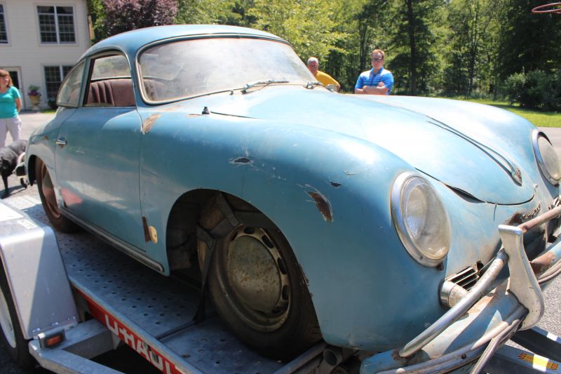

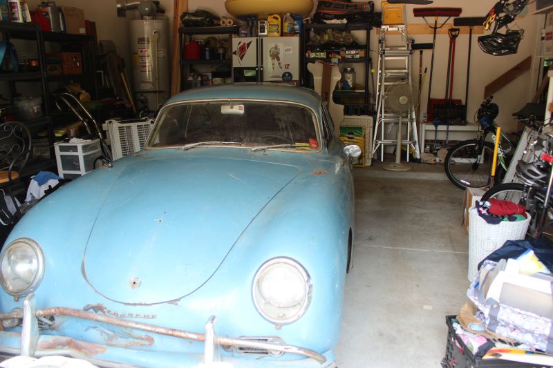

    I had originally thought (before I took possession of the car) I would a lot of the work myself, so I watched several restoration/fabrication TV shows, bought 3 different restoration books on 356 specifically, the service manual, and a set of wrenches. LOL, looks like I was a bit naive.

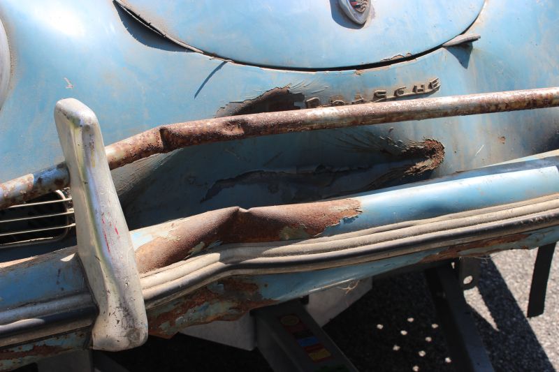

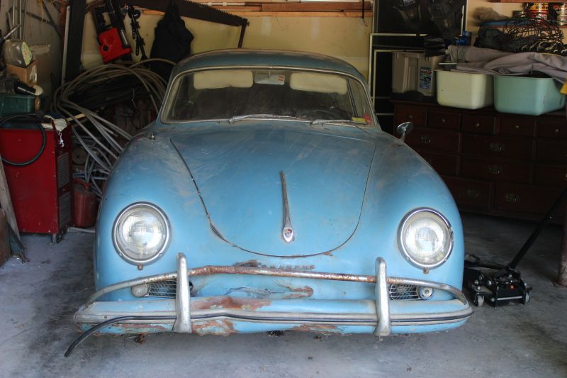

    I got the car into my garage and started to really look at it. There is so much rust, I am quickly over my head. I can put my finger through the "metal" that holds the rear torsion bar in the rear wheel well. I had a couple of local body shop guys come out and help me assess the car to see what it would take for them to "restore" it. I would have to mortgage my house, and provide my first born for that to work out.
    So, I am back to a plan of taking the car apart, having the paint/rust stripping done somewhere (still deciding on what the best method would be, and where), and then having a shop do the major structural welding. From there, my current plan is to get the engine rebuilt (doing as much as I can myself), and then doing the outer body.

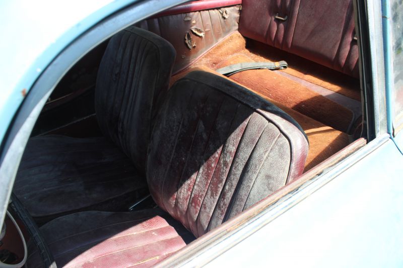

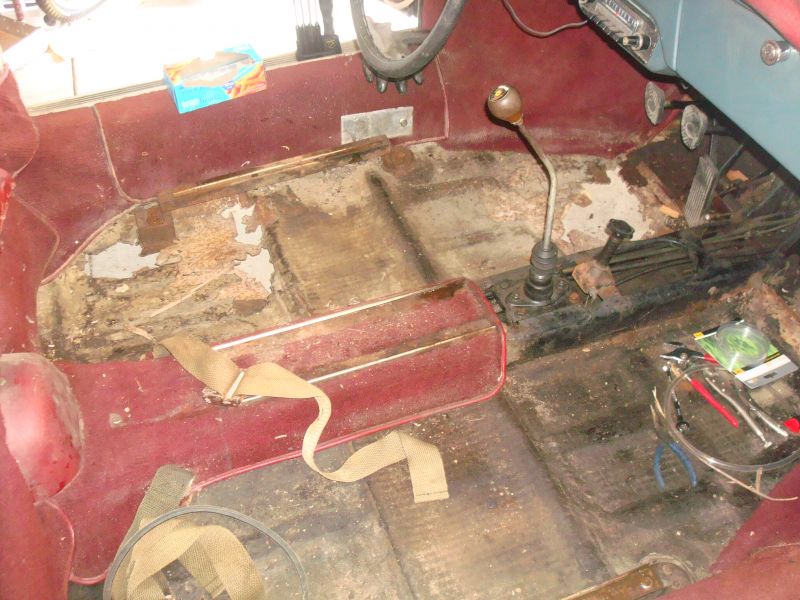

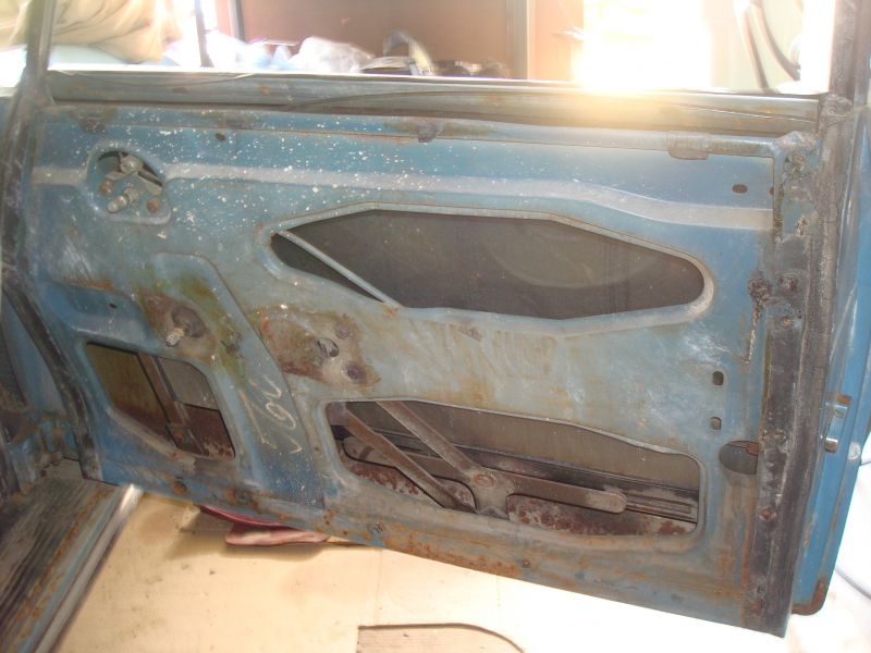

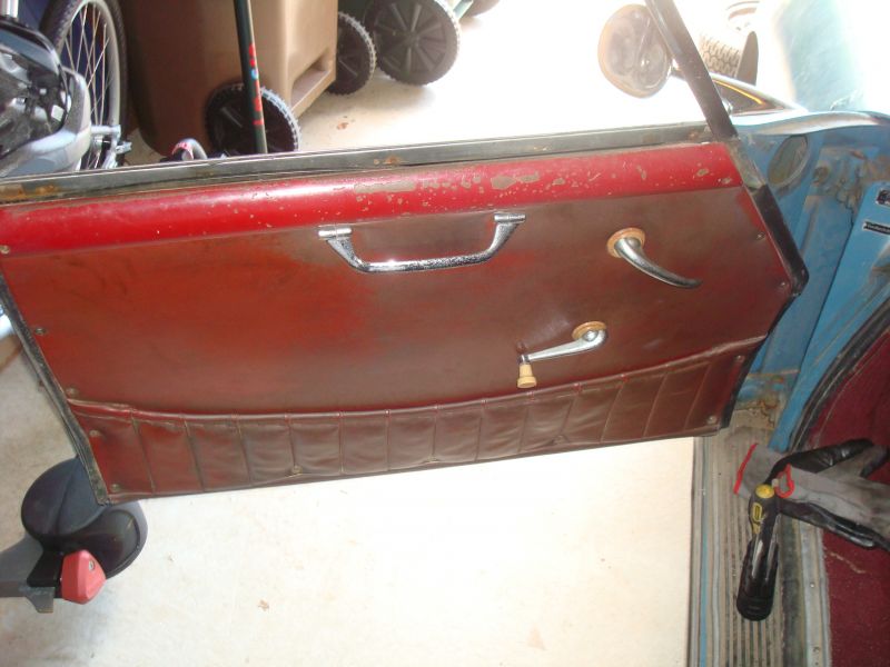

    I have started to tear down the interior, which is going slower than expected as there always seems to be one screw that doesn't want to come out easily and needs some extra incentive. Knowing that every little bit of trim or rubber seal is so important for rebuild or templates, I am taking it extra slow. I have followed the guidance of several members here and have many boxes of ziplock storage bags for small parts and screws, and have written on them with sharpie pen what they are and where they go. As a couple of people also pointed out in the Welcome post, journaling the process/layout/orientation and taking measurements is going to be key to success during the rebuild.

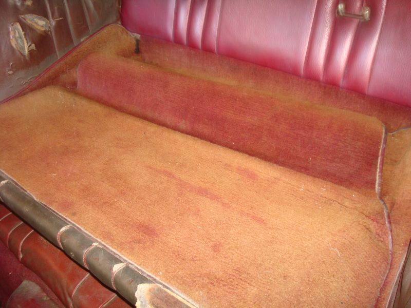

          Also, thank you Justin for the comment on the carpet. I thought the carpet was original, but then questioned it this weekend when I found some speaker wire running to the back of the car under the carpet. I hope whoever changed the carpet used the original as a template, and I am not re-creating a bad install. Based on some of the other ugly work I found this weekend, I am going to assume not and look for some other owners that have original carpet for some layout guidance when I get to that stage.

            I spent some time in the garage this weekend, working to get all the seats, carpet, and upholstery out. It took quite a bit longer than expected, but was very insightful, and therapeutic. A few cans of PB Blaster, and most of the screws came out okay. A couple were very stubborn and took some coaxing to get out.
            I was able to get the front seats out, and the mats below them. Look at those holes. It's a wonder I didn't fall right through when I was sitting in it.

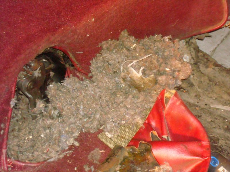

            I found a bit of a surprise in the Transmission bell/Shift linkage housing. Looks like these guys made the trip from New York with me as well.
            With the passenger side door panel removed, the door interiors look okay with just a small bit of rust.

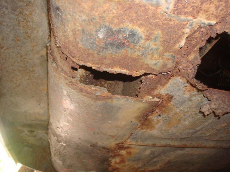

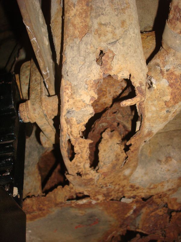

              I got the rear of the car up on jack stands and started to poke around under the car. I found some pretty nasty previous repair jobs, so as DG and Jonesy mentioned, I probably can't do any worse than these.
              Yikes!

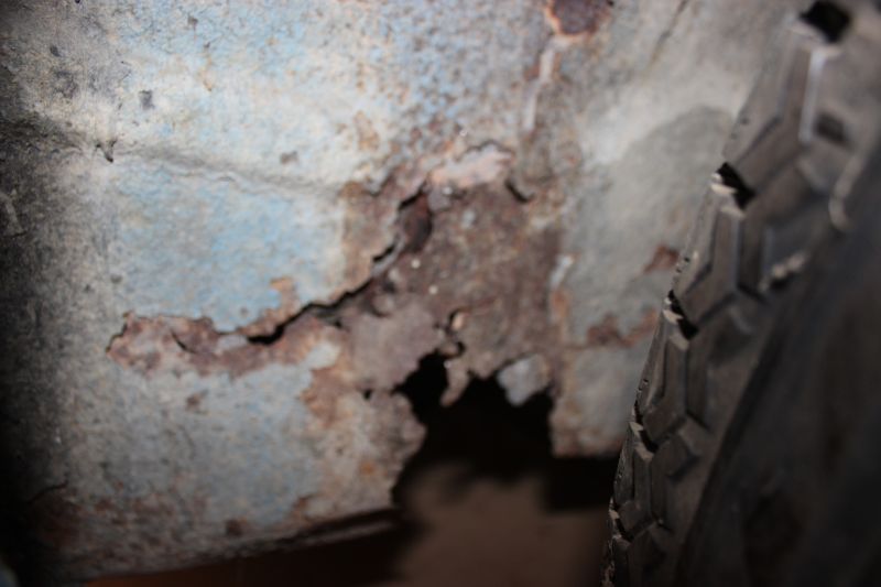

              There are some pretty bad rust spots under the car, with the rear torsion bar support being of main concern.

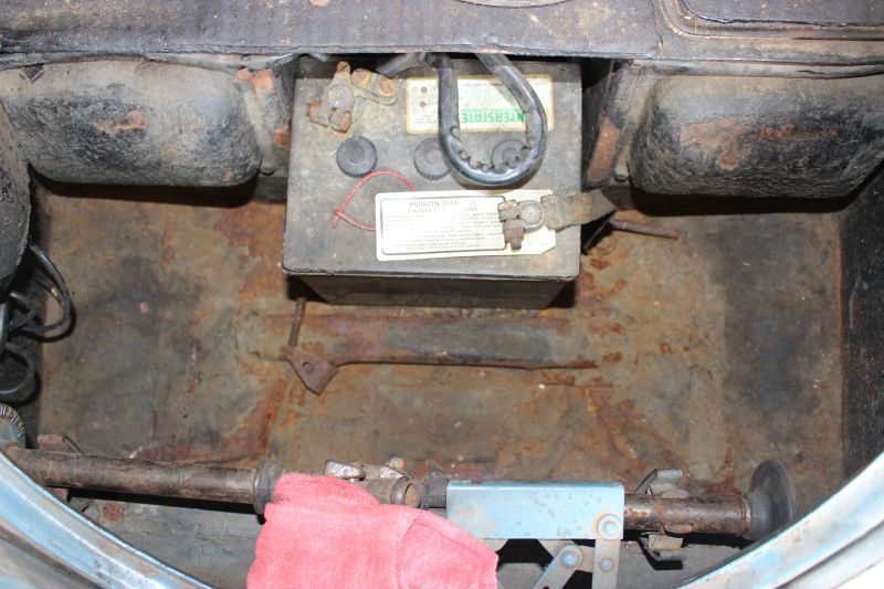

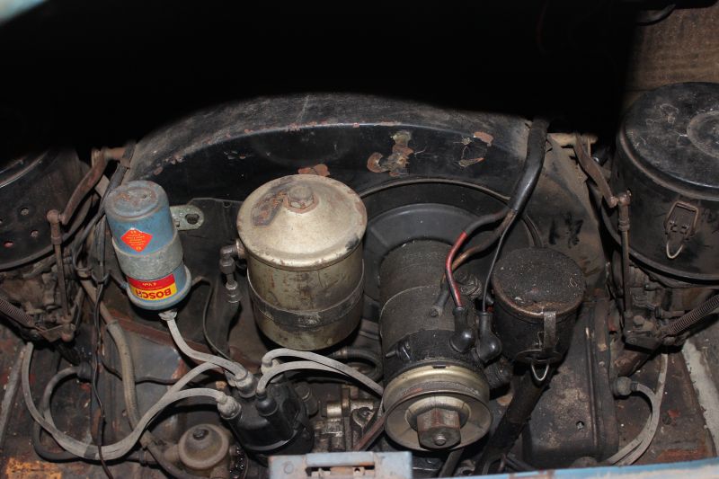

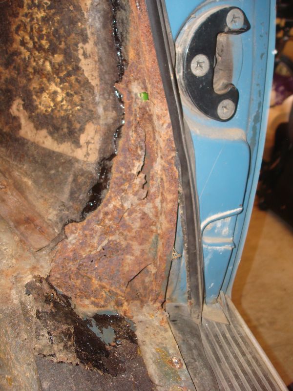

              There are some other rather rusty spots throughout the car, but the battery tray seems to be solid.

                Your door has still the stencilled end 3 digits of the chassis number. The front and rear hood also have the 3 digits. Look on the hinge areas. They are stamped not stencilled.

                Take your time!Pleased Justin confimed like me the carpet is wrong. By the way full carpet sets can be purchased for your car correct with German weave but ask questions on that before you buy as some are not exactly correct on the back seat area.

                  I will add some more pictures of the underside in a bit as well. Warning- they are not pretty. I am really glad that you have seen worse. I wasn't sure what to expect with the torsion damage, and if I was going to get the "it's too far gone" message.
