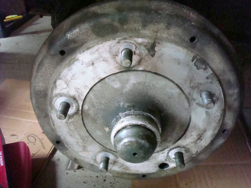

                            Alright, here is the first in a line of likely dumb questions. I purchased the Service Manual for the car from Charlie White, and the smaller "Clymer" style Service Manual. I have searched this forum, the 356Registry forum, and the general Internet with no real success. It must be an obvious job, so no one has written about it, BUT... how do you remove the front brake drums?
                            I have removed the tire/rim, removed the rubber dust cover, removed the cotter pin. I loosened the star wheel to relieve the brake shoe pressure. I tried to wiggle the whole drum assembly off, but it doesn't seem to budge. It rotates freely. I don't want to start smacking it with a hammer until I am sure I have the correct pieces taken off.
                            Do I need to take off this black cap before the drum, or will this come off with the drum, and I just need to tap it from the back?

                              That "black cap" is a dust cap. It is just tapped on with a mallet a sort of press fit. You can try pulling on it (kind of rocking it side to side) with channel locks which will likely leave marks or look closely around the edge where the steel cap ends & the aluminum drum starts. Try to tap a slim screwdriver or chisel in there to "force" it out. Again it may leave marks. Once it starts to move you can go around it in different spots tapping the screwdriver in to remove it.
                              Once removed you should find the wheel bearing locknuts. Either two nuts jammed together or a single clamp type with a small allen bolt. If the allen bolt type then loosen the allen bolt & unscrew the clamp. If you see two nuts then remove them. Once removed the drum should pull straight off, be careful not to drop the bearing in the dirt as it will be loose in the end.
                              Hope that helps.

                                I am so glad you are asking questions like this. There is an assumed body of knowledge, and I, for one, have always found that assumptions are the mother of all f-ups.
                                These Porsche front ends are similar in engineering to VW. That cup shaped item in your first pgotgraph is just a cap that covers some nuts underneath If you get a broad faced screwdriver or other similar tool and use it to lever the cup off, it should fall away pretty easily. You may need to force the issue a little with some gentle strikes. It is pressed laterally on ( ie, towards the centre of the car) and the point of purchase is in behind the first little lip. The cup is slightly domed shaped, like a mushroom. Gentle persuasion around the whole circumference, a little at a time, should get it started.
                                That should get you started, but there may be more dramas with the bearing races..
                                Good luck!
