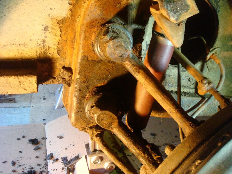

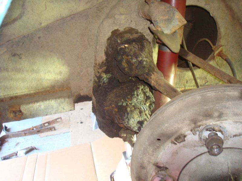

                        Fellas- I have another set of questions that I hope someone can help with.
                        I was able to get another couple of hours in the garage this weekend, and am bouncing around the car a bit. I cleaned off the front suspension "knuckles" (I think that is the right term) as they were covered in a thick build up grease and muck.
                        I cleaned them up a bit. so they look better, but not great.

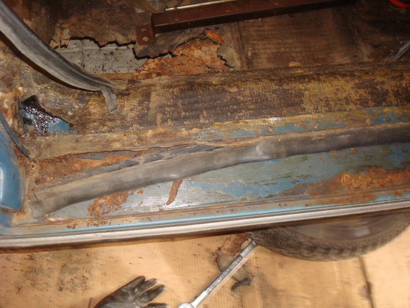

                        While working on getting the door sill trim off, I had a question on the rubber seal and its removal. I started to pull the wide rubber seal that looks to be installed between the longitudinal weld seams and the door sill itself.

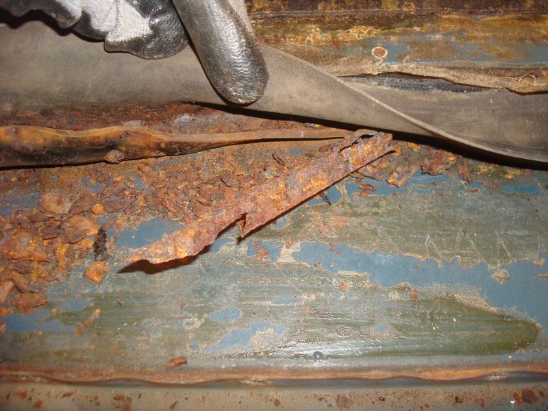

                        When I started to pull this out (pulled straight out from the center of the car to outside, similar to opening a door) it started to pull out this very rusty piece of metal.
                        My question is... is this a piece of bent metal (looks like a 3 sided box) that is pushed in to hold this seal in, or am I removing this seal incorrectly, and pulling out a rusty frame component that I will not be able to recreate if I continue? I don't see any references to how this section goes together. I looked in the Stoddard parts catalog in hopes of seeing a part exploded view.
                        • #42
                          It's a U channel that holds the threshold seal. Look for the the threshold seal section in your Stoddard catalog. PN 644 551 917 00
                          Joel

                            Looking at the photos, the brake lines are corroded and frozen. Get a small stainless wire tooth brush. Clean them well on the hard line side, about an inch back from the flare. They will clean up and look shinny but dark with the brush, then put a little penetrating oil on the tube and nut. You will need to each junction , master cylinder, each wheel and above the transmission. There is rust on the tube, inside the flare and on the threads both. But they will free up and come off.
                            A few days later you will need a flare nut wrench for both sides. One on the hard line flare and the other on the hose. Brake them loose, watch the tubing and make sure it does not turn with the smaller fitting flare. If it does, just re brush clean and more oil on the tube interface, when loose re lube them wait and hour, the tighten and loosen 1/8 turn back and forth until you feel the free up The flare will now come out with your fingers. This may help you save the hard lines. Mark them by wheel. Take photos
                            There in a company in Argentina that bought the old ATE tooling / drawings and makes the original lines, or you can use the new SS Teflon flex lines. The old tubing should be OK unless the line is kinked or twist with flare fitting. The hard lines are made from very soft steel , but they will clean up. Look for pits inside with a strong light. The inside the tubing will be dark, the pits are black. You can push a bailing wire through the tubes and look for goo or rust flakes then Sit them aside in the brake box for reassembly in a year or so.
                            Now you have good samples when you fabricate the new hard lines with.
