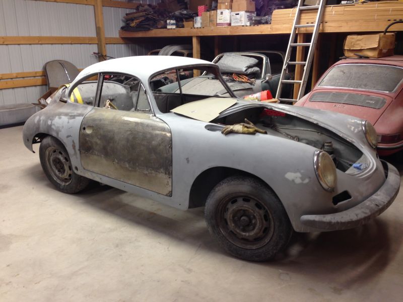

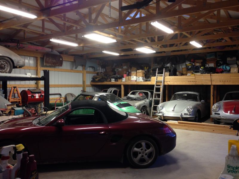

          I really should get rid of something anyway (Swiss Miss maybe?) Here is a shot of my shop after re-arranging to store the silver car for a little while.

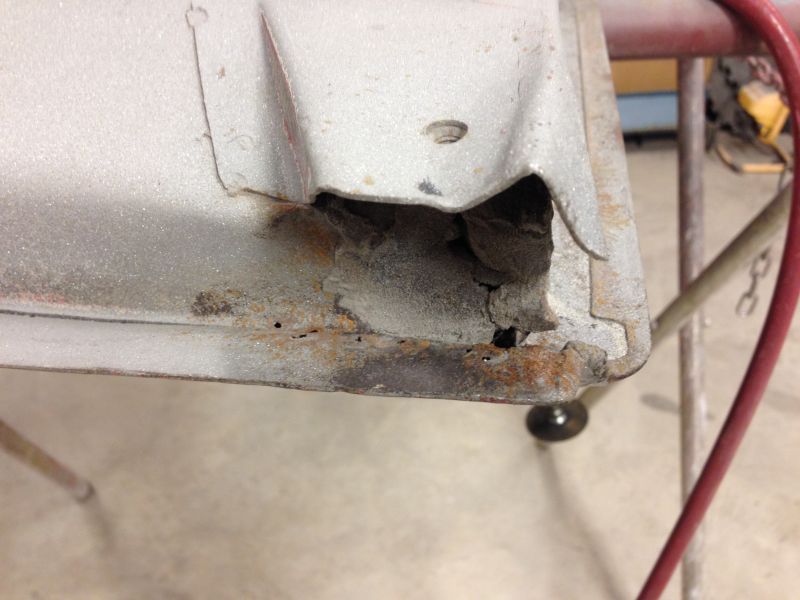

                In yet another odd coincidence, John and I were working on doors at the exact same time. Although I've patched doors in the past, I had never done a door bottom/lower skin replacement before. Started by reading Tom's very thorough blog entries. Then followed Johns posts closely, and especially the followup comments from Bruce, Jack, Phil, etc. See? Somebody really does read all this stuff!
                Initially I was thinking I didn't have much of a problem. Just a small patch job. But closer inspection suggested bigger troubles.

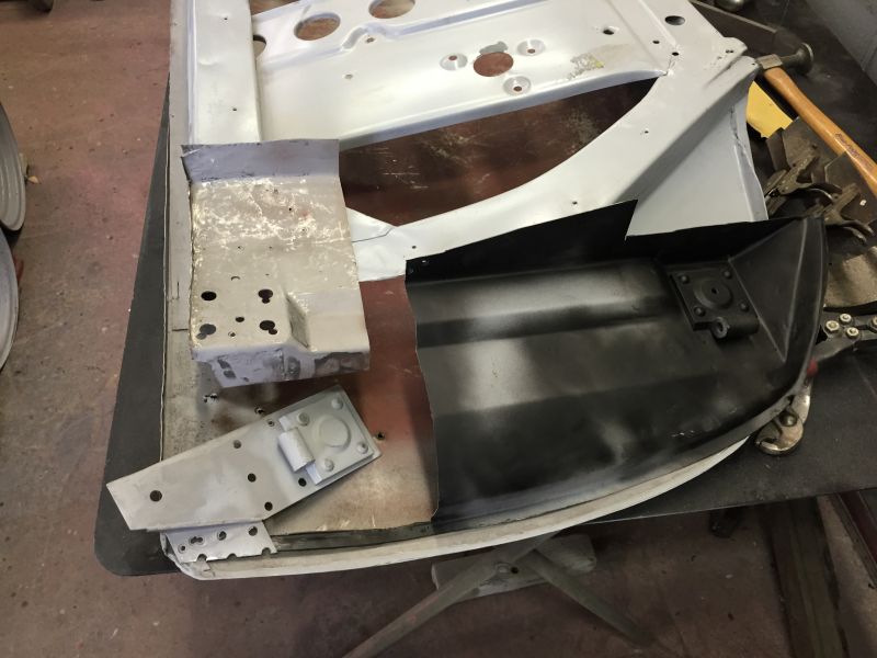

                Obviously going to have to remove the stop bracket too.

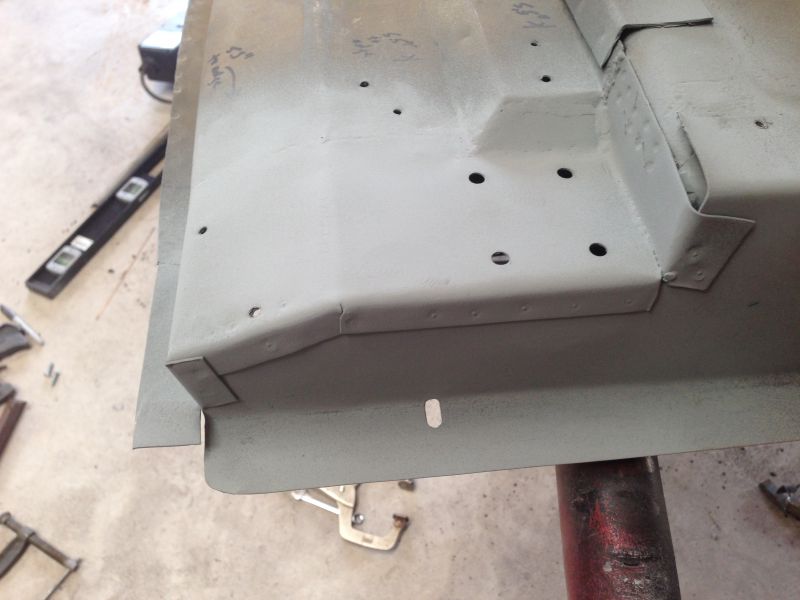

                Before I went any farther, I fabricated a new stop bracket, and insured it fit correctly.

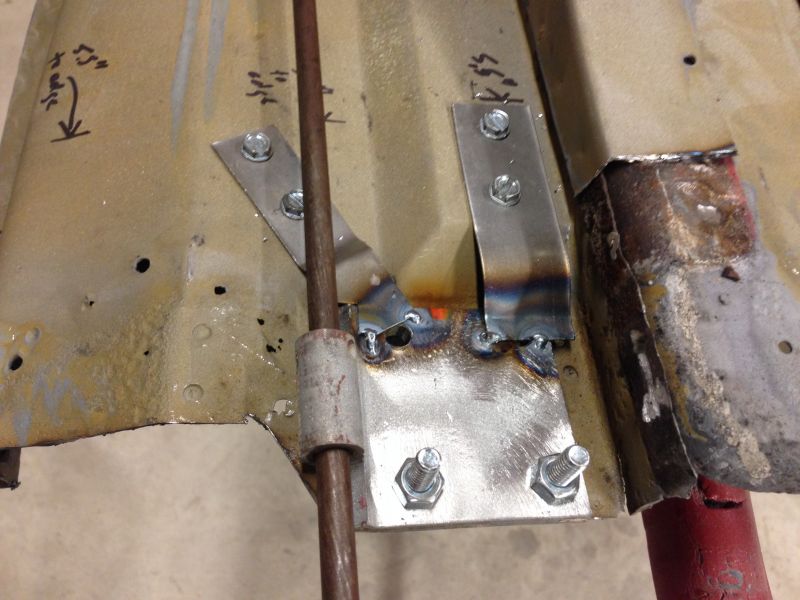

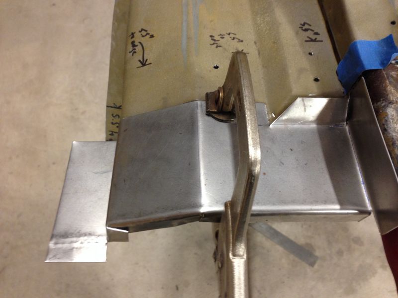

                And so I could put the lower hinge back in the right spot, after replacing the metal underneath, tacked a couple of locating tabs to it and screwed them to the good metal higher up. Rod verifies alignment with the upper hinge.

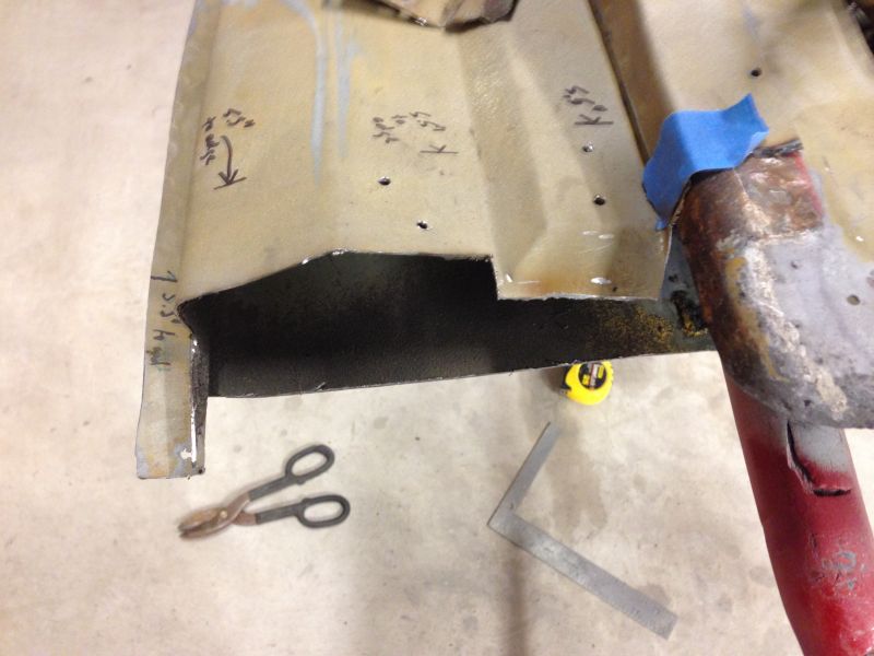

                Bad metal cut away.

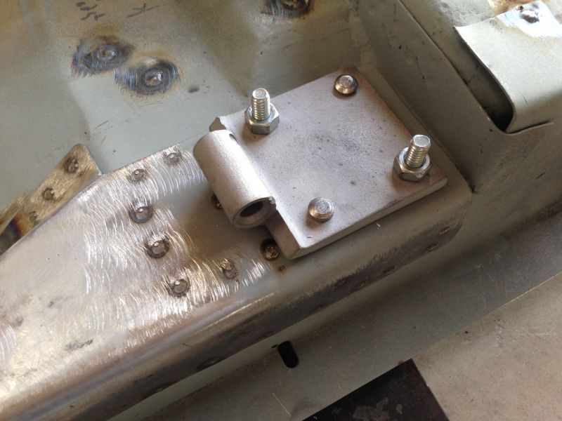

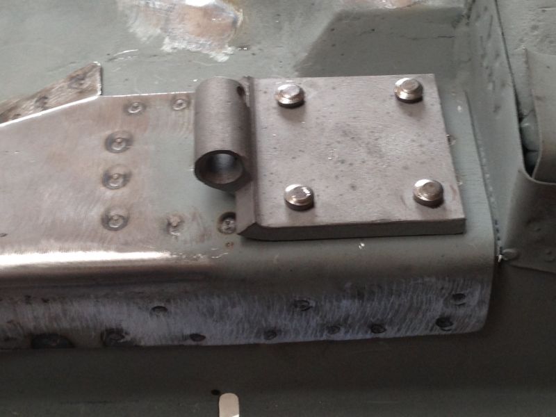

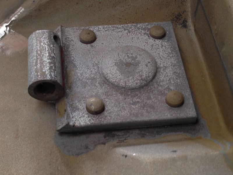

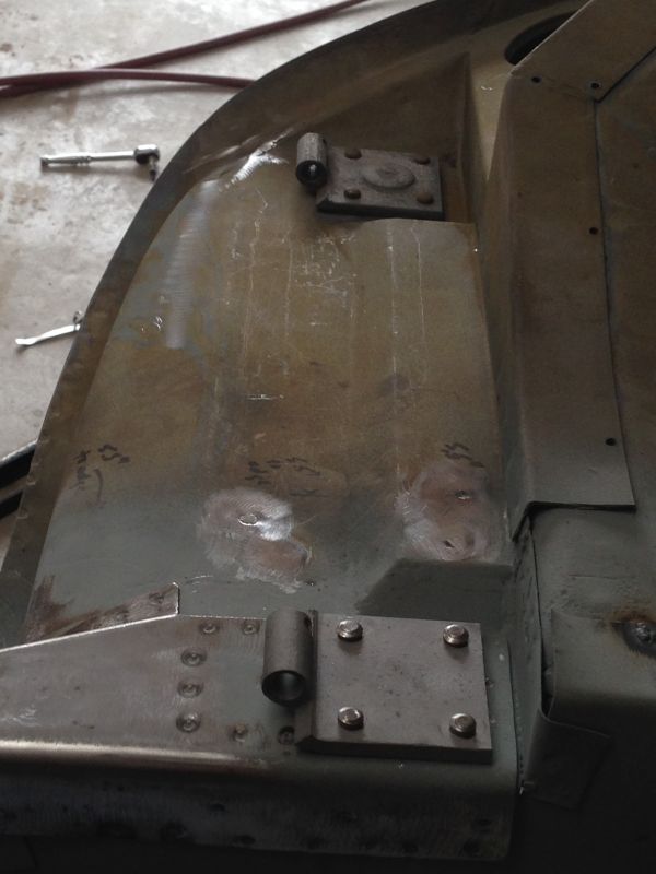

                  Then I put the lower hinge back on. Initially bolted it in place, and test fit to the car. Then went back and replaced bolts with rivets.
                  Was a little worried about the riveting process, but the end result is nice I think. Looks close enough to original that few would notice it had been removed/replaced.

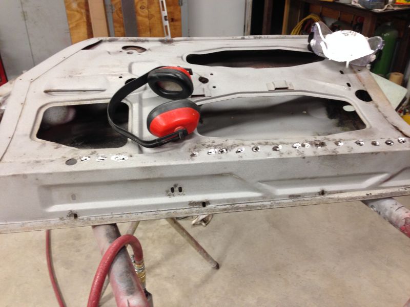

                  • Now on to the outer skin. Trimmed the flange of the door bottom to fit the opening. So far so good. Then I welded the new skin repair piece in place. So far so good. Then I folded the lower edge of the skin over the door bottom flange. Looked beautiful. Then I put it on the car......had about a 1/2" gap in the middle of the bottom of the door. What happened? In the process of hammering over the skin, I was also hammering upwards. Since the door bottom is only secured at the ends, I was hammering it upwards too. Aaarrghhh! I cut the outer skin off again just above my recently completed (and for me, unusually clean and smooth) weld. And that's where these photos start.
                    Checking things out and re-aligning the bottom door gap. The original skin went all the way from front to back, but I was really happy how the frontmost couple of inches looked, so I left that bit when I cut the remainder away.

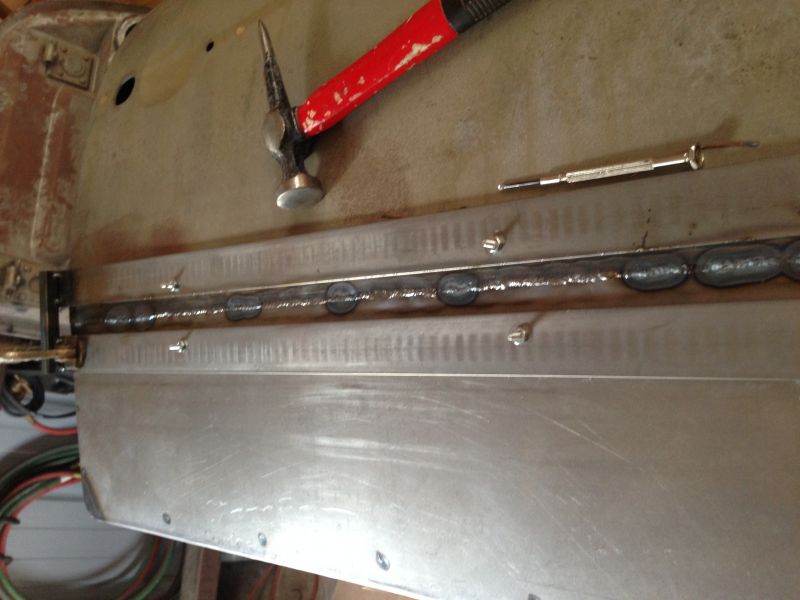

                    On this attempt, I bent a flange on the bottom of my repair piece, using the brake. Then I placed and fitted it. Then spot welded it to the door bottom flange every 5 or 6 inches. This photo shows the welding process after all that had been done, as well as the jig I used. Rather than clamp the jig inside/out, I predrilled small holes in both pieces, then bolted it in place with machine screws through the skin. Left me with 10 small holes to weld up afterwards, but no big deal and seemed to work well.

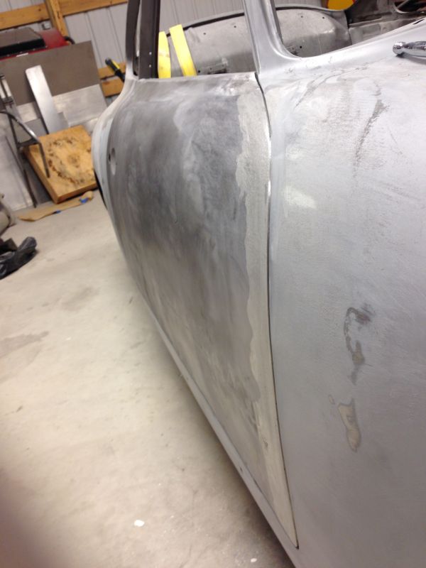

                    Finished product, after (again, just like John) about three days of heating/beating/shrinking. Far from perfect, but close enough for government work.

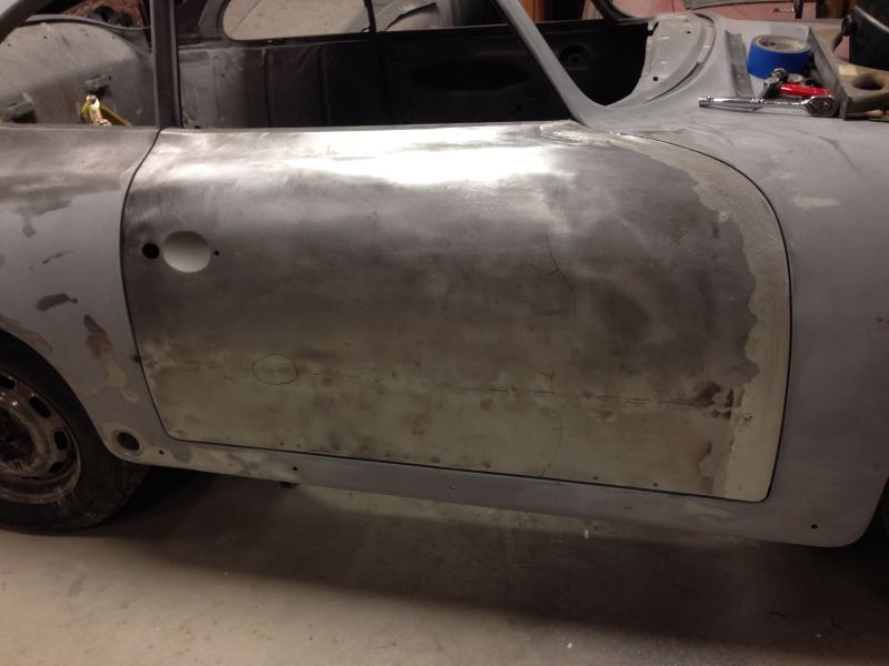

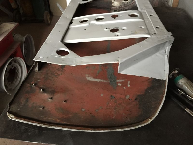

                          David, the "spring" you recognized is not rust, in fact that may have relieved some from when the parts were assembled on a jig in a "forced fit" energy that can be released when major repairs are done.

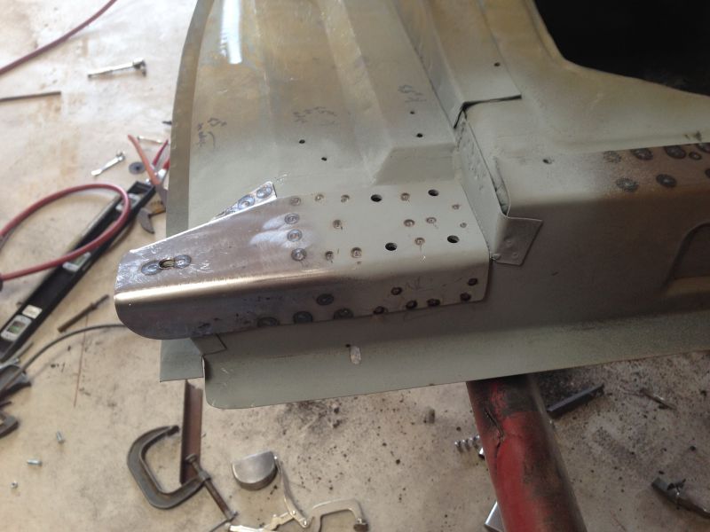

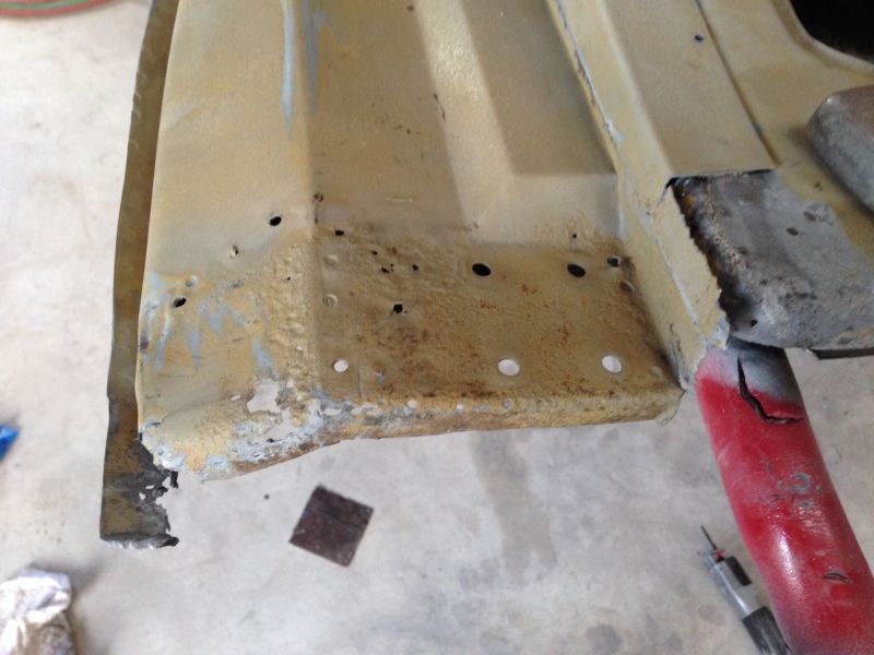

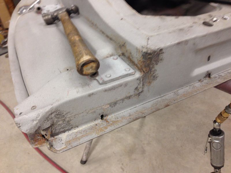

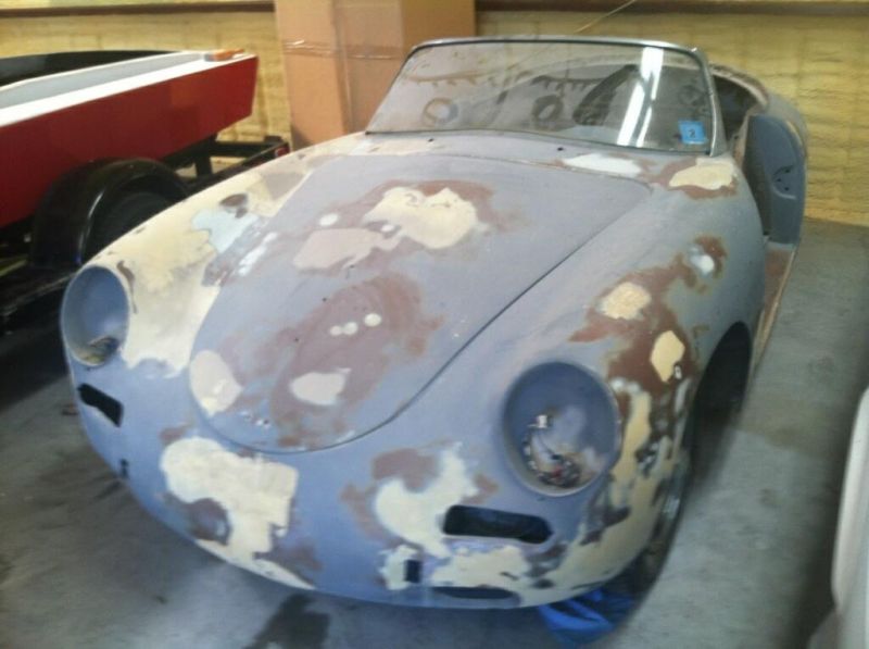

                          The 356 that this door is from was hit all over, whether in one multiple hit crash or many. It's a rare enough Cabriolet that it is being done "correctly" and a LOT of energy is being released as damage repaired poorly in it's past is pushed, pulled and cut apart. Unibody cars are more challenging than older framed cars and the worst is the combo of rust and collision. Luckily, the early Cab was not really very rusted...just a victim of repairs done when not worth much at all.
                          I wish I could say "keep up the good work" as a hobbyist speaking as one who is working on his own car as you guys are on your own. I can't, as my personal A sunroof Coupe languishes under a tarp, sitting on a chassis dolly, year after year.....while I read and see the great work here on Justin's site as a tease and I slowly bring Parts Cars back from the dead and into the realm of Restoration Candidates for a "living". Drat!
                          PS, that inside color is orange primer seen most on early 356s. As this Cab was stripped, several primer colors original to this car were found. We have evolved into "enthusiasts" who need to know that sort of trivia. It's not new, it's just yet another challenge with which to keep up. I have yet to be asked to match primer colors when doing a restoration but I'll bet some of the Big Boys have. Whether they have really done that or not, well........I, for one, would argue for 'better chemistry available now.'

                                Can you tell me where you sourced the rivets from? I haven't seen them from the usual vendors. Any tricks with the process? Did you heat them? Hand hammered with a backing dolly? Any advice appreciated.
                                Jonesy
