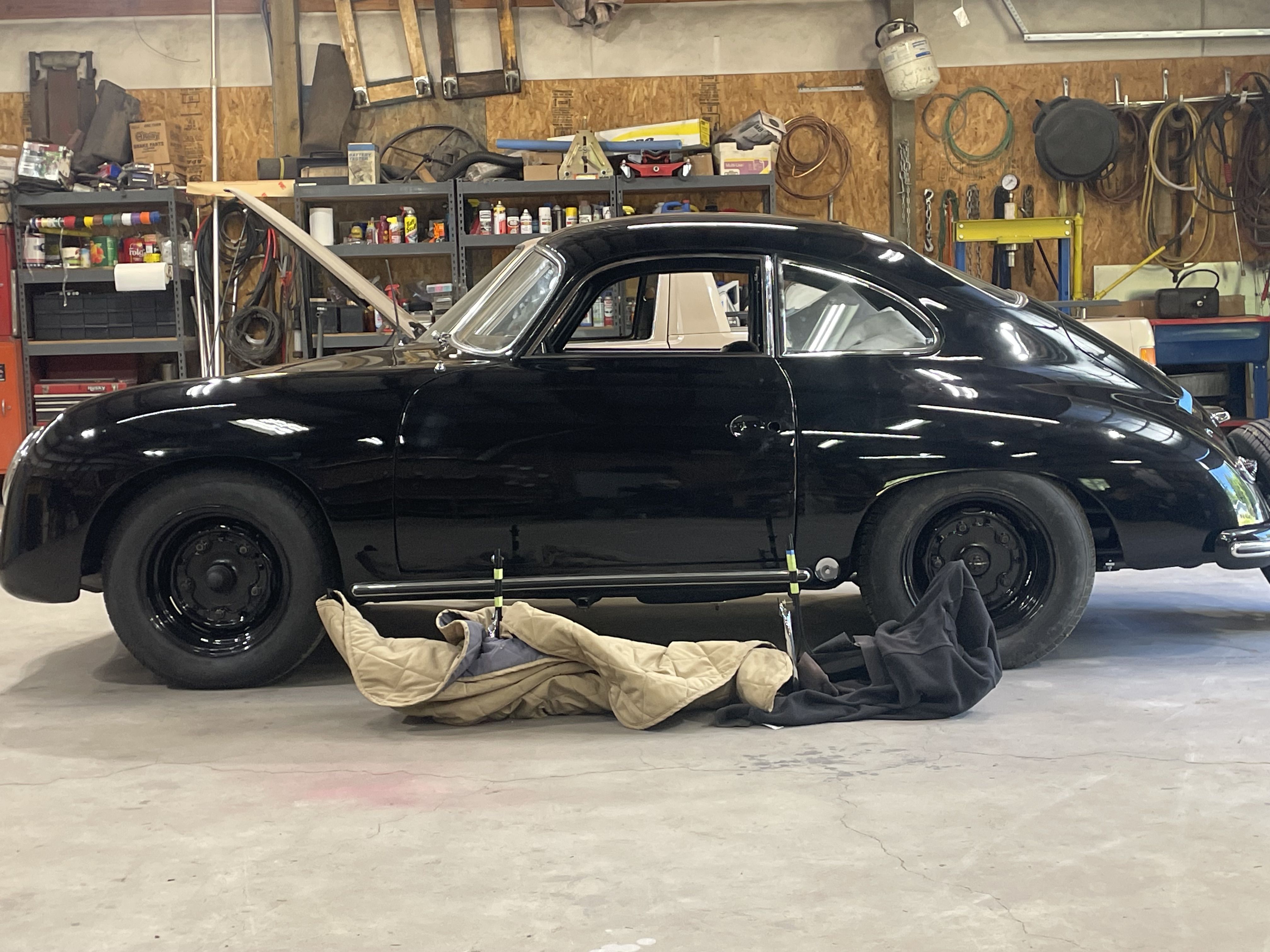

Another long term storage, this time a T-1 Coupe

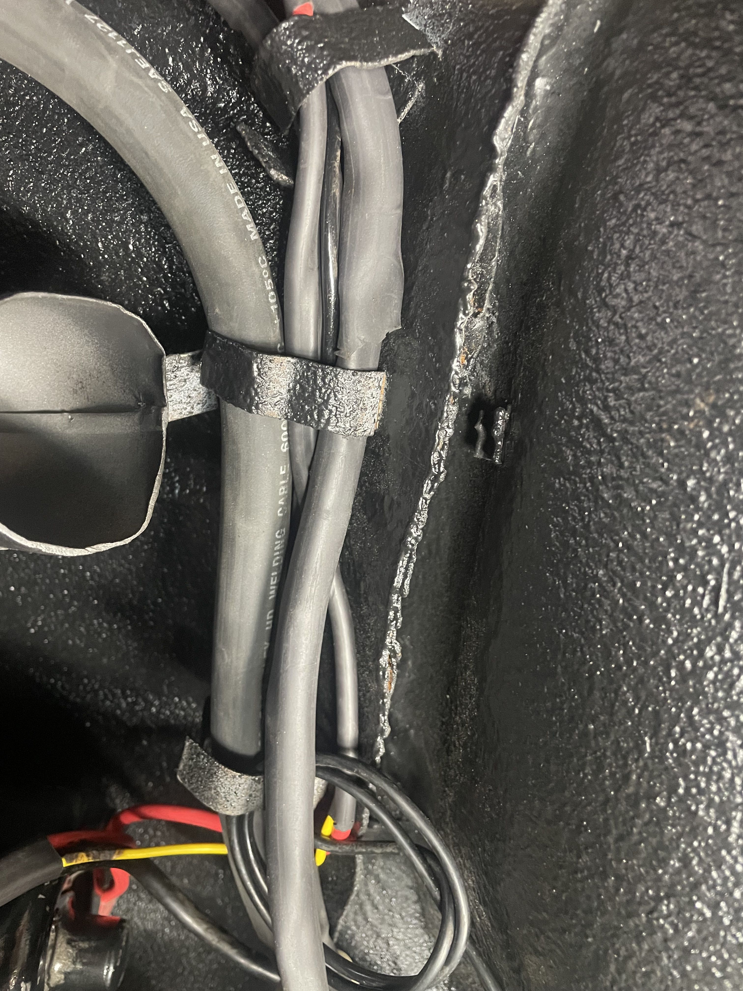

    Spent the morning heat shrinking and re routing the rear harness. Installed a remote starter switch for maintenance and hard starts. Just a simple 12 mm marine momentary switch next to the voltage regulator. Wire from Batt on the regulator, through the switch to the 50 spade on the starter solenoid. I will also install a hot start relay on this one at the same time. So both the key switch and the button power the coil on the relay. Simple and should be done on all the 356’s.

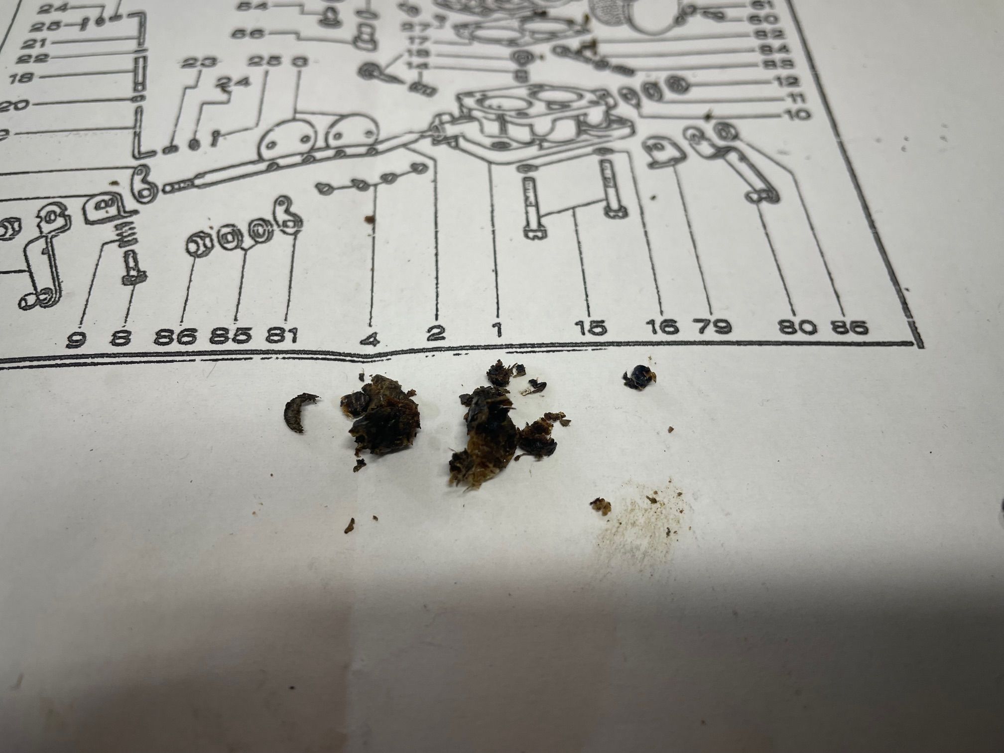

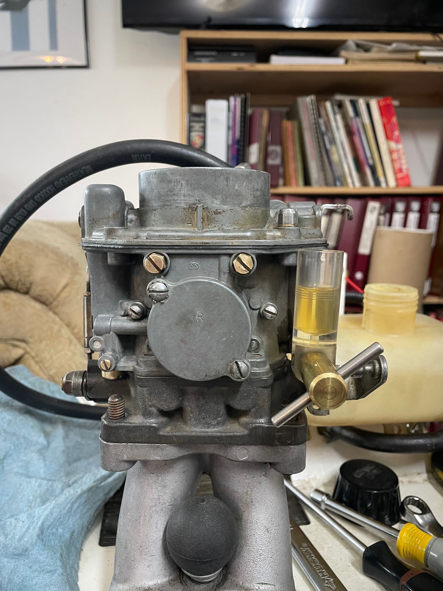

    On a funner note today, rebuilding the carburetors. went through the dip. then the ultrasonic cleaner, and blow out the passages with air. I reassembled them, they looked very good, went to leak check and set the float level . I leak check by putting 20cc of gas in the vent tube, and let them sit, then look for shinny or wet spots. Then I run the pump and fill the bowl an check the level.
    Well one wont fill. pump runs, no fuel in the P-Tool. Pop the top, lift it run the pump. no gas through the float valve... Pull the valve, blow through it is good, try blowing through the banjo fitting, no luck, Ah Ha passage plugged, blow it with air, no luck. probe it with wire, it goes through and see some black debris, keep probing, the put a plastic tube form a aerosol can it from the small end and push out the carcass of a beetle from the passage. it was about the size of the passage. I have no Idea how long it ha been in there.

    bug debris remnants on the left, a good carb on right.

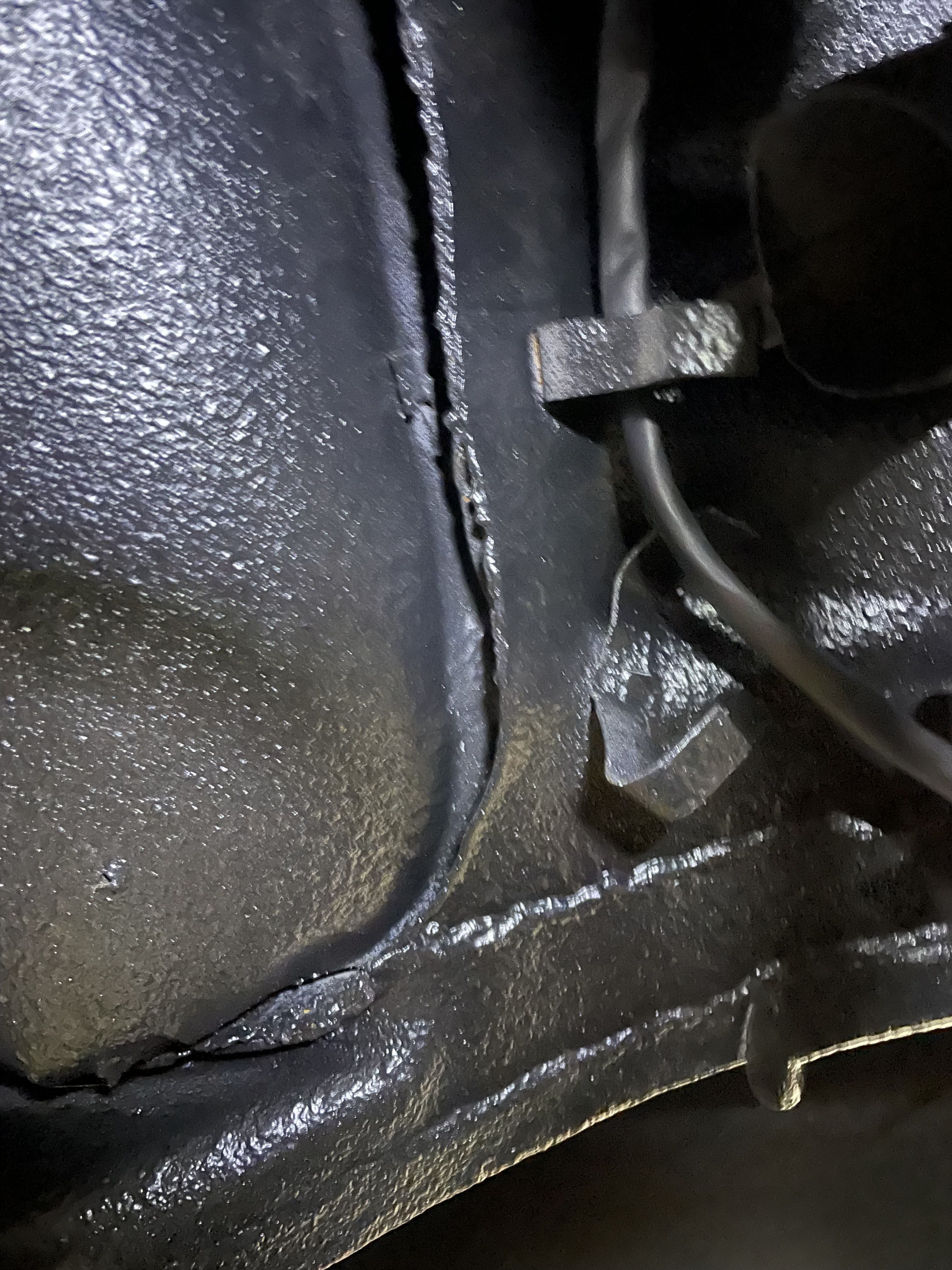

      Interesting joint where they grafted in that T5 rear seat pan.

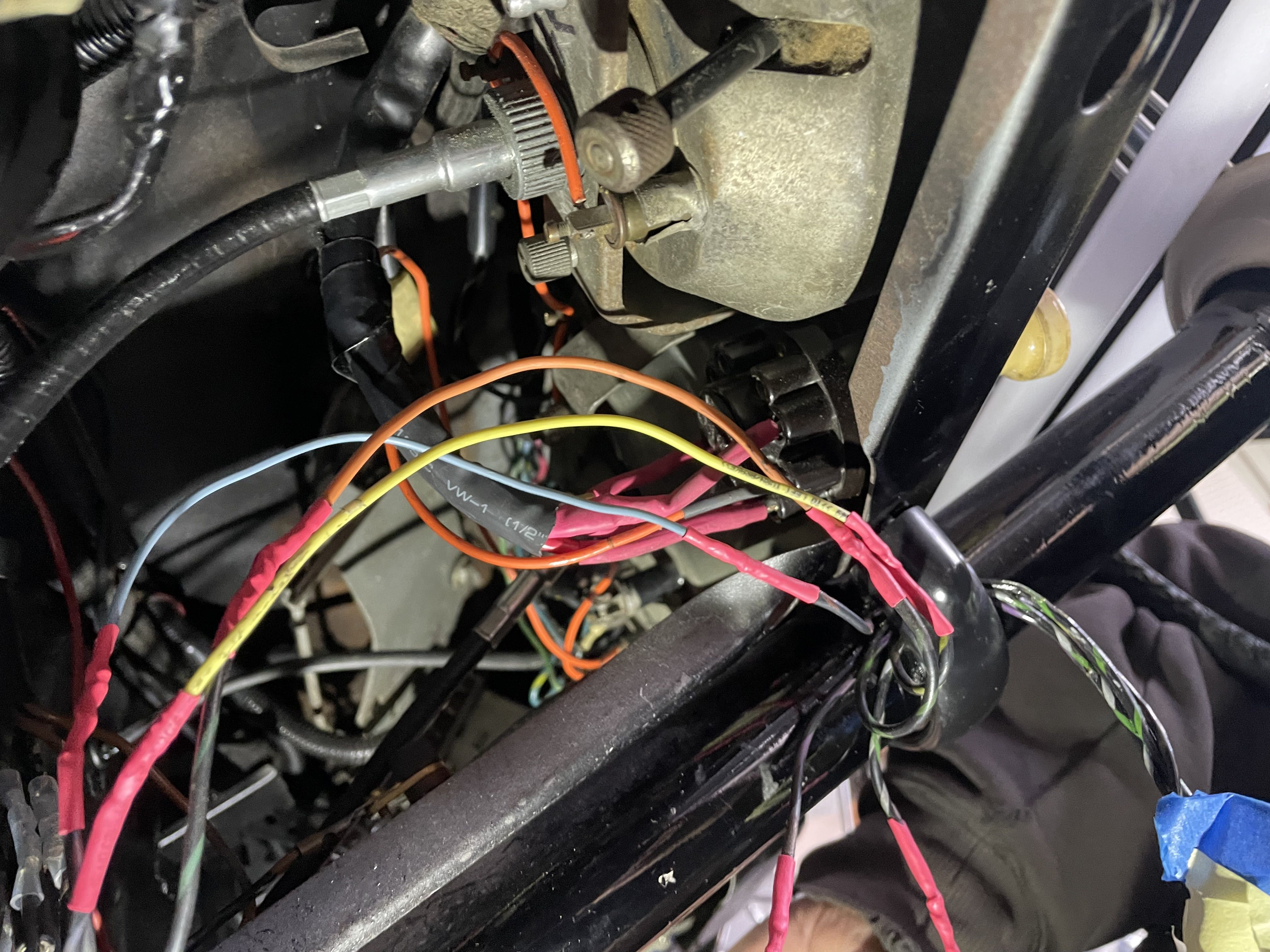

    Not sure on the trans yet. They swapped the nose to a 741 I think, it’s on the ground and hard to see right now. They hacked in a T-5/6 shifter and piece pipe. Then Installed the shifter rod after the trans was in, by chopping some on the center tunnel. Just not sure why, I really need to look at the forward trans mount. Welds are poor but I have not measurements yet.

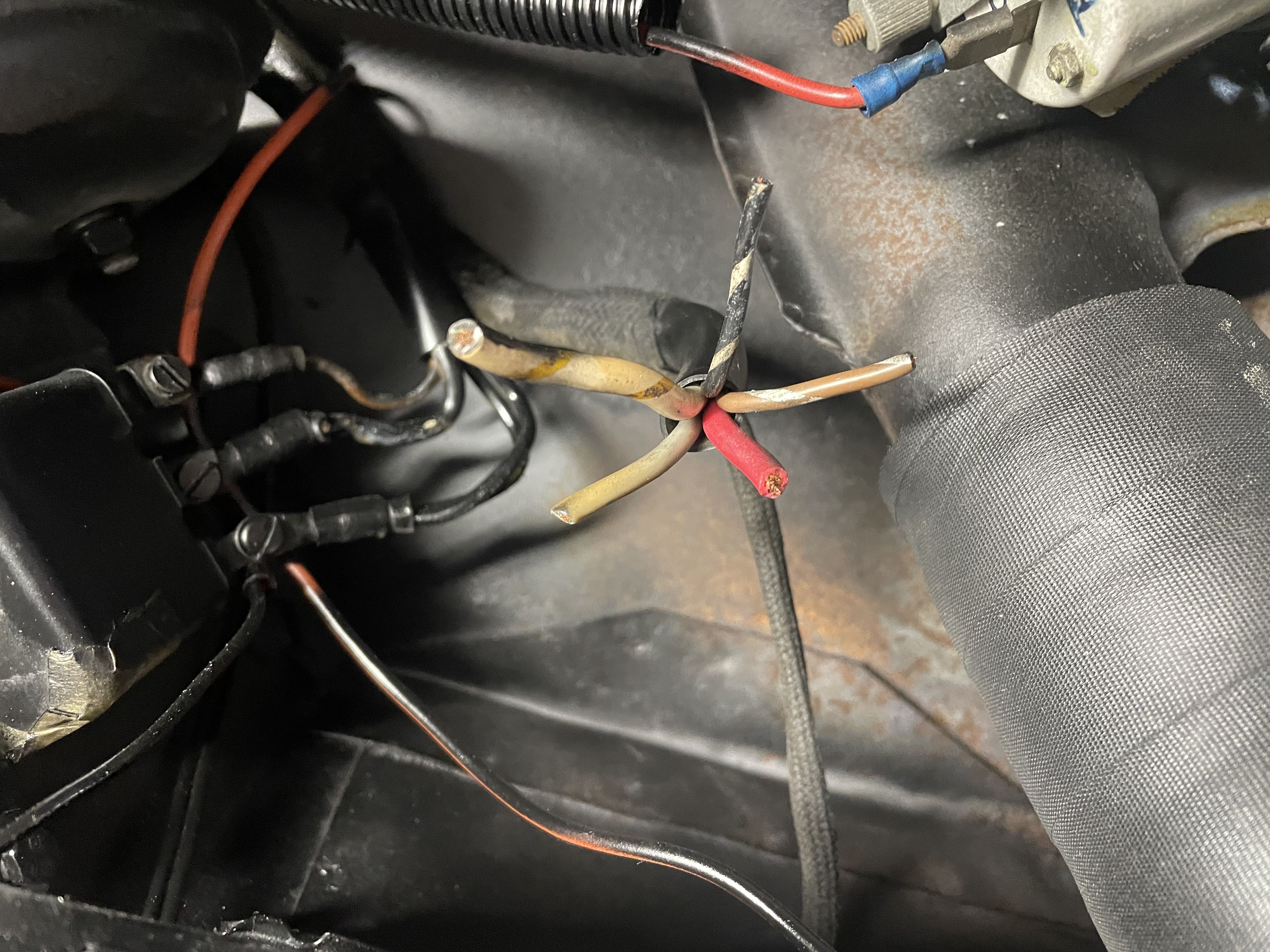

    Spent the last few days chasing wires, and the turn signal stalk. The wires were chopped off, the single color wires crimped in the ends. Laying on your back under the wheel is so much fun. Not sure about a couple things yet, T-1 used a brass block and screw for connections, now some switched are original for some bullets and some spades. Like the ignition looks like a 911/912 key in the back but wired like 356 with spades and the original key fits.

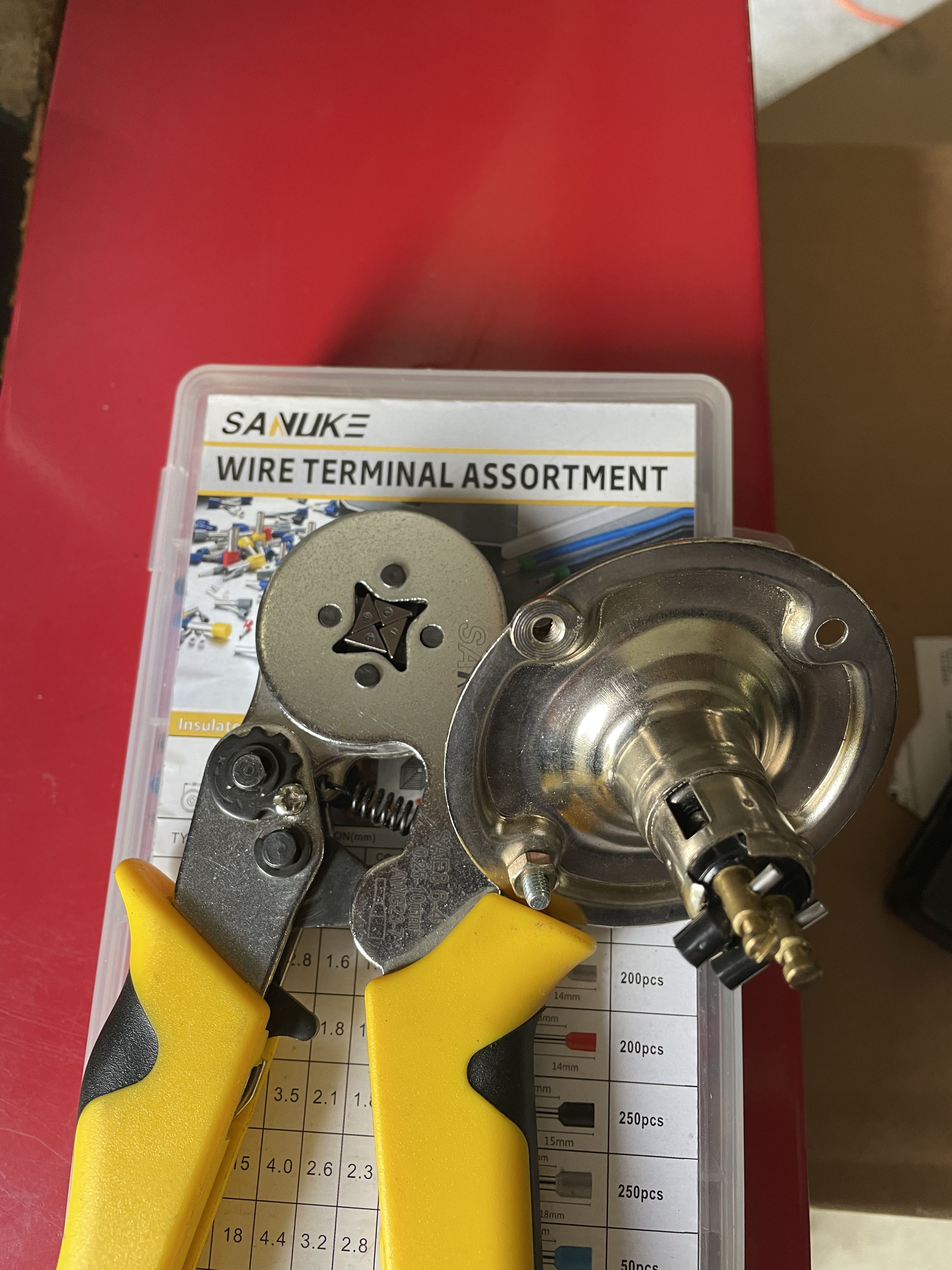

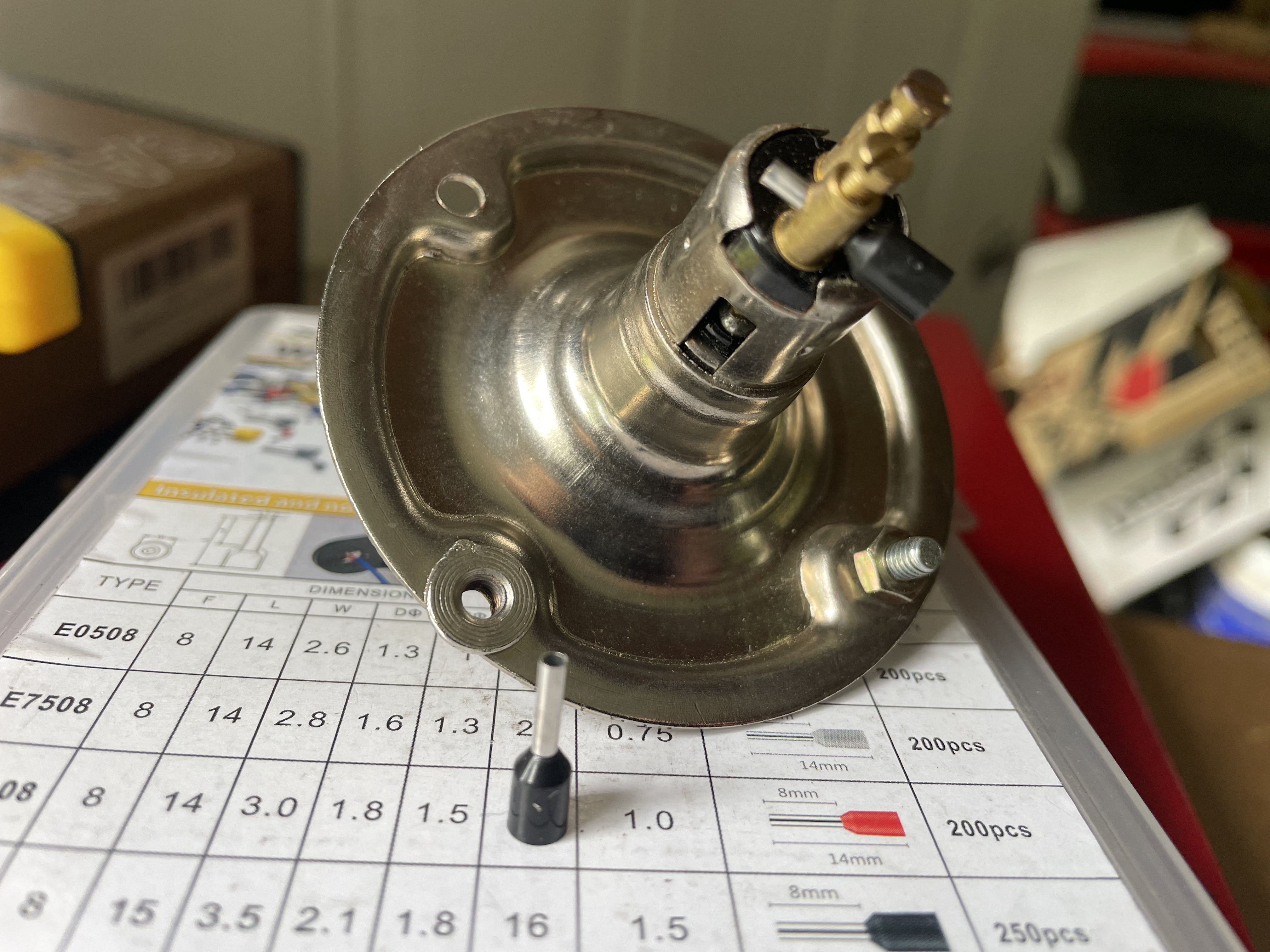

    Also using ferrules on the new wire connections. They crimp over the bare ends and make assembly simpler

    wires are always so much fun, after simple hydralics.
      I like those termina ends. Yes, very few bullet connections on a T1. Most connections under the dash were spade.

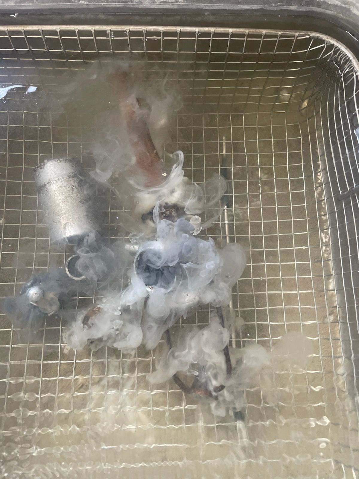

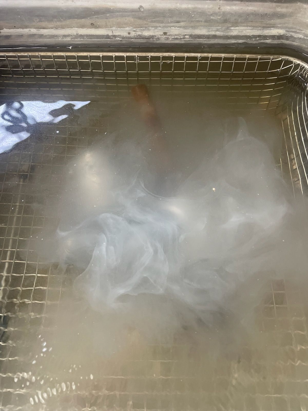

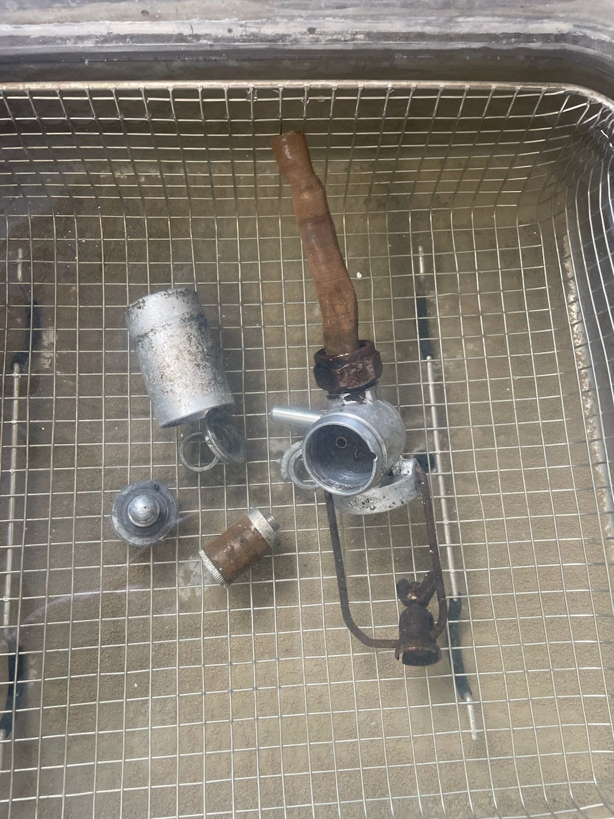

    Back to the ultrasonic cleaner. photos are Before…. Then On for 3 seconds…… then 10 seconds later….. it is really fast at first, the goo just jumps off. This was pretty nasty inside after this the pump is probably next.
    Click image for larger version  Name:	76826934477__1A427017-A304-4026-A450-BF16BEDA15EF.HEIC.jpg Views:	7 Size:	335.7 KB ID:	116560 Click image for larger version  Name:	76826935587__AB58AFAC-E10F-4771-8225-B4A38B77DD9B.HEIC.jpg Views:	7 Size:	250.8 KB ID:	116562
    Click image for larger version  Name:	76826938593__DC5FDB08-BD7F-4C18-A86D-A891F776A192.HEIC.jpg Views:	7 Size:	185.0 KB ID:	116561

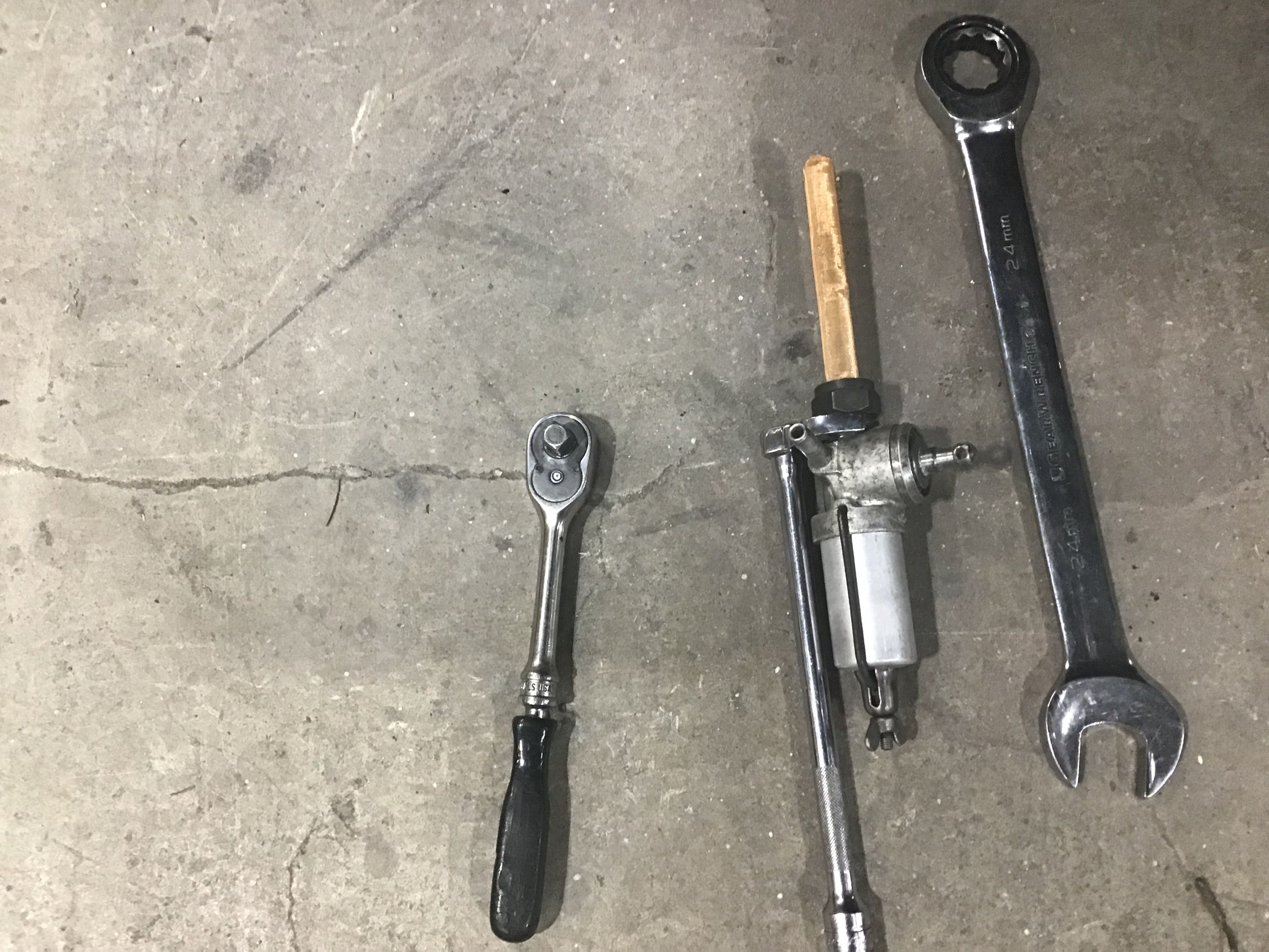

    Short 24mm wrench, 19mm crows foot. The nut has left and right hand threads, so you turn it down to the base, then screw the nut into the tank, keeping the selector point to the tube you hold it straight with the crows foot and seat the nut into the tank. A bent 19mm might give clearance between the wrenches, but crows foot was fine.
    Click image for larger version  Name:	IMG_2144.jpg Views:	141 Size:	904.9 KB ID:	116563 Click image for larger version  Name:	IMG_2143.jpg Views:	160 Size:	798.1 KB ID:	116564
    If you get a cleaner it “can't be too big”. You can also put parts in a glass jar, with different chemicals and submerge the jar. The sound goes through the glass, works well. I hope to finish the wiring, and get the engine started by the weekend.

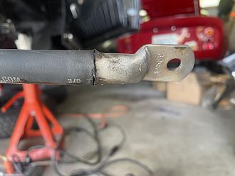

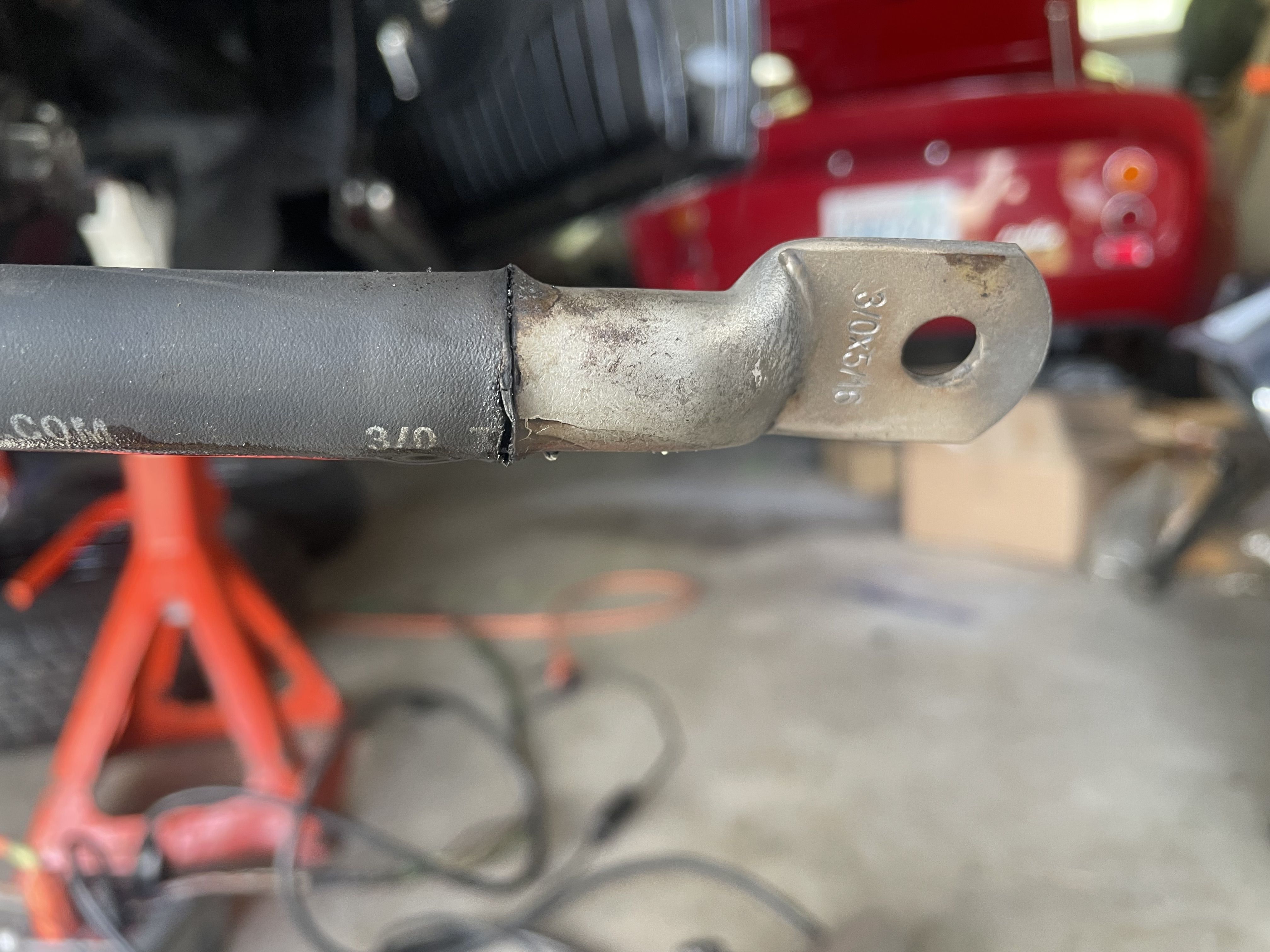

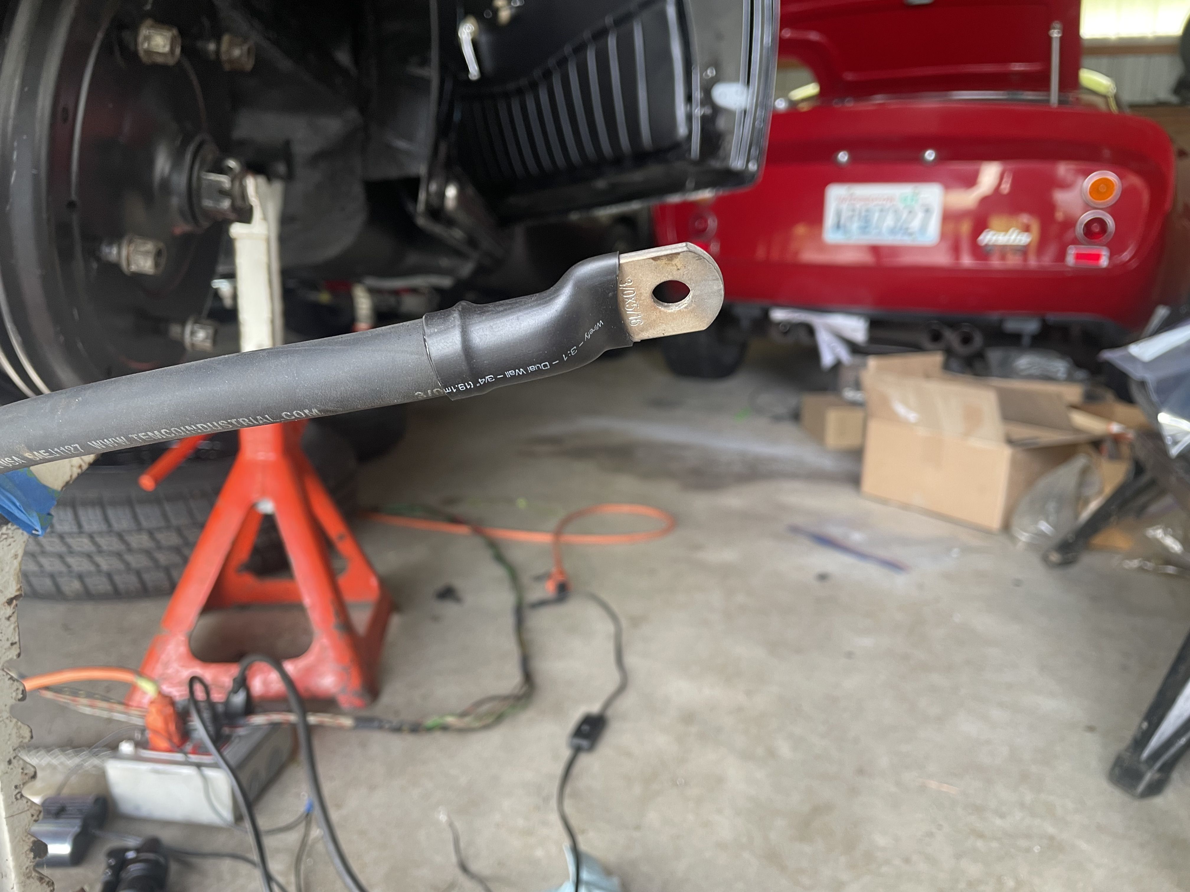

      The battery cable is done, dip soldered and just a little longer than original. Too many skinned Knuckles over the years from the original wire length. I think only 5-6 more days of wires, then the carbs back on and it might be ready to start. Tail pipes are fitted, made from stainless, almost stock, probably a little louder!

        Cable end looks good. you do nice work. Like the stance on that A coupe with the hood straps.

      Carburetors back on, I hope to move on to the engine for a while. Will start with valve adjustment, then a leak down series. If that looks reasonable, then compression test. After compression and oil fuel pressure validation, we will do a full electrical tune. I need to put the muffler and tail pipes on before trying to start it. Debating clamping or welding the tail pipes, it a Dansk muffler, so I know I will need to measure and straighten and parallel the head flanges. The tail pipes are .087 wall 304 stainless tube, so I may laser weld them. That will give me something solid to pull on.

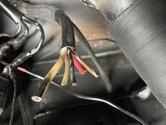

        Boobb chopped off all the wires under the dash, everything is short, even the main power cable between the battery and fuse box. . It’s a real mess but we are slowly overcoming all the defects. The light control relay is missing, and unobtainable. I can use a modern double pole single throw relays to replace it. Might be better in the long run.

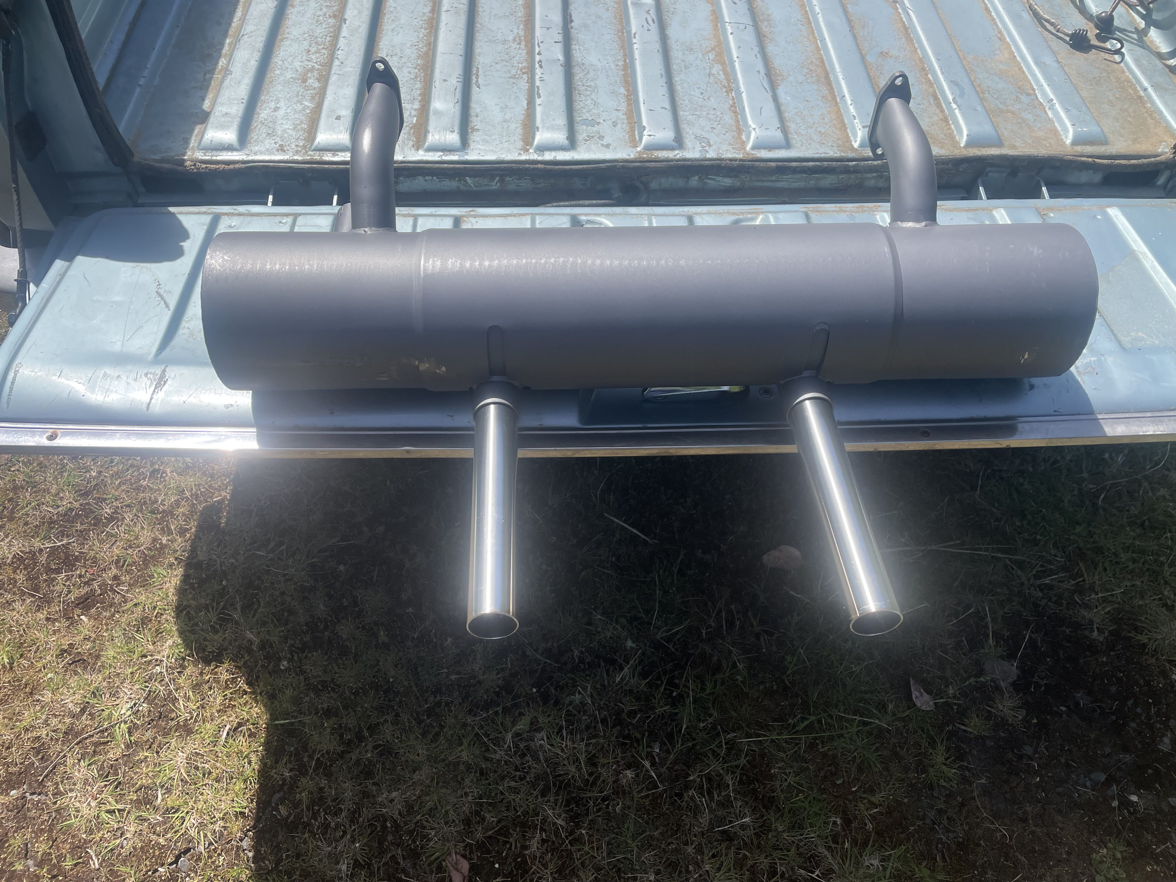

          Not much new. Another week of wires, the more I look, the worse it is. some mufflers parts came in, so I can fabricate tail pipes. Photos show the ferrules I use on the wires. These make stranded wire easy to manage. They crimp around the bare wire. Shown is the new harness into the beehives, works well. The crimp tool and kit is pretty cheap, it makes life easier. The authenticity police might not approve, but some things have improved over time.

          tool link:
          https://www.ebay.com/sch/i.html?_nkw=ferrule+crimping+tool+kit

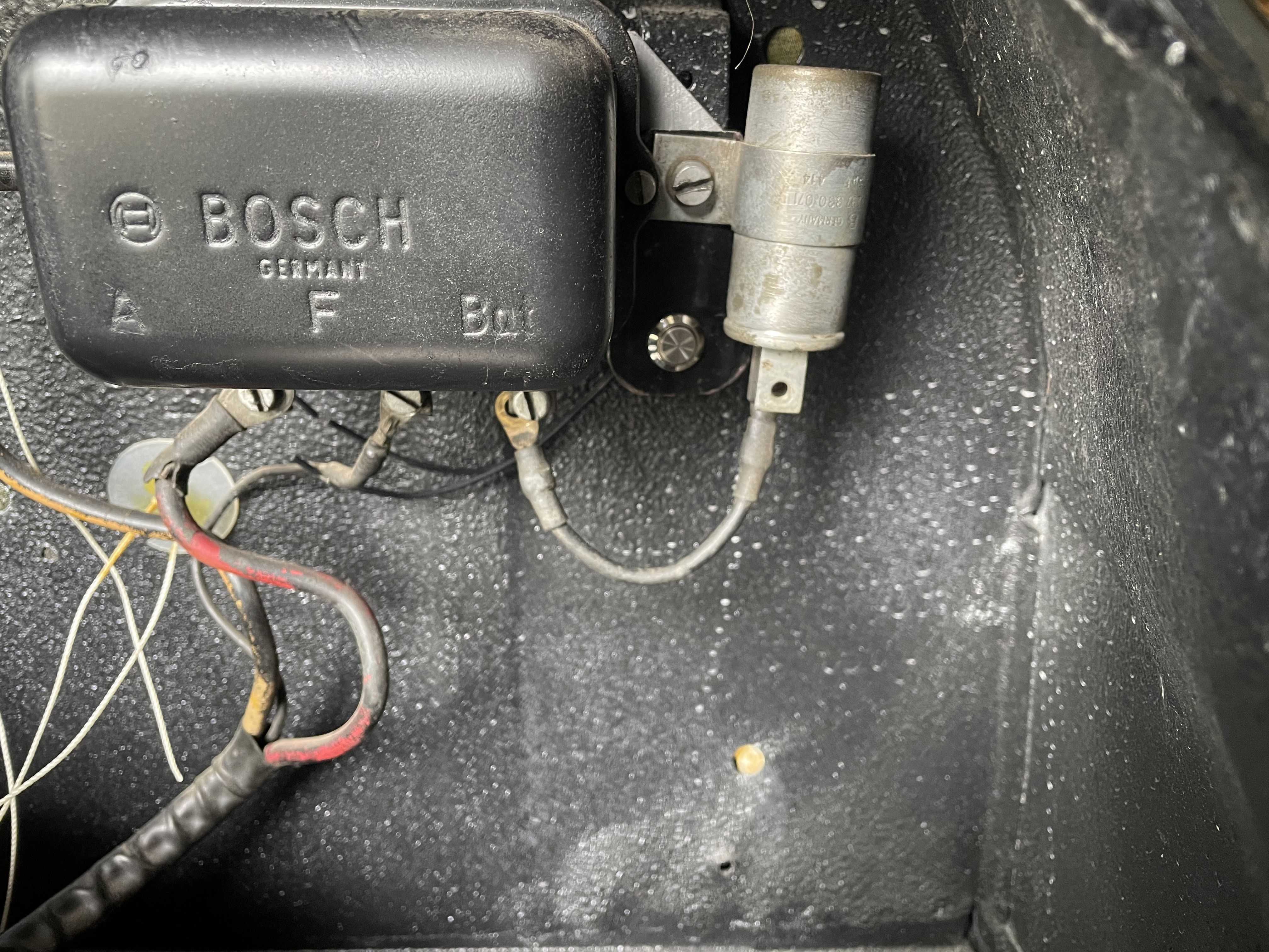

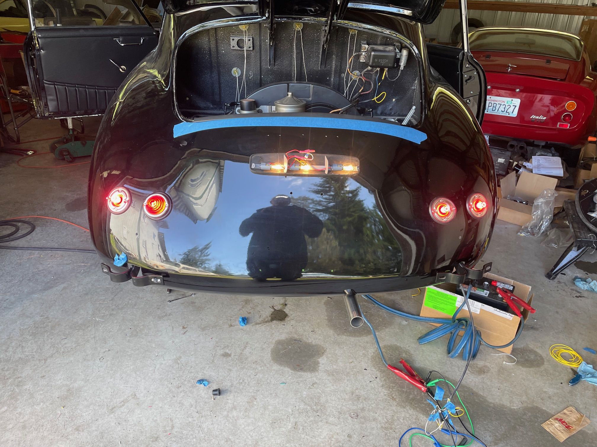

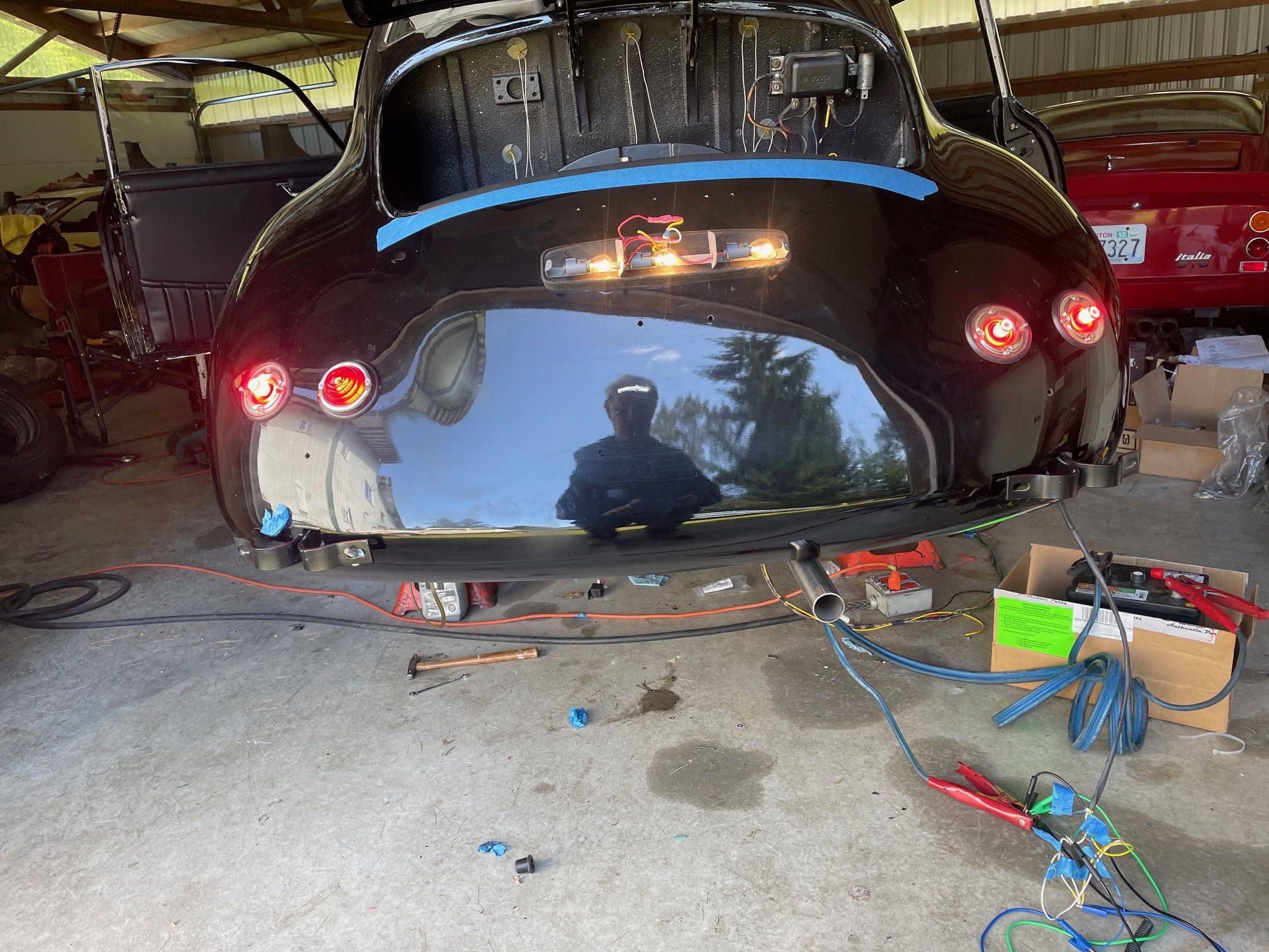

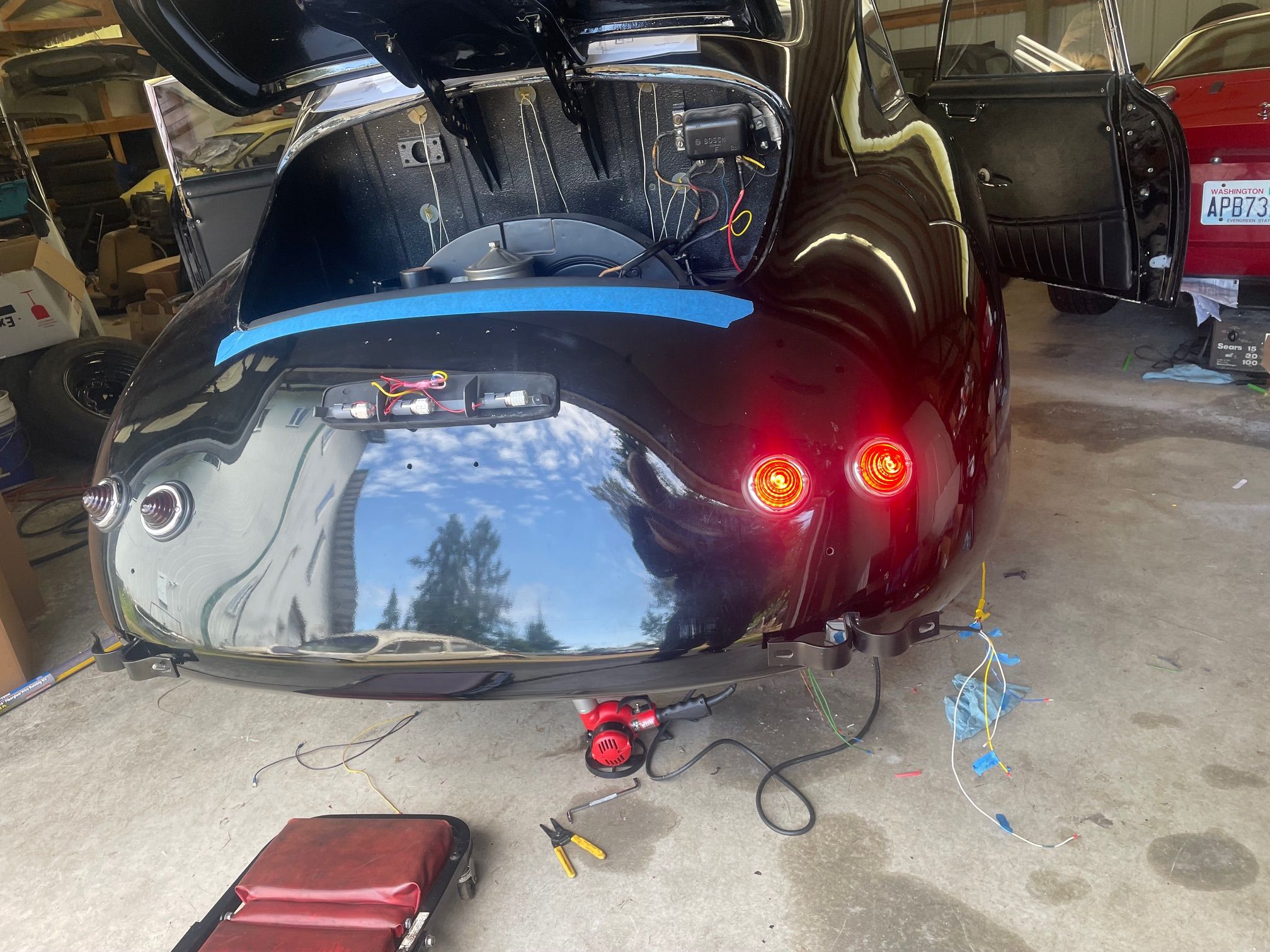

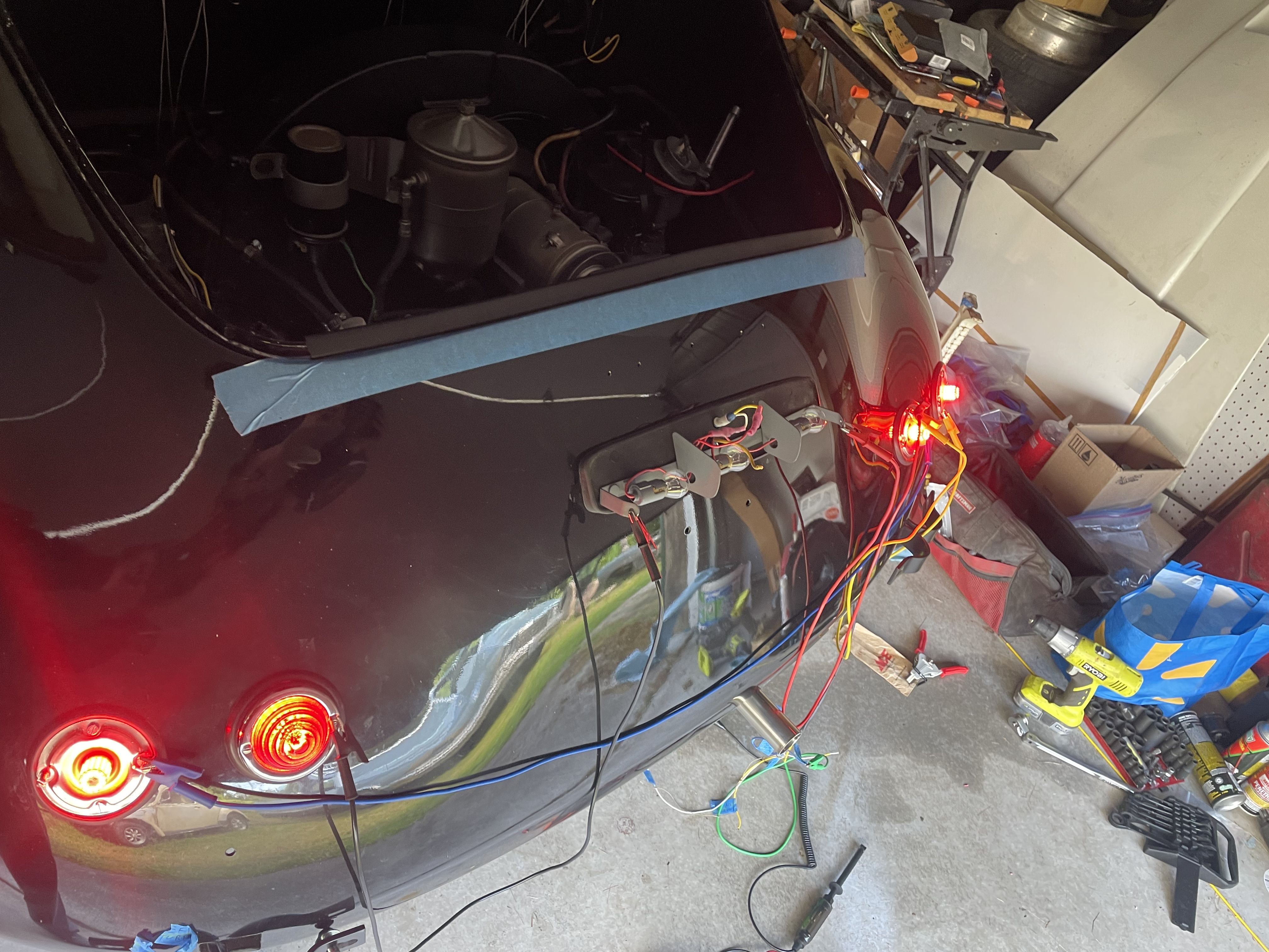

          ONE WIRE AT A TIME. Well after a couple weeks of wiring I think I can see light at the end of the tunnel. I never realized how bad someone could mess up a wiring harness.. And if you cut the wires to the flasher, or light relays or splice wires together with out matching the color codes. We have been starting at the bulb a working back to the fuse box, or turn signal selector, one at a time. I could not believe he cut the stalk harness 1/4" below the disconnect bullets and then spliced in a foot of red wire into the stalk, but did not match the original color codes from the harness. I do have Greg Bryant’s big windshield size color wire diagram, with out that I would have had to punt this one.
          Click image for larger version  Name:	rear lights1.jpg Views:	0 Size:	475.7 KB ID:	116637 Click image for larger version  Name:	rear lights4.jpg Views:	0 Size:	417.8 KB ID:	116638
          We have been starting with color code, then meter to the fuse box, then on to stalk switch or relay. After a good trace, inject power into the wire, if not too big of a voltage drop then test with a bulb.. one wire at a time. Cant believe how many miss connected wires there are. Also the 8Ga from battery to the fuse box was clipped right at the conduit above the battery. I sid manage to get a new battery cable in a couple weeks ago an a hot start relay with a push button next to the voltage regulator. I have finally crank the engine over and have oil pressure. The starter wire (50) is shorted into the ignition (30) somewhere so if you connect the battery to fuse box wire, touch the key and the starter runs. Never seen that before.
          Click image for larger version  Name:	rear lights2.jpg Views:	0 Size:	509.8 KB ID:	116639 Click image for larger version  Name:	rear lights3.jpg Views:	0 Size:	520.4 KB ID:	116640
          Click image for larger version  Name:	IMG_8015.HEIC.jpg Views:	0 Size:	1.49 MB ID:	116641
          jumpers, a kludge a couple bypass & work arounds and some extra wires but the original lamps finally light up
          BOOB ordered new reproductions but the wrong beehives, all dual filament fronts assemblies. I had Celeste order a T-1 LED kit from Vintage Trader, I called Jules, told him of the double filaments, and he sent new rear bulbs at no cost. I wired them in parallel so you now get two turn signal or four brake lights. Way brighter than the original bulbs.

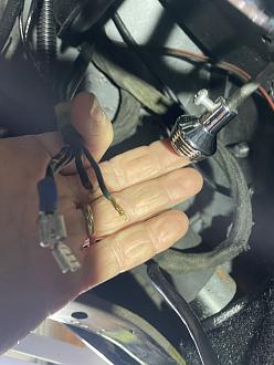

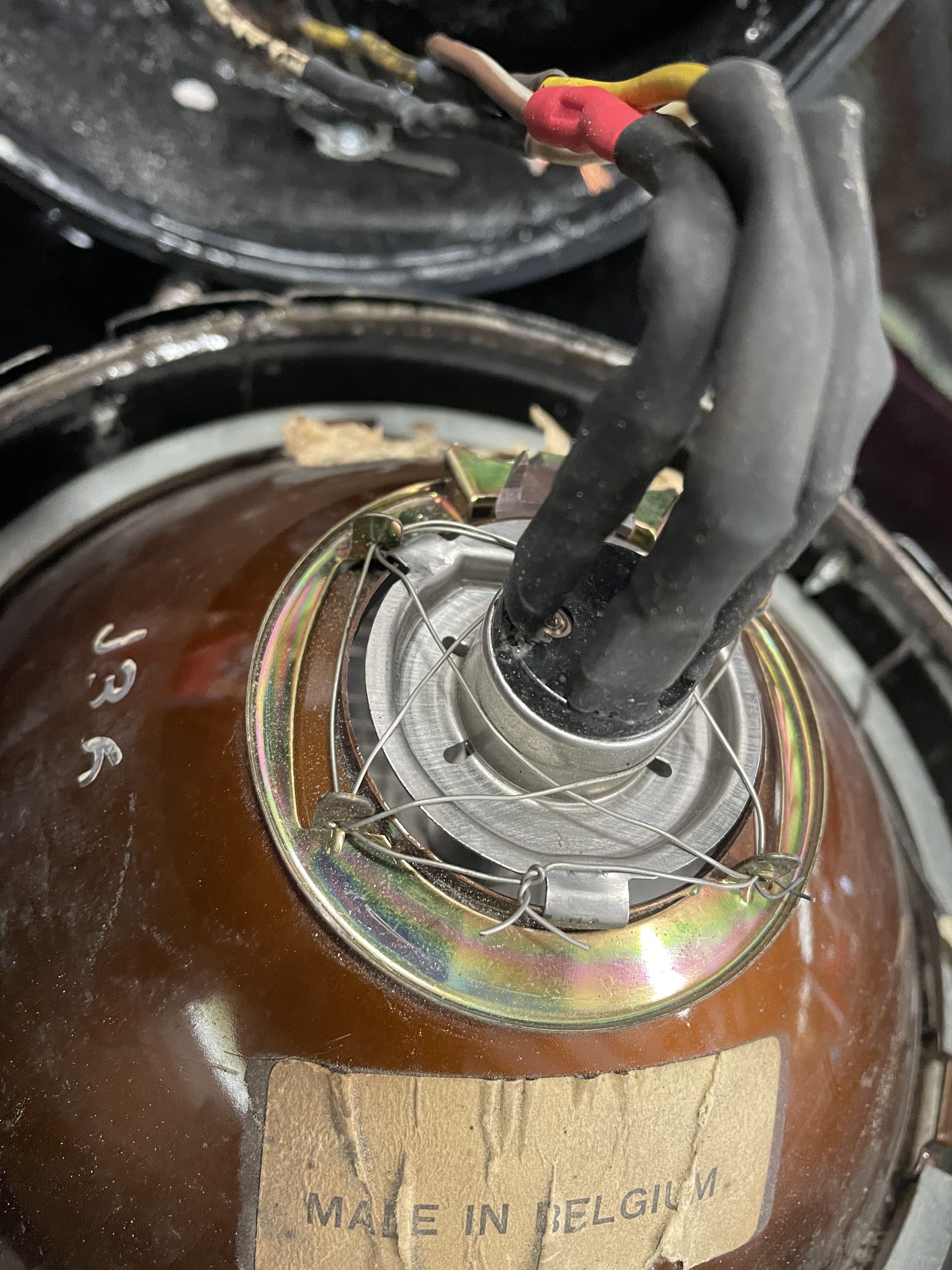

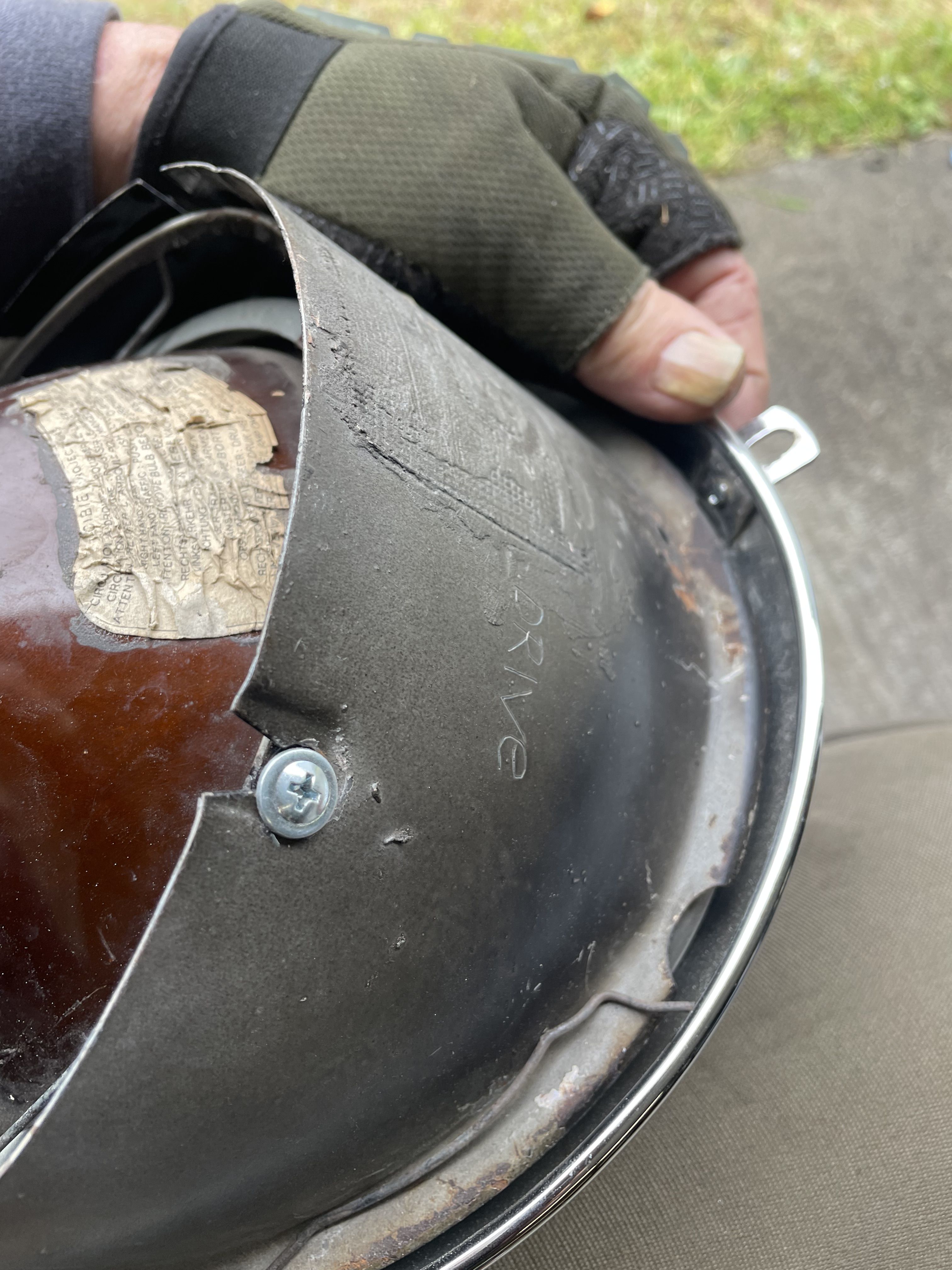

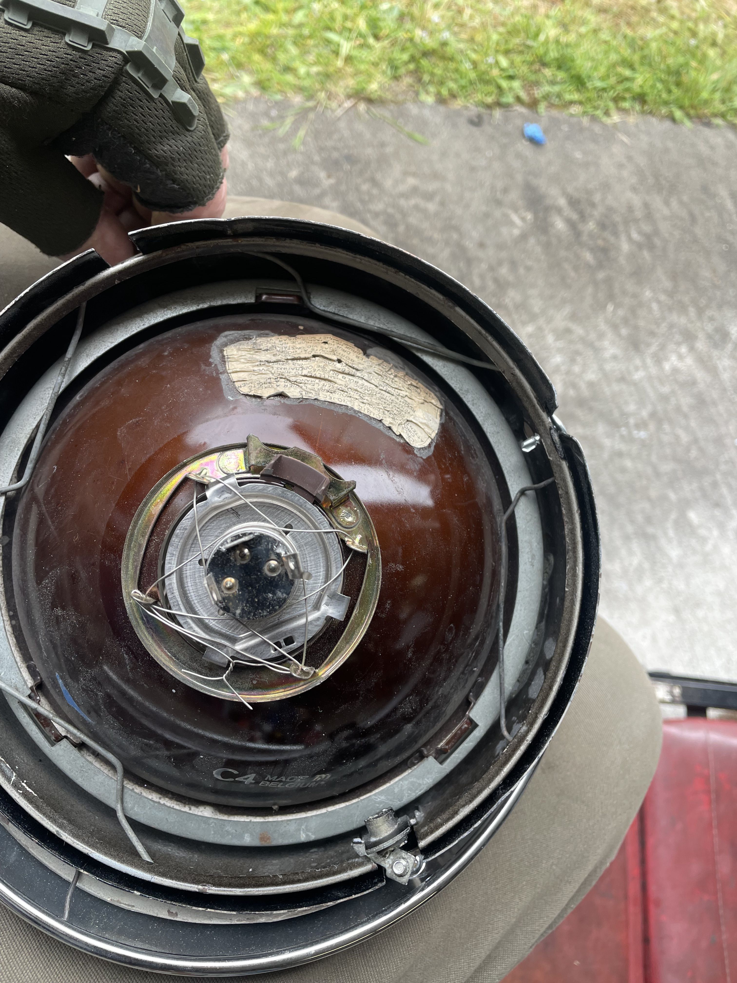

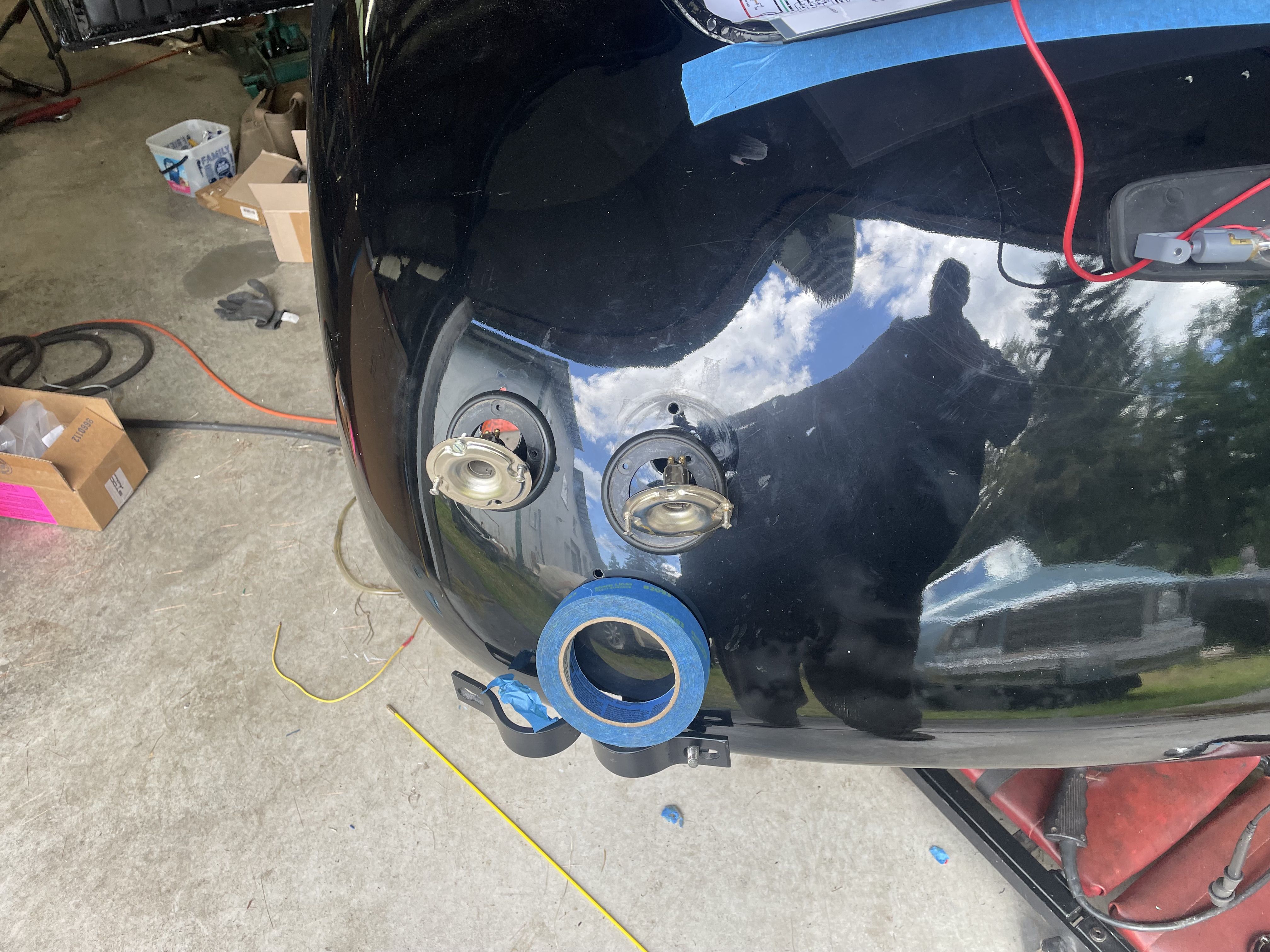

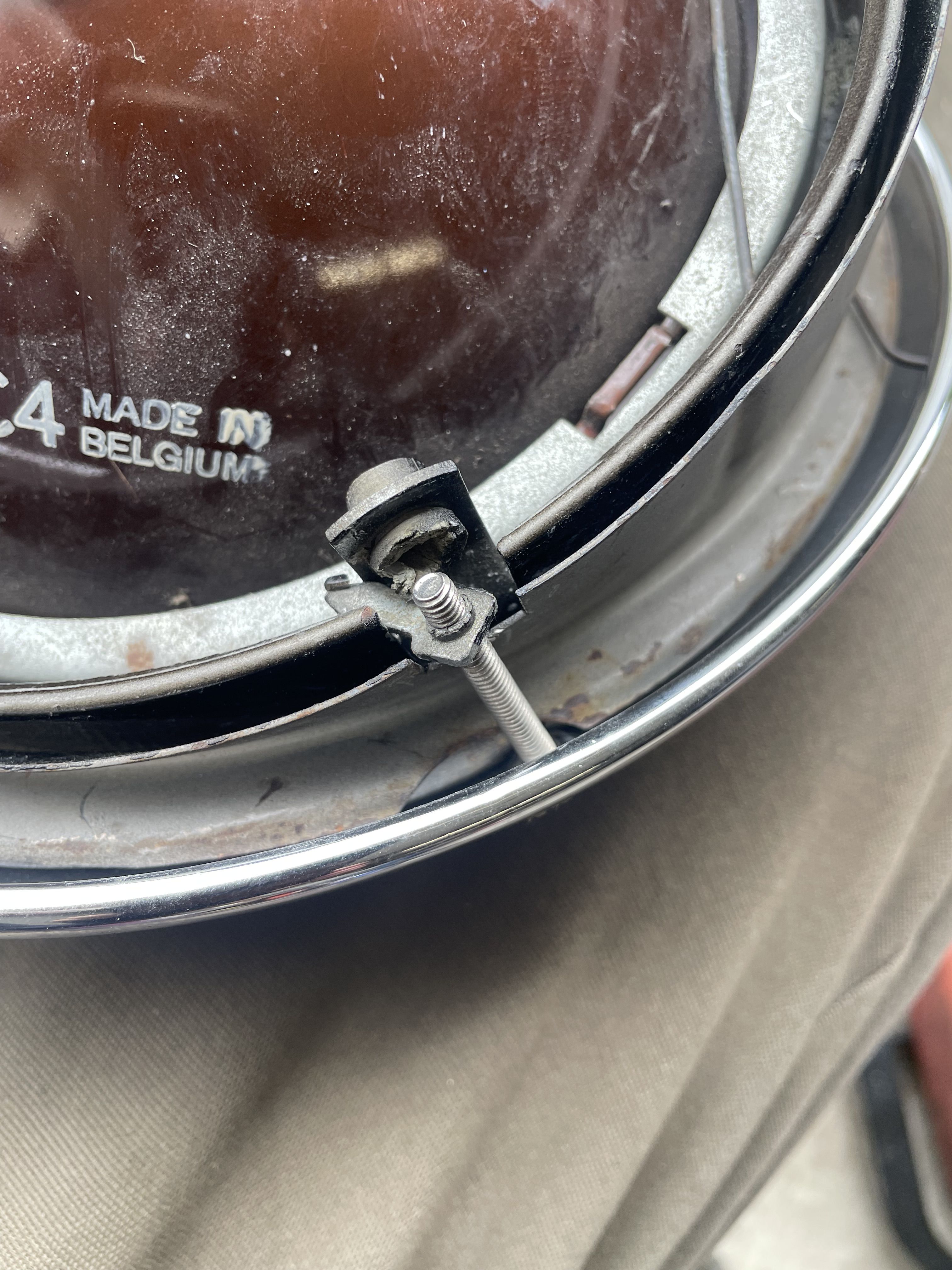

          I did swap out the headlights with led’s today. The previous Boob did not but the buckets back together correctly. I need to order some springs and rubber pivot kit. I think the buckets can be saved but there is no way they will adjust like they are. The old reflectors were cobbled together, they were painted black and sheet metal screwed together. Every time I start something it seems Boob was there first.
          Click image for larger version  Name:	IMG_8052.jpg Views:	0 Size:	1.19 MB ID:	116663 Click image for larger version  Name:	IMG_8050.jpg Views:	0 Size:	1.24 MB ID:	116664
          Click image for larger version  Name:	IMG_8051.jpg Views:	0 Size:	1.36 MB ID:	116665 Click image for larger version  Name:	IMG_8053.jpg Views:	0 Size:	1.66 MB ID:	116667
          Click image for larger version  Name:	IMG_8048.jpg Views:	0 Size:	1.59 MB ID:	116666

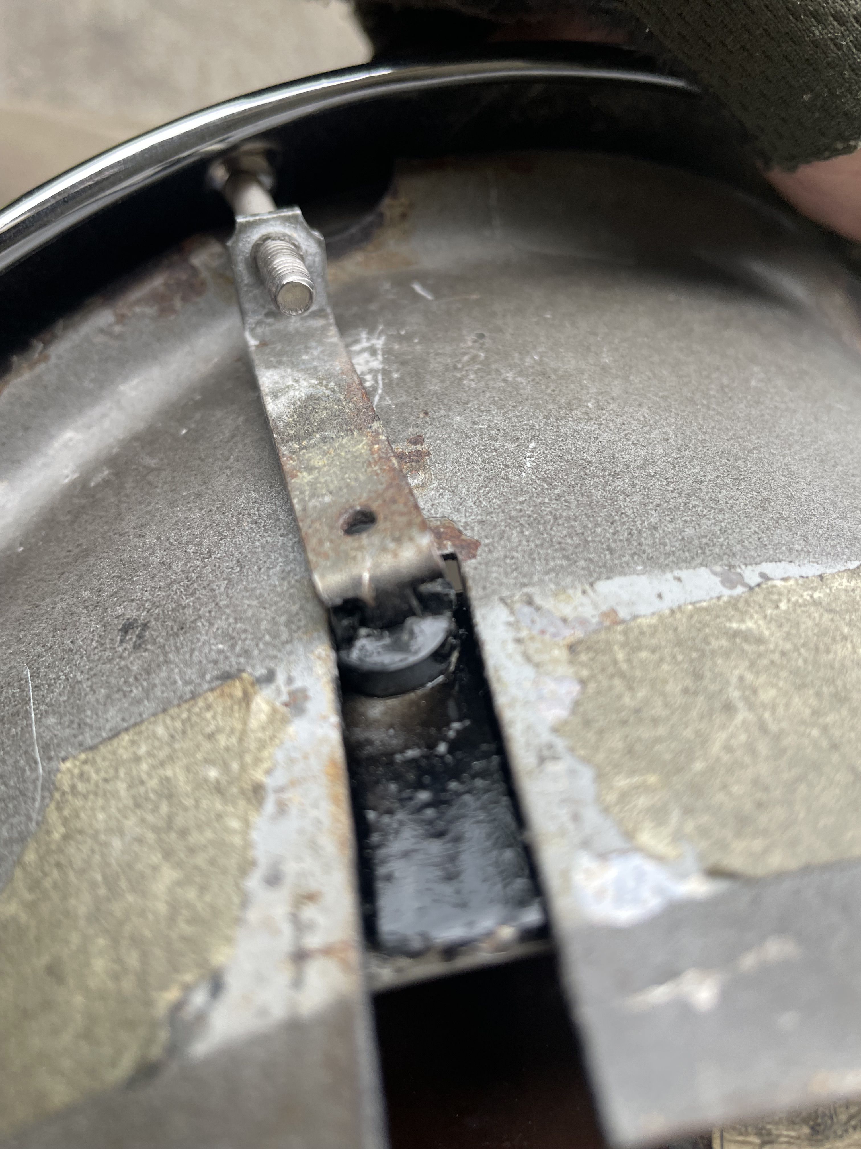

          Nothing like pulling a light bucket, and find 4 retainer springs laying in the fender bucket, and 22 gauge wire & spades on the headlight plugs, and some 0.010 safety wire holding the entire mess together. Plus the glass lens was loose with the inner seal popped out.

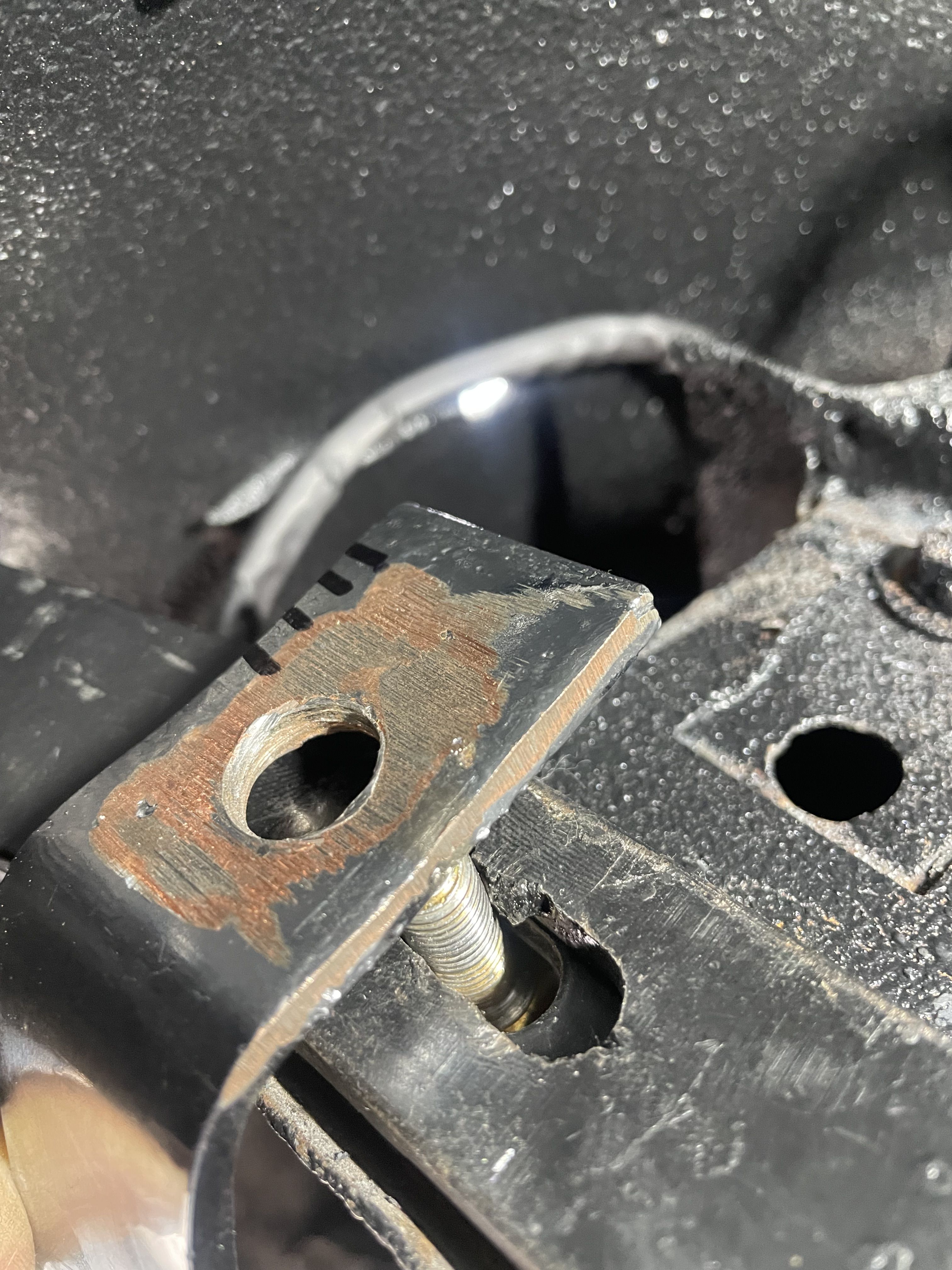

          Got away from wires for a weekend. I got all the way back to the turn signal stalk, ran into 8 red wires, spliced into the harness. They are cut at the bullet plugs, three you can see the color code, the rest are over sprayed with paint, all the old wires have green on them. The meter will tell but I am really tired of laying on my back under the dash. Can’t find the wire segment between the master cylinder and stalk for brake lights.

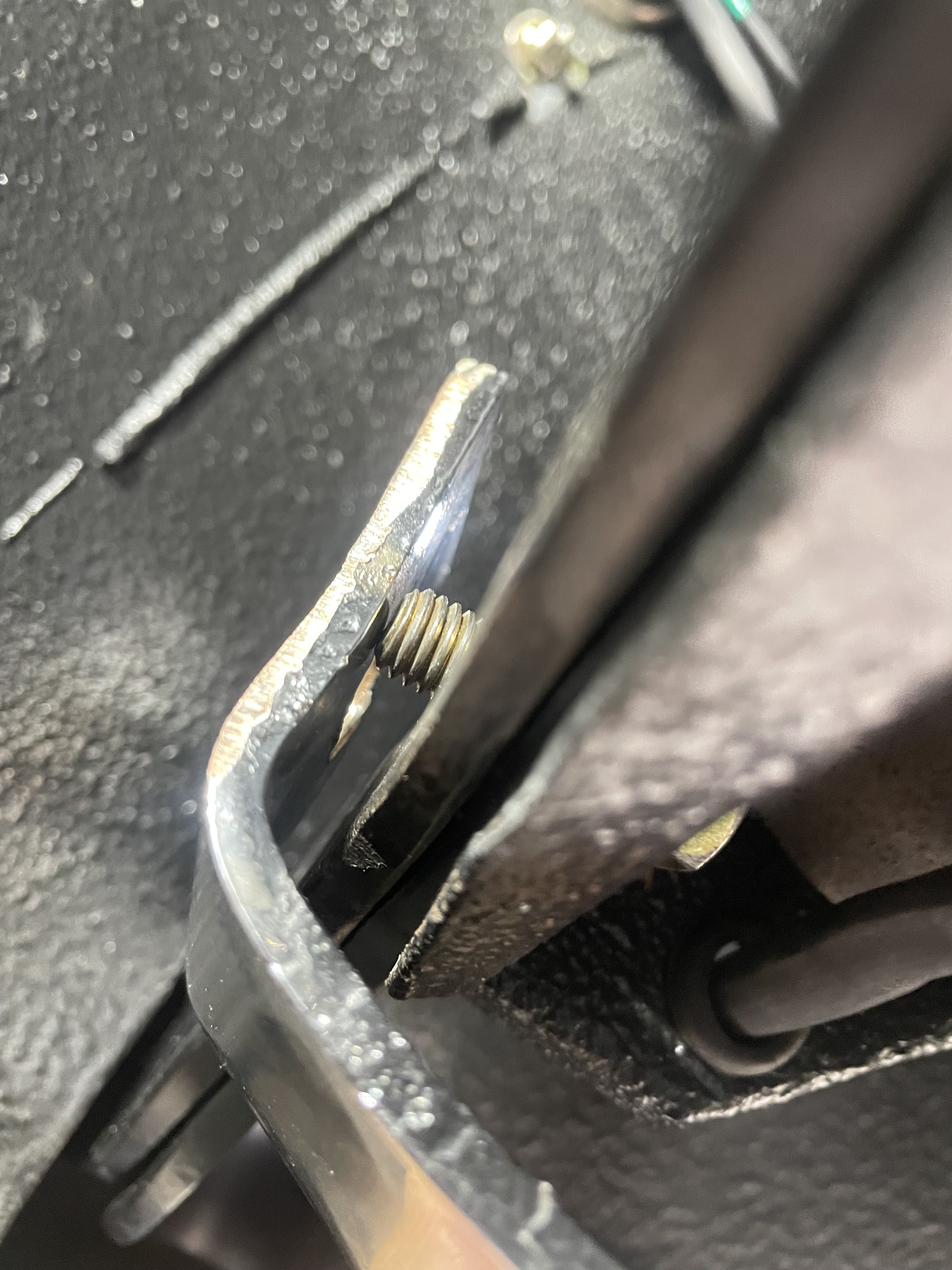

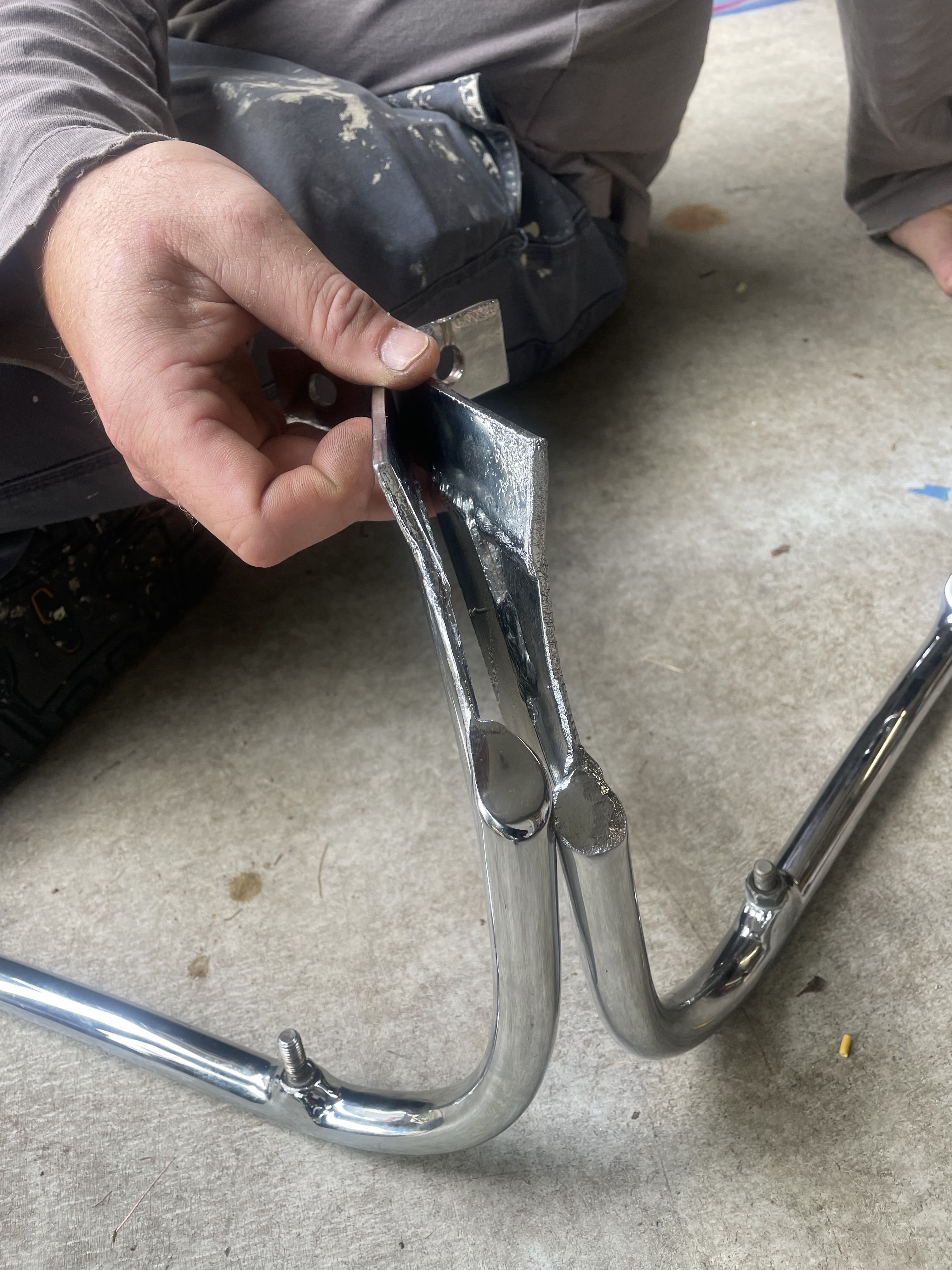

          Spent Saturday installing the bumpers, yea 5 hours on a bumper… I think Boob bought new attach bars, they shipped with the car but not with the bumpers or nerf bars. The rear nerf bars were 8mm off from the slots in the bumper bars. . The front fender braces are welded to the bumpers mount, not below them. The bumpers almost align, just another item of the list.

            Always interesting to see the creative ways guys come up with to do things wrong. Five hours on a bumper I can surely imagine as the time slips by quickly as you're wrestling with things and trying to unwind what was done. You really are on triple duty here old friend and the milage you've accrued just to get this far is really mind blowing. I hope you can get it back to your place soon and I also hope she appreciates the effort that is being spent here.

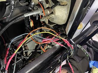

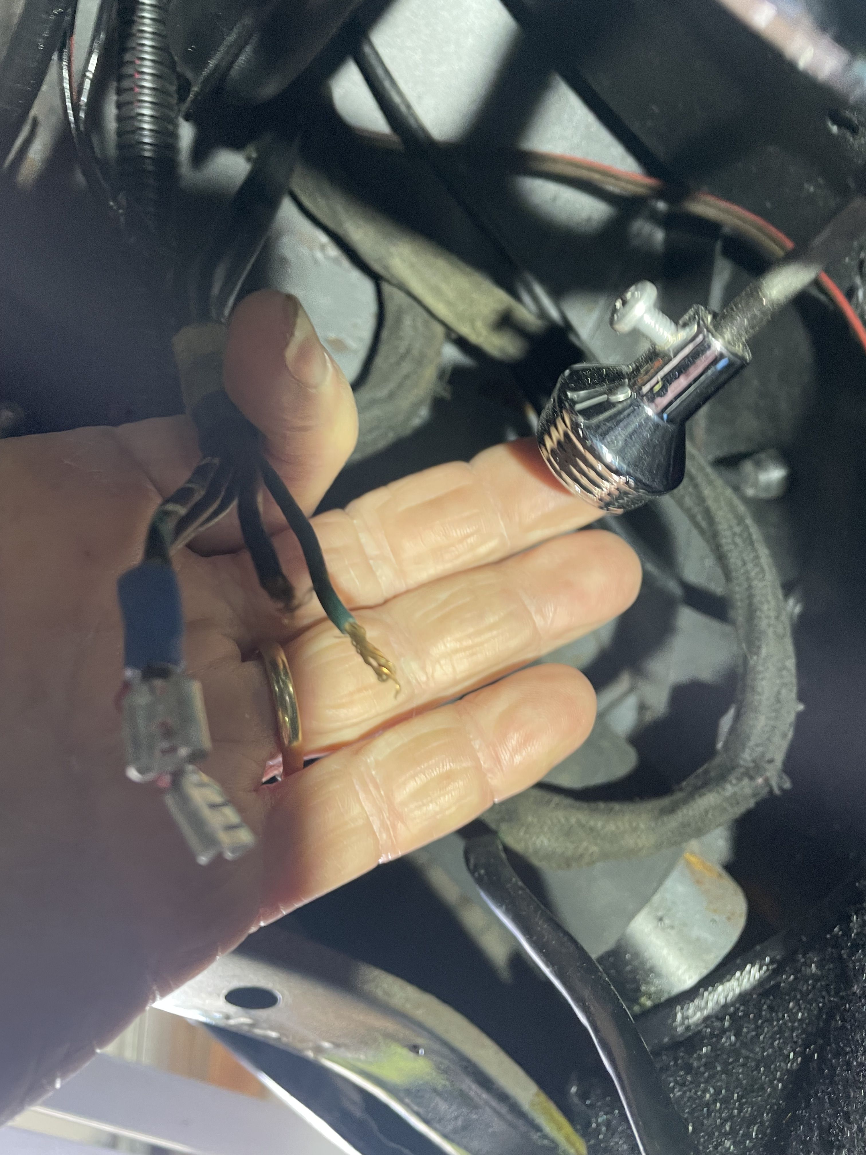

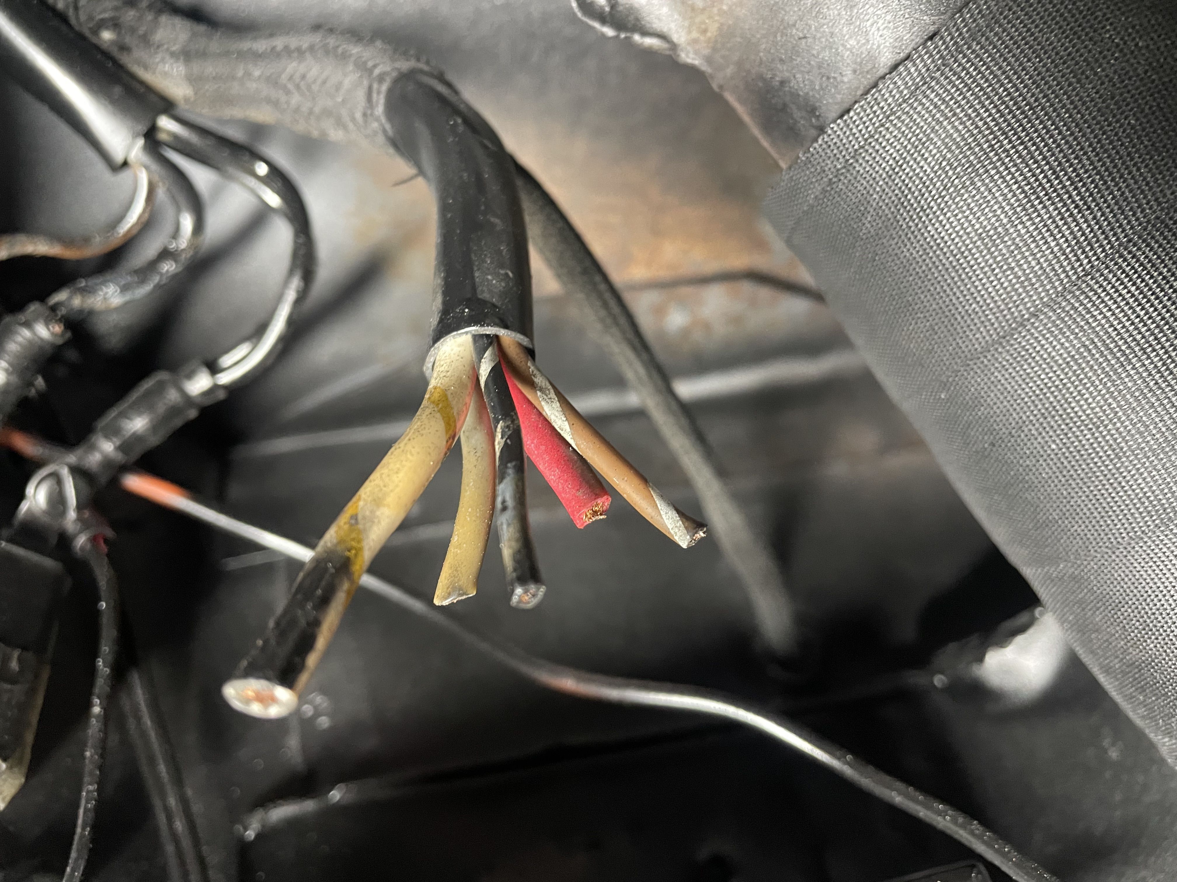

          Well was a goodish kind of week. More wrong or broken wires to fix. I think Boob is colorblind, if he works on his house it will burn down. We got it to crank with good oil pressures . Then went to do a static tune up to start. Points plugs static timing. Filled the carb bowels with gas, it fired up sounds good, no knocks or squeals so far. But just a couple 30-45 second runs before it ran out of gas. Tank still dry, bad fuel valve to rebuild. Went to look at the valve adjustment, and Boob put the valve covers with what looks like JB Weld. I picked and pulled every way I know of and they are stuck. Probably need to pull the motor and get out the big torch, get the cover red hot and burn off the glue. And the front flywheel oil seal is leaking , and both axel boots have the joint pointing straight down. When we added fluids on Monday, we found leaks everywhere.

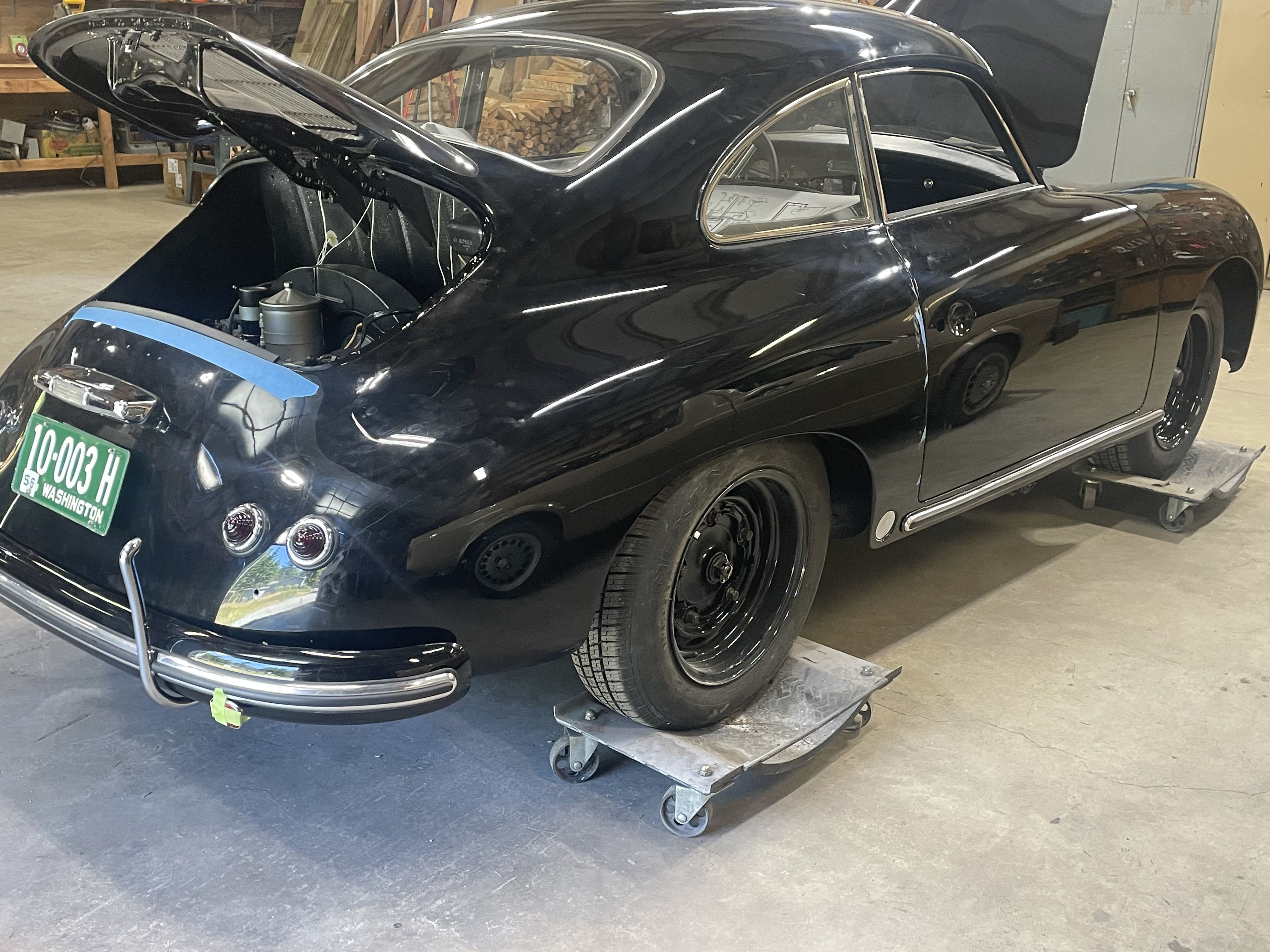

          We got it up to our shop today, so that will cut my commute in half. When we started it in storage facility , it went straight up on jack stands and in to evaluation. All the front end nuts were only finger tight. Today when I put the tires on they have 1/8” clearence between the tire and fenders. They are scary close. The have not rubbed, I put the spare on it has 1.5”. The wheel’s Boob bought are 6” wide when a huge outer off set. The inner rim is about 8mm off the lower shock mount, the spare wheel is 5mm. So that’s close on the inside, but that’s a fixed clearence. The outer is very close, the reproduction wheels are just too wide. They may work on the road but it’s the smallest clearance I have seen. .

          here are photos of the clearence between the aftermarket (L). and original wheel (R) I can get a couple fingers between the spare and the finder , from the outer edge of the fender the depth gauge says it is less than 3/8”
          but the good news it’s up at the shop with everything I need to pull the motor and the rest of the tools. I am shooting for a driver next week, we have an annual 356 Groupe NW BullSesaion on Sunday 19 July. This old girl needs to be there.

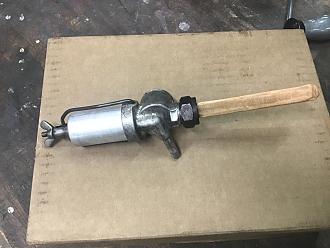

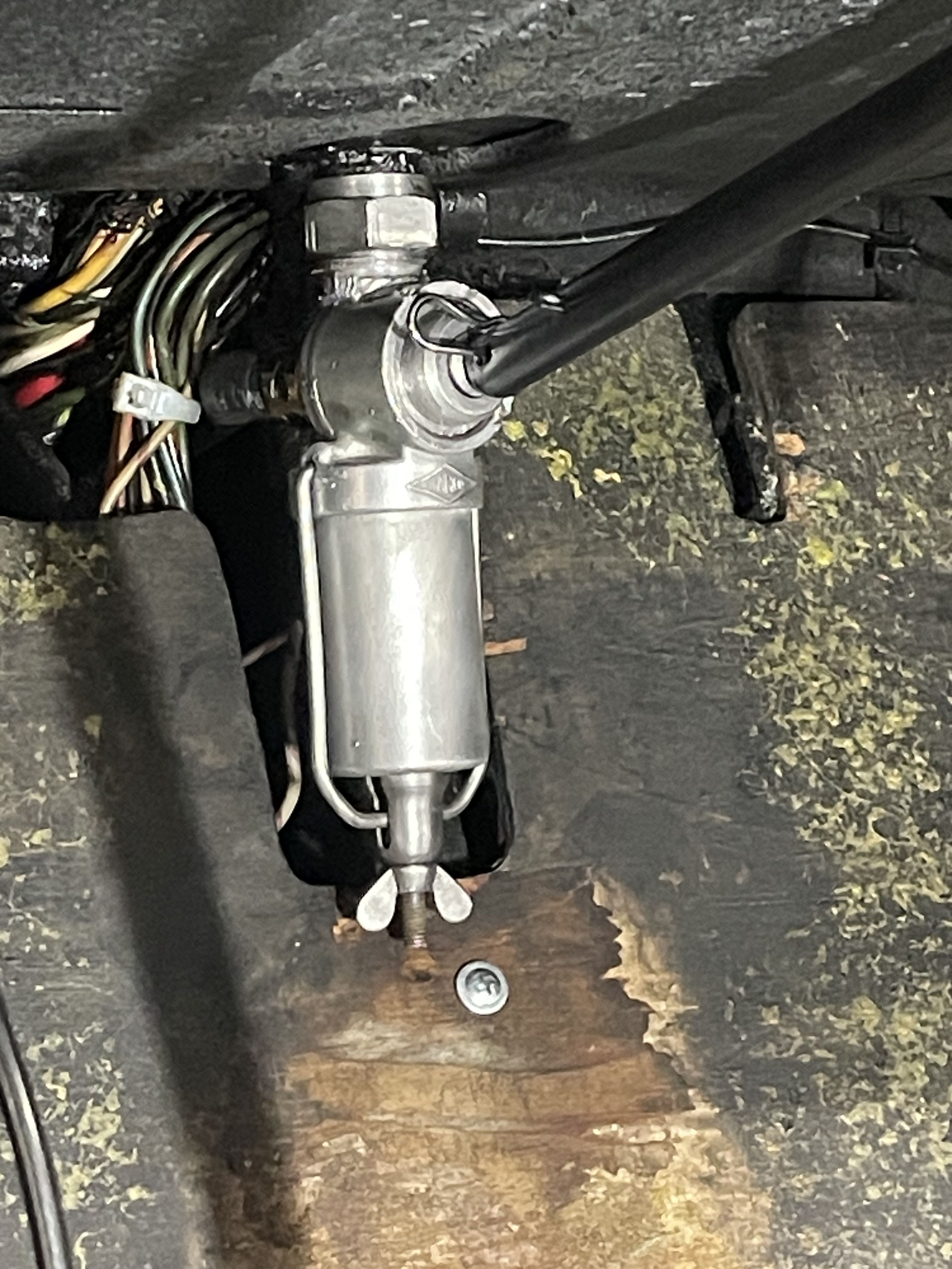

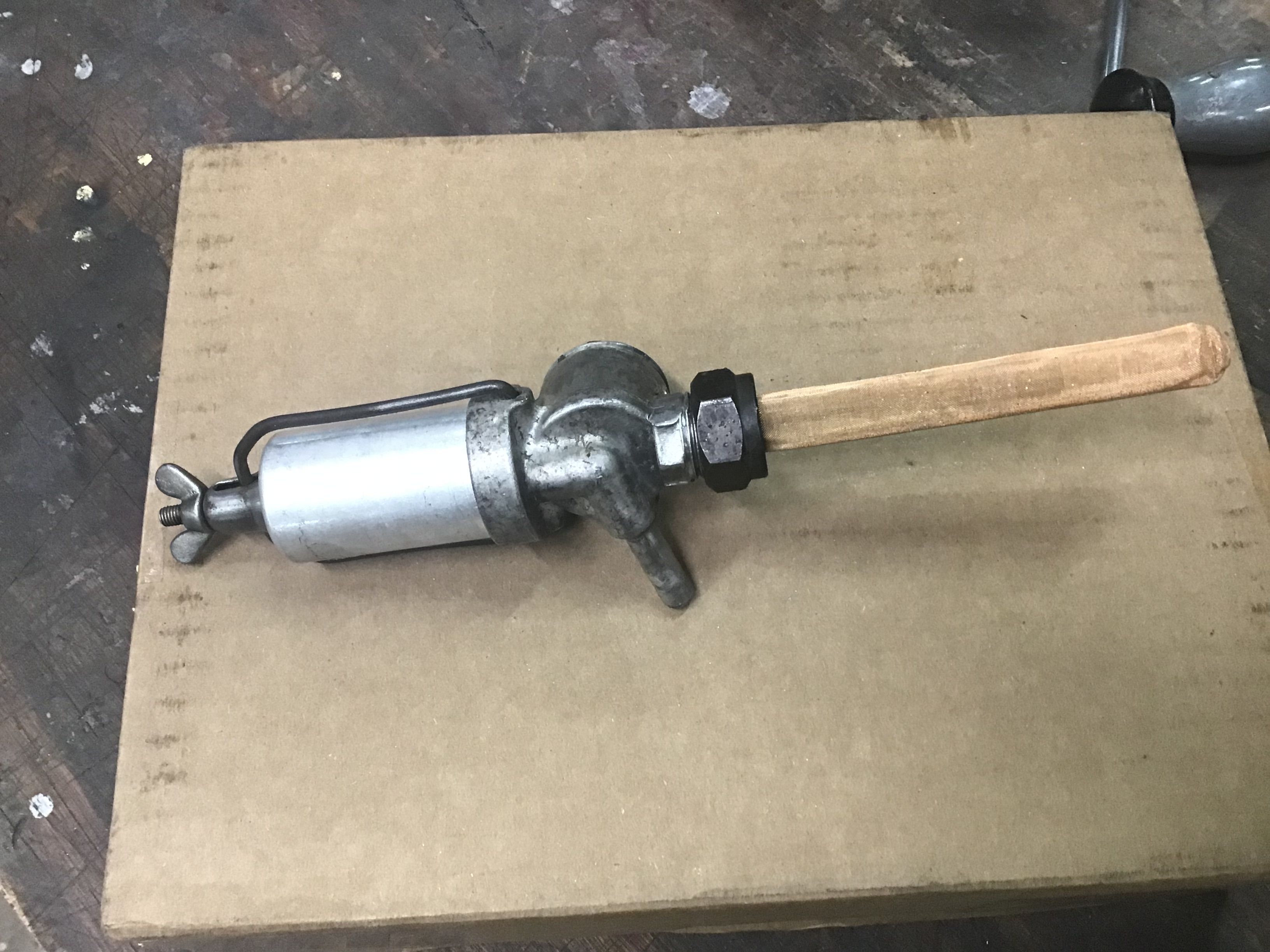

          Replaced the fuel cock yesterday, leak checked it over night with a single gallon, all is good, no seep. . The turned it on while up on jack stands seemed ok but the car was a little nose down while I finished the rear wire loom. Then went to put it back on the ground, and crap gas leak at the rear fuel pipe. Leaking about a drop a second. Fuel back off!

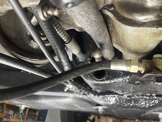

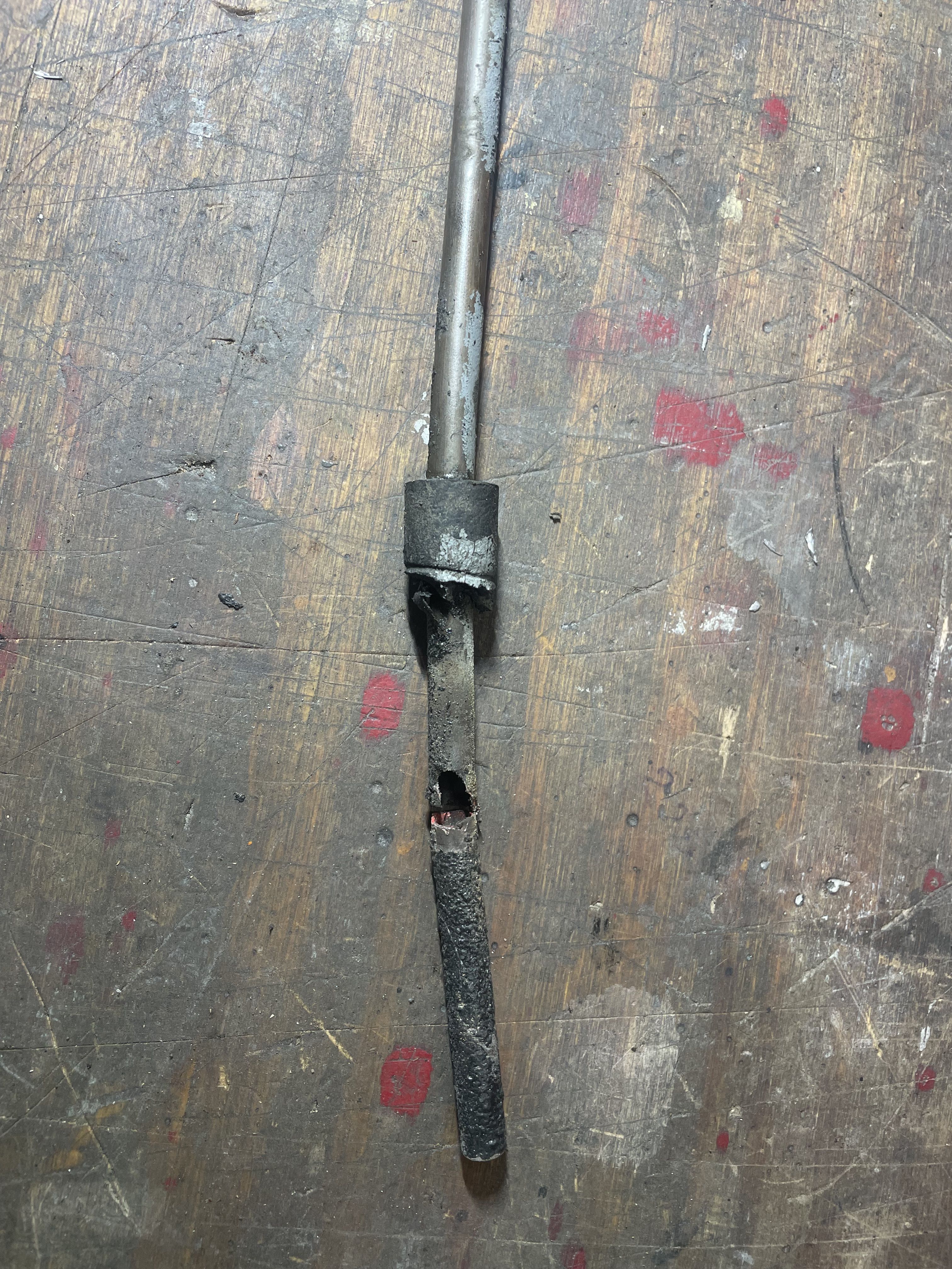

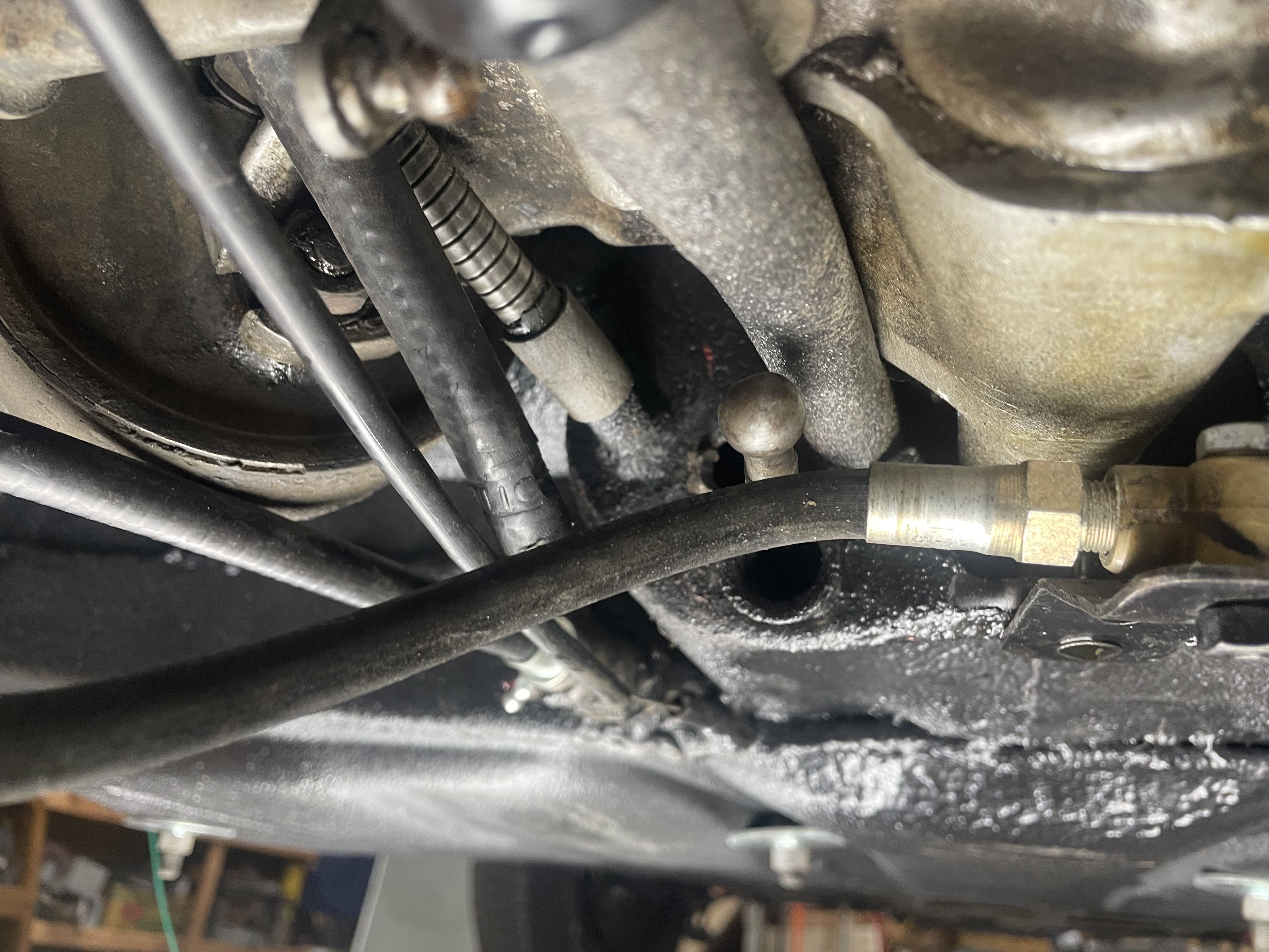

          Thought it was a loose or bad hose, but OH NO Boob sandblasted a hole in the fuel pipe, right where it goes through the body. Making a new pipe tonight. Did get the rear wires wrapper and routed. Still have a few wires under the dash to find, but it’s coming together.

          But each day it gets closer, it’s been a real journey. A few bullet connectors on the headlight light and ignition switches to replace. Then rewire the turn stalk, horn button, light flasher thanks for following.
