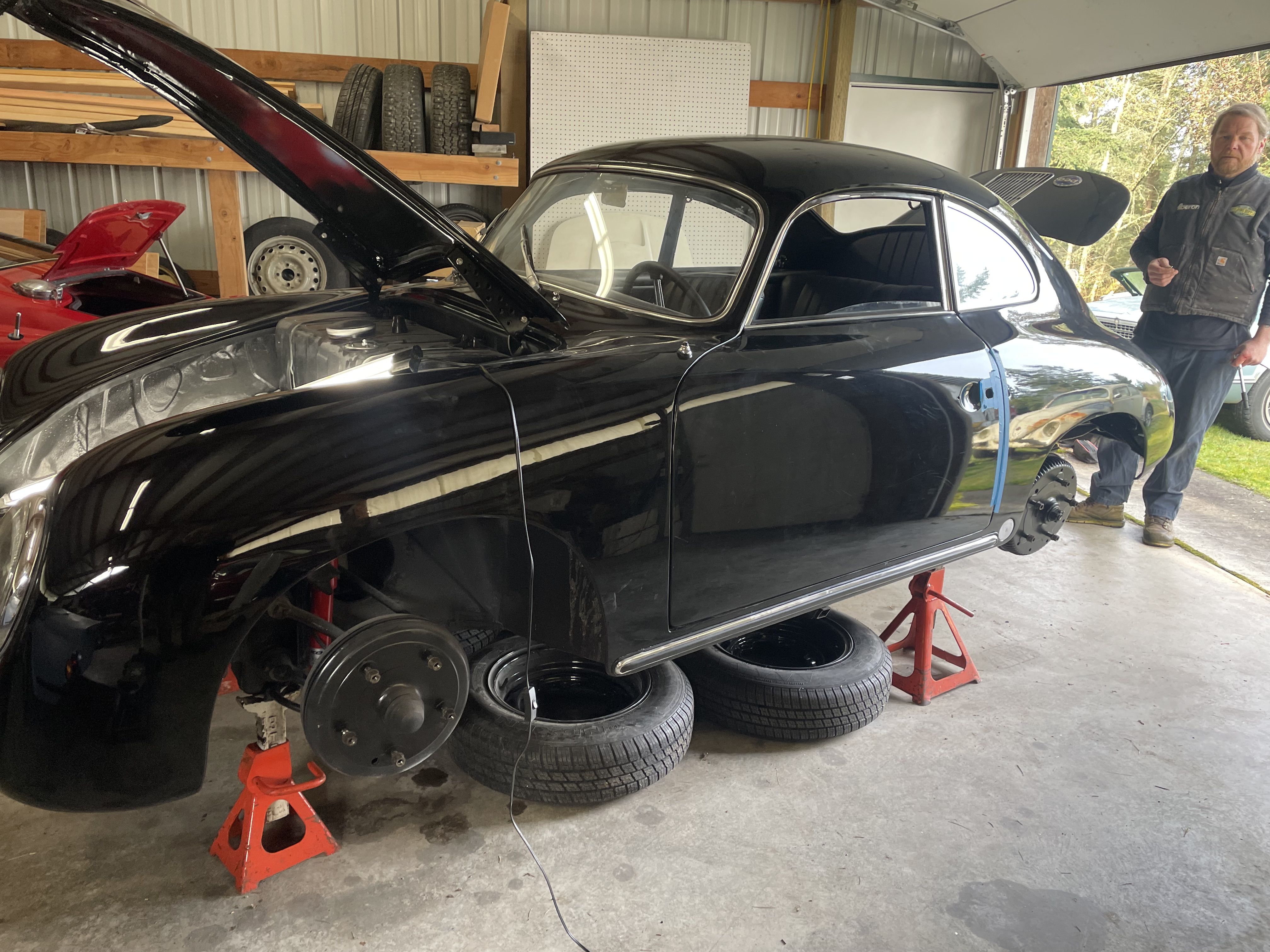

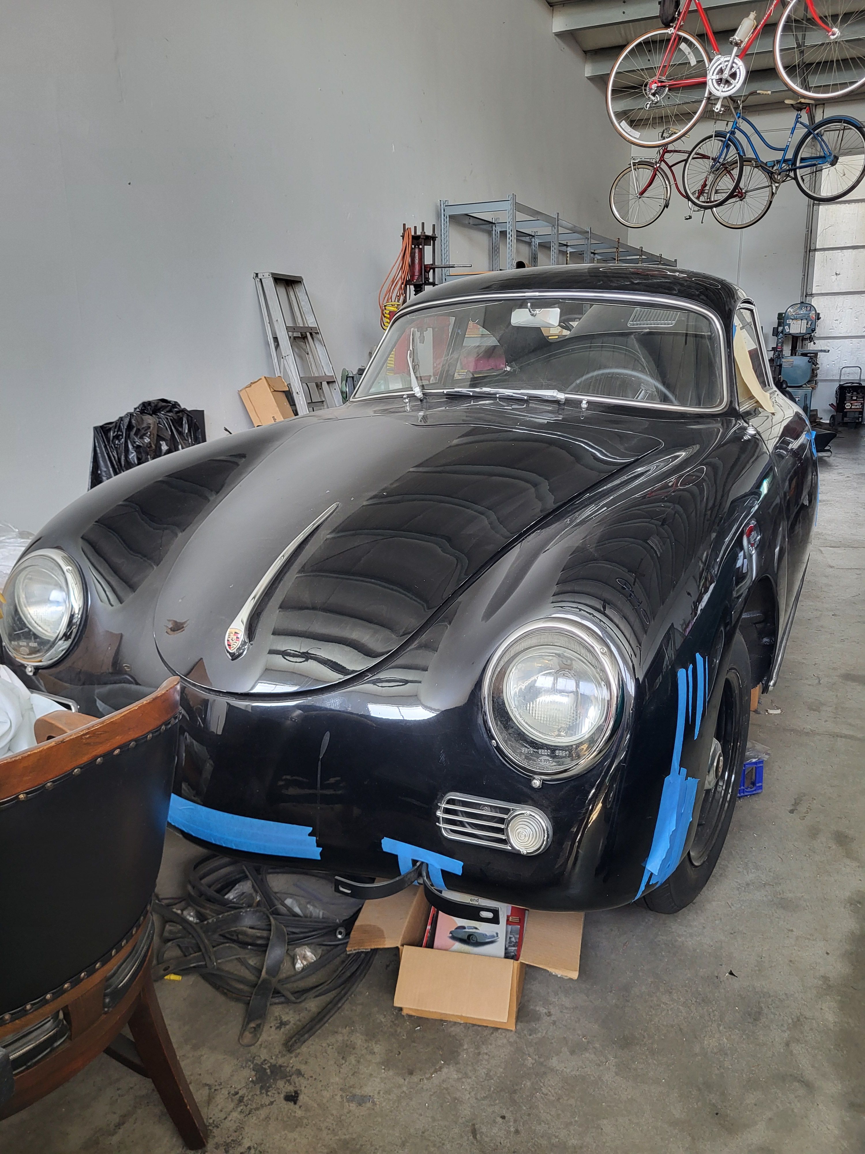

    They just keep falling out of the sky. This time a 56 T-1 coupe, but only off road for 18 years this time.

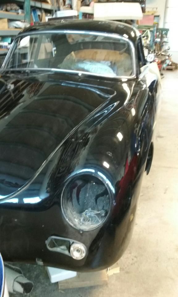

    Got a blind call from the lady who owns it. Not real clear on all the details yet, but went in for a floor repair, that turned into a full restoration 15 years ago. Most of the repair and paint interior is finished, just needs being put back together, and then made road worthy.
    Click image for larger version  Name:	zporsche 20240423_110350.jpg Views:	0 Size:	1.40 MB ID:	116355 Click image for larger version  Name:	20160930_172303.jpg Views:	0 Size:	66.7 KB ID:	116353
    The shop owner who has been working on it since the “Chinese invented arithmetic”, gave up and retired. I have not looked at it yet but from the phone calls should not be impossible. It will probably need all the stuff we just did on the 65SC,. Then engine brakes, carbs, fuel system. Hard to know now until we get into it, has not had a battery in 15 years. We will install a Vintage Trader LED lamp kit and headlight set.
    Click image for larger version  Name:	porsche 2016093095172222.jpg Views:	0 Size:	68.1 KB ID:	116352 Click image for larger version  Name:	20160930_172334.jpg Views:	0 Size:	135.3 KB ID:	116354
    Will post more as we determine what it takes. But at lease I will have a project for a while.

      Well, it’s not too bad. Got it moved over on the island and into storage for now. It’s Dry, no fluids, no battery etc. starting a list of what needs to be done. It’s been in restoration for 15 years, and not finished. The owner is a very nice woman, who has owned the car for quite some time. The Guy doing the restoration had a small interior shop, He is closing up and moving to Idaho. Car looks 90% done, he claims the engine and mechanicals are all done 10-12 years ago. But it dry, there is no oil in the motor, I don’t think it been started after rebuild. Gas tank is dry but clean,
      So it’s going to be from scratch, I have no history or knowledge of the skills of the previous guy, except he was slow. We will start with .borescope the cylinders, the marvel oil through the plug holes. Then pump in oil through the oil filter pipe back through the pump and oil galleries , hand rotate, hoping we get some oil into the mains and rods journals. Hand oil the rockers with a hypodermic syringe. Then a leak down test, some serious spinning with the starter, no plugs to check oil pressure, and do a compression test.
      Next will be the fuel. Tank looks clean, but I will use an electric pump and small fuel tank to check for leaks and floats and accelerator pump volume. If that’s all good, it’s start it up, get it to temperature, standard oil leak test, and we should be good….. next will be brakes, but that’s just hydraulics, I have lots of kits, hoses etc.
      I will go through the electrical, put Jules “Vintage Trader” LED light kit in it, finish the assembly and start to drive it. Easy right…..
      So the plan is to get the GO working, then the STOP, then the pixies, and see if a T-1 will still go 80 mph. It’s only been 53 years since I worked on a T-1.

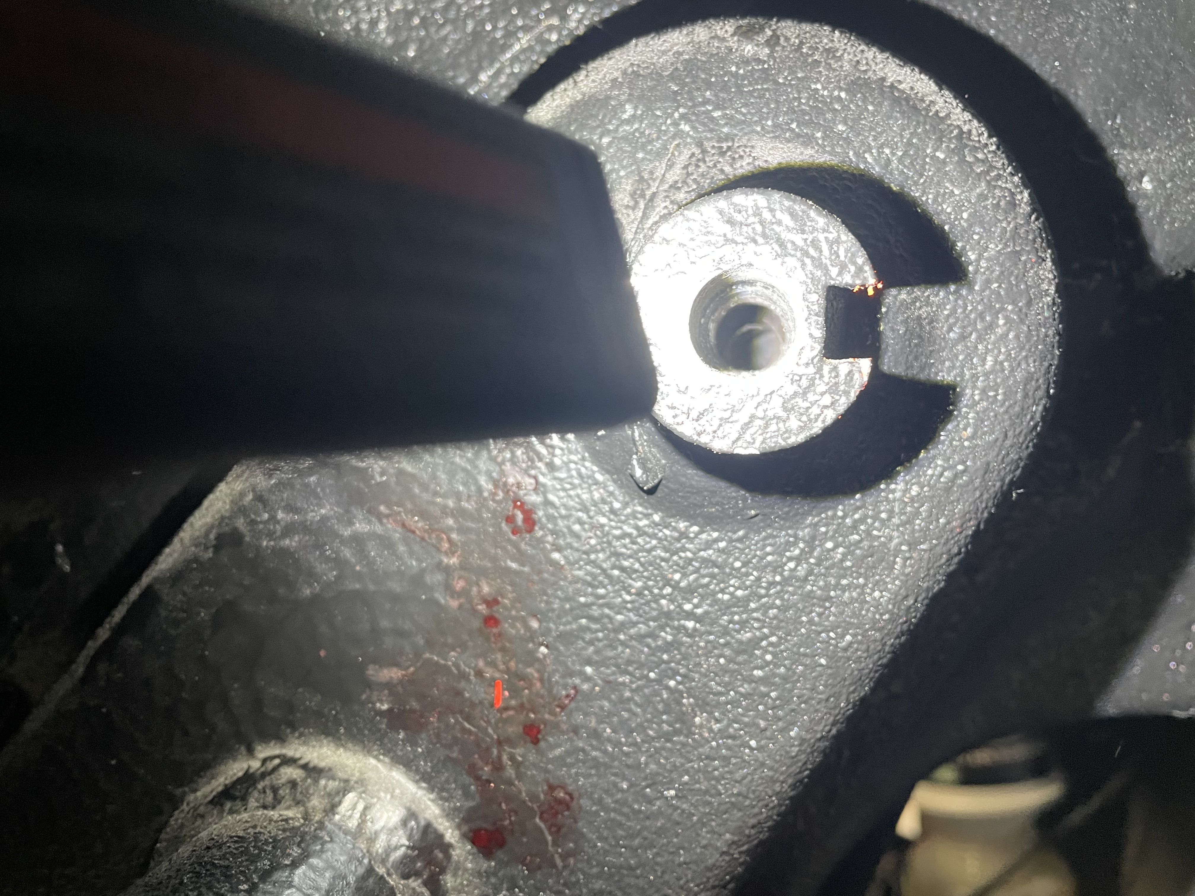

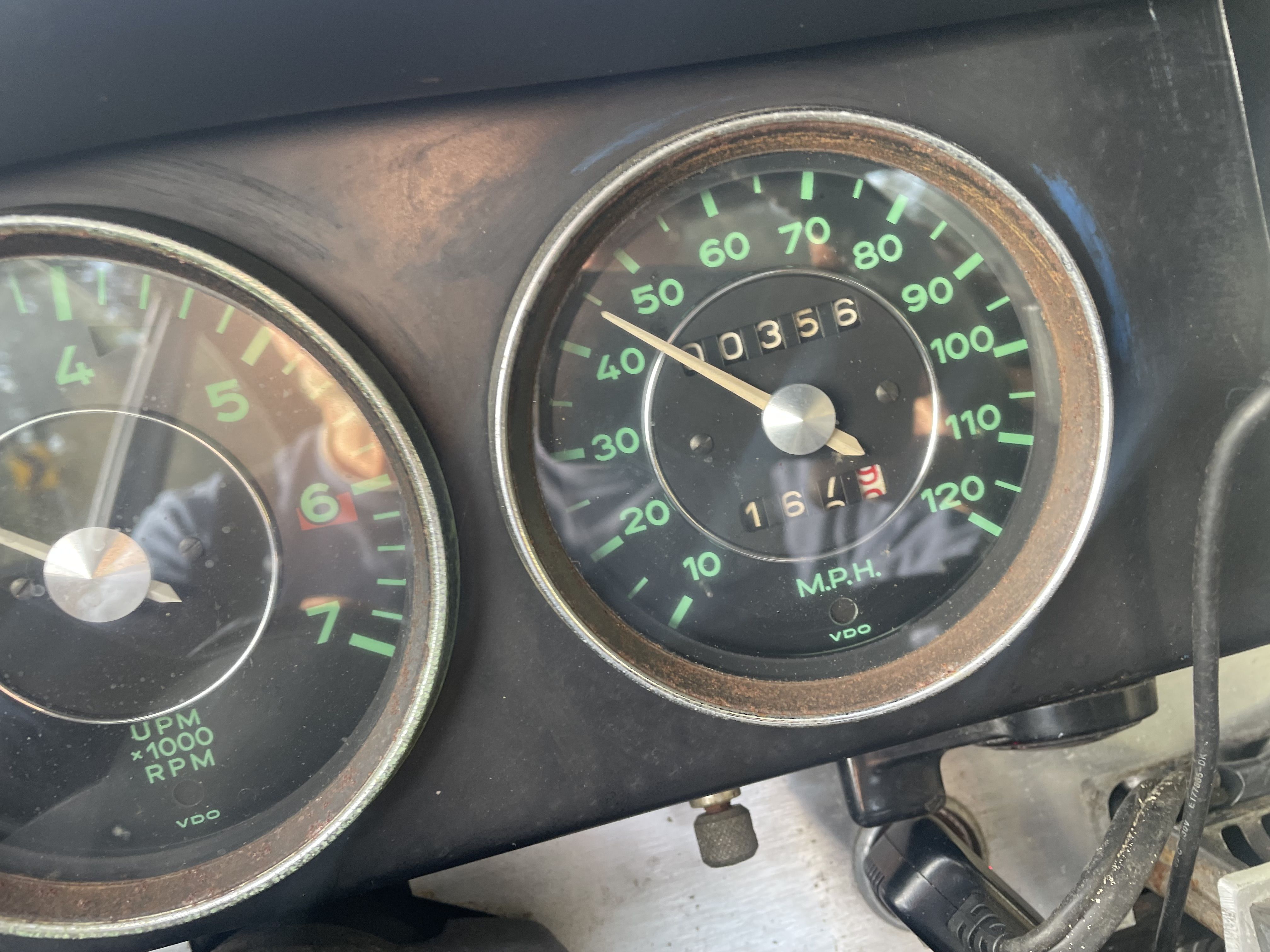

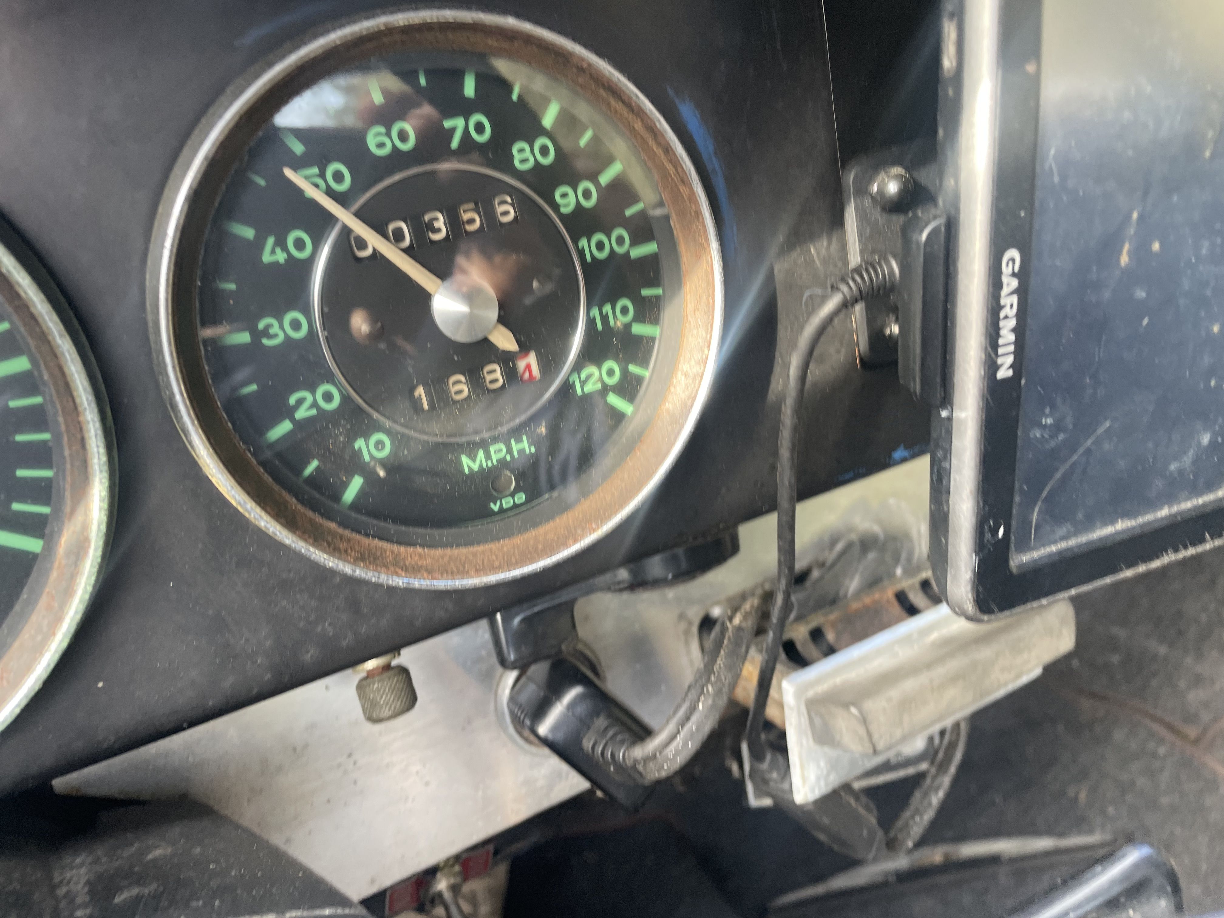

          Got almost a full day today doing a deeper inspection. No fluids at all, she is completely dry. Front Brake cylinders were installed backwards, shoes pushing on the hydraulic side, not the adjuster. They all seem to have frozen pistons, but that is expected with this long off the road. No muffler or starter, missing a cover next to the battery. Lots of strange bolts and screws. But over all a very nice T-1 coupe. Have not got out the trammel pins for measuring hard points but my eye says it’s close, with a 6-10mm twist, but trammels and lasers will tell real the story.

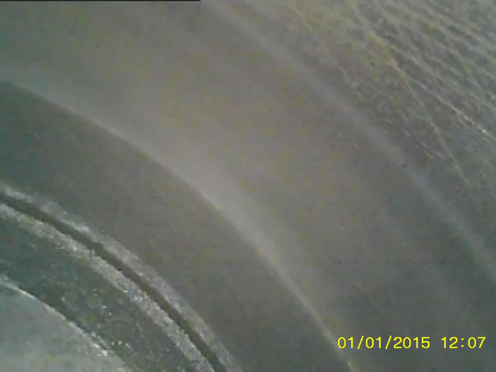

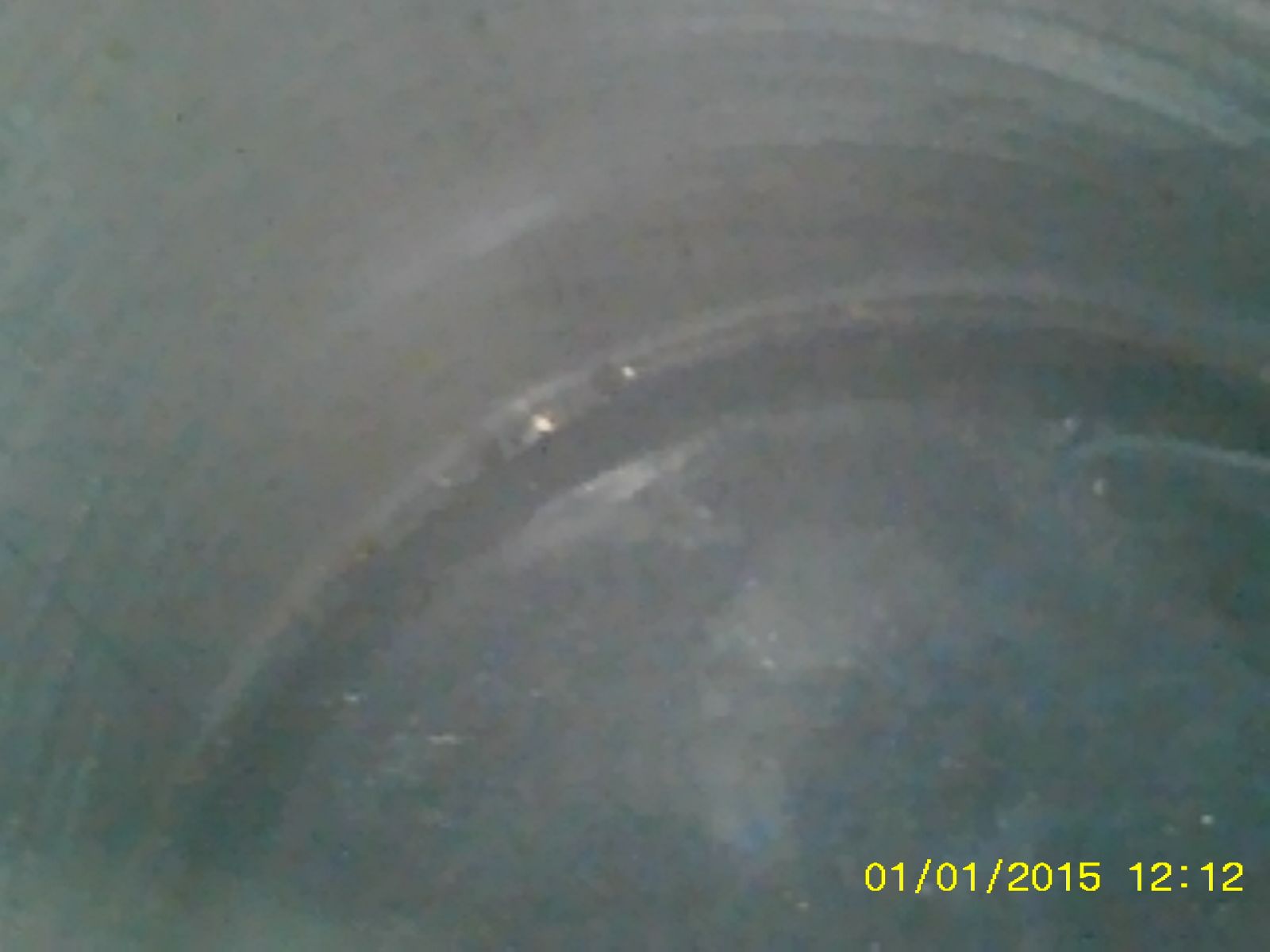

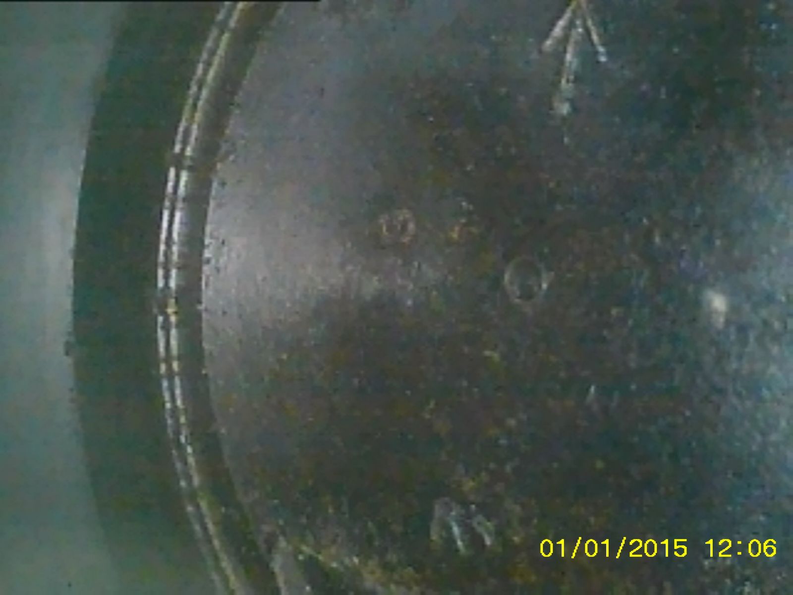

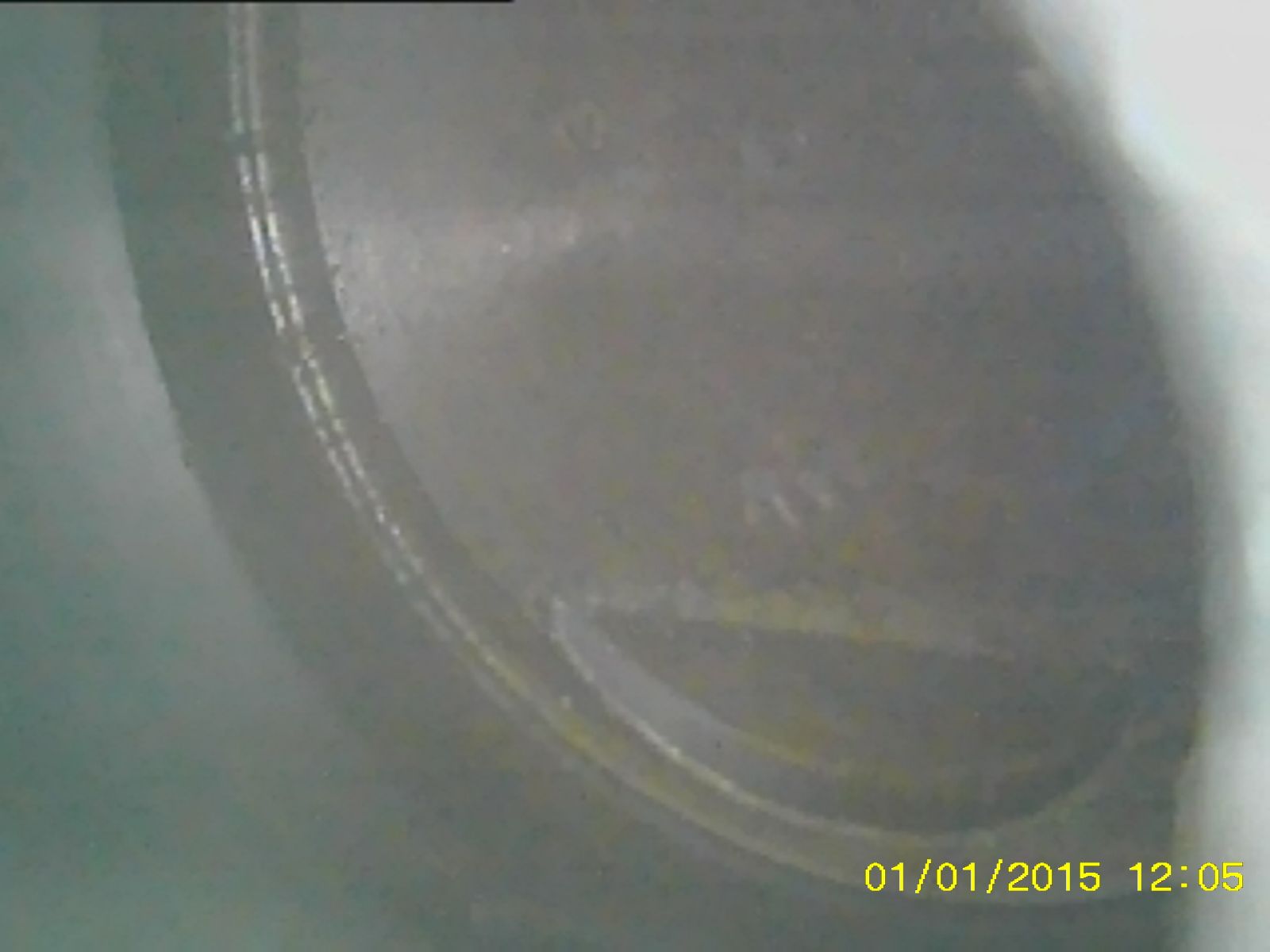

          Got the borescope in the plug holes, cylinder are ok so far, no rust or scoring, but did not rotate the crank, no oil.. The engine was rebuilt shortly before it started the restoration, and driven some, but #2 cylinder has never seen fire. Bright and shinny inside, clean plug, the others has some carbon buildup, looked like very rich mixture. But No#2 still bothers me. It probably ran but poorly, but why #2 is dead? Might be simple, a plug wire or plug, the rotor and cap are new, wires look Ok visually. We will see in a few weeks. I was hoping I could avoid pulling the “New Motor” but it might be easier on the run in test stand to trouble shoot.
ID:	116387 Click image for larger version
          Over all, no show stoppers so far. Will put oil in it via the oil filter inlet line. I have a kluge that pushes oil through the galleries into the sump. After a quart I will hand rotate the crank until the lifters and push rods start to drip. This is a slow process but it better than a spun bearings. With no starter to spin the motor it will be the only get pressure is via the oil line, from a pressure tank.

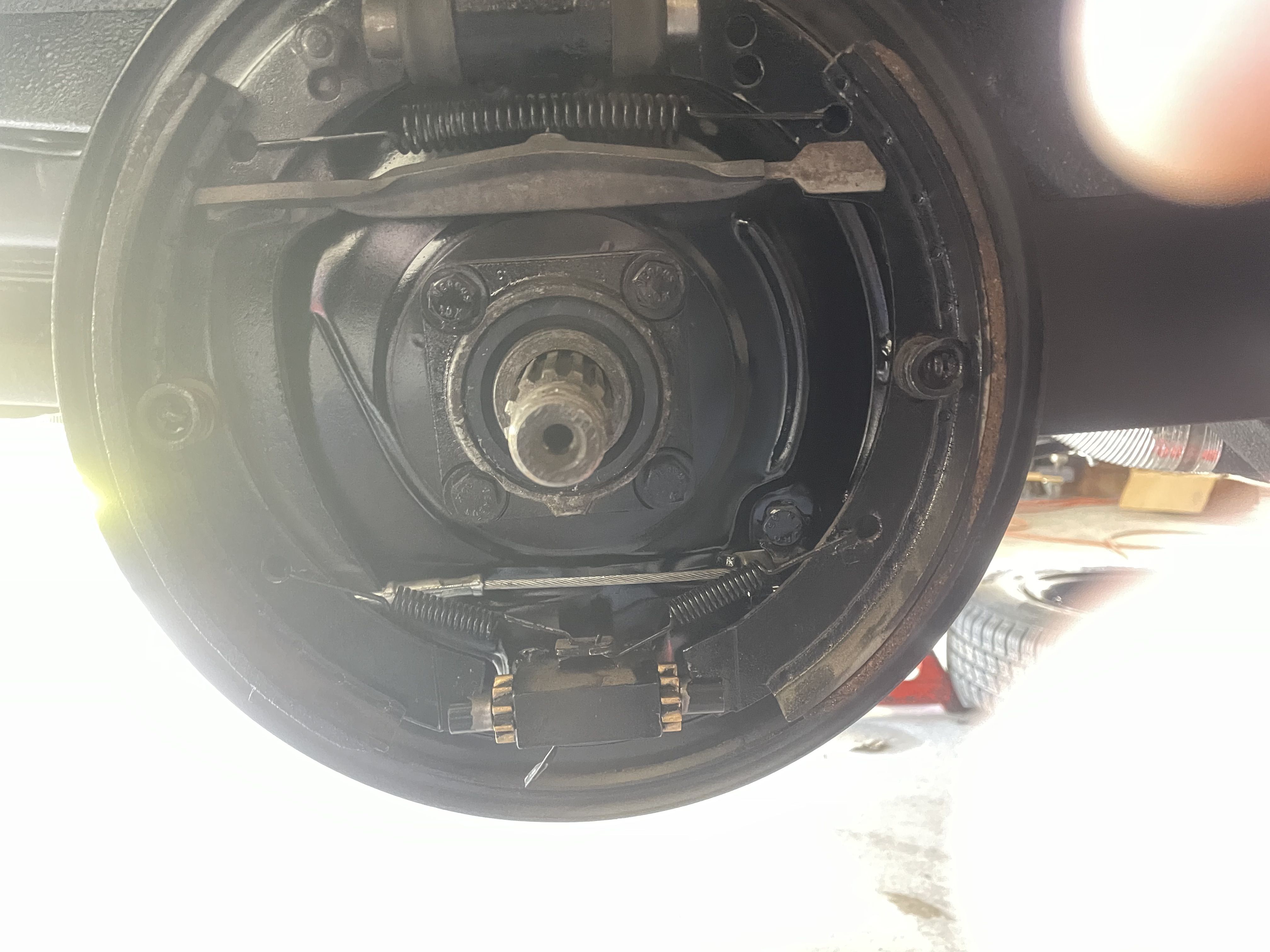

          Anyone want to guess what’s wrong with this picture?

          Sorry about the date stamp
          Click image for larger version  Name:	Cyl3.jpg Views:	0 Size:	108.3 KB ID:	116397 Click image for larger version  Name:	Cyl1.jpg Views:	0 Size:	77.0 KB ID:	116398
          Click image for larger version  Name:	Cyl4.jpg Views:	0 Size:	77.1 KB ID:	116400 Click image for larger version  Name:	Cyl2.jpg Views:	0 Size:	88.0 KB ID:	116399

            Looks like we're missing a spring down low there. Are you happy with how the bores are looking? Nothing more unpleasant than working on a car remotely especially 50 miles away!
          Justin good eye

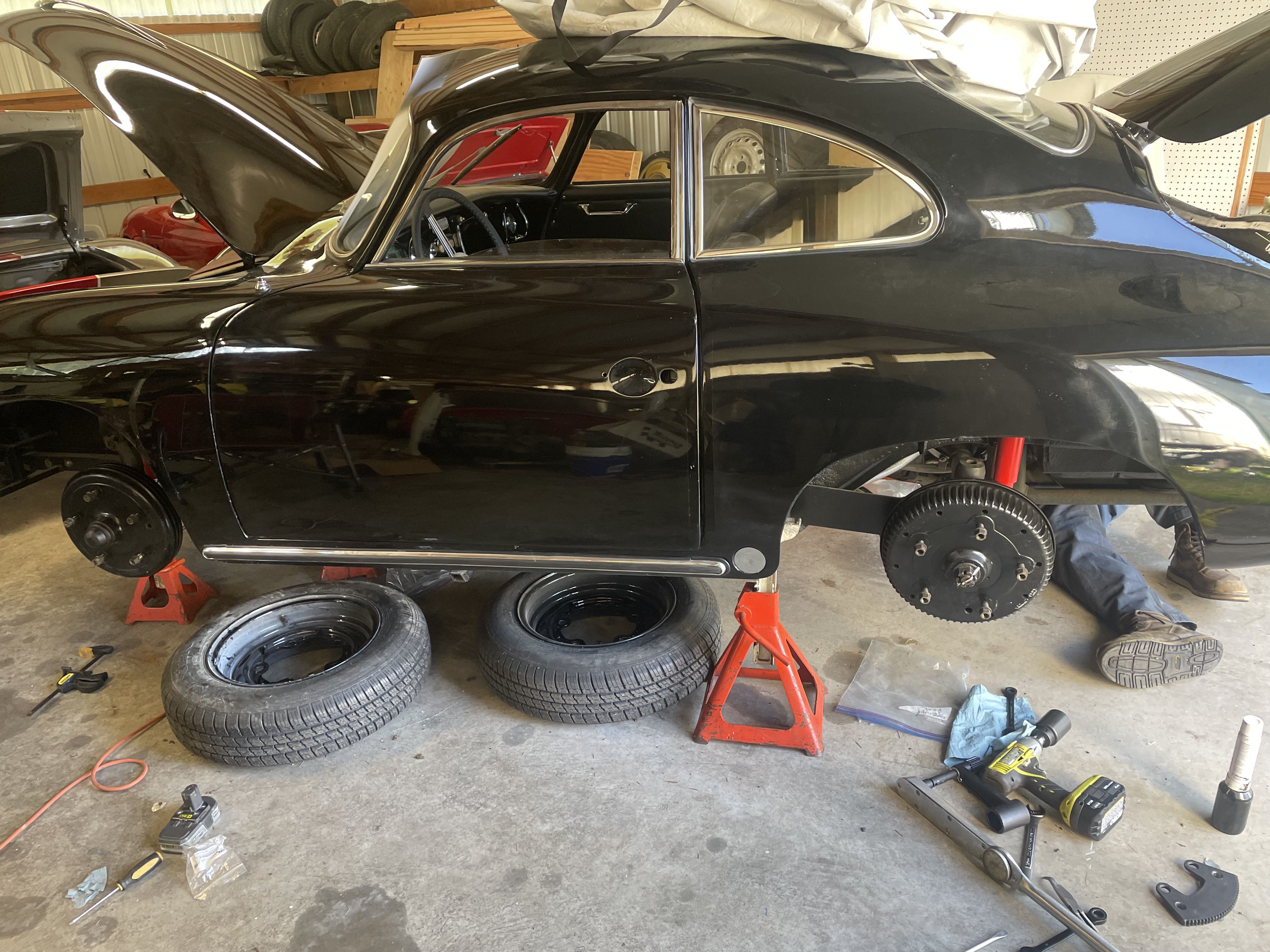

          Spent the day on brakes today. Brakes were a disaster, right front wheel cylinders installed backwards, rotation pushing into the hydraulic side. Springs in the wrong holes, shoes on backwards.. all the pistons were frozen. We ran a 1/2” fine tap in the piston bores until it bottomed out, then you can twist them loose and pull them out. It threaded the pistons but holds the same IDA so they are still usable. The threads will hold some grease for less corrosion in the future. I thought I would snap a tap on a couple stuck pistons.
          All the bolts are finger tight. I thought it was strange I removed the rear drums with a 3/8 ratchet, (the cotter pins were installed) then wheel cylinders, tie rod ends, shocks, steering box clamp all finger tight. Almost like they were waiting for a torque wrench to finish. We will need to check every nut and bolt.
          Click image for larger version  Name:	IMG_7673.jpg Views:	0 Size:	1.63 MB ID:	116416 Click image for larger version  Name:	IMG_7670.jpg Views:	0 Size:	1.53 MB ID:	116417 Click image for larger version  Name:	IMG_7671.jpg Views:	0 Size:	1.67 MB ID:	116418
          We overhauled the hydraulics, honed all the cylinders, installed new cups polished the pistons and cleaned the adjusters. My son JR helped today, his first 356 brake job. Good worker and I do not have to get up and down as much. But he is charging me$100.00 an hour. Above he is applying red rubber grease on the adjusters, and looking for a bleeder valve that was painted. I use a hypodermic to apply the caster bean based grease. It’s compatible with brake fluid. Keep s the moisture away from the moving parts. Every thing is painted black, car, drums, wires everything, such fun.
          The metal work, floors, battery box, longitudinal, door skin, fender repairs are quality work . It’s was subcontracted out. The paint and gaps and also nice. The car was sand blasted, bear metal paint in 2009. Then re-assembly started. It’s missing lots of stuff, but most is obtainable. The interior is leather but not correct.

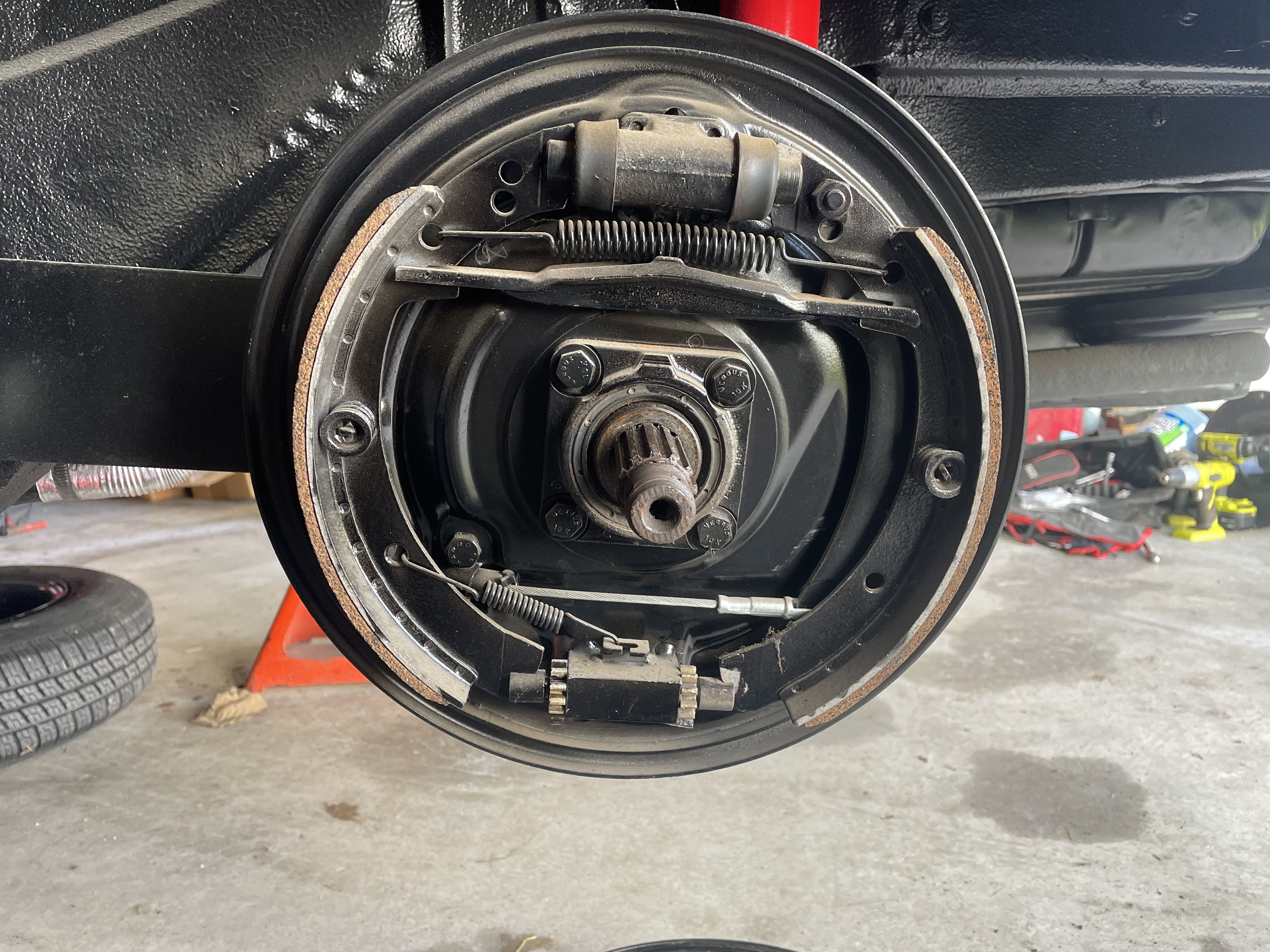

          Another Sunday in the book. We got the brakes back together an adjusted. Typical drums. old shoes but still have 4-5mm of stopping left. We got the rear axle nuts torqued properly with my good old "torque dude" . We pulled the tops of both carbs, a little crusty but not a disaster. put 50cc of gas in the bowels, an naturally the jet covers leak. Got the starter installed, had the bolt but no M10 x 1.5 nuts. We got the front end put back together all the tie-rods torqued will check how close the alignment is next week.

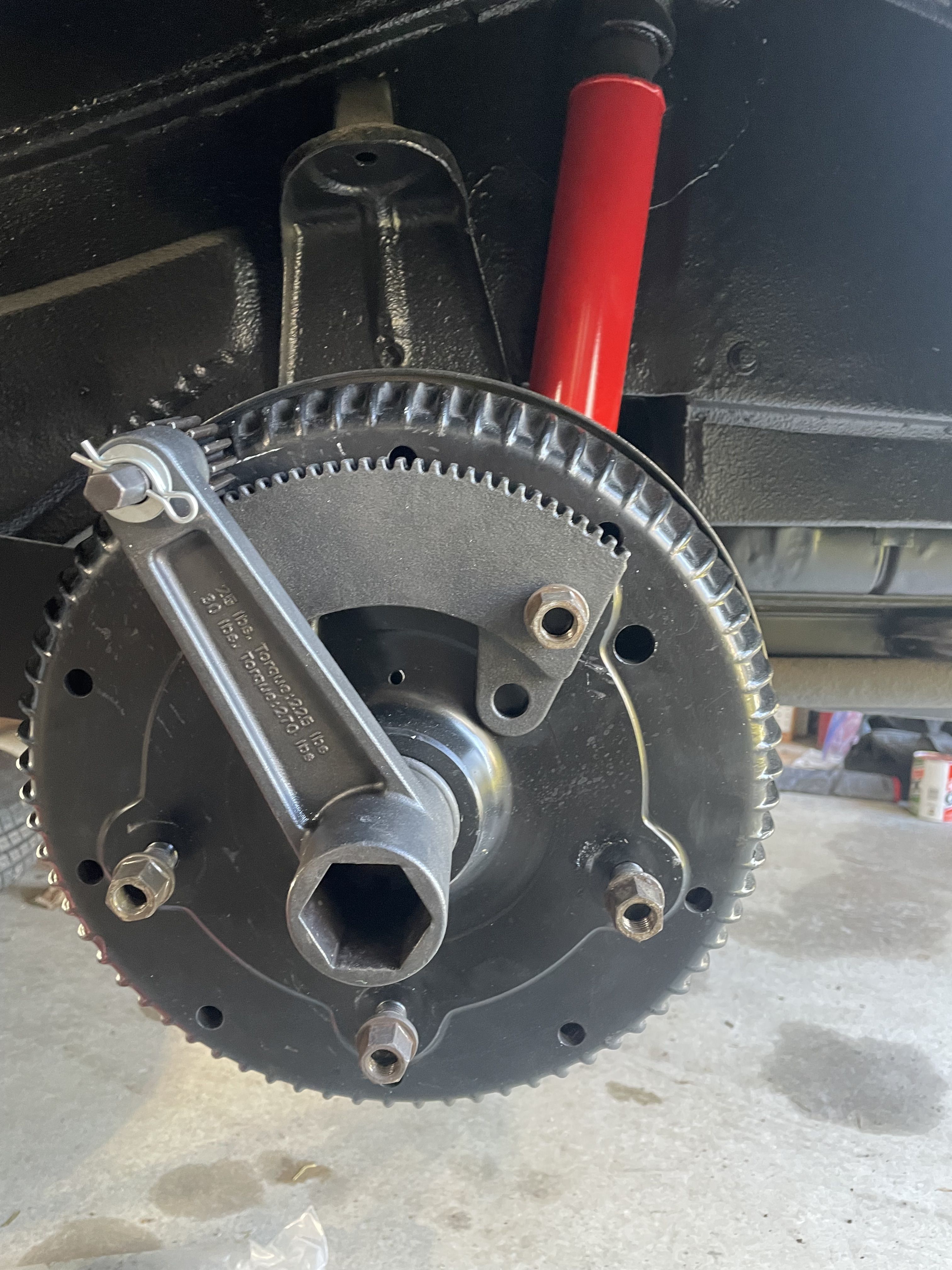

            Love that force multiplying tool for drum nut. So you can use a standard torque wrench on the end of it to achieve the 300 foot pounds of torque it needs?

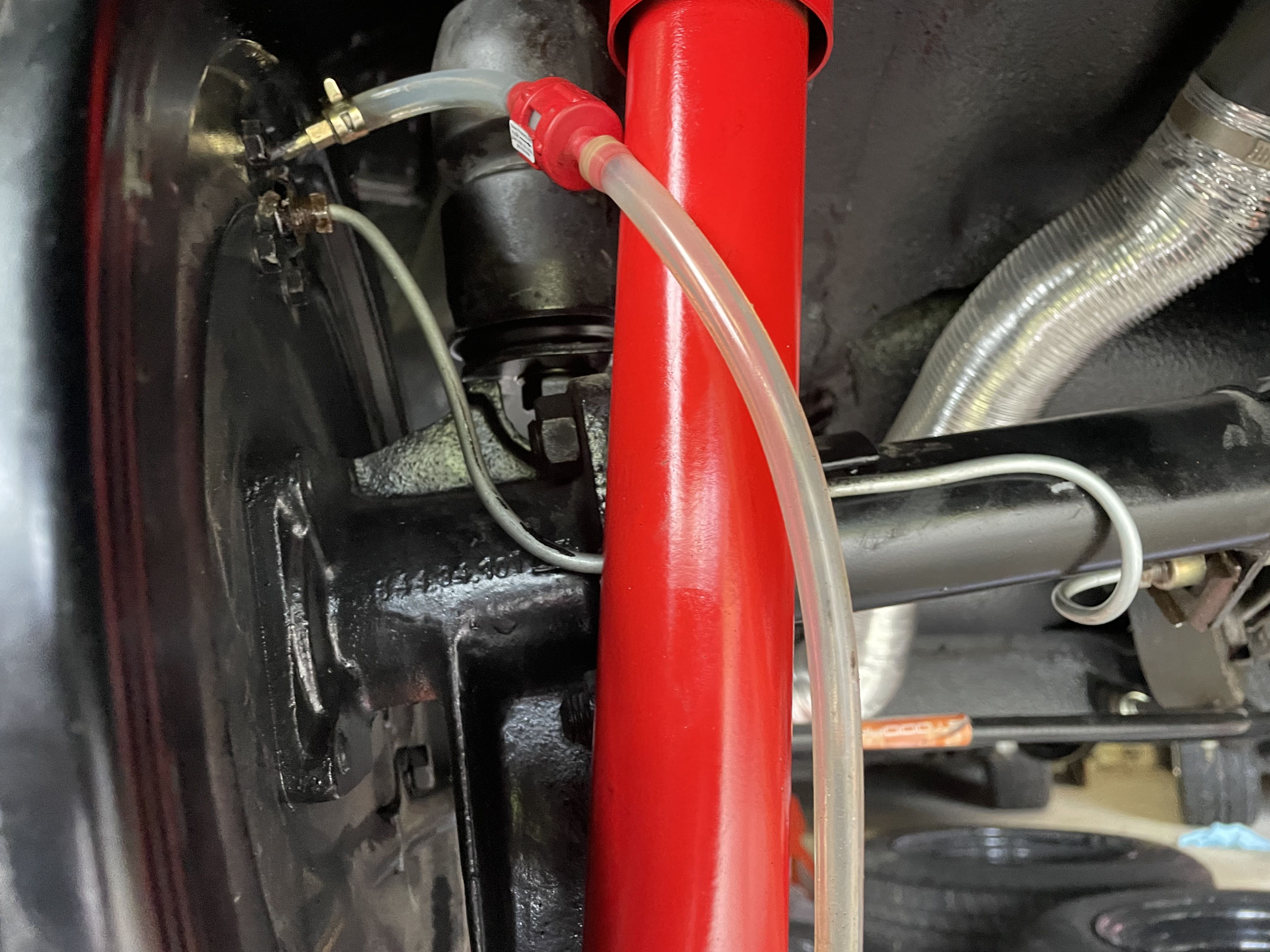

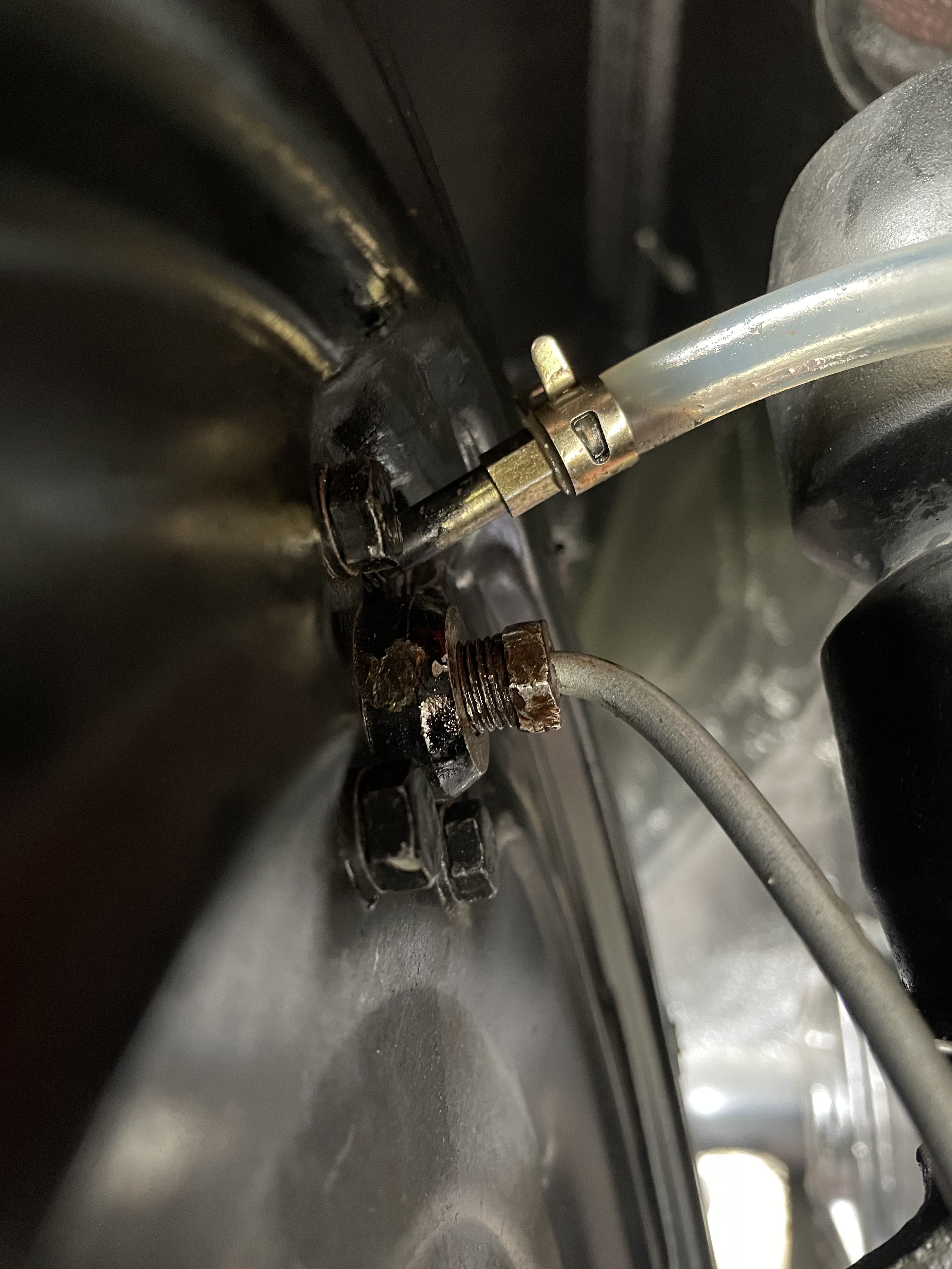

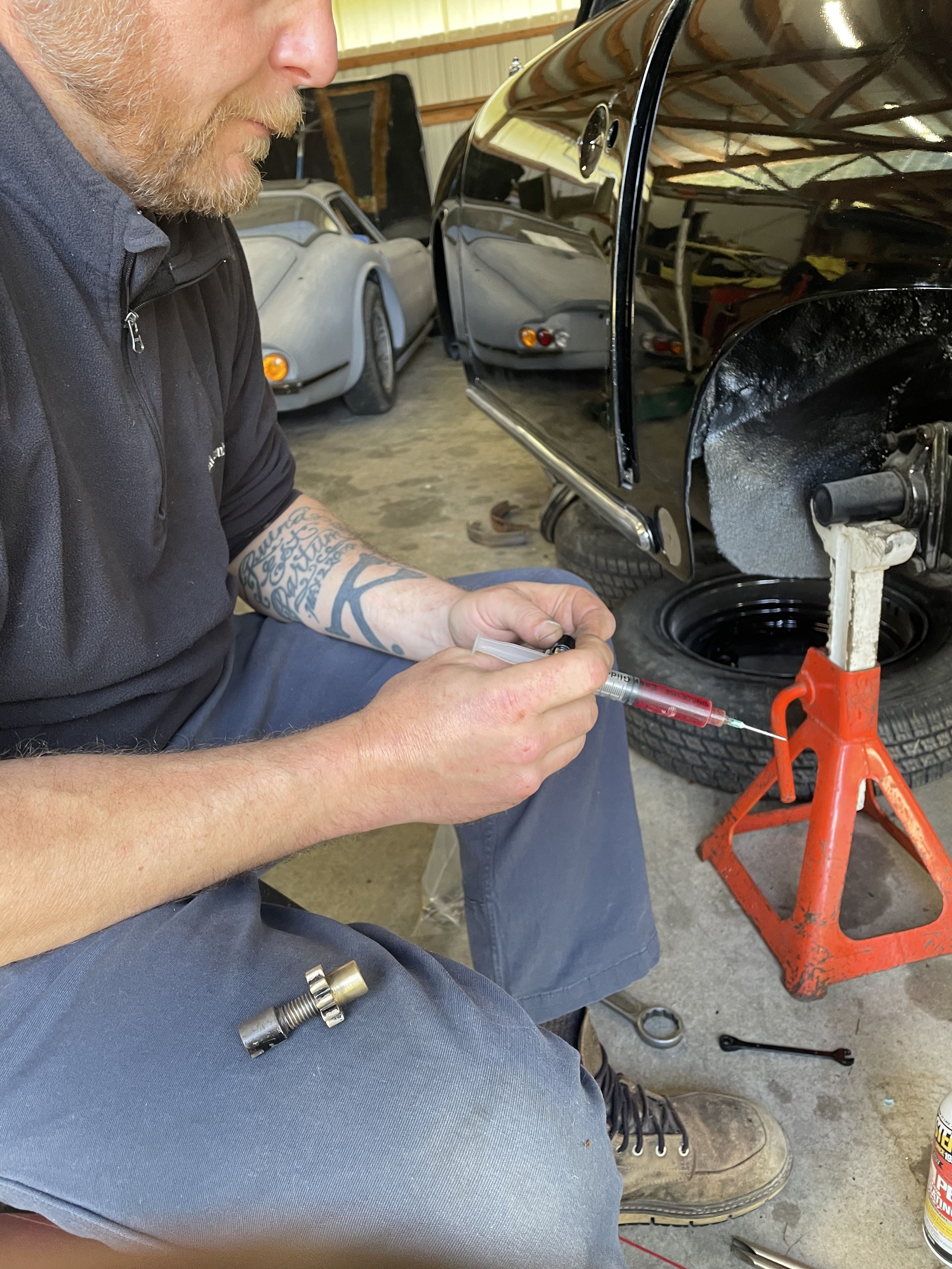

          Brake wheel cylinders were rebuilt, shoes installed and adjusted ready to bleed. Started out OK right rear went fine, then notice the left rear was leaking. It had new pipes an hoses installed. Well the right rear was leaking at the hose and the wheel cylinder . Previous guy made the pipe, but did not use Metric fittings. the started but at lease he did not strip pr cross threads Pipe on order. Mose of the bolts are finger tight while going through them, found the top left front shock bolt stripped out. the anchor bolt is inside the suspension riser so that will take some engineering to properly repair. thought about a helicoil but I believe I will insert a rivnut. I have 10x1.5 of both, its making the threads match the original position so it pulls the shock in tight and has the shear strength were rebuild, Both carburetors leaked, around the jet covers, New O-ring fixed one, so I pull both carbs to run across the test bench at home. That way I can set the floats, put a kit in them and eliminate later problems.
ID:	116447 Click image for larger version
          In the first photo , the red thing in the bleed hose is a check valve. It’s has a 15 pound spring in it. It’s takes that much pressure to overcome the check. This insures the system stays pressurized and does not suck air back through the bleeder. Not really needed, but allows me to bleed the brakes with the pedal with out someone operating the bleeder screw. I like this better than a vacuum or pressure bleeder. Really works well on the M calipers on 356c and early solid disc ATE brakes.

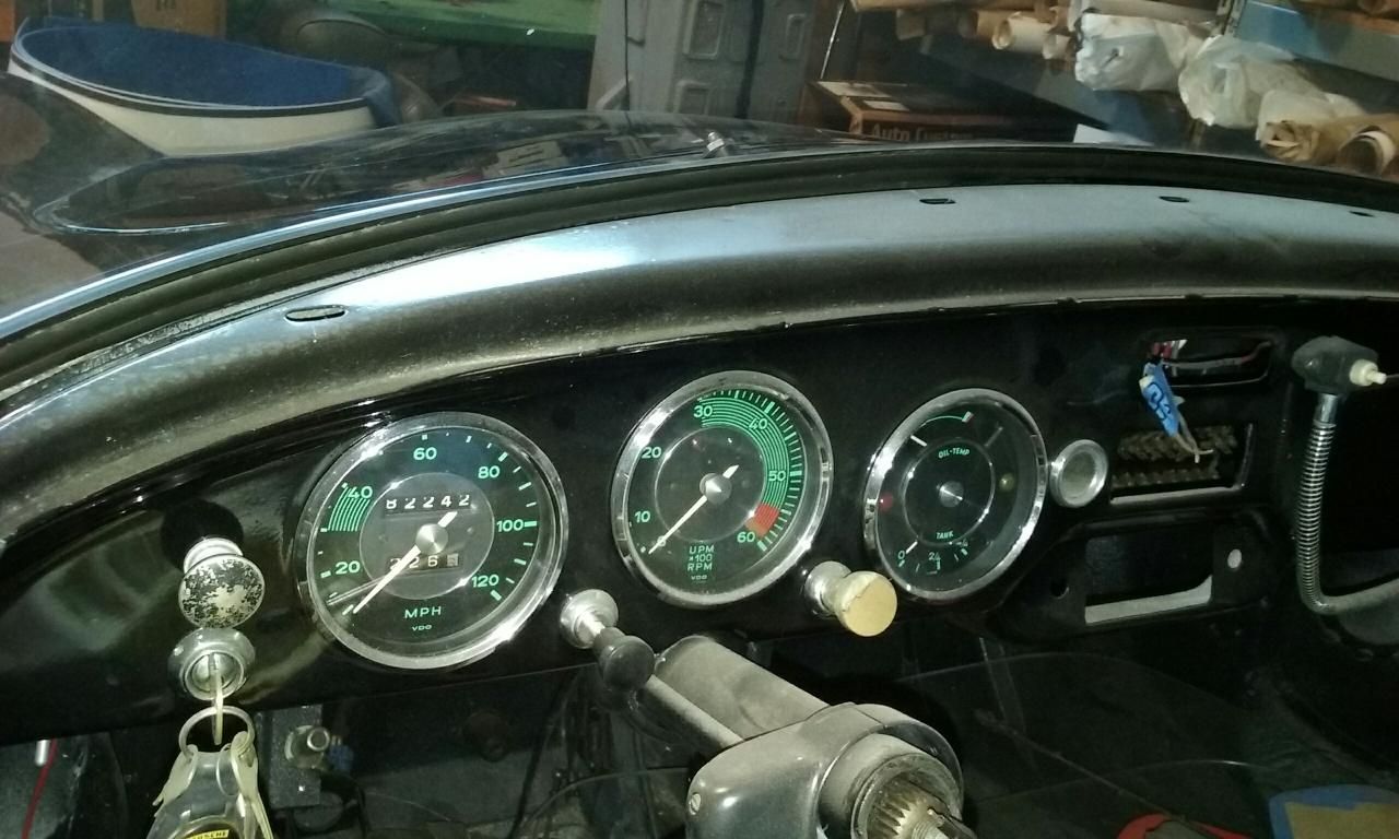

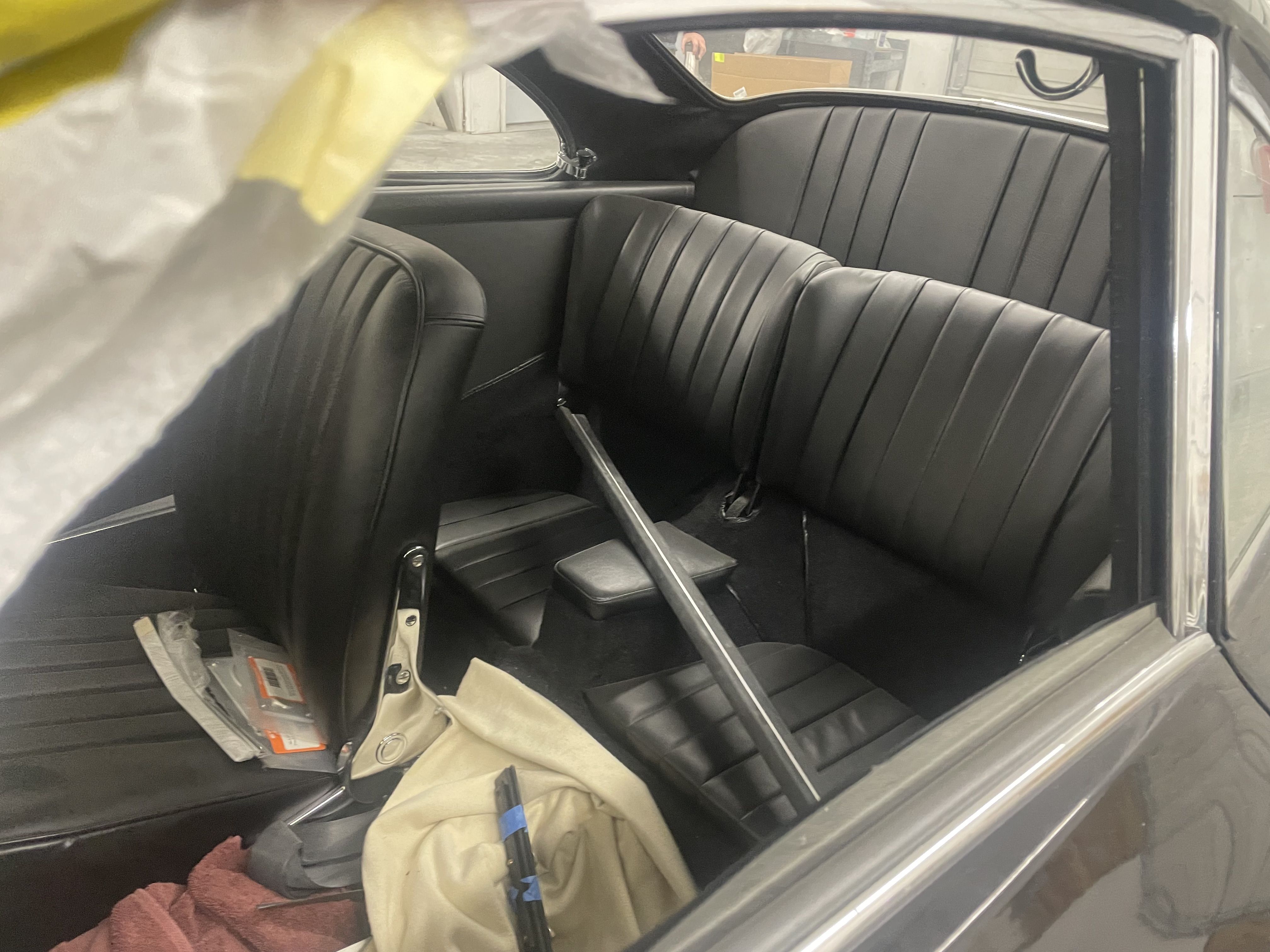

          interior bits and jewelry on, I need to install the steering column an turn signal switch, then start on the electrics. a good week over all except for the stuff the previous guy did. such fun.

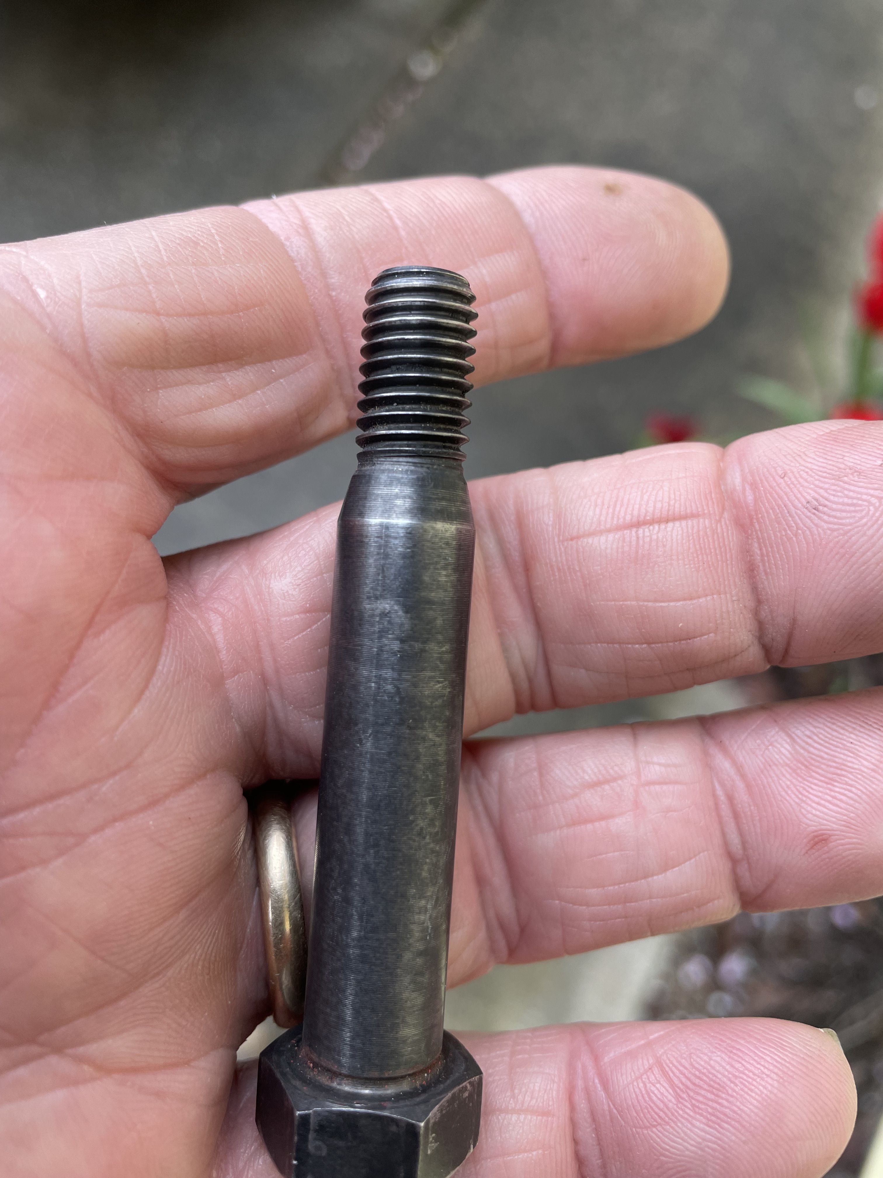

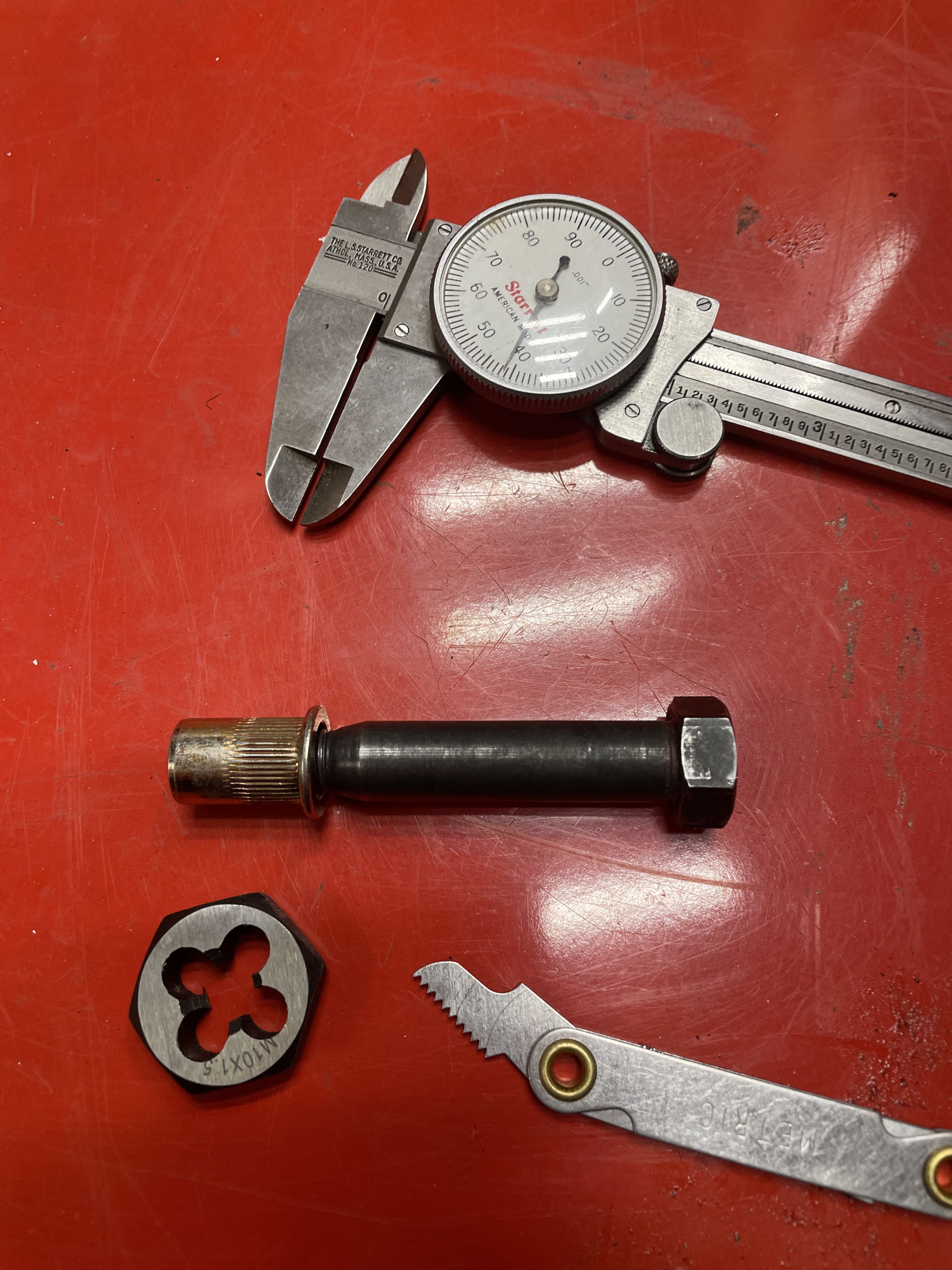

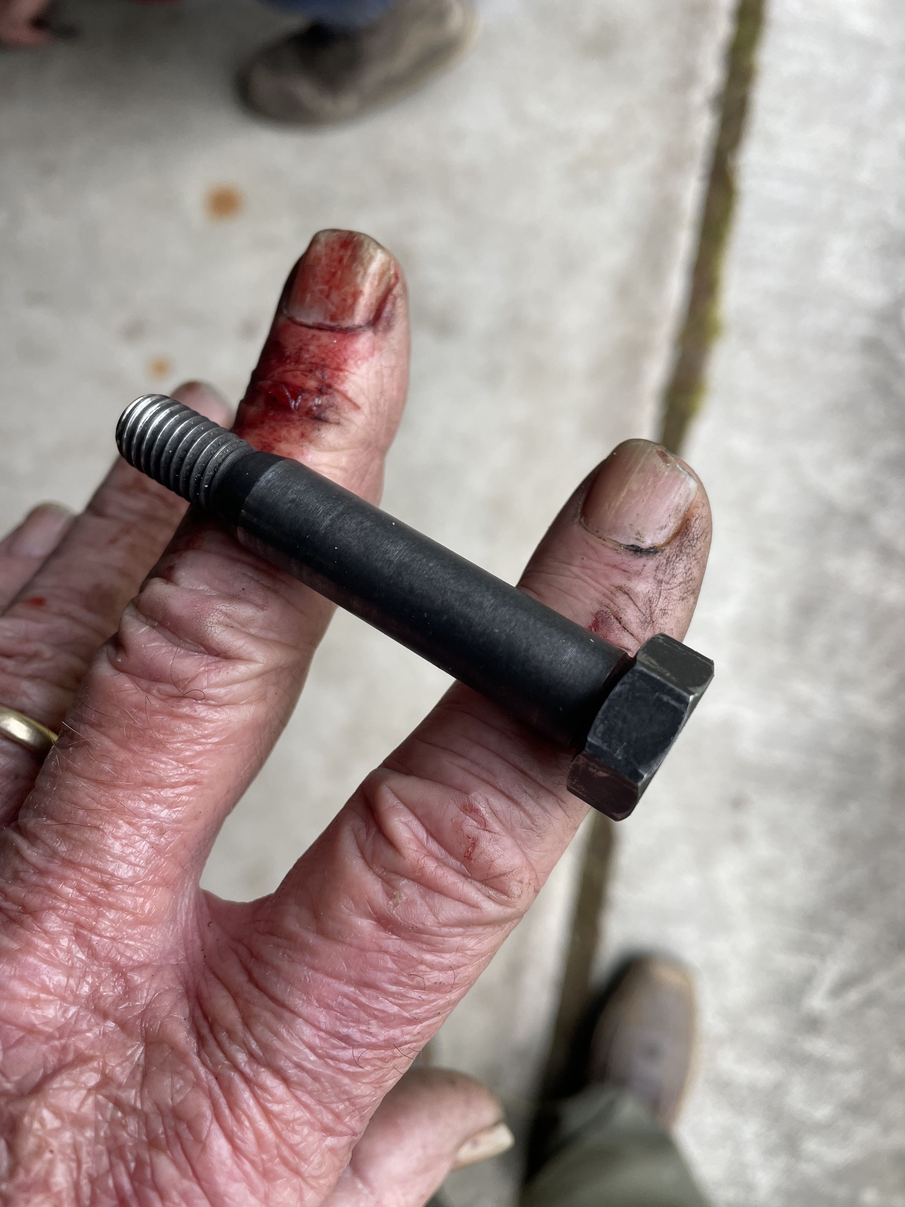

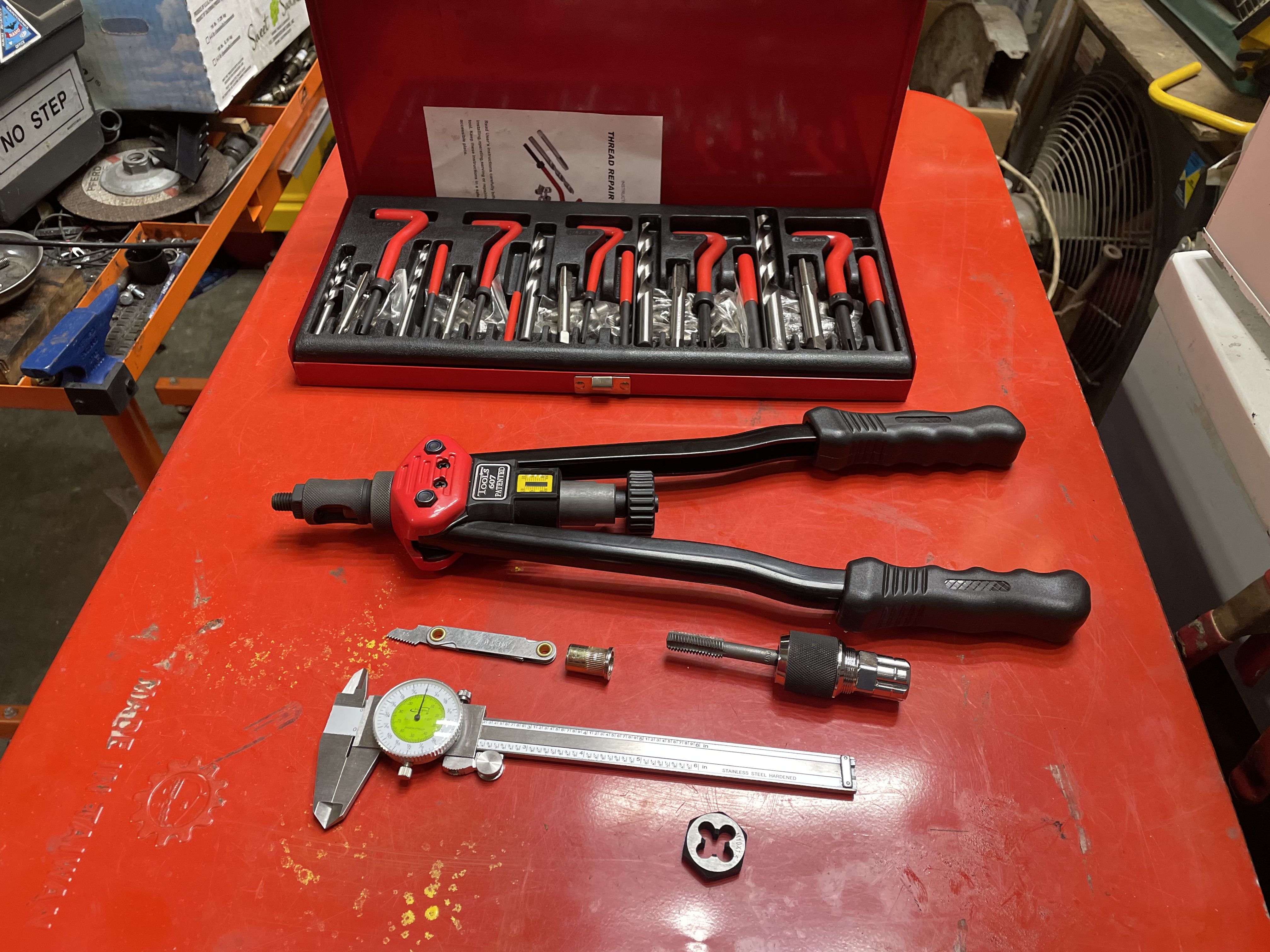

            That upper shock mount is tough one to repair properly at this point.
            Click image for larger version  Name:	IMG_0300.jpg Views:	0 Size:	204.2 KB ID:	116452 If you drill this row of spot welds and peel this lateral flap of the trunk floor you'll have direct access to the back side of the bung for a shouldered repair.
              Shock was stripped, but we put a helicoil in it worked OK. The Bolt shank is 11.5mm extends inside about 12mm so the shear load is carried by the shank, the thread are in a tension so the helicoil is only holding the shock against the suspension point so we should good.

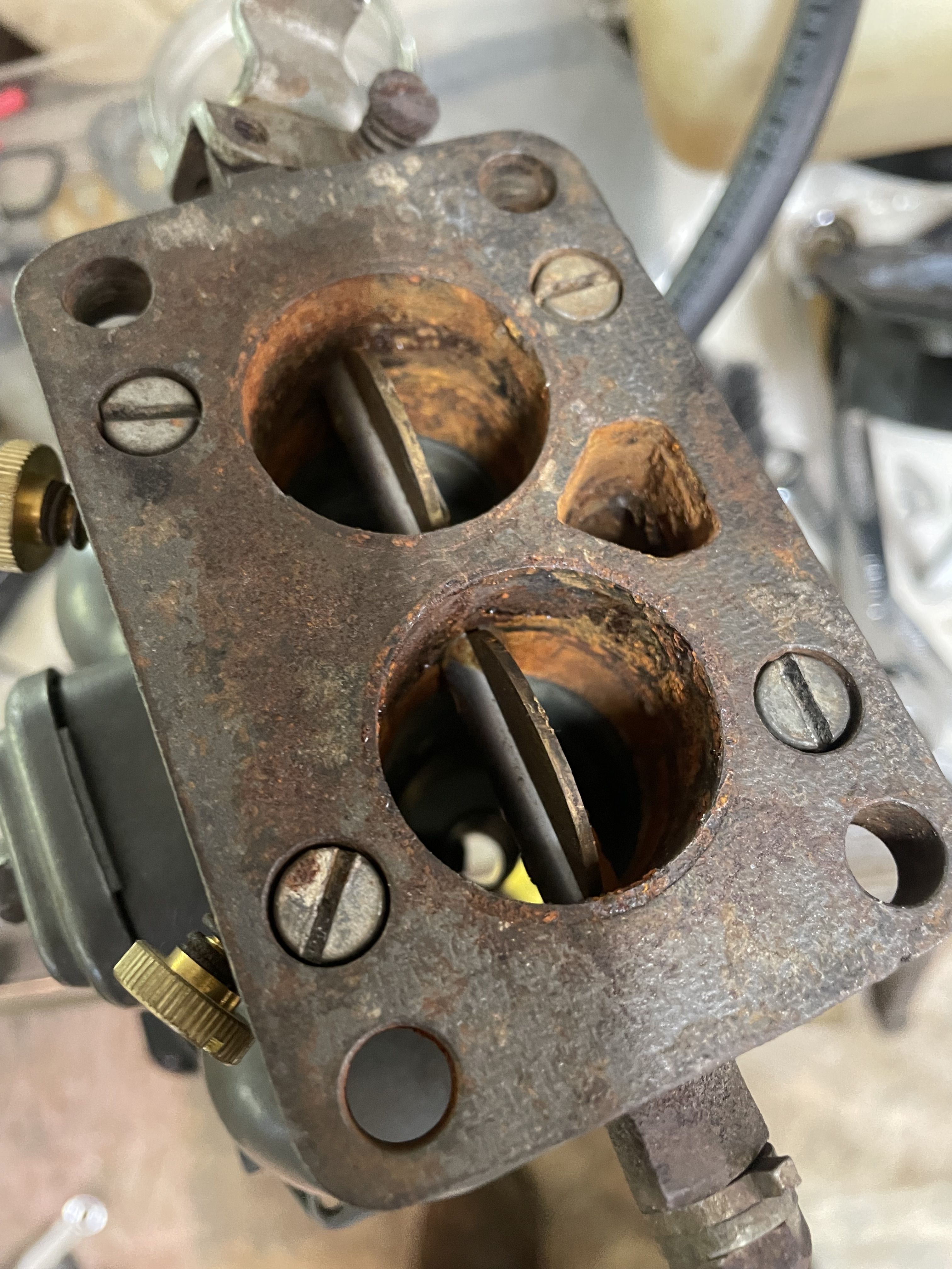

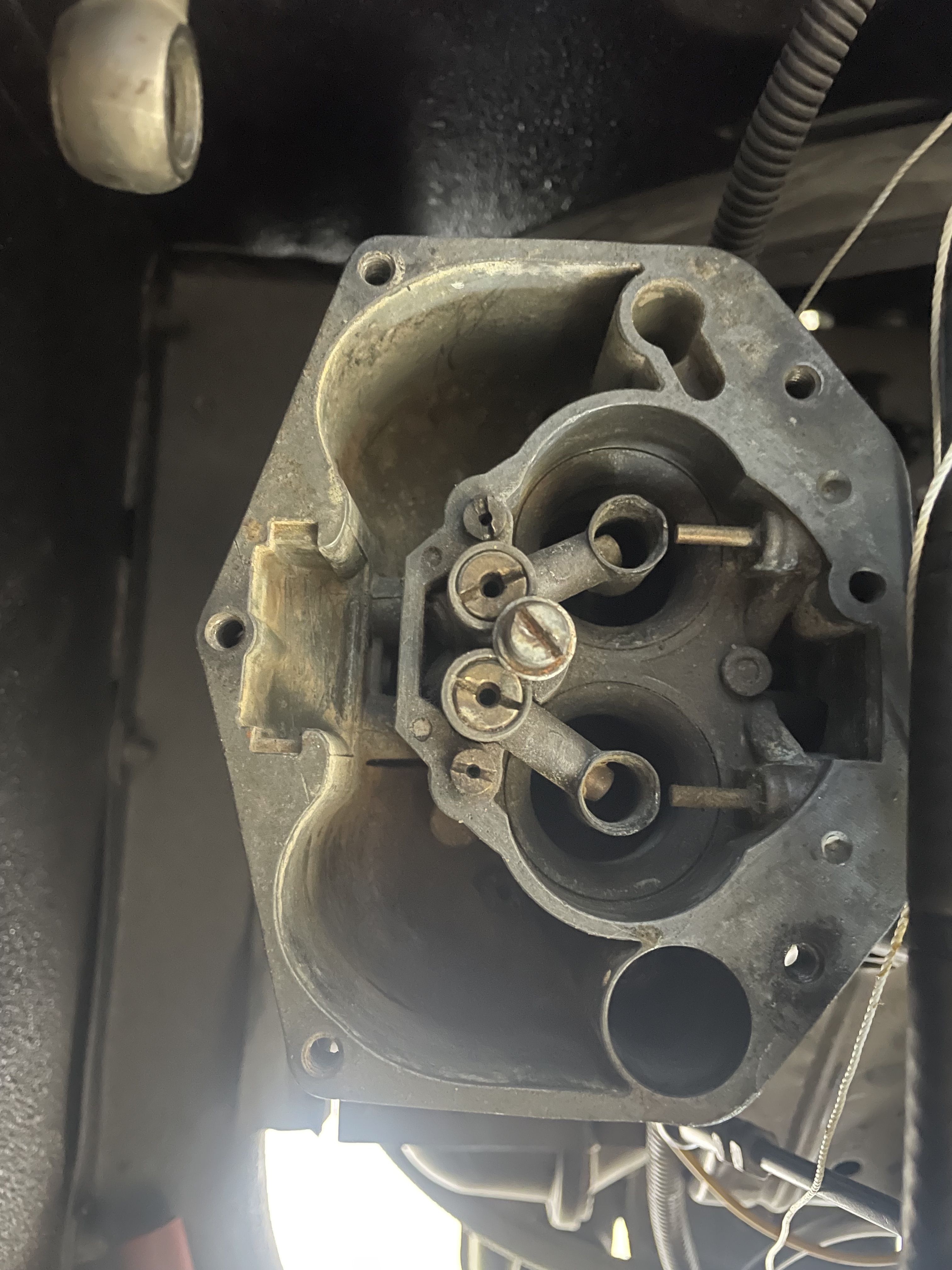

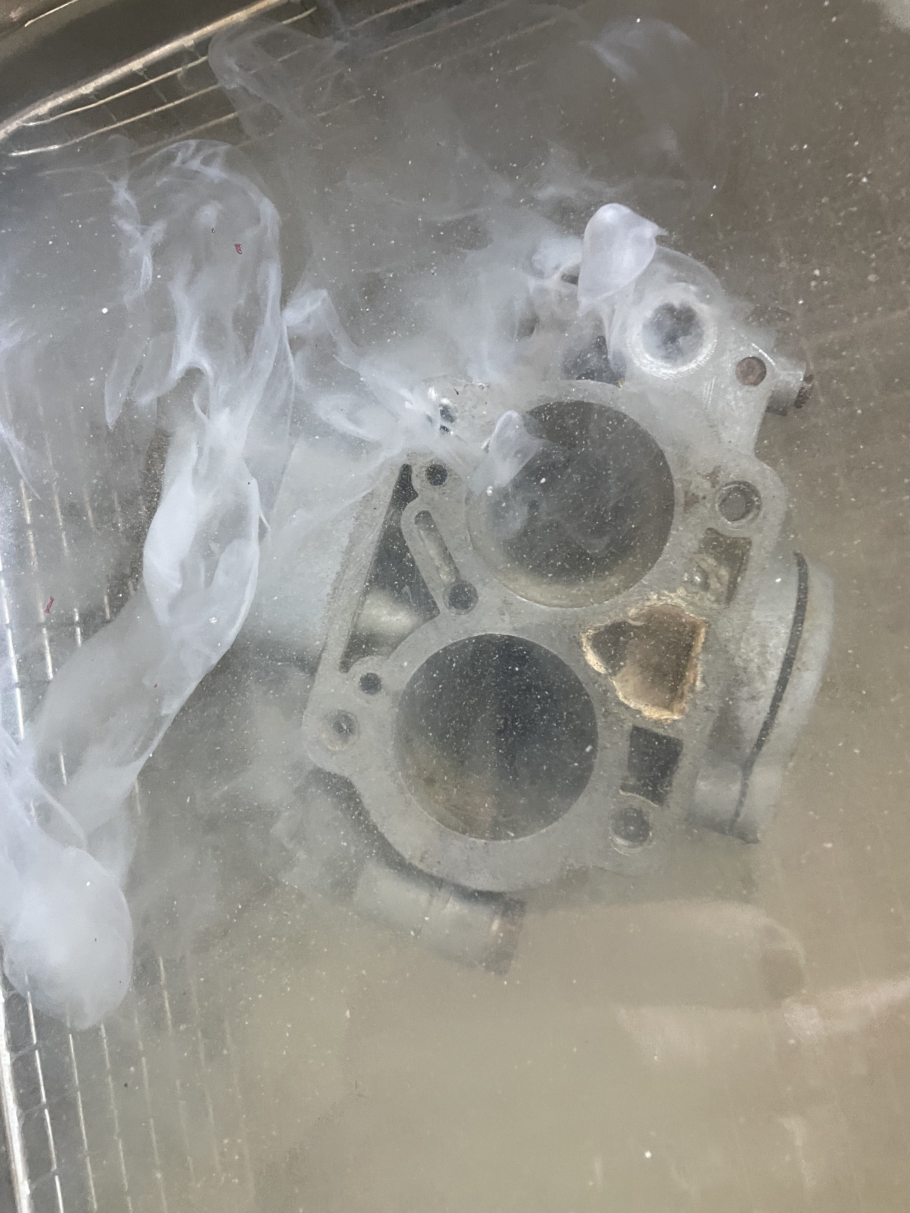

              Carbs are in the ultrasonic now for rebuild. still had the rivets in the top gaskets so they might be original.

              Biggest surprise was we went to put in the starter a start the oil pressure, compression a leak down test. The previous IDIOT do not install the Positive (+) battery cable. No kidding I need to install a 3.52mm cable through the tunnel on a completed car, with a full interior and all the other wires and BS in the tunnel. and to add to the life experience the wire harness has no wrap, just rats nest loose wires coming out of the back of the pipe.

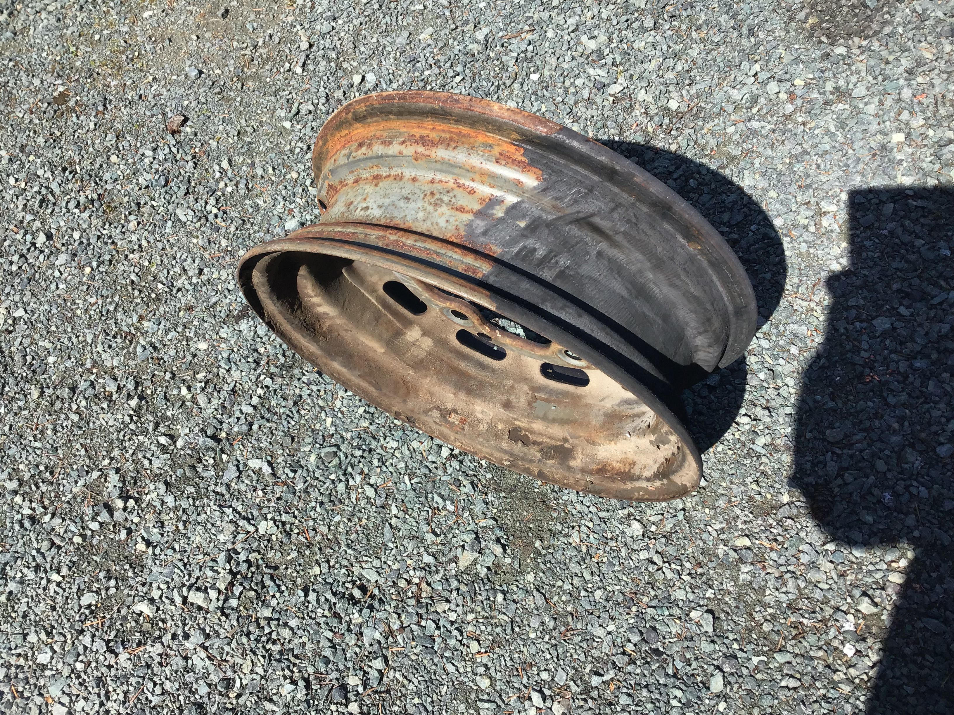

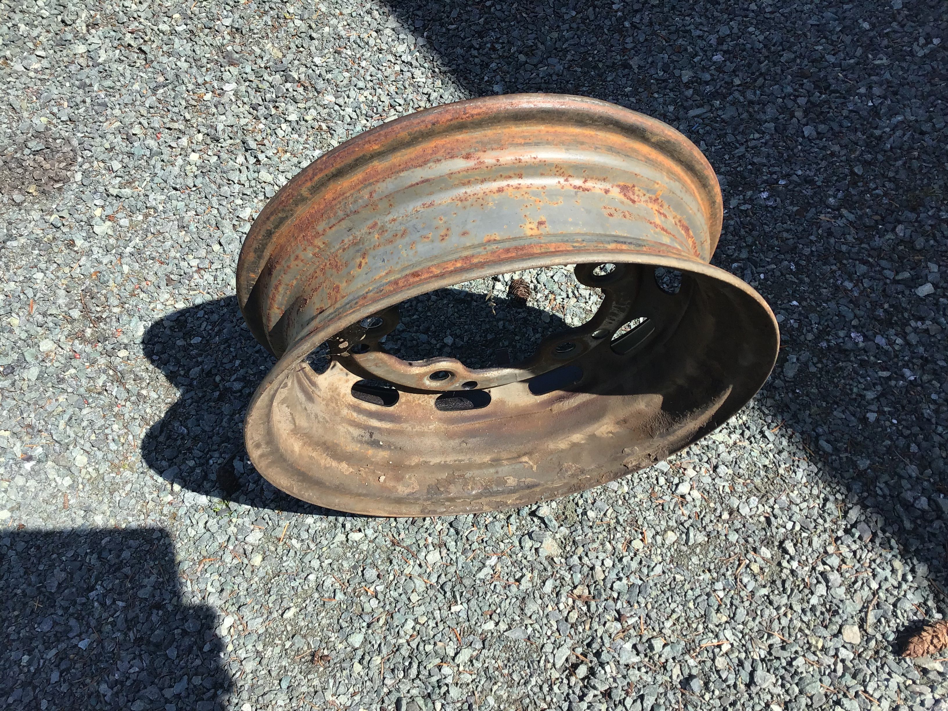

              Laser back together. Celeste bought a used wheel from eBay, another missing part, the spare tire. Anyway used and not even cleaned before shipping. We got the laser figured out and working today, so after a few minutes of test welds, shifted to cleaning. The wheel inside was coated with dried grease and dirt, typical of a well used front wheel. The laser turned all the coatings to carbon, the black dust you see comes off with a soft brush. Took about 10 minutes to bare metal. A quick wipe and it’s ready for the powder coat. I am going to like this!

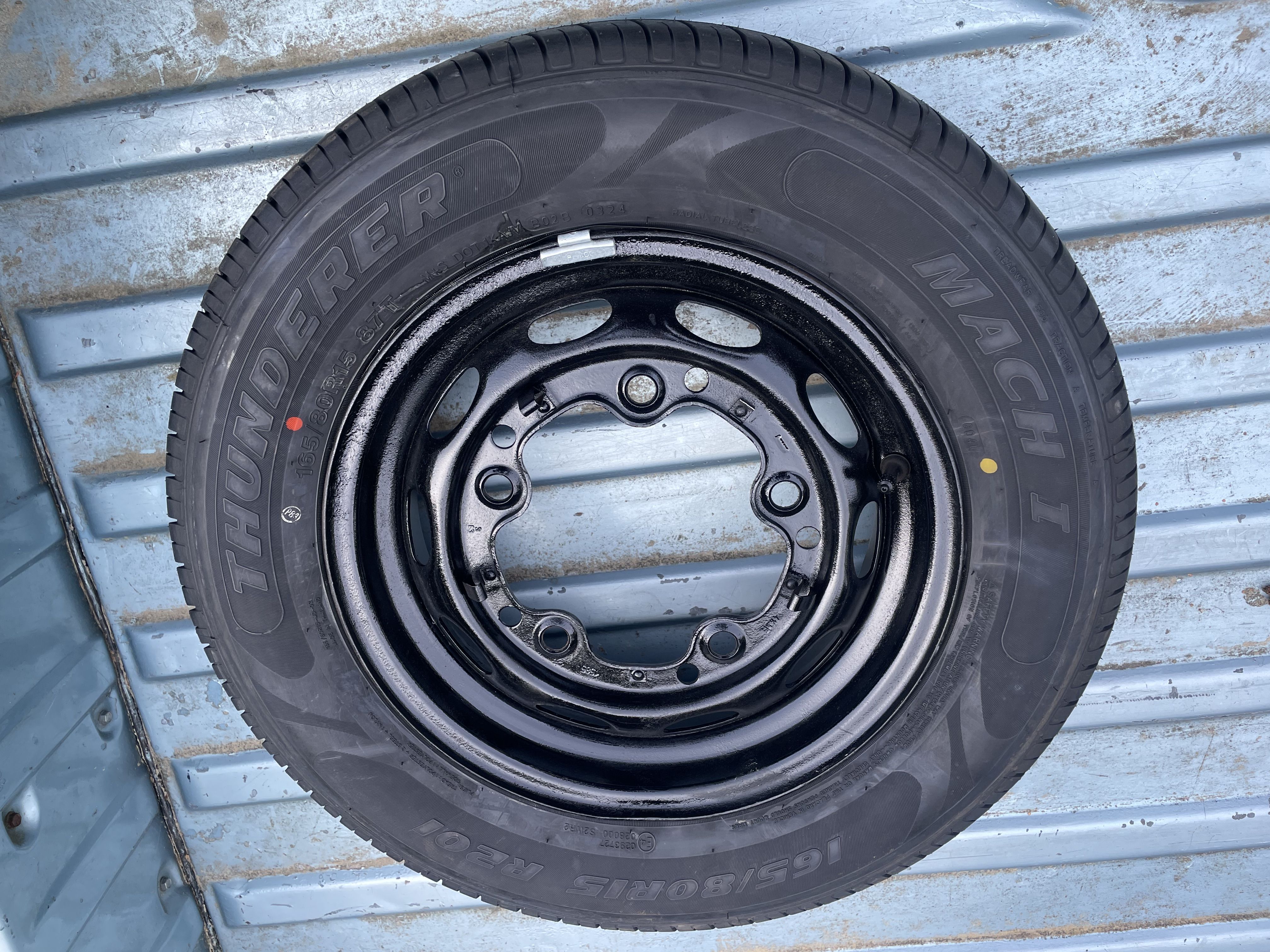

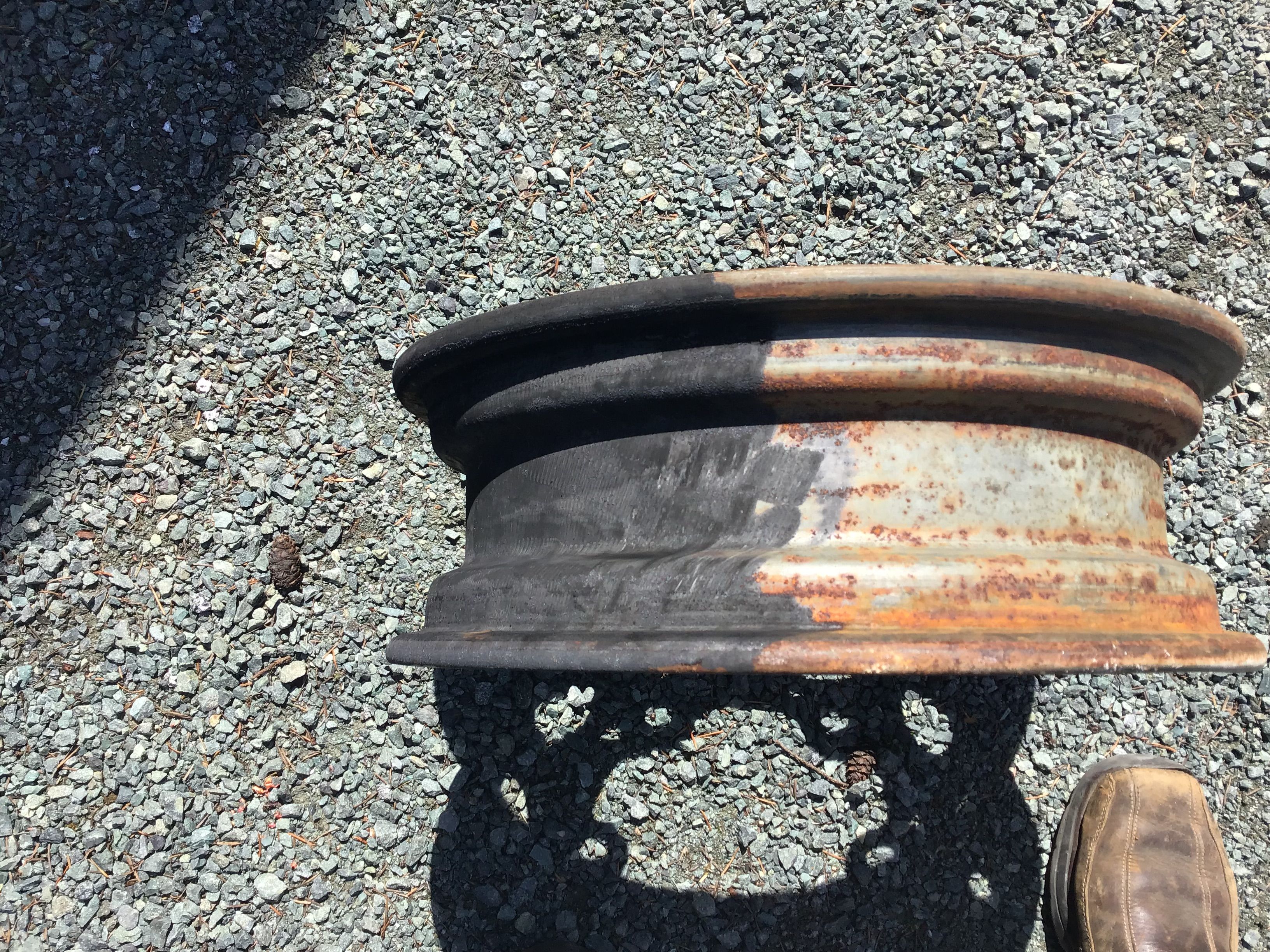

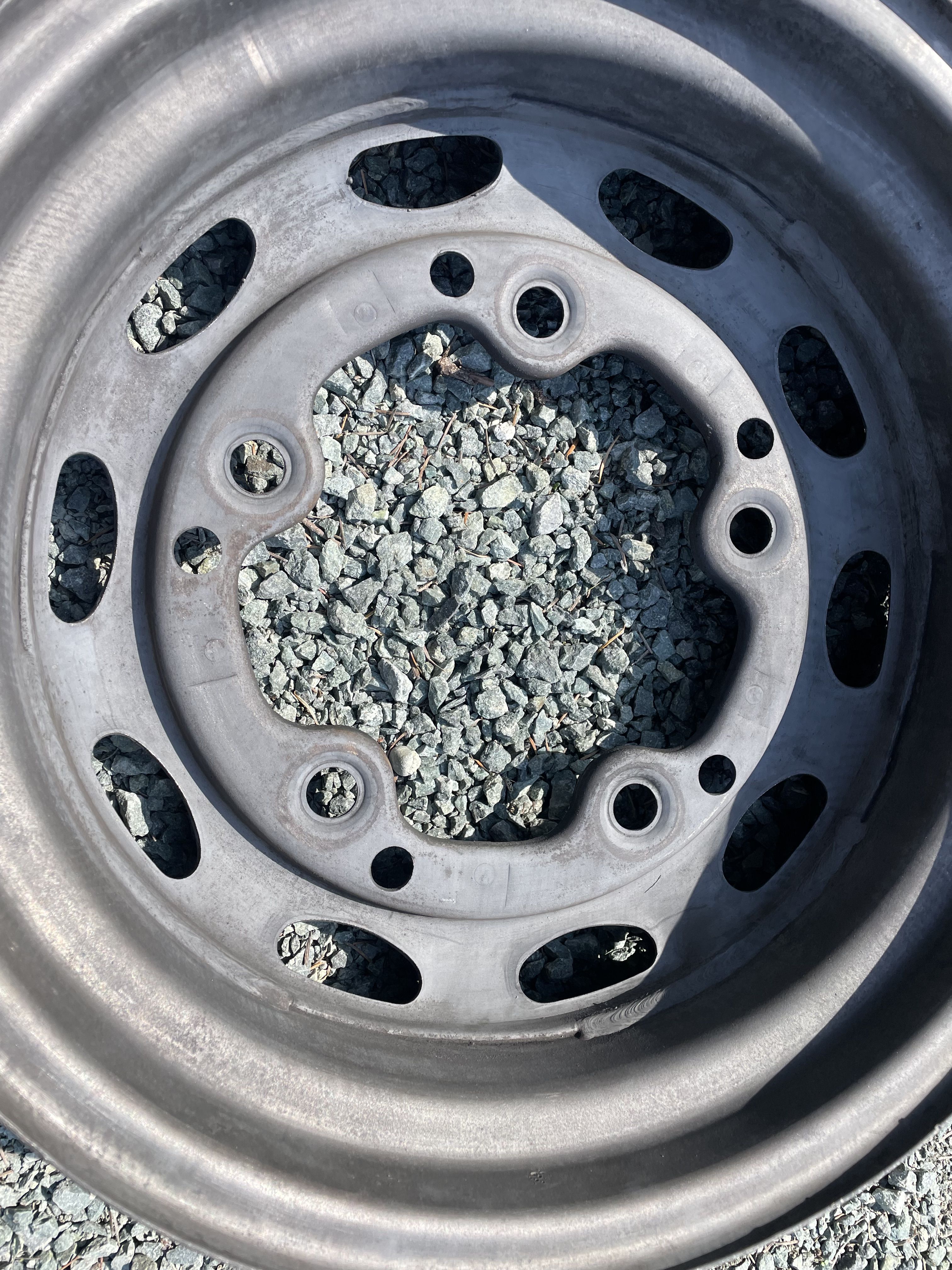

              Got the spare mounted today. That in itself is the only real accomplishment. Body color wheels, I am looking for baby moons and trim rings

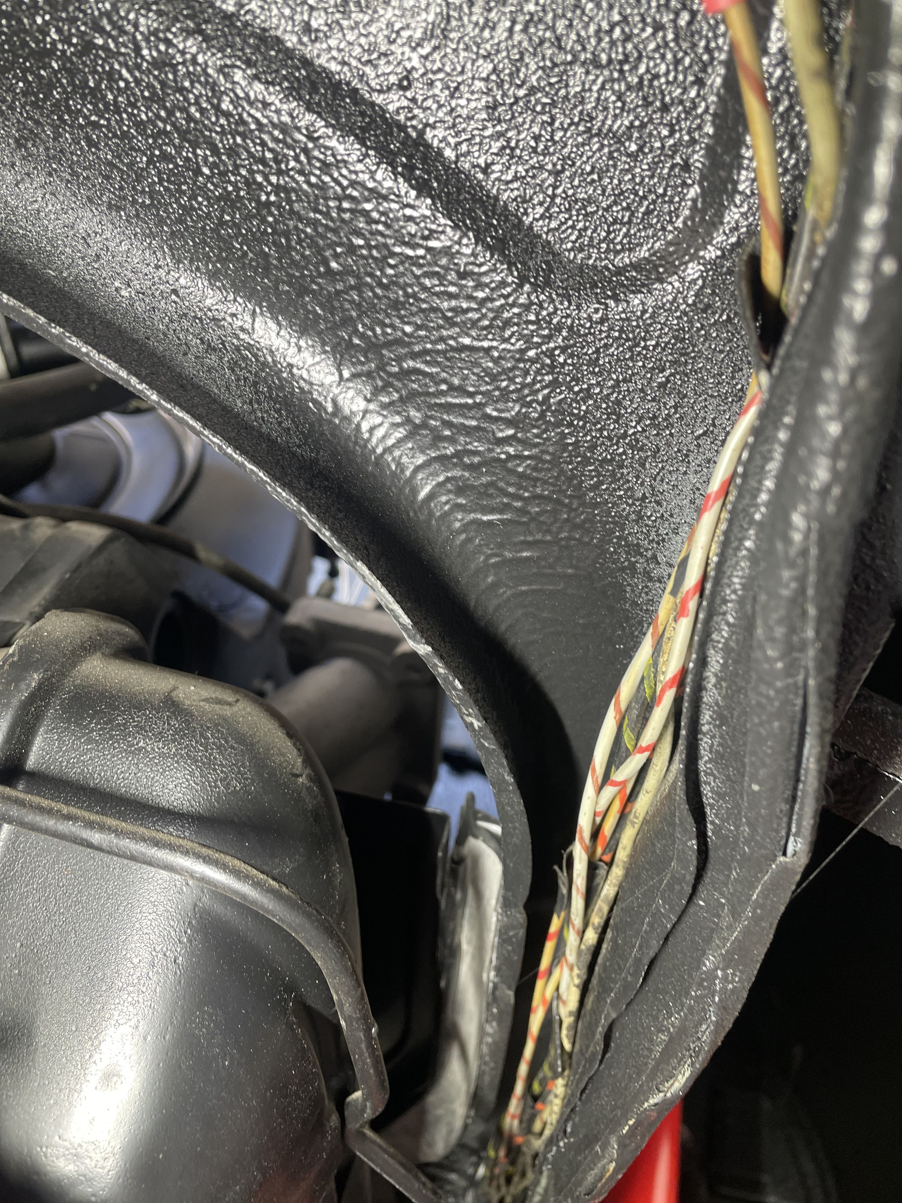

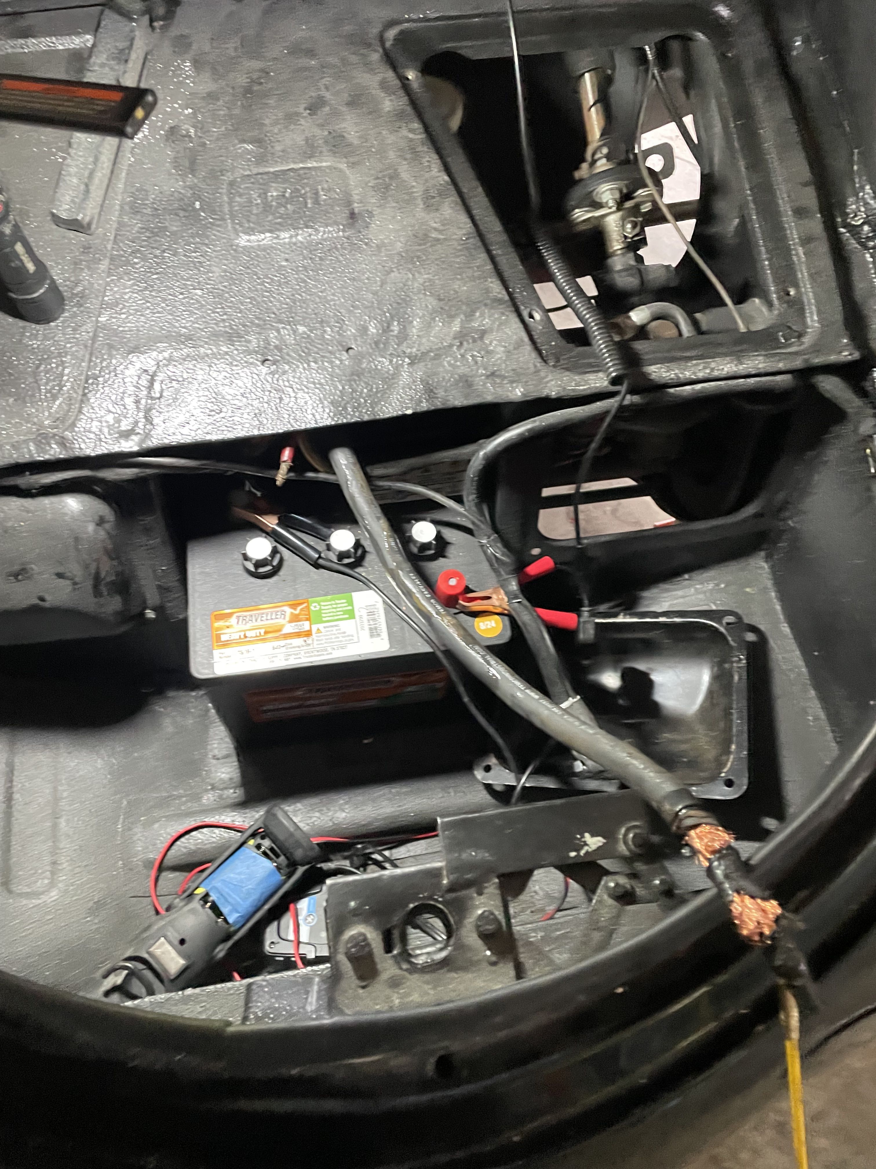

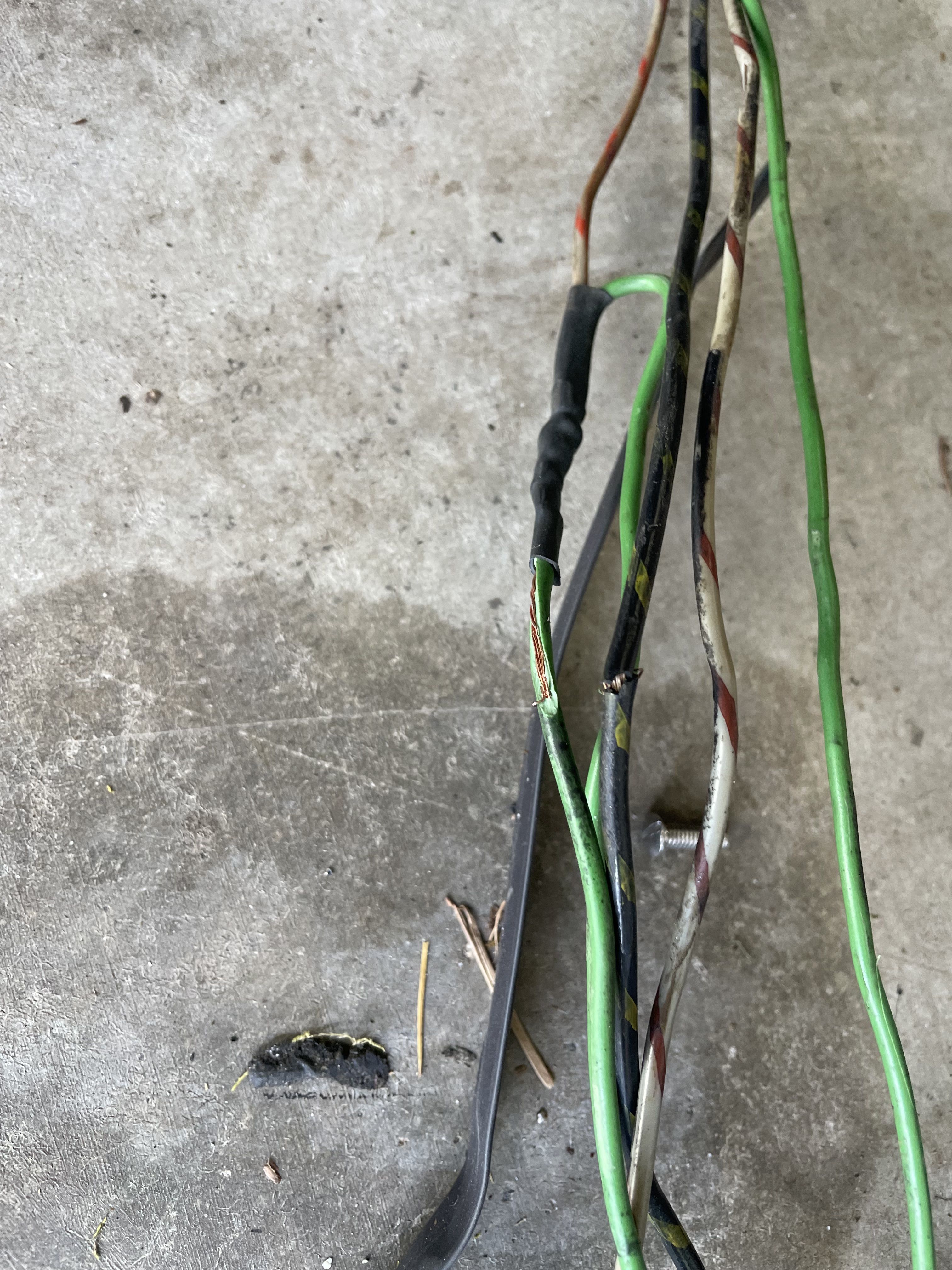

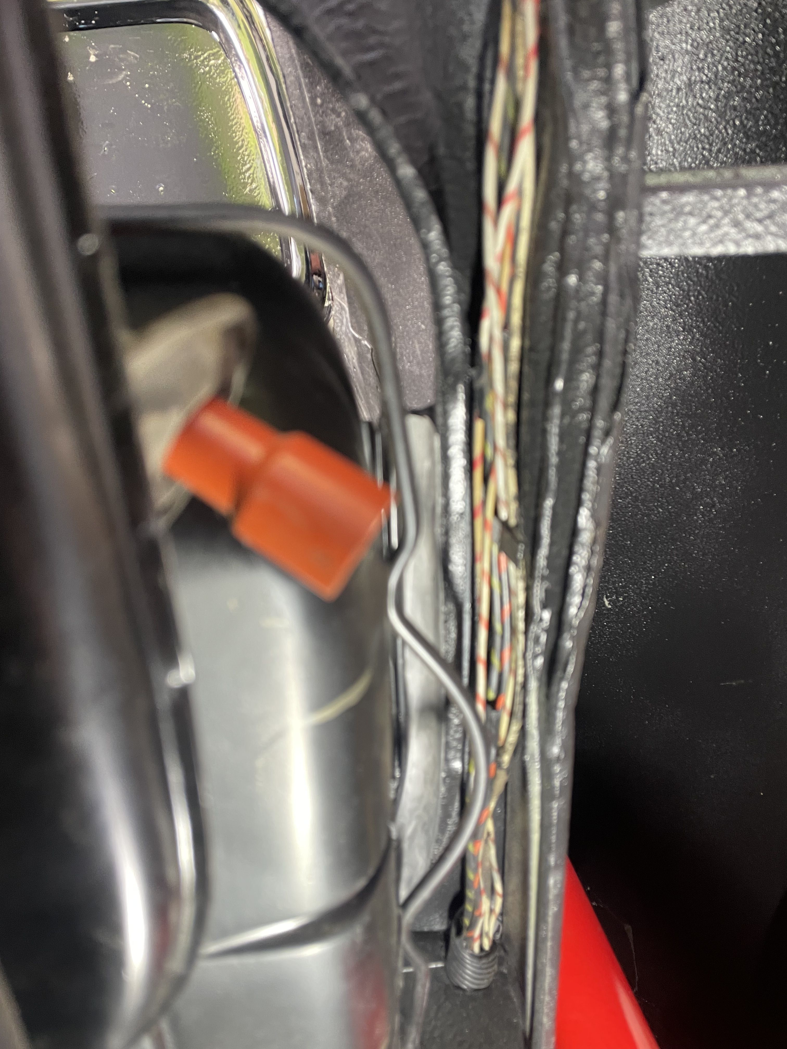

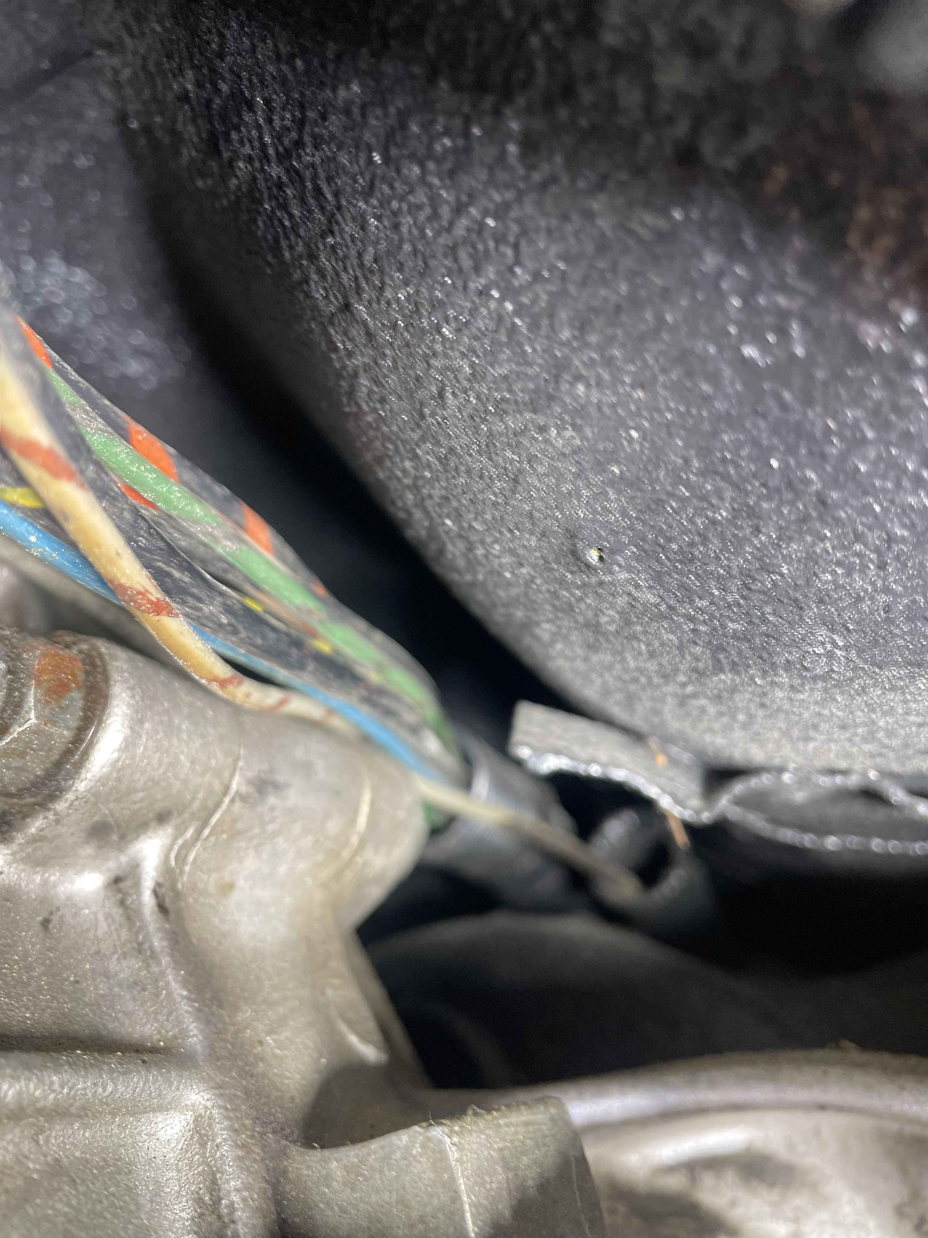

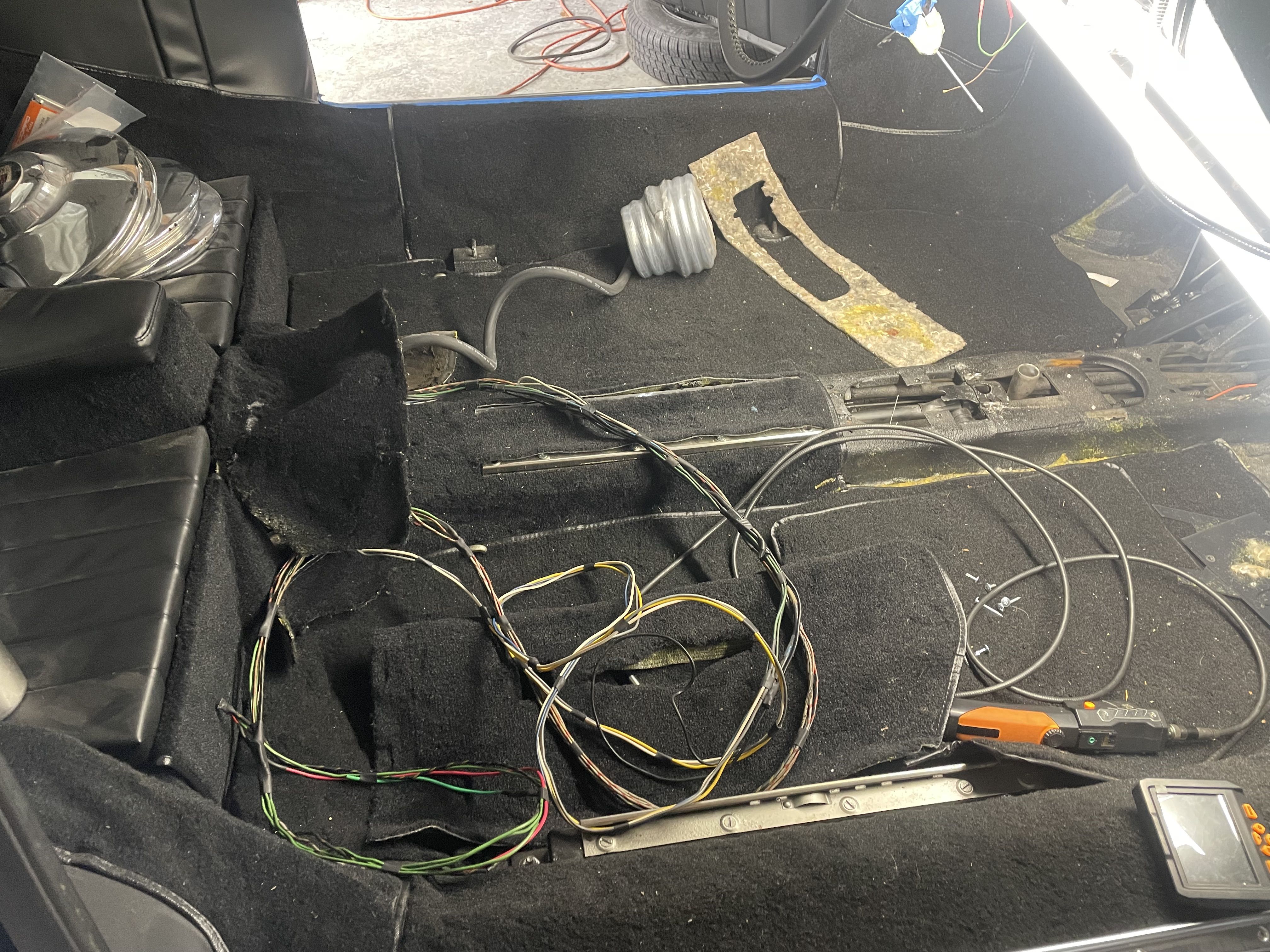

              Went back to get another look at the wiring. Have not paid much attention to it, up to now, minor mistake. Previous restoration guy, let’s call him “Boob” did so many things wrong it hard to catch up. Wiring is original but the harness is routed through the wrong conduits, and all the sheathing has been removed. Lots of wires hanging out in the weather. Even the ground straps are wrong . Then there is no positive (+) cable to the starter. And both cable conduits have loose wires in them already. Note there is a couple pieces of whistle tube, but I am still getting a brain hemorrhoid every time I look at something.
              Click image for larger version  Name:	IMG_7797.jpg Views:	52 Size:	2.15 MB ID:	116503 Click image for larger version  Name:	IMG_7795.jpg Views:	53 Size:	2.08 MB ID:	116502
              Click image for larger version  Name:	IMG_7794.jpg Views:	53 Size:	1.56 MB ID:	116505 Click image for larger version  Name:	IMG_7791.jpg Views:	60 Size:	1.38 MB ID:	116500

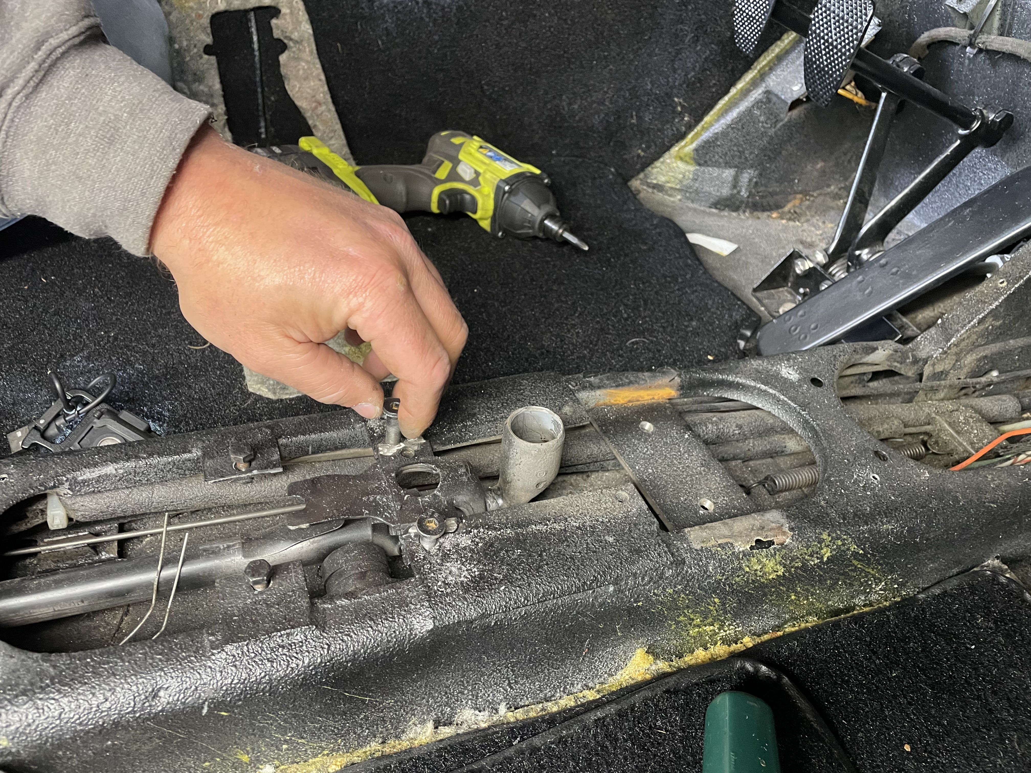

              now looking like a engine & trans drop, remove the seats, carpets open up the tunnel and start fixing wires. On a new leather interior carpets and floors. The main power cable to the fuse box is cut too short to use,, I can’t wait to see what it looks like under the dash, or behind the fuse box. Well the saga drives on ( I wish it could drive)

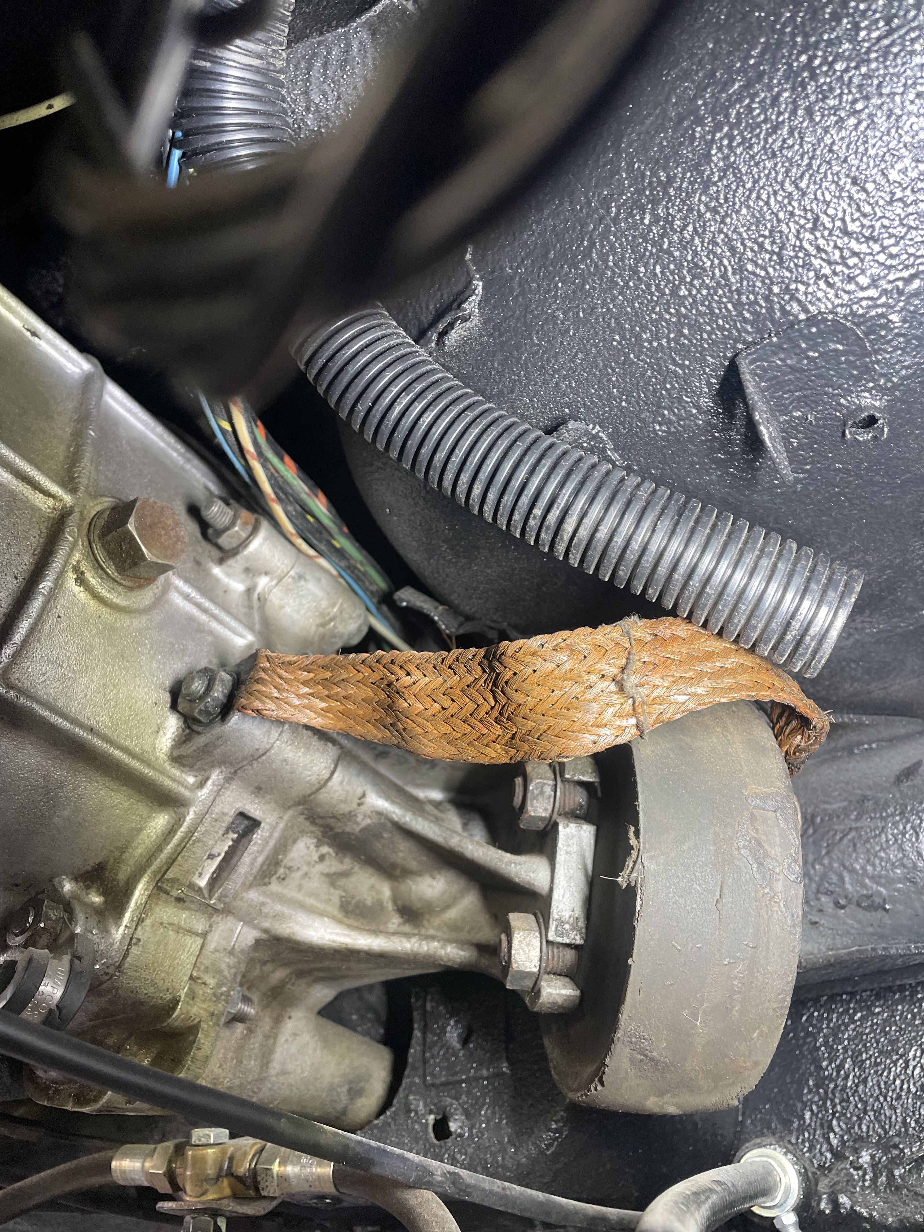

              Did the Happy Dance today. After pulling the aft half of the wire harness, back up into the tunnel. We were able to finally get a good inspection on the wires and the damage done by Boob. I can fix most of it. Then we installed the (+) battery cable today. It was not fun at all but we got it. 3/0 or 35mm2 cable is not easy. This is usually the first wire you put back in after blasting. I used welding cable with a rubber jacket. It is softer than the original PVC, and has a larger friction point, but will do better than the OEM. Y&Z wanted twice what it cost to make one, and I have extra length fo male it fit the starter better for future work Boob did not for some reason. But we found all he wires, now it just remove all the splices, spade used for splices and extra wires. Not sure about the Red 10Ga that feeds the fuse box, that was cut up by the conduit. Needs to be replaced also. There would have been serious lighting issues the way it was. I have a full set of Greg Bryant’s wiring diagrams, having a windshield size color diagram is a life saver.

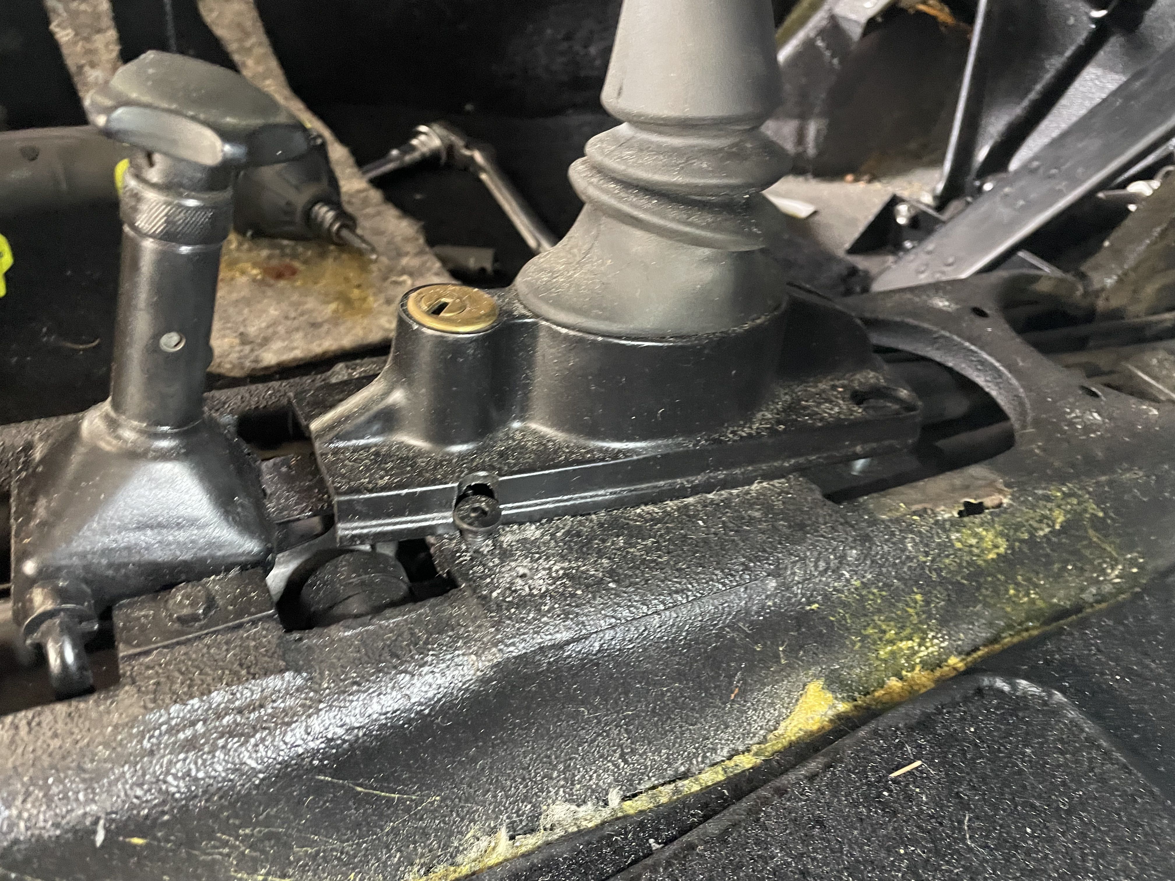

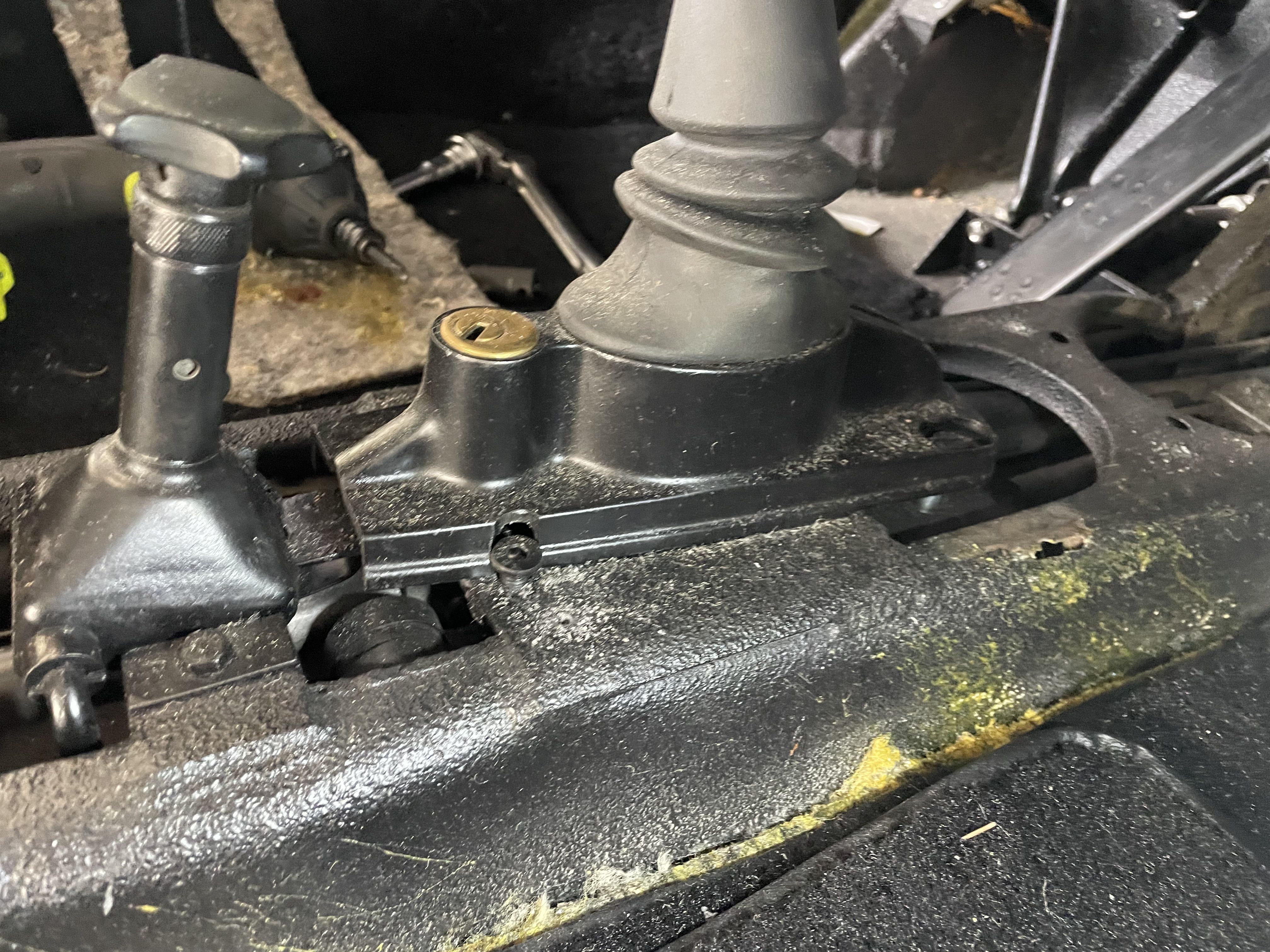

              Have not figured out the shifter mod, took a T-5 pedestal and cut off 4” off the rear, then used some stupid counter sunk screws to pinch it into place, the nose of the transmission was changed to a T-5 piece pipe with a 911 swivel. It looks like the did that after the trans was in since the tunnel was split and notched. To get the pipe in. Boob must know Mickey Mouse.

                At least they didn't hack up the original tunnel mounts. Are you keeping this shifter or going back to the early style?
