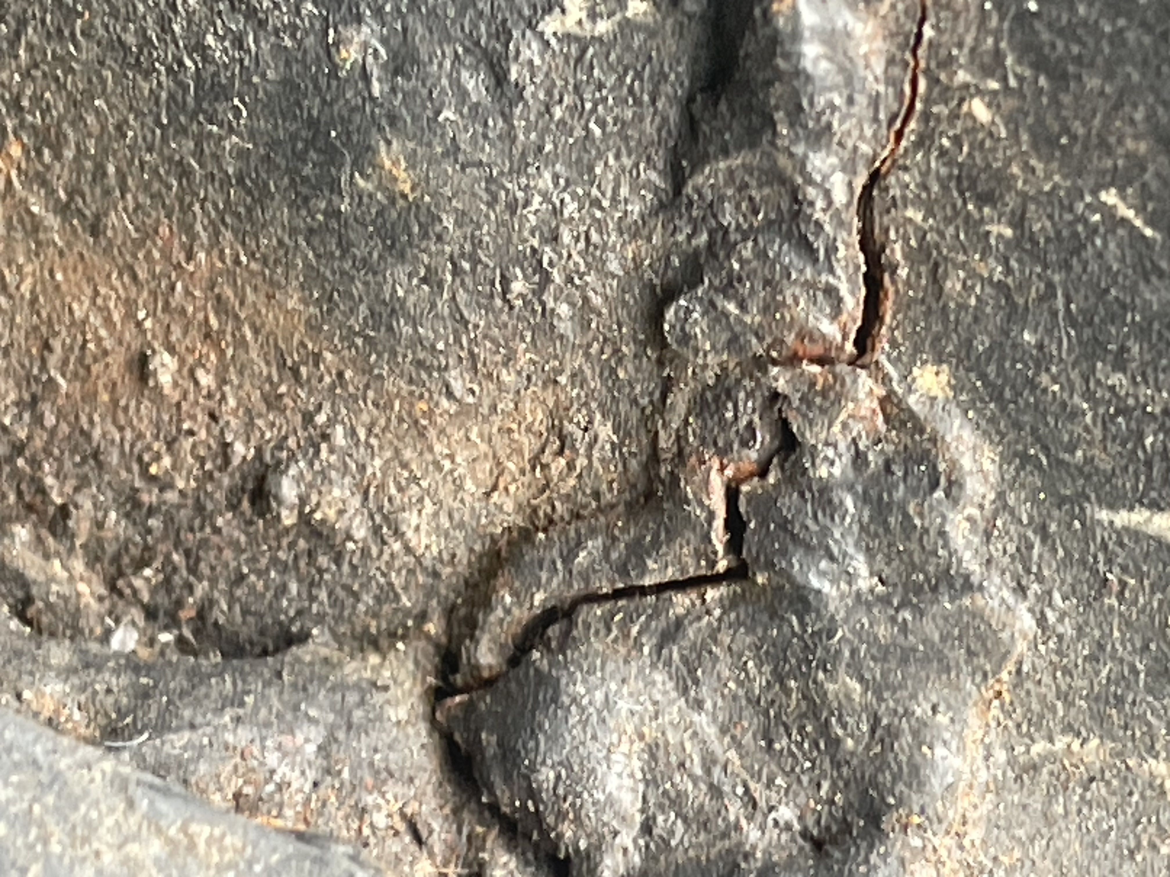

    but overall this is going to be a nice car, the metal work is fine, it has truck bed liner everywhere to seal it up, paint looks OK, jts now mostly nit picking stuff.

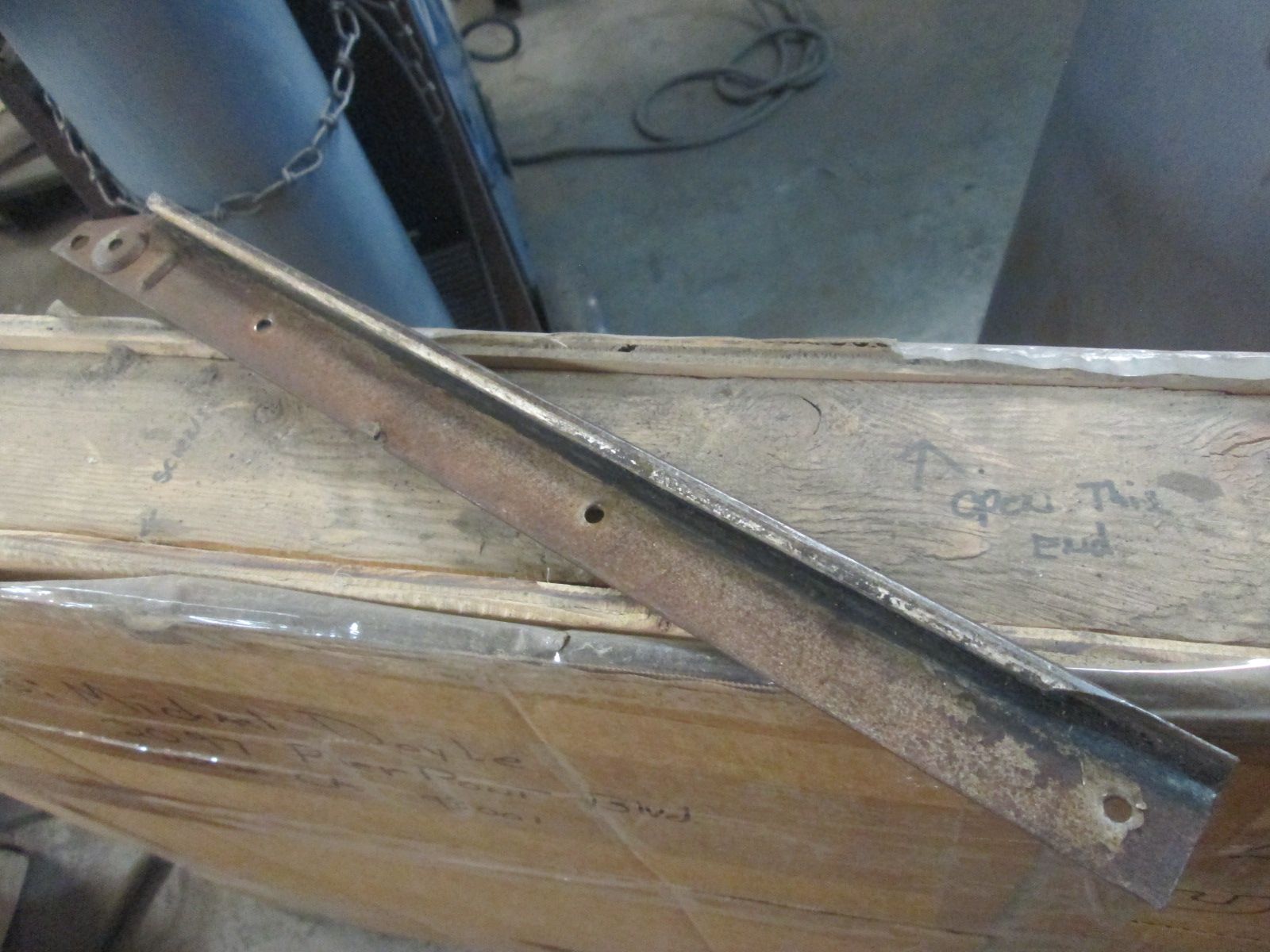

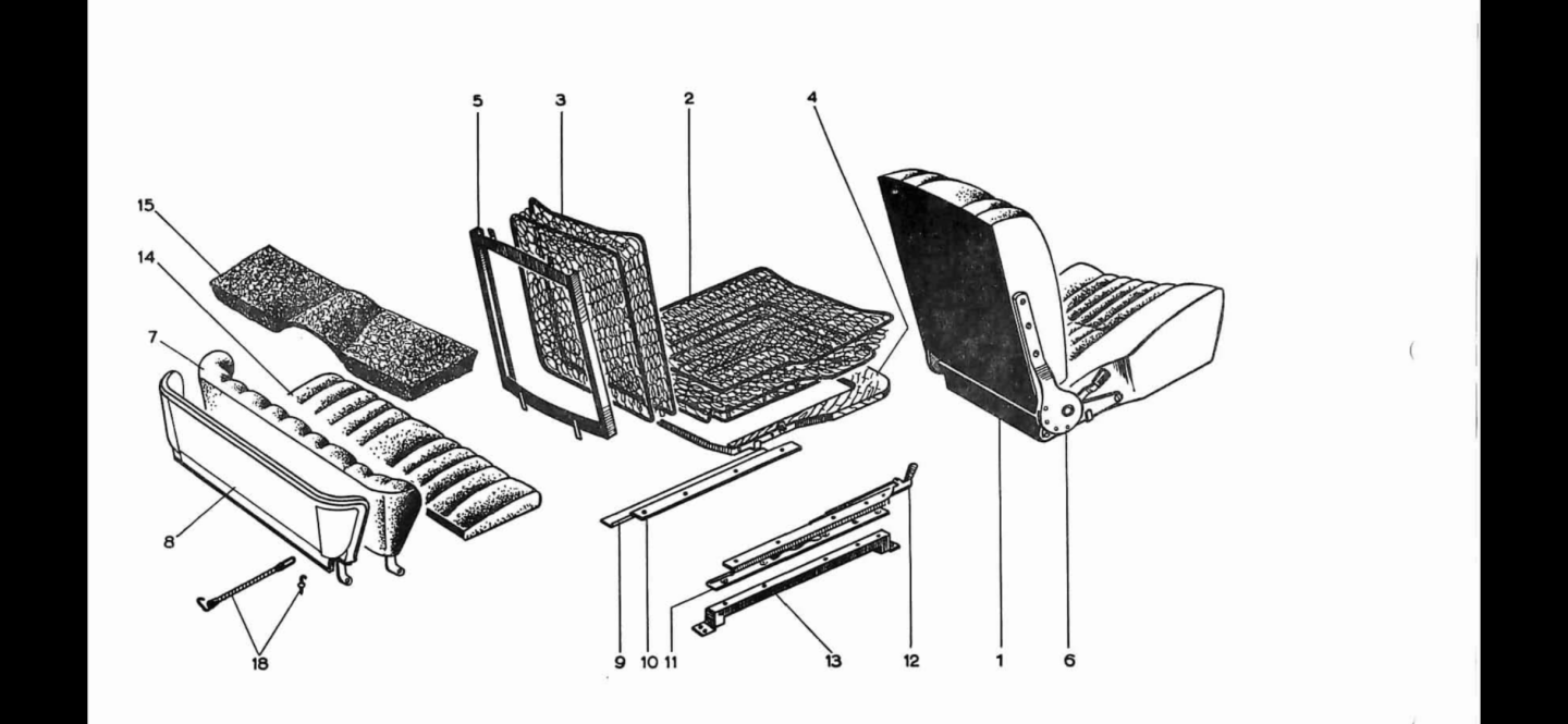

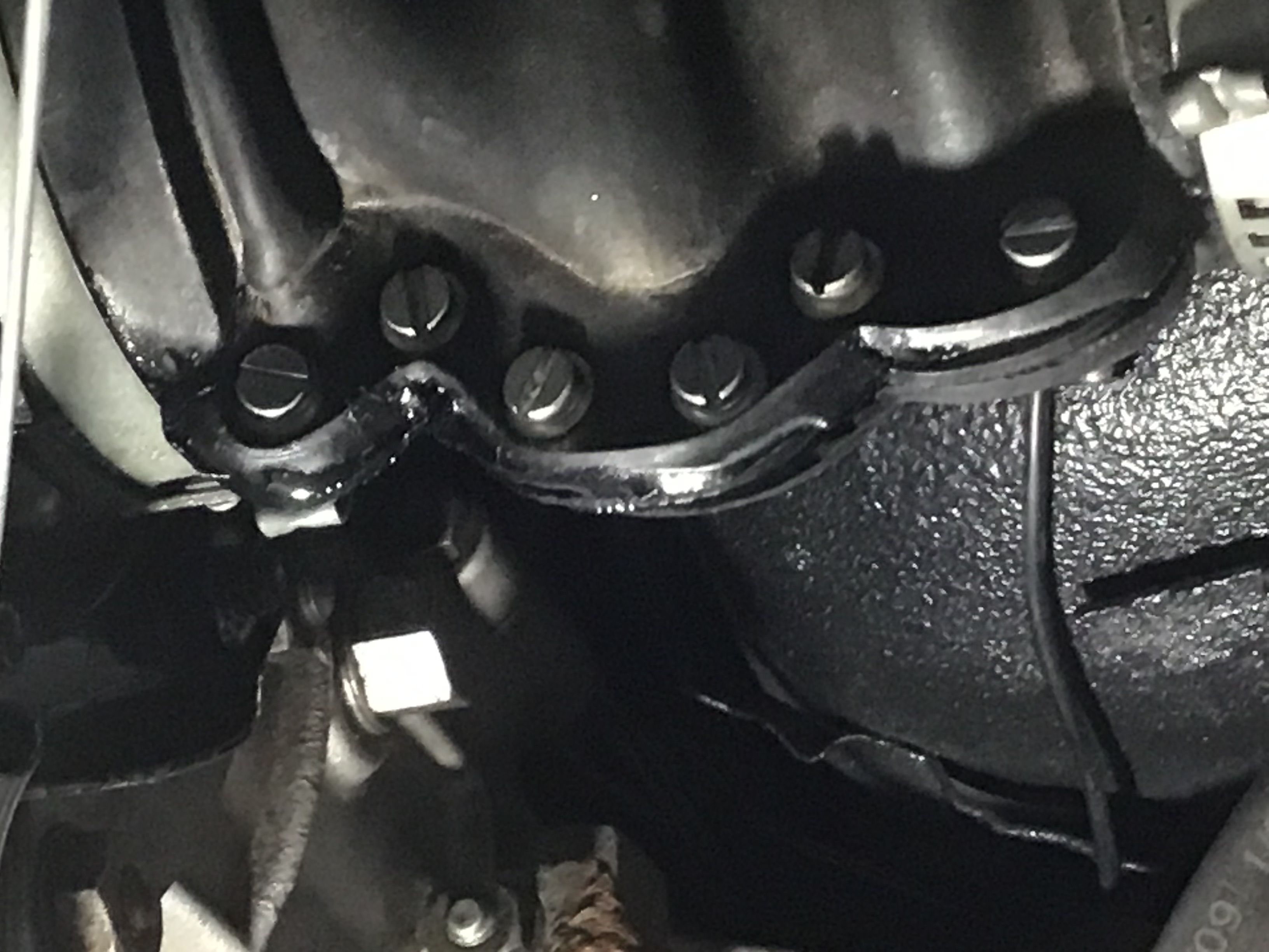

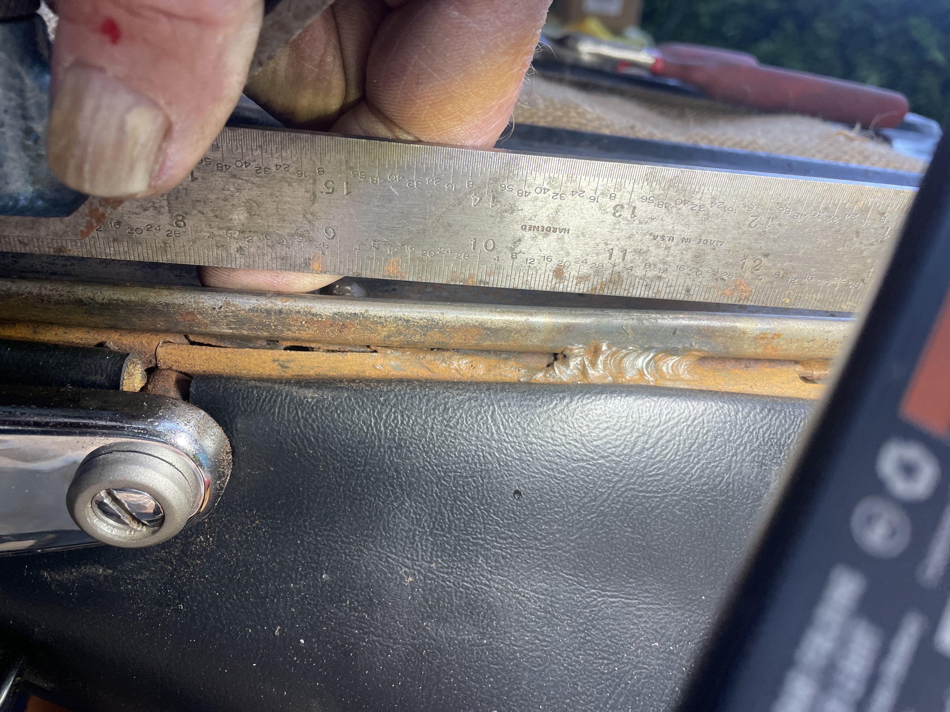

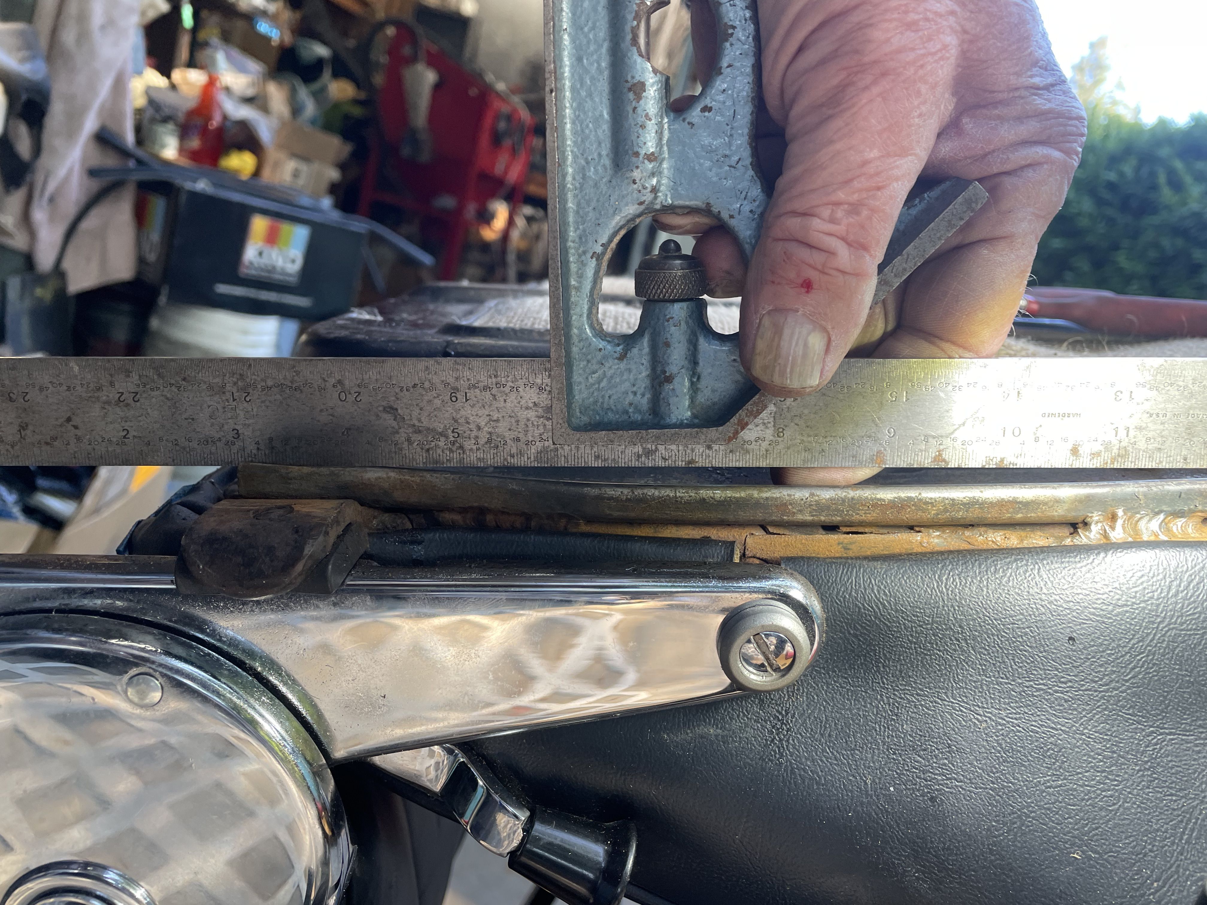

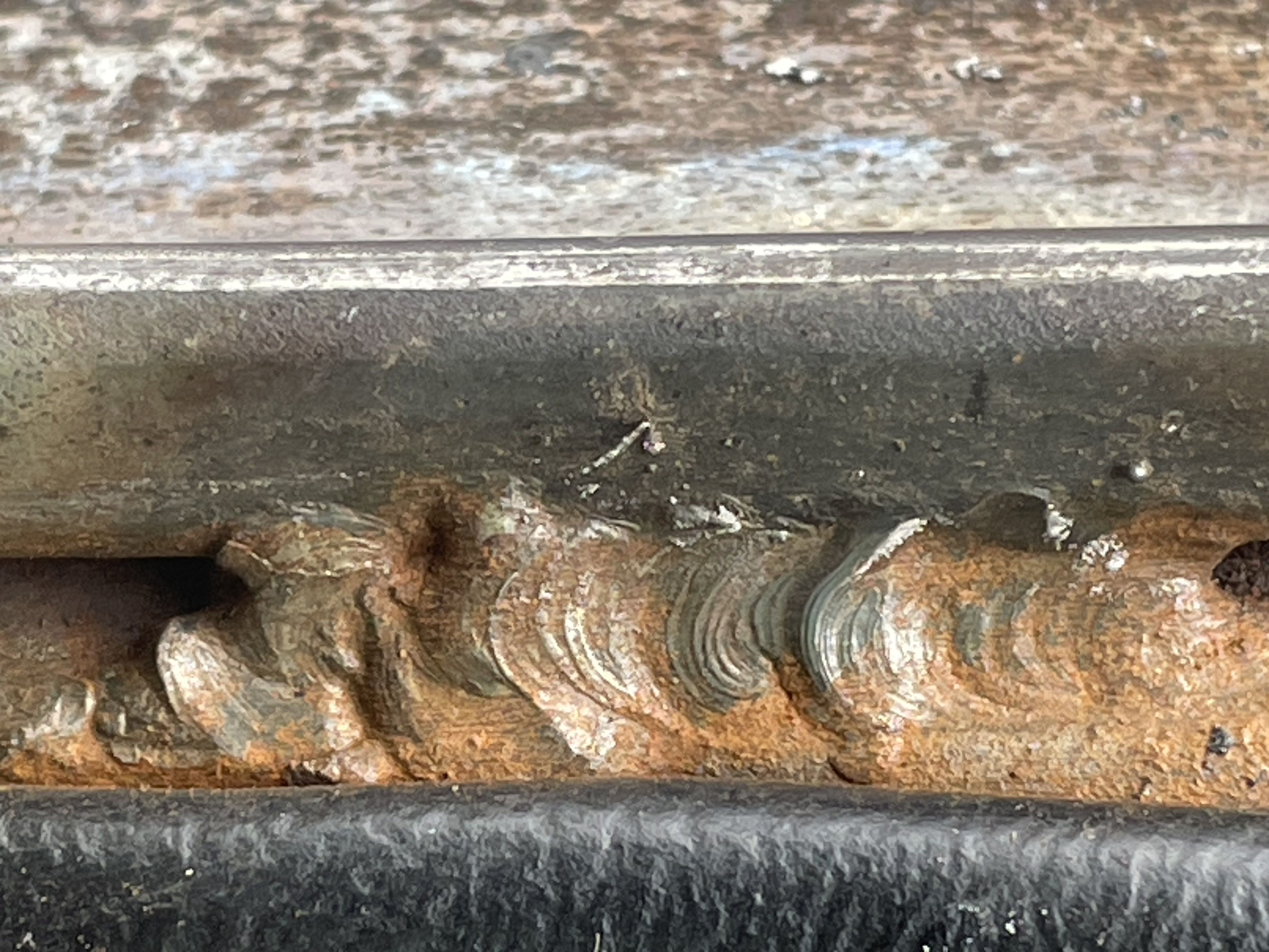

      Seat adjustment, drivers seat rail is bent like a rainbow( item 10). Someone has welded it to the pan, and the rear warped it. The pan is in poor condition with lots of flex and cracks. I got some of the bend out. I can get the seat back 5-6” now. It will work for now but I am looking for a T-1, T-2 or T-5 seat pan or a seat bottom. I found a drivers rail but holding out for a pan. Push come to shove I can drill out the rivets and replace the bent seat rail. I could replace the rivets with rivnuts with a doubler inside. I really do not want to take a new recovered seat apart.
ID:	116804 Click image for larger version
ID:	116807 Click image for larger version
      u Click image for larger version
      I am looking for a new or better pan, or a complete bottom, or at least a new upper drivers rail for a. T-1, T-2, or early T-5. If you have one in you stash let me know. I could replace the rail but the pan needs allot of work. But at least I can get it it and my belt buckle does not rub the wheel.
        I might have a Rail for you John, I'll take a look. Amazing how people build or assemble things thinking that its going to work properly in the end.

ID:	116817 Hey John, I have this good core drivers side upper if you're still in need. It has the plain mounting holes which are correct for the steel pan version which it was riveted to. Switching over the adjustment handle is very easy and straight forward as you probably already know.... Justin

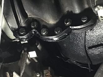

        thanks I have a replacement rail. I have the seal slider 3/4 back now, good for now, we will do the pan next winter, I need to get this little girl home.

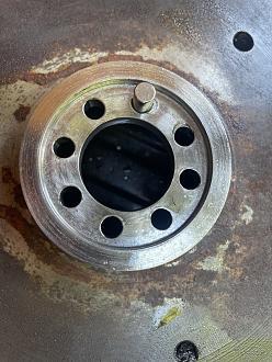

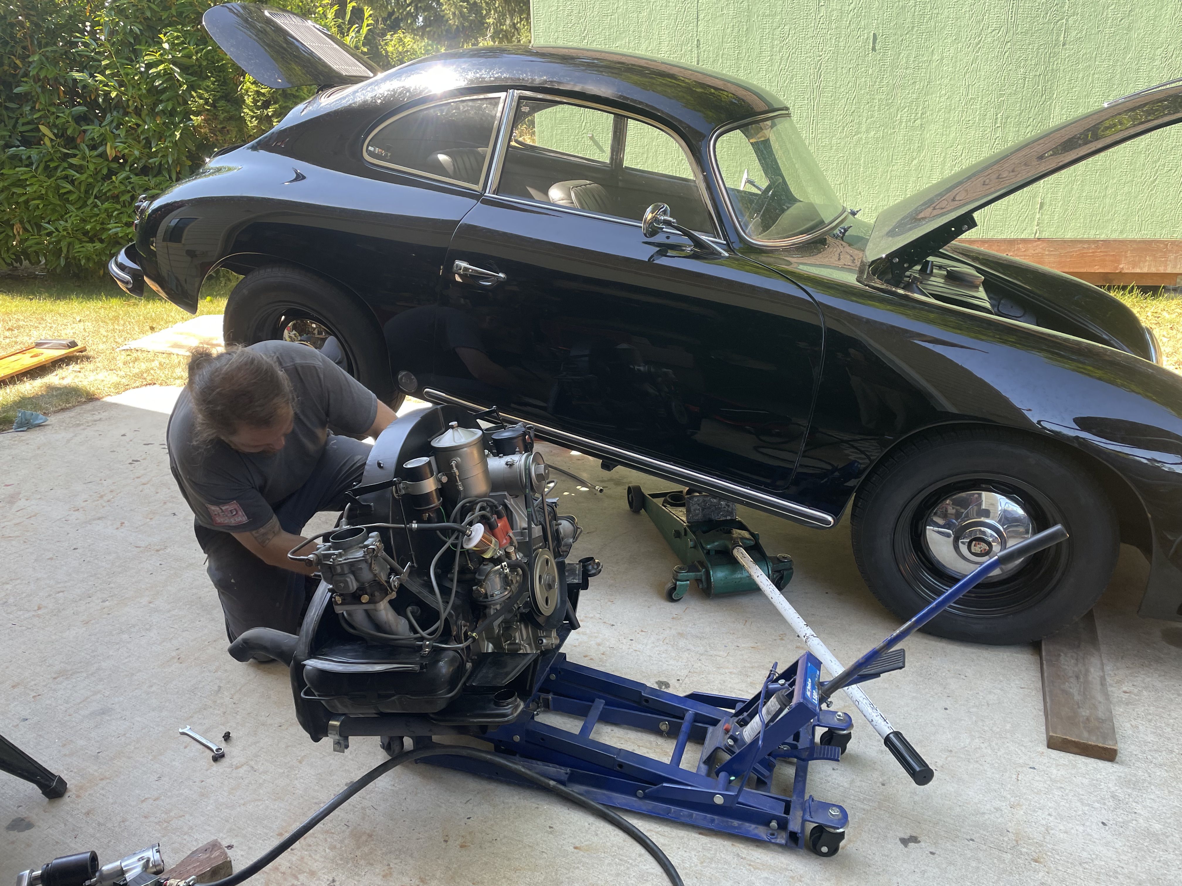

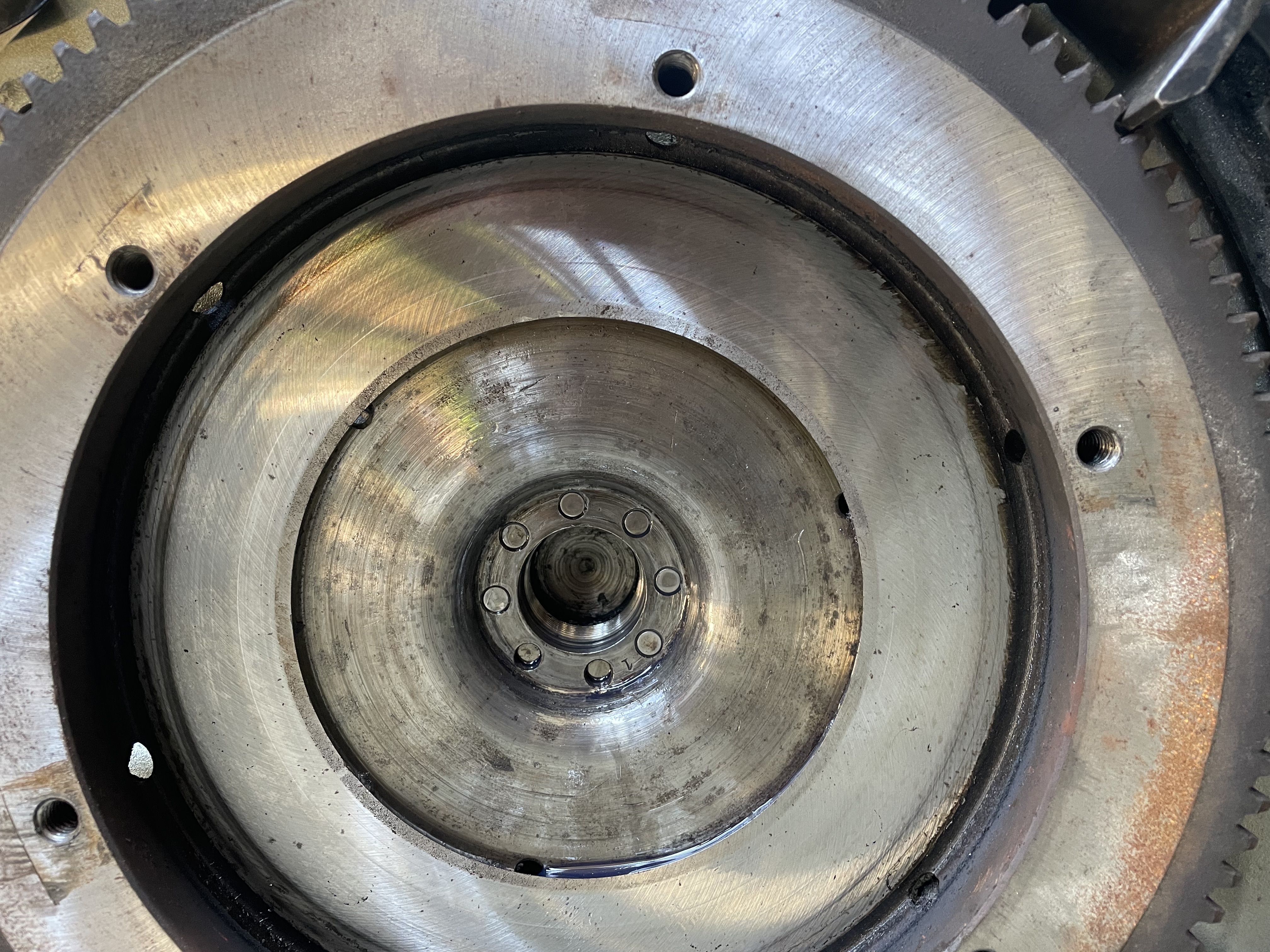

        Bigger fish in the pan, started having a flywheel seal leak. So I pulled the engine to fix it. Had to pull the muffler since it a T-1. The we find out the Nerff bars were designed in such a way the Mufler will not come out with them installed. Two steps forward one back. Note the double reflectors, Boob mounted the originals to the bumper for some reason and left the original holes open.

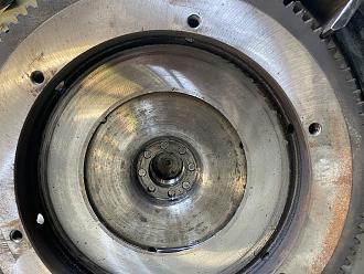

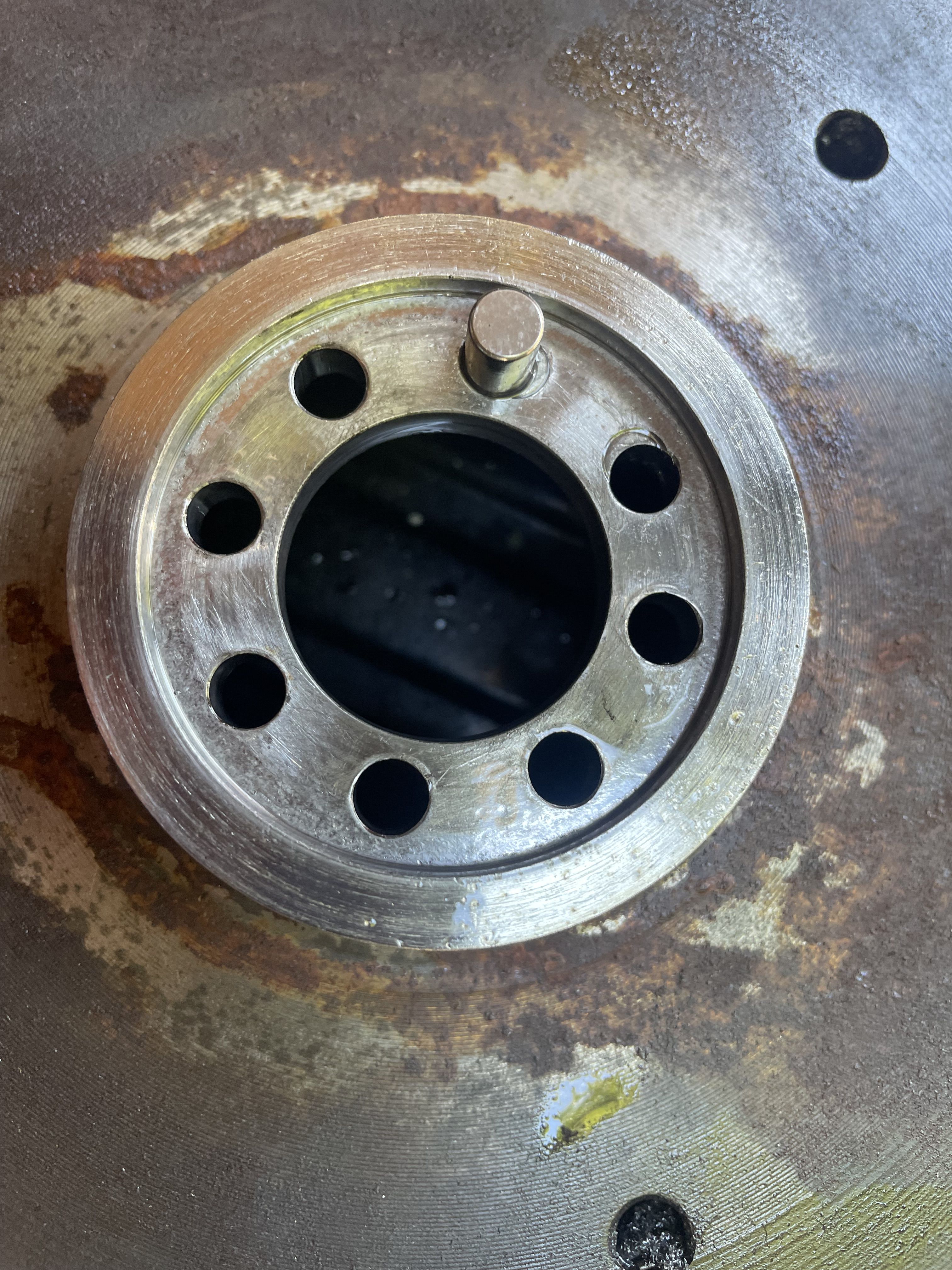

        Then we got engine out, I go to look at the crankshaft end play, I grab the flywheel it’s got 6-8mm movement, my heart sinks, then when I go to remove the gland nut, it’s hand tight. Yes put the socket on the nut and remove it by hand. Then pull off the flywheel and it’s missing two of the dowel pins. My god, Boob did some stupid stuff during his “full restoration” but this is ridiculous. I guess since he did not know about the two close pins he could not get the flywheel to align, so he removed a couple pins, then did not torque the gland nut. There is a witness mark on a couple holes where the pins were not aligned then the nut was tightened. One pin was stuck in the flywheel, but it aligned fine into the crank. But the holes in the crank and flywheel look OK not oval from too much sloppy fit up. So a new iron crush seal, couple dowels from the stash and fresh crank seal it back together.
ID:	116830 Click image for larger version

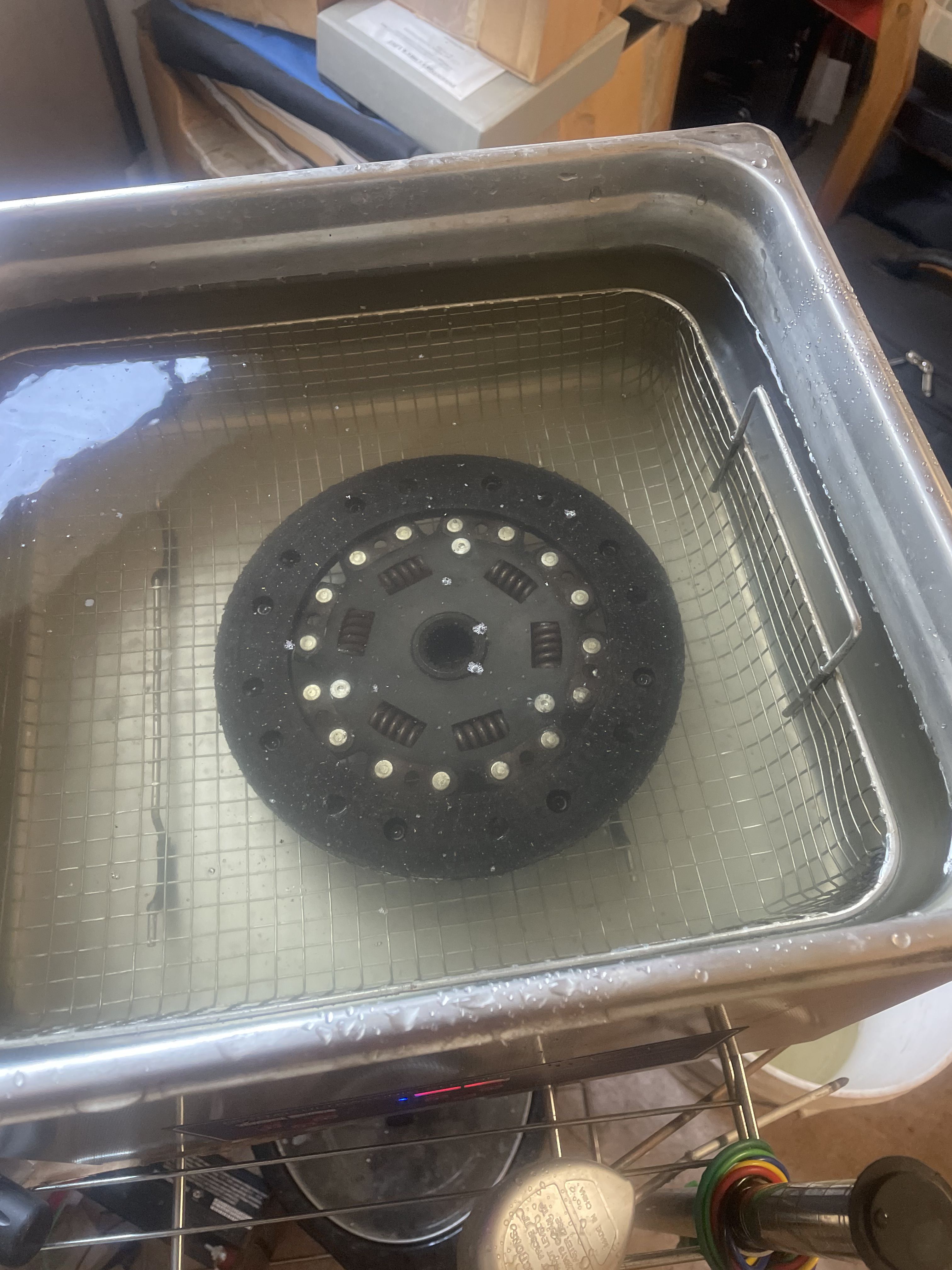

        Clutch disc was a little oily, but right at 8.2mm thick with no runout, so it is in tolerance, so into the ultrasonic cleaner to remove the oil and we’re back together. Going back as soon as I figure out how to remove the valve covers since it looks like Boob used JB Weld instead of gaskets.

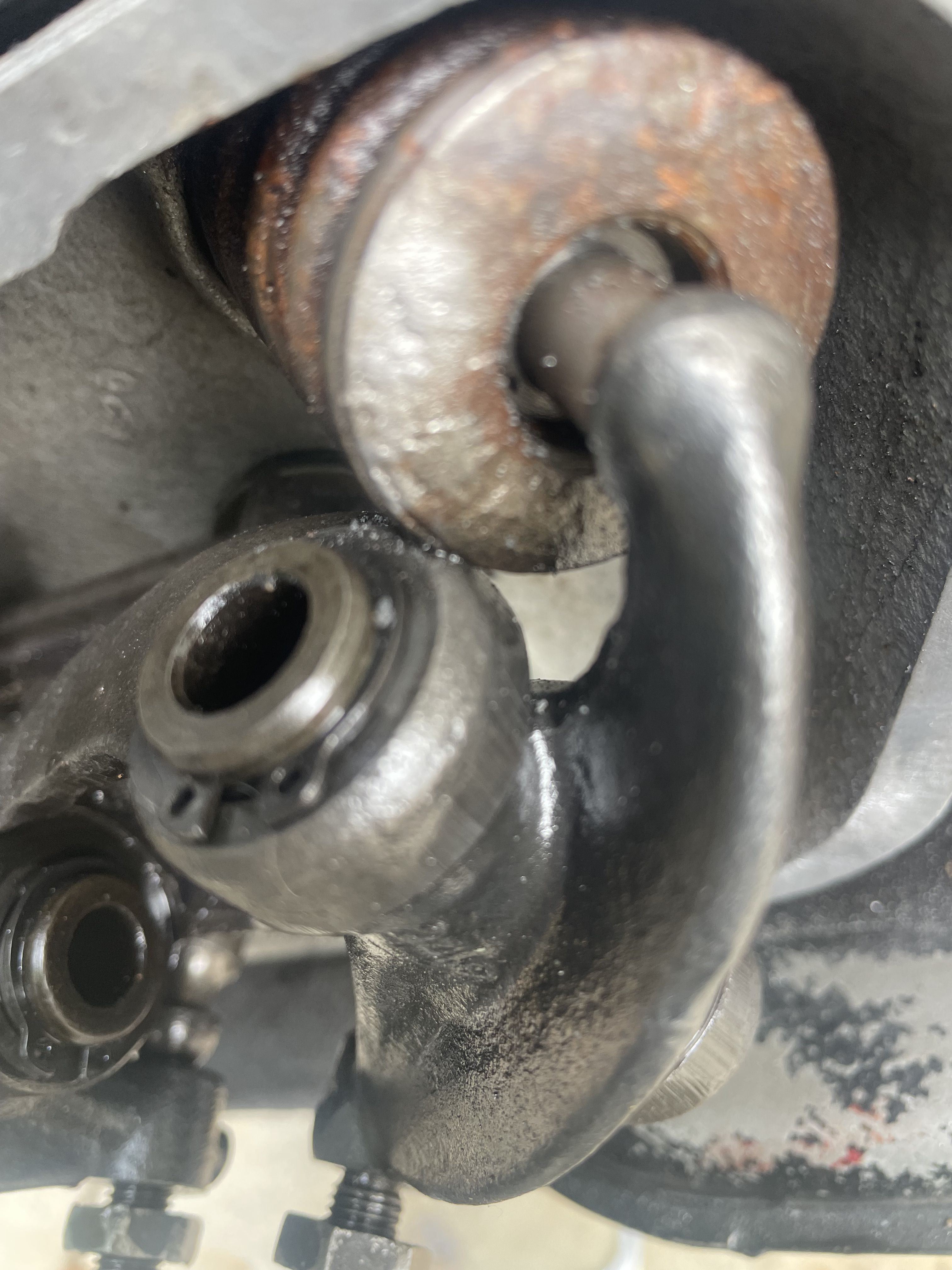

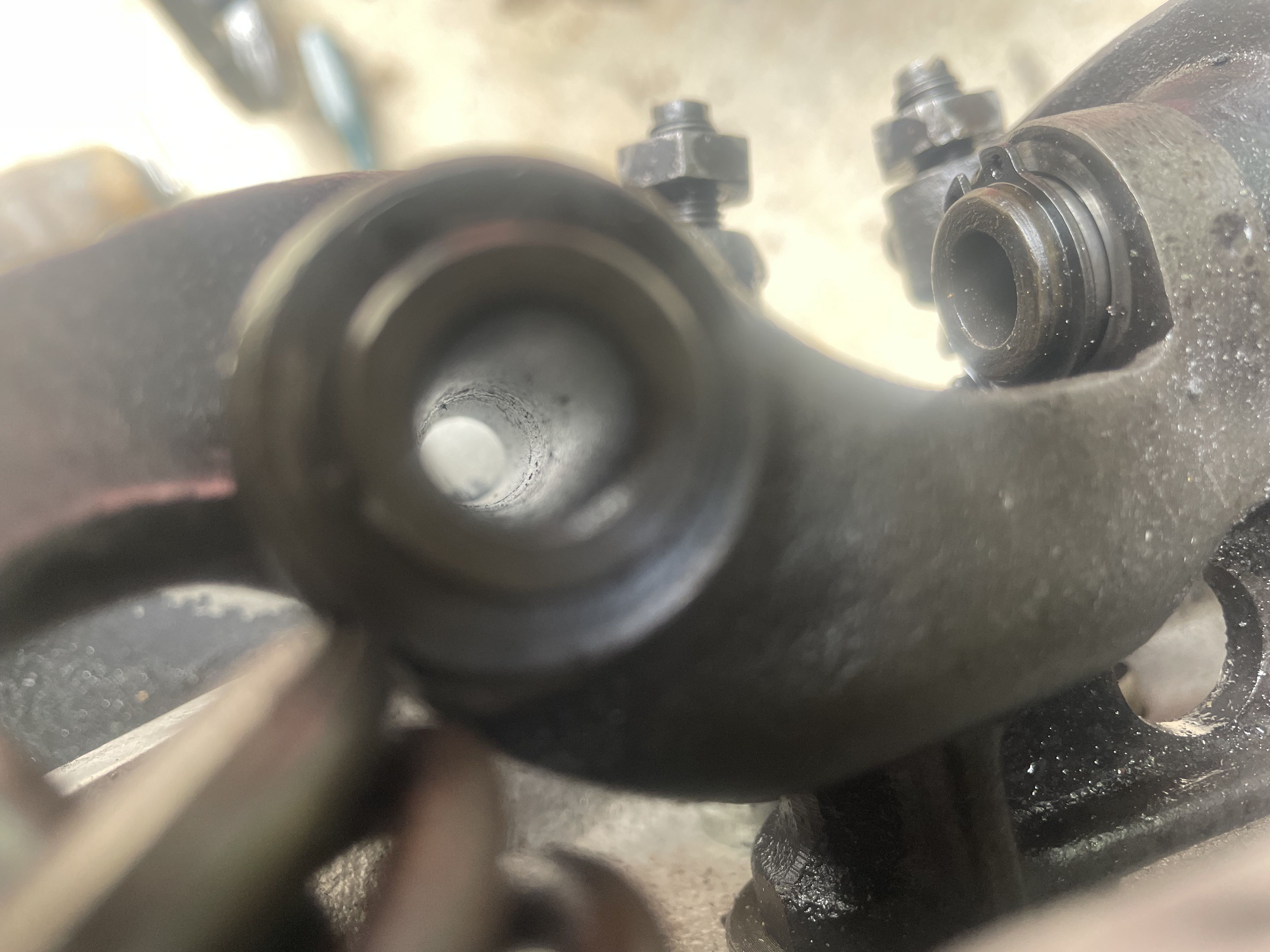

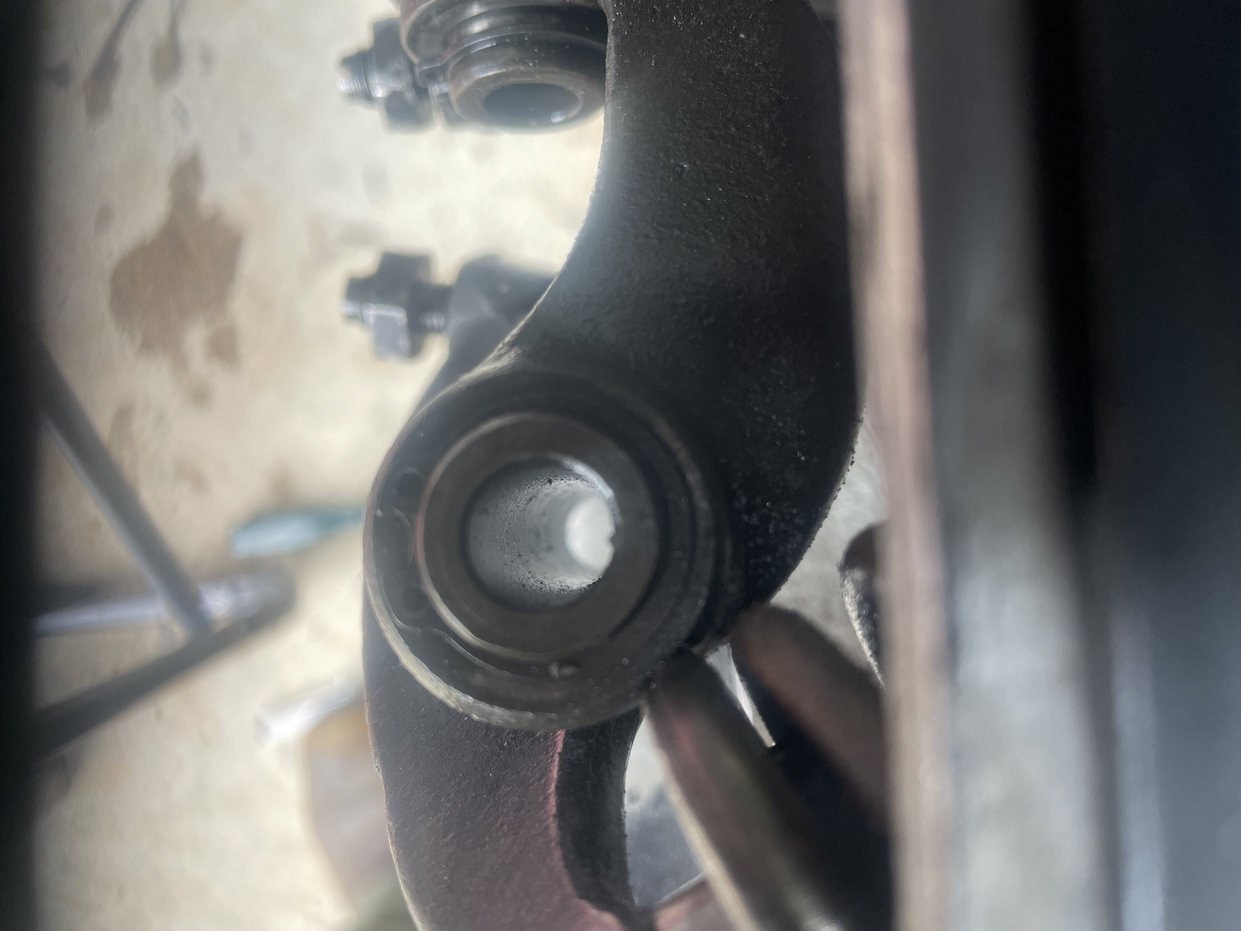

          While adjusting the valves, found #4 exhaust was very tight, and the adjuster was all the way in. Looks like the valve seat is receding or it had a previous hatchet valve job. We started to pull the head. The valve spring was touching the rocker stand. The rocker are had a witness from the stem cap.. I went to the book to look for tolerances, spring hight was ok. After an hour of discussion with my minion, I decided to do a “10,000 mile” fix, vise what would turn into another few weeks overhaul on this motor. I used a couple kin pin shims and moved the rocker stand out .060. The shim will shift the geometry on the rocker stand, give me some clearance between the valve cap and the stand. It seems to work. But only .008-.010 clearance’, but it does not touch anymore, and I picked up 3/4 of valve adjuster screw, adjusted fine after the shim. We will check next tune up, it it’s a receding valve seat, the next adjustment will show us if was not a bad previous valve job. Since the compression and leak down test were good, the valve is sealing. The fix should good for a while.

          So the valves are adjusted, tune up complete, motor is back in, heater cables adjusted, looks good. Finally looked at the engine numbers, turns out it’s a 616/15 case with matching half’s. New 3 piece, different 3 digit and no serial number, with early A heads, and Zenith32’s . A “FRKENMOTOR”.

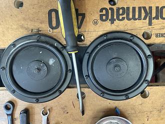

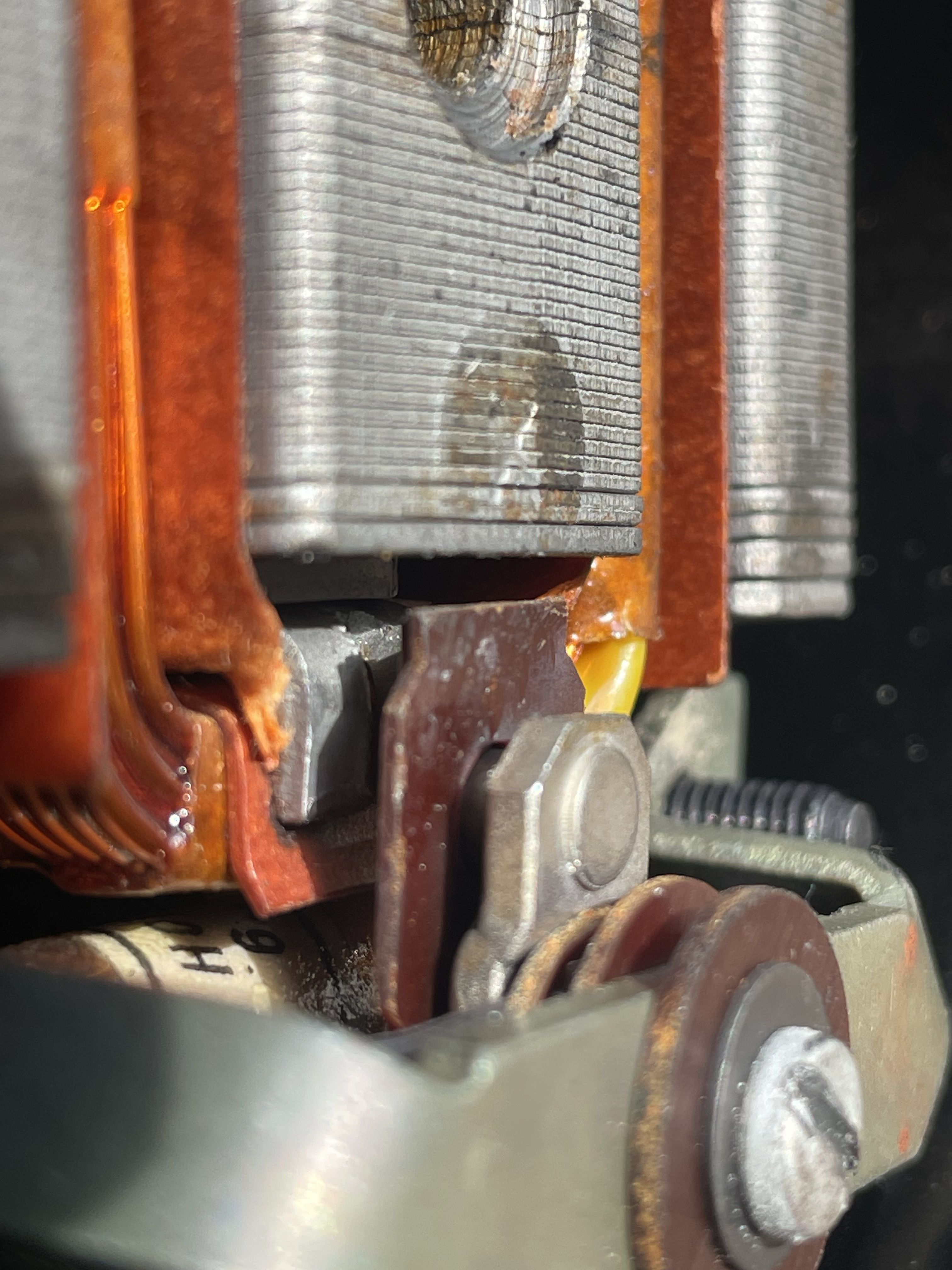

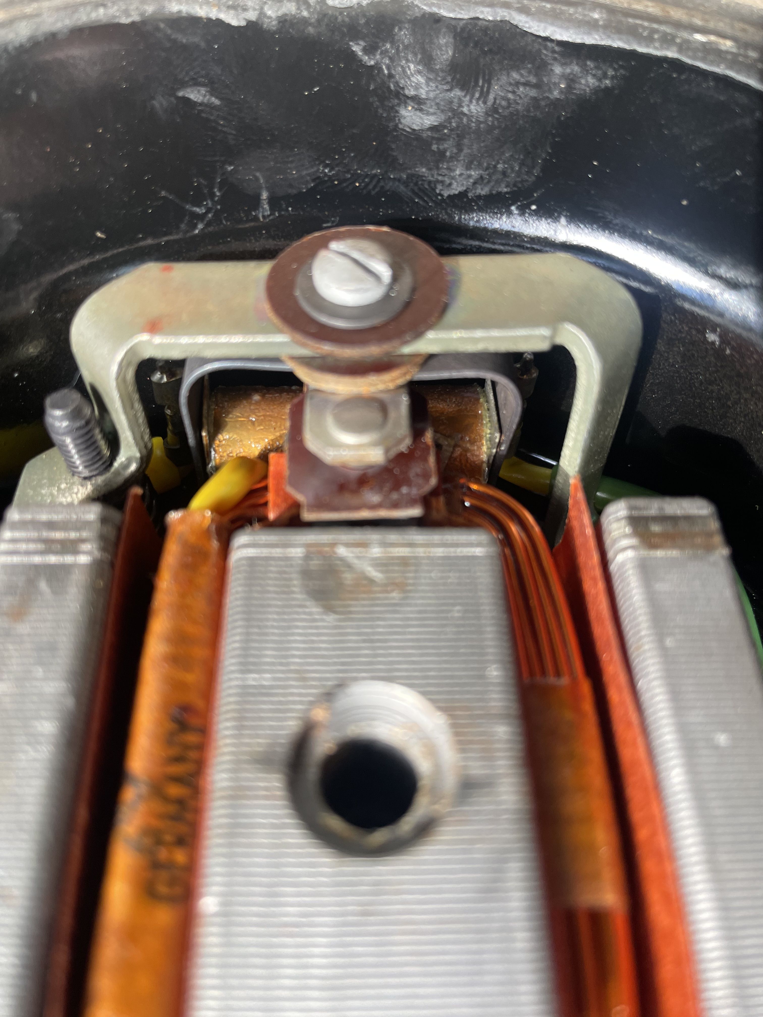

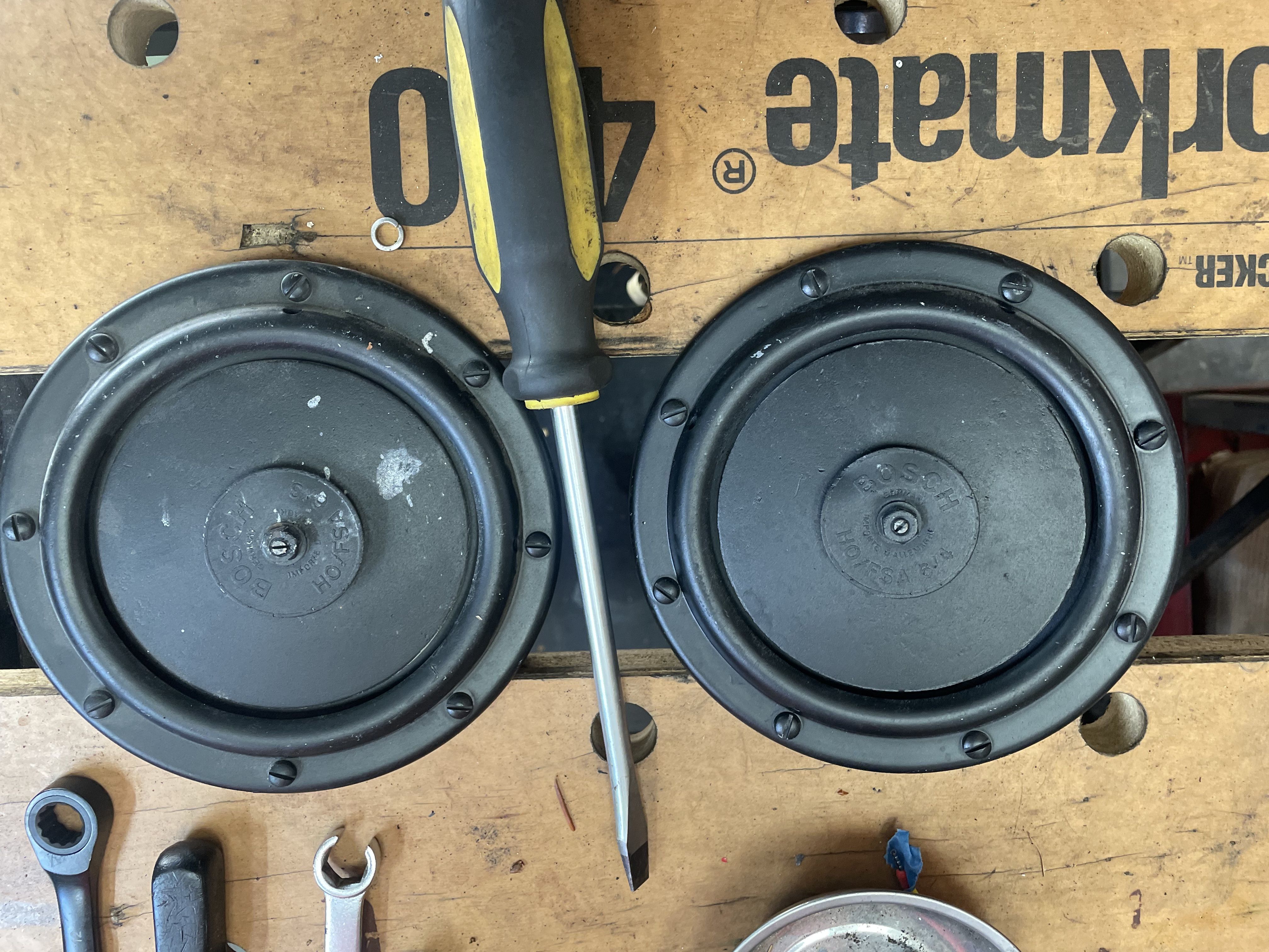

                  Horn day today, my last circuit. Rebuilt one horn and tuned the tone on the other, and the relay was stuck open, I removed the cover and the coil needed to be resoldered. The bad horn was just not opening the points, a little 400 grit and 5-6 turns on the adjuster worked. The bottom of the points as a small tab, that is struck by the laminated steel attached to the horn face diaphragm when pulled in by the electro magnet . That opens the points in the circuit, horn face springs back out, points close. The bad horn would not open the points. This tab needs to be .006- .008 higher than the magnet base. There is a small screw in the back to adjust this hight, and the tone of the horn. The screw has creations that you can feel and count little clicks as you turn it. I used a feeler gauge on the electromagnet to get it at .006, then added a couple clicks of more open to set the tone.
ID:	116863 Click image for larger version
                  There is a witness mark (round spot with X) where the upper block was striking the electro magnet, this was preventing the points from opening. The adjusting screw in seen in the bottom photos. ( Accessed from the back ). The big hole is a guide rod for the diaphragm block alignment, the block is pulled in by the electromagnetism flexes the diaphragm and opens the points. Just before it strikes the magnet it should open the points. It’s very sensitive maybe 1/2-3/4 of a turn between a clicker, the horn and dead. But using a feeler gauge to set the contact point of that brown tab and the top of the witness mark made it easy. The tab needs to be slightly proud of the magnet . After setting that hight reassemble the diaphragm apply power and the fine tune for the tone. Not as complicated as I expected.
                  So the “No Horn was just, no ground in the steering column to body, open relay coil, and closed points on the horns. We’re getting close now.

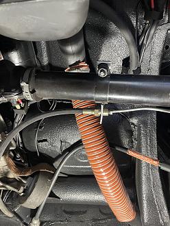

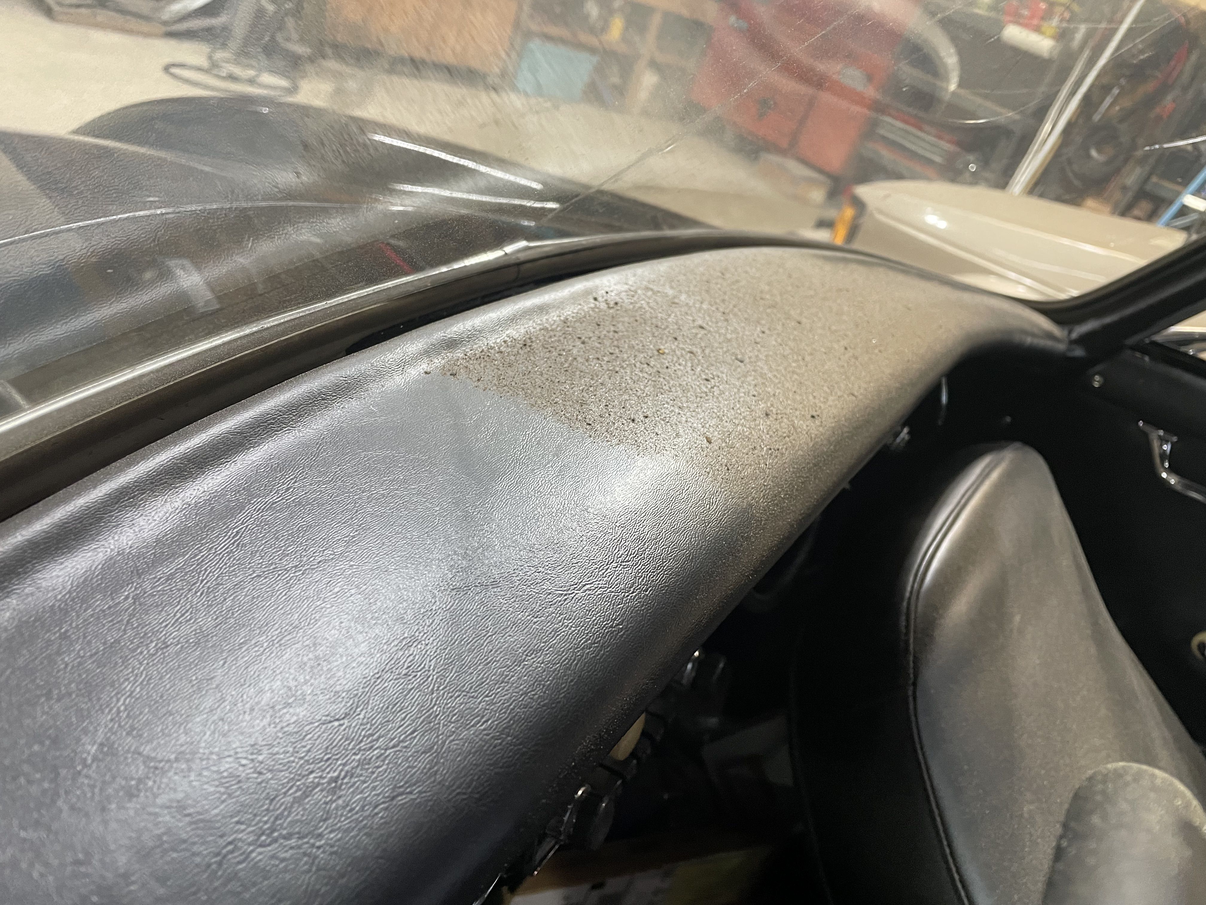

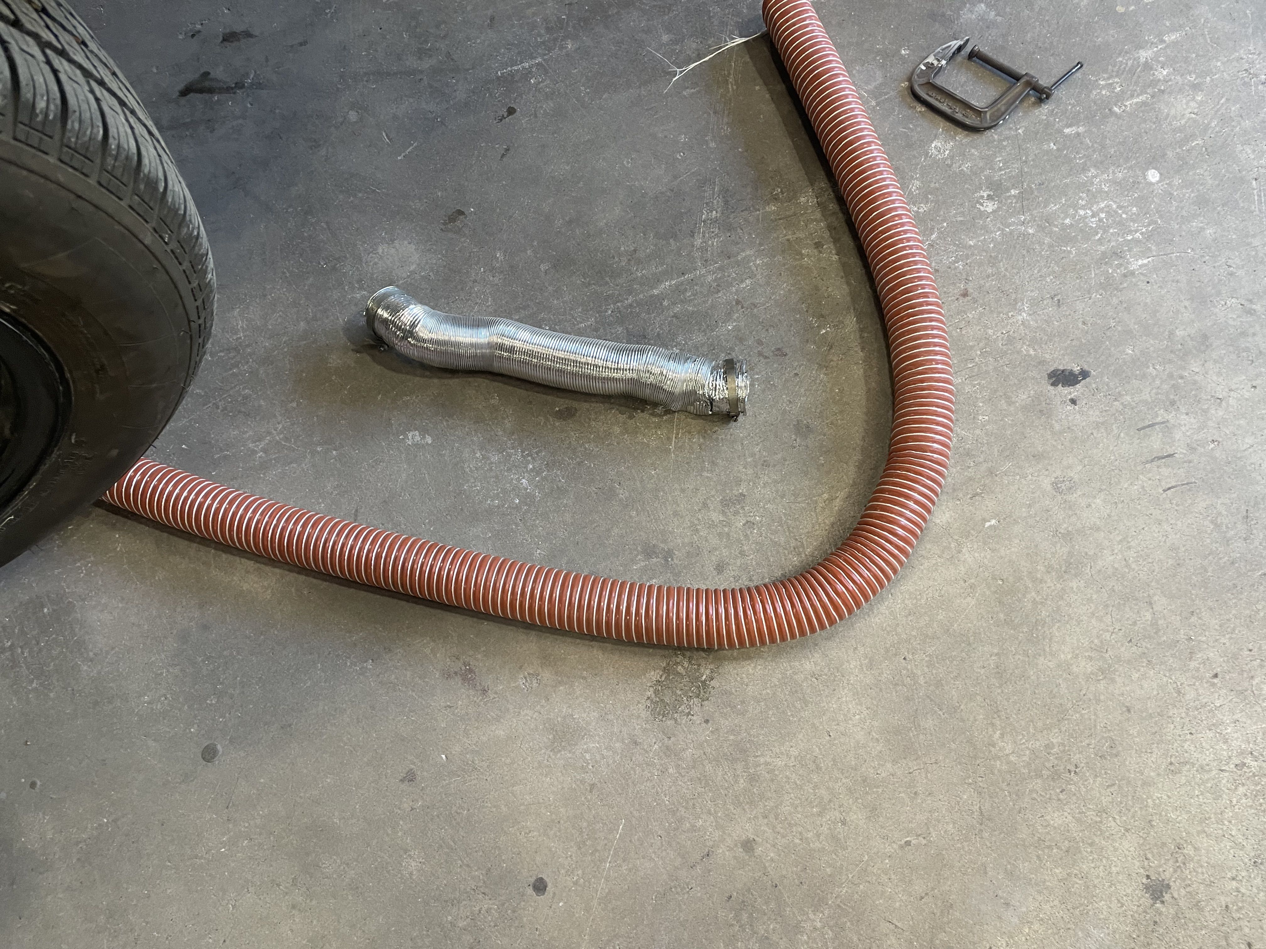

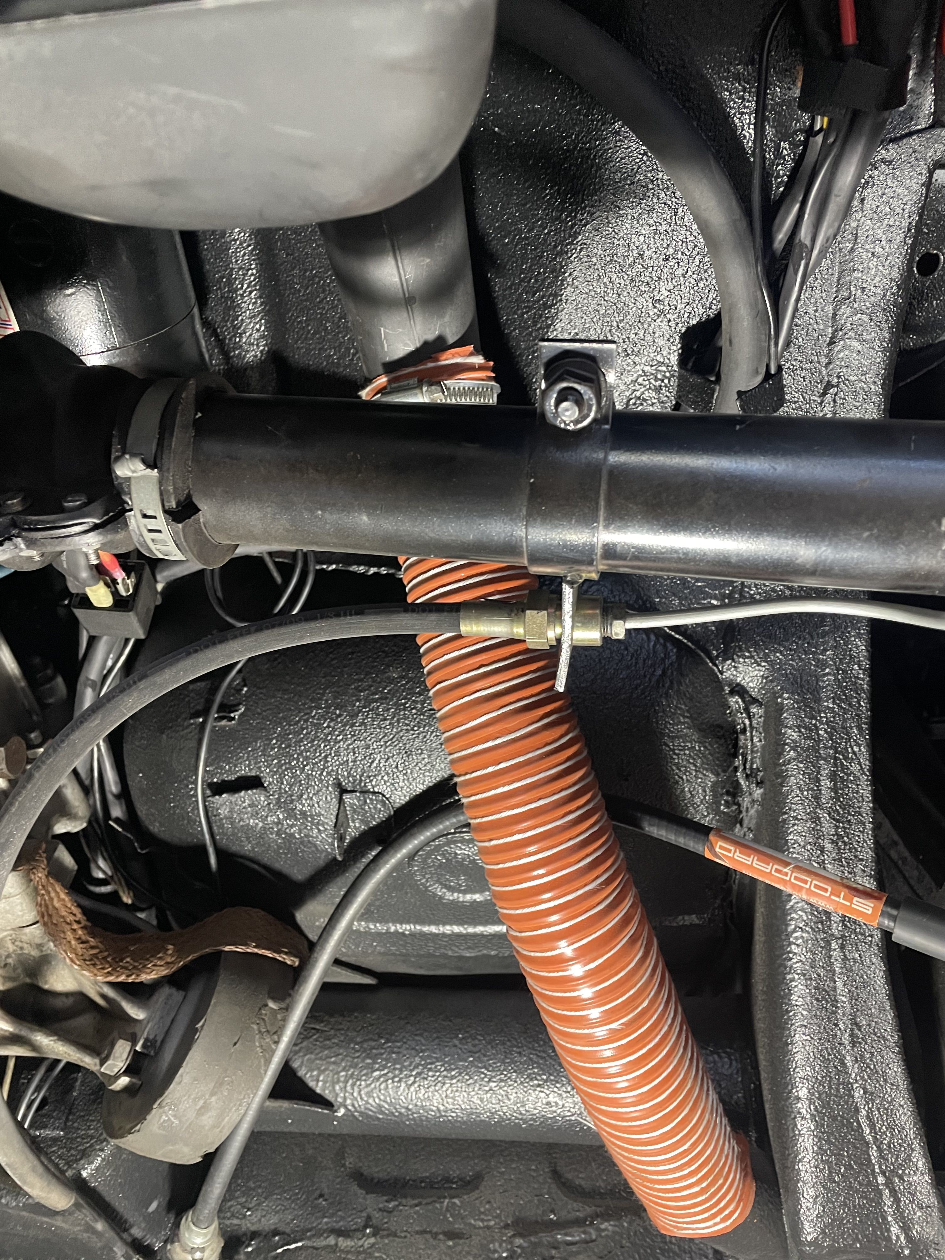

                  Every time I would get over 60 MPH the inside would cloud up like a Dust Storm. Eyes itch, the air looks brown inside. So we disconnected the heater hose, stuck a leaf blower in the longitudinal. Probably a cup of sand and rust flakes came out of the defroster vents. Quite a mess but vacuumed up.
ID:	116866 Click image for larger version

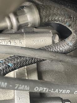

                  I replaced the aluminum dryer hose Boob used with a SCEET aircraft silicone duct, 2-1/4” PN 05-30609. ( red in photo 4 ). I get it from aircraft spruce, by the foot. I have been using this for over 30 years on the heater ducts. Far superior to the paper foil ducts. It come in all sizes from as small as 1/4” to 24”. It’s a slip fit and if you cut the pipe 4” longer than needed it does not need clamps. A wire spring prevents collapse, water proof and of course shock and oil resistant.
ID:	116868 Click image for larger version

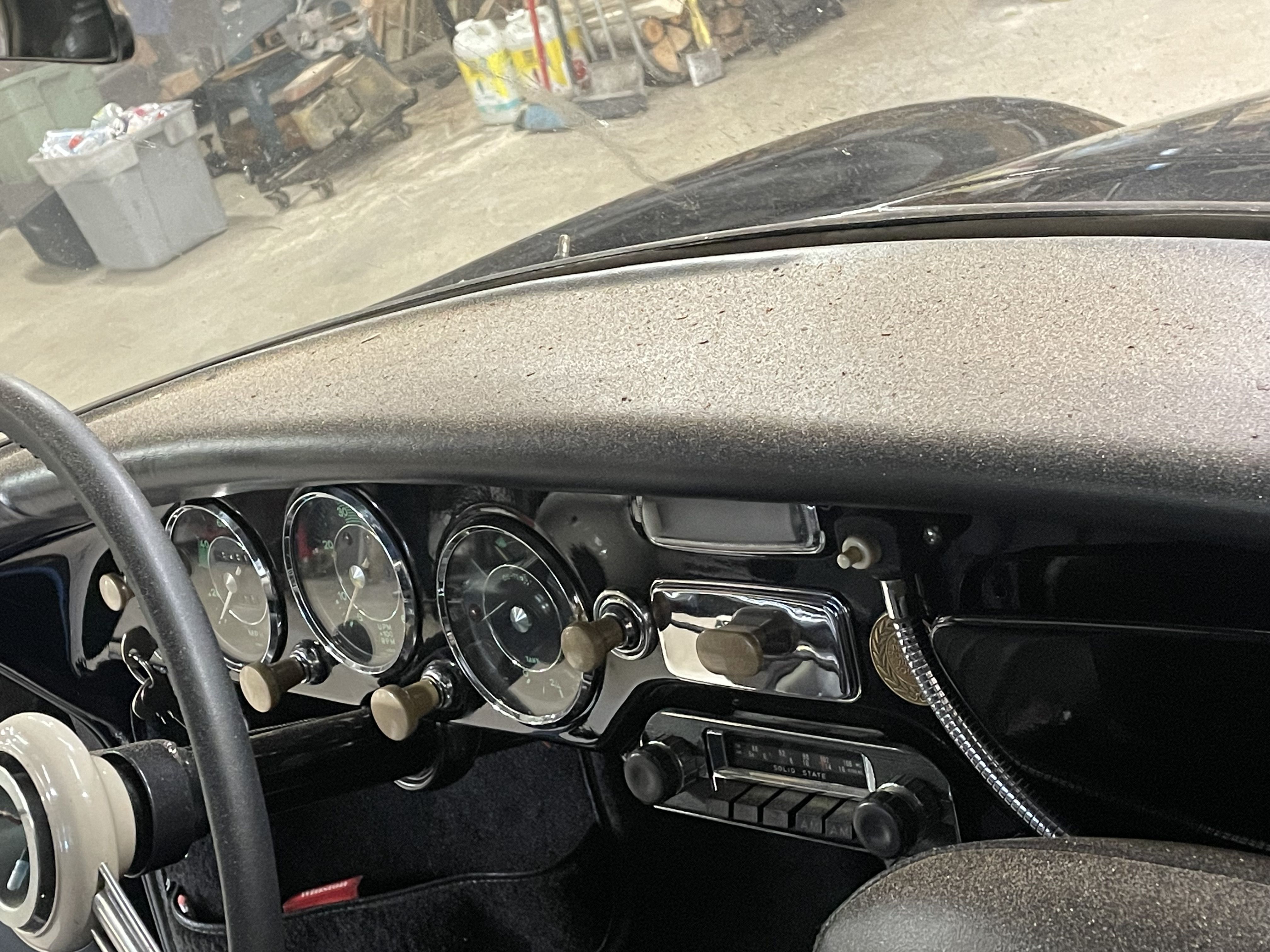

                  More “G-Boob what were you thinking” . Traced out the speaker wires down behind the carpet, crap no speakers. After getting all the horns rebuilt and working went to final install on the steering wheel, crap where is the Horn Ring? Not in any of the multi boxes of old parts. It’s been so long since I worked on a 356 A, I forgot it had one. Crap back we go to SMC to spend more money. Then the older style cup has a screw clip for the horn wire and micarta plastic insulators. New ones don't and use rubber washers for insulators. Speakers not too bad at least the size is standard.

                    yeah, one of the drawbacks of media blasting as there seems to be a never ending supply of it flying out from some dark corner. Interesting dash top, did they upholster directly to the metal without any padding? Keep up the great progress!

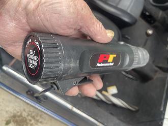

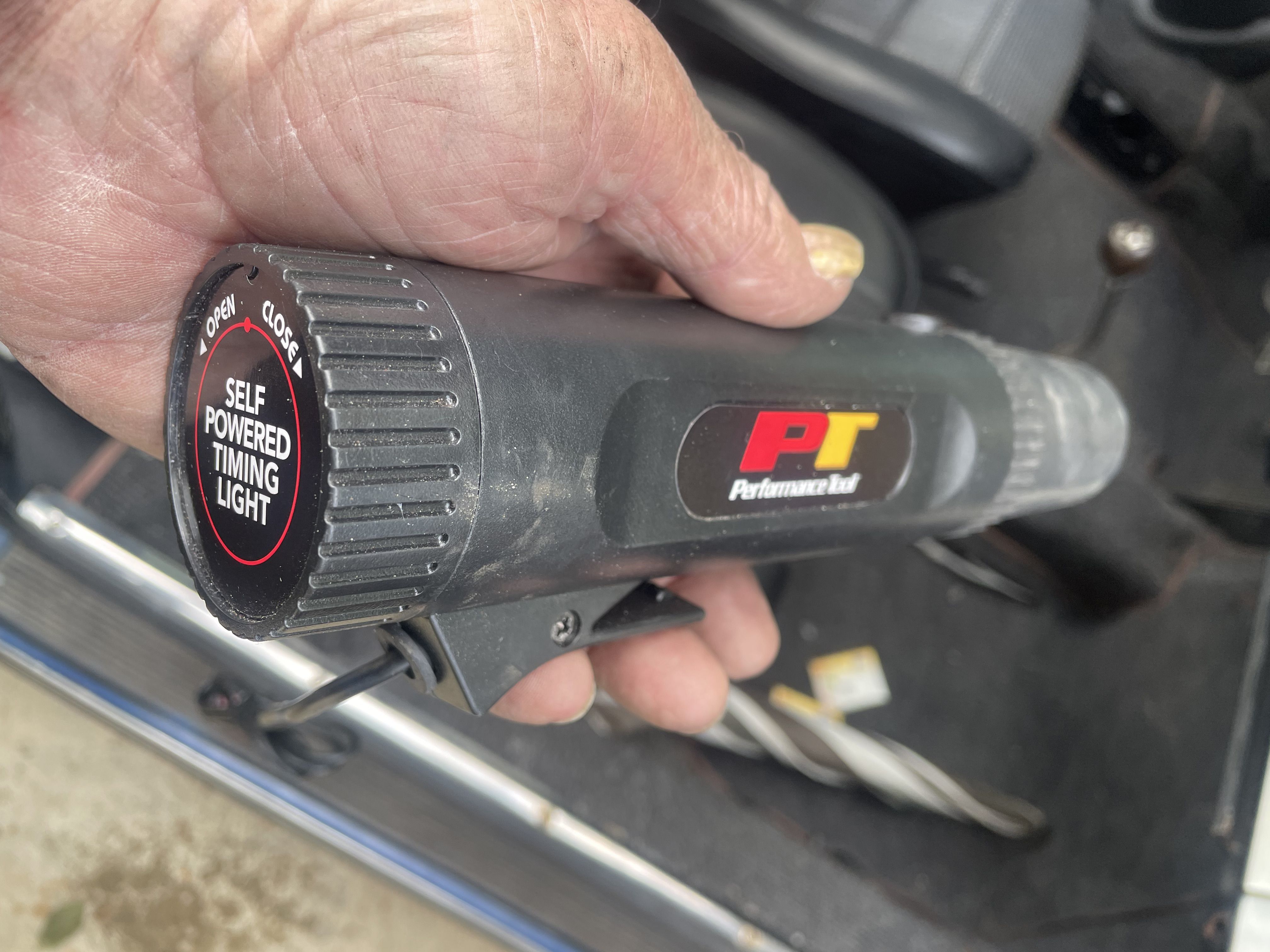

                  on a brighter note below is a battery powder timing light. It used 2 D cells, not the brightest I have seen but very handy in the parking lot or on the side of the road.

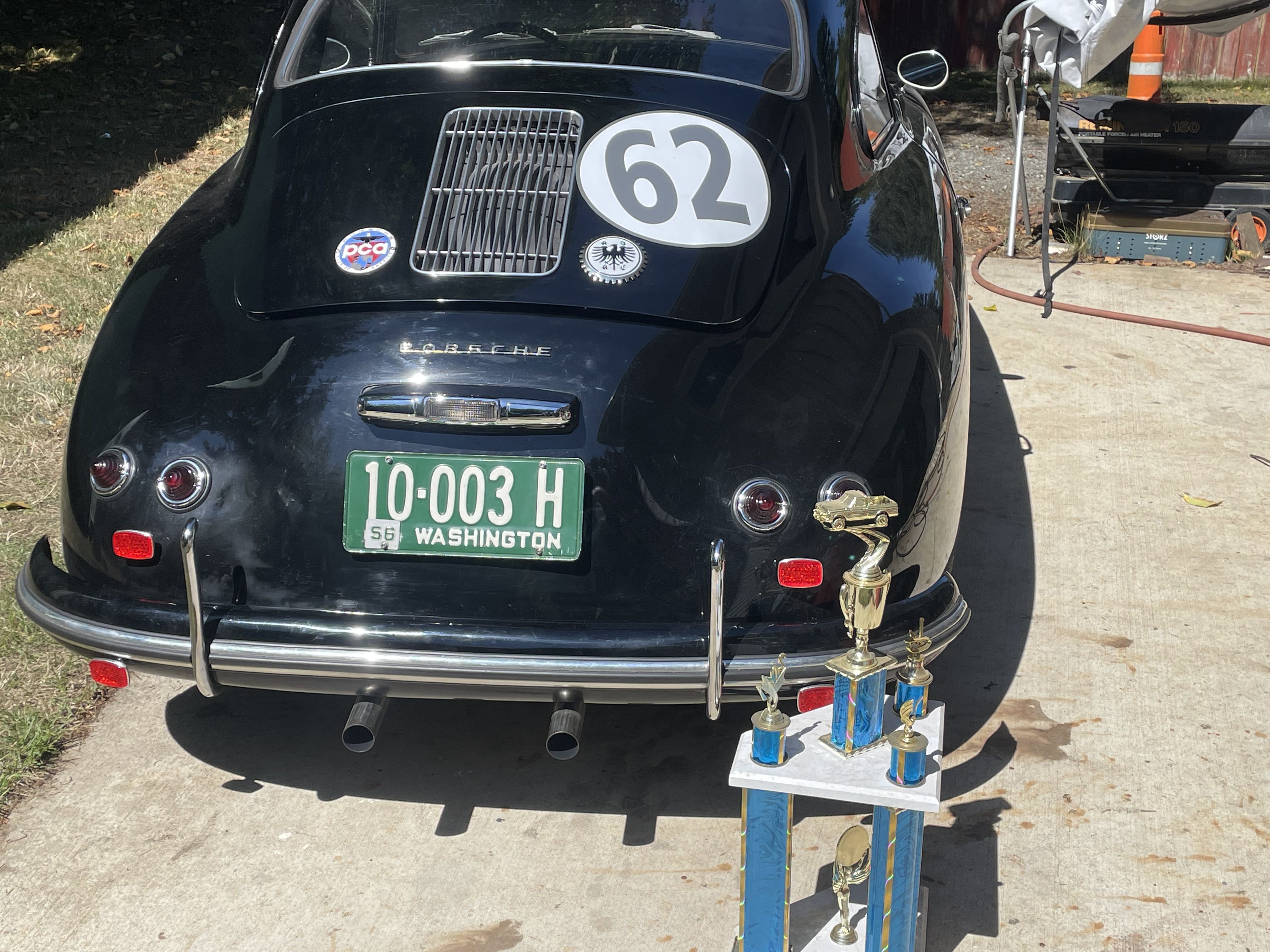

                  so after Four hard months we gave her a number and the “pain in the ass” trophy. And never let “Boob near your car.”.

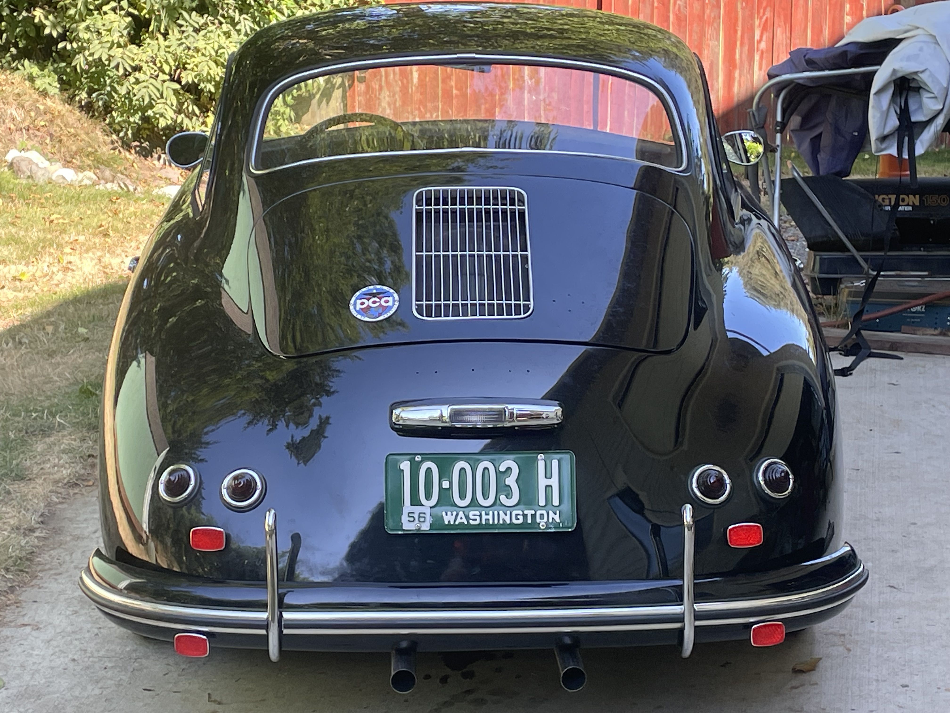

                    Well guys after four months, she’s done! Road worthy, solid driver looks good and it’s safe. I can’t believe how many critical defects Boob left on a 95% complete car. Stupid things like axel nuts or flywheel gland nut hand tight. All the front end steering bolts, the metal work and paint are typical, It does have urathane bed liner throughout instead of undercoat. So overhauled brakes, carbs, distributor, bad wires beyond comprehension. I think Boob is color blind, and all the wires were grey with a stripe. Starter and battery cable , spare tire & wheel. All the fluids and done.

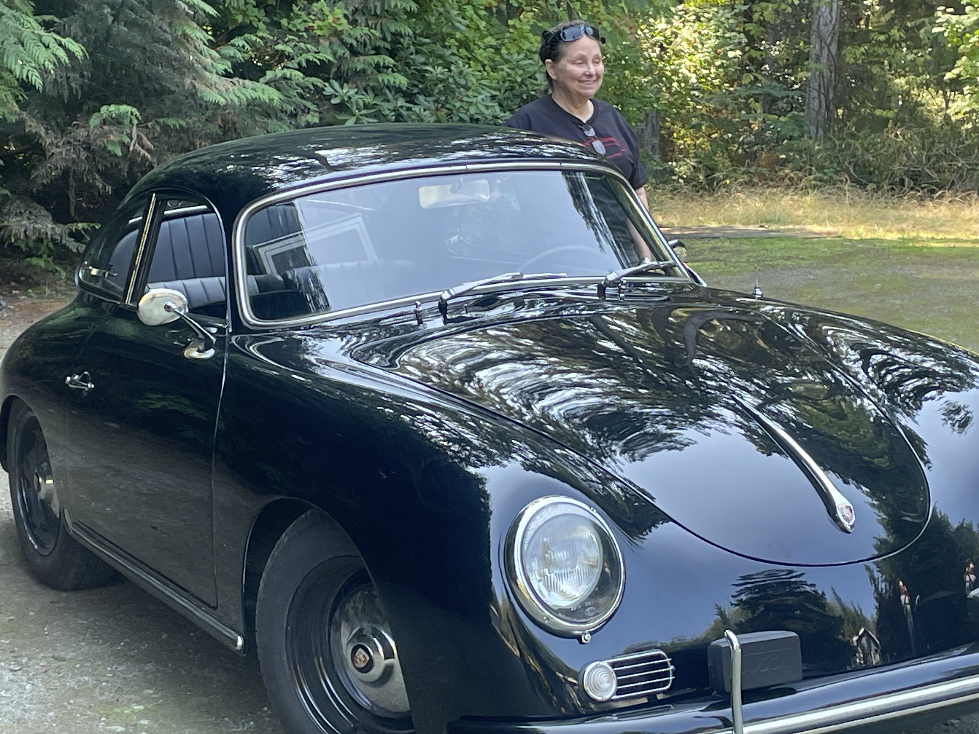

                        It’s gone finally. Celeste seems happy, she has to relearn how to drive it. We took a 10 mile test run, as soon as she remembers not to shift until 4-4500RPM she will be ok. But it’s done and gone home for a good bath, clay bar, and hand wax.

                          Congratulations on that John, you really had your work cut out for you. She is incredibly fortunate to have had you finishing this project for her, I'm sure she knows that. Anyway, the car looks great and from your accounts, runs and drives just as nice.
