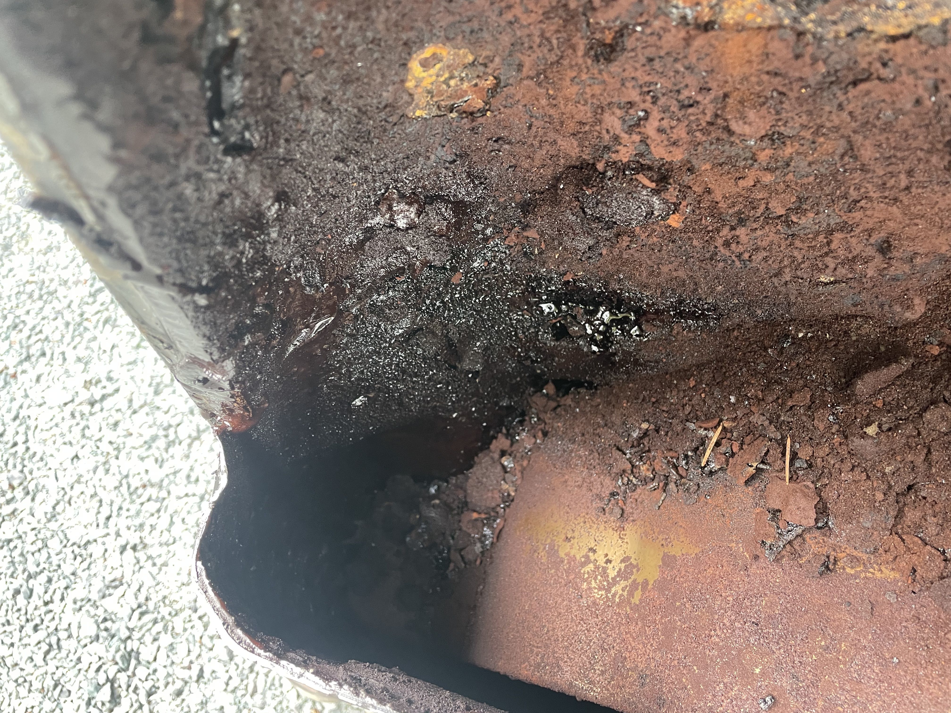

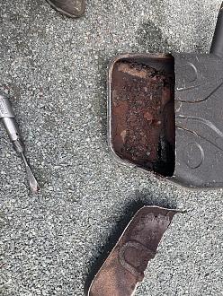

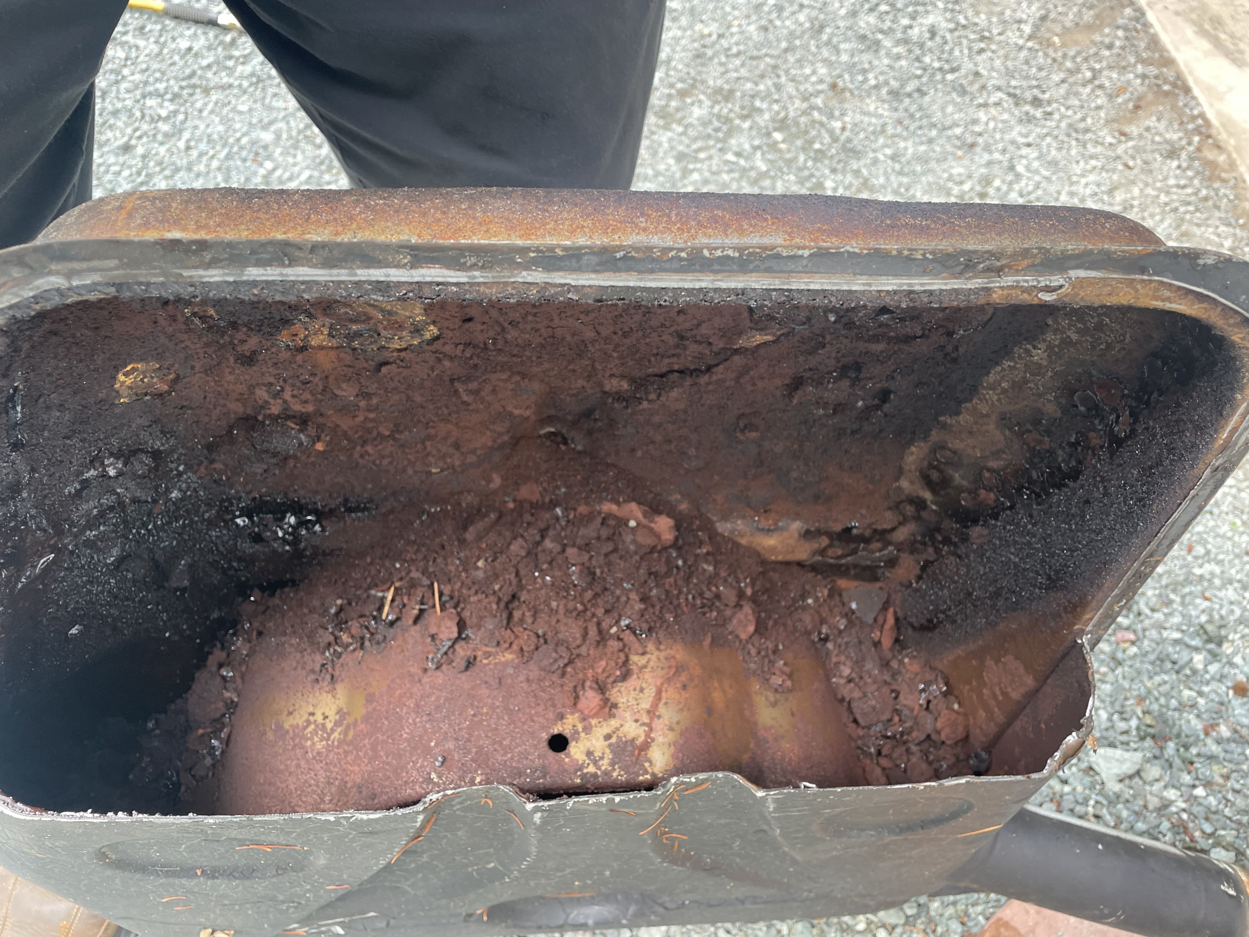

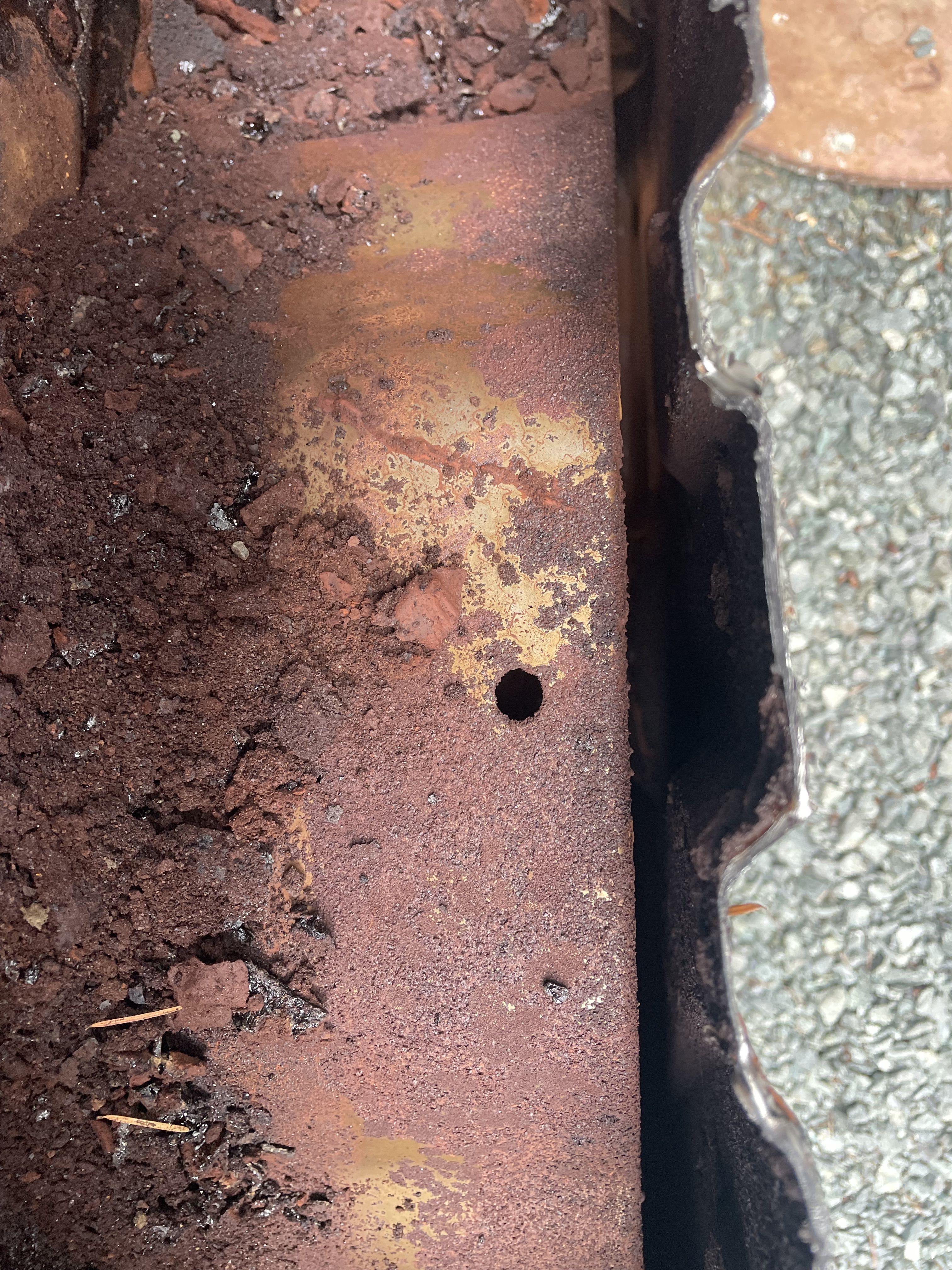

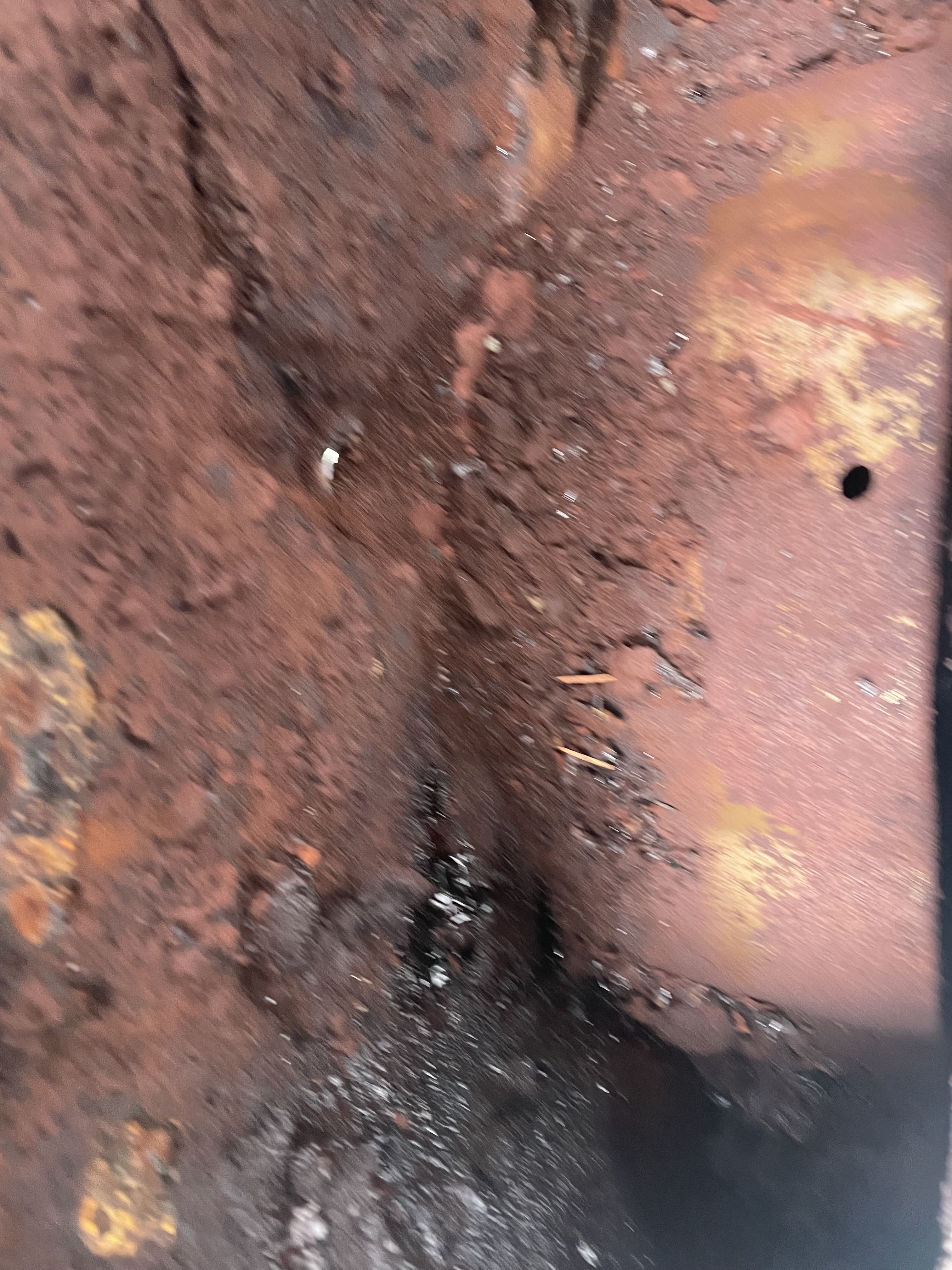

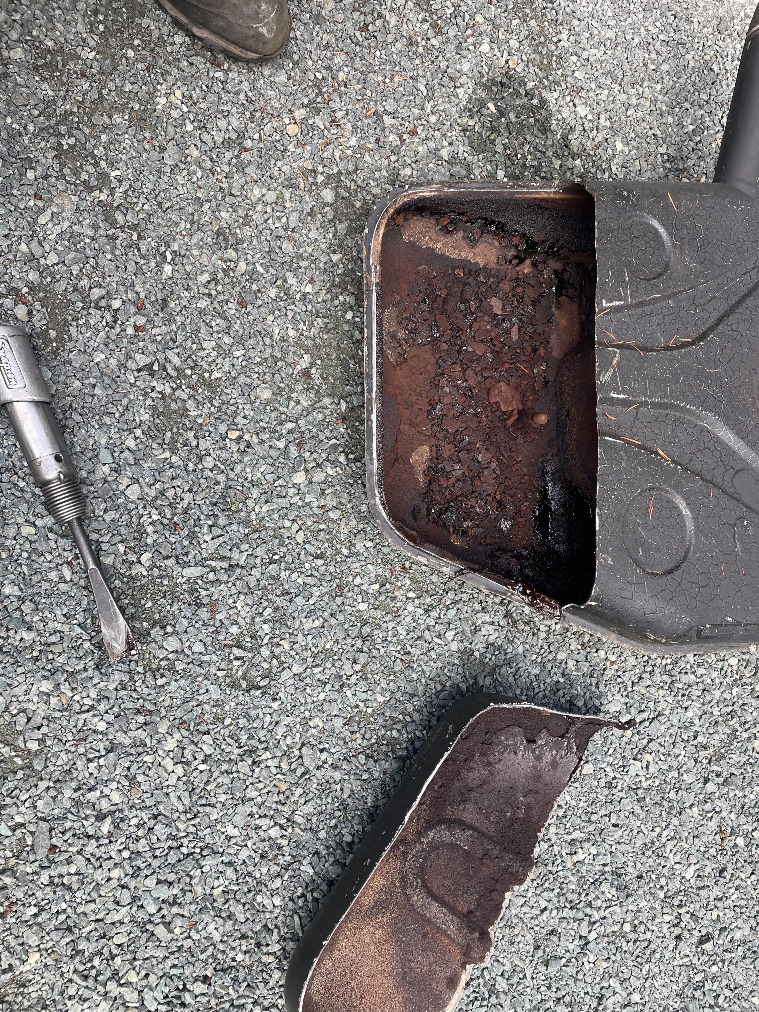

    Slow day cleaning the shop up for the paint stripping. Kept smelling that bad gas smell, from the carburetor cleaning. Traced it outside to the old tank. Decided to open it up and look inside. Boy was that a bad idea, I may never get the stink out. The loose rust and scale is from the top of the tank. Just like before when we split a tank to test electrolysis rust removable. The top surface has most of the rust you see in the fuel filters. The tar from gas remnants tooled like undercoating.
    I have never seen a tank this bad..
ID:	115838 Click image for larger version
    the black tar in the below left photo, was still pliable and damp. That is the stink

    this photo shows the clearance at the top of the tank and the internal slosh baffle. So when cleaning one with Evaporust or molasses, do the upper surface first. You can see a little clearance between the baffle and top. The ends and finally the bottom surface. Same process when using POR-15 or some other tank sealant. The baffle is almost solid at the bottom, but open at the top. So put the sealer in the top surface first, so it can get into the bottom half.

      Is this tank really savable underneath all of that? That laser sure would be nice right about now.

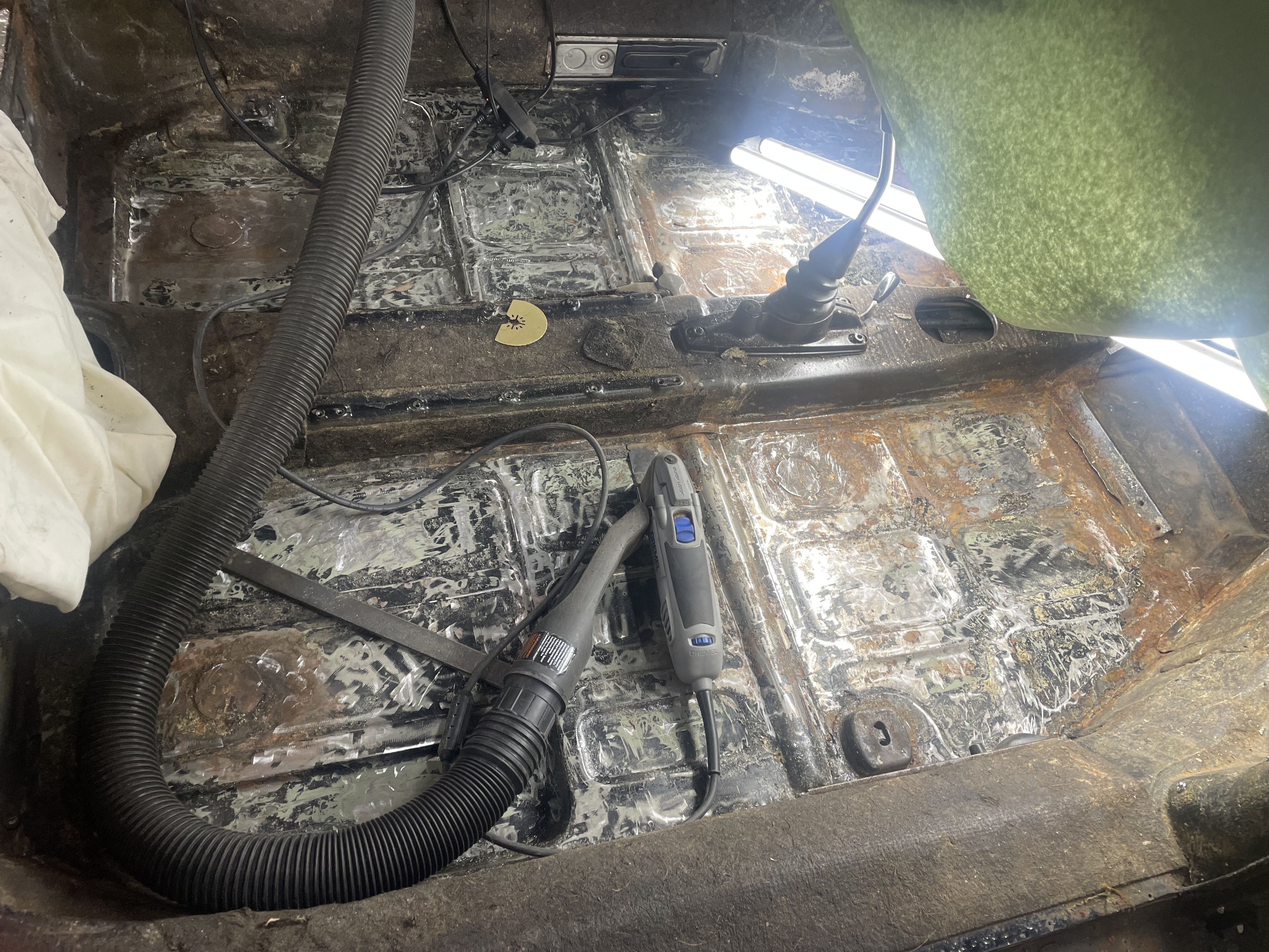

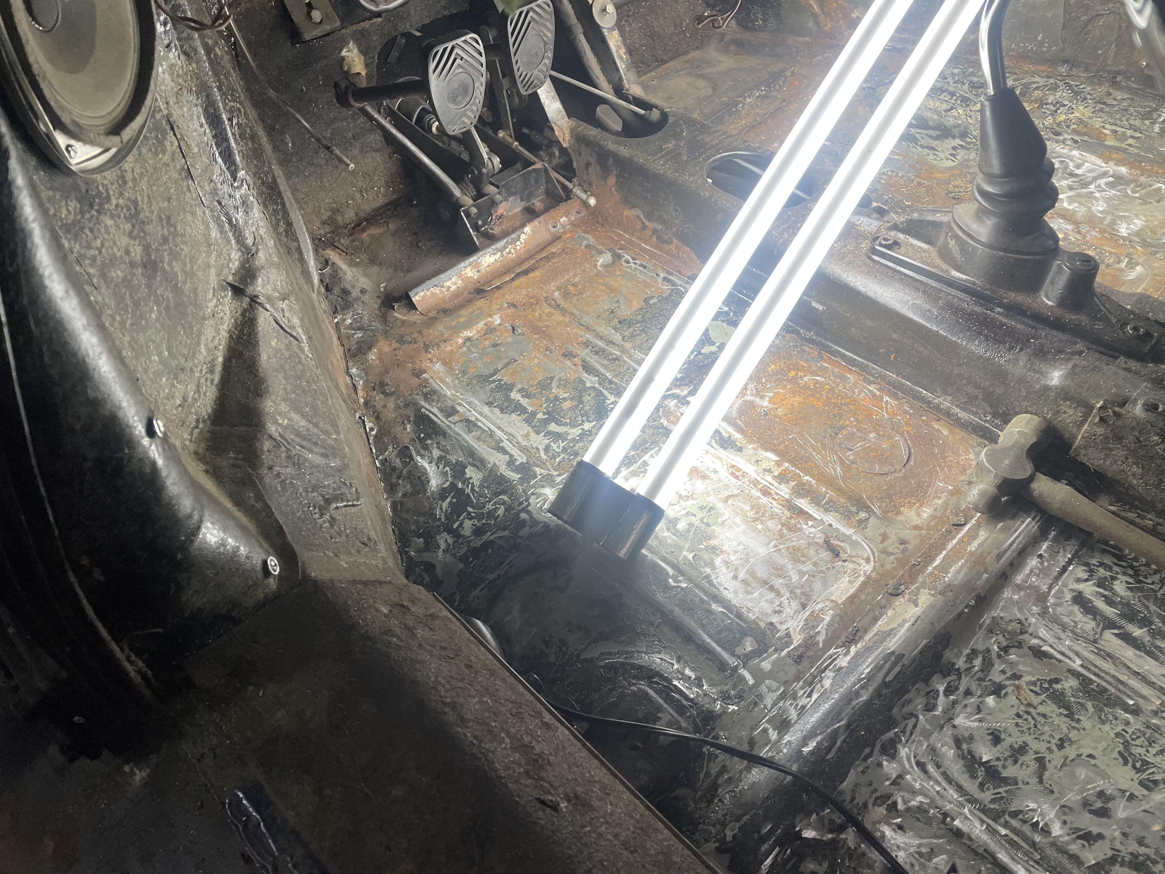

    Click image for larger version  Name:	IMG_7123.jpg Views:	0 Size:	2.14 MB ID:	115840 Click image for larger version  Name:	IMG_7125.jpg Views:	0 Size:	2.01 MB ID:	115841

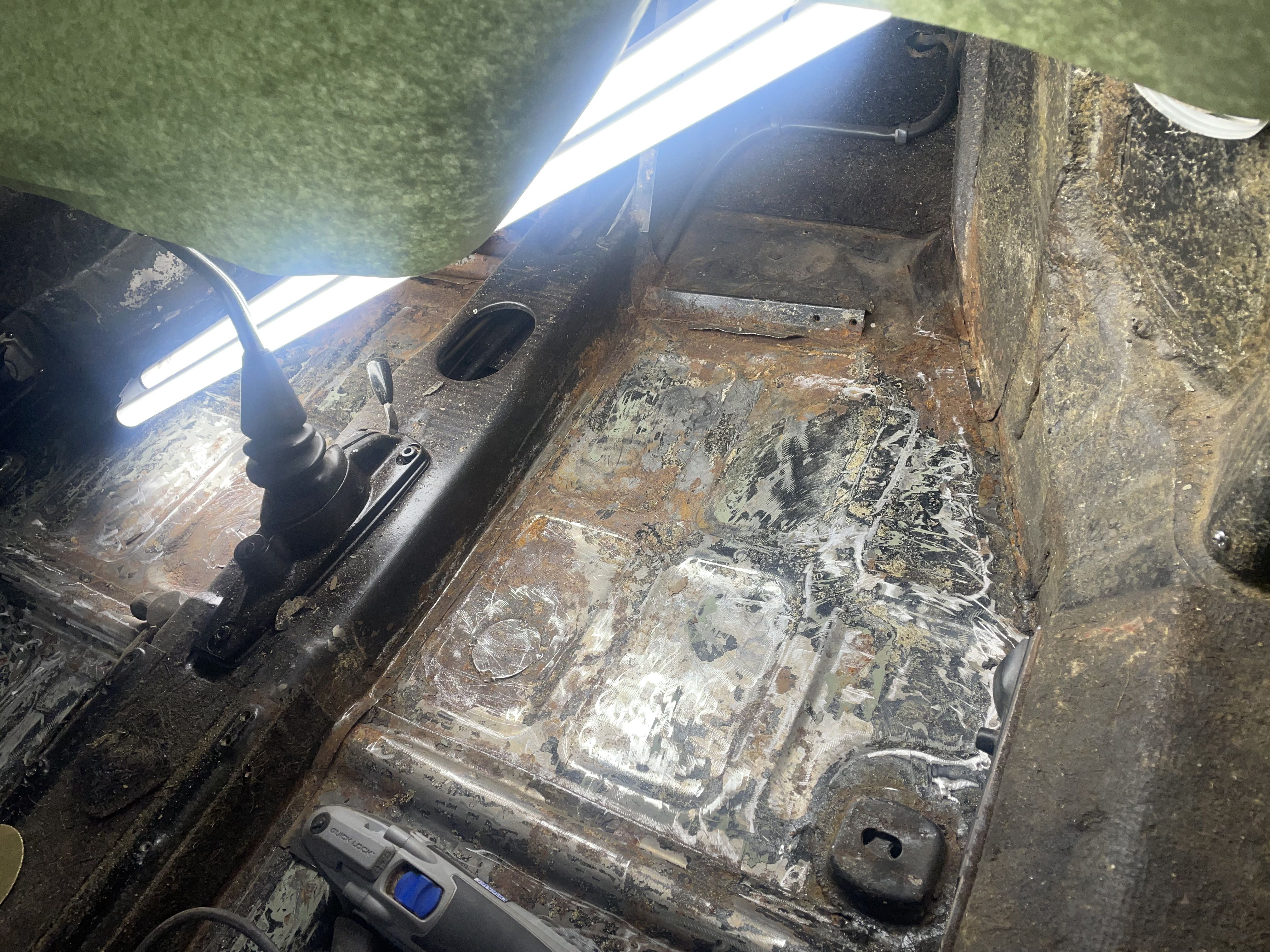

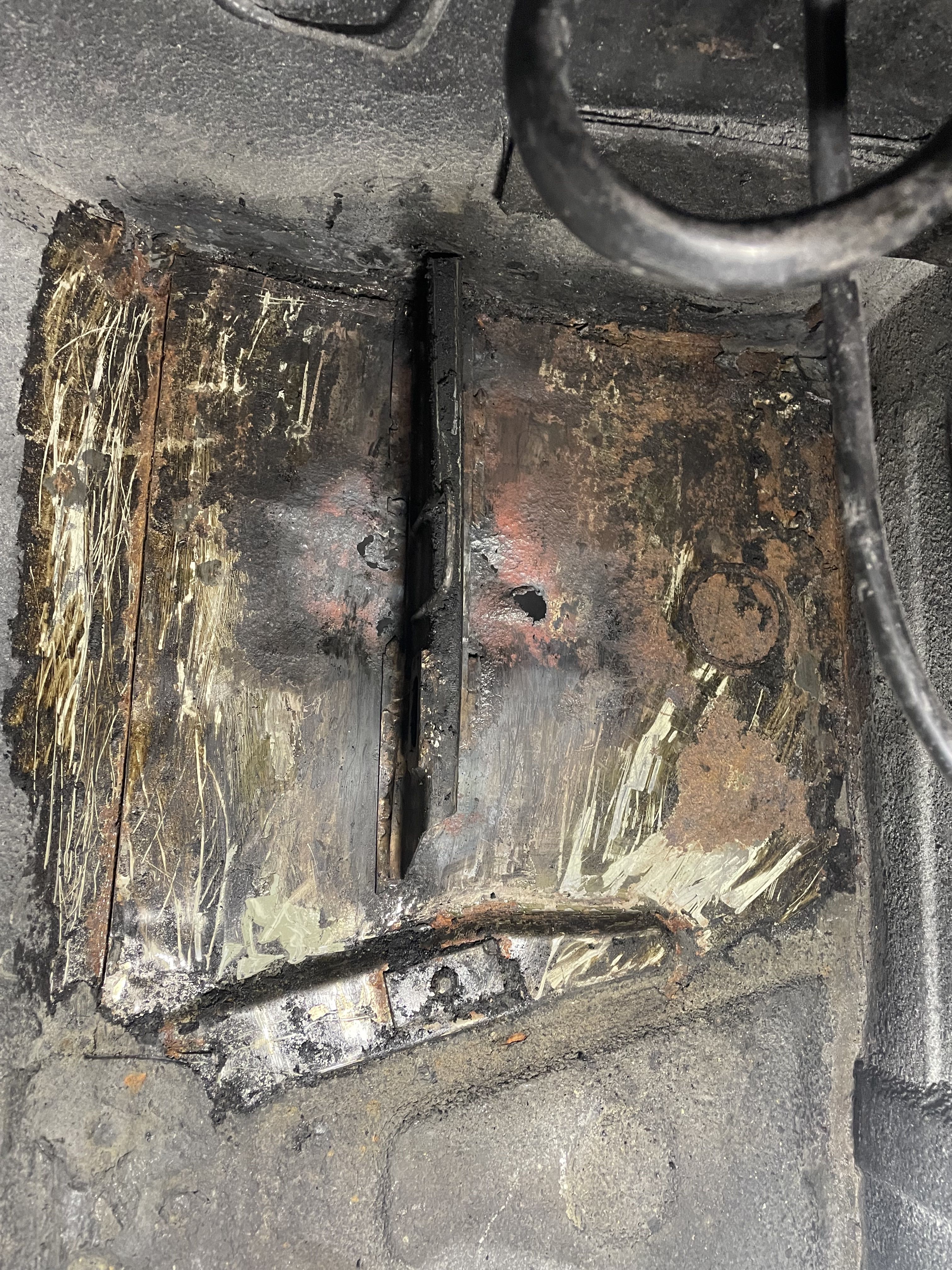

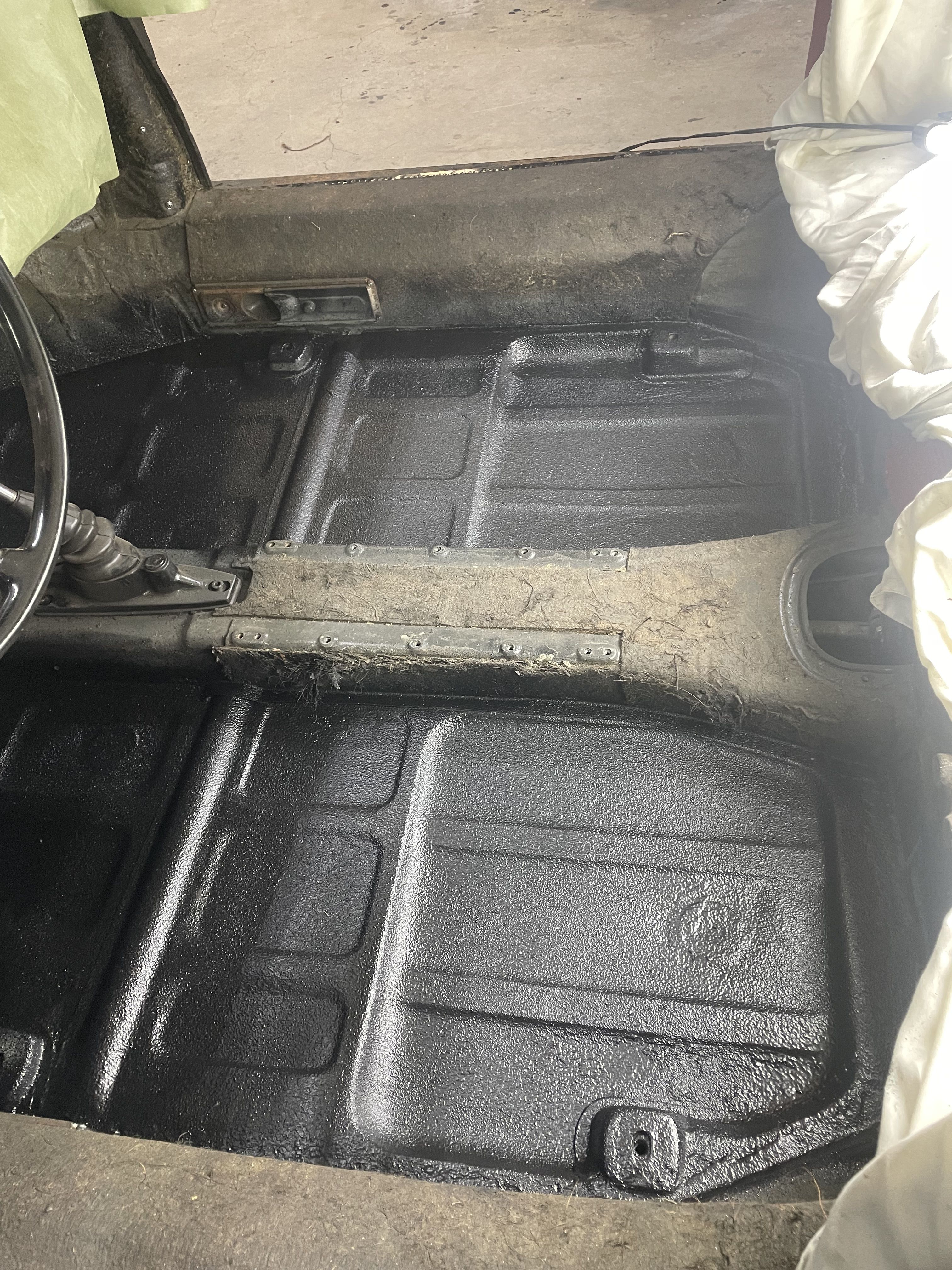

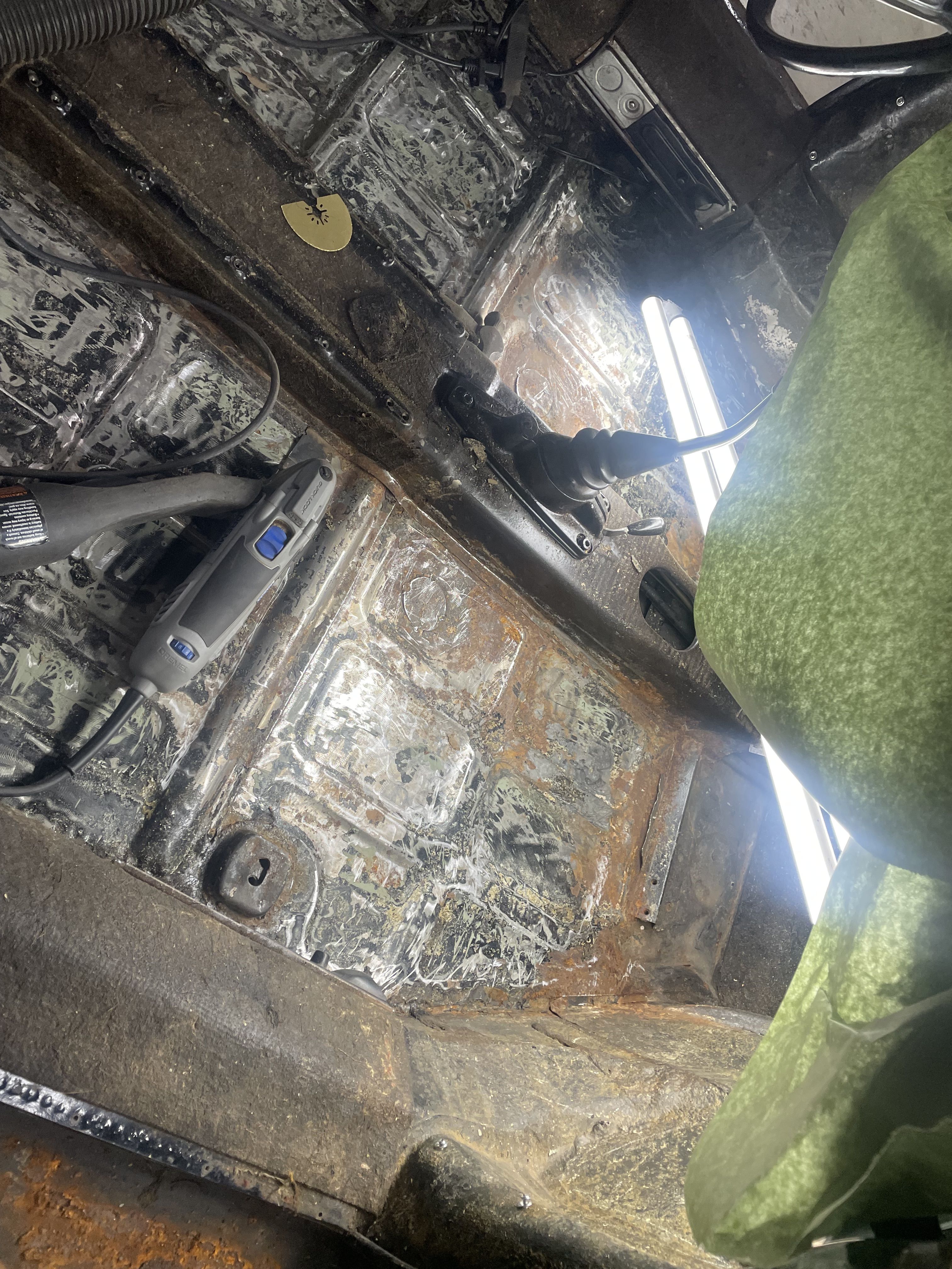

    Floors….my least favorite part of these cars. The jute came off with some heat and a wide scraper, but the rest of the floor was a little different. Knotted wire brush was polishing, not removing the undercoat. Bob had a great idea oscillating saw or multi tool with a scraper and a 1” blade with dull teeth it got under and chipped off the old tar and paint, like a needle scaler on a weld. It worked super, easiest floor we have done. Lots of hidden surface rust under areas that looked solid and intact. But no holes or swiss cheese in the low spots. Next is the knotted brush, scotch bright surface conditioning pad, then Ospho (Orthophosphoric acid), 3M 8307 self leveling seam sealer, epoxy primer then Raptor truck bed liner.
ID:	115842 Click image for larger version

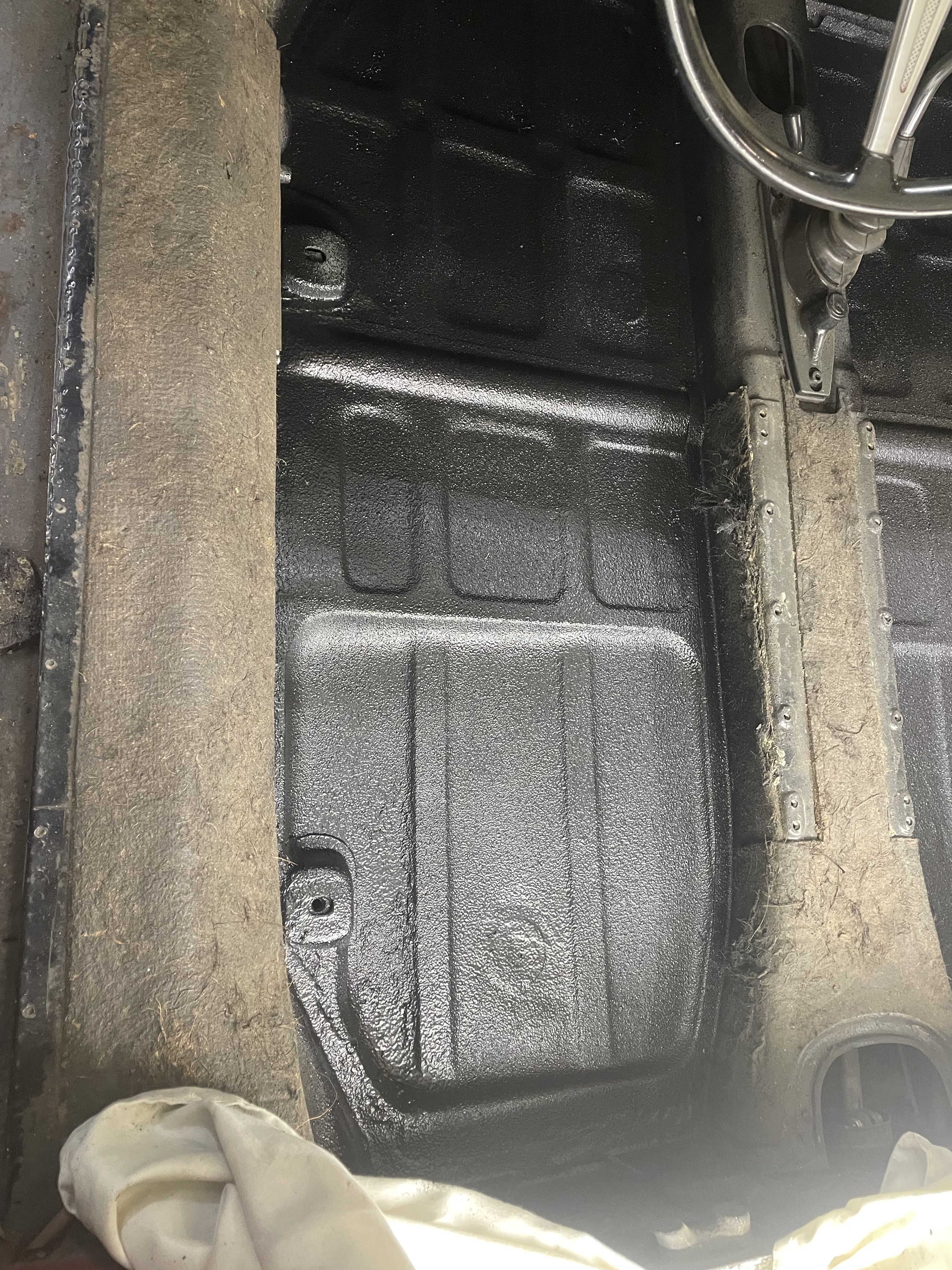

    I know some people will not like the idea of Raptor, but it looks like factory undercoating, tuff seeps in to any cracks and will permanently seal the floor. It’s also will strengthen the floor and reduce road noise. Goes on like shatz but much harder but urethane based and flexible.
      Again, that laser they confiscated from you sure would have made this clean up go a lot quicker. What's going on with that BTW? The floors in this car look solid.

    most of the loose rust was from the topof the tank. We bought a NOS OEM tank. Floors done with a coat of Raptor Bed Liner. It’s went fine, and aluminum foil is your friend for masking..

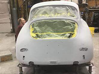

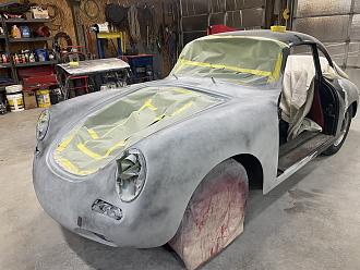

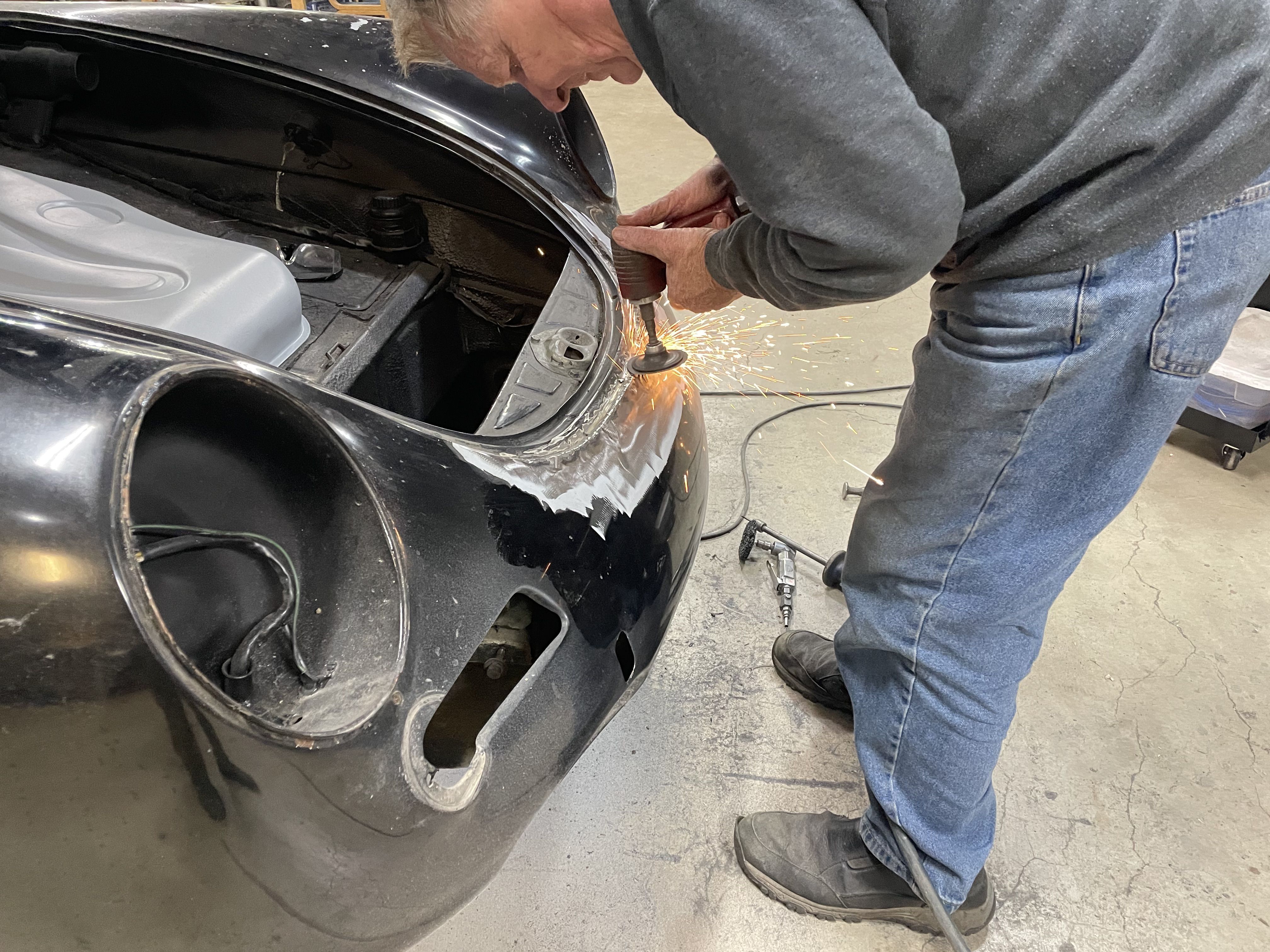

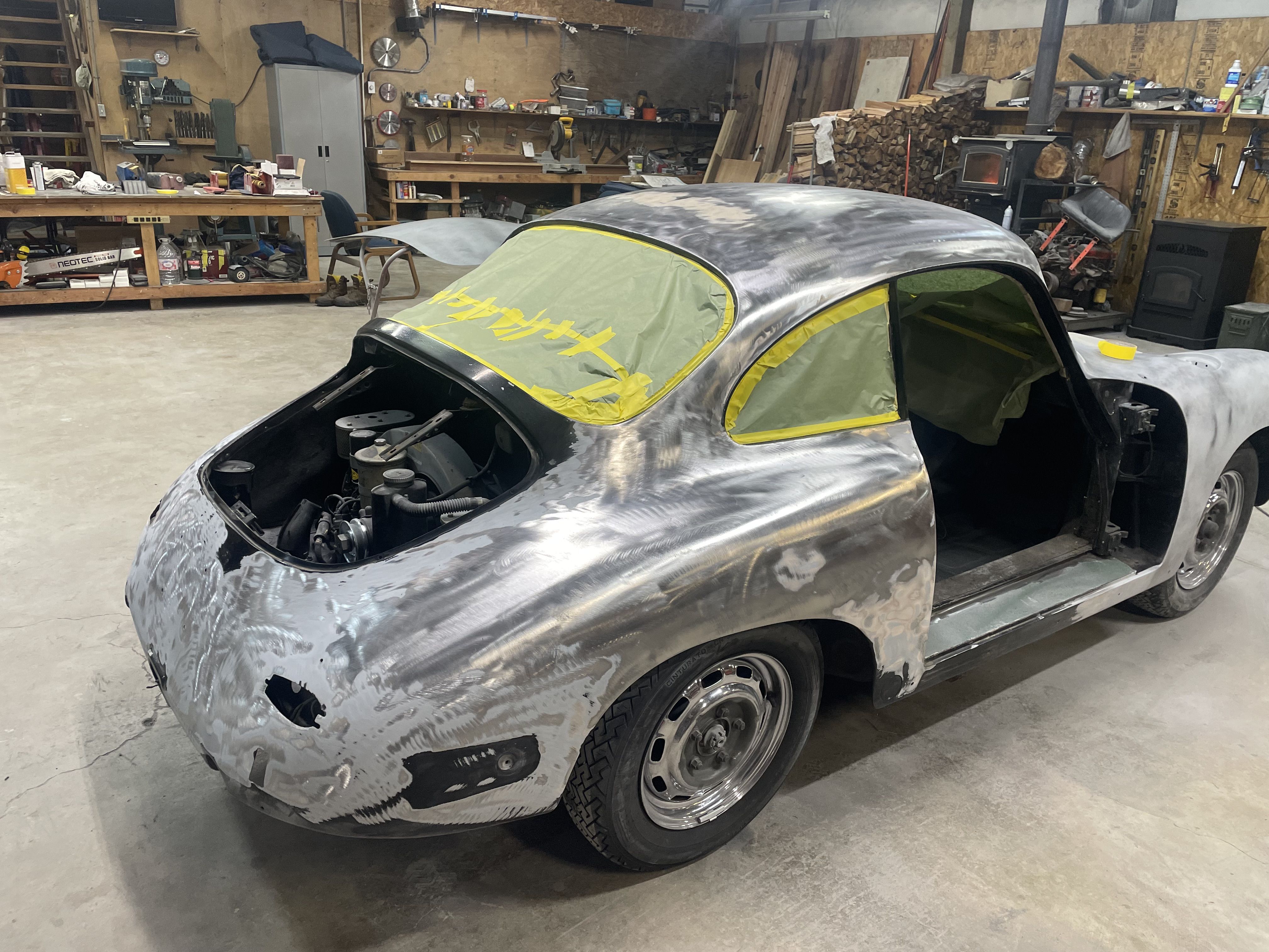

    • #64

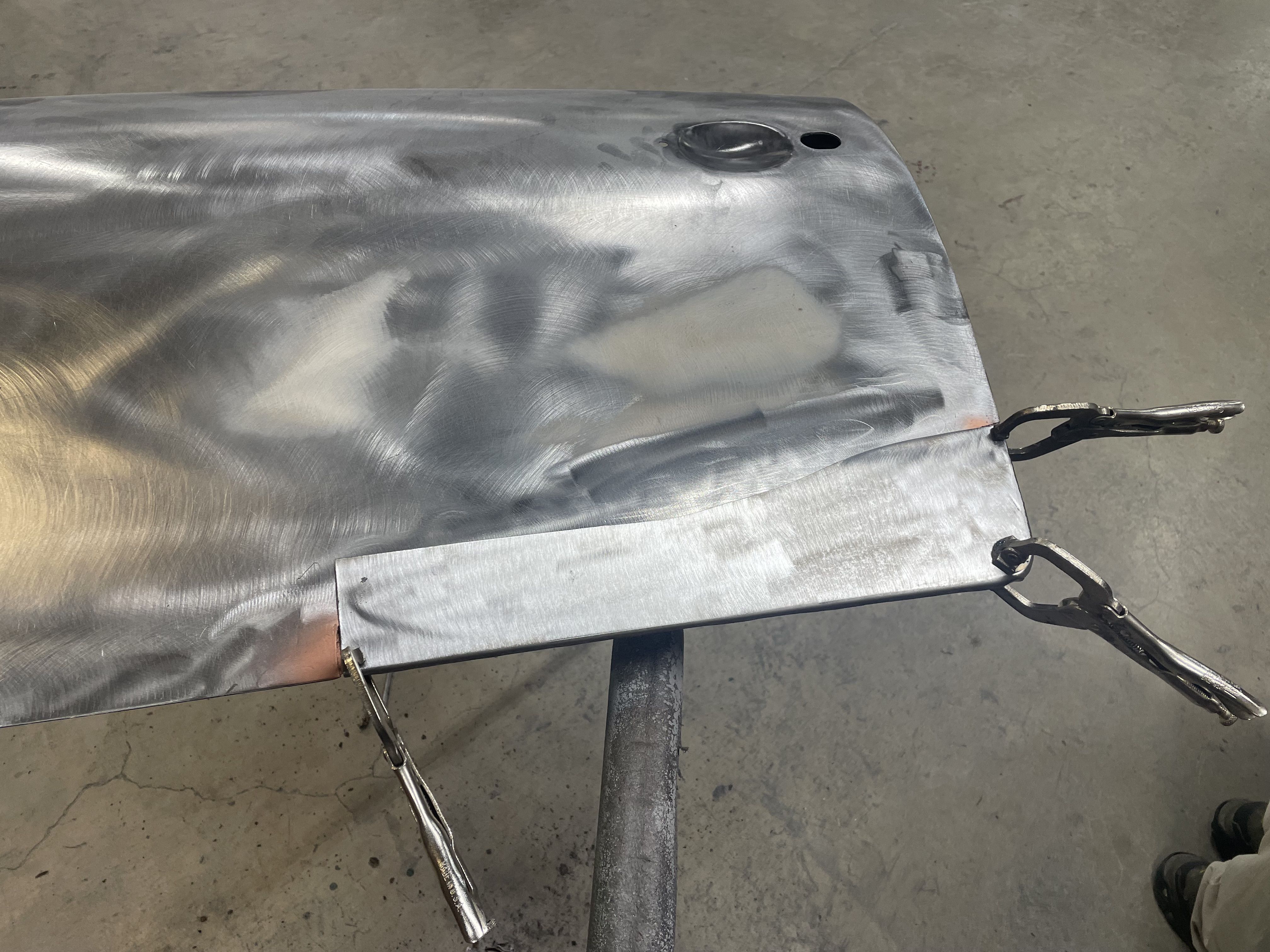

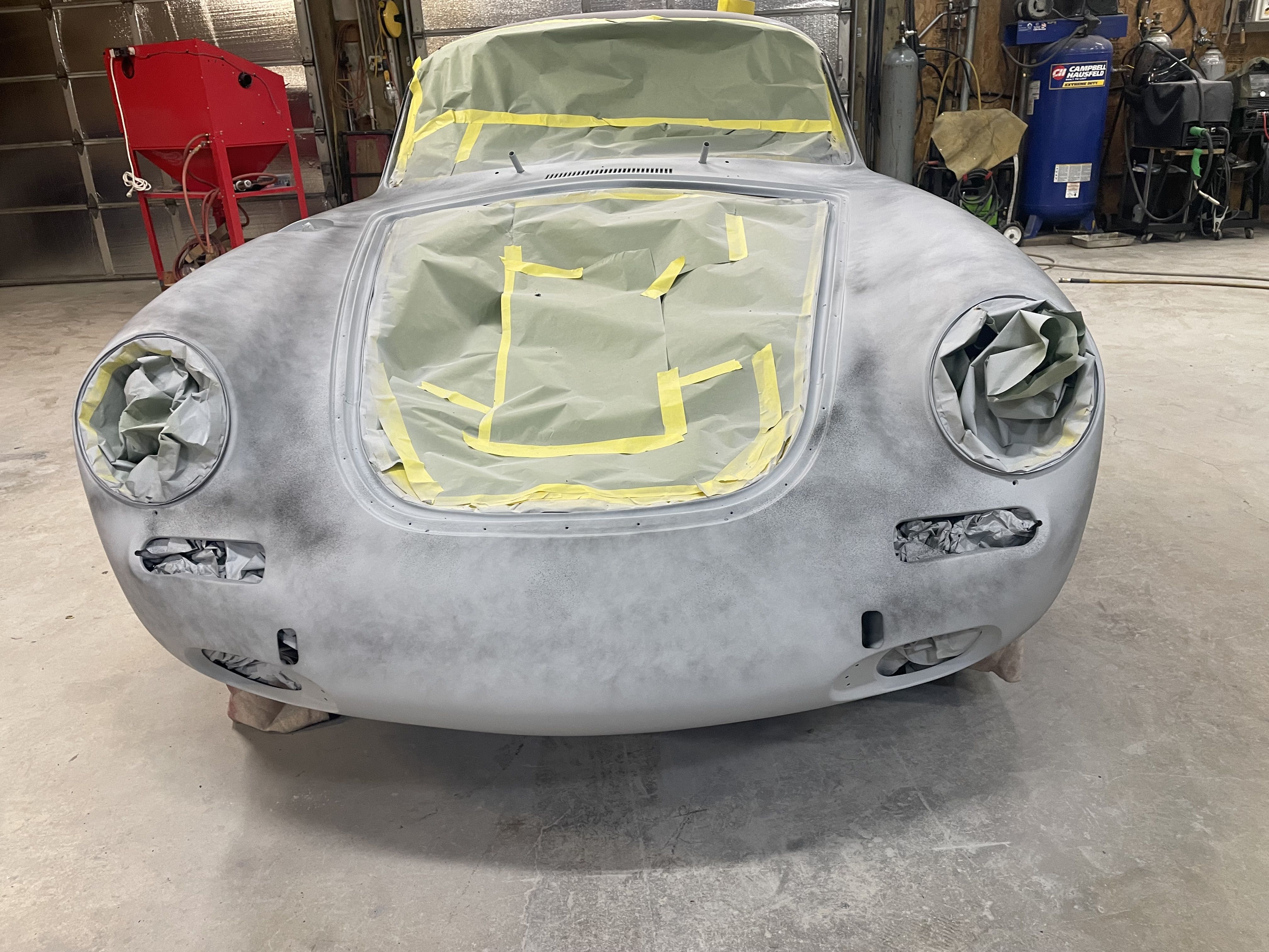

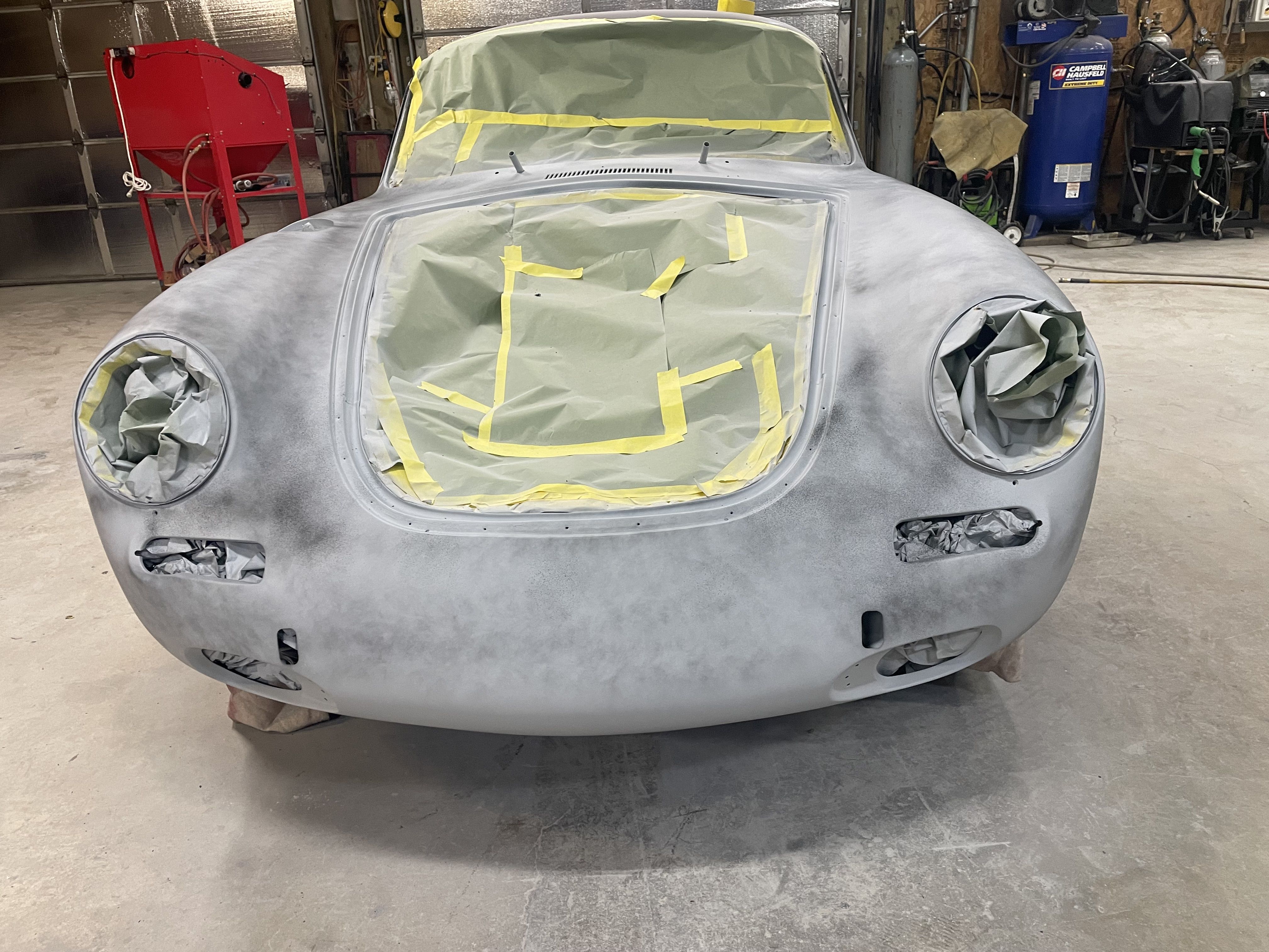

      Body work begins, lots of previous repair, nothing serious yet. Working on gaps, and door skins, rusted from the inside as usual from bad previous repairs. Blisters on the color coat was caused by the spray filler out gassing. Color was applied before it cured, In places it’s over 1/16” thick. Sanded and stripped forward of the A pillars, first coat of sealer / primer applied, guide coat to look for deep scratches in the fender.
ID:	115950 Click image for larger version
ID:	115952 Click image for larger version

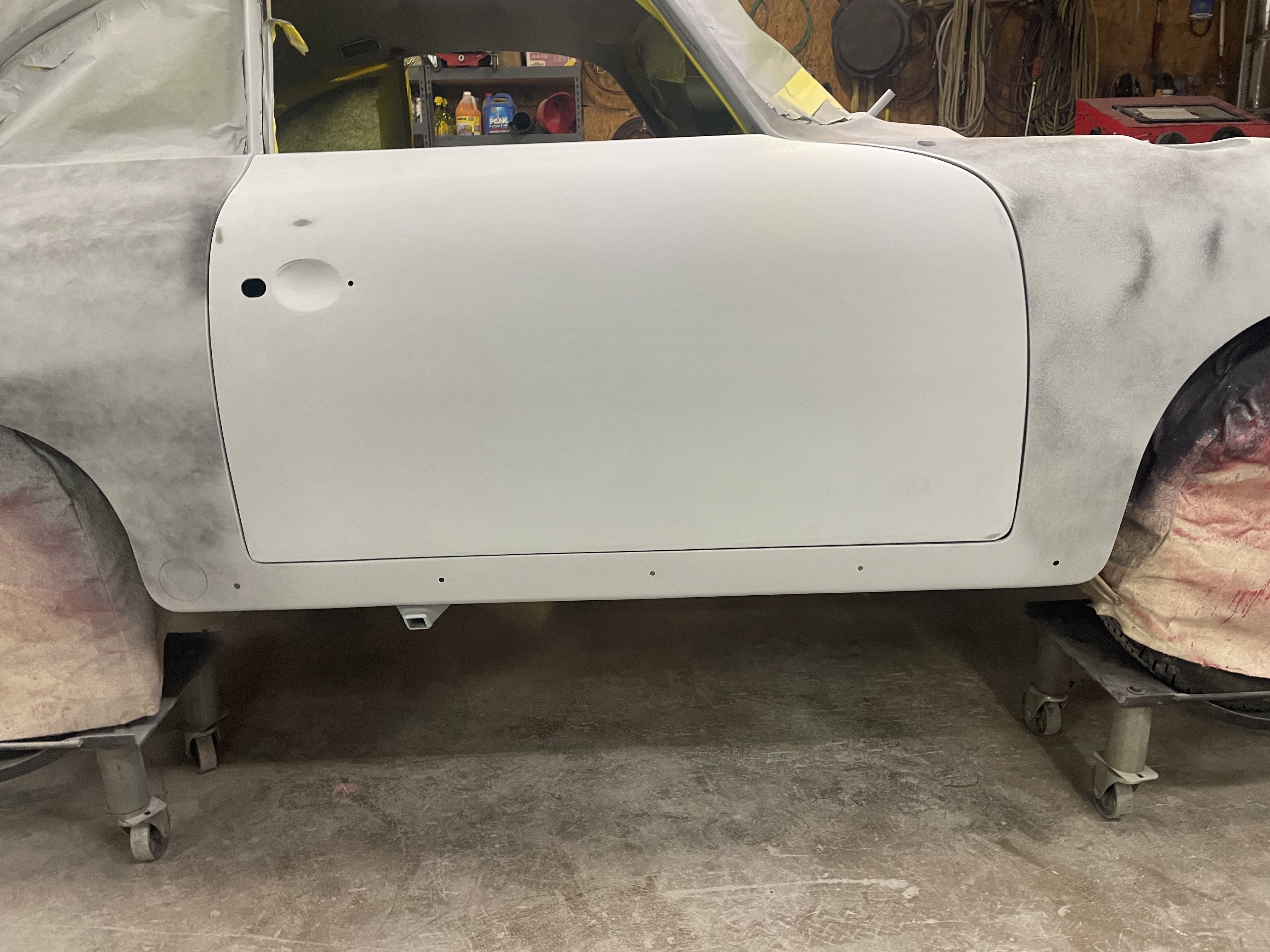

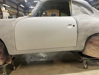

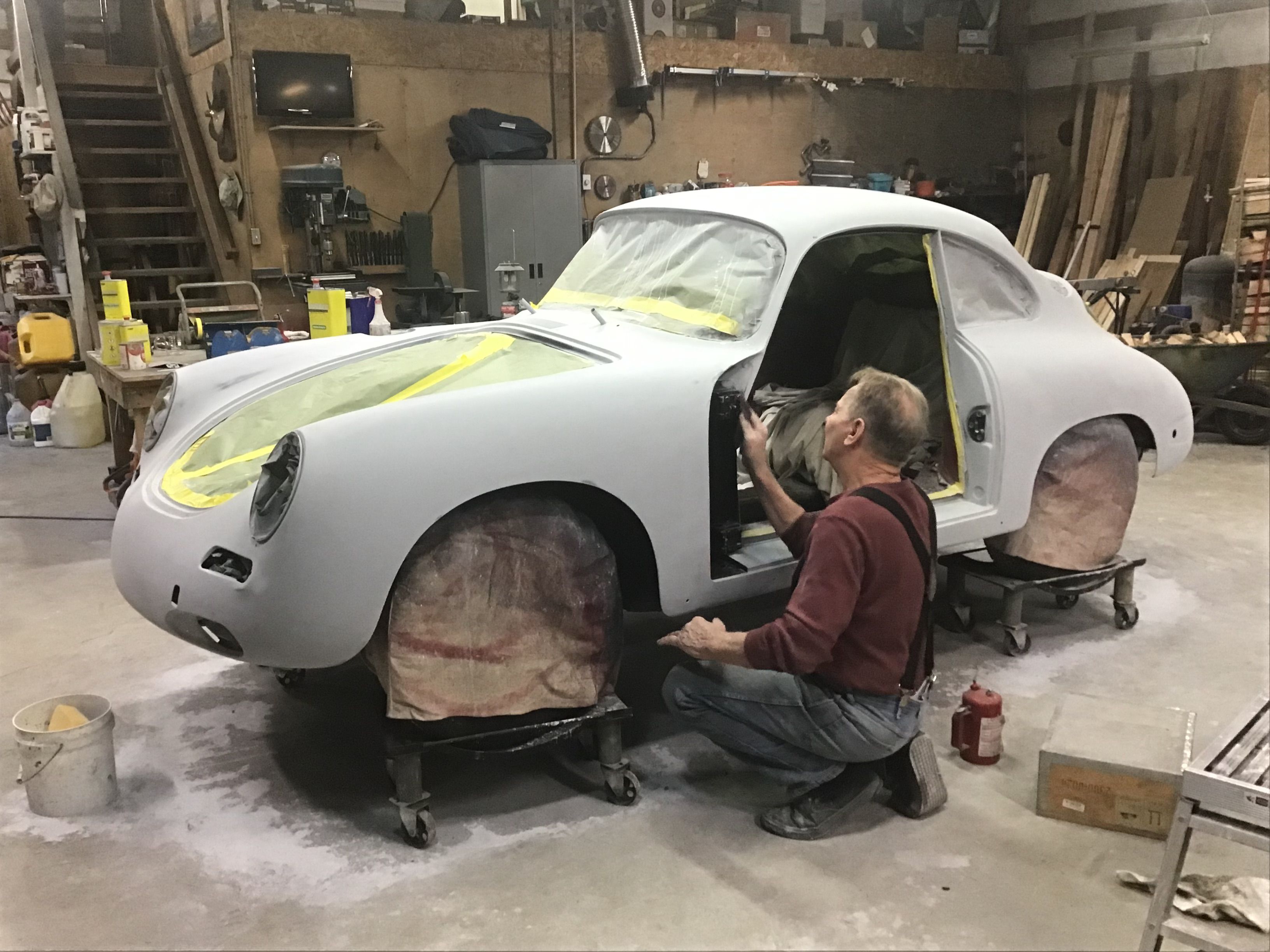

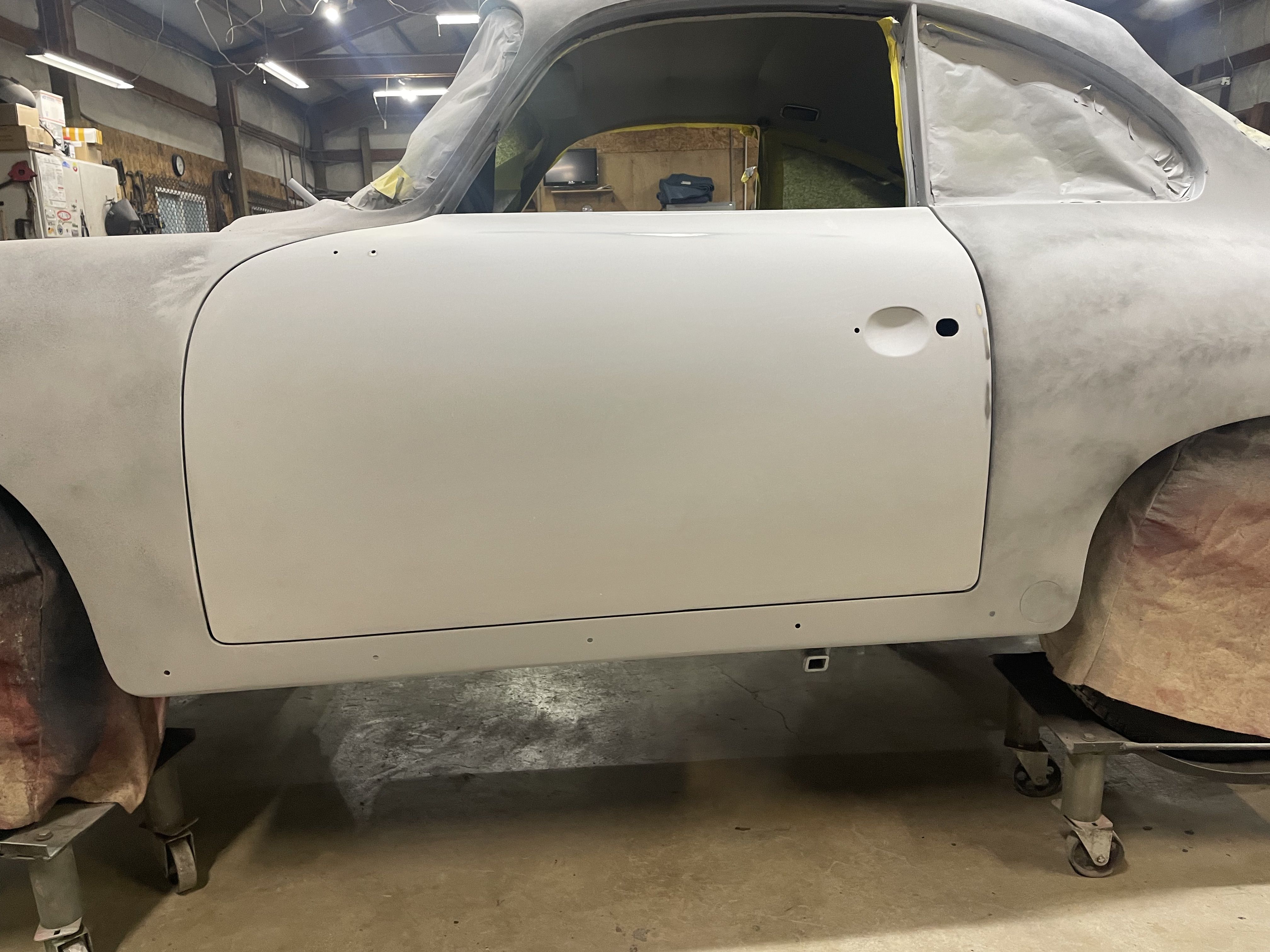

      Door gaps set, block sand re prime, block sand, rinse and repeat. Life is good
ID:	116053 Click image for larger version
        Shes looking good!

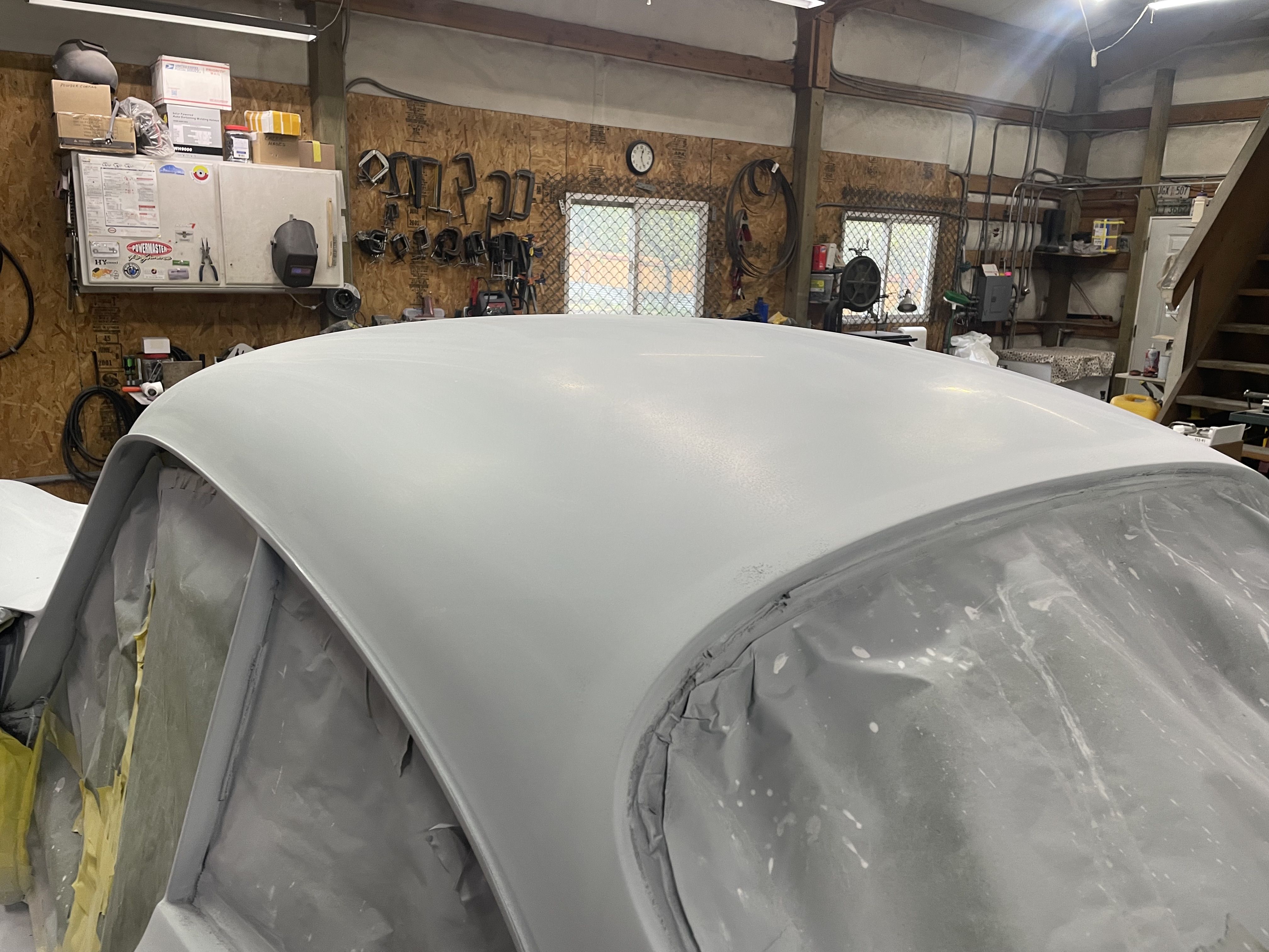

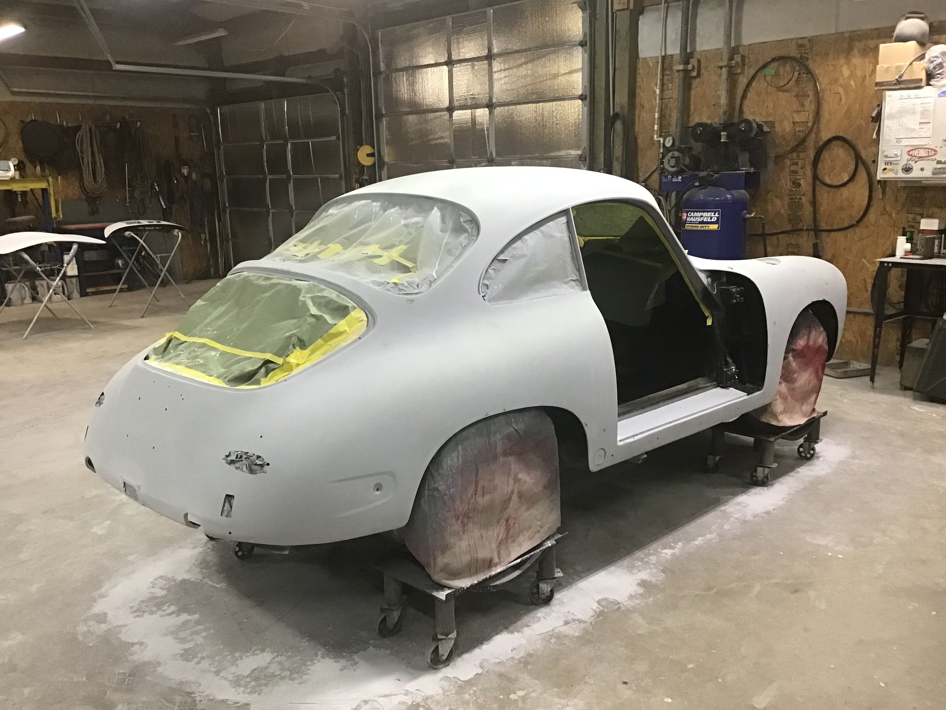

        Wet sanding the second primer coat, the body is super smooth now, but one more primer and wet sand to get it like glass.
ID:	116069 Click image for larger version
ID:	116068 Click image for larger version
        put it together, block sand, fit test, take apart, prime, repeatedly.
        thanks for looking

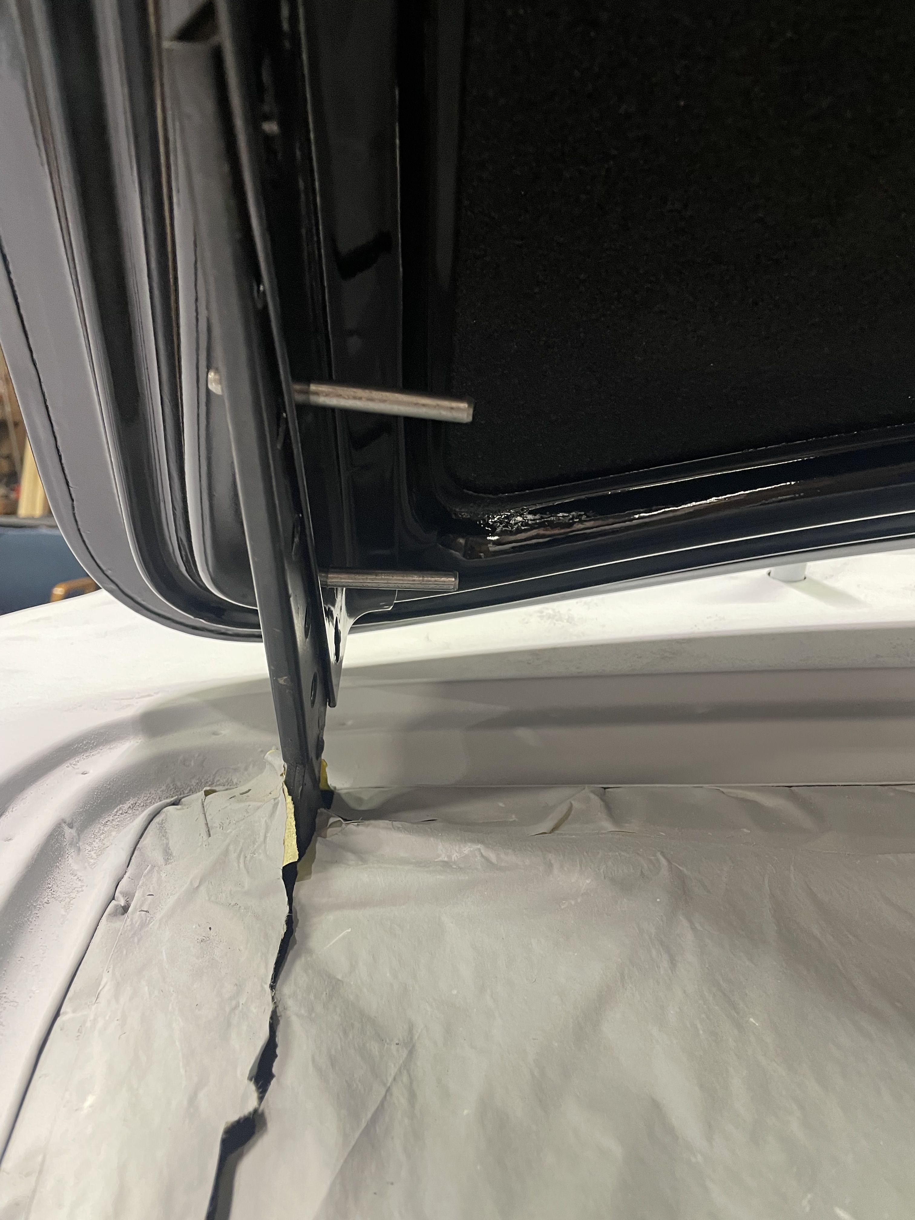

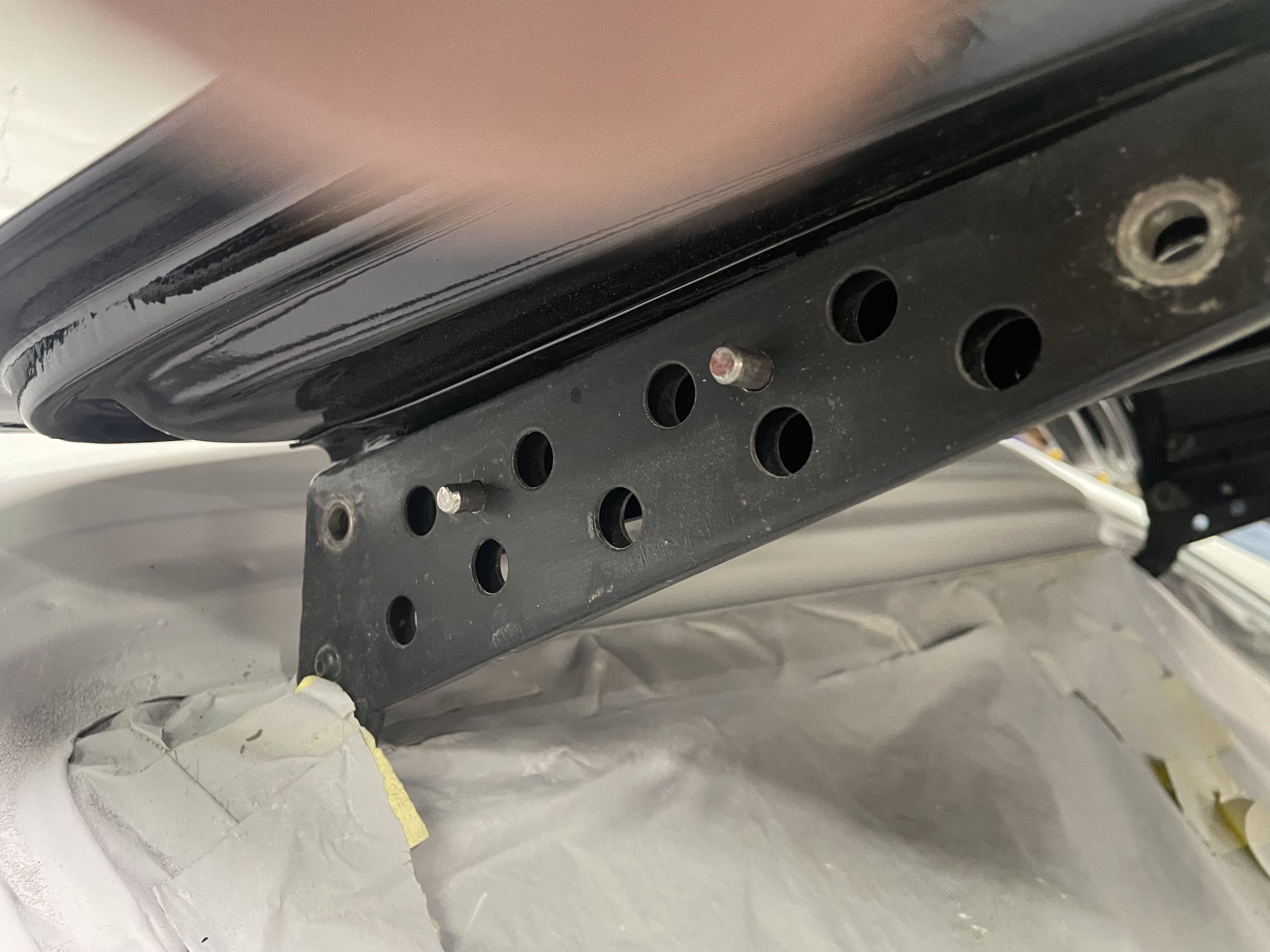

          Wet sanding complete, started the trim out paint, and recheck the fits. Couple of photos of the hood align pins. There are 8mm pins used to put in the hinge point holes. We check the original alignment and gaps. Ream out the holes to accept a 8mm pin. Then remove the bolts and the hood. This allows us to easily remove the hood for fit and gaps. The pins will support the hood, make it very east to remove and replace.
ID:	116081 Click image for larger version
ID:	116082 Click image for larger version

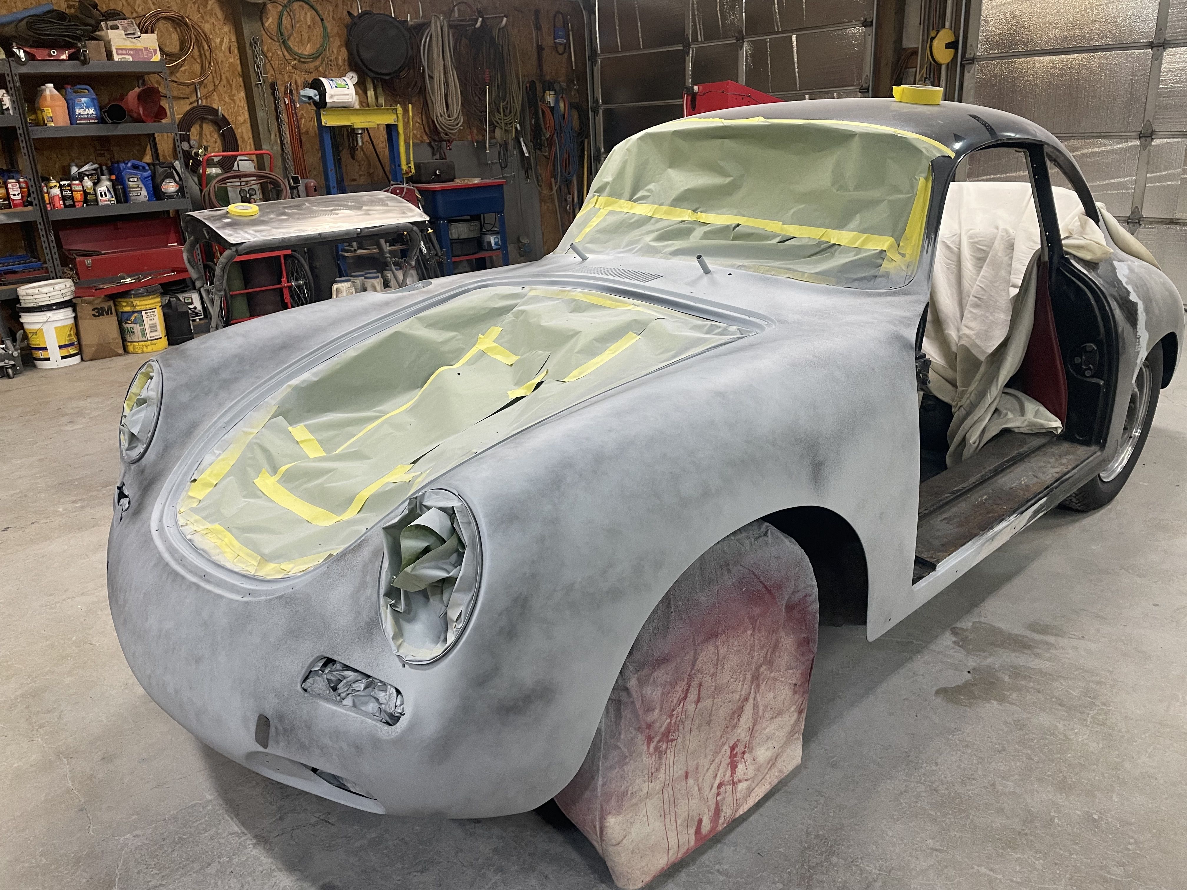

          Body is like glass now, blocked and sanded , it’s starting to turn black , that’s sanding dust on the underside hood where the chrome attaches, forgot to tape it for wet paper

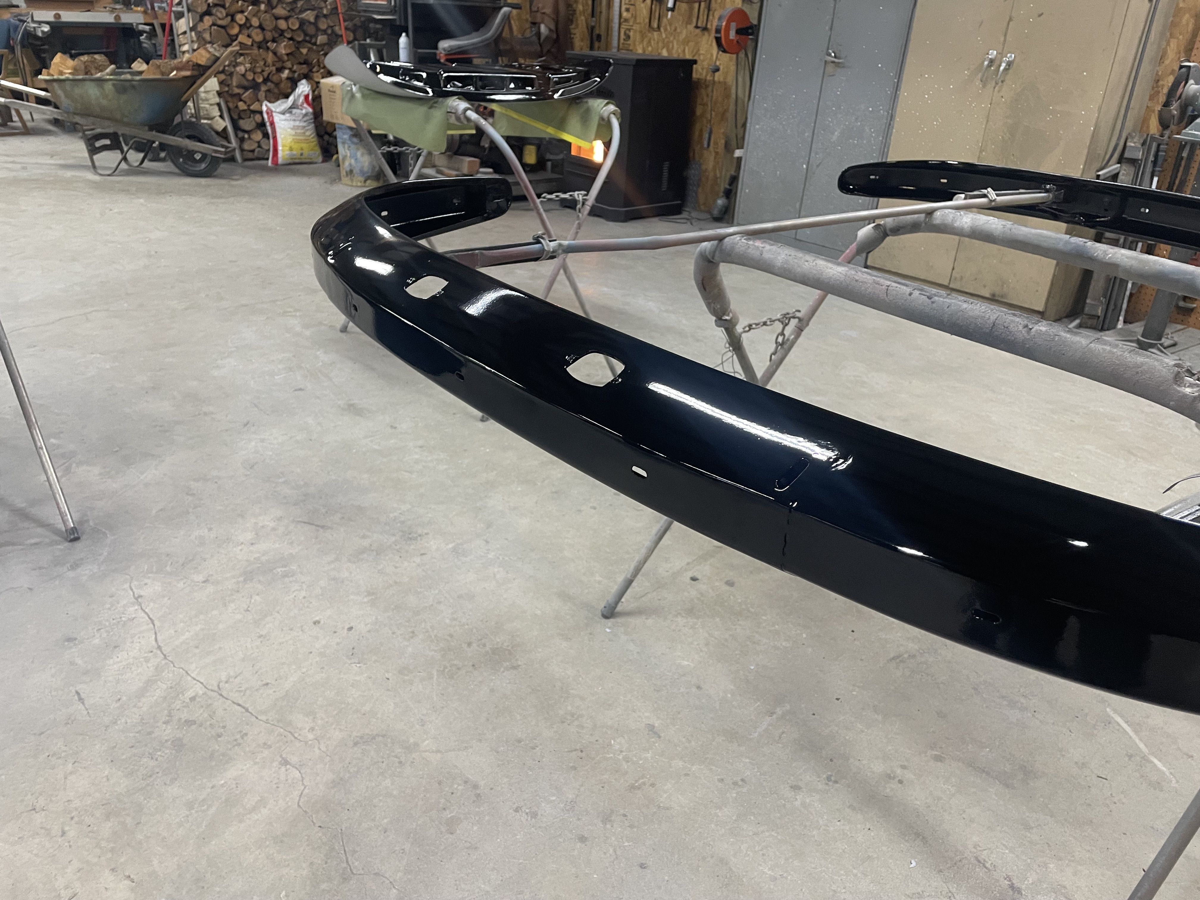

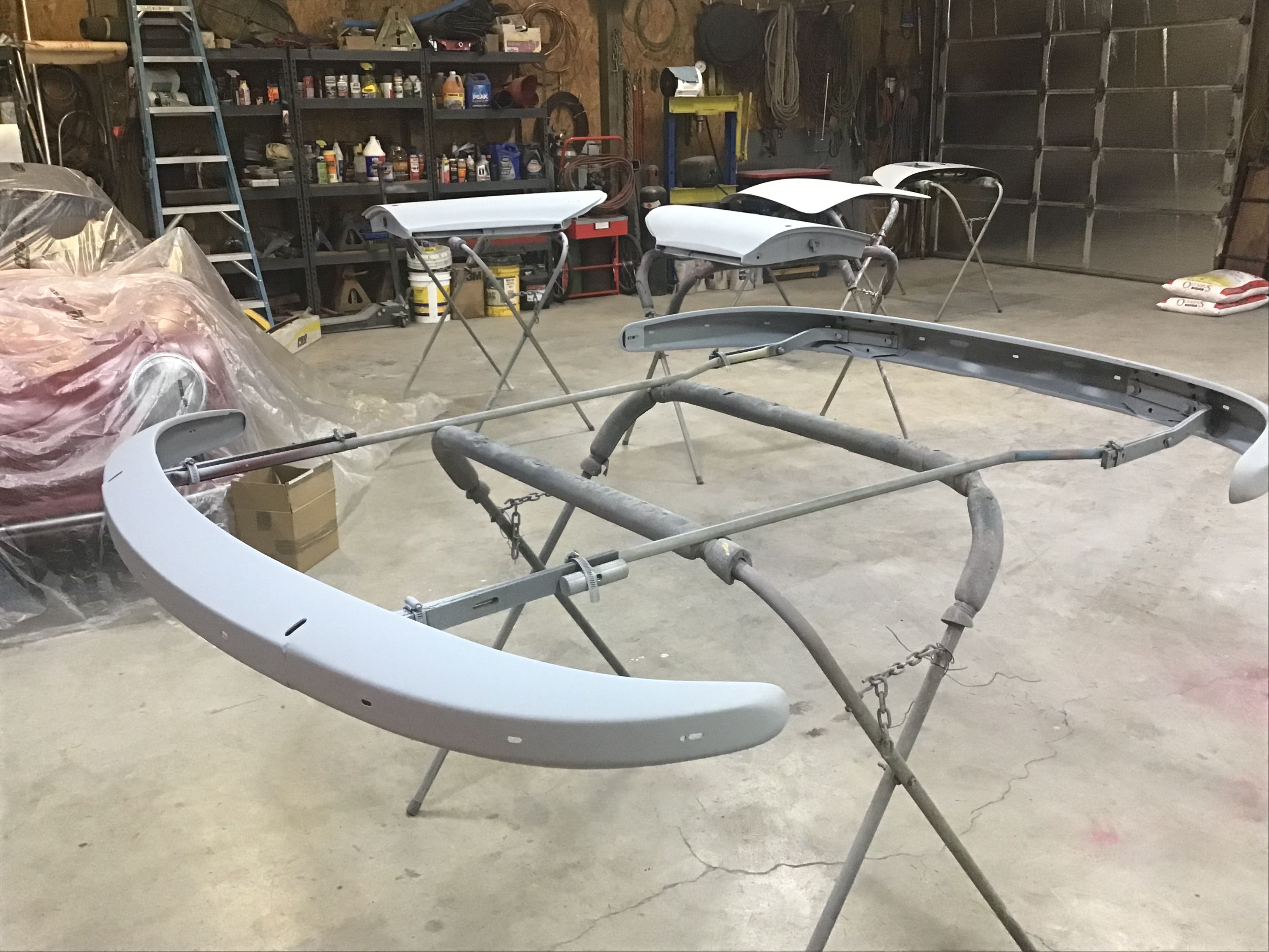

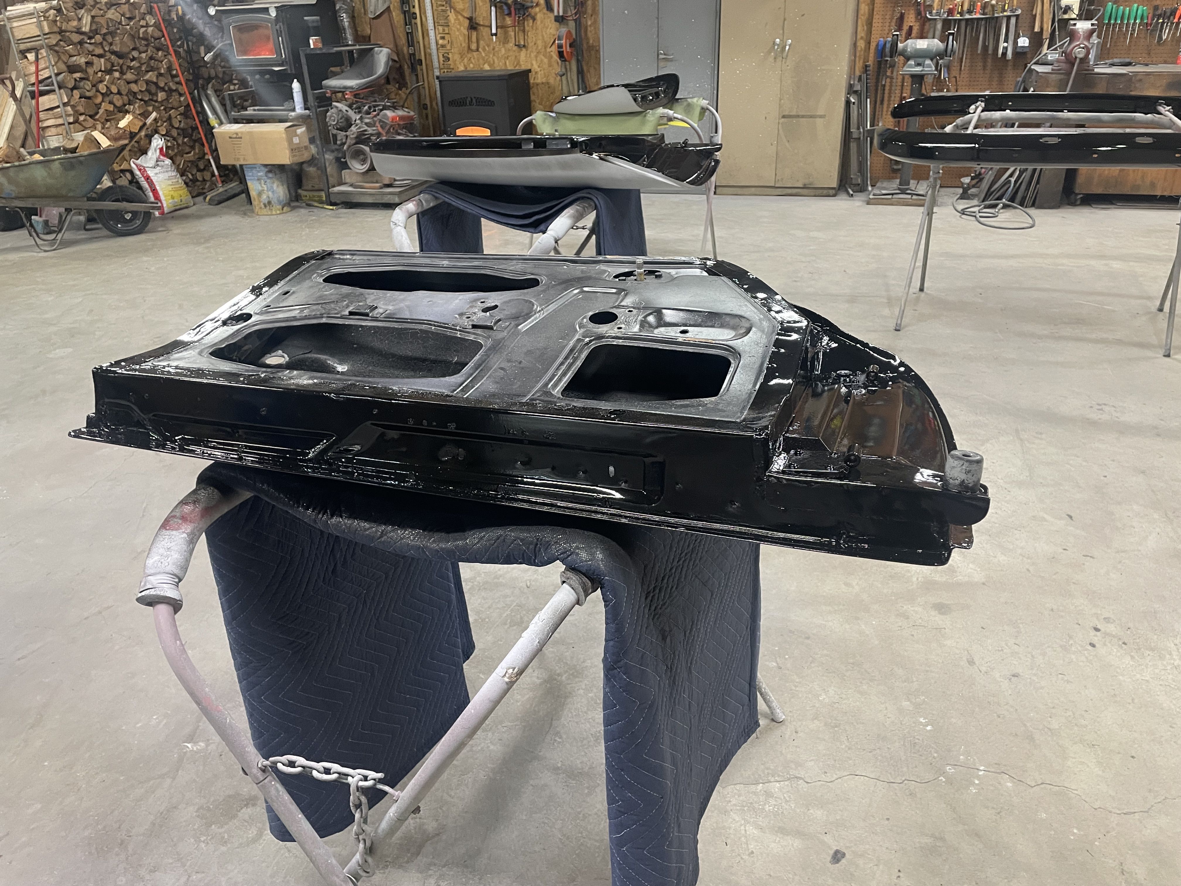

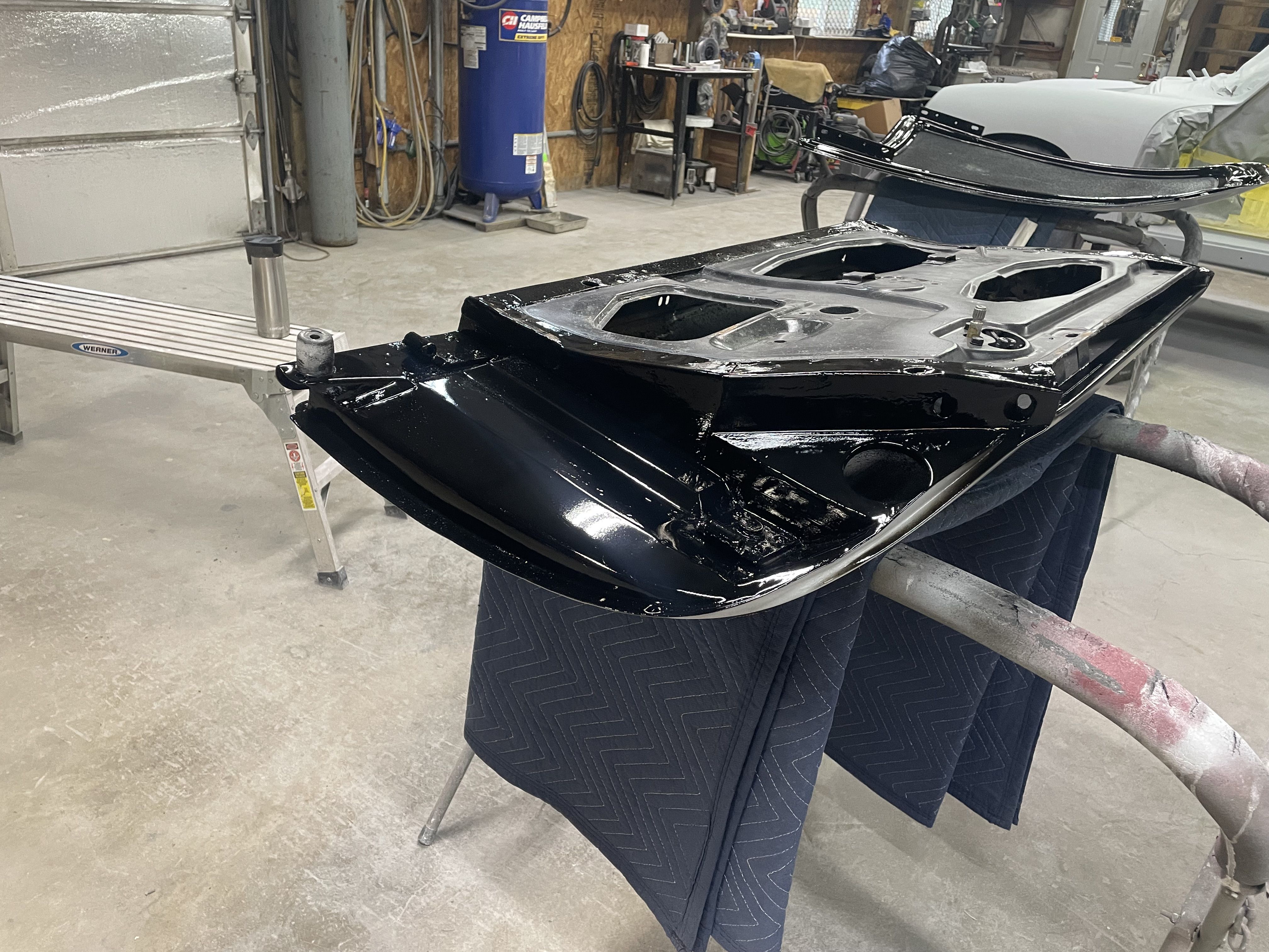

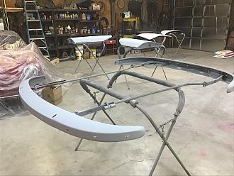

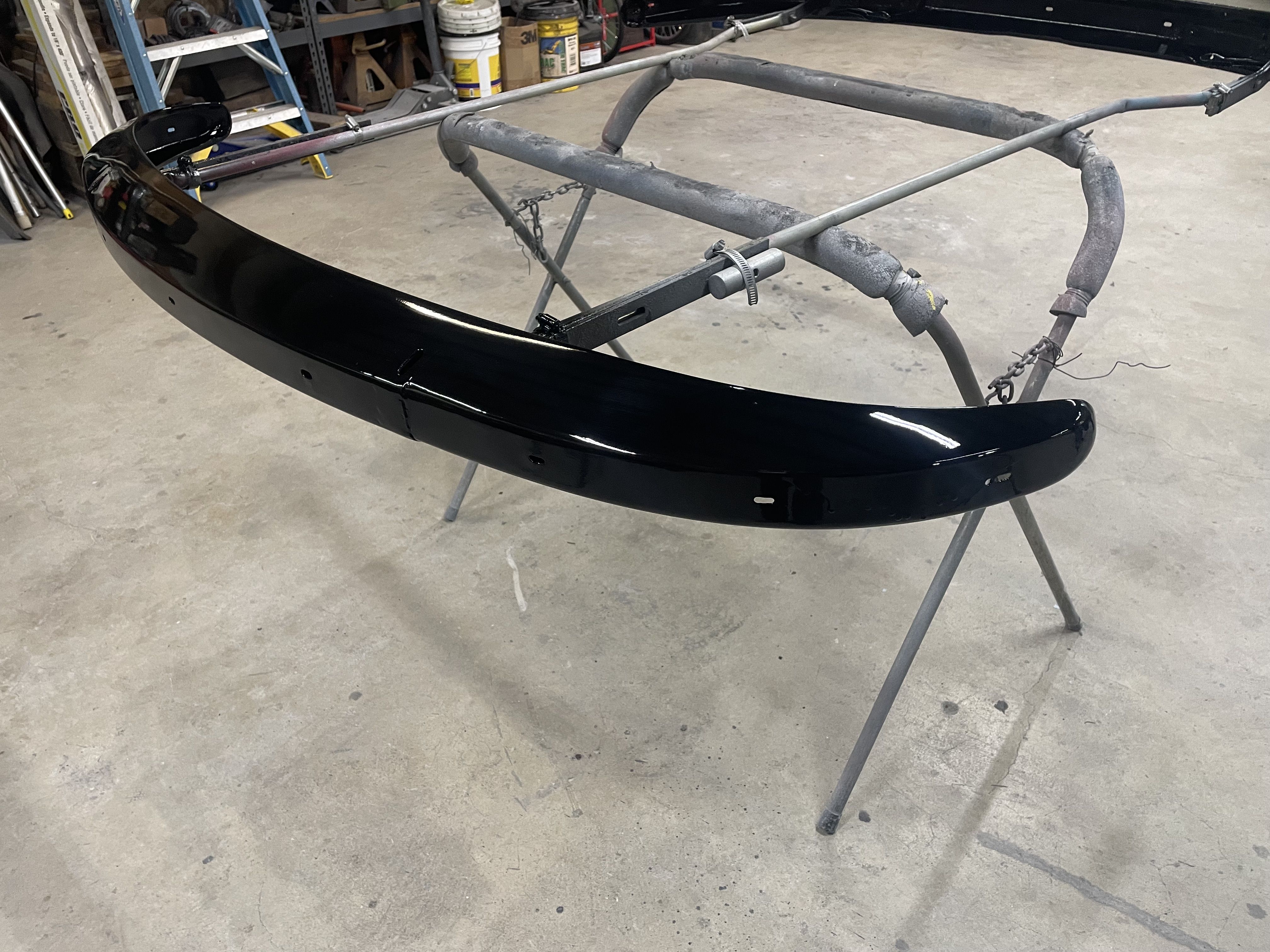

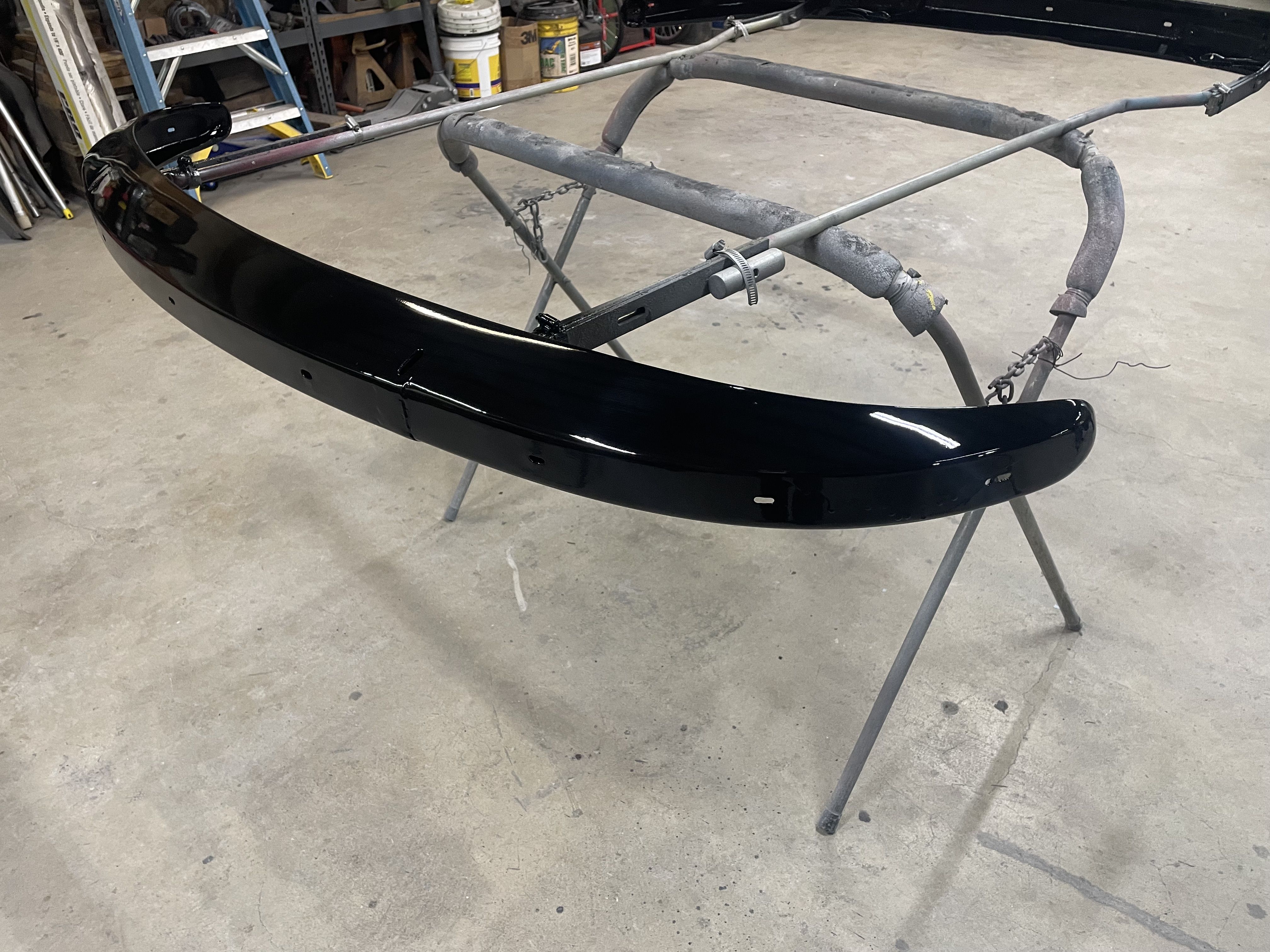

            Bumpers done, I need to put the lights on, but the look like new. Bob fabricated some holders from EMT that makes the easy to flip and handle.
ID:	116092 Click image for larger version

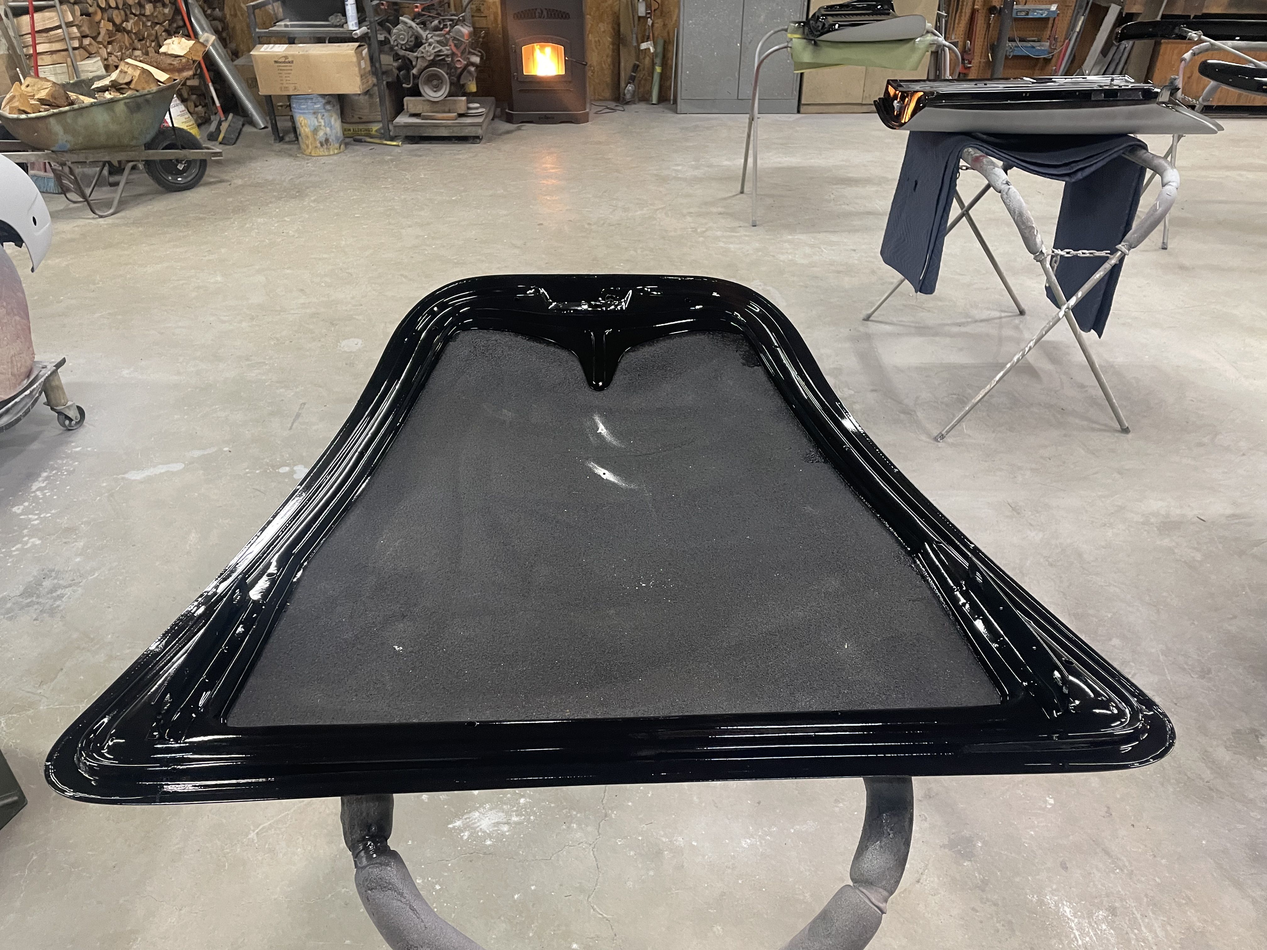

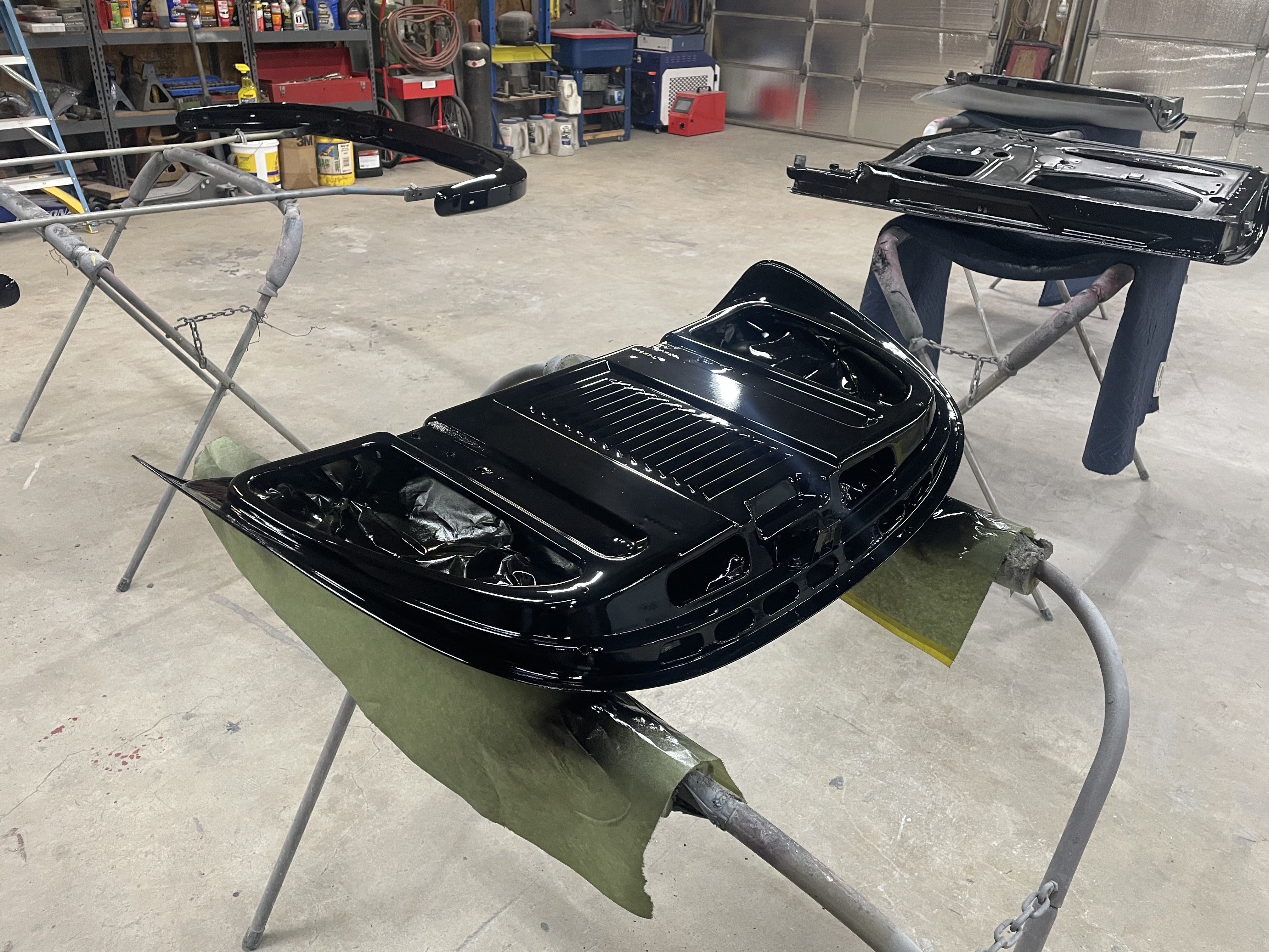

            The deck lid and hood are painted on the underside now
ID:	116088 Click image for larger version

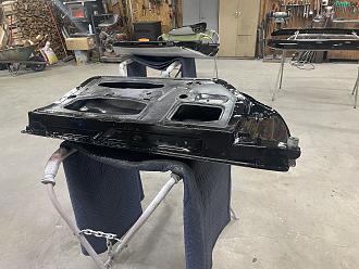

            Door trimming paint complete, as soon as it warms up a little around here, the entire car will become a single color. We originally planned this for August or early September, but things happen. But it progresses.
              I like the bumper holding jigs. They tend to get a little slipperier to handle and store after final paint.

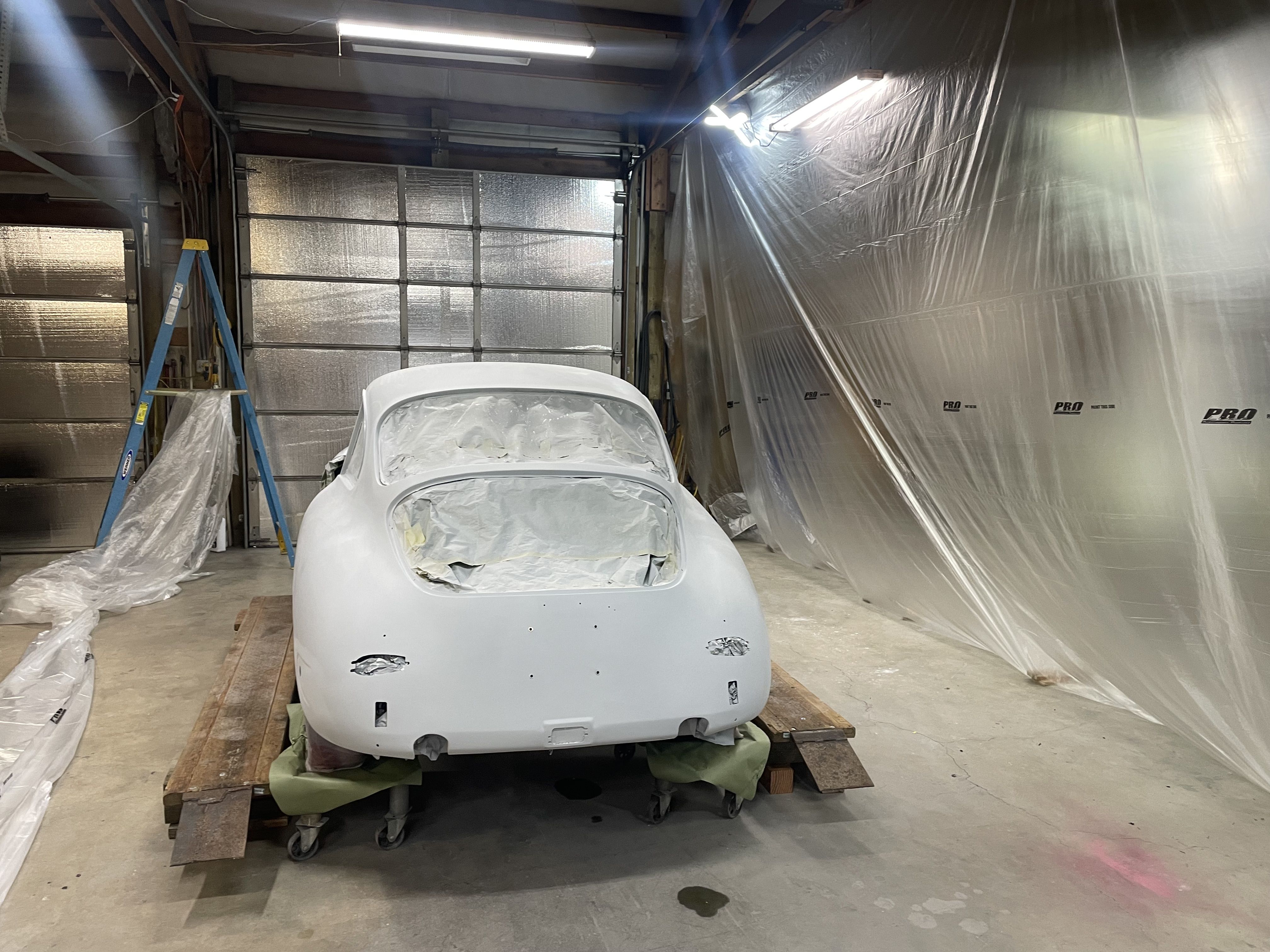

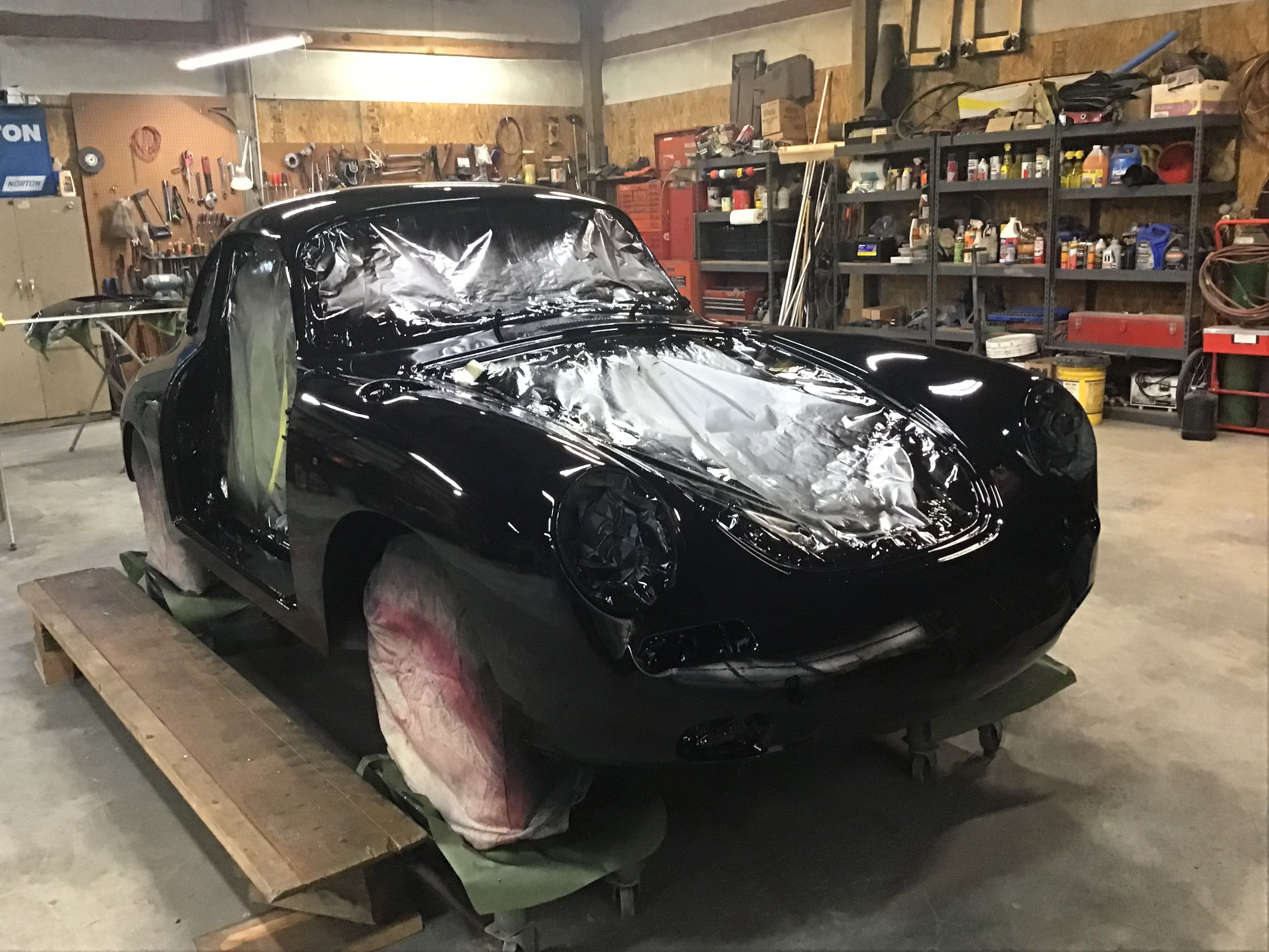

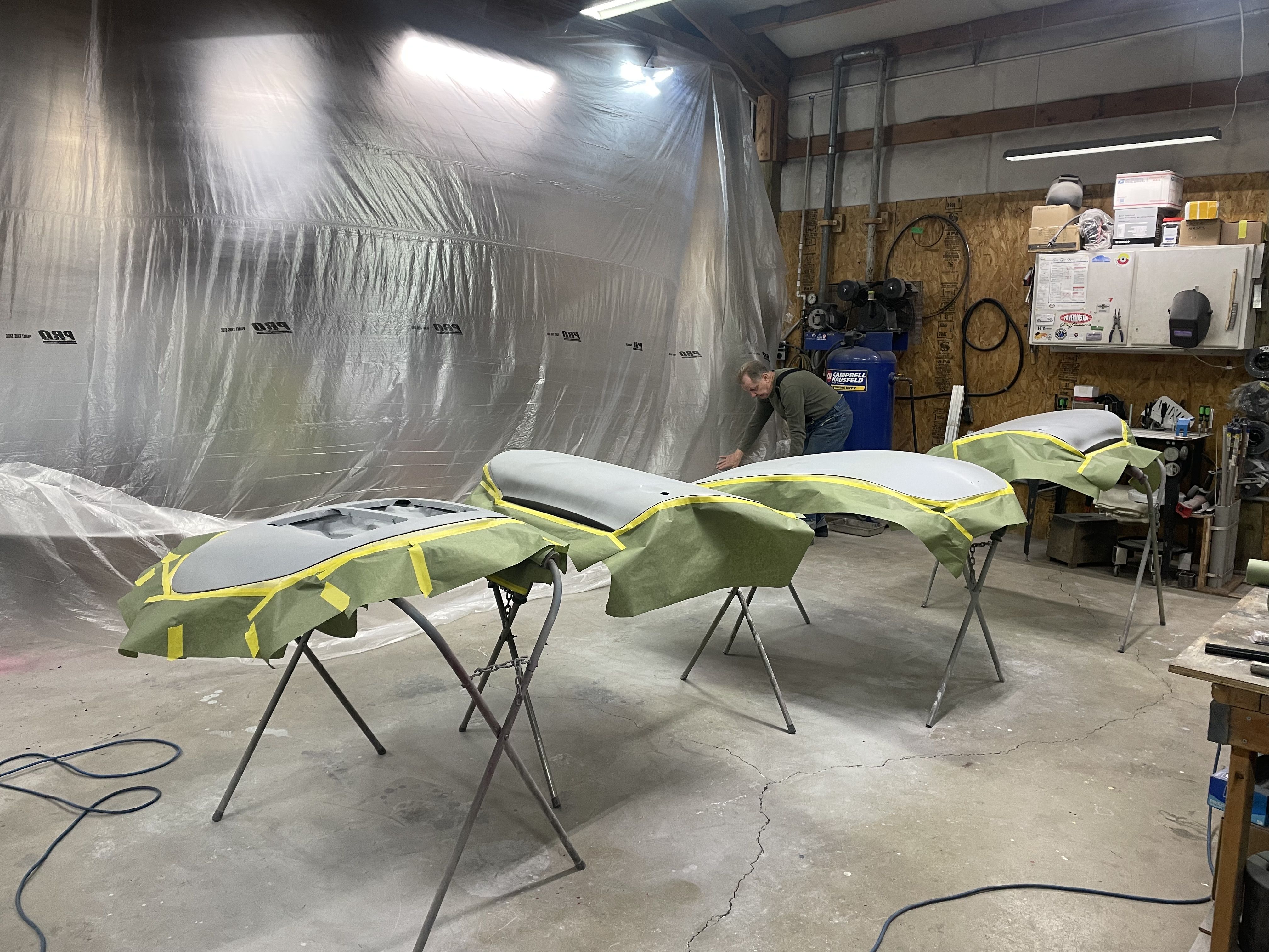

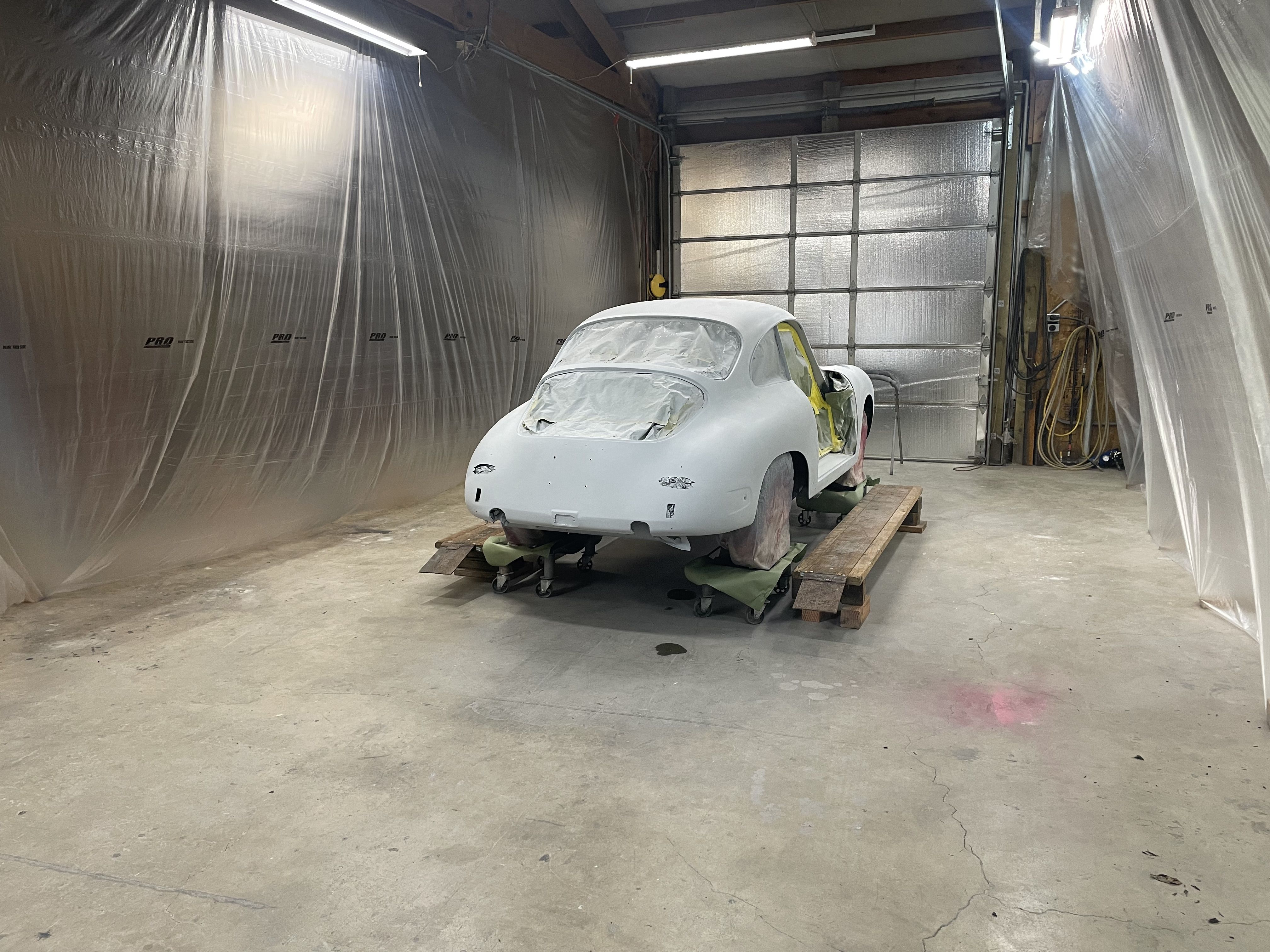

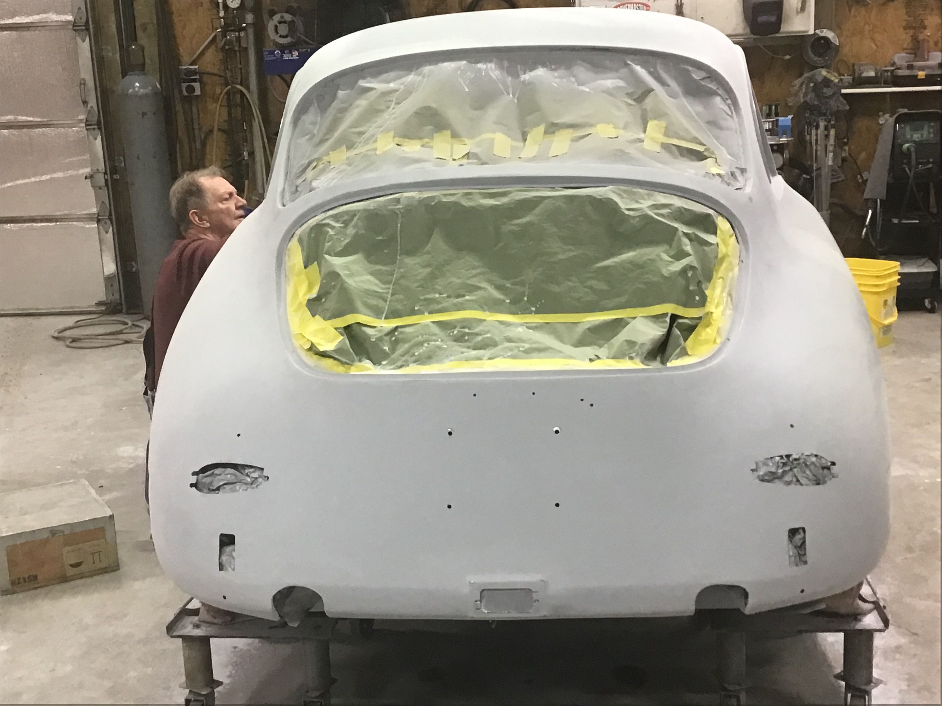

            Plastic is up, shop blown down, floor mopped, dust collectors on. So it sits for a couple days in isolation, at 70-80 degrees to let any more dust settle out of the shop. Then it will get a tac cloth rubdown a couple times, then we paint. Hope to have it new Black on by Sunday. It’s glass smooth and absolutely flat and smooth. Fingers crossed.
ID:	116097 Click image for larger version
              That's the way my Father did it back in the 80's. He built himself a booth made of plastic inside his shop just like you're doing. He managed to get pretty clean jobs out of it. I think most of the lint or trash in the paint actually came off of him as he painted. Good planning with those side runners so you can reach the center of the roof without touching the body; or least buy yourself some additional space. Good luck with it!

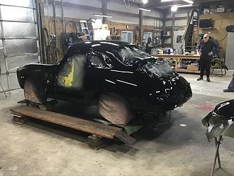

          • #73

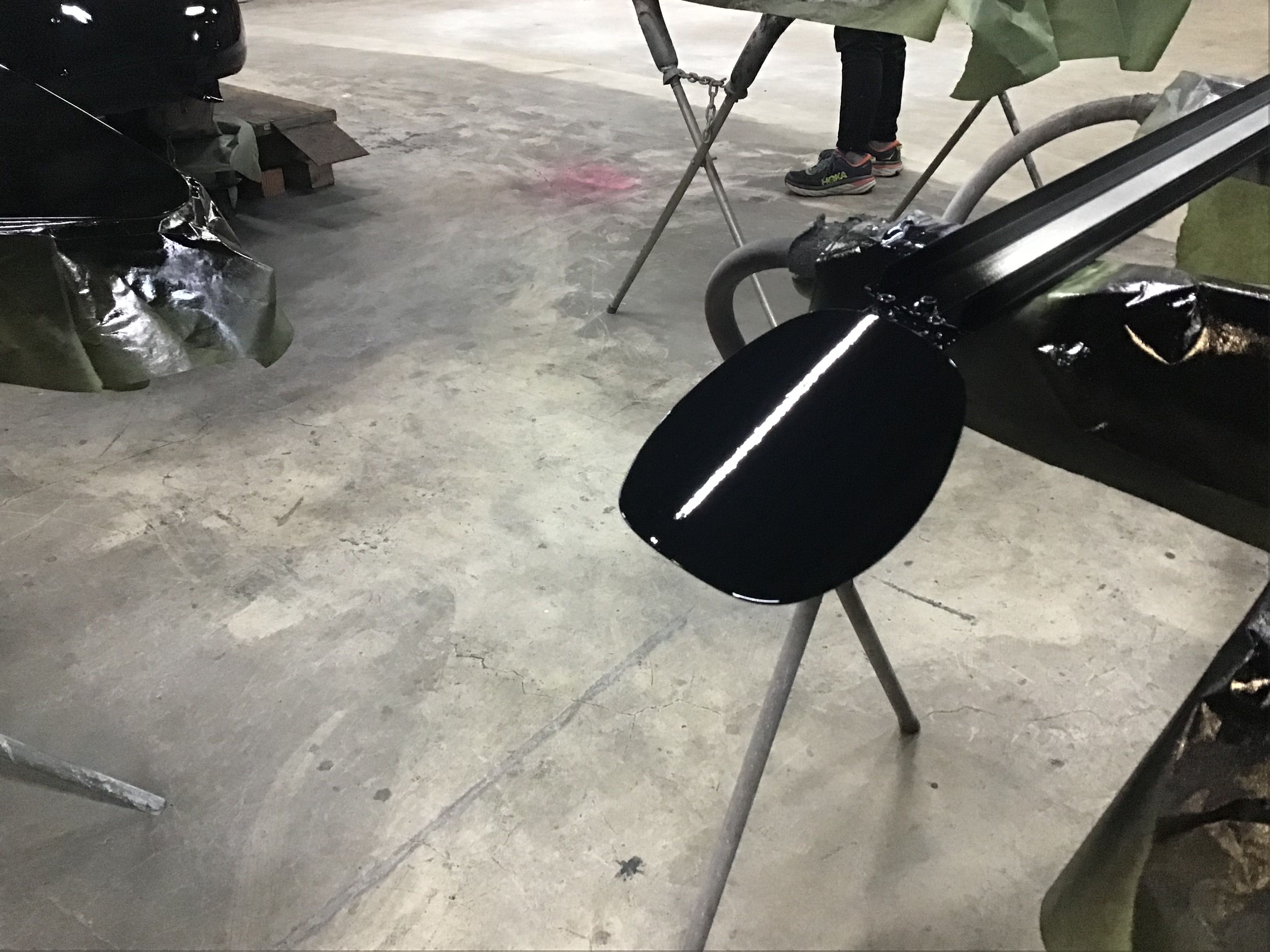

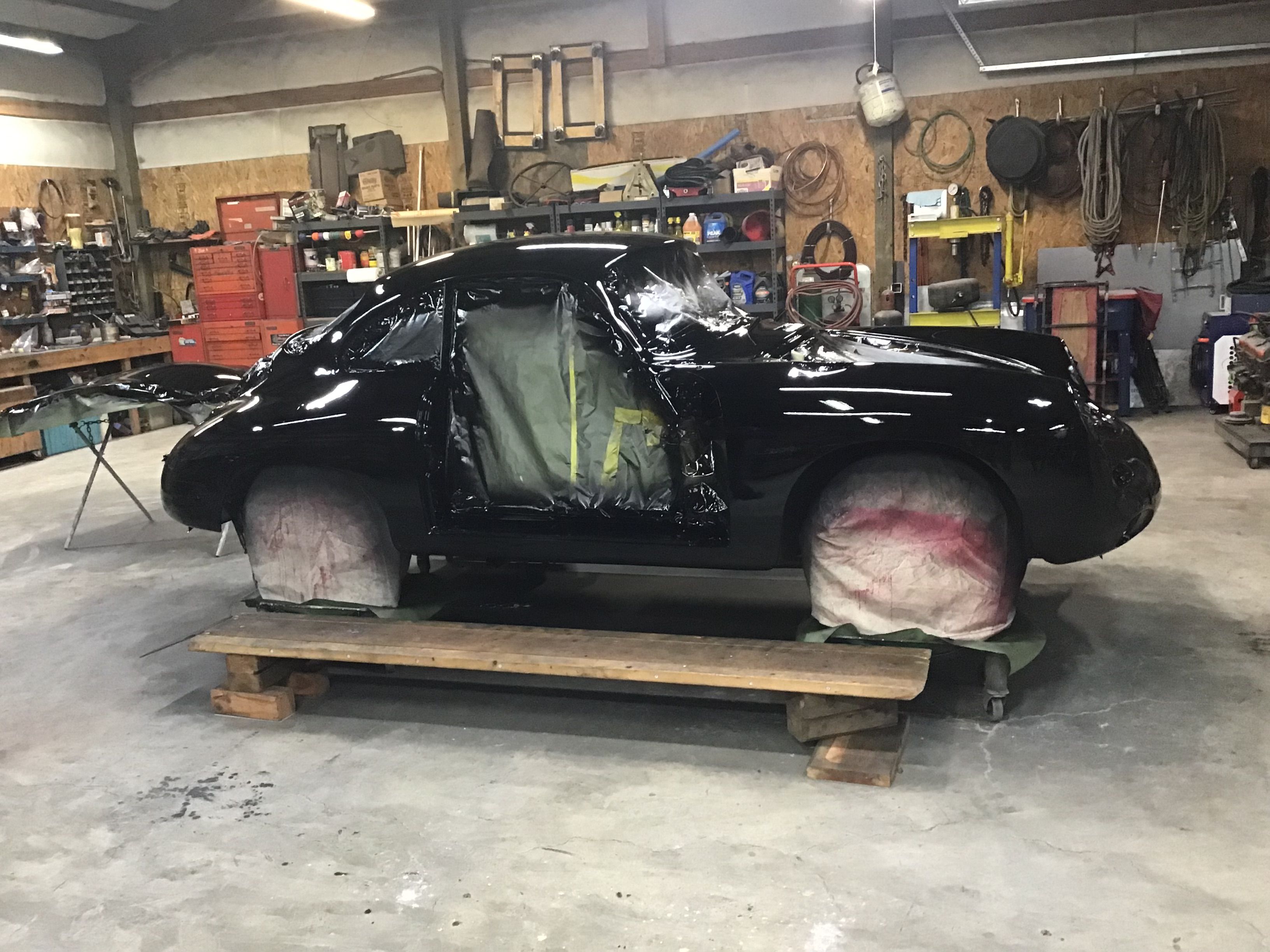

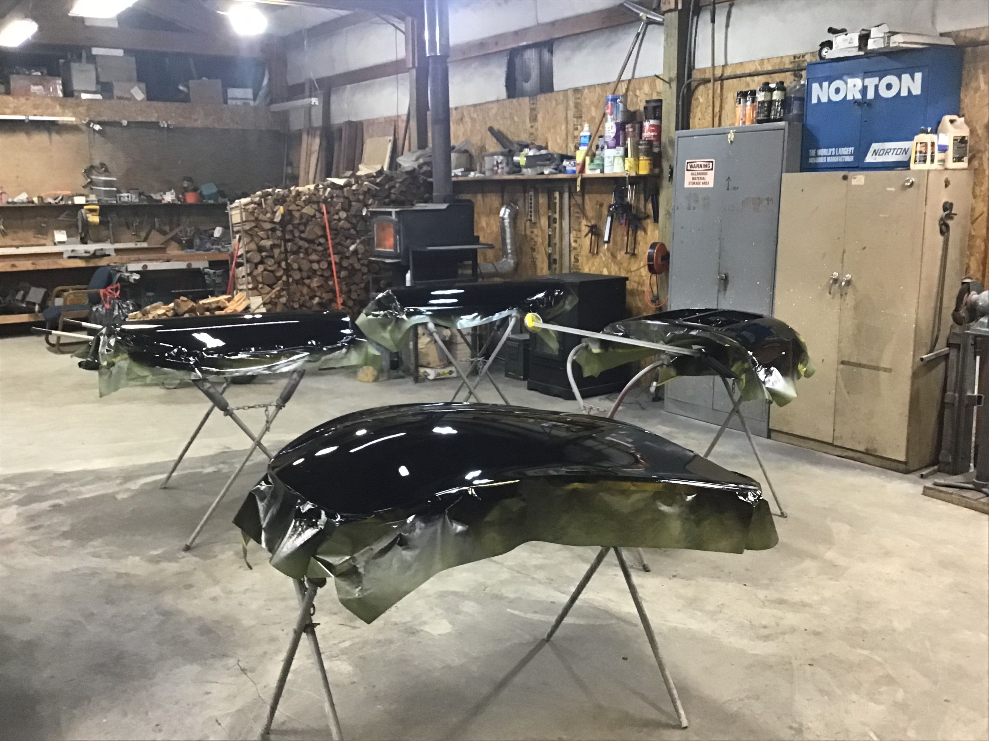

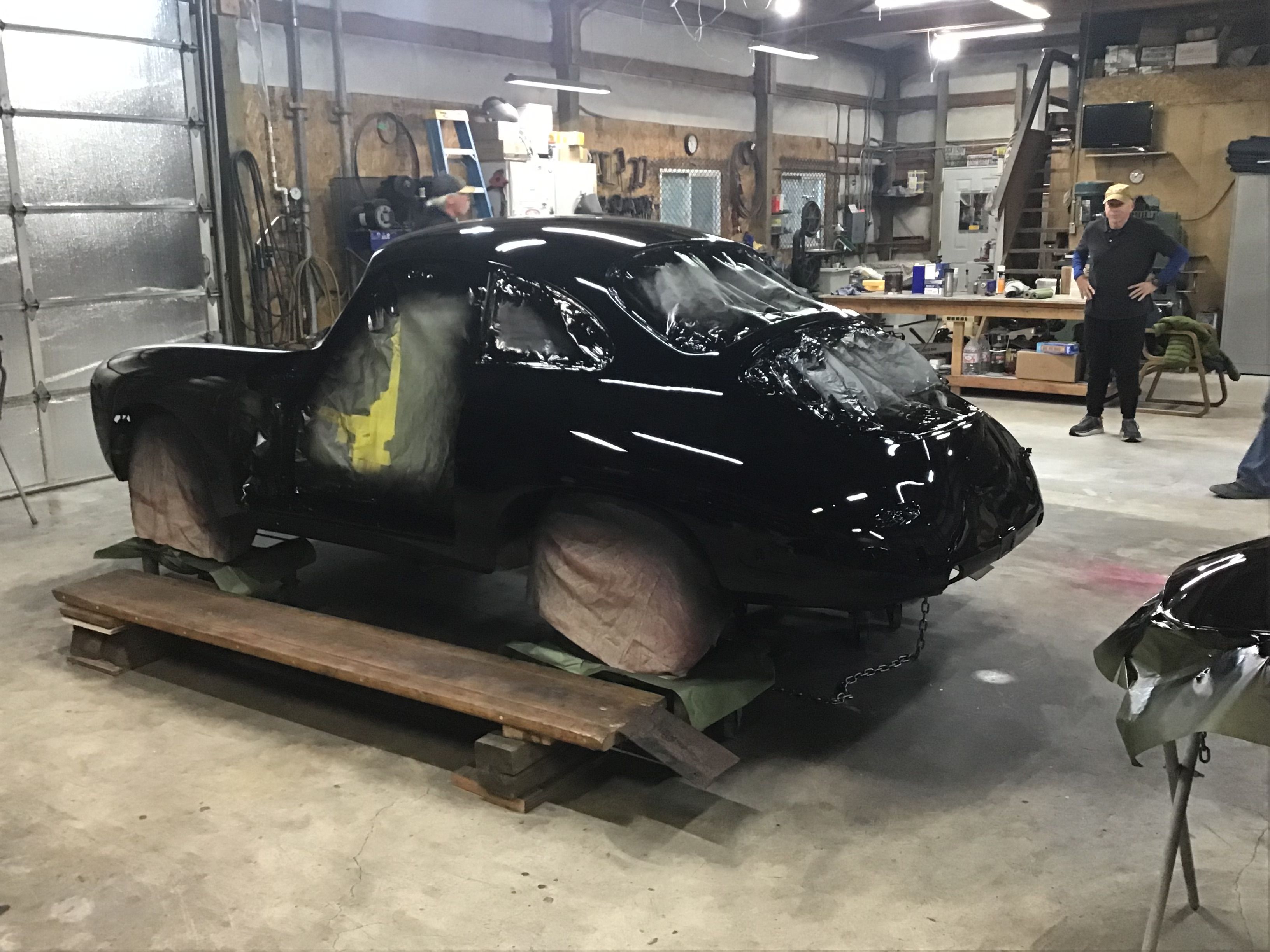

            Well Bob made it all black, came out nice and smoother that original. The body is super straight and flat so the black looks amazing. I am not a big fan of black, but this one it’s one of the best I have seen. All the extra prep really paid off, this black is amazing. Now for a week to let it cure out and we can start the reassembly process getting it back together will be a couple weeks. Then I will drive it for a couple hundred more miles, the service and finally delivery.
ID:	116104 Click image for larger version
ID:	116105 Click image for larger version
              The guy with his hands on his hips in your fourth photo says it all. The big mental pay off of instant gratification culminating from all those hard fought hours of paint prep. It is a magical time just after the fumes clear and the paint kicks making it safe to walk around and admire the finished product. Congratulations she looks great!

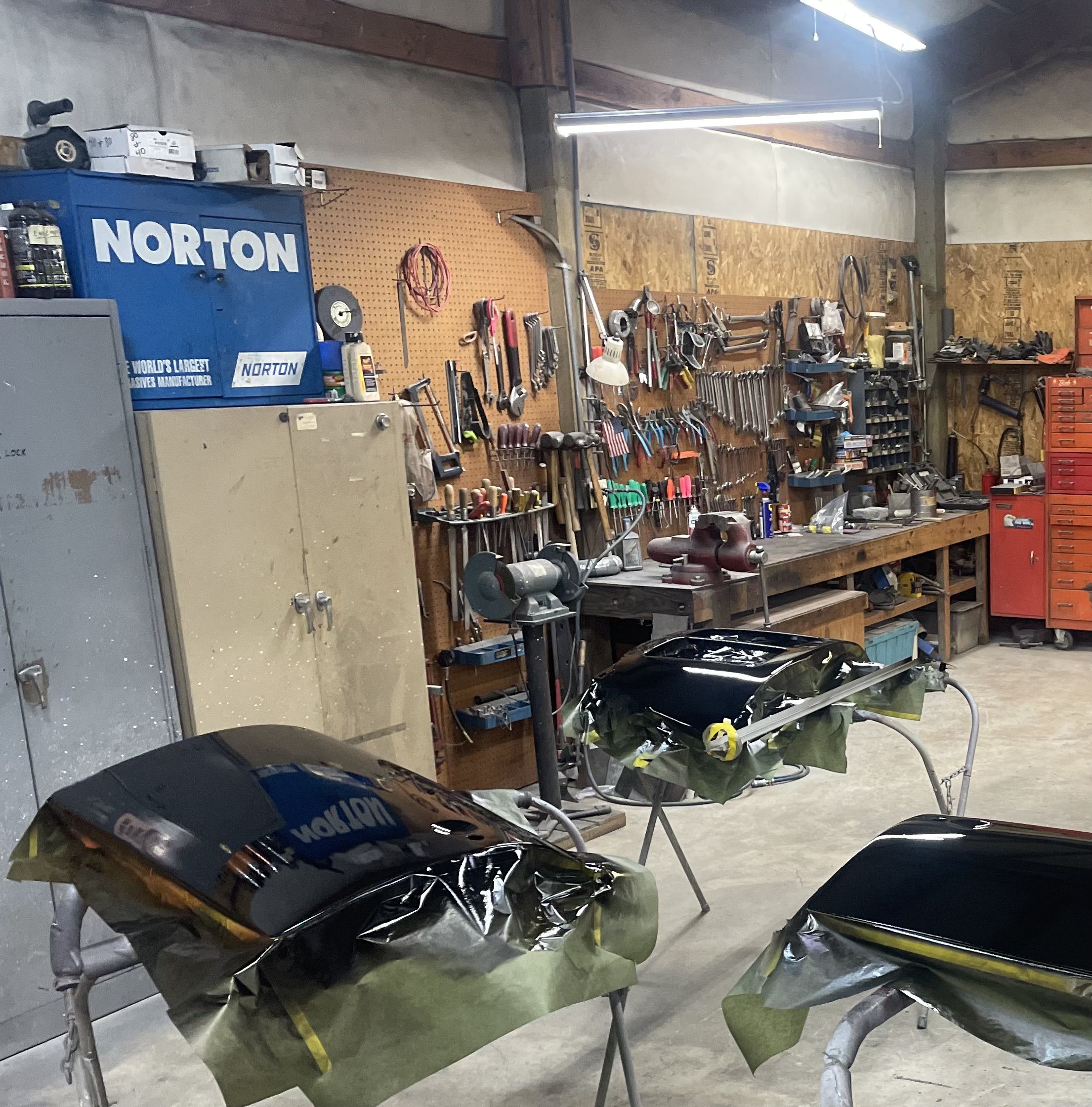

          • #74
            Note the NORTON reflection in the door
