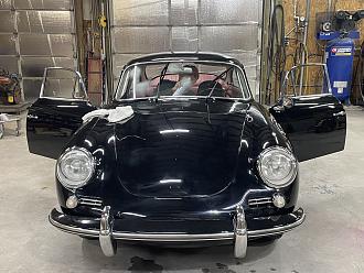

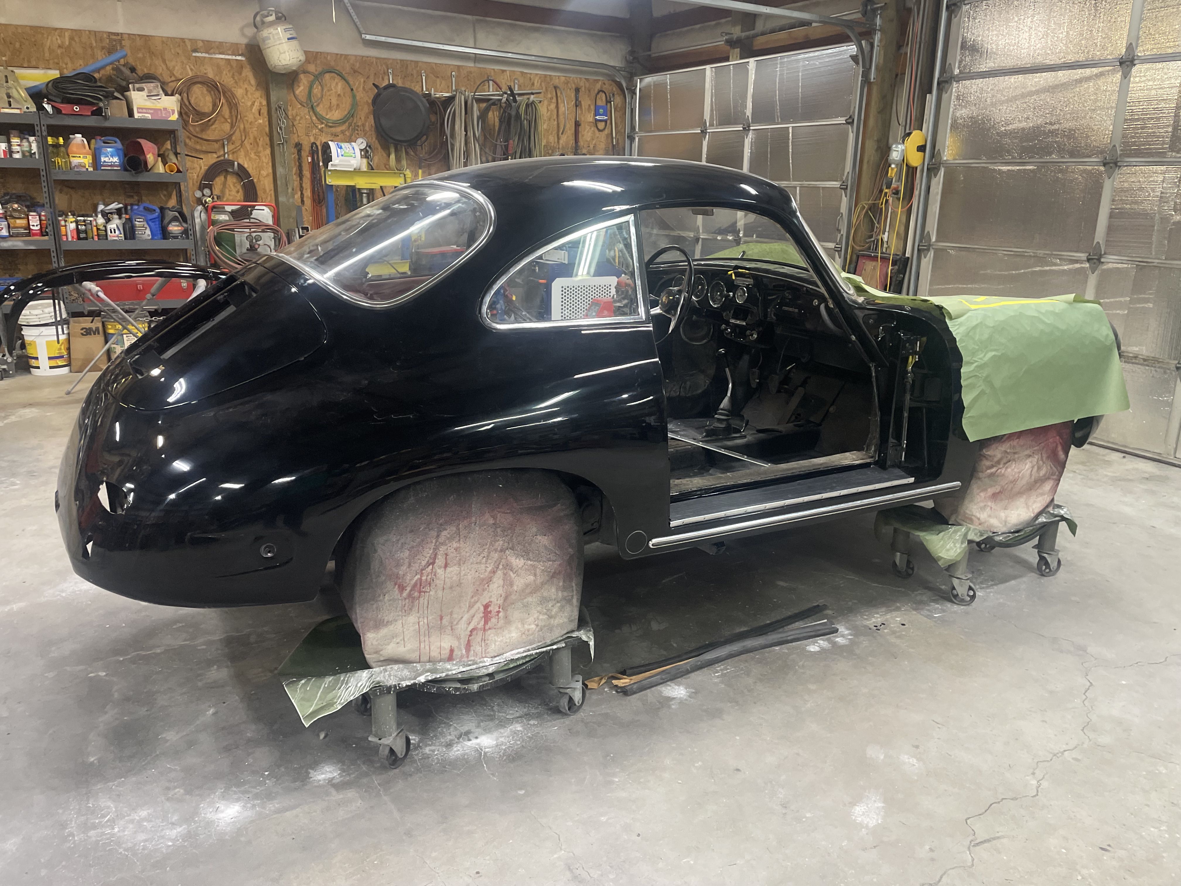

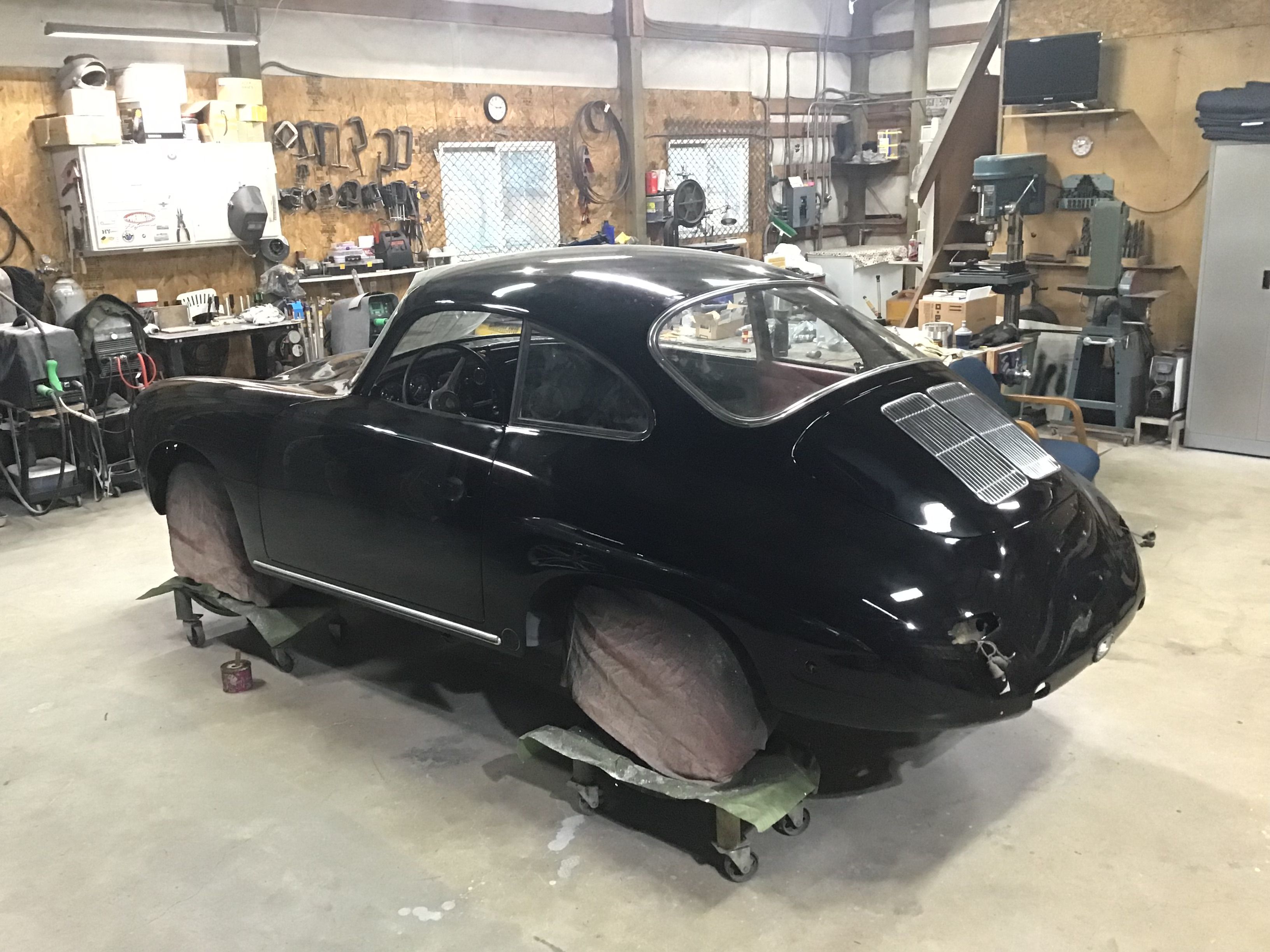

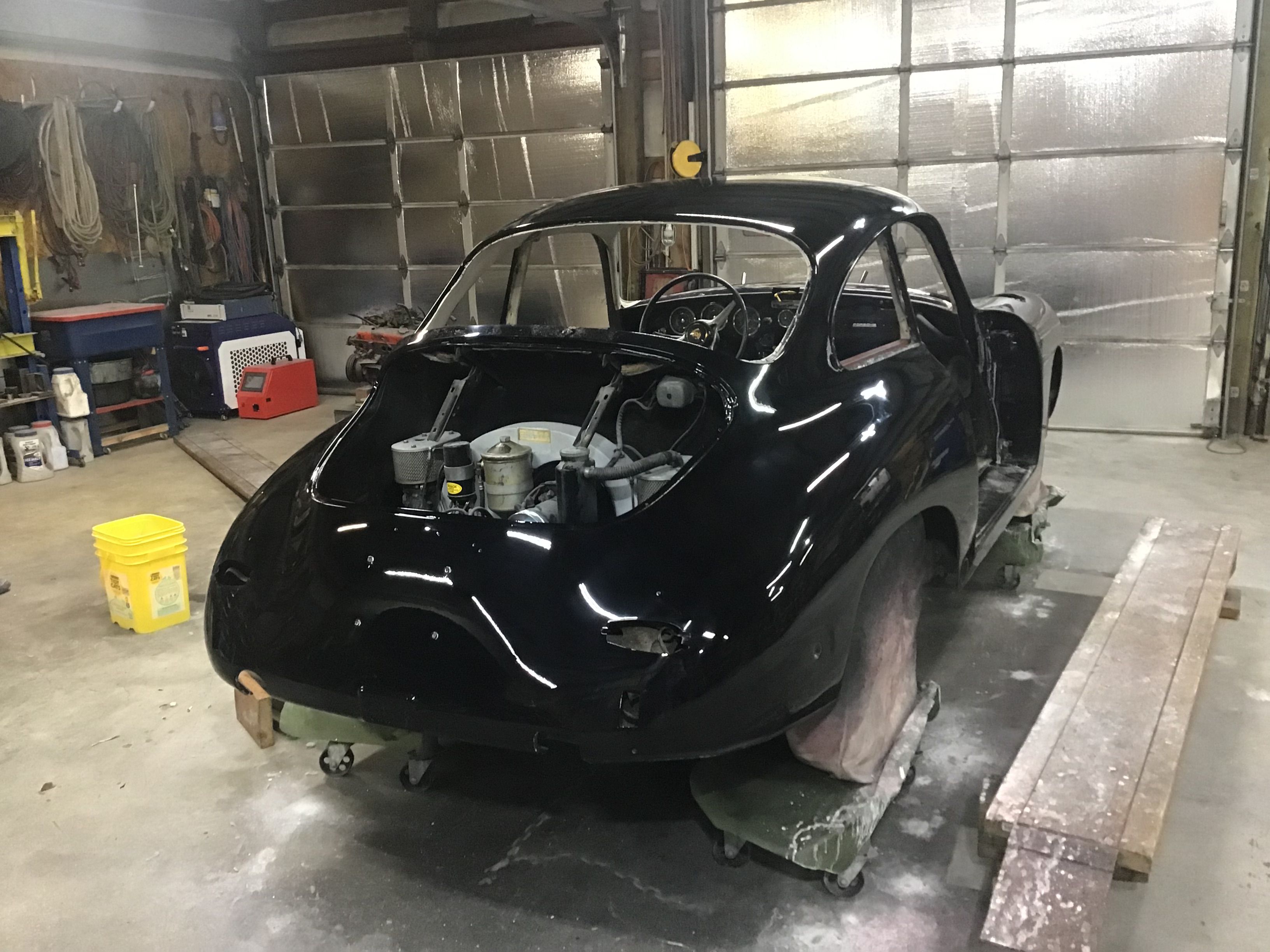

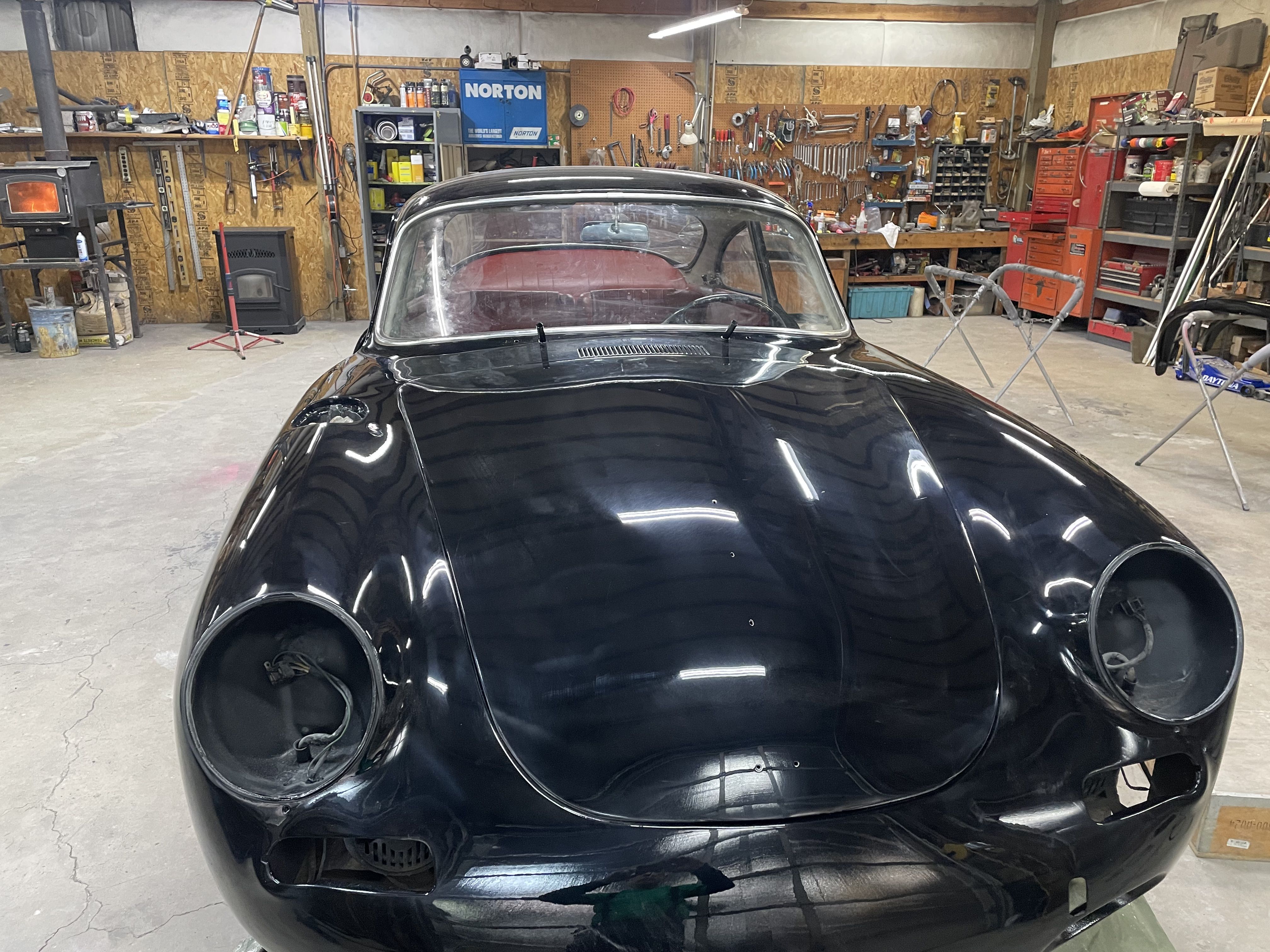

      thanks you are right, starting to put it back together now, should be done before the first of the year . Glass back in, hood and door seals in, deck lid and hood back on. Straying to look like a 356 again.

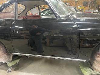

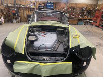

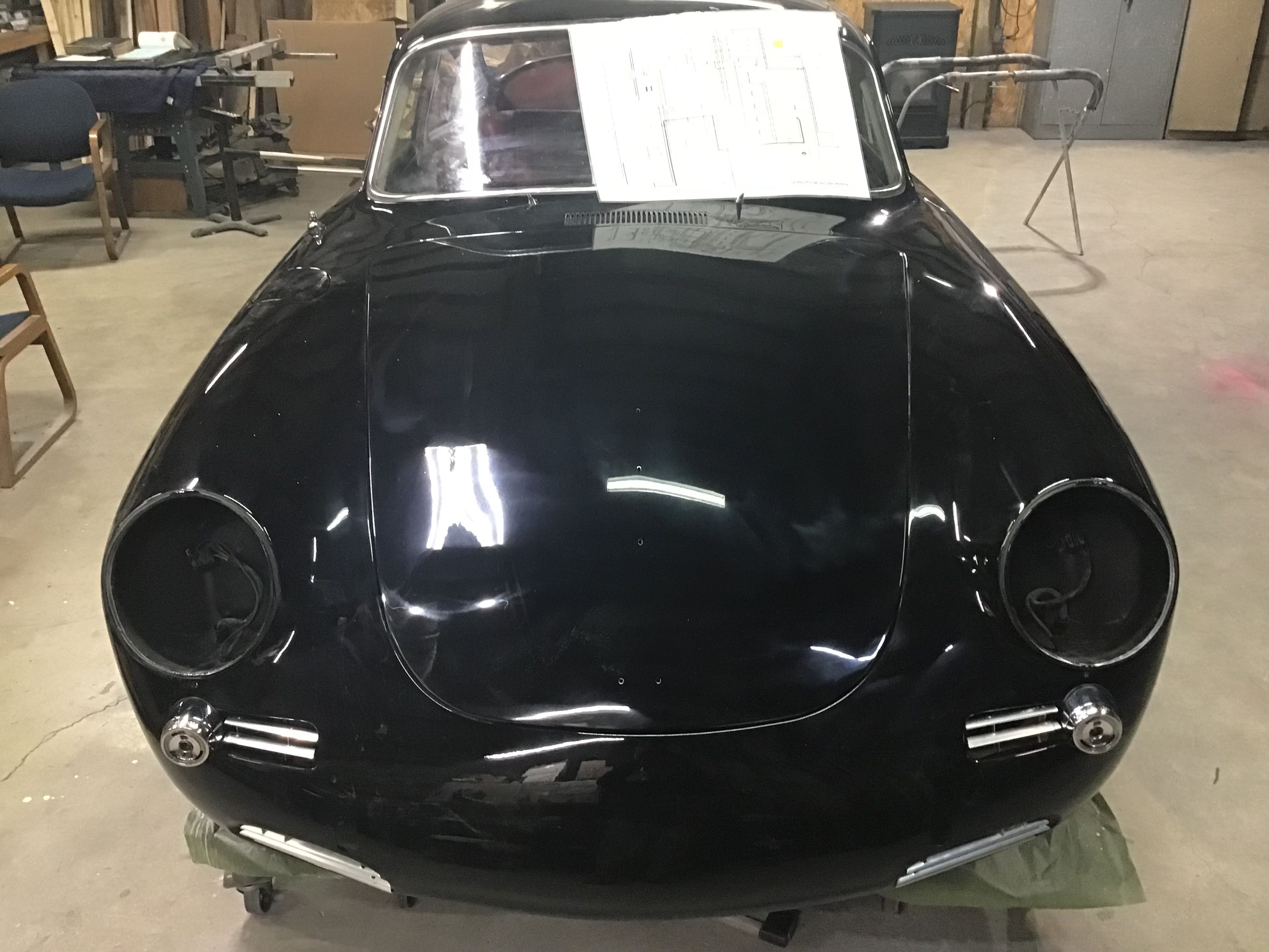

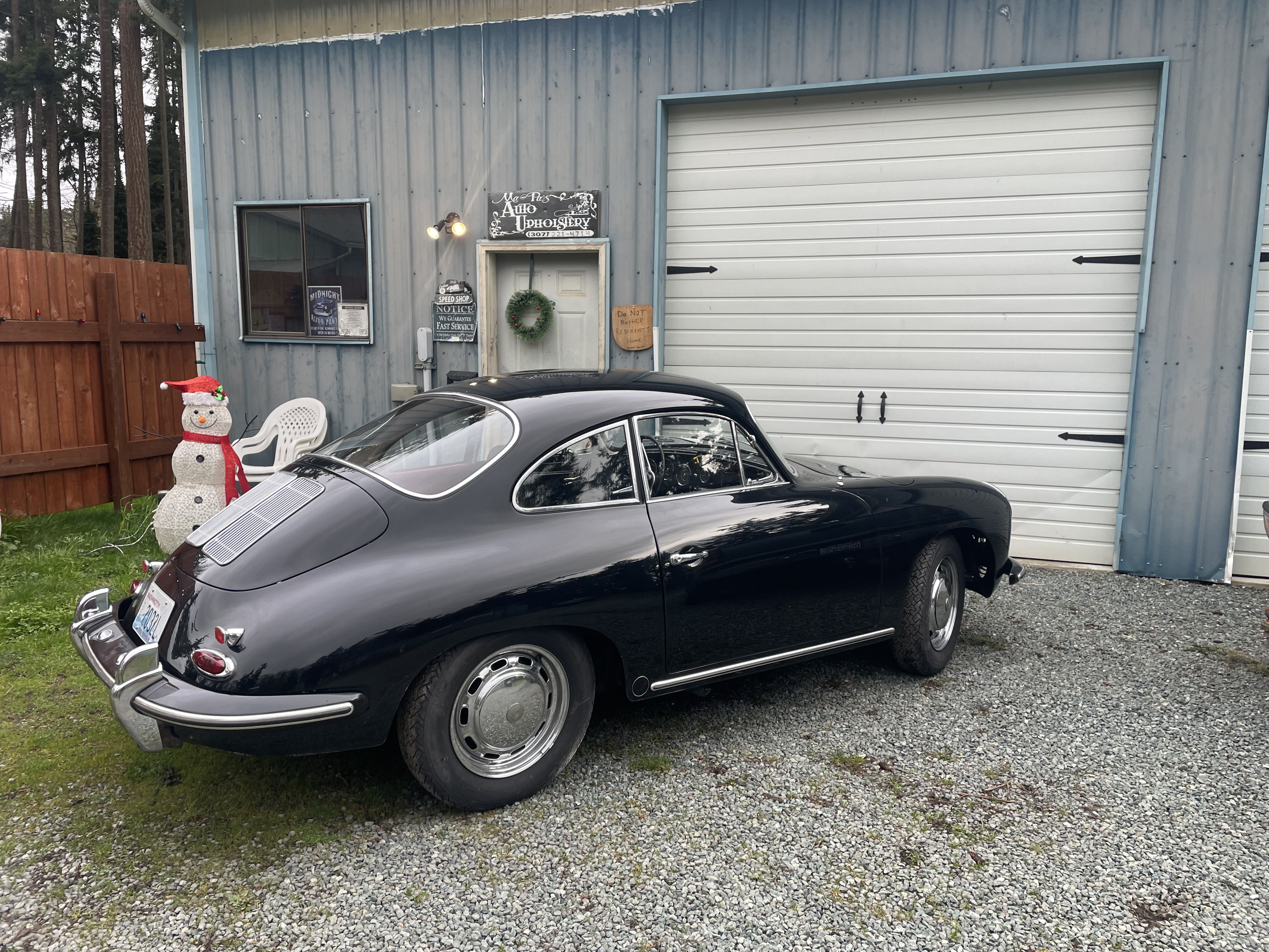

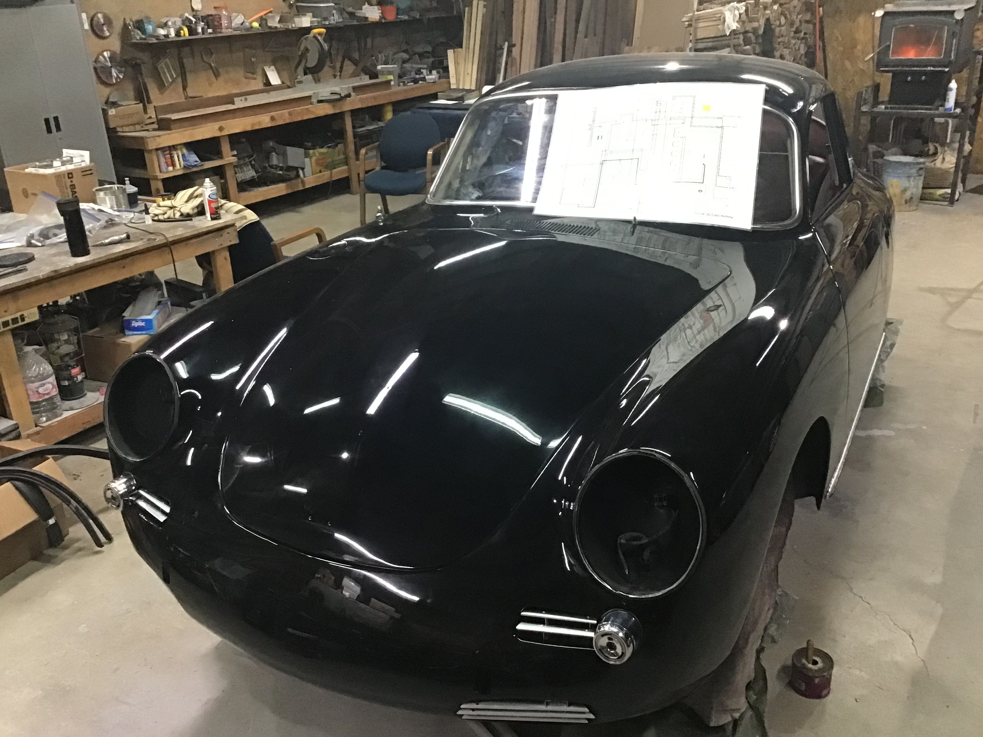

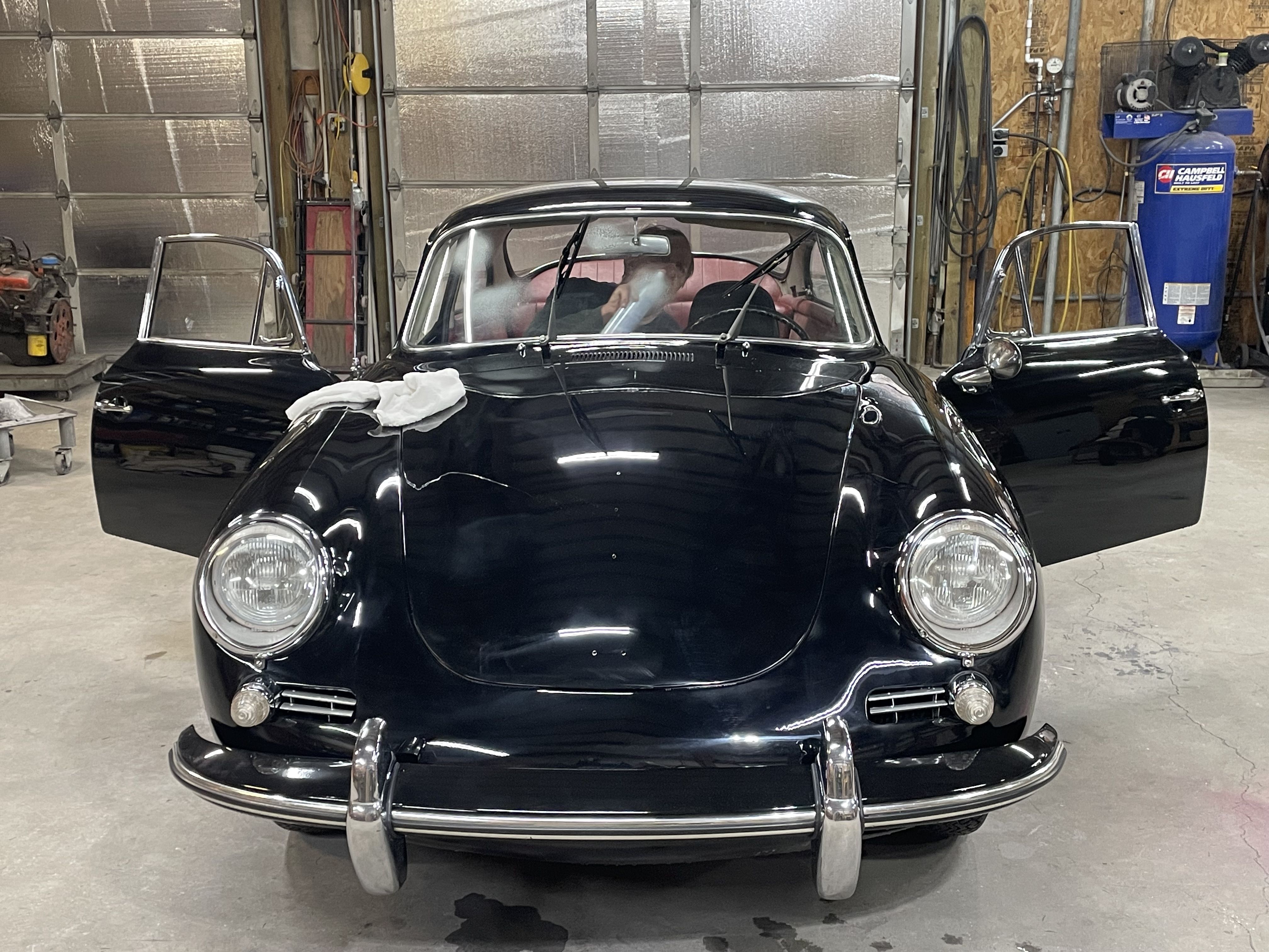

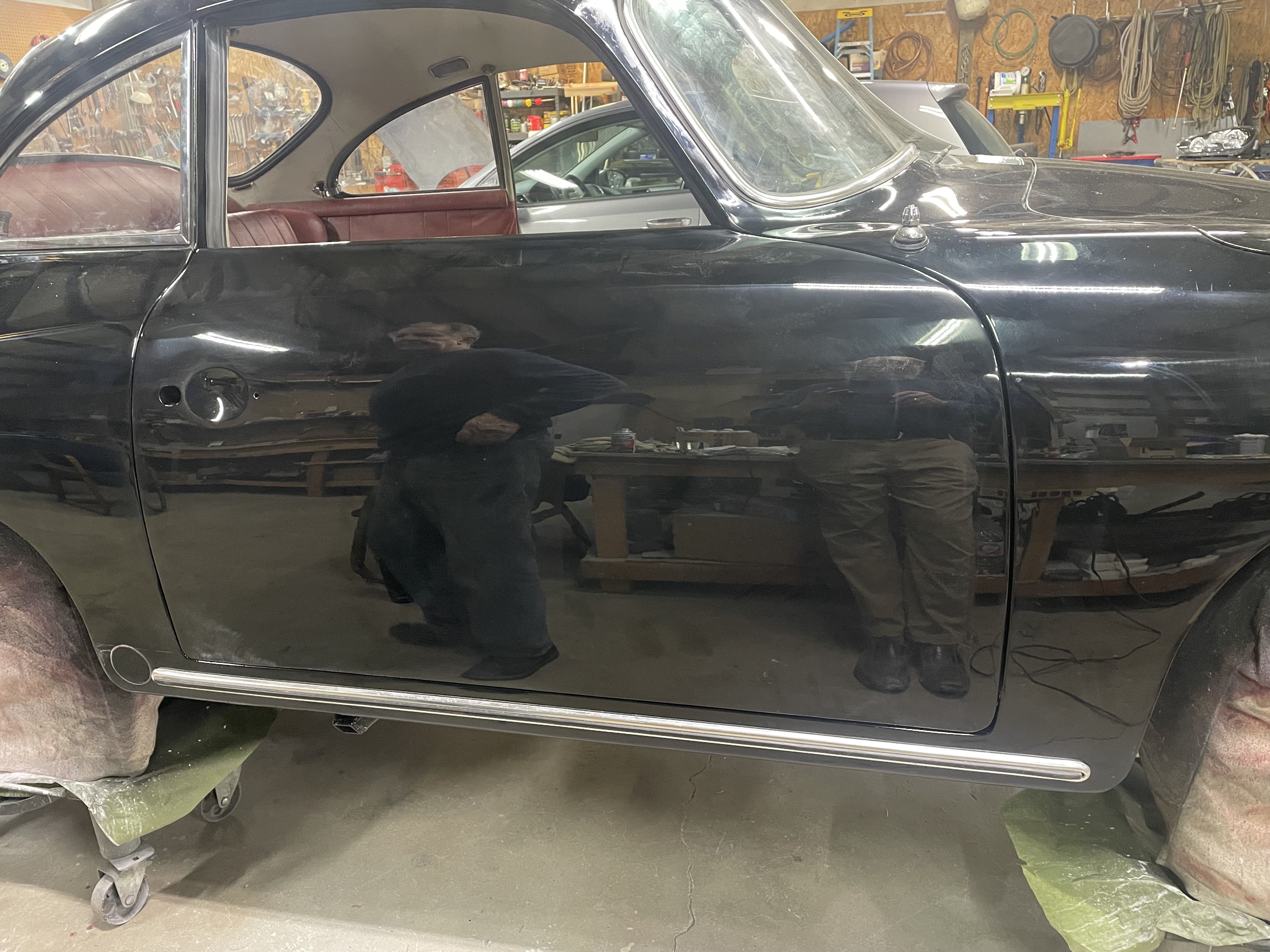

        Reassembling continues, doors on, jewelry begins, cleaning grounds, electrical connections, new rubber seals etc. It’s the little things now and attention to detail. After paint gaps are good, the body is razor straight.

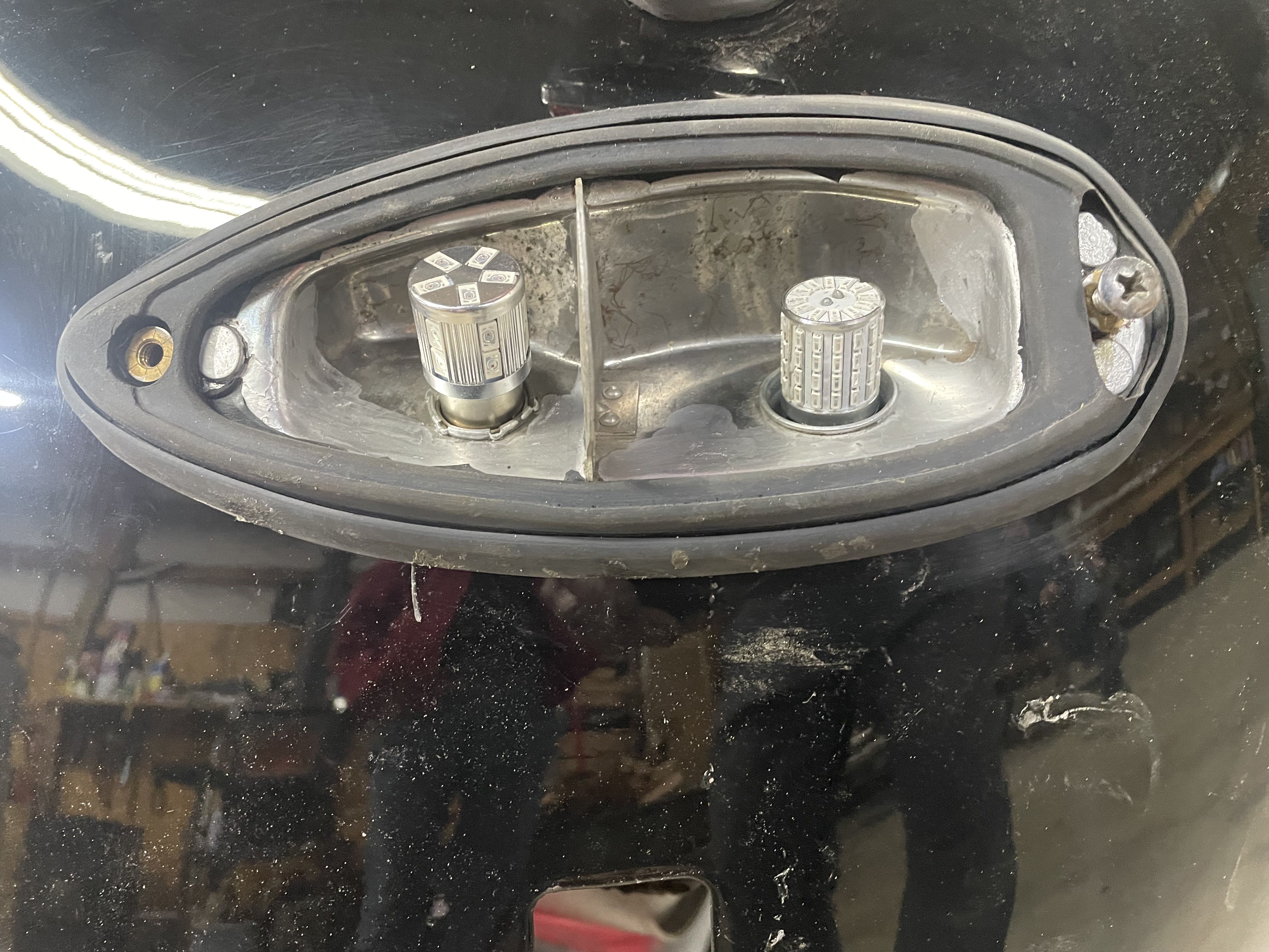

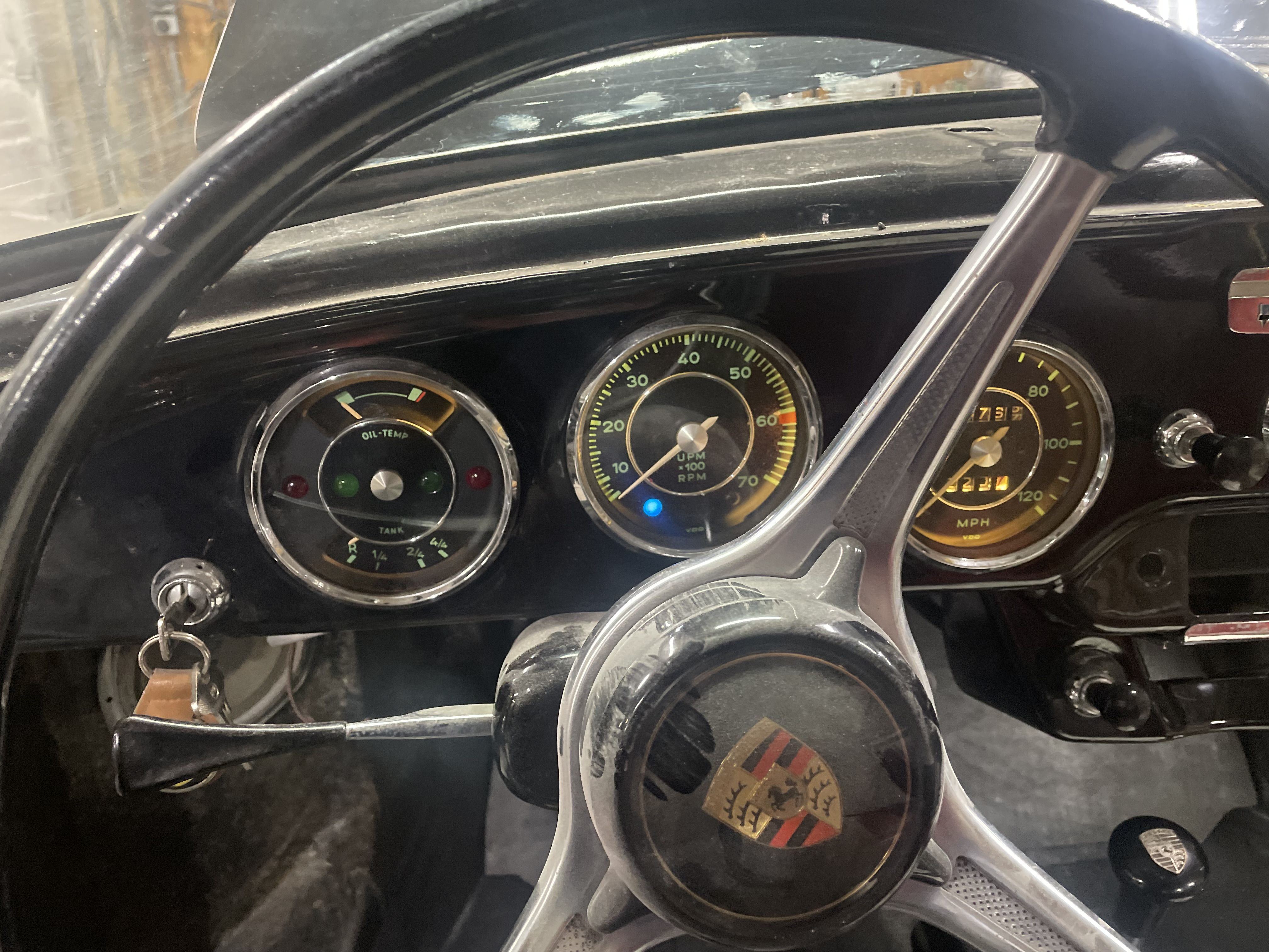

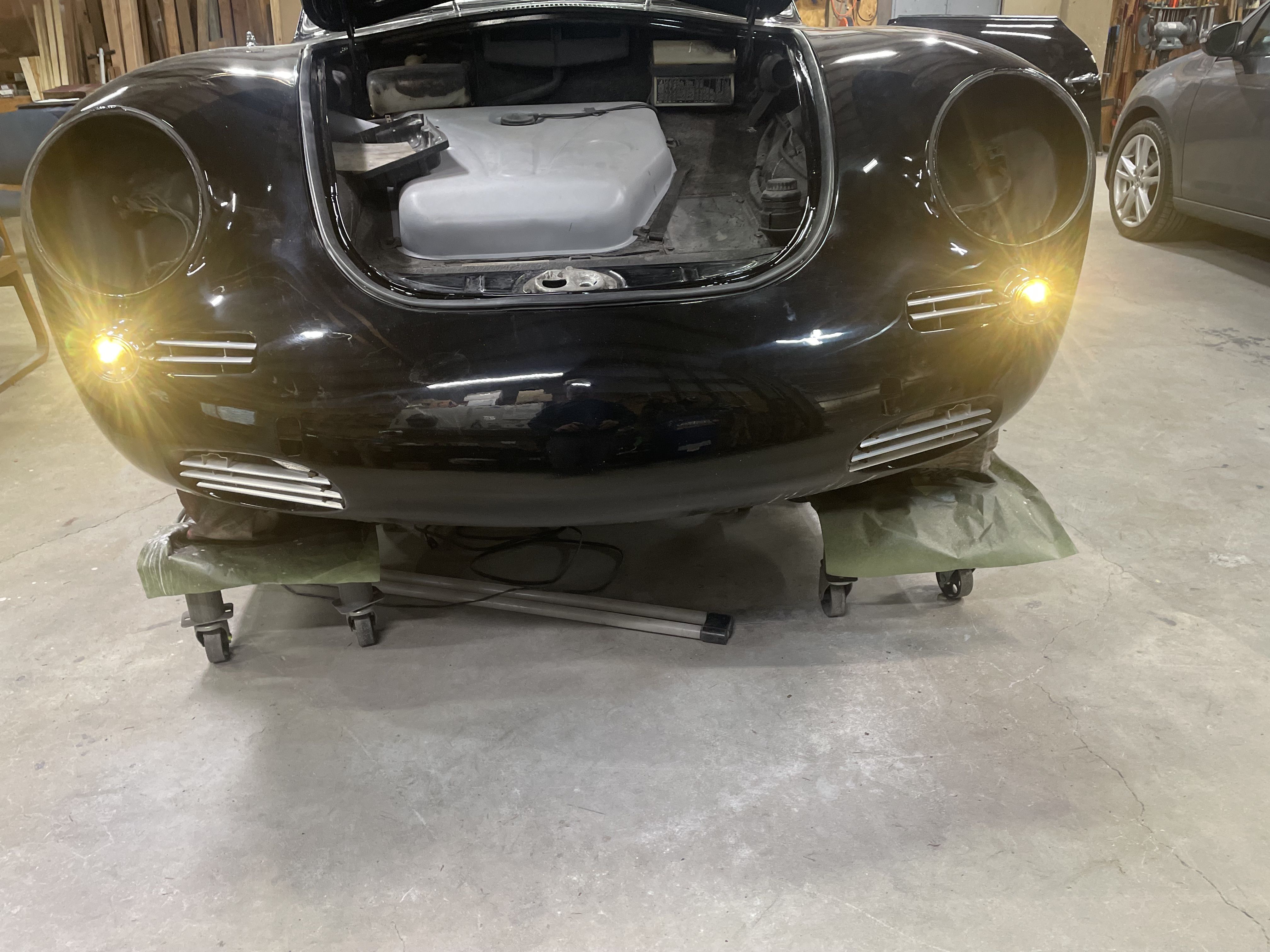

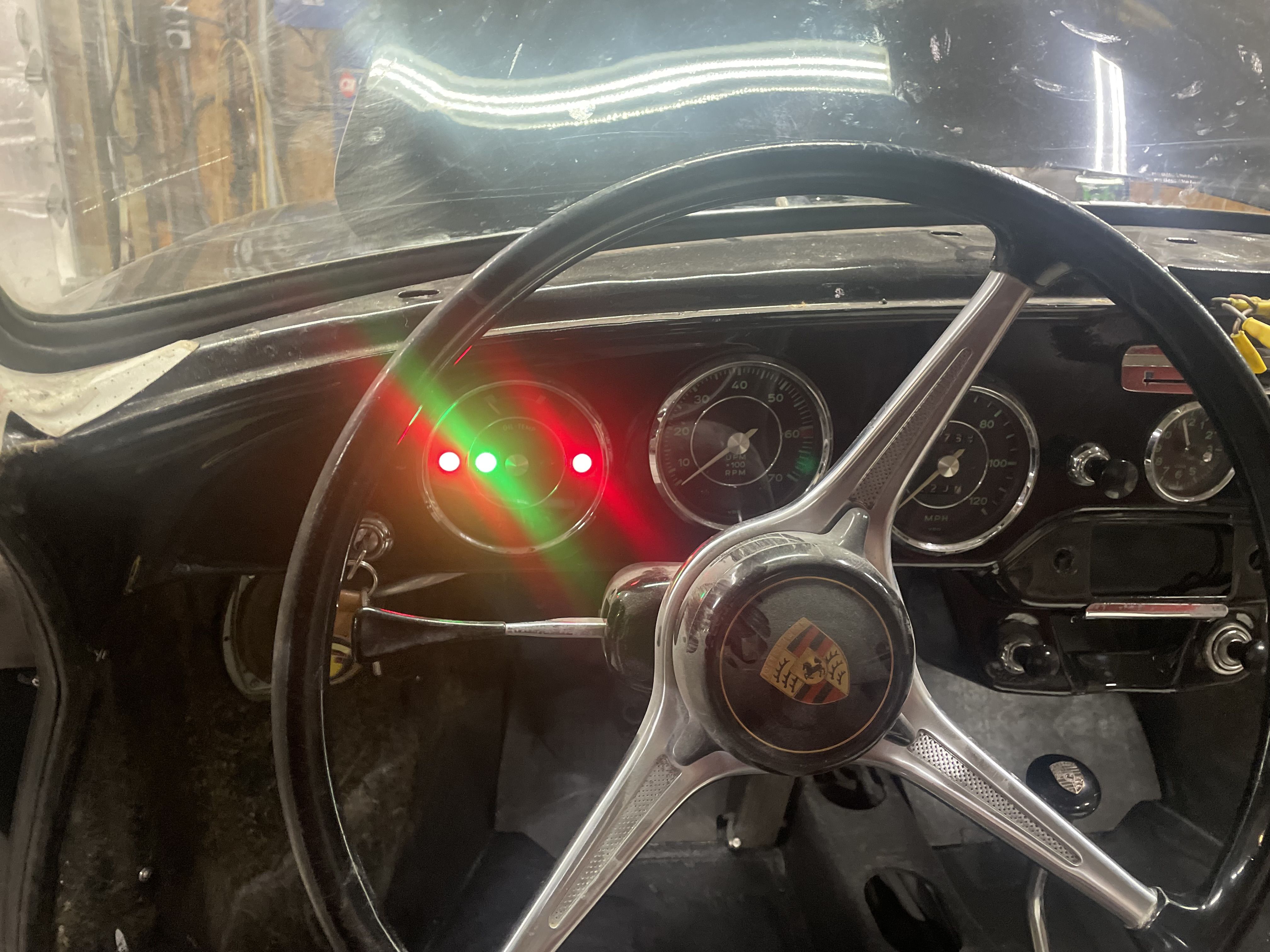

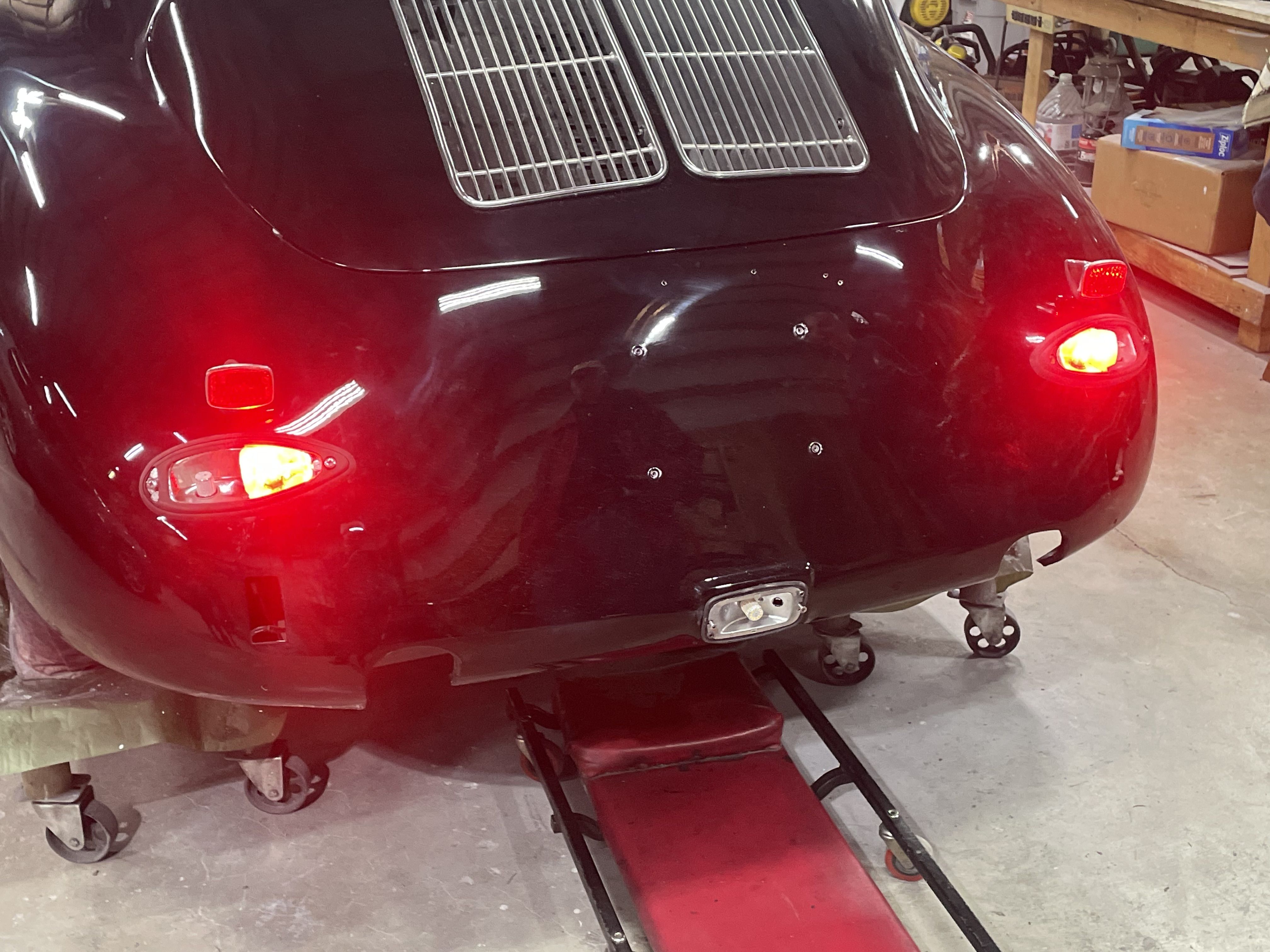

        Today was electrical day, started installing the “Vintage Trader” LED conversation kit. Jules spent a little over a year researching the best LED replacement bulbs available. He makes a complete kit with all the replacements including head lights and killer instrument bulbs.
        I did a similar kit a few years ago, I used Chinese LEDs from EBay. I just searched the SAE base style and 6v LED. They are adequate , but only 40-50% brightness and quality of the Vintagetrader.com kits. Note the brightness of the small front parking bulbs, spectacular!

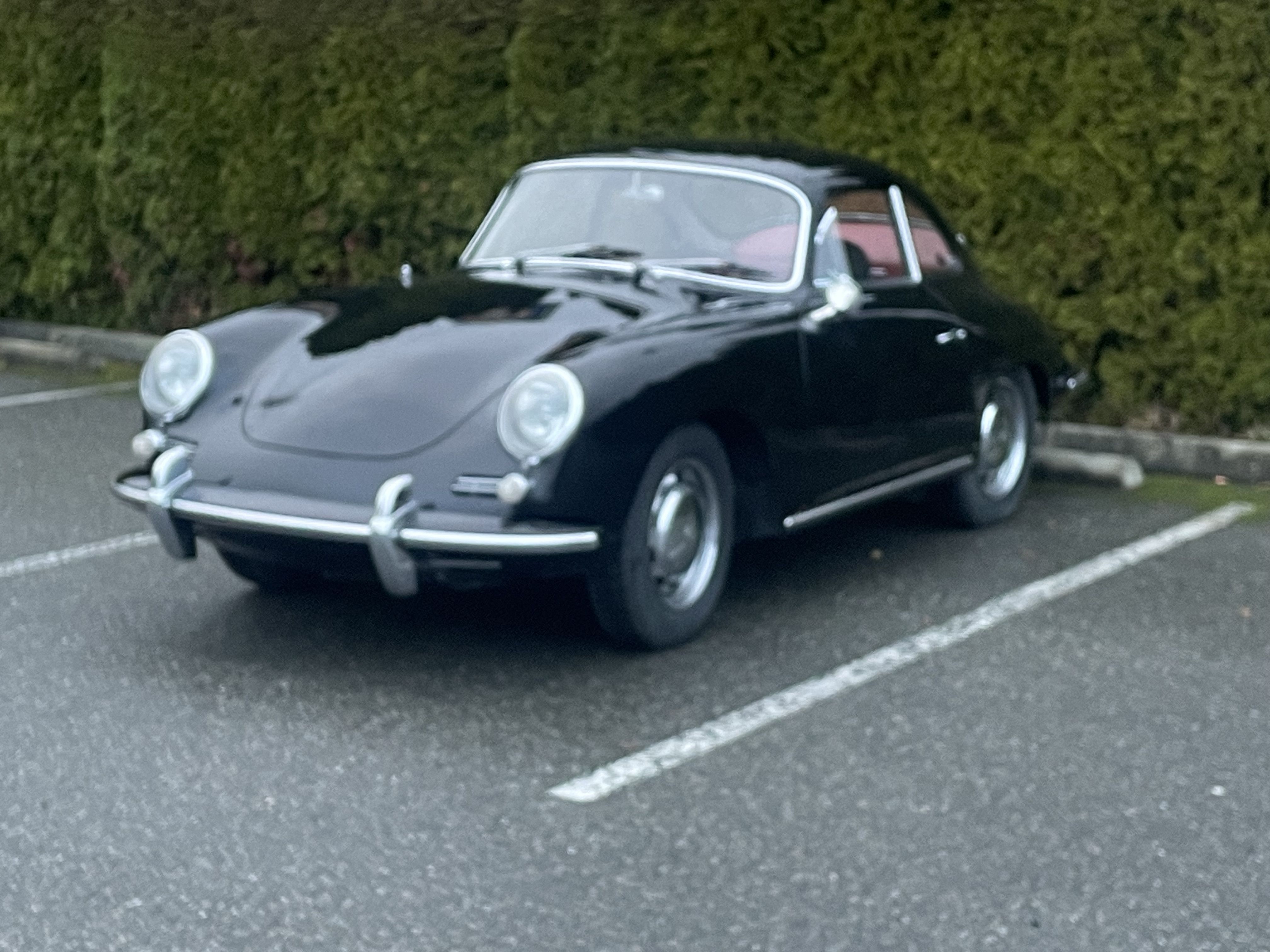

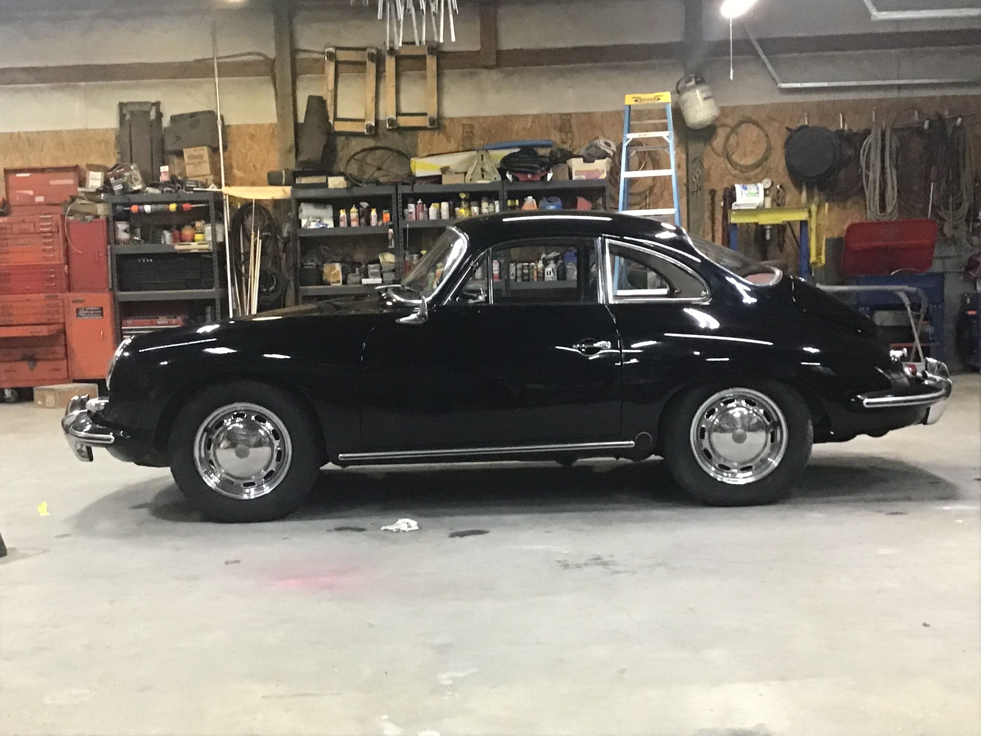

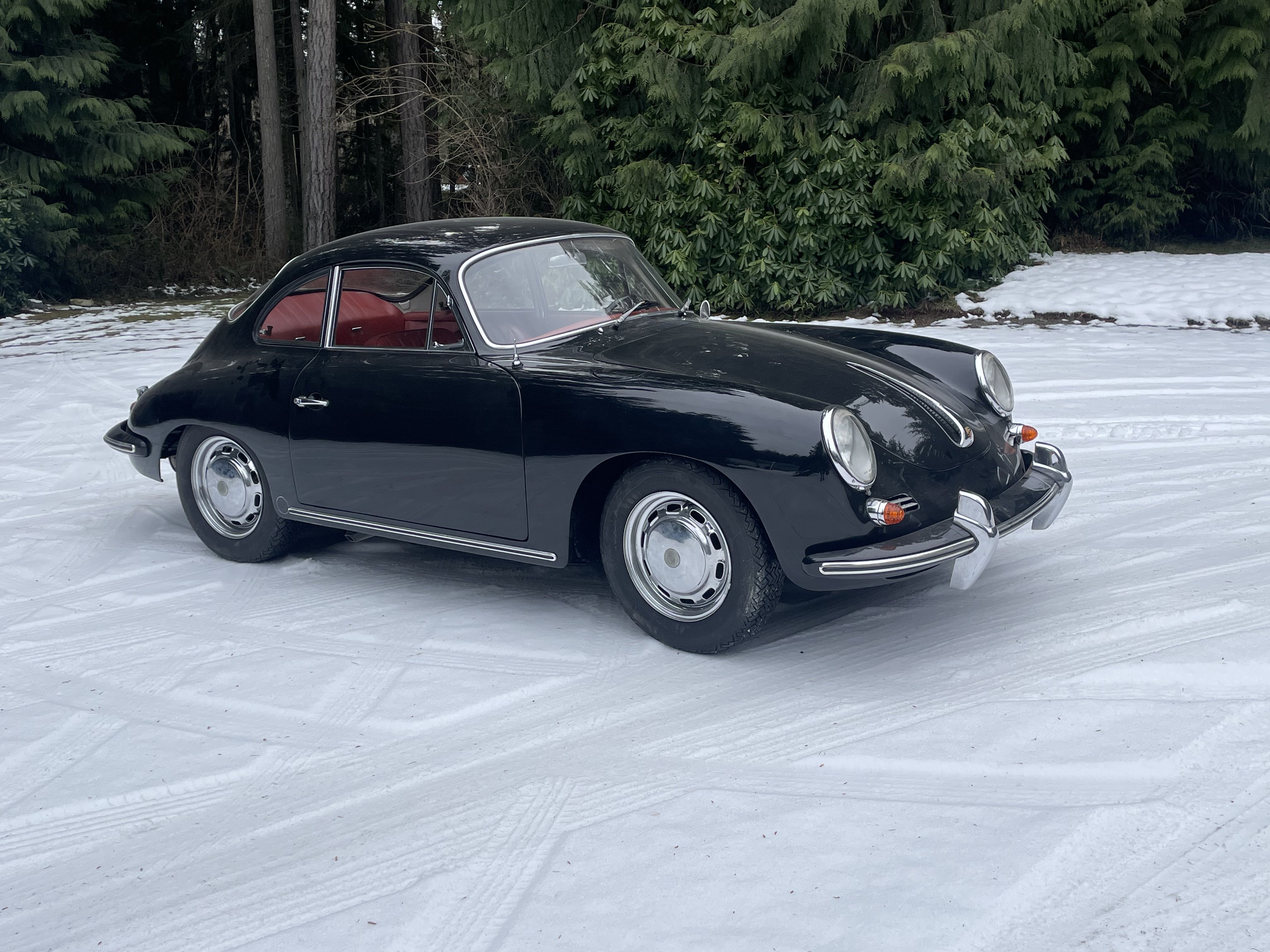

        We’re getting close, did the factory water hose leakage test on the seals this afternoon, all is well and dry….
        Then drove it about 10 miles got the oil up to temp, rides well, handles as expected, stops straight. Looking good, now back to upholstery shop for a couple weeks

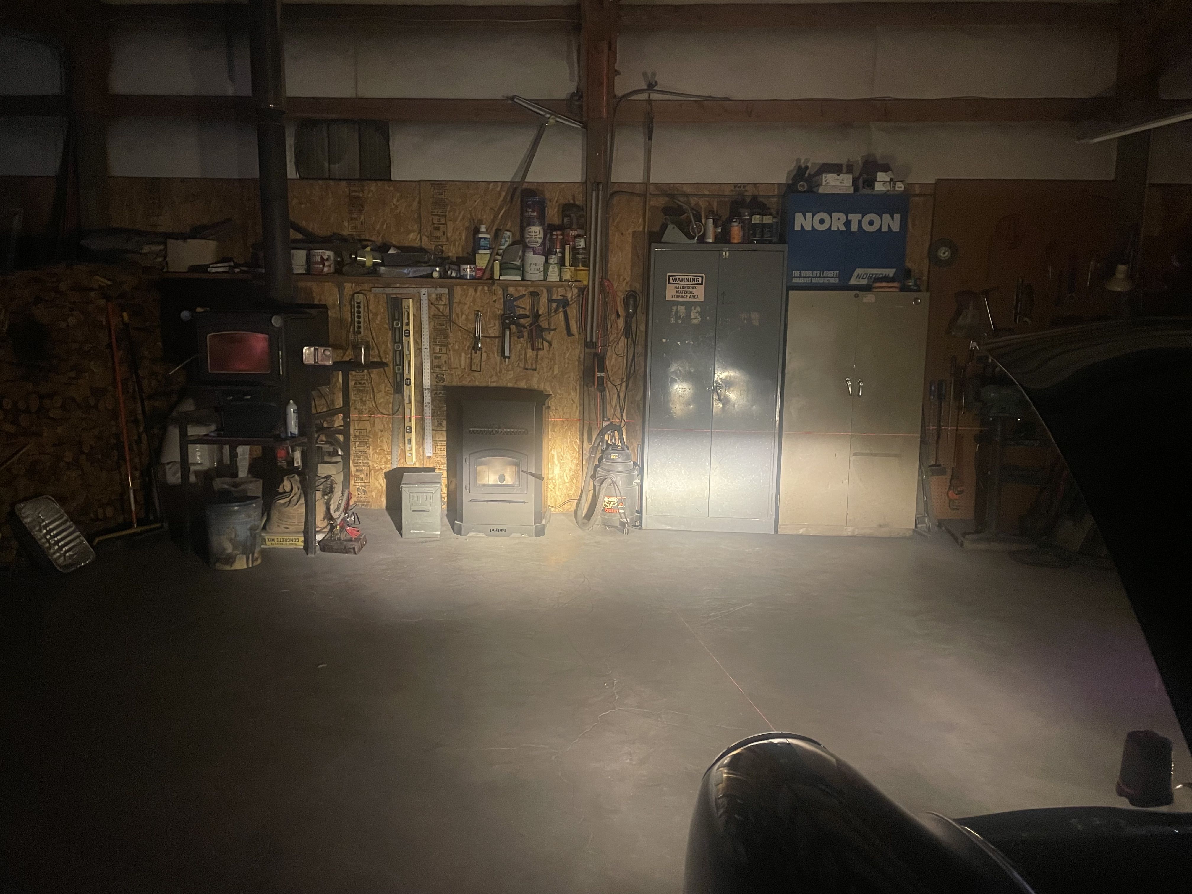

        Put the laser on the new led headlights, got them adjusted, you can see the red center line hight on the wall. Hood adornment is the last thing to go on, after cutting the paint. . Drove it to the local car club today and then off to the upholstery shop to install the interior. Ran fine, big hit with the locals, with fresh paint. Looks like a new car now. So it will be with the interior guy for a week or so, then back for a service and some more driving miles of shakedown. But she’s getting close to the end.

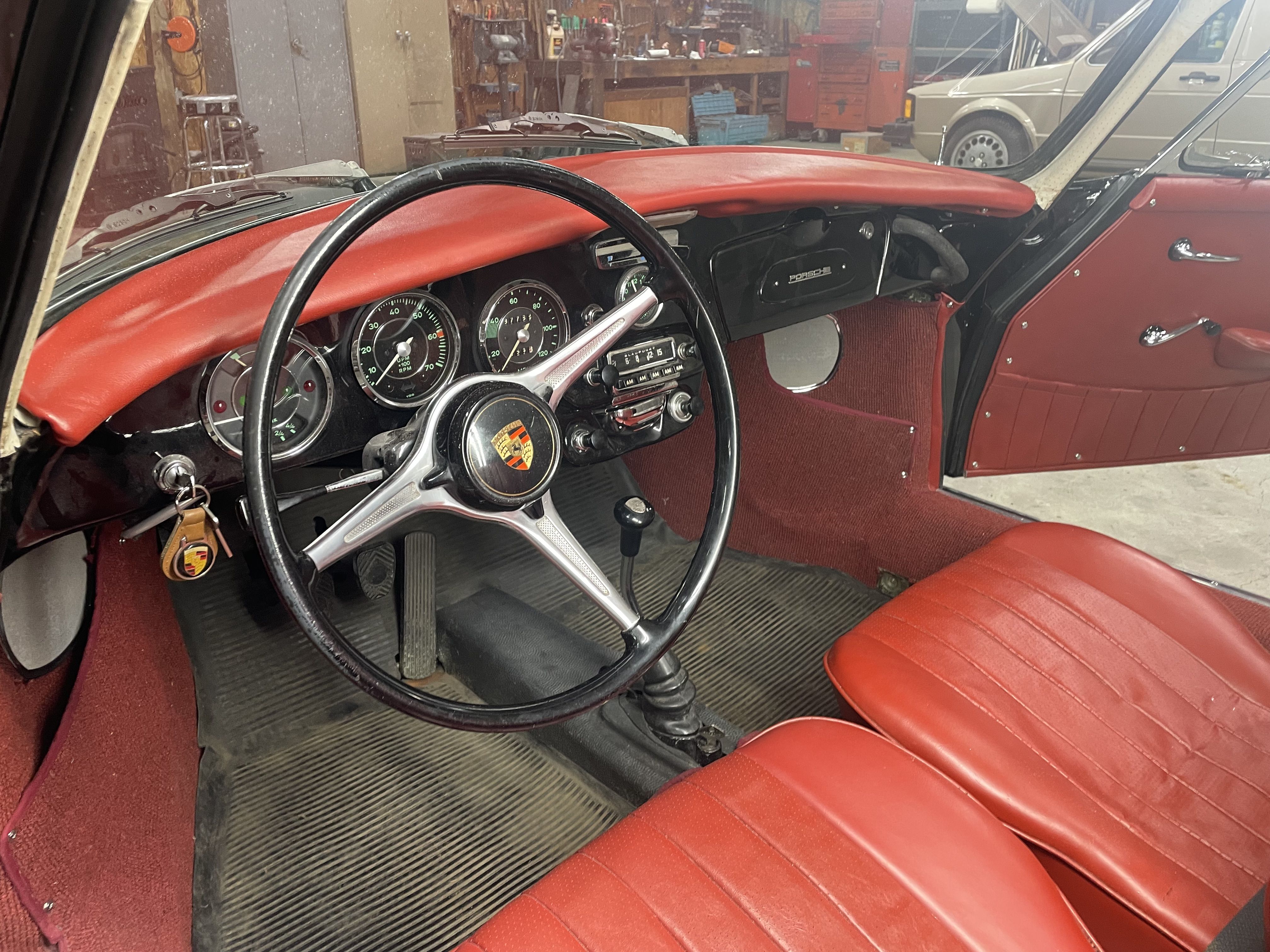

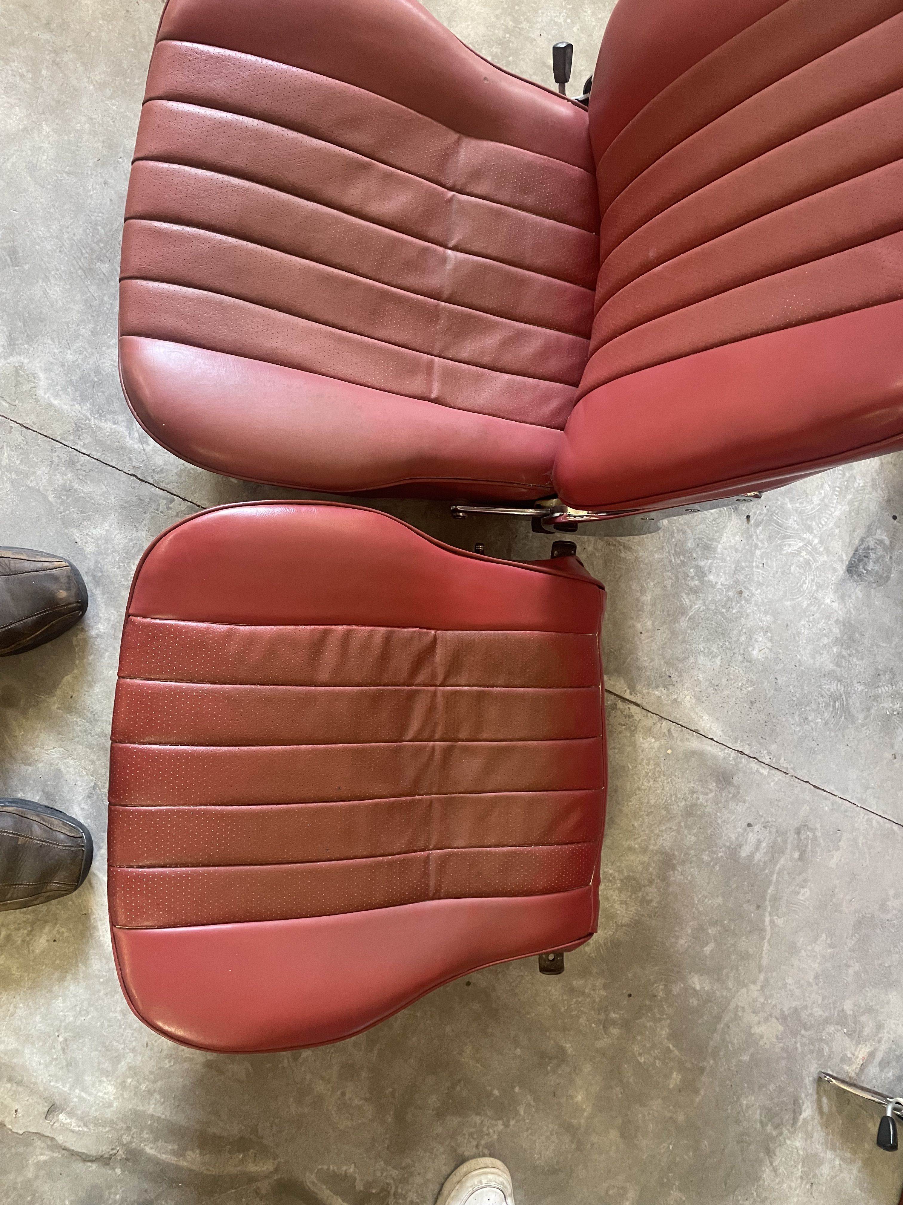

      • #82

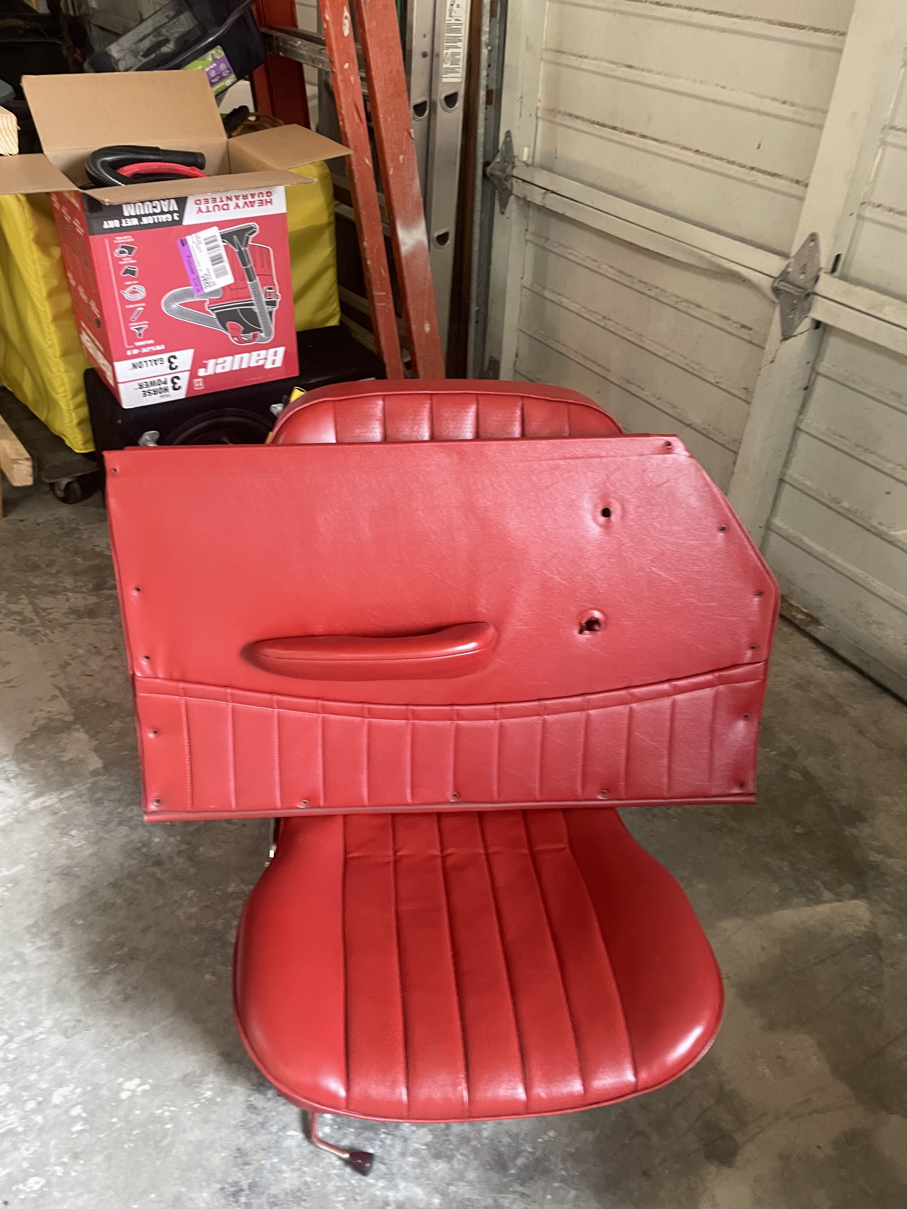

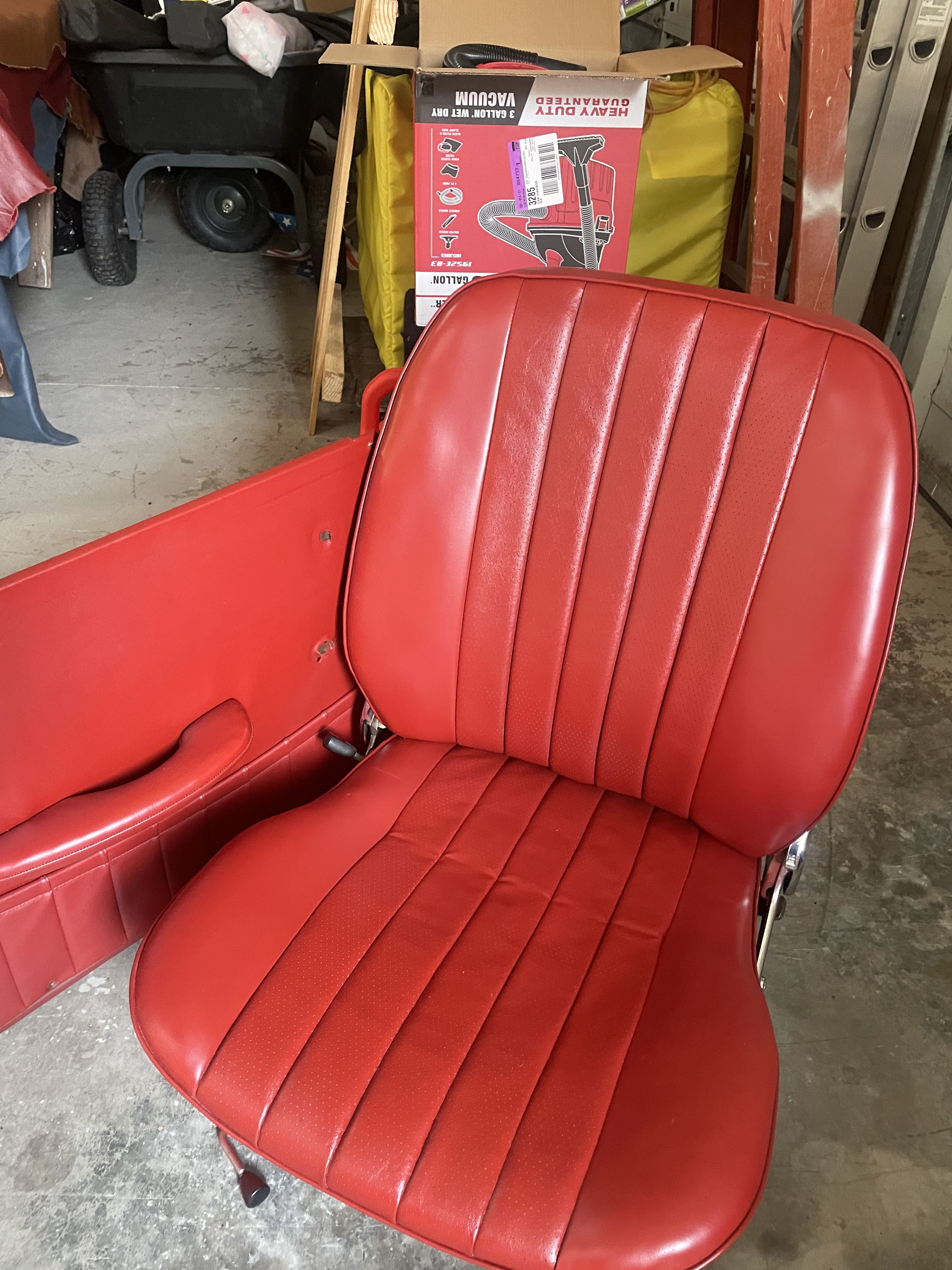

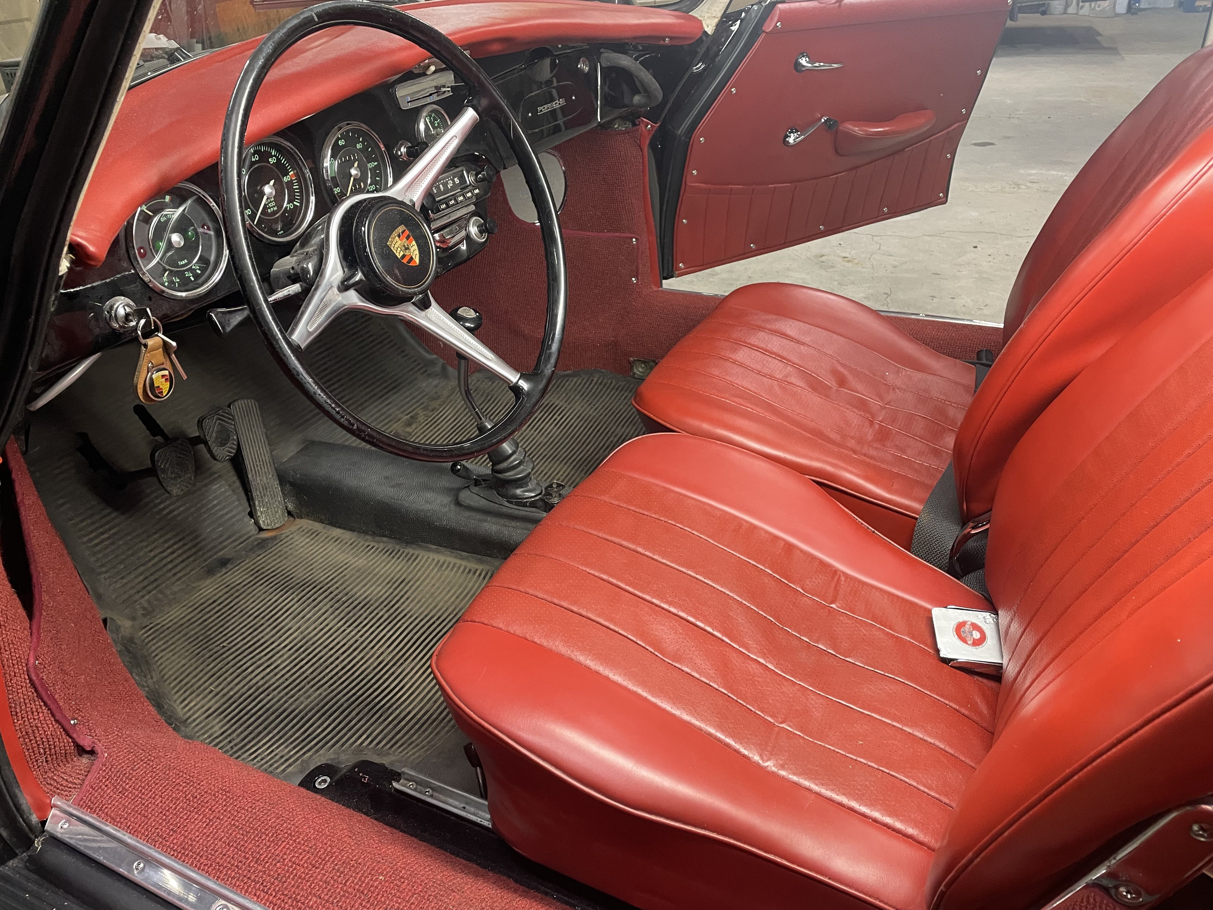

        The Car is still at the interior shop. He is slow but sure. Ted’s day job is working on airliner seats. He uses a SEM dye that can be matched to any color. It penetrates well and you can sit on a seat 2 minutes after applied. Alaska Airlines uses it on turnaround cleaning between flights. I must admit I have see age old Marhide dye seats, I was not impressed. This stuff is spectacular, the local auto body store can mix it to match and put it in an aerosol can.

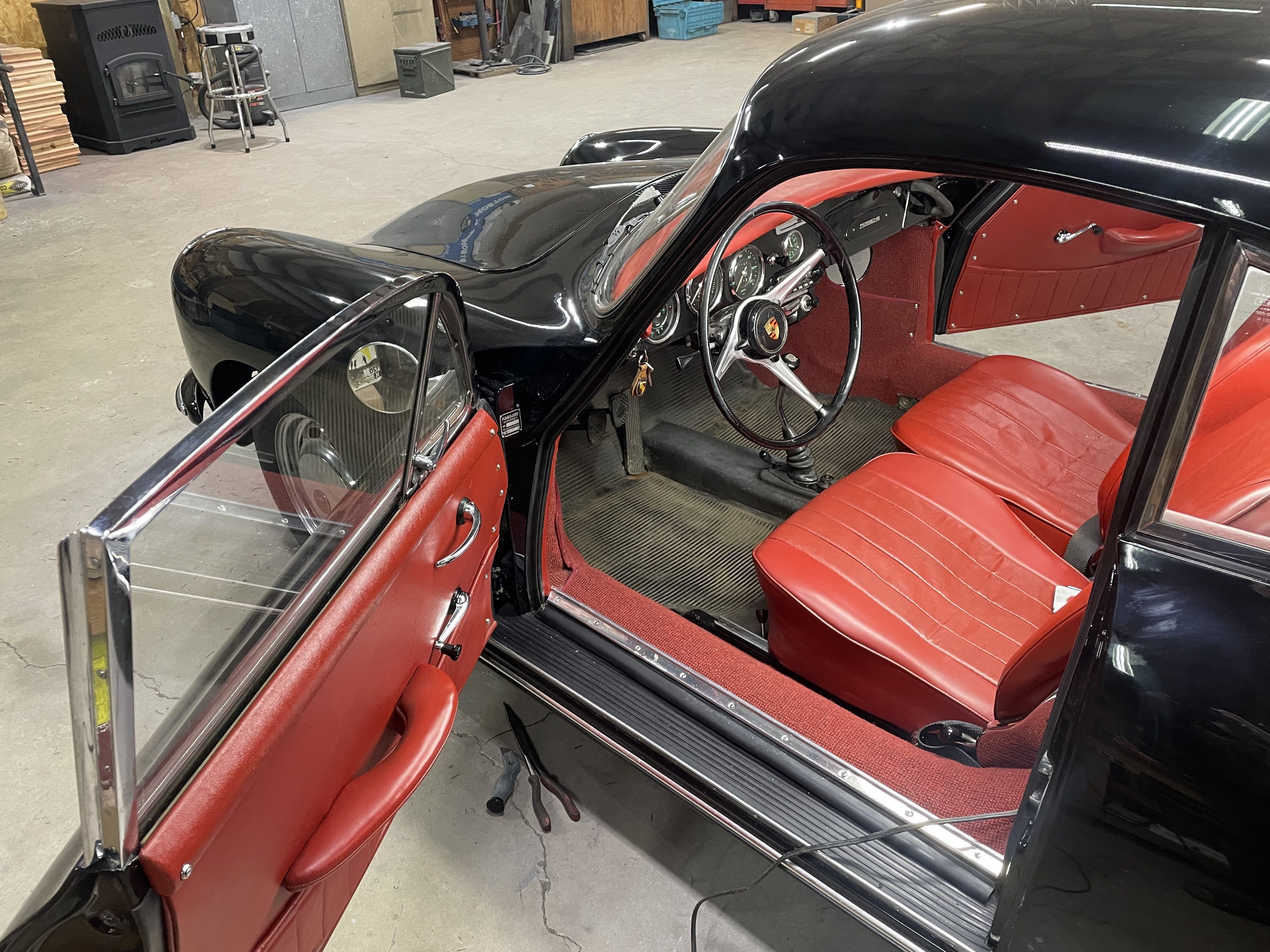

ID:	116204 Click image for larger version
ID:	116206 Click image for larger version

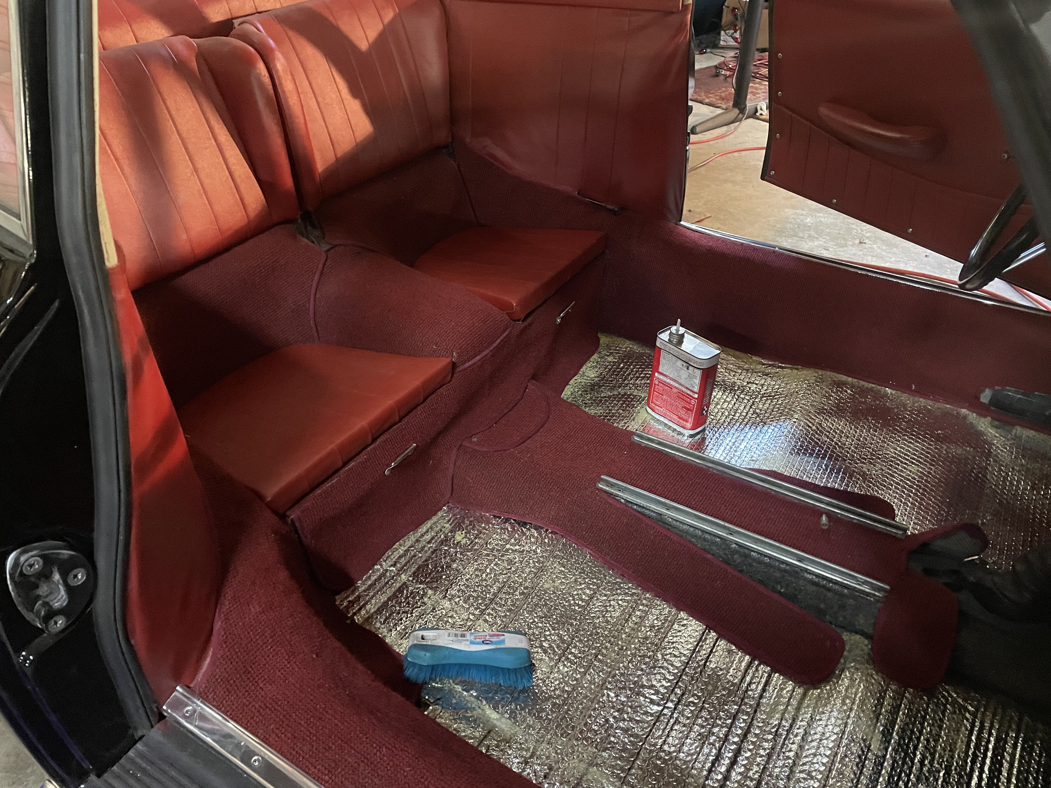

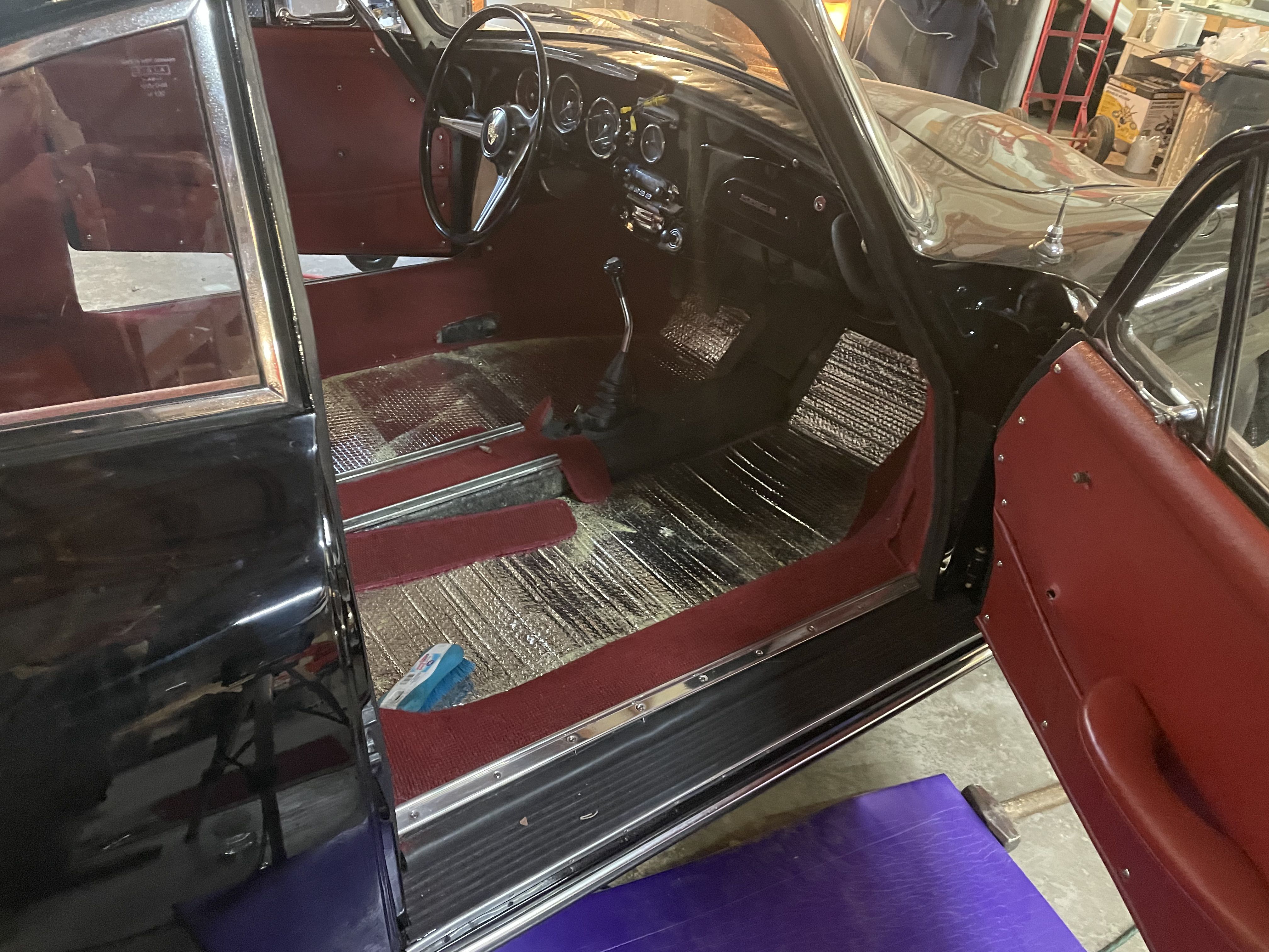

        Replacing the old coconut tar insulation with Dynamat. It’s going in over top of the truck bead liner, we used seal up the inside of the floors after repair. All that’s left is I have to drive it 4-500 miles to shake out any bugs. Then a major tune up with oil change we are done. FINALLY..

          The dye is just the right hue not too red with a little burnt orange tinge to it. Vintage Porsche look to it all the way.

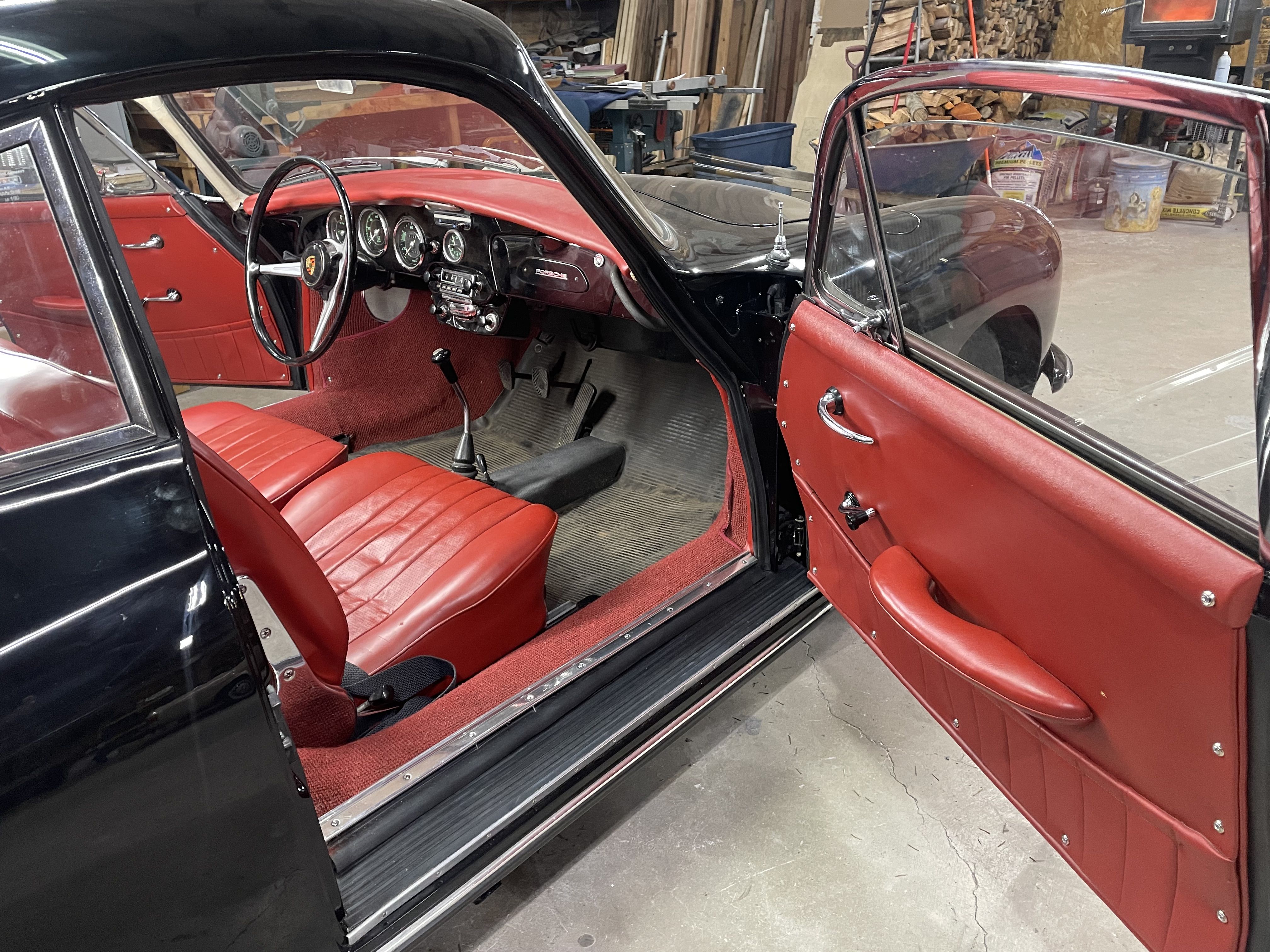

      • #84

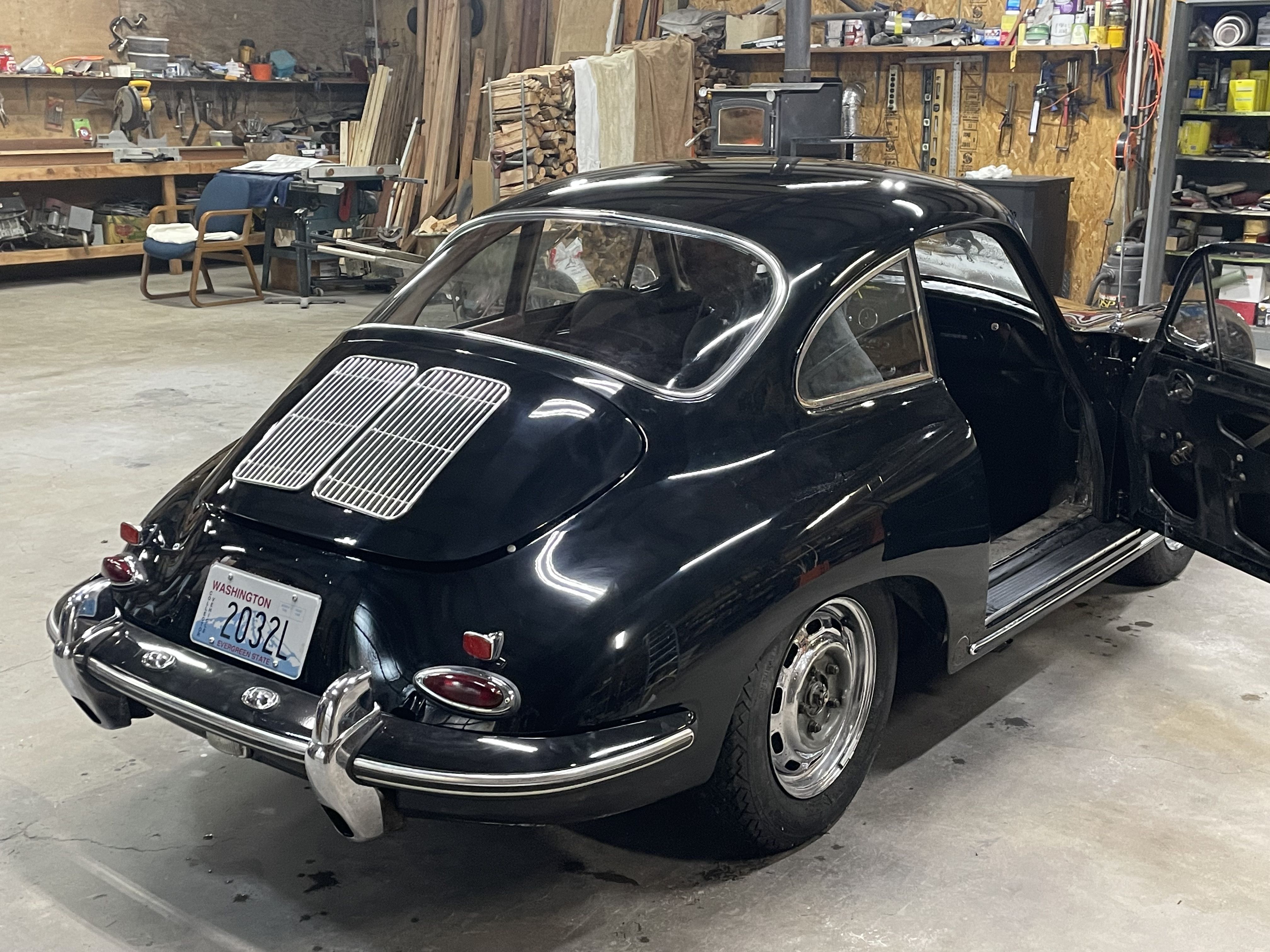

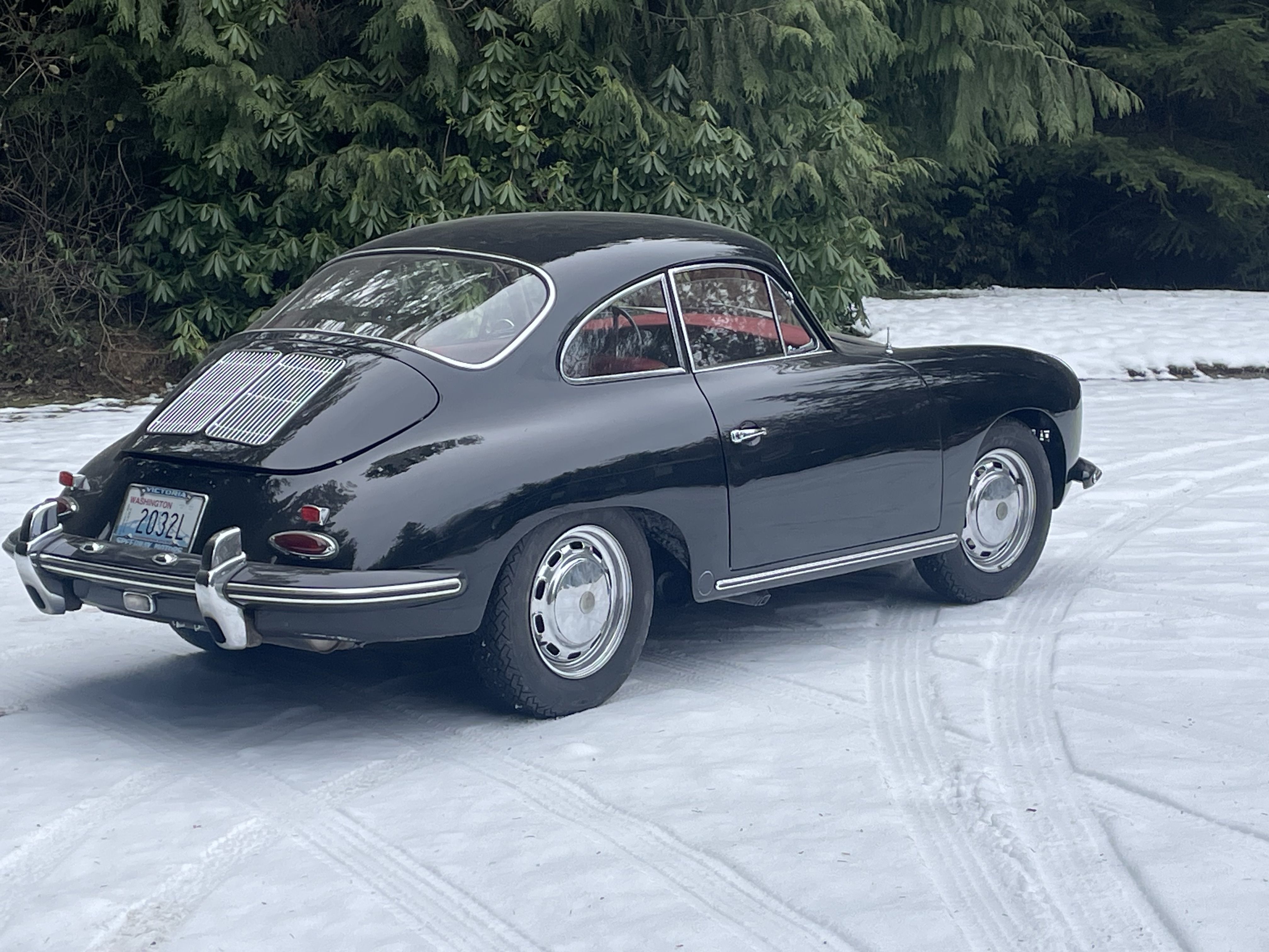

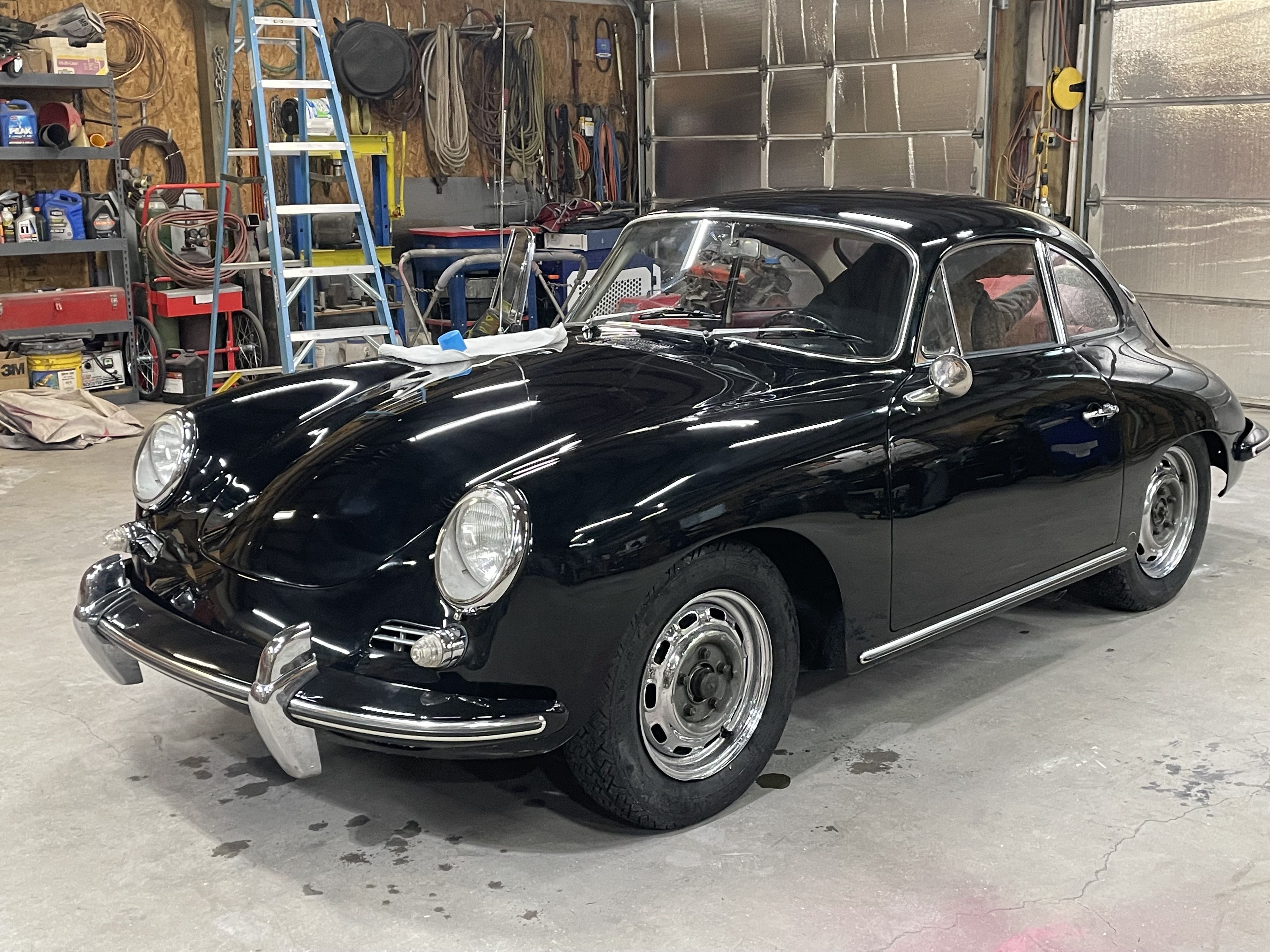

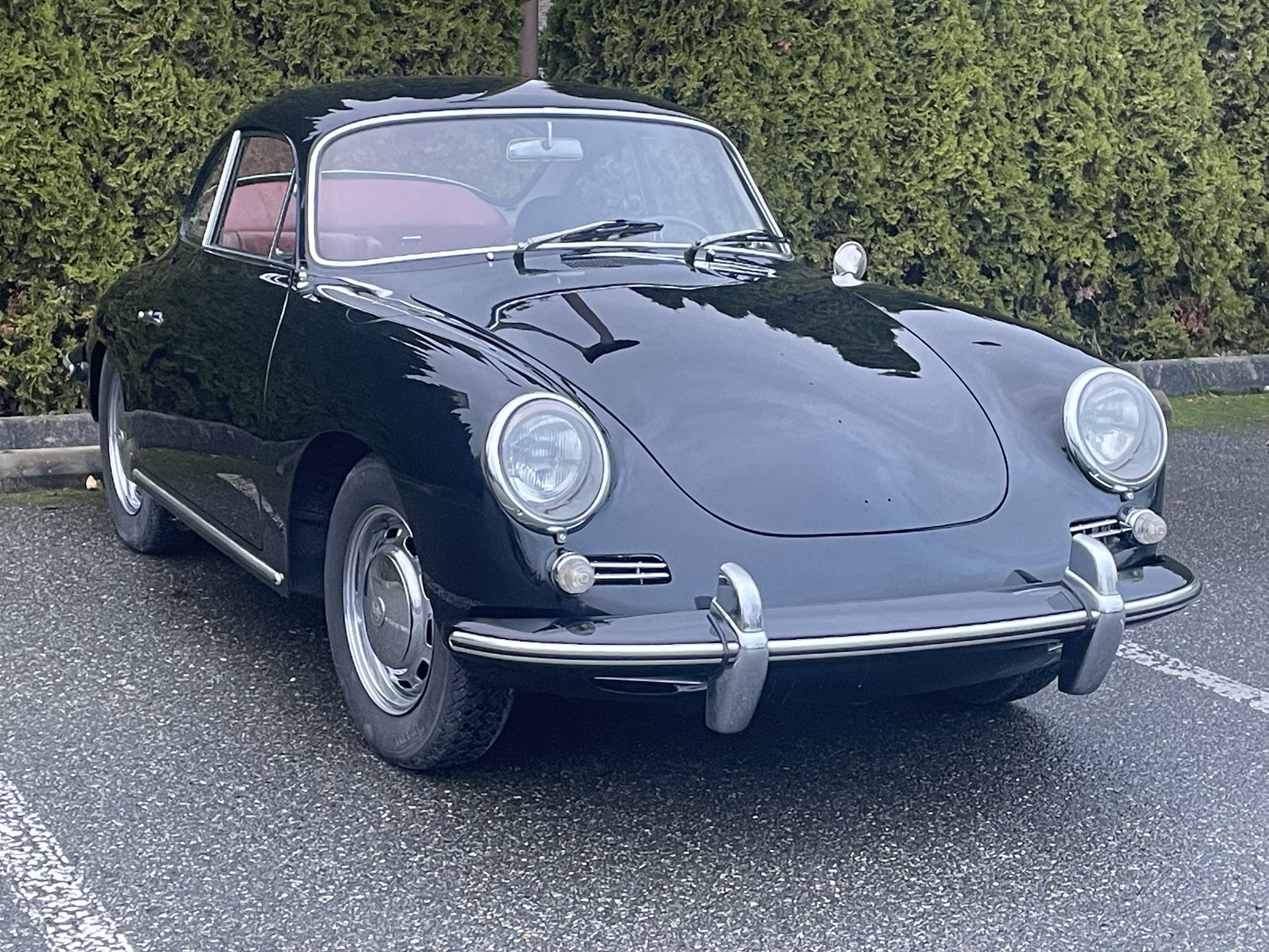

        Done……. All it needs now is a few hundred miles on the rings. Looks like new. Its idling here, no smoke, heater is on defrost on, everything works.

          It looks fantastic John, both inside and out. Congratulations on a job very well done!

        That dye is a SEM color coat. The local paint store (WESCO auto body supply), can color match it with an optical scanner like paint. Then put the dye in an aerosol spray can like paint. We took a seat bottom section that was folded under an had never seen light to match it. Once mixed you can apply it with a spray gun or the can. Its matched perfectly, and you can handle it in about two minutes. The dye penetrates the material, drys fast and is permanent . Our interior guy does airliner maintenance, he uses it all the time on leather seats. He did restitch the original and rebuild the springs and padding like the factory before the dye. After that its was just sprayed and put back together. It was a job, but worked out well to keep as much of the car original as possible. Remember this was a resurrection not a restoration. We are putting it back on the road as a solid rebuilt driver not a concourse trailer queen.
          SEM makes the best interior dye. I used that to go from gray to blue on my old Toyota and better than 30 years later it is still holding up!
