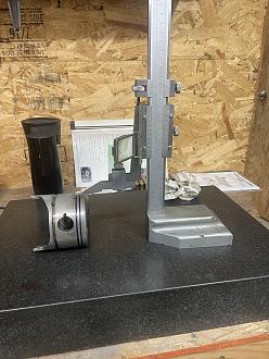

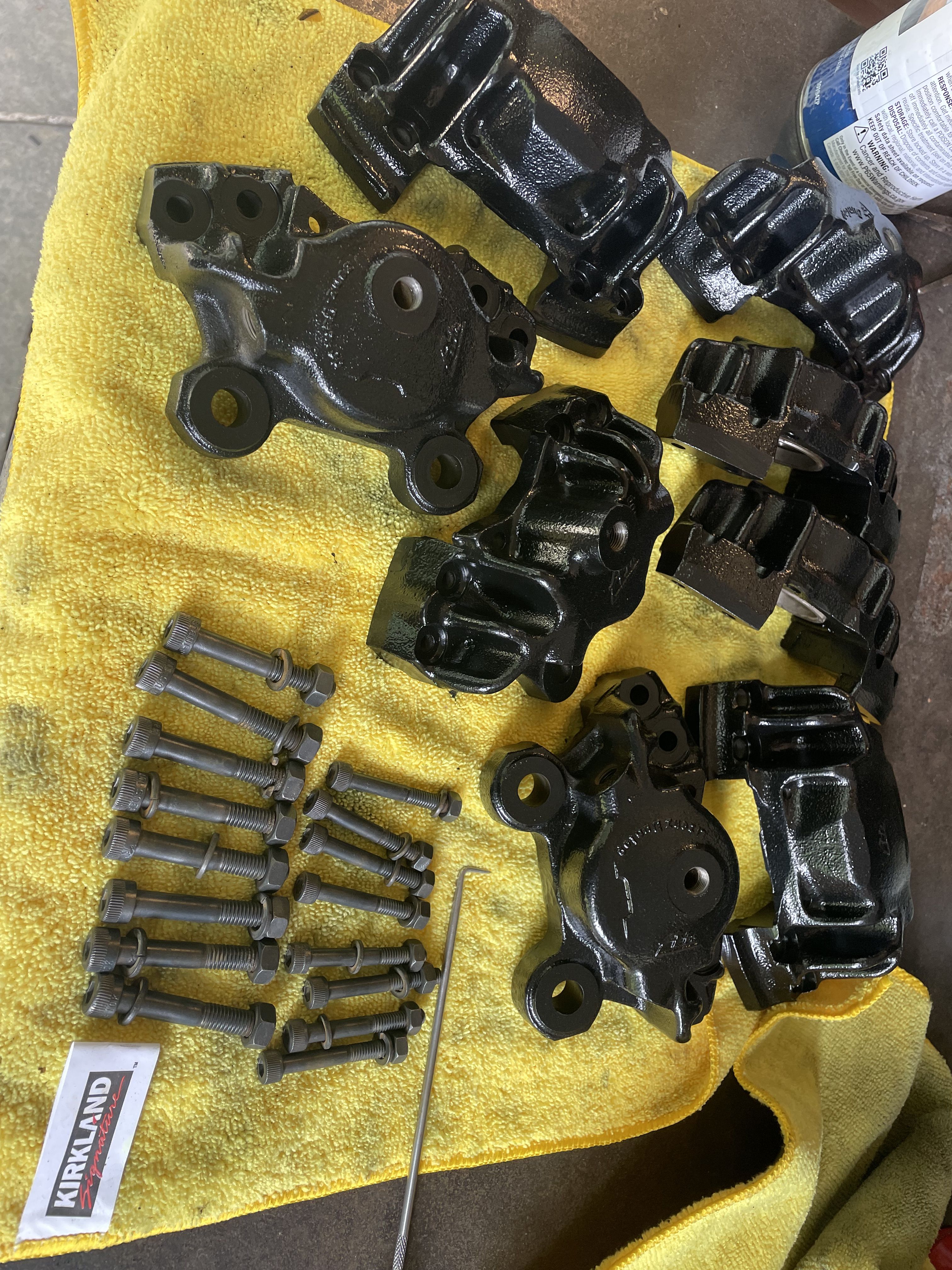

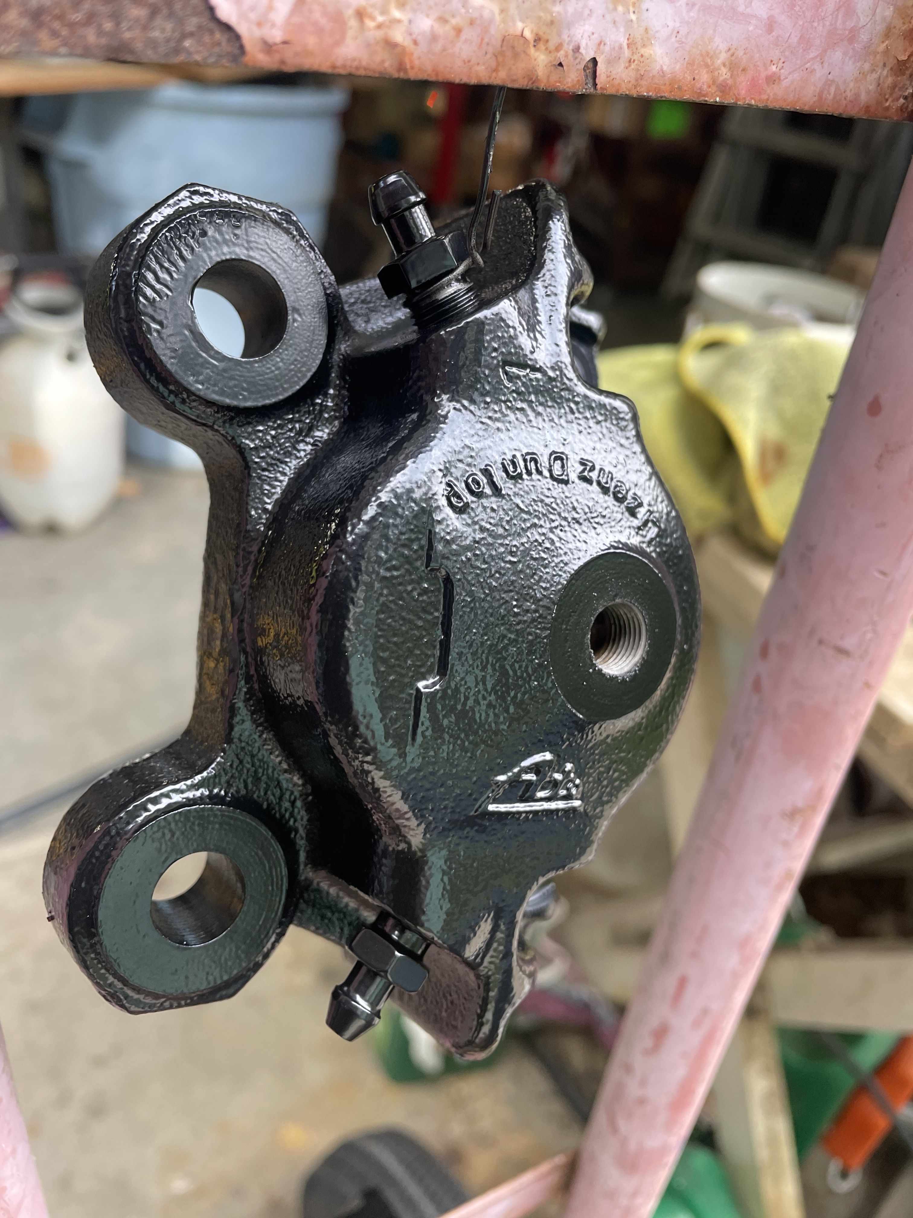

      Powder coating all day. Did a couple quick measurements on piston cylinders. Cleaned up the calipers, upper tins and ran them through the powder coat ovens. Nothing too spectacular about this. Turned out nice as usual.

      Owner wanted black calipers, I did not want to go through the zinc and cad plating on these. PMB wants too much per set. Powder is better in the long run I my opinion. I did the last couple sets yellow, new guys always ask if they are carbon disc, stupid new 996.2.3GTS owners just don’t have a clue, but have a good lease rate.

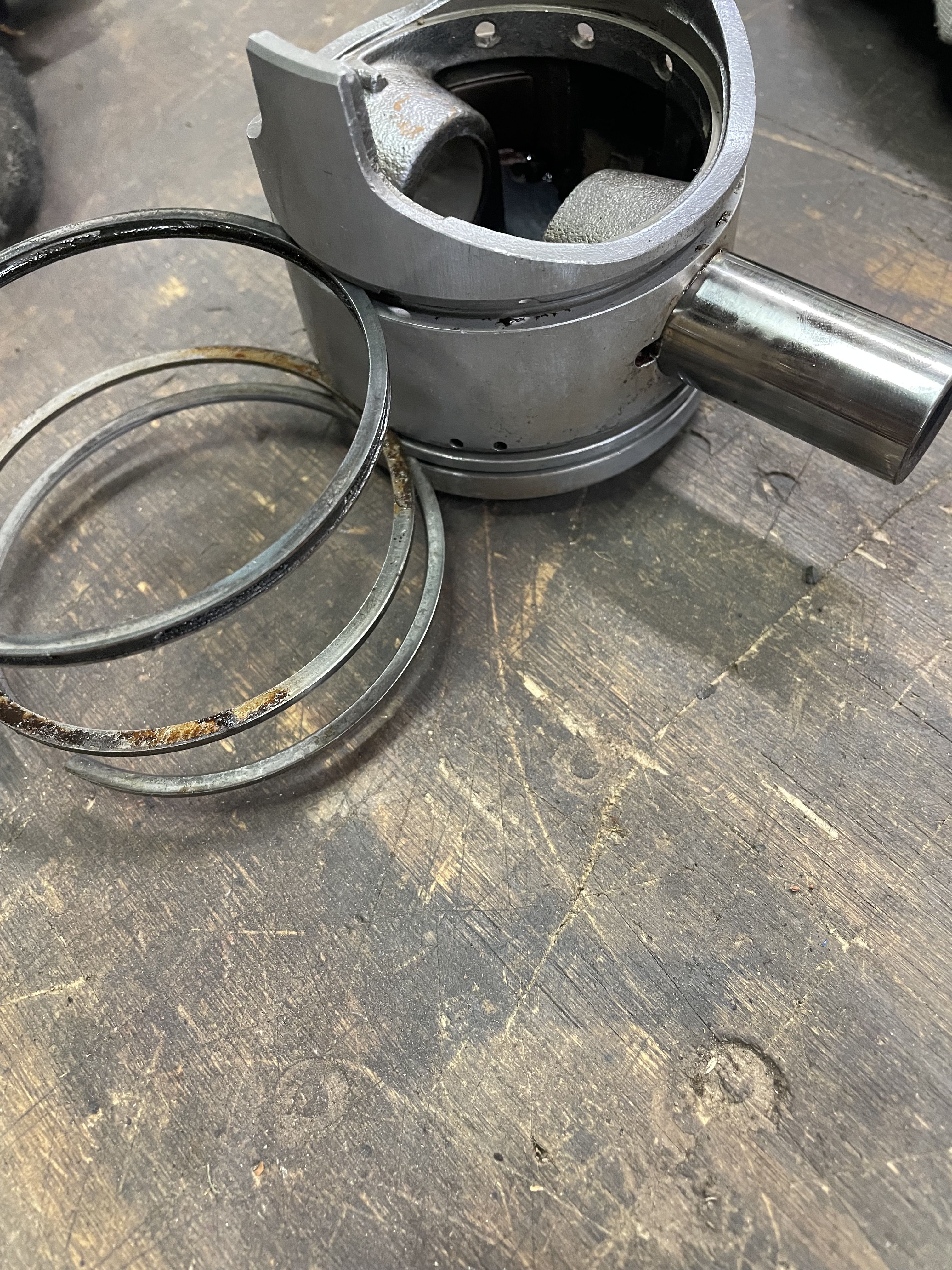

ID:	115336 pistons and cylinders measure fine, Now to find a set of rings. The resurrection progresses. FDA is still holding the laser welder hostage, but the first of next week I going to start using it while waiting for the inspection.

      Spent all day Sunday finishing up the calipers and getting ready for assembly. Rebuild Kits were at the other shop, so it was just parkerizing the bolts and final hone on the hydraulics bores. Put them together later when I remember to bring the kits.

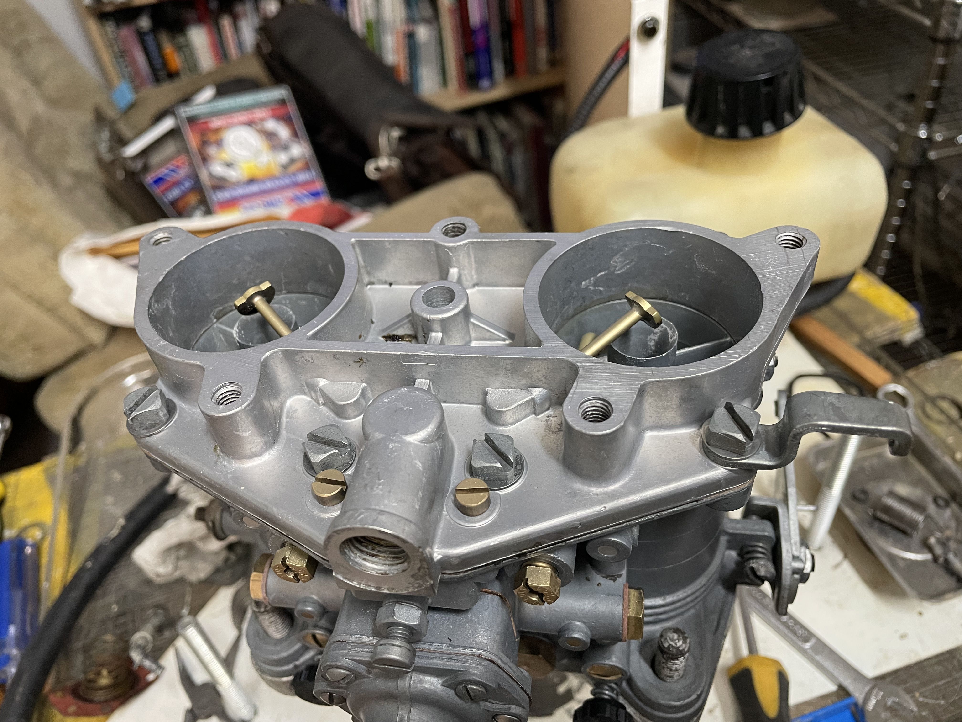

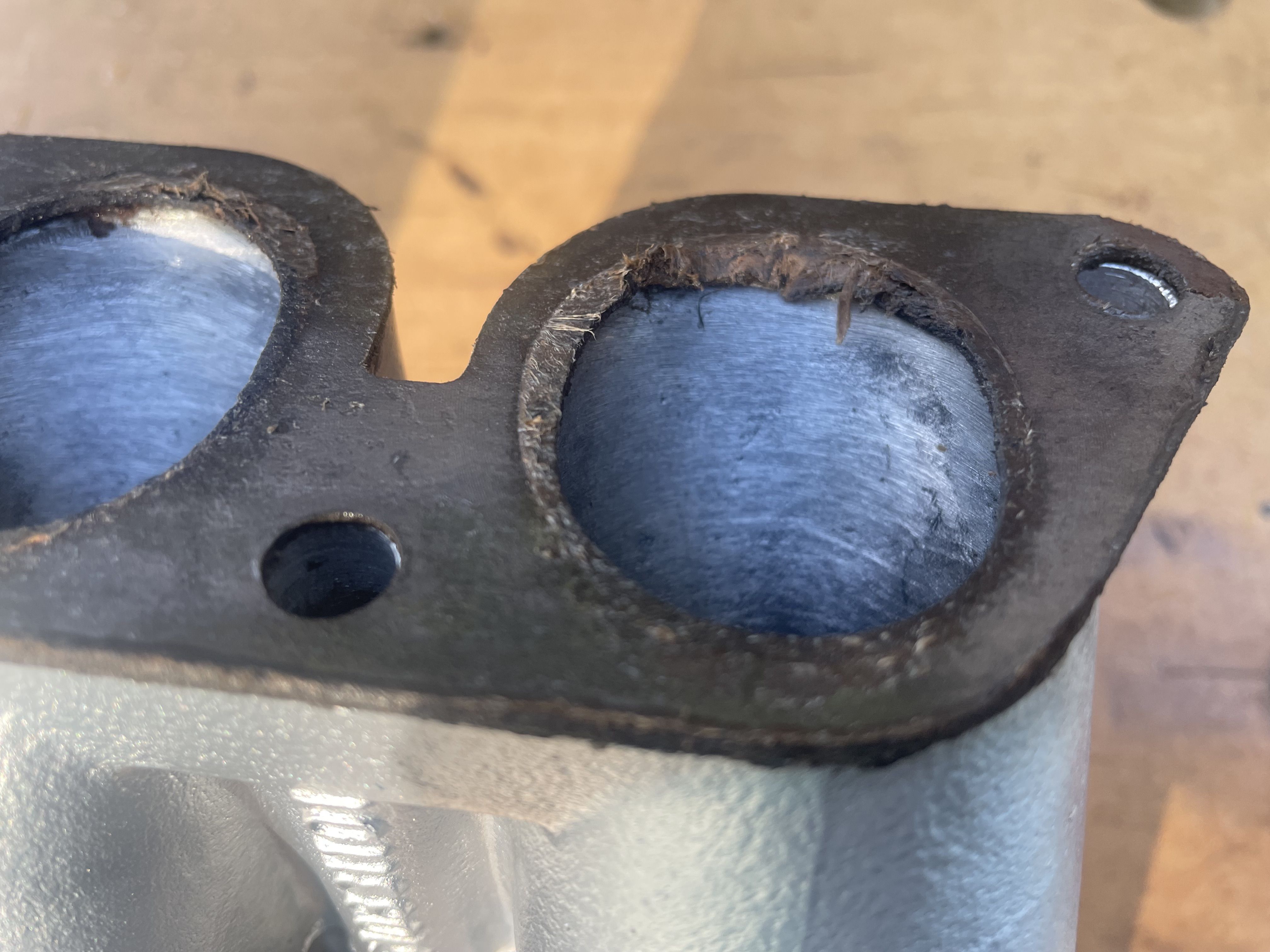

      Then with nothing left on brakes, started back on the Carburetors. Now this is a real challenge, frozen, gummed up, corroded. I have seen ones out under a tree for 10 years that were in better shape. Time to shift over to the hydro blaster we built a couple years ago and start cleaning them. One has been in the ultrasonic cleaner for several days, 90 min at a time. Probably 12-15 hours total on the one in the tank at 50C. It’s coming back but ugly. All the ports are plugged, has caked dried gasoline in everything.
      So it time to step up and get out the big gun. I should have started here.

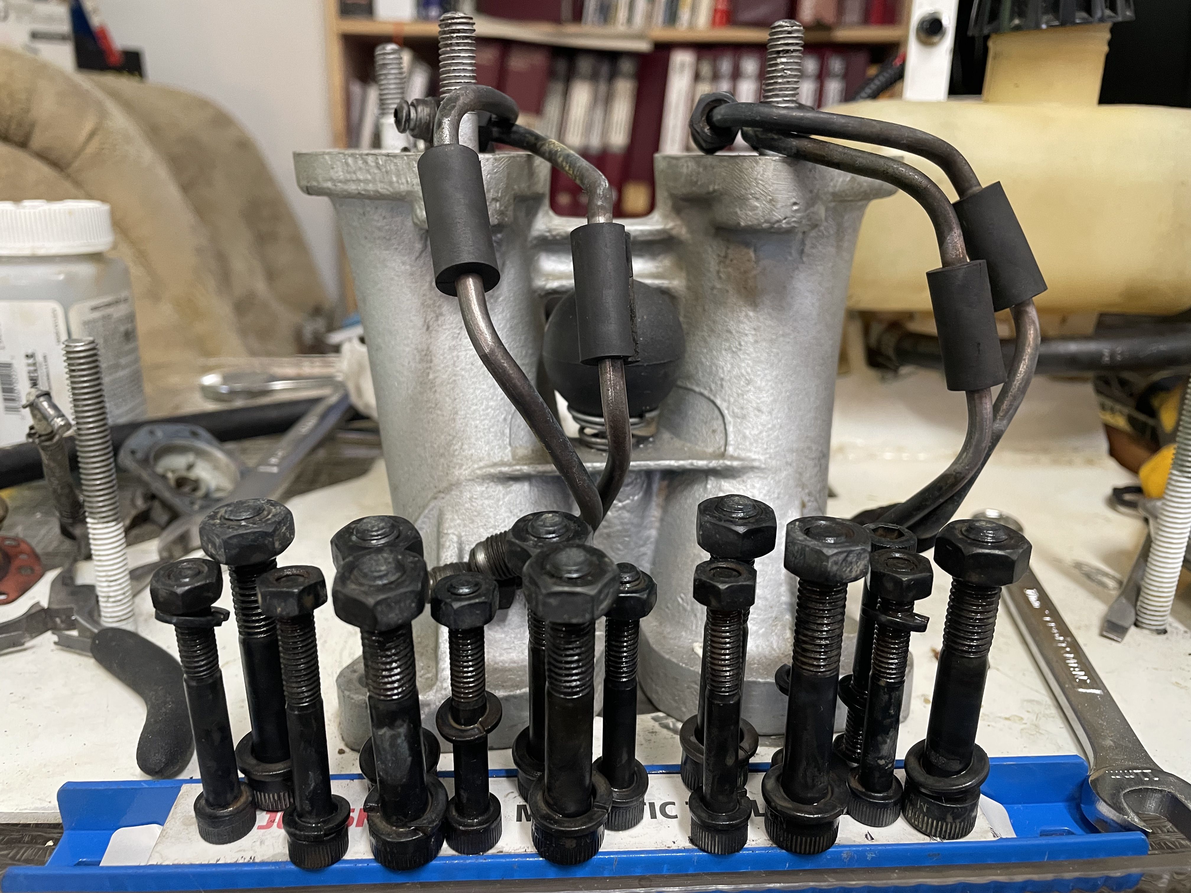

        CARBURETORS…..

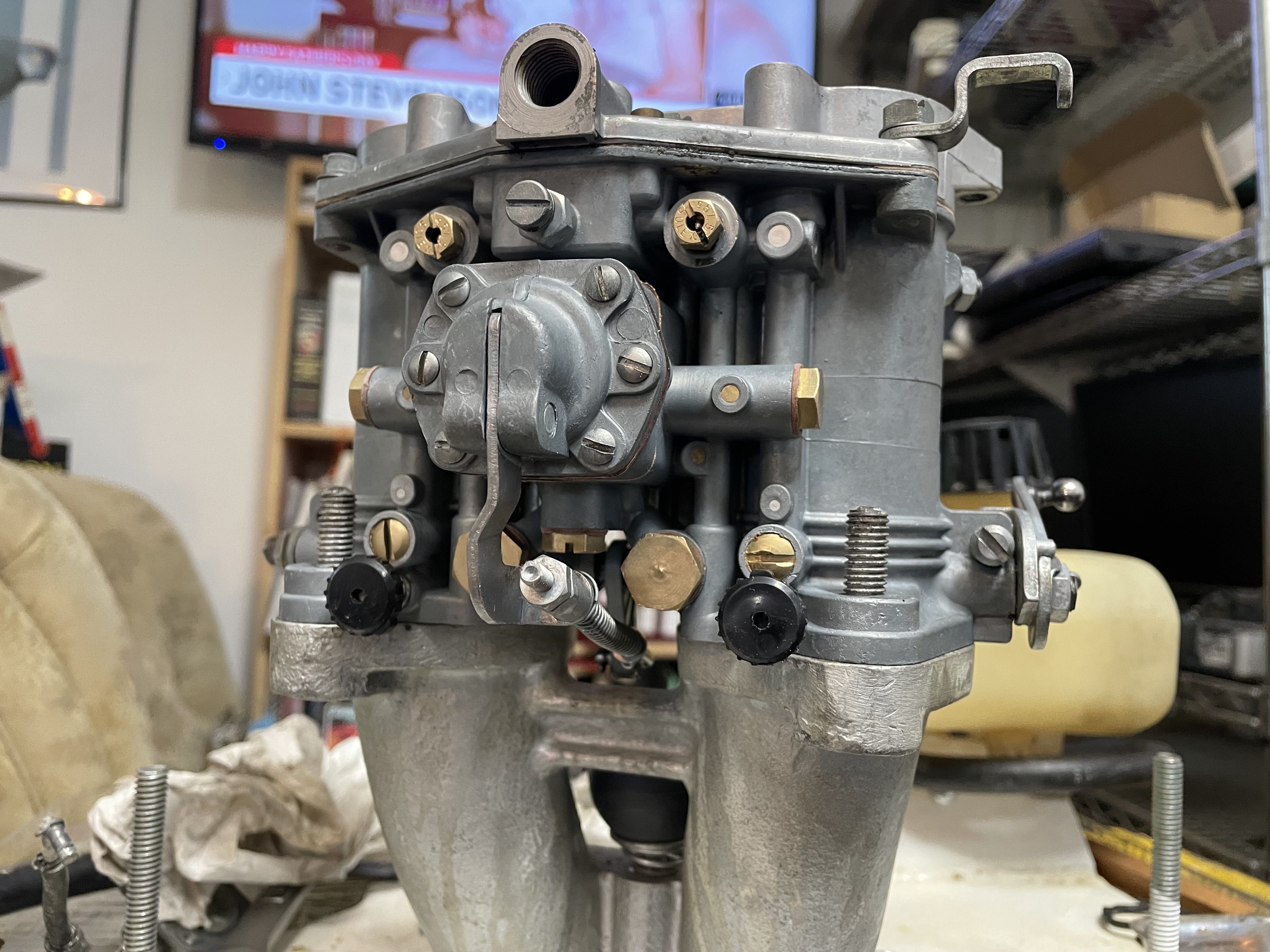

        Now parked for 38 years what could be wrong? Frozen throttle shafts, All the brass jets and plugs bolts corroded and frozen. 8-10 mm of hardened goo in the float bowel. Jets and passages plugged. Forgot the before photos, but that might scare someone into Weber’s. With some 6 point wrenches and some directed heat, I broke one carb down and tossed it in the ultra sonic cleaner. Normally 90 minutes at 110 deg your done. Went in to eat, came back a couple hours later, crap looked like I forgot to turn it on. Almost no noticeable effect, still hot but still plugged and gummed up. Another 90 min, nothing, then again, and again and again. After a week, I gave up. They were coming clean but, I can not believe how slow.
        Normally a carb will clean up in a single cycle. This one turned the fluid black like normal, but nothing was coming off except sone grease. I would spray with cab cleaner, let it soak, toss it back. Slowly worked but, taking
        Click image for larger version  Name:	IMG_6705.jpg Views:	0 Size:	1.38 MB ID:	115361 Click image for larger version  Name:	IMG_6713.jpg Views:	0 Size:	1.52 MB ID:	115360

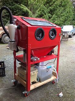

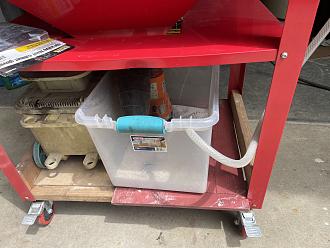

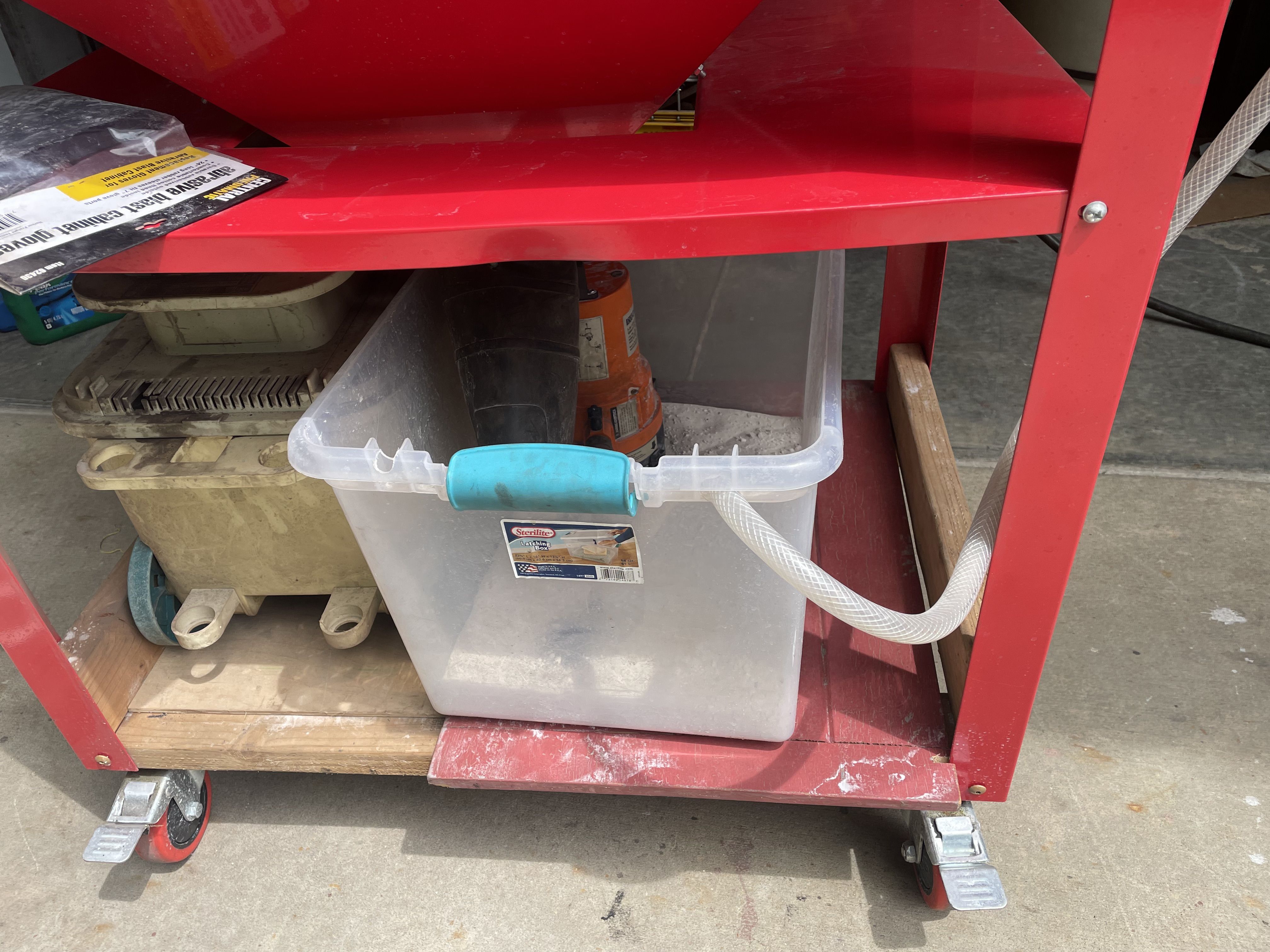

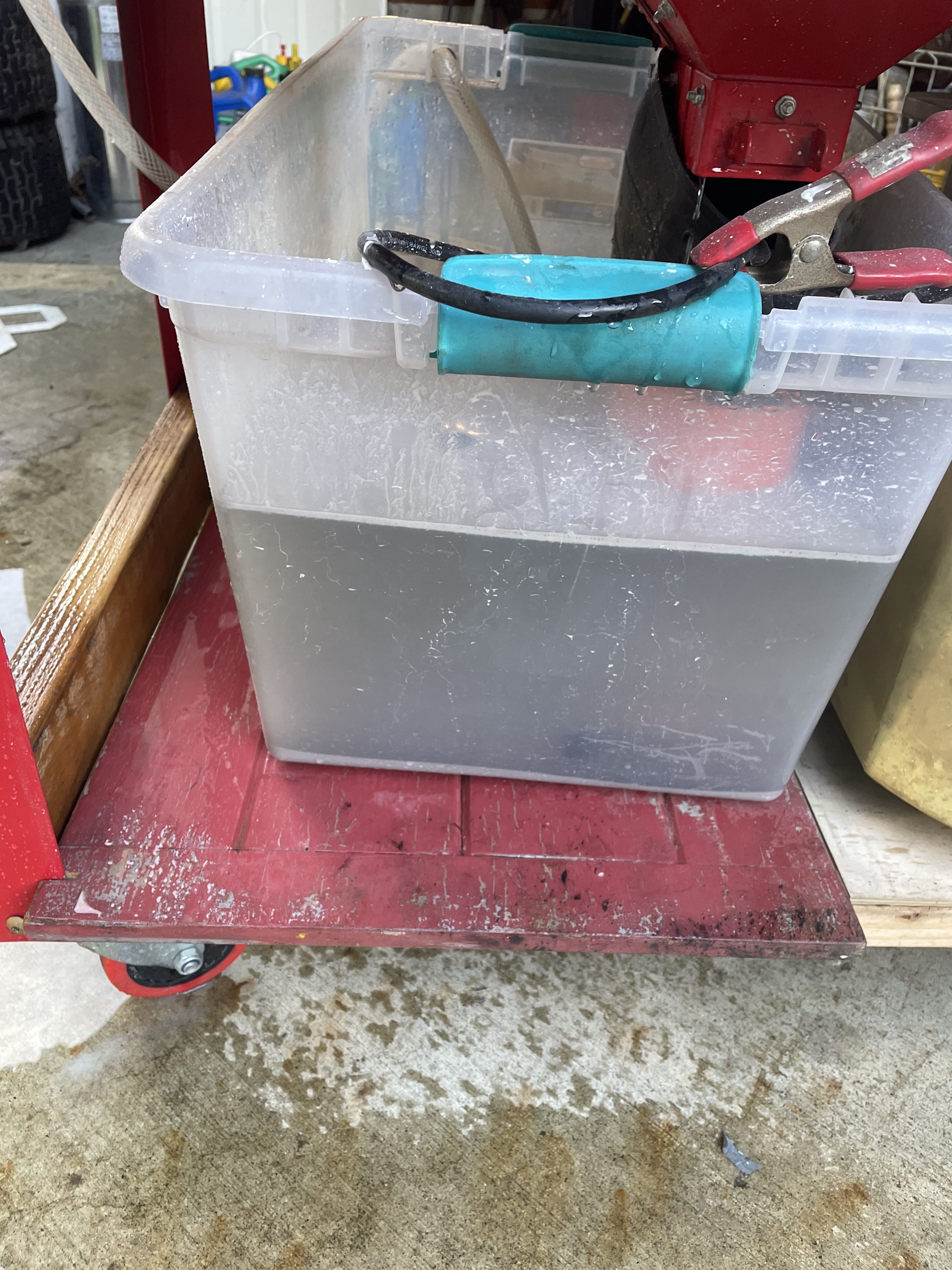

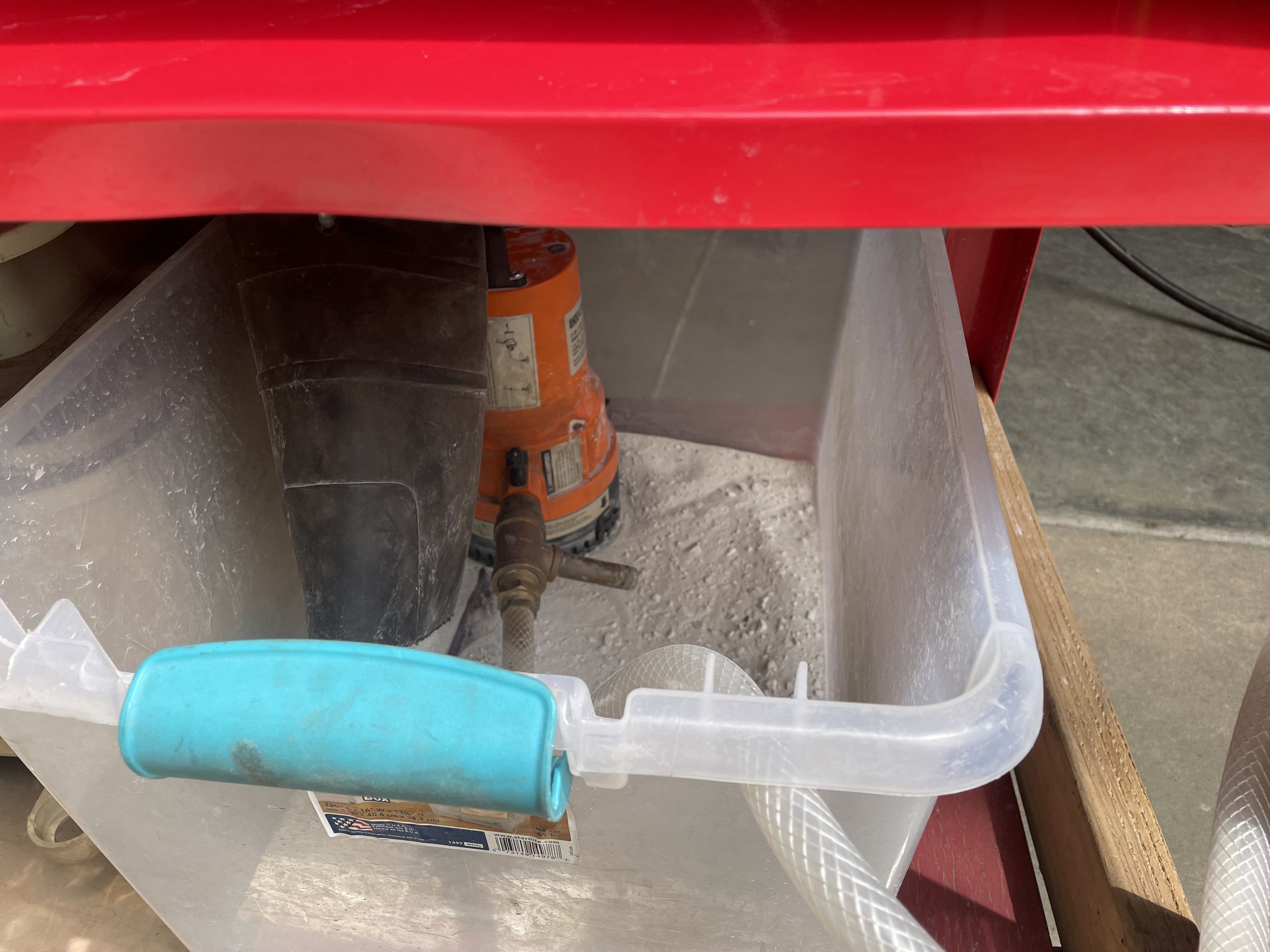

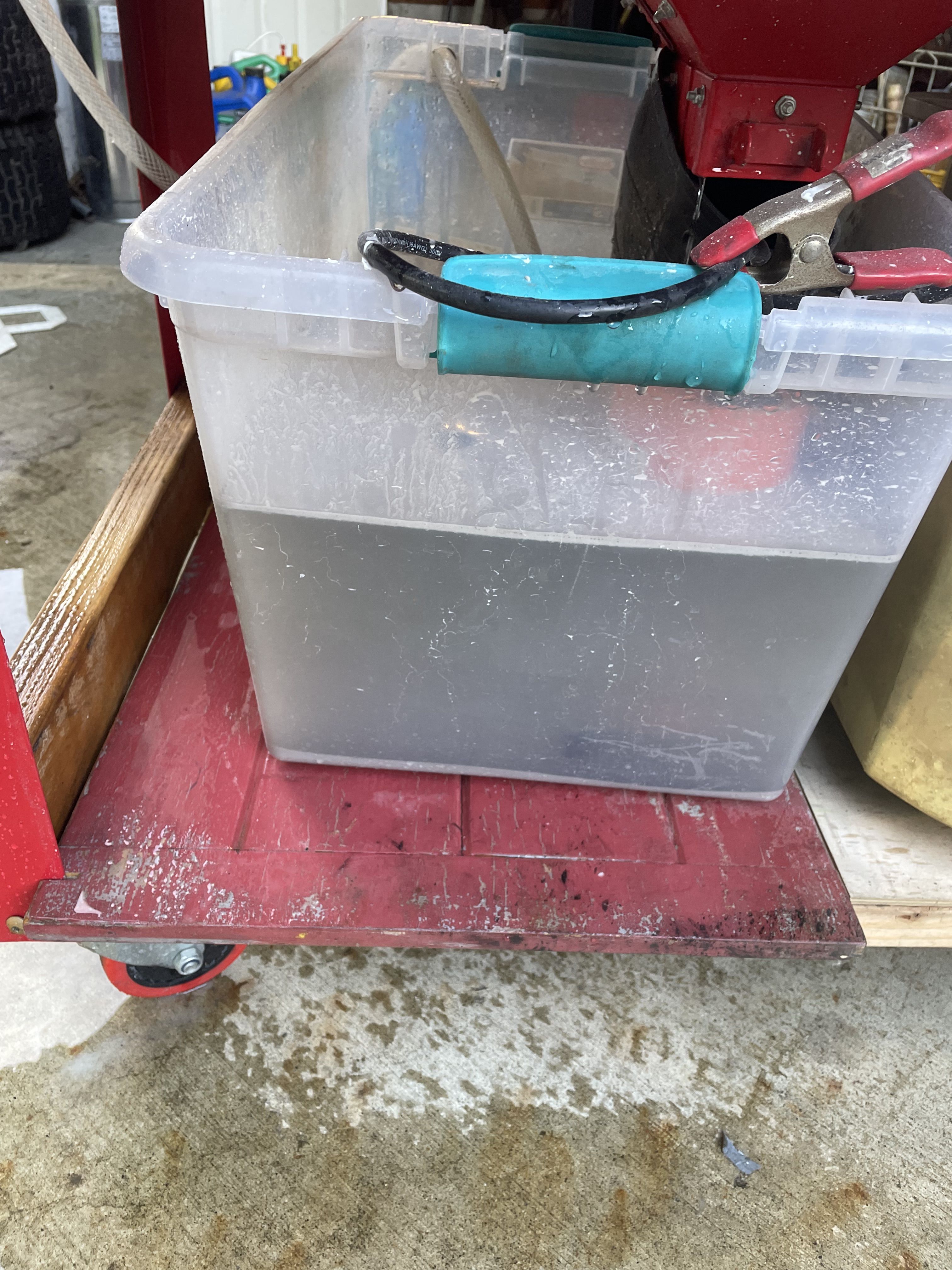

        First photo is the storage tub, white stuff is the media, dried out and stored from last use. Pump and media feed line up to the gun. Second is the amount of stuff in the water from the first carb. Cleaning the cabinet and tank after use is pretty simple. You let the media settle to the bottom for 10 minutes, the siphon off the dirty water down as close to the silicon spheres as you dare, then let it completely dry. I have several tubs with different sized media. To change it, you put the sump pump in a 5 gal bucket of fresh water, turn it on and rinse out the inside of the cabinet. Slide out the old dirty tub , slide in a new tub, add water, start working. Brain dead easy.
        So this afternoon I got out the Big Guns. I had the blast cabinet configured for dry garnet blasting for calipers. They were pretty cruddy even after the degrease tank. Cleaning them had contaminated the media anyway, so drop the door, removed the garnet and the dry plumbing and set up, the wet side. Easy enough, remove the bottom door and dry side media hose. Slide in the storage tub with the sump pump and old glass spheres from last time a couple years ago. Hook up the media hose, add water and presto we are ready, probably 15 minutes to change over.
        Click image for larger version  Name:	IMG_6708.jpg Views:	0 Size:	1.70 MB ID:	115358Click image for larger version  Name:	IMG_6712.jpg Views:	0 Size:	1.54 MB ID:	115357

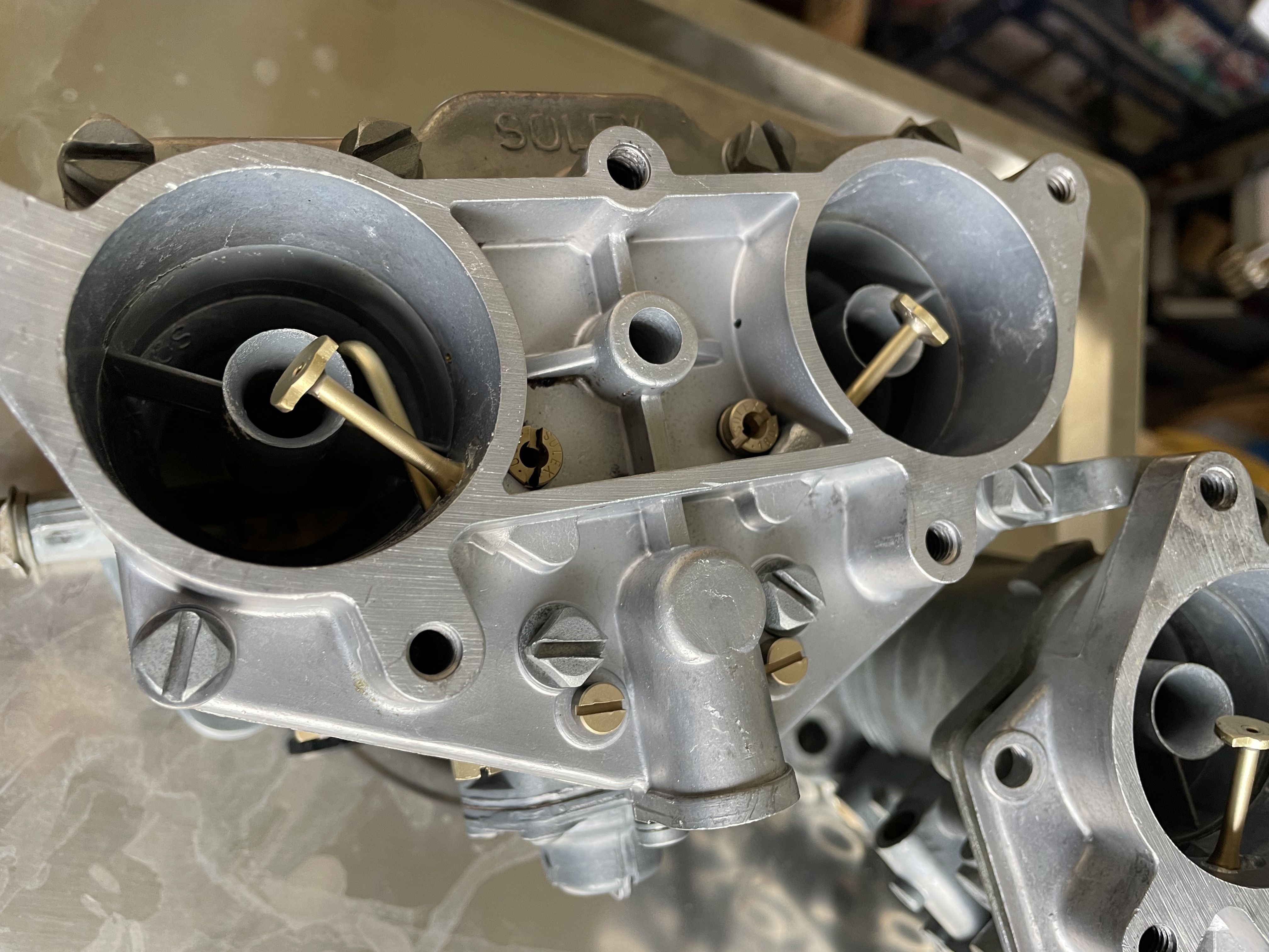

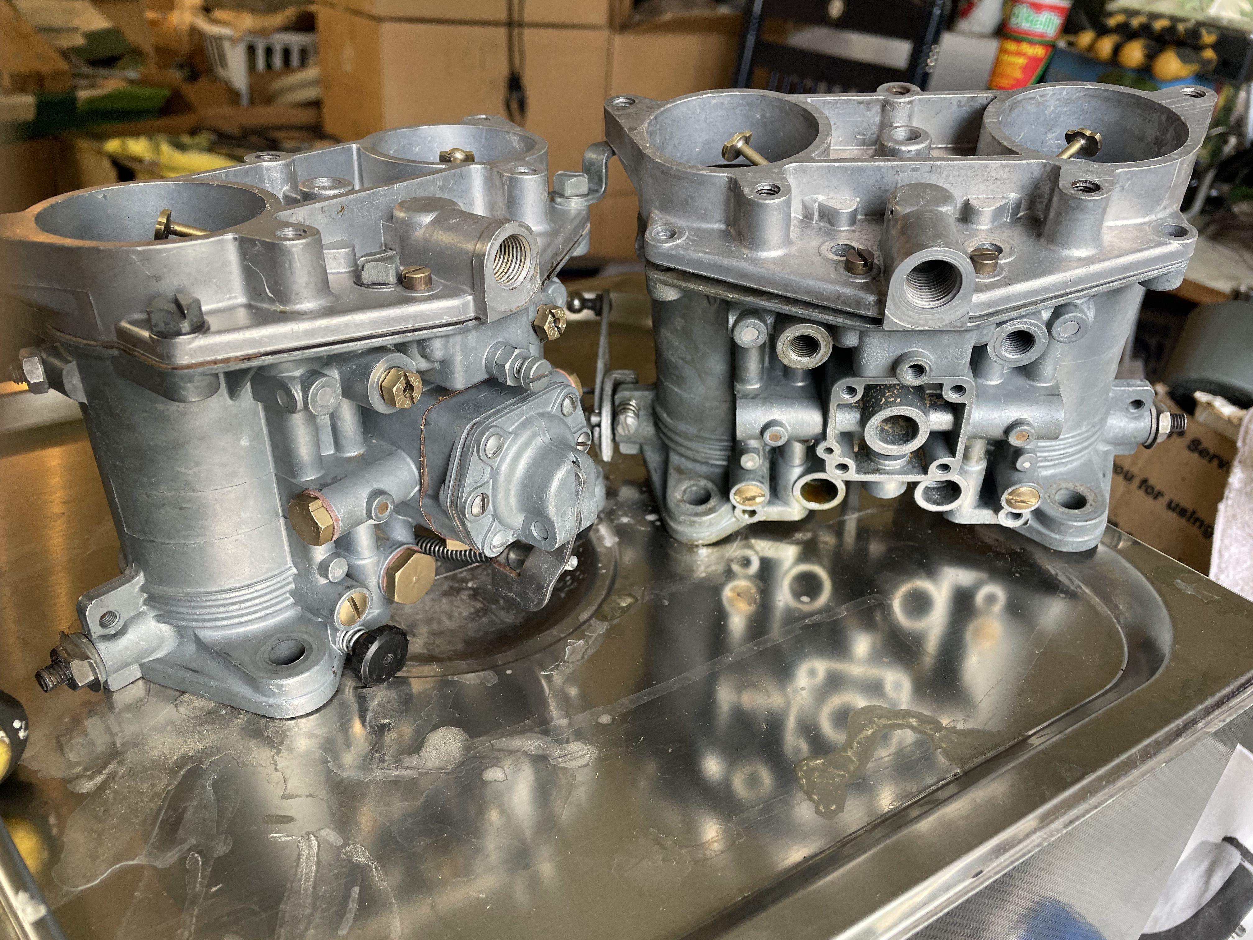

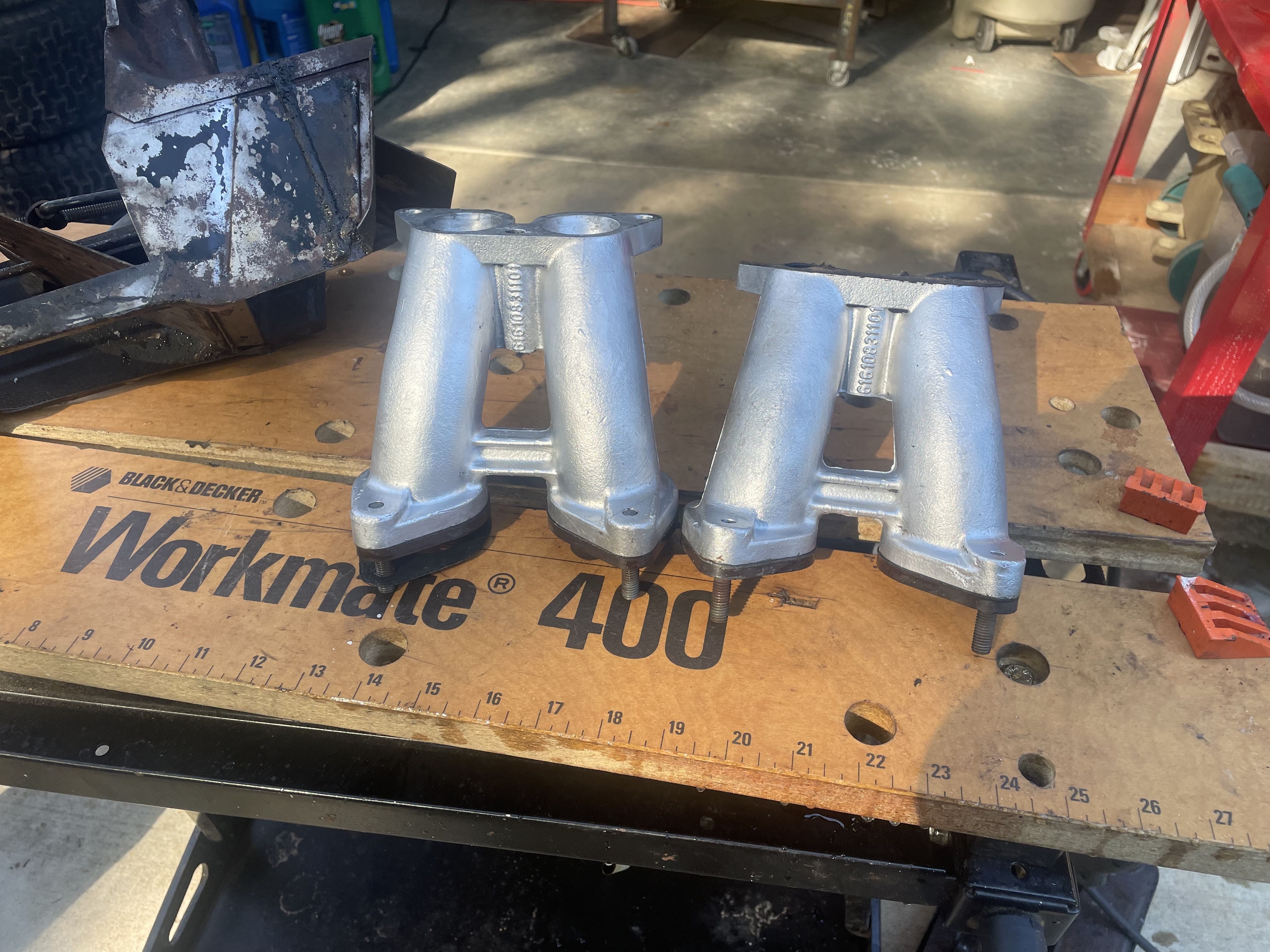

        Took the completely assembled carb, tossed it in the cabinet and started cleaning it up. 5 minutes later I have a like new carburetor ( outside) . It been a year since I cleaned one with this the last few were just soft brush and carb spray. They worked ok, but not like this. First photo is complete carb out of the blaster, one on the right has been in the ultrasonic cleaner all week. Then I put it through the blaster and all the goo came out. In about 10 minutes the jet passages are clean, white flaky stuff gone throttle plates bright and the shafts are moving. The plates were corroded to the throats, the fine media removed the corrosion and witness marks. Still a little stiff, but not locked up anymore.
        Click image for larger version  Name:	IMG_6711.jpg Views:	0 Size:	1.41 MB ID:	115363
          Another photo of the storage tub, silicone spheres before adding water, sump pump and media feed hose

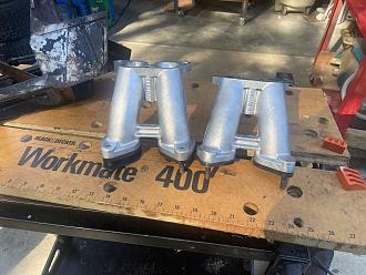

          and a couple more larger photos of the complete carb after cleaning the outside and throats
            They look fresh from carburetor rescue, if they were still around. Nice work!
          Well John that finally really did work out really well for you !

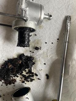

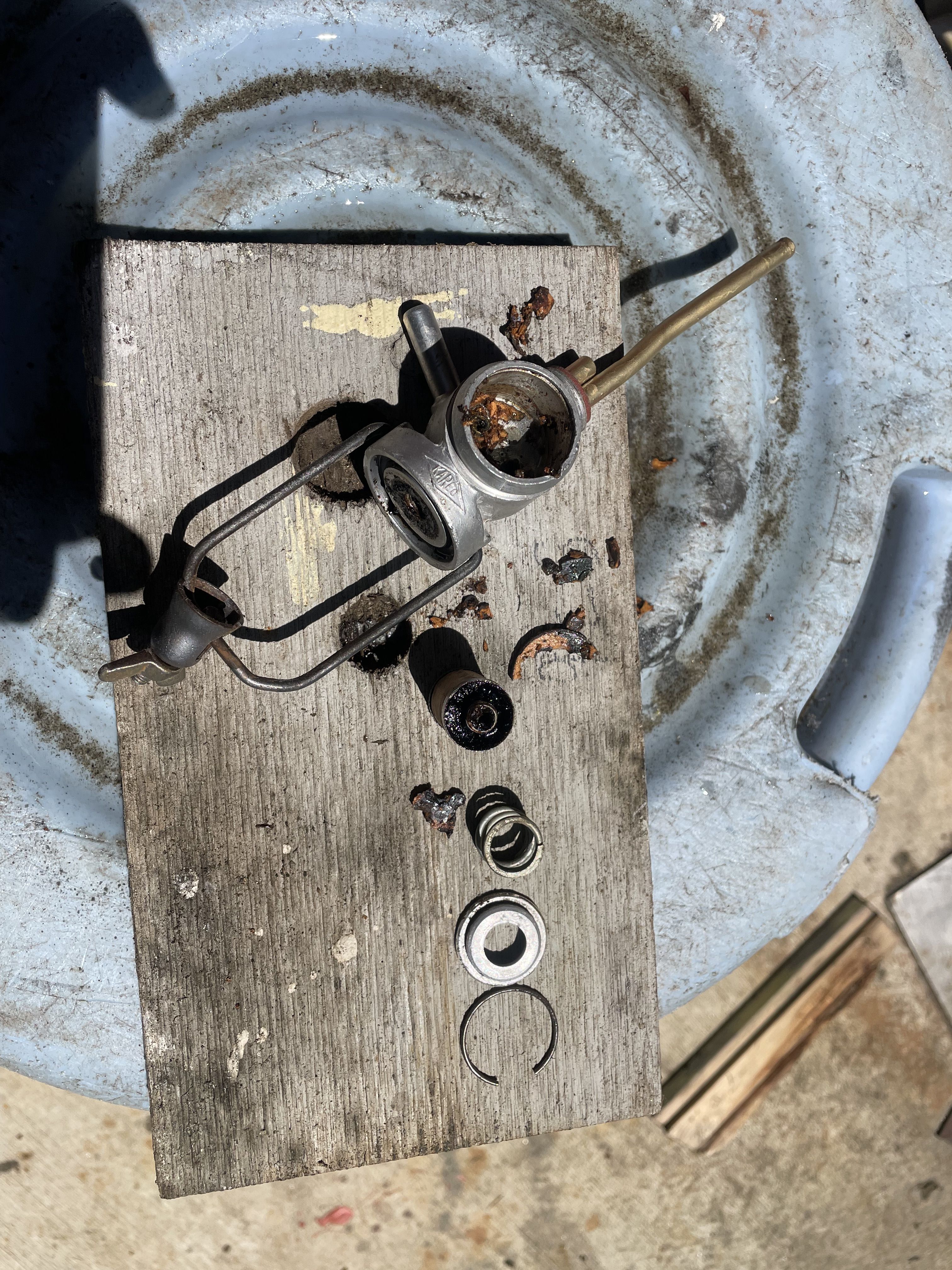

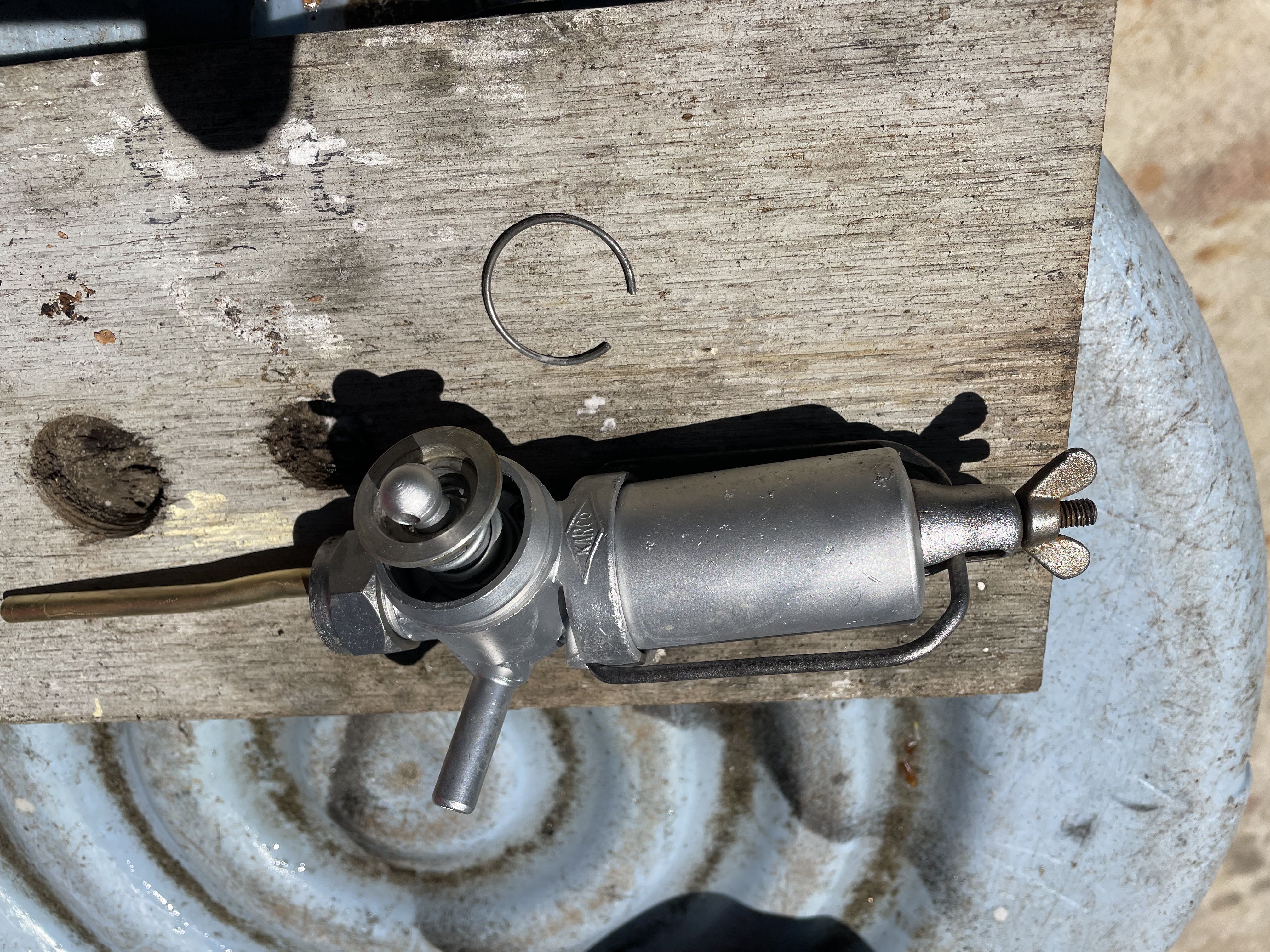

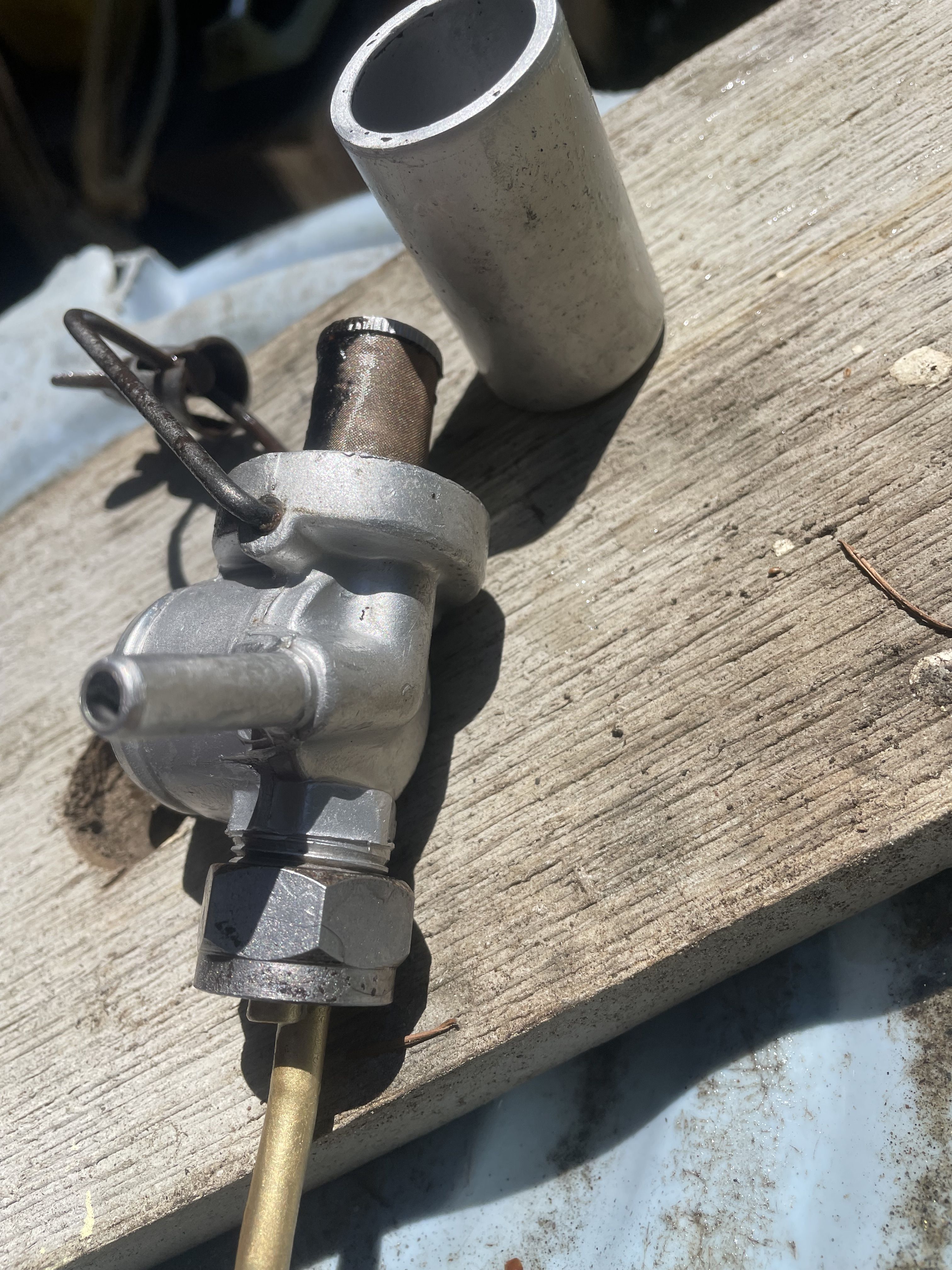

            Fuel cock…. Overhaul commenced

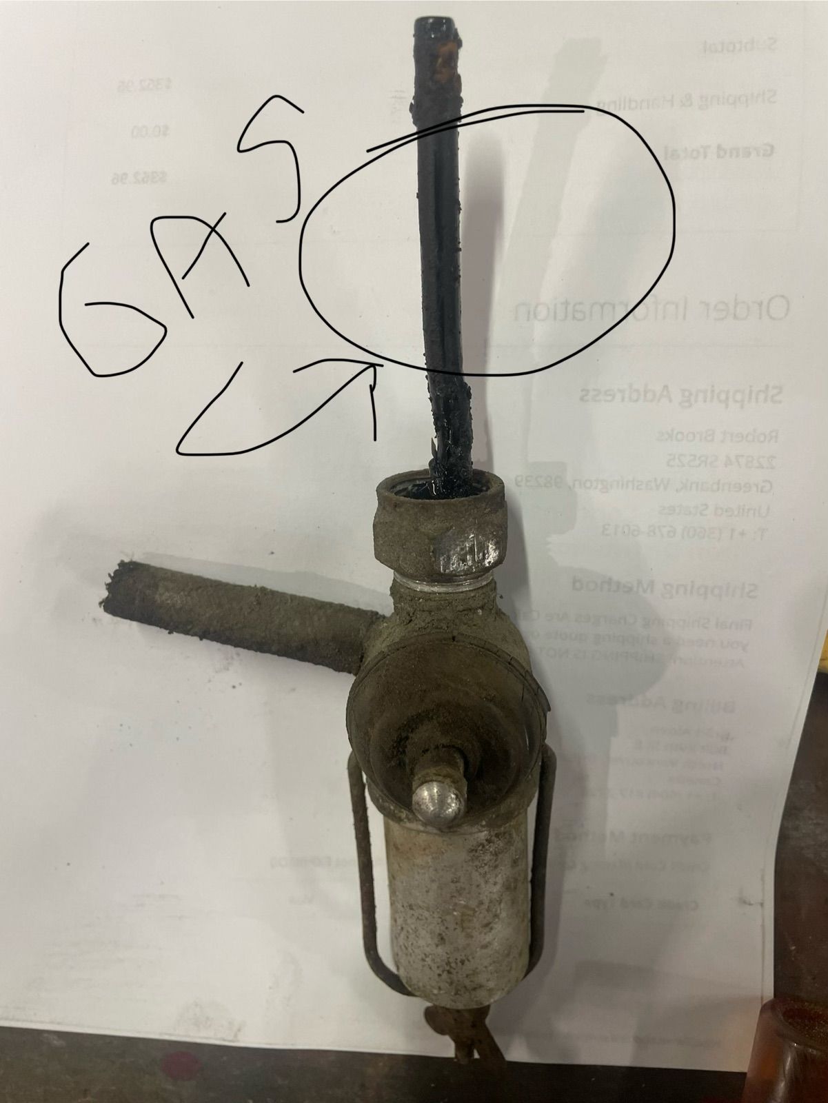

            We pulled the fuel tank, it is beyond economical repair, but did get the fuel cock to unscrew. The sludge in the tank retained the brass screens when I pulled it out. Really cruddy. So i tosses it the bottom of the degrease tank for a week. Pulled it out, not much difference wing nut frozen, selector rod still won’t turn.
            Processed it in the hydroblaster, 5 minutes later looks new. Wing nut turns, but the selector is frozen.

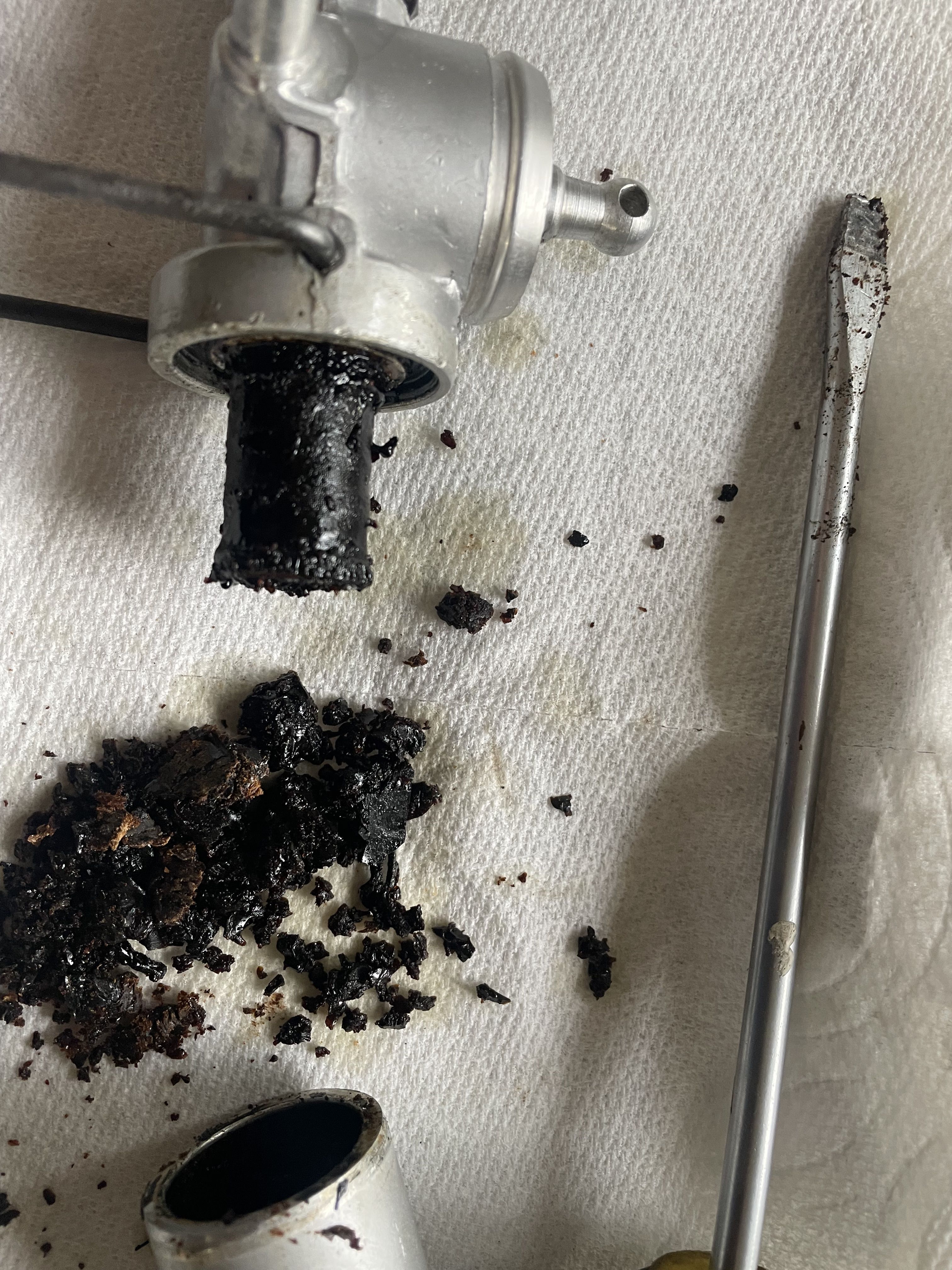

            Was a little concerned with the selector , until I removed the strainer. There was 3/8”of hardened gasoline in the bottom of the cup. Big screwdriver to pry it out. And the smell of coagulated gas is too strong to be around. The corks must be glued to the selector disc.
ID:	115389 Click image for larger version
            but it will go back in the hydroblaster, and then the ultrasonic tank. And maybe the a few days in evaporust and then an acetone bath. Pretty nasty. I left the fuel level sender in evaporust for a week, it looks new, and electrically test OK. Will still replace it, but it’s the second one that cleaned up with just evaporust soak
            My surface rust problem just went away !
            Thanks for looking, if you want to build a wet blast cabinet PM me l will explain what we did. I might have $350.00 in mine including some super “off-road LED” light bars inside. Mods to a 40lb Harbor Freight cabinet were easy, I can’t say enough on how well this works.
              Ya finally got it, Congratulations! That thing is amazing and am very jealous. I'd love to have that for my current project. What a luxury to be able to clean all those inner surfaces and cavities that the media blaster could not get to. That will clean paint off too, correct?

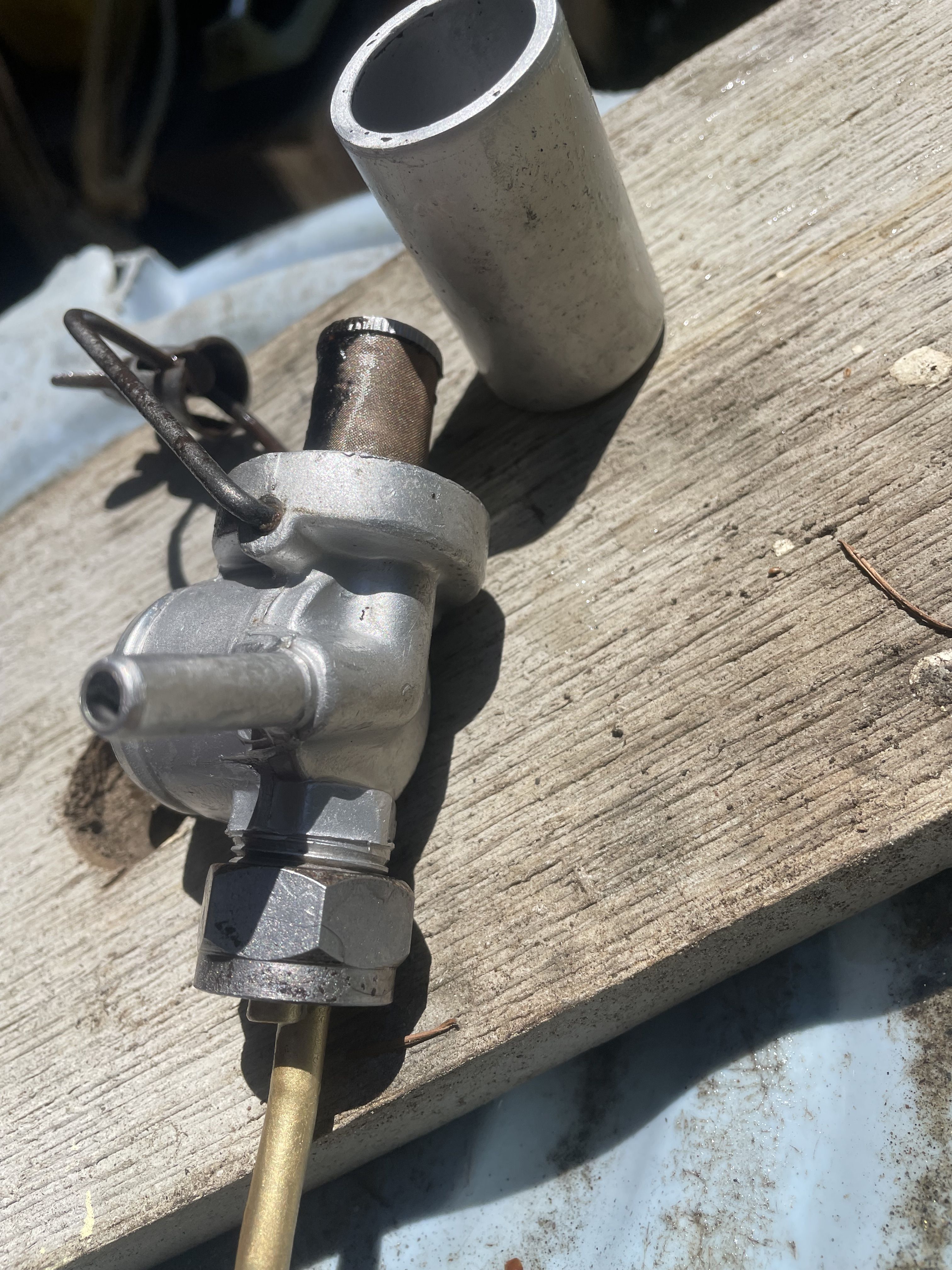

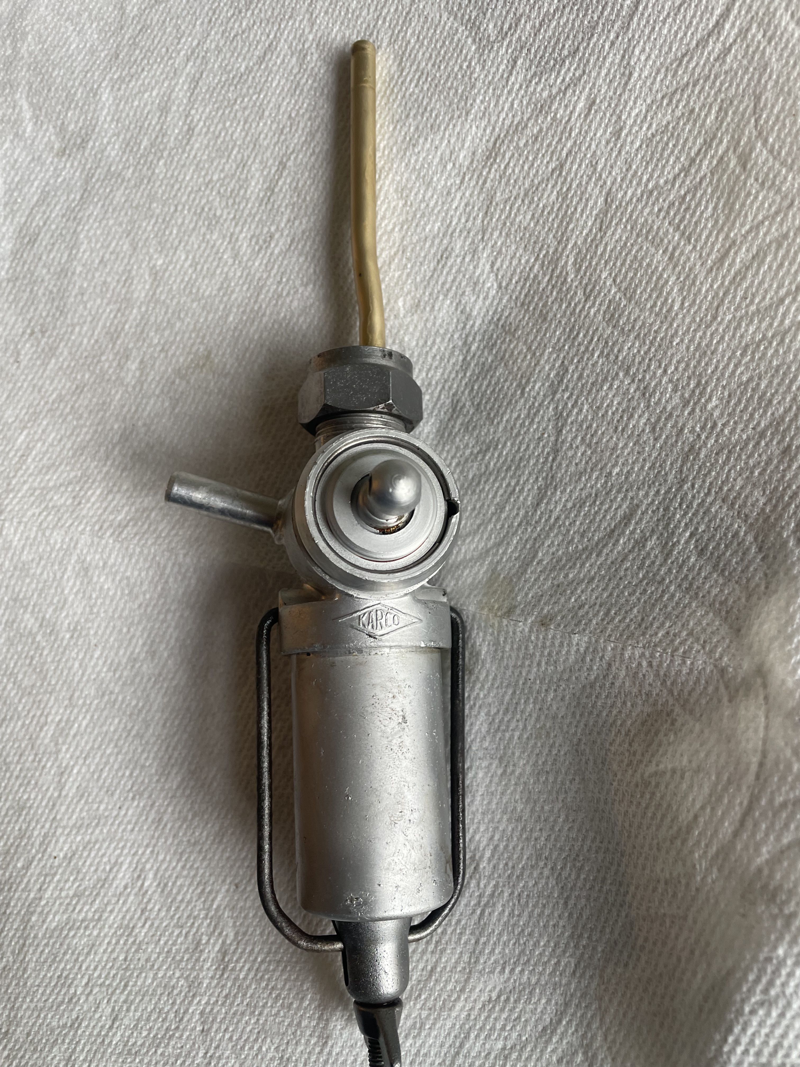

            Well that Petcock really amazed me. I restored mine a few years ago got the rebuild kit I think from Stoddards. Amazing what happens when its left for years. Your cleaning items John really are saving you so many problems. Excellent results.

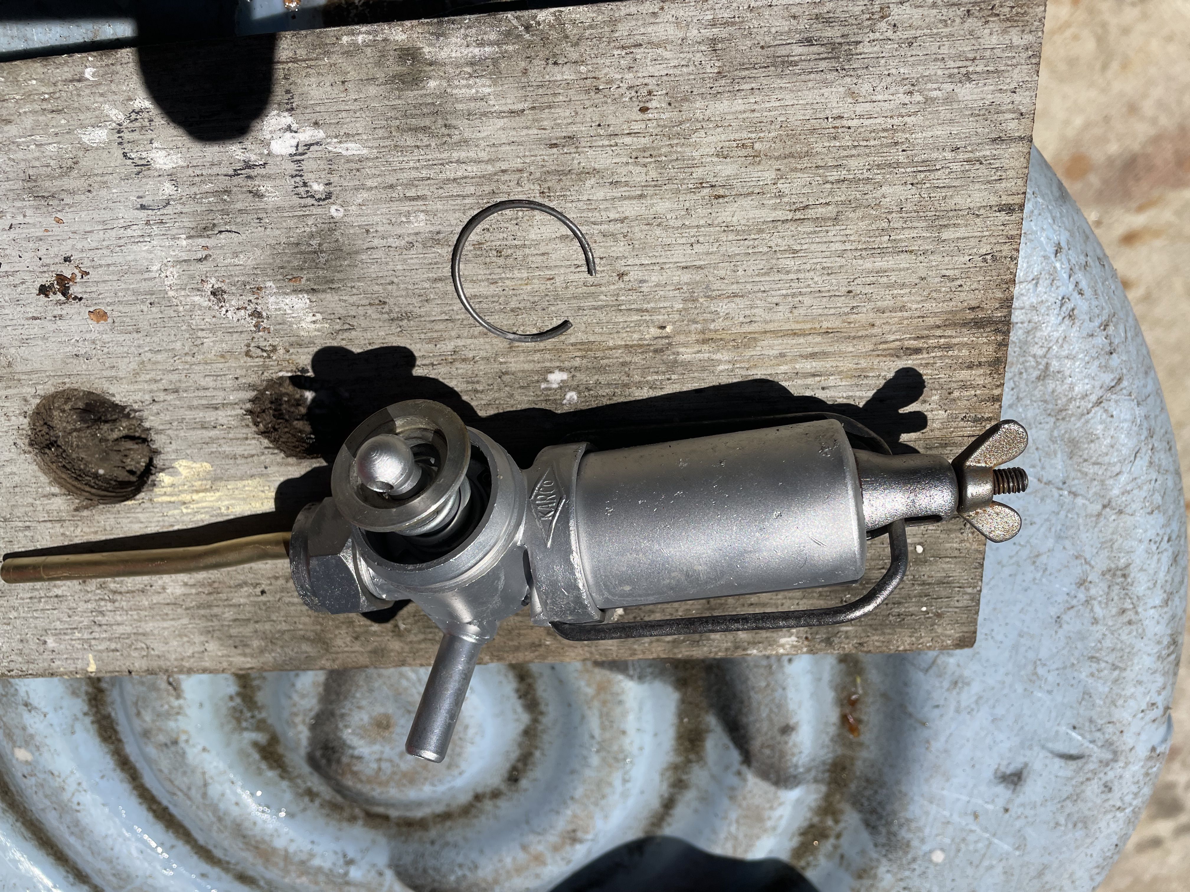

              Its done less the final assembly. the entire fuel cock was full of bitumen, all the internal passages, pipes valve. Beyond the worst one I have ever rebuilt. Soaking in acetone did almost nothing to dissolve the goo. Spray carburetor cleaner just bounced off. but I got it and another original part stays with the car. Wet blasting is the savior of this part,
              Third photo shows 1/2 of the filter screen after cleaning
ID:	115397 Click image for larger version
ID:	115398 Click image for larger version

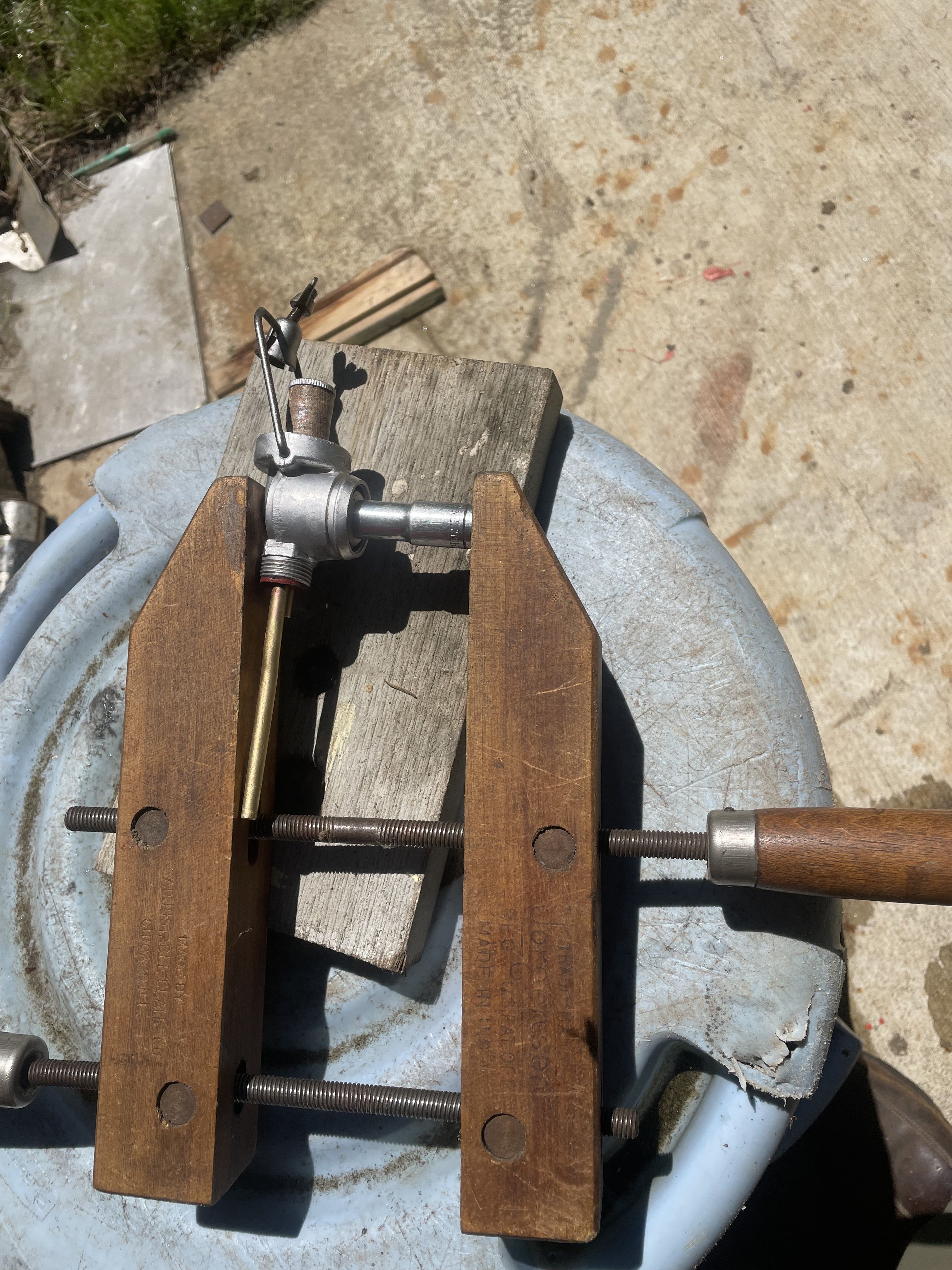

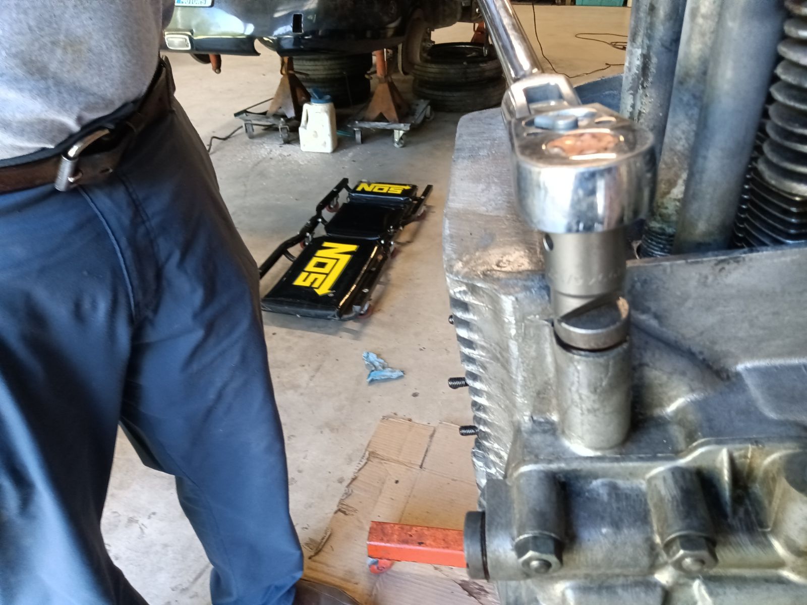

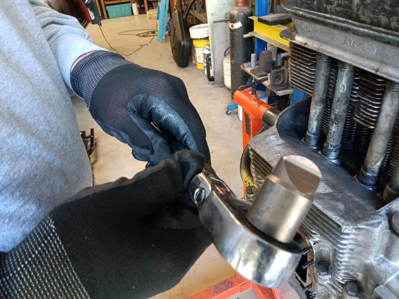

              My special tool for fuel cocks. Jergeson clamp and deep socket. Compresses the spring so you can get the snap ring.
ID:	115394 Click image for larger version
              Brake calipers are assembled and ready to install tomorrow. we will flush the metal pipes with alcohol and blow them dry before installing new flex hoses and a master cylinder. Once the stoppers are installed an bled its off to the fuel system. rebuild the pump, flush the lines, replace the flex hoses install a new gas tank and pressure check the system. we progress

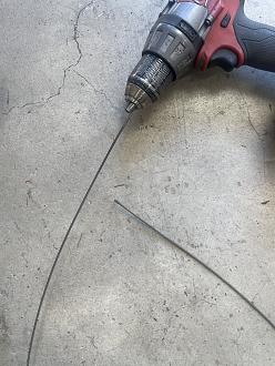

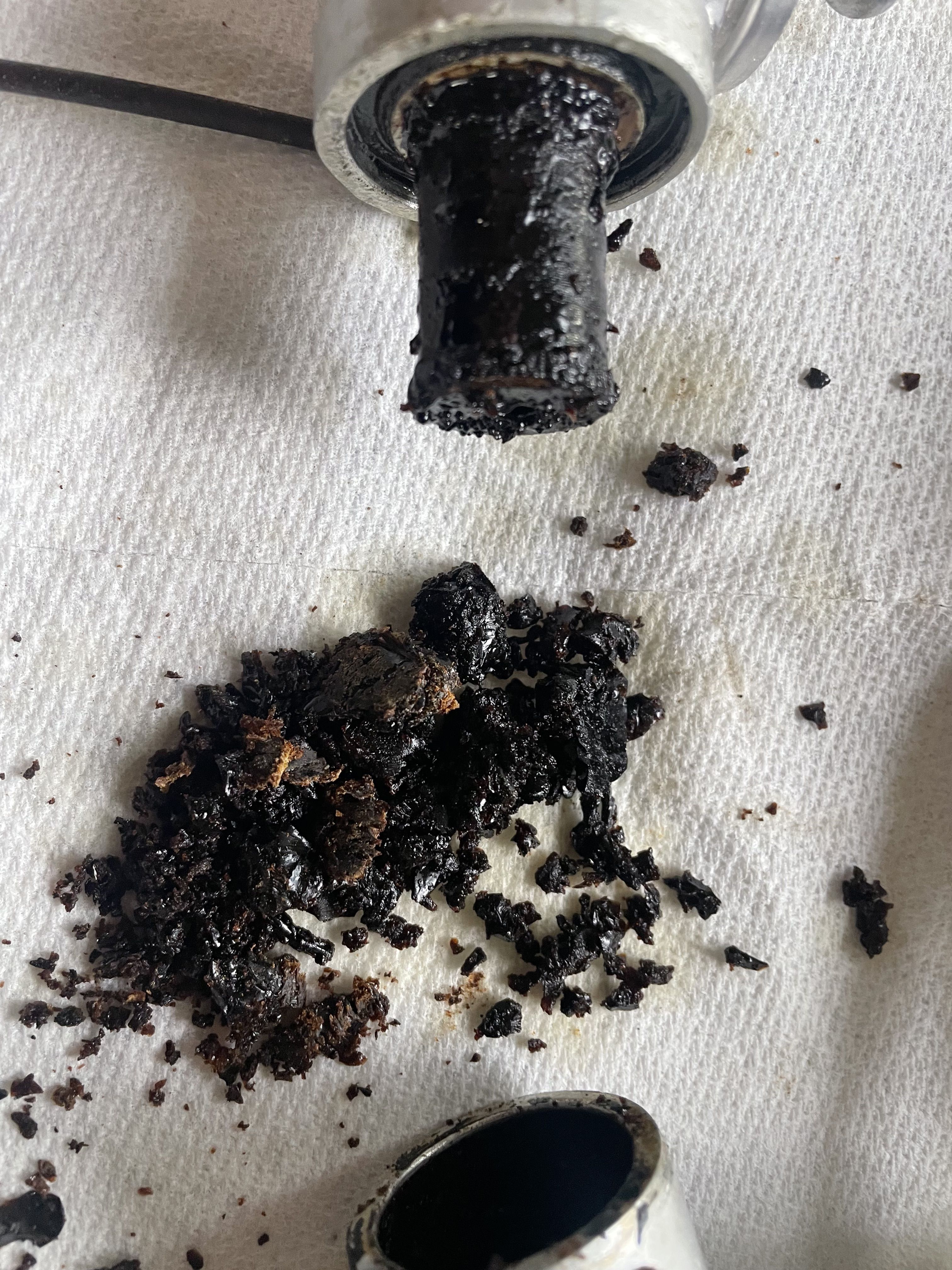

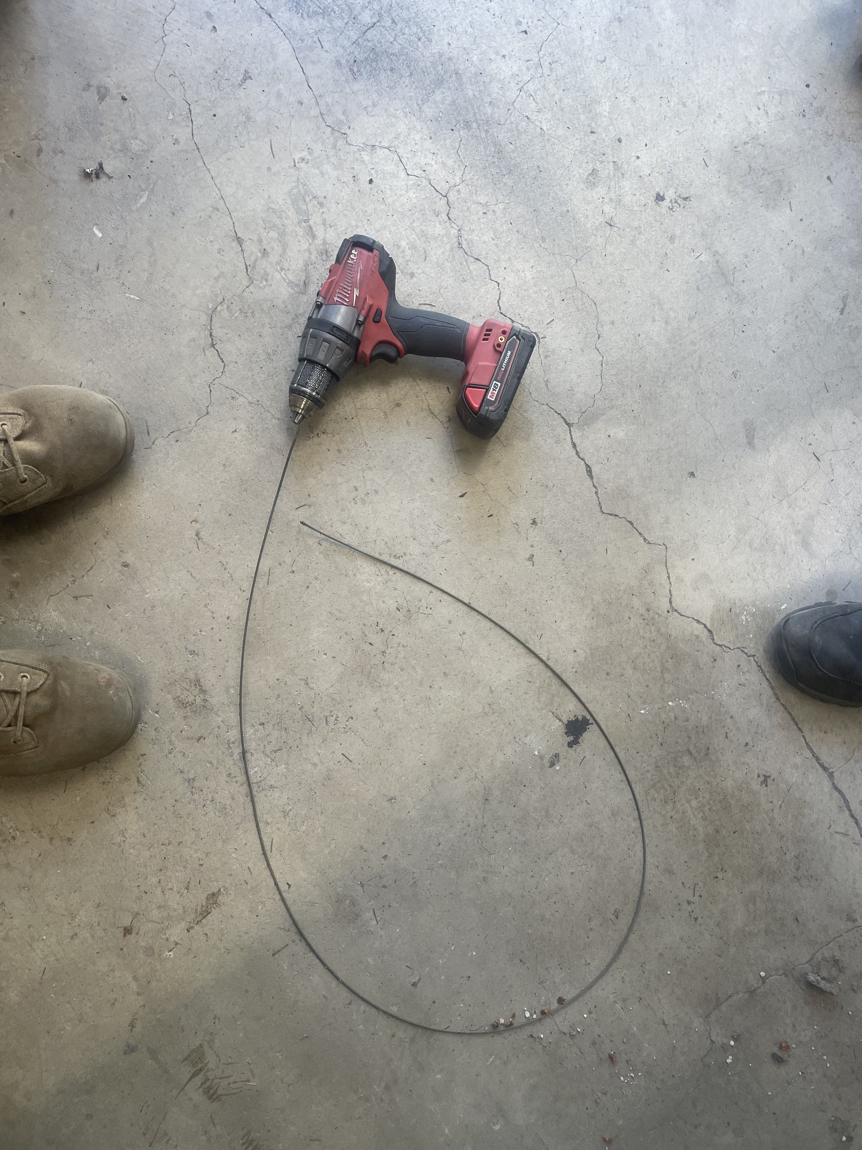

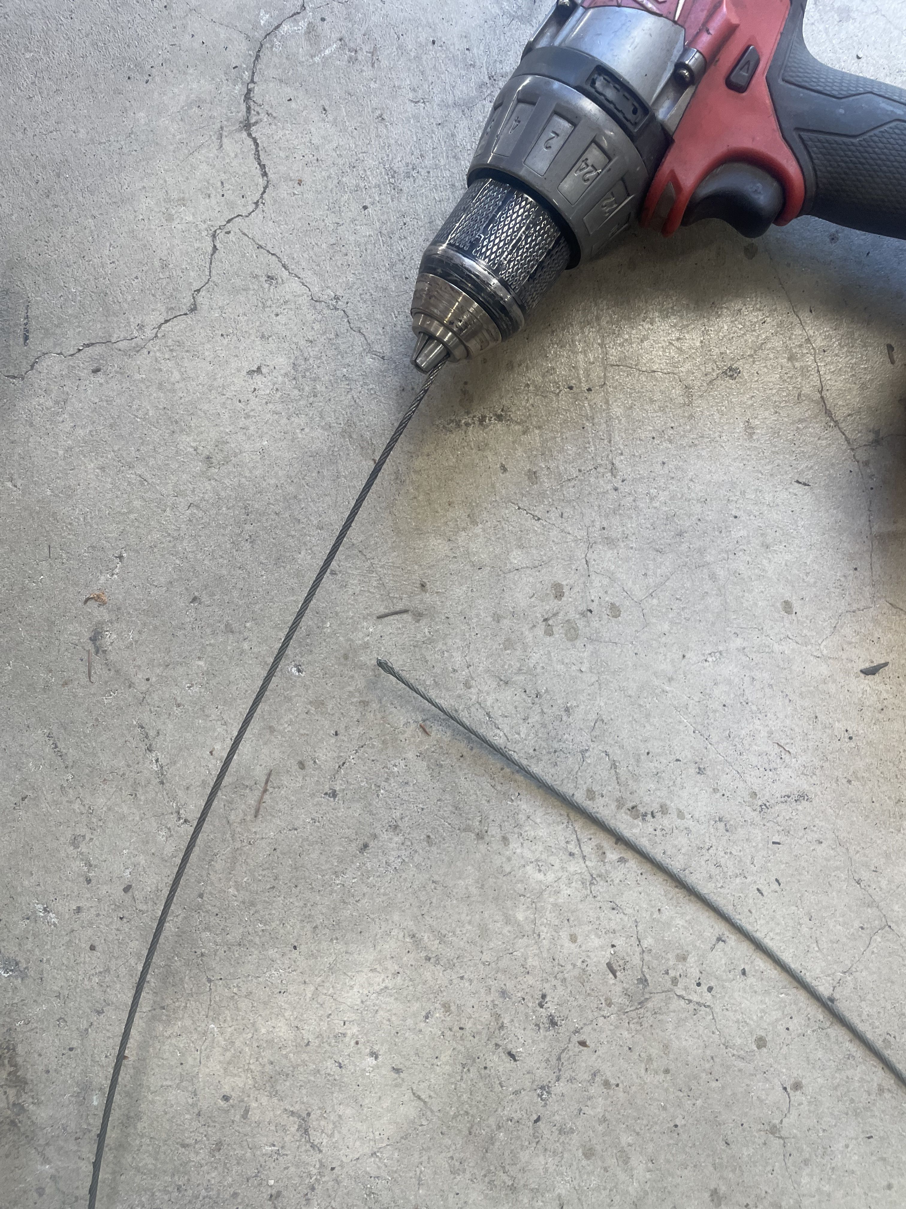

                Not much exciting today, got the main fuel line cleared, it was full of the black goo like the Fuel cock. After 3-4 hours with Carb Cleaner standing in a collum into the pipe in the trunk we gave up an ran a 1/16" 7x19 wire cable through the line from both ends. Even after pushing the cable through about 6' the main line was still blocked. so we put a drill on the end of the cable an spun it. The end of the cable was a little frayed and worked like a wire brush. We got 1/2 a cup of black gel out of the line, blew air though the line, added acetone soak and more air.. Line runs clean.
ID:	115423 Click image for larger version

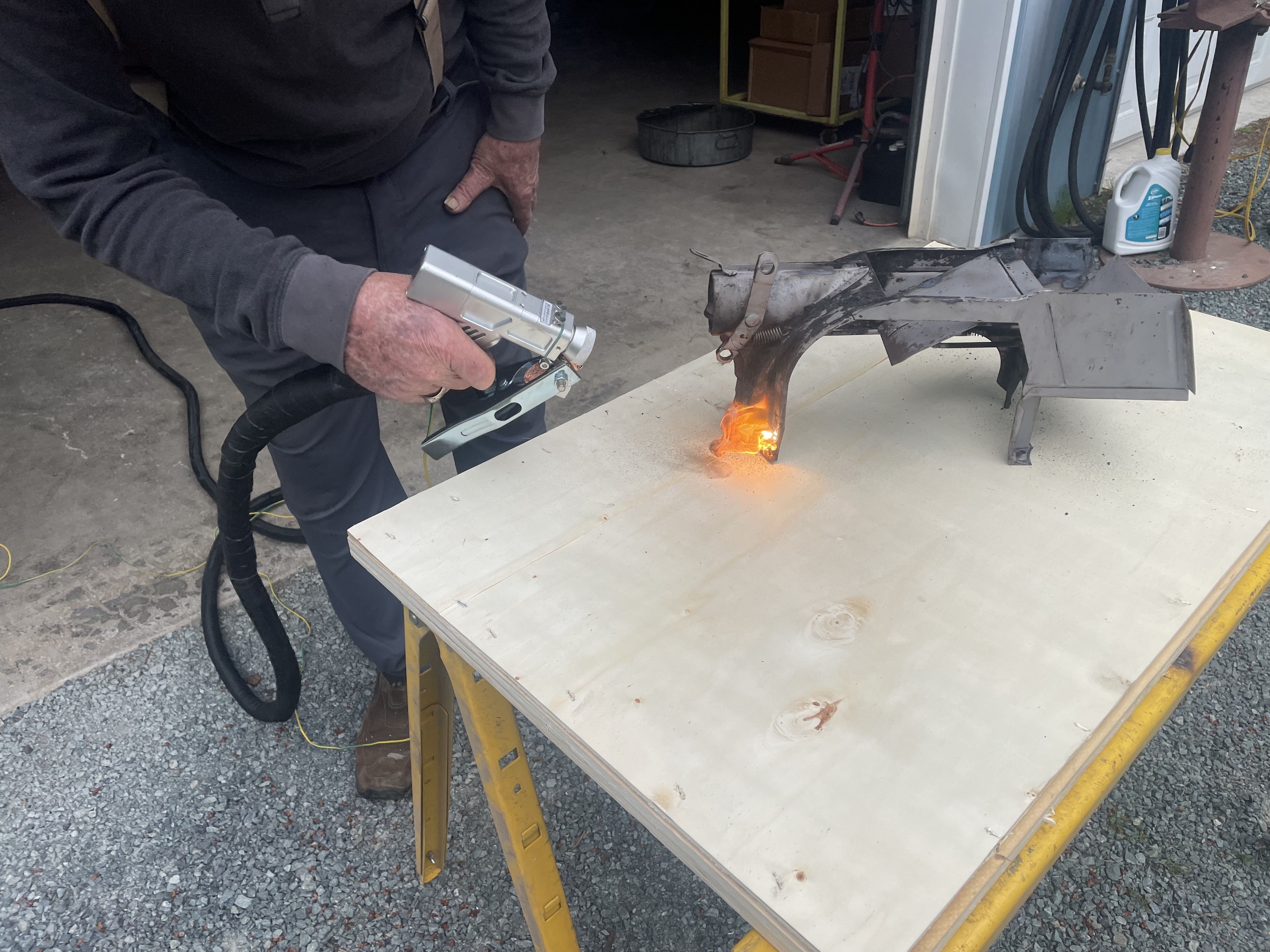

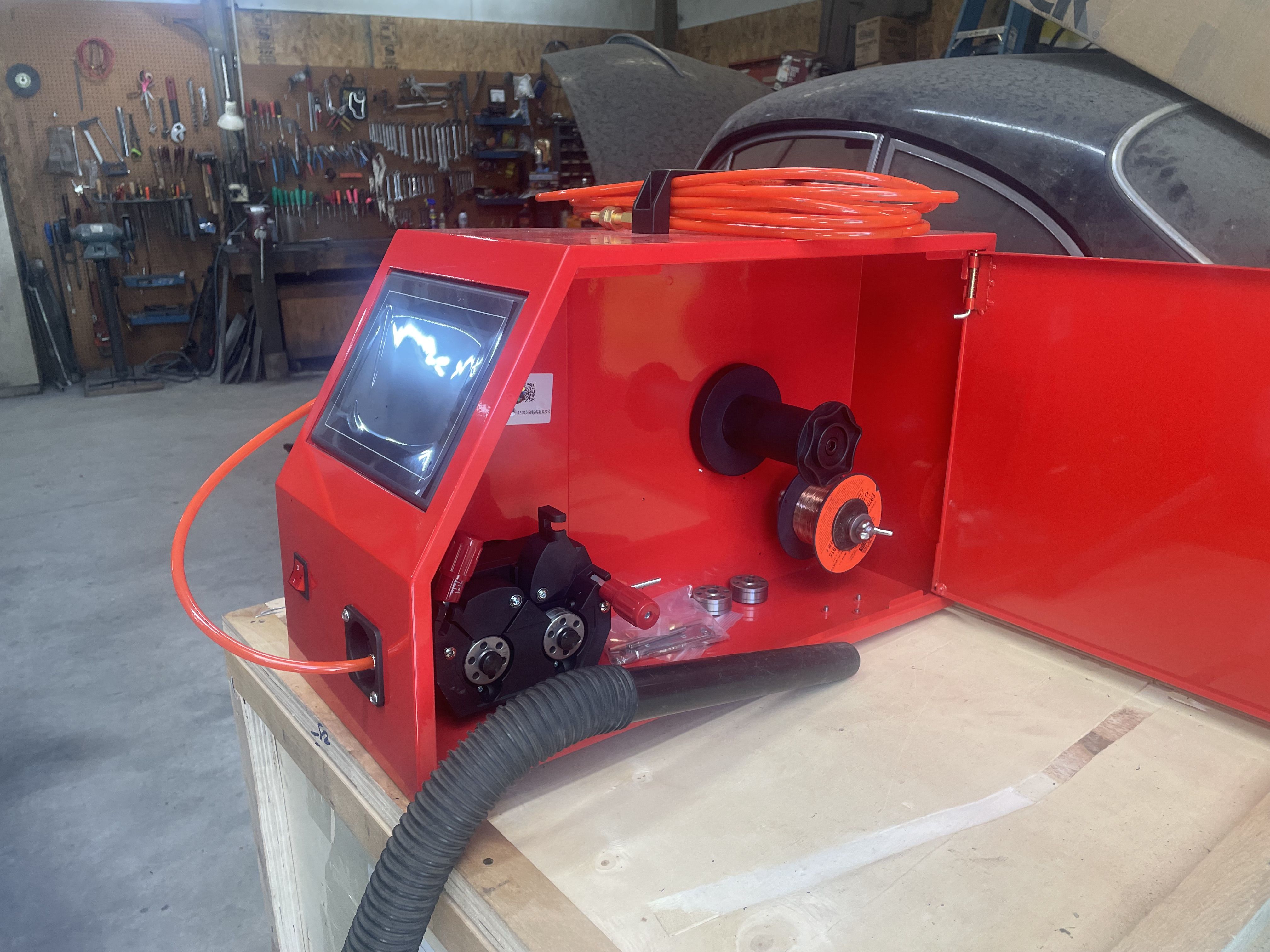

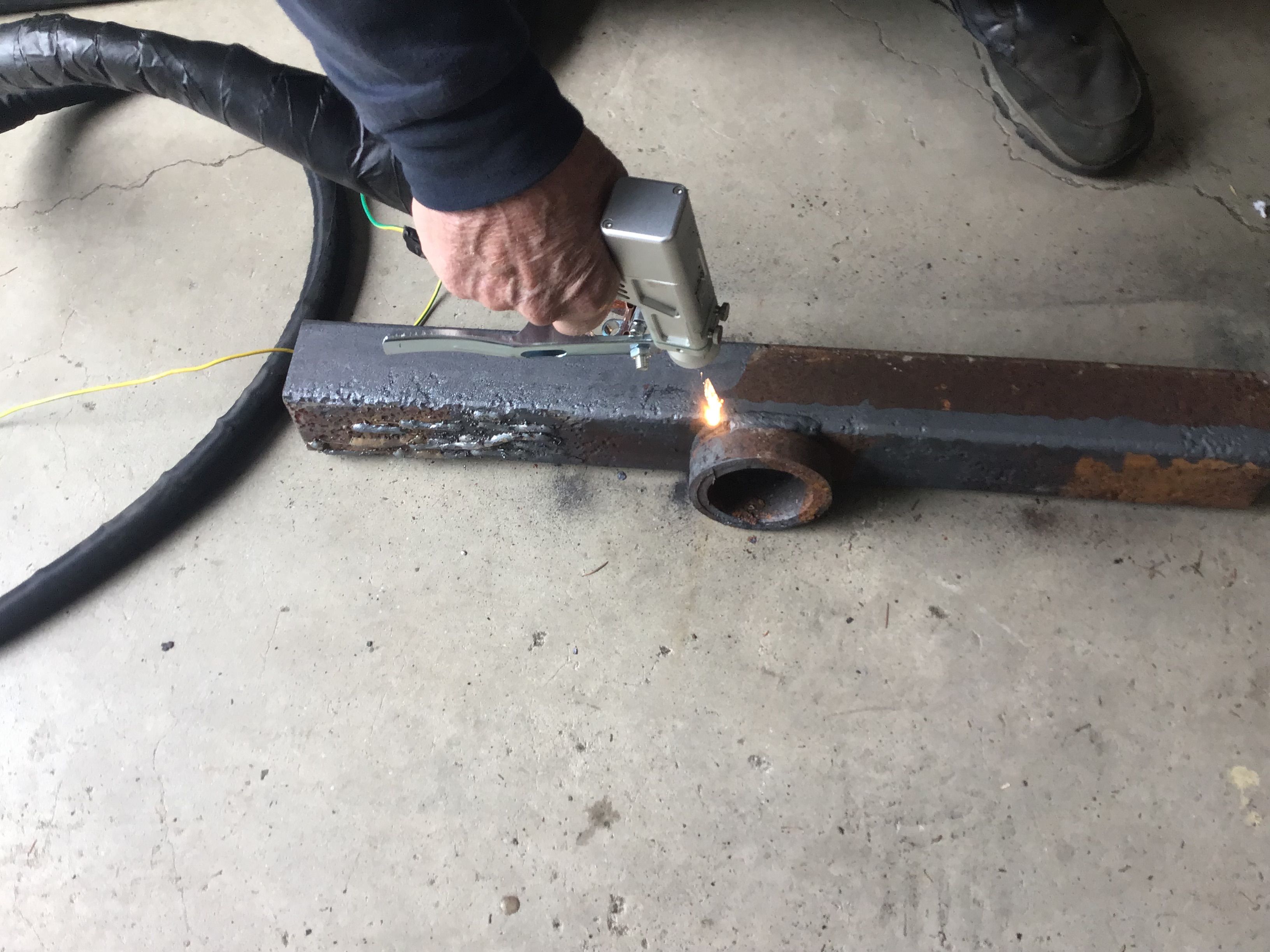

                The FDA CDHR Field Engineer cam by early to do the inspection on the laser welder, pretty simple 5 hours I wont get back anytime soon. but after hundreds of photos and questions, The report is off to DC tomorrow. Should hear back in 1-6 weeks, but its works well I really like it. I did a 0.5mm weld bead on a 3/8" aluminum plate. Cleans just like the YouTube videos. I like it!
                We also modified the wire feeder to take small spools of wire.

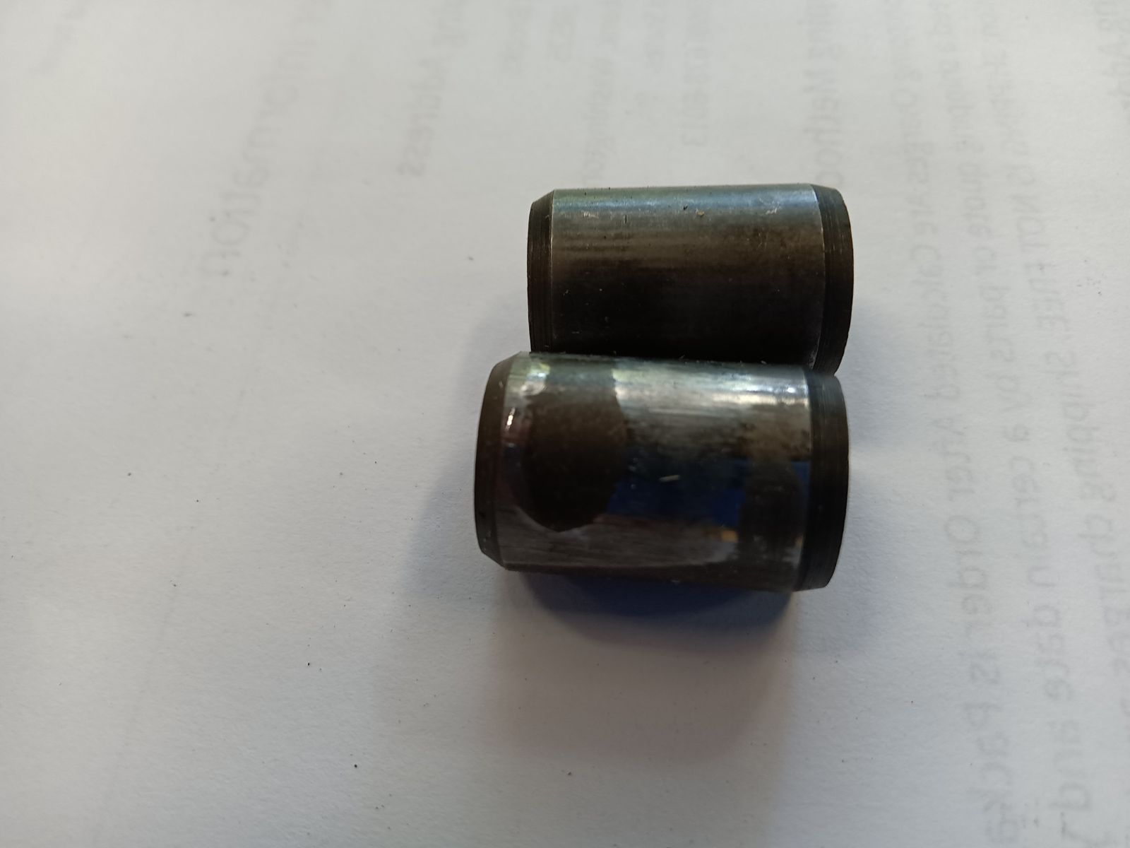

                  Today was slow, removed brake lines preparing to install new hoses. Only took half the day, but slow and steady. Was very lucky did not twist or brake a hard line. I can’t say enough good things about snap on flare-nut wrenches. Wire brush the nut, then overnight with PB Blaster. They were tight but came loose.

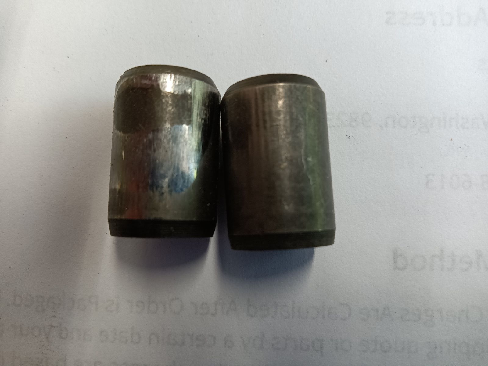

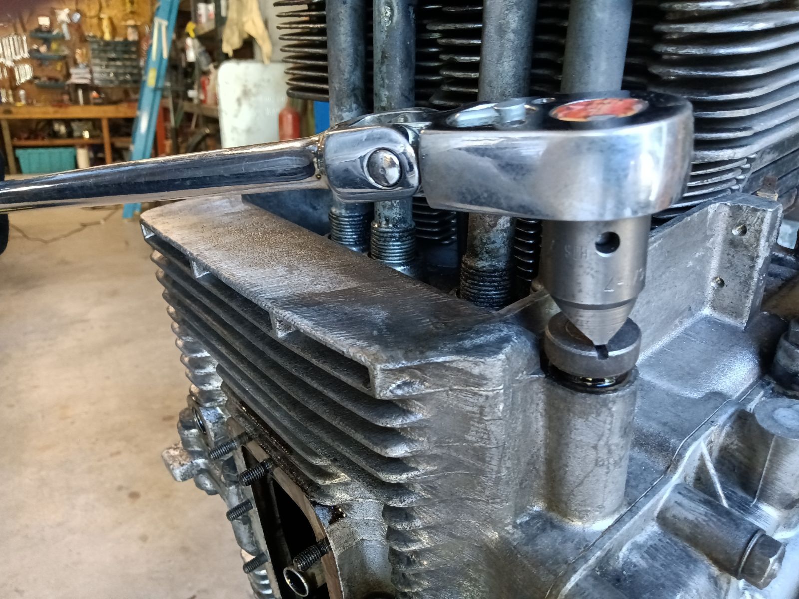

                  Also pulled the oil pressure and temperature pistons to take a look. Someone has been in the engine before. After cleaning the cylinders have numbers filed on the fins, and Permatex on the case center. The crank end play and connecting side clearance are good. So I wanted to look the pressure piston/plunger and springs. The oil pressure piston is galled pretty bad. Will get a borescope in the gallery tomorrow. I think it has been sticking 1/2 way down. I will replace both pistons.
                  Click image for larger version  Name:	image000000.jpg Views:	0 Size:	160.3 KB ID:	115428 Click image for larger version  Name:	image000000 2.jpg Views:	0 Size:	95.5 KB ID:	115426
                  Side note:
                  Also DONT use a SCREWDRIVER on the slotted bolts. They are “high torque“ fasteners, not a BIG straight slot or a pipe wrench. Get the proper P-Tool or an “APEX HTS #7 high torque driver”. Don’t leave the next guy a buggered up bolt.
                  Click image for larger version  Name:	image000000.jpg Views:	0 Size:	212.7 KB ID:	115429 Click image for larger version  Name:	image000000 2.jpg Views:	0 Size:	306.8 KB ID:	115427

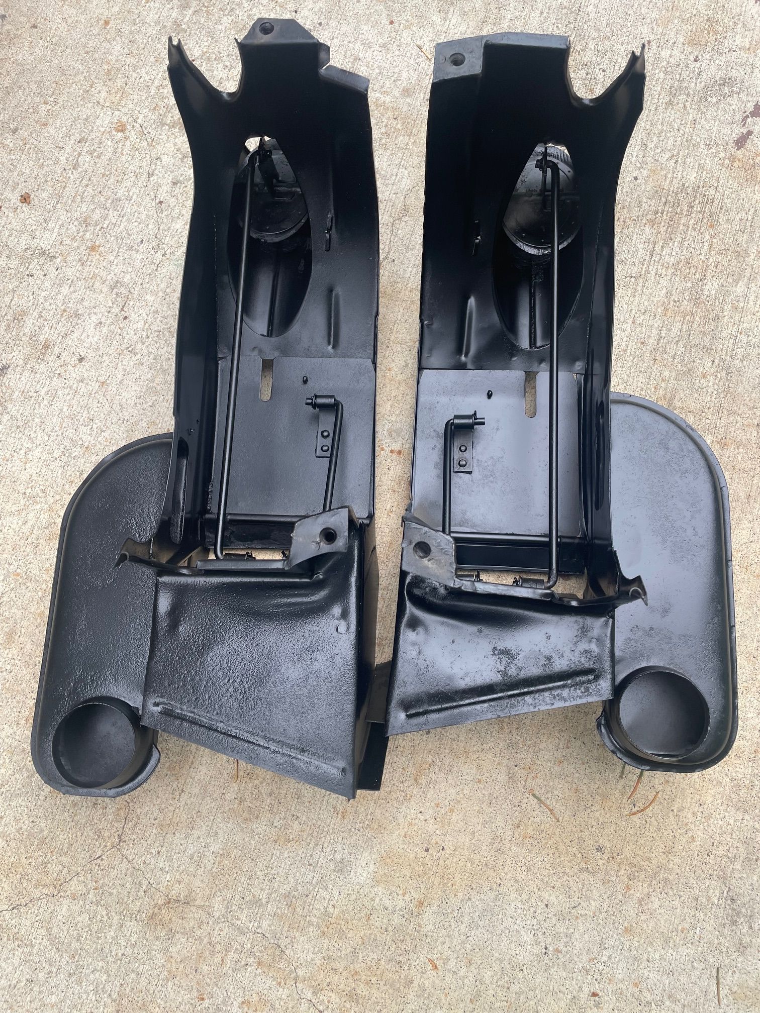

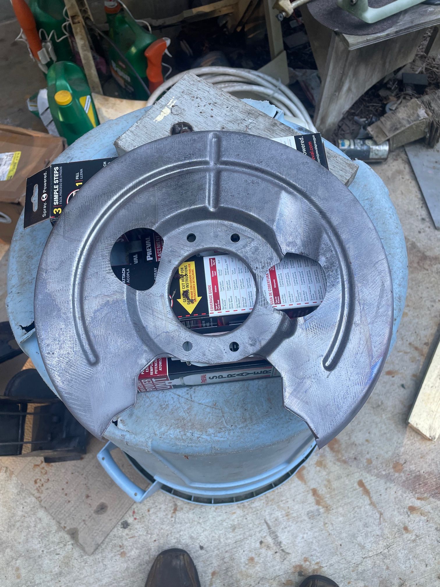

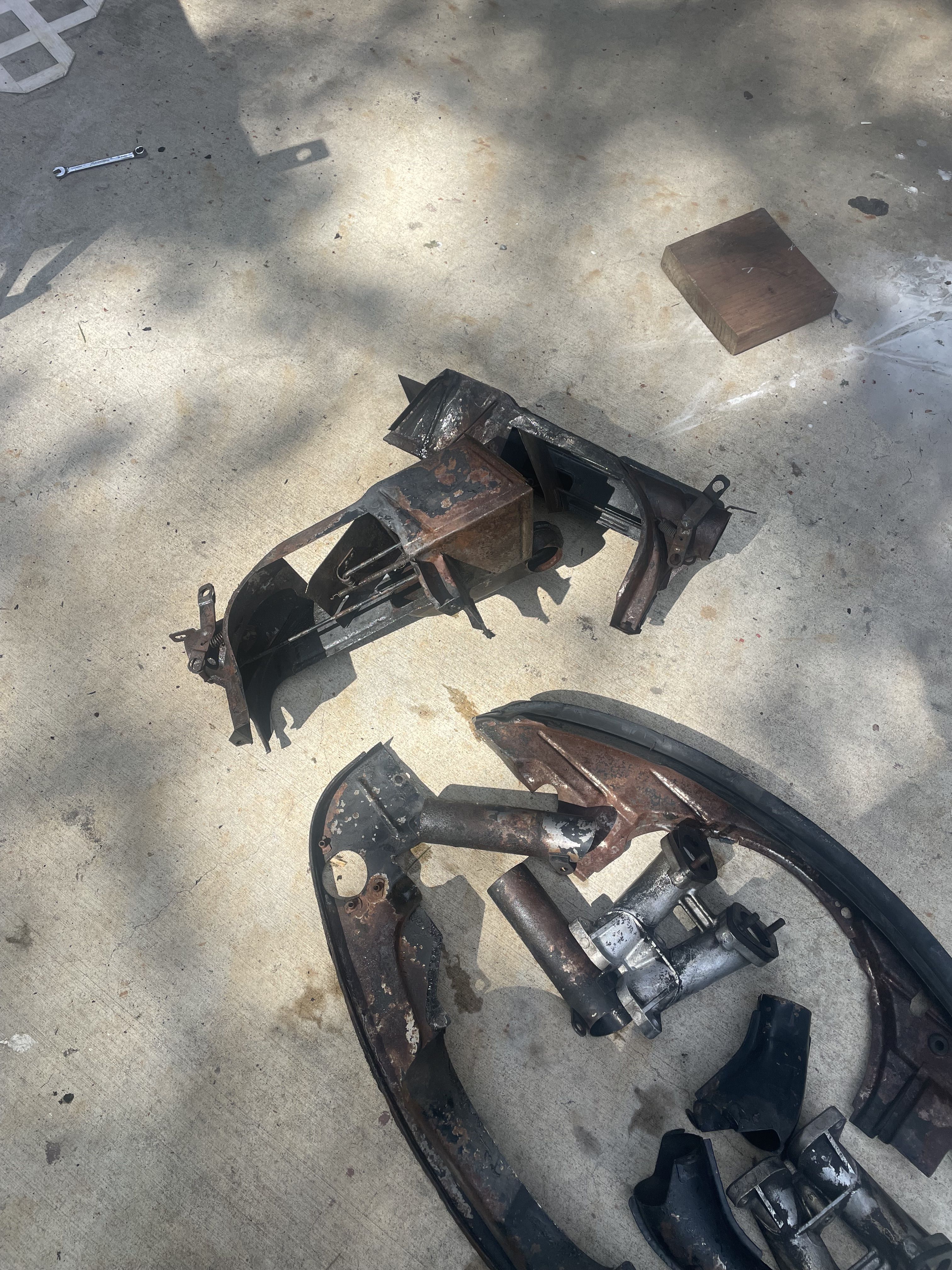

                  This evening I pressure washed and cleaned up the flapper boxes and large tins. Once the oil and grease is gone we can zap the rust with the laser. Both need some hammer and dolly work and a complete rebuild. Then into the power coat oven.
                    Having the right tool for the job. Nothing more important.

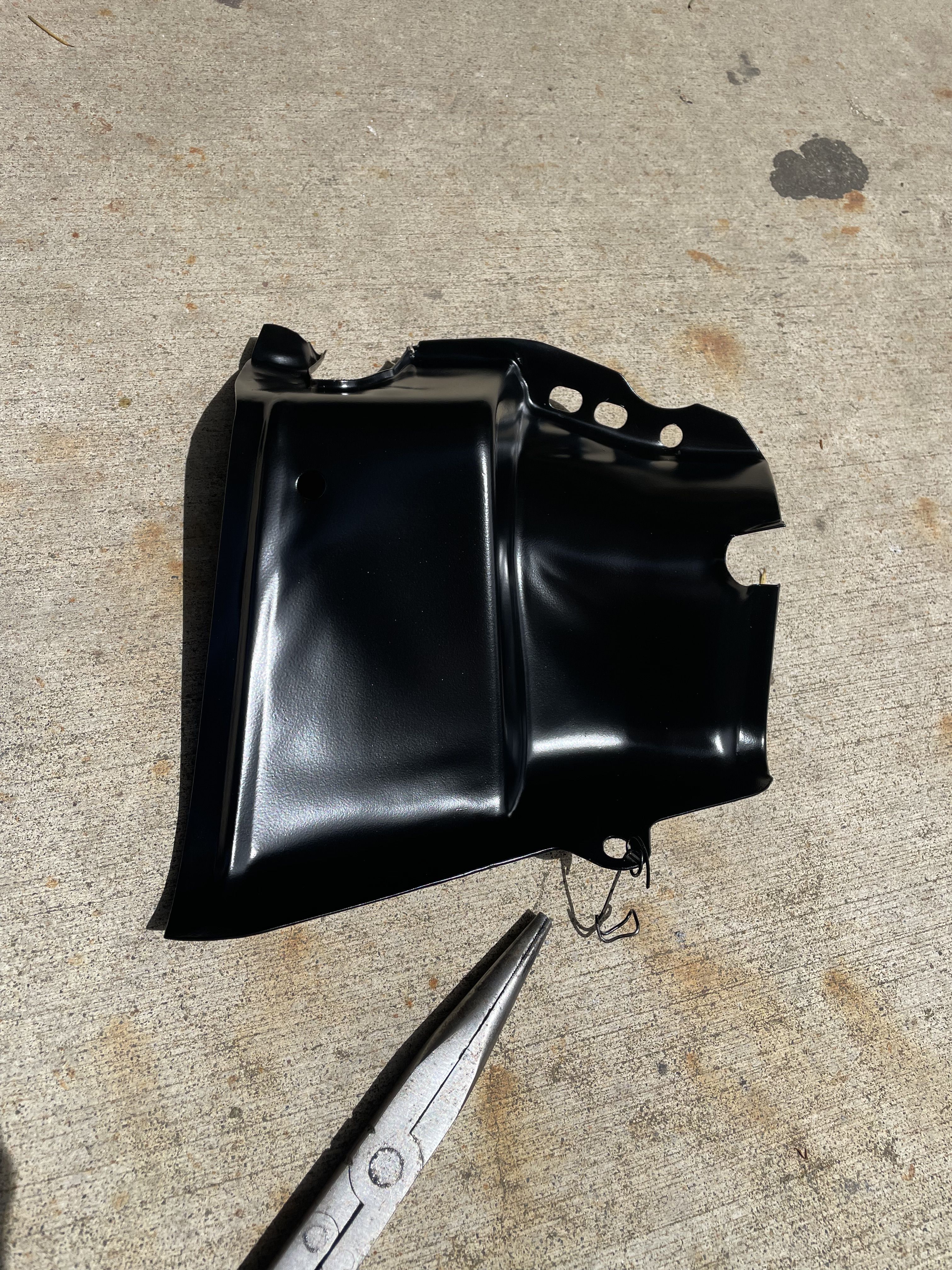

                  More cleaning and fixing the flapper boxes and long tins. A little hammer and dolly, align flaps adjust rods.

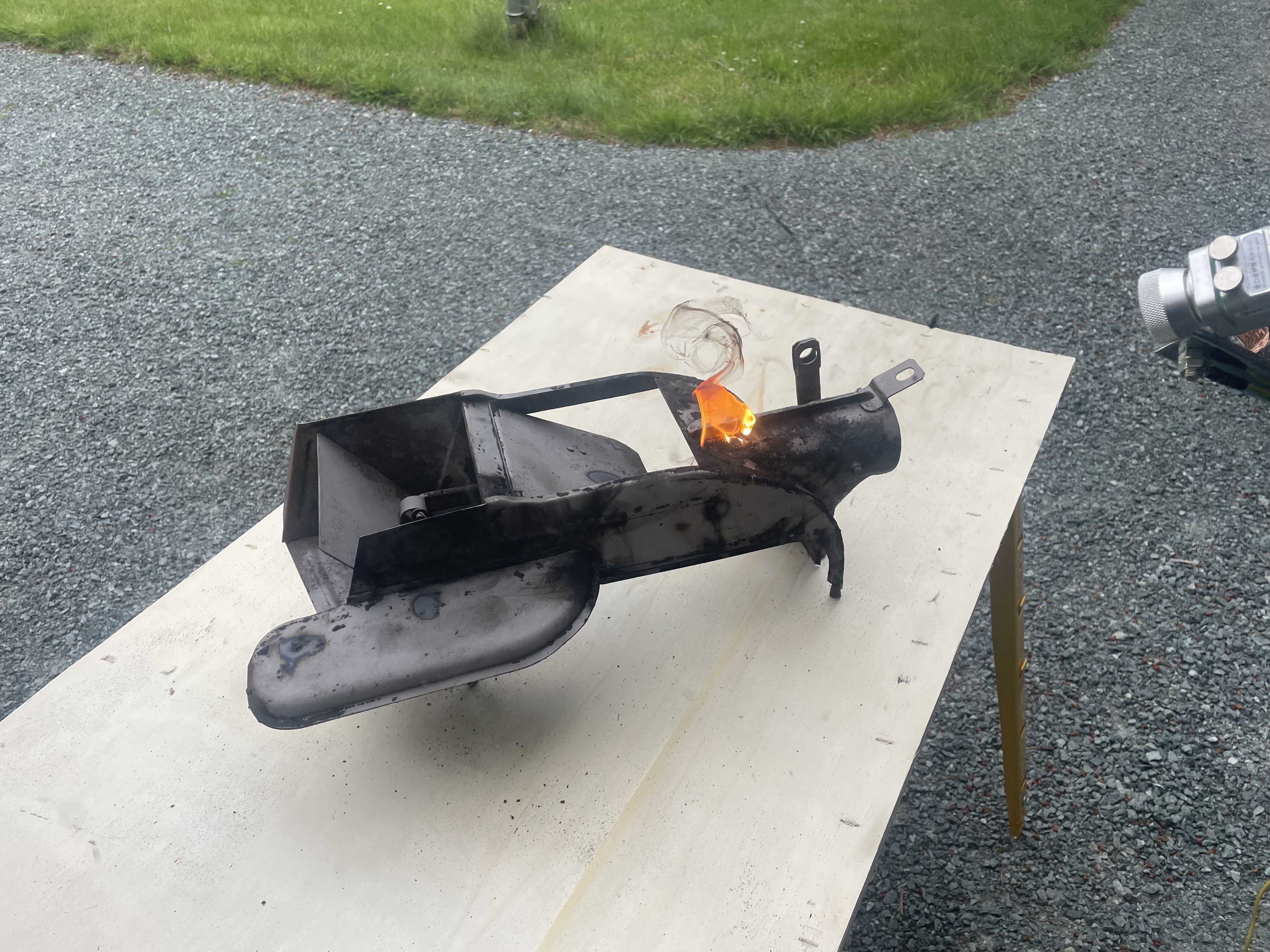

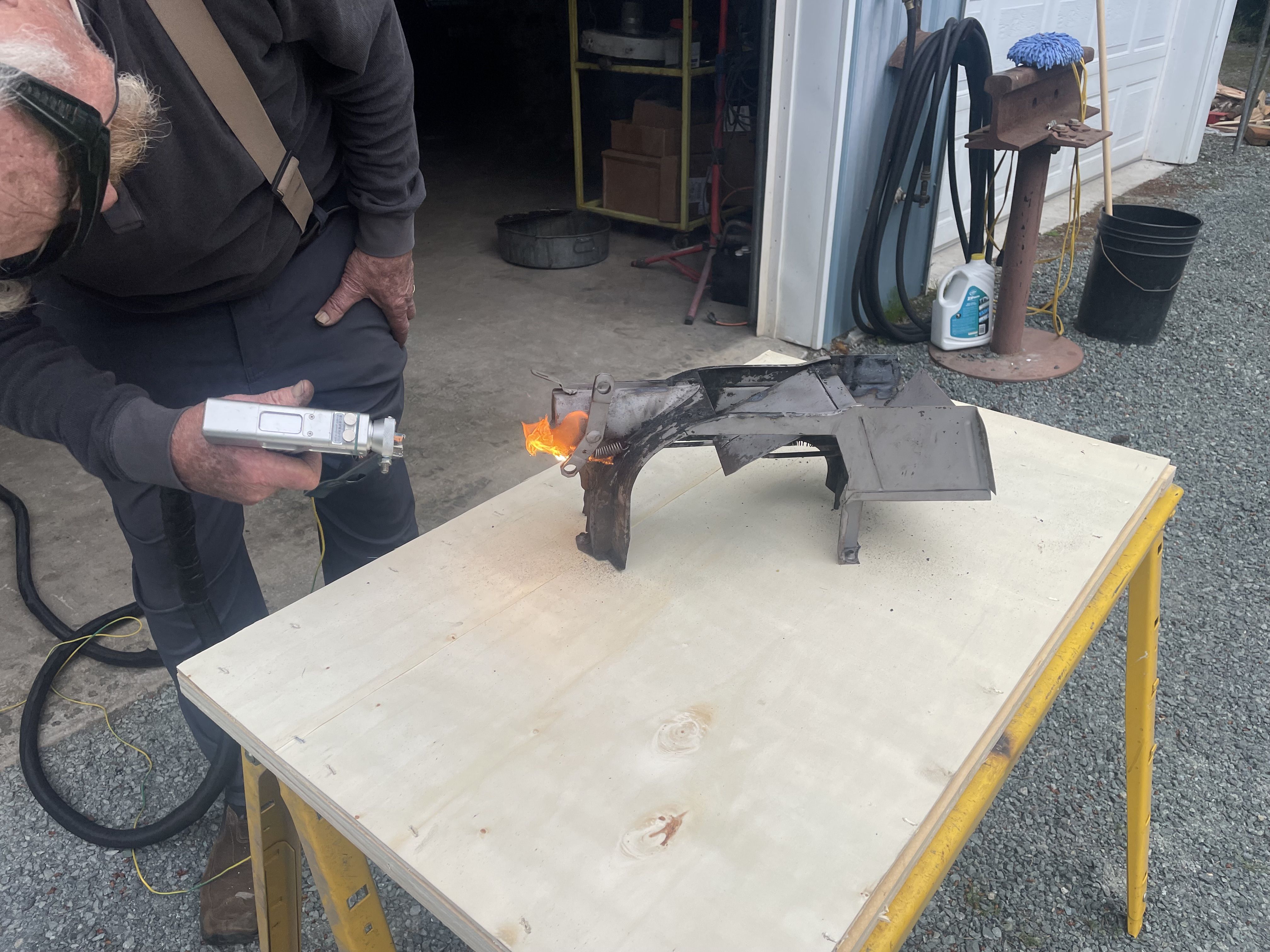

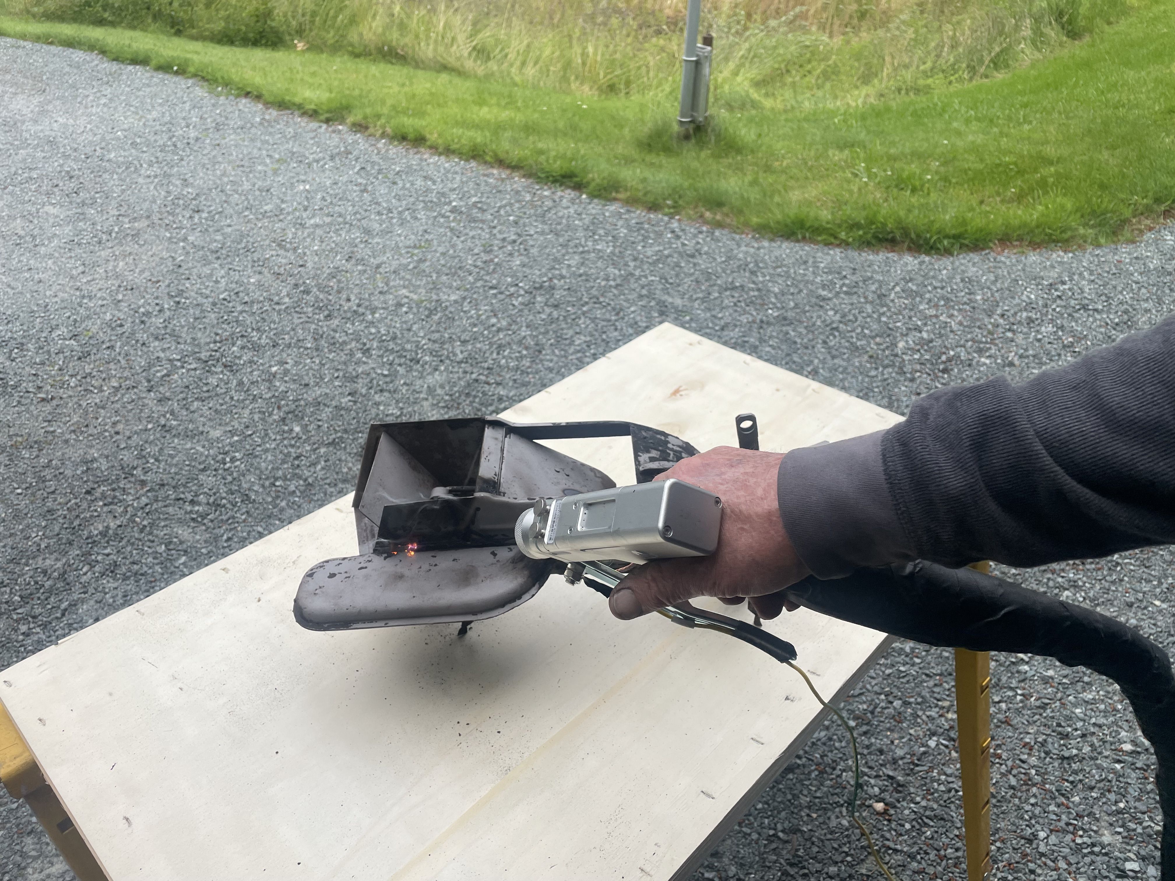

                  Still trying to figure out the laser. Started at 200W too much for sheet metal. Went down in steps to 20W. You can see a couple blue spots in the photos. Still trying to figure out the system. There are 3 variable adjustment's to play with , power, scan rate, scan width, in addition to the distance from laser head to target. As you can see the oil/ grease makes an instant flame, lots of heavy soot. But it’s working, I believe but the chinglish manual is not the best.
                  Click image for larger version  Name:	IMG_6766.jpg Views:	0 Size:	1.51 MB ID:	115433
                  Click image for larger version  Name:	IMG_6764.jpg Views:	0 Size:	1.73 MB ID:	115434 Click image for larger version  Name:	IMG_6762.jpg Views:	0 Size:	1.68 MB ID:	115435
                  Click image for larger version  Name:	IMG_6749.jpg Views:	0 Size:	2.34 MB ID:	115436
                  We tried numerous several settings, different power levels , beam widths, distances and sweep rates. Looks like 500mm for distance, 20 watts, 50mm wide and 100 sweeps per second was the best. But we managed to set soot on the lens and burned a hole it it so I stopped to go review the manual and see what it says.
                  But so far I like it. It’s clean, let’s see how power will stick to it. Got home, put one flapper back in the blast cabinet, cleaned right it. Most of the residue from the paint, grease and undercoat was just a black ash. Places I missed with the laser were odious but with practice I think it will do the job.
                  thanks for looking.

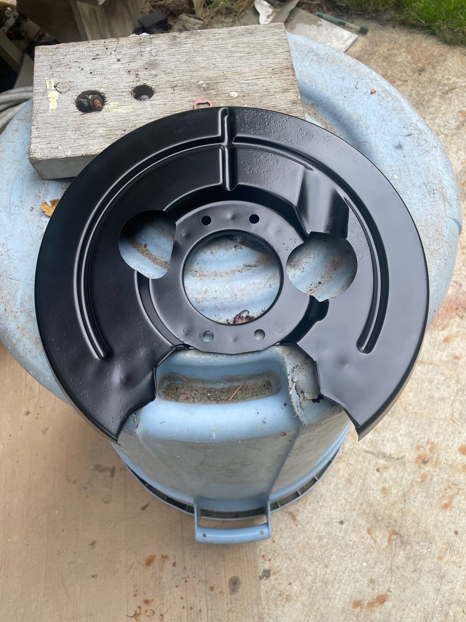

                    Interesting, so would you say a limitation might be with thin, painted, grease coated sheet steel? How did it react with those alloy intakes?
                • #28
                  it works, but the wet blaster is better, it can leave laser scan lines in the metal . Won’t burn silicone, but I did not really try hard
                  Click image for larger version  Name:	IMG_6753.jpg Views:	0 Size:	1.04 MB ID:	115446 Click image for larger version  Name:	IMG_6752.jpg Views:	0 Size:	1.60 MB ID:	115447

                  John interesting work and methods ! Cleaning that fuel pipe with the wire was really good thinking and there are so many tools you need to do these jobs properly. I would lioke to have the experience of the latest welding gear now available. After a some years of using oxy/acetelene and then a very short trying MIG I realised just how far things have moved on in nearly 50 years since I last held a torch,

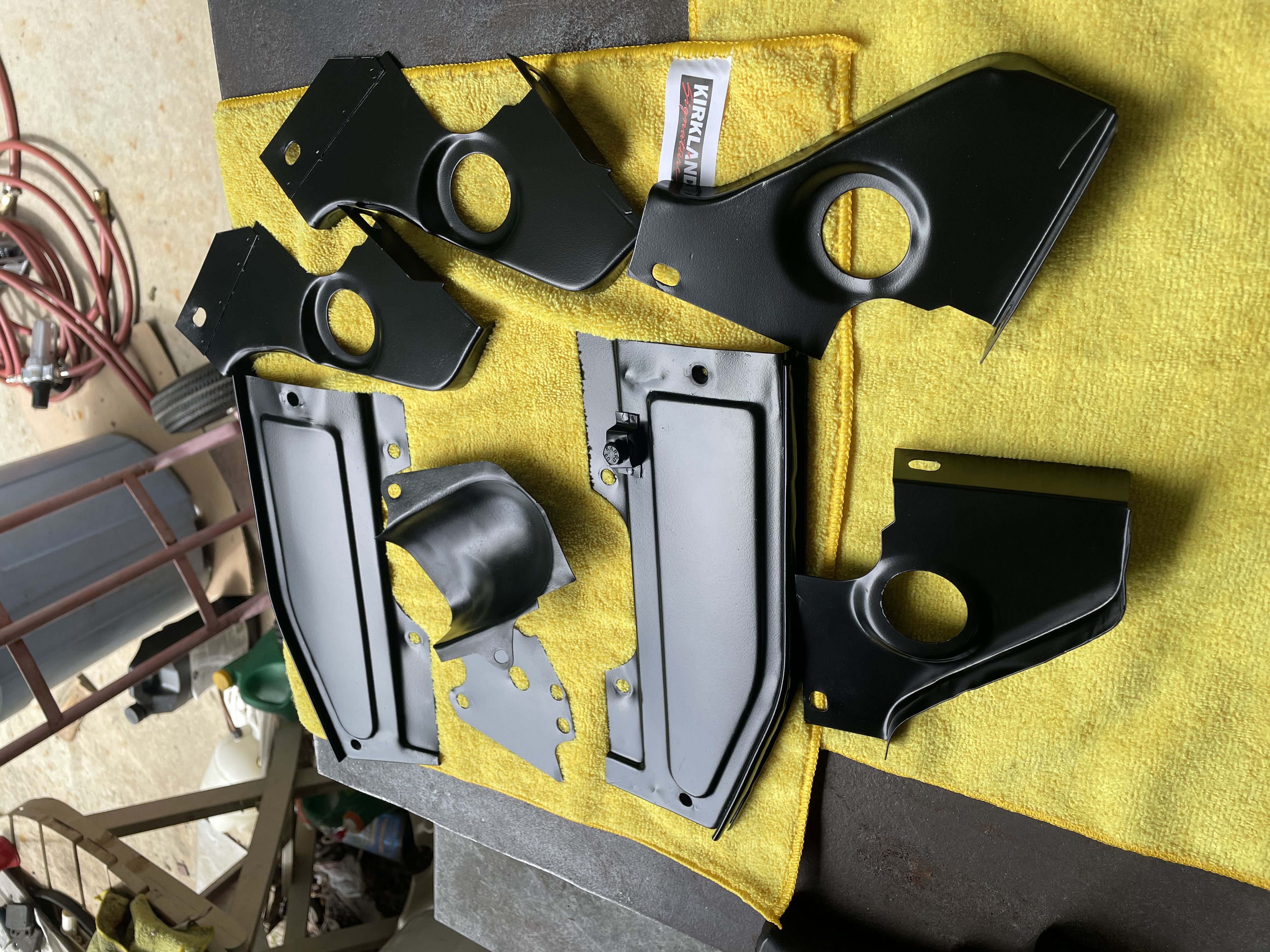

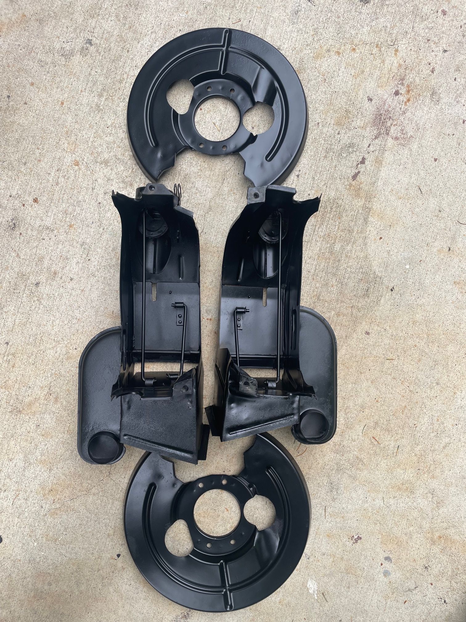

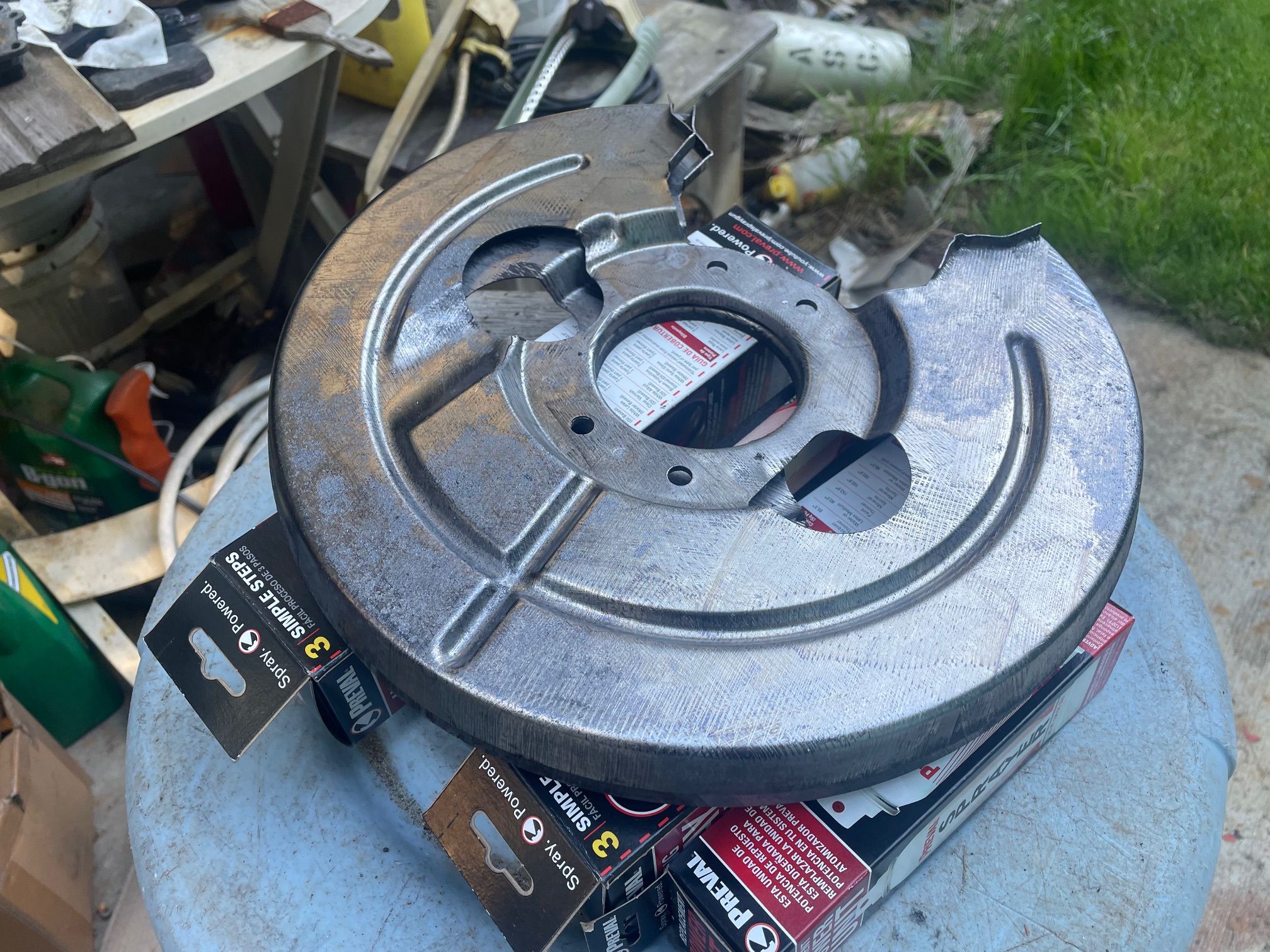

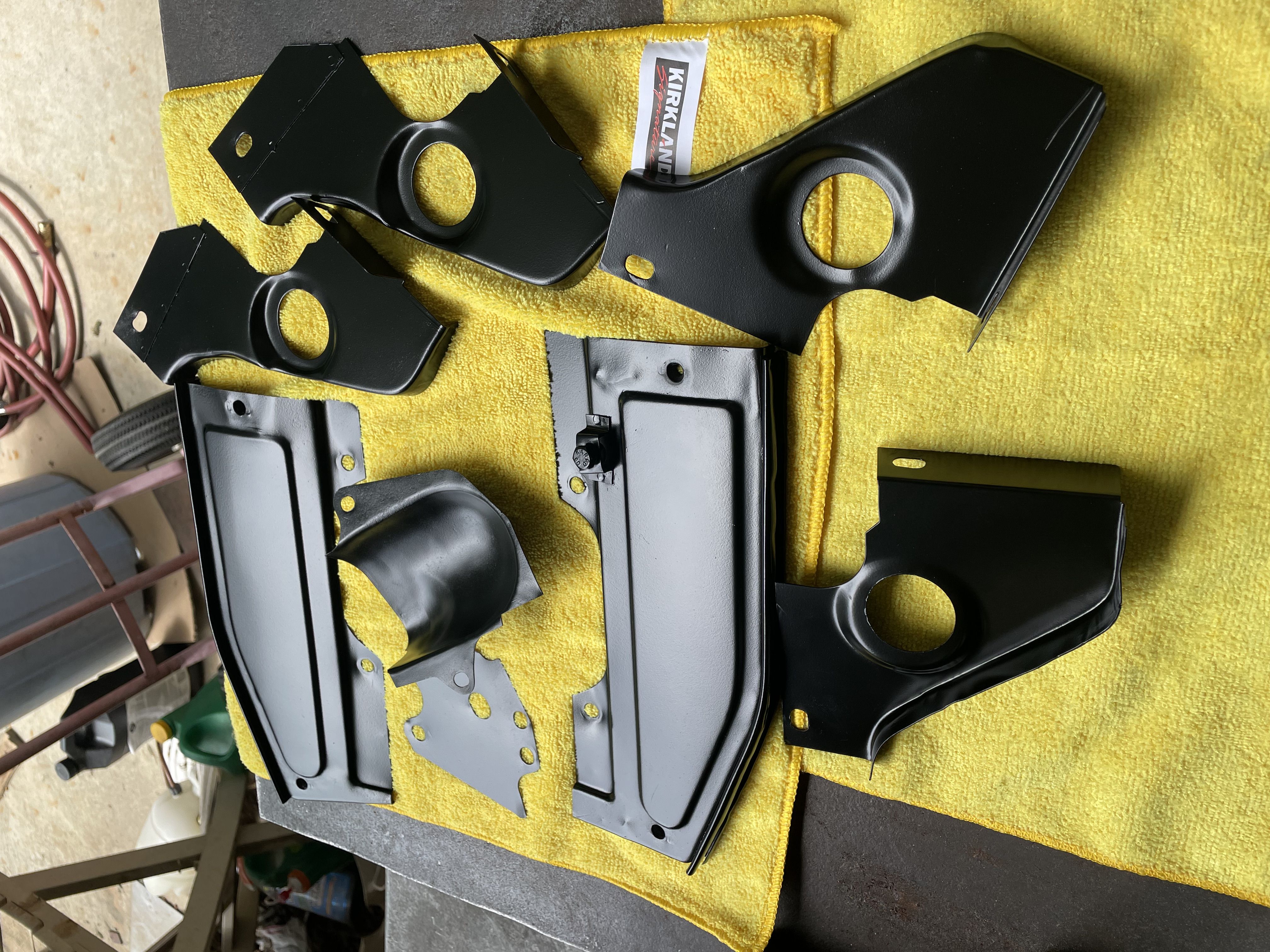

                    Laser is plugged in and working, its pretty cool, the Link is a video of us using it for the first time. Changing the sweep speeds and the power settings. More testing the unit, than working.
                    its just rips through all the paint grease and oil.
                    The photos are the backing plates after laser, smooth clean bright no rust. powder went on as expected. the rust pitting and scale came off but it shows through the powder. I figure this area needed more protection than cosmetic appearance. all these were covered in rust under oil grease and zebart coating. but the cleaned up fine and operate now like new. A couple of springs (1*9x100mm) and I am good to go.
                    Sorry for the cameraman, He's just old.
Name:	l backing .jpg
ID:	115456 Click image for larger version
Name:	R backing.jpg
ID:	115455 Click image for larger version
Name:	powder backing.jpg
ID:	115457 Click image for larger version
                      Beautiful! Did you try welding up those fatigue cracks in the shields with it?
