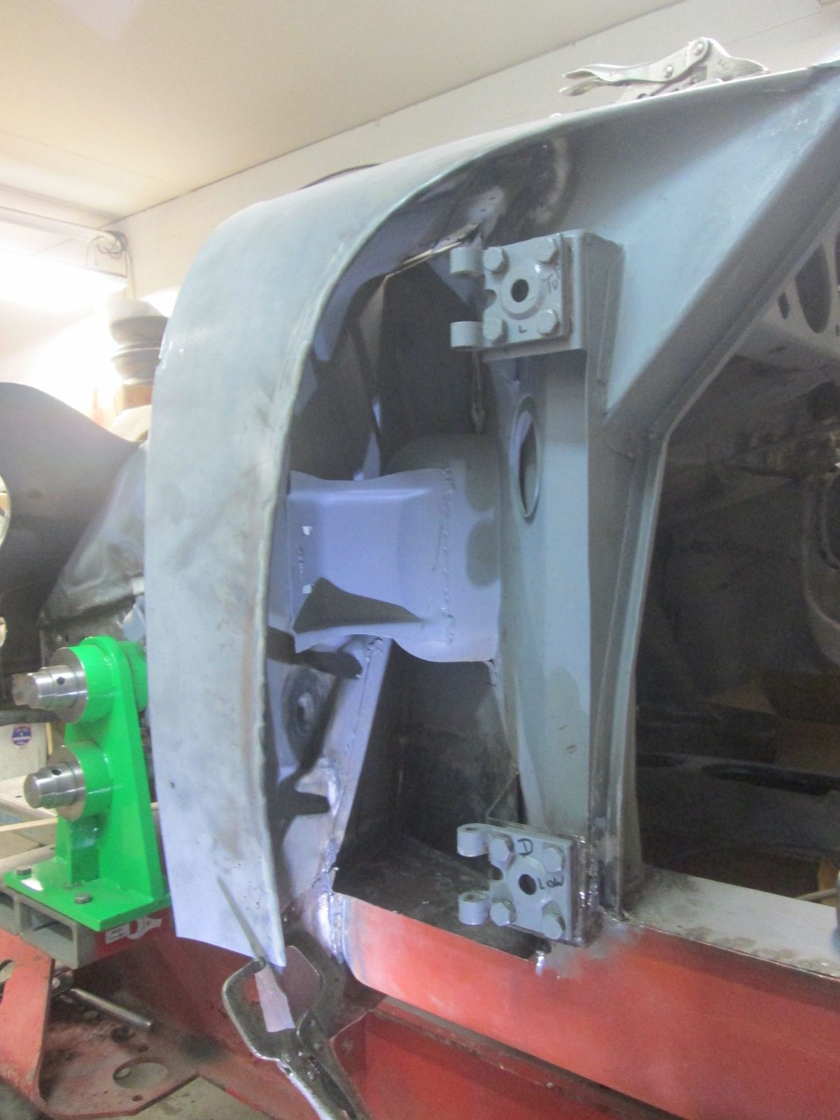

  • Lower hinge base install:
ID:	114992 Sight marked the base back into its original position as closely as possible using drill marks and edge breaks where I had cut it free. Makeshift holding jig making sure its surface is running parallel with the upper mount. Ready for a tack weld and then a door test before a final stitching.
ID:	114993 Initial door test fit.
ID:	114994 Pretty close but after a bit of wrestling, adjusting and readjusting the door now sits right at the edge of the flange.
ID:	114995 Rear gap is okay but closes down towards the bottom. I've reskinned this door so between all the repairs to both the closing panel and the car itself the fitment just changed. Adjustments have to be made as it goes back together. The most critical issue for right now was that the top edge of the door carried on into the quarter window opening. Well within range.
ID:	114996 Last little confirmation was that the original hole in the lower base still lined up with the cover plate. As close as I can get it; Ready for final welding.
    • Hinge base set completing the lower door well repairs except for the eventual threshold.
      Click image for larger version  Name:	IMG_1655.jpg Views:	0 Size:	179.9 KB ID:	114998 Seam welding up the leading edge all but completing this reinstallation.
      Click image for larger version  Name:	IMG_1653.jpg Views:	0 Size:	216.8 KB ID:	115000 Almost done just have to add in the bottom inch of the seal channel that mounted against the base.
      Click image for larger version  Name:	IMG_1657.jpg Views:	4 Size:	184.5 KB ID:	114999Seal channel section added back on. Welds dressed with a gas weld detail added to the closing wall's edge as found originally. Done in here for now.
      Click image for larger version  Name:	IMG_1663.jpg Views:	0 Size:	248.8 KB ID:	115001 Door remounted for another test fit to confirm nothing changed dramatically after all the welding and heat.

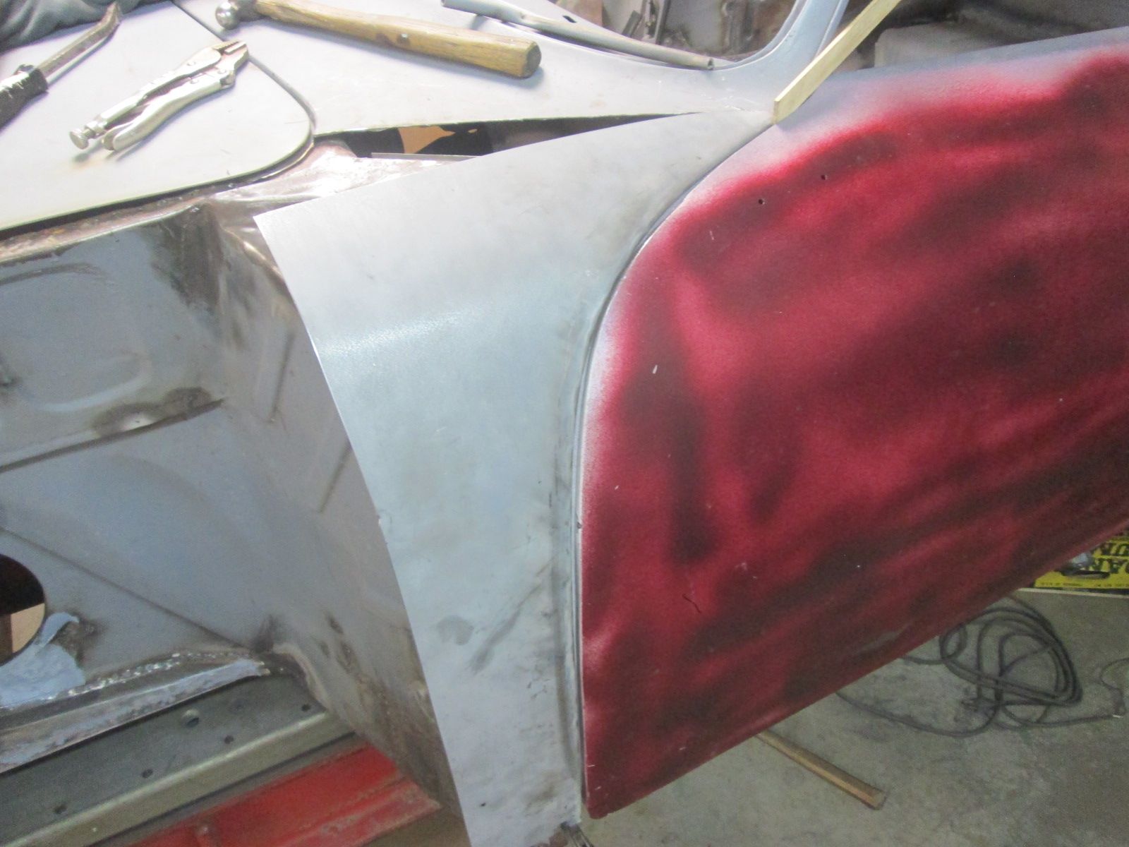

      • Begin rebuilding the body around this hinged and latched door.
ID:	115003 Latched door runs 80% even down the edge of the quarter panel but stands a little proud at this upper corner. Not horrible and will be ironed out eventually but again my main concern at this point was making sure to top of this door carried on the line of the rear quarter opening.

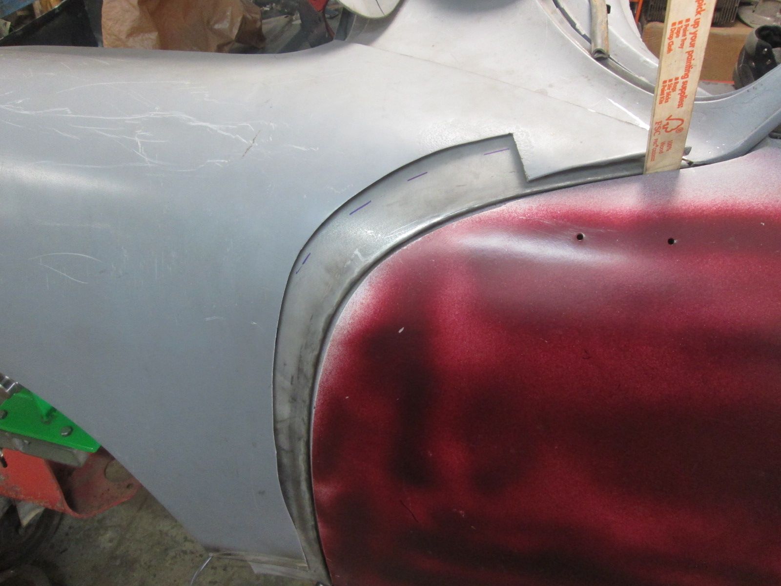

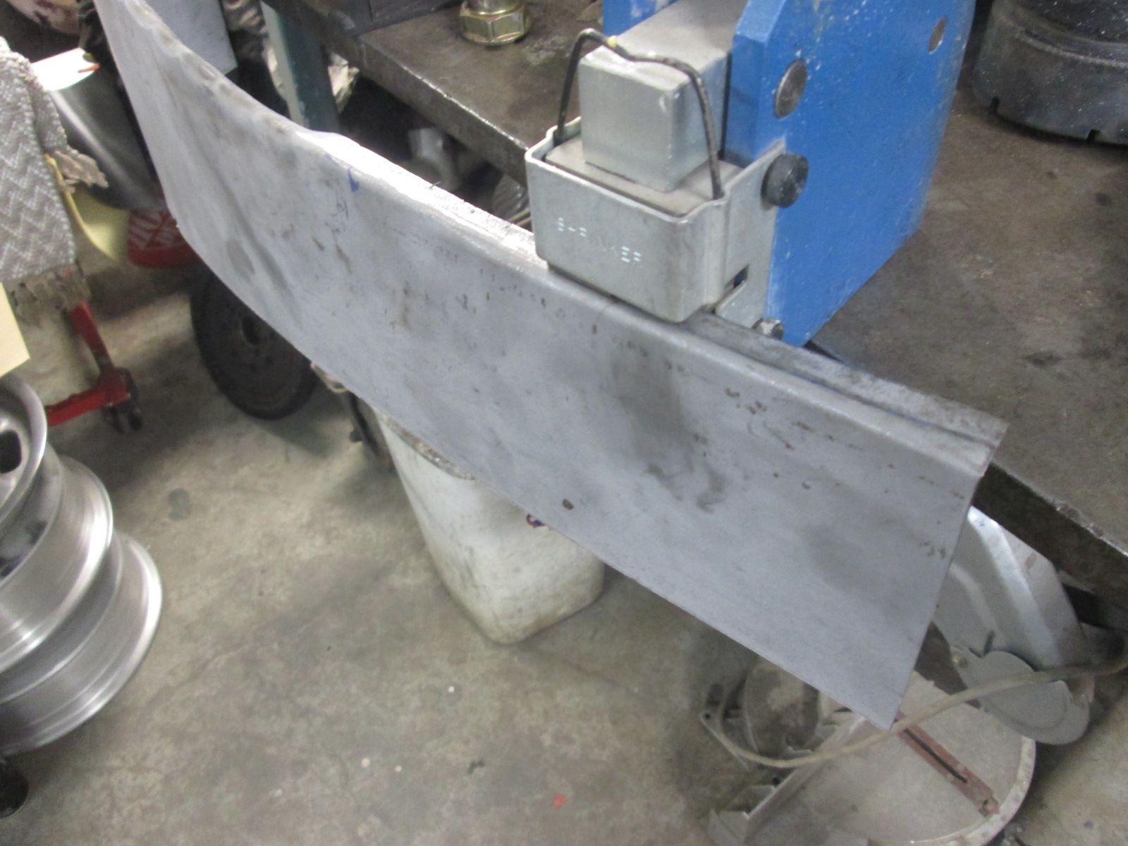

        • Rough skin mock ups:
          Click image for larger version  Name:	IMG_1679.jpg Views:	0 Size:	233.3 KB ID:	115009 Flanged trimmed back for the needed clearance to create the new gap.
          Click image for larger version  Name:	IMG_1680.jpg Views:	0 Size:	179.9 KB ID:	115010 Now I can begin shaping and trimming this new repair section to fit. Promising basic contoured opening shape against this door.
          Click image for larger version  Name:	IMG_1681.jpg Views:	0 Size:	176.7 KB ID:	115011 This lower corner however is already well short. Actually I don't know why they added this feature in. Click image for larger version  Name:	IMG_1682.jpg Views:	0 Size:	174.5 KB ID:	115012
          This corner is part of the rocker assembly so not only is it in the wrong position but it shouldn't be on the fender side in the first place.
          Click image for larger version  Name:	IMG_1684.jpg Views:	0 Size:	176.1 KB ID:	115013 Moved onto an initial mock up with the new rocker skin. My initial aim was to save and reuse the original rockers but this side is too bent up and the other side too rusty. We will save and reuse the original thresholds so just the outer skins were ordered. So far so good. Nice 3mm gap with good clearance and reveal with the jack spur.

            Again nice door gap right out of the box up front too. I'm sure the wired leading edge up here will also need work though the front fender is on just yet to confirm this. Marked a cut line even with the end of the mating flange so I can trim off that corner on the repair section.
            Click image for larger version  Name:	IMG_1688.jpg Views:	0 Size:	183.6 KB ID:	115018 Trimming it off right about here...

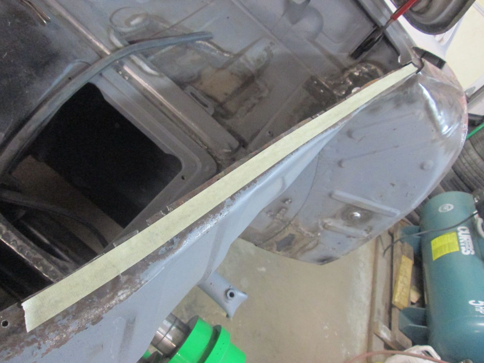

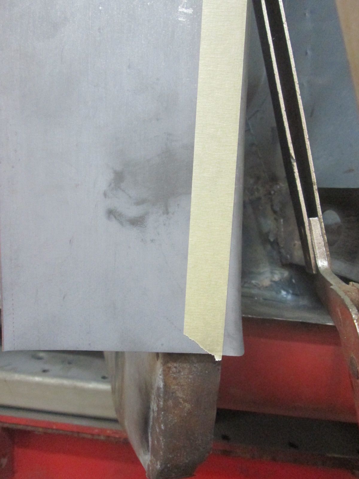

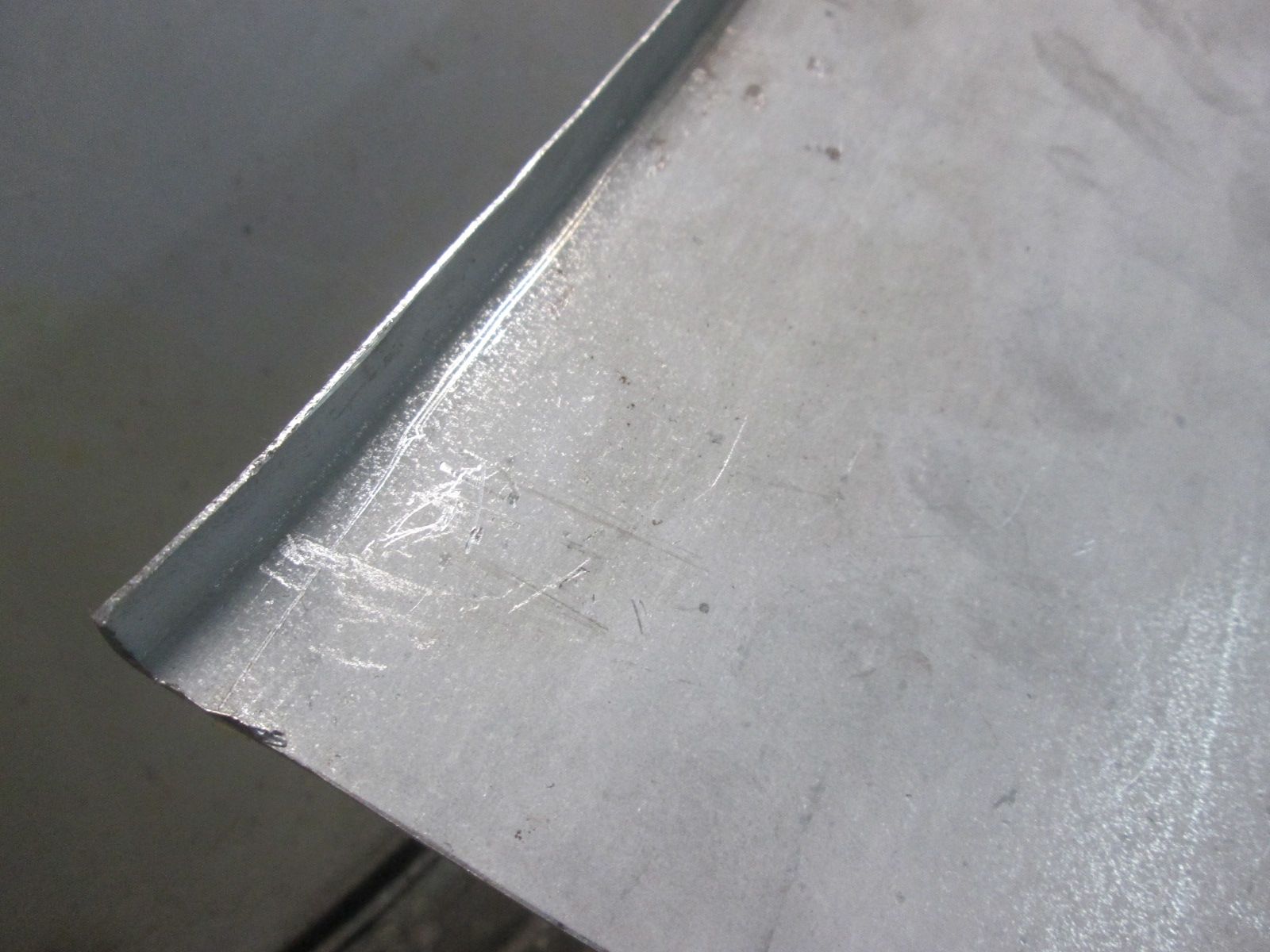

            • Fitting the repair section:
ID:	115023 New section in its best adjusted position.

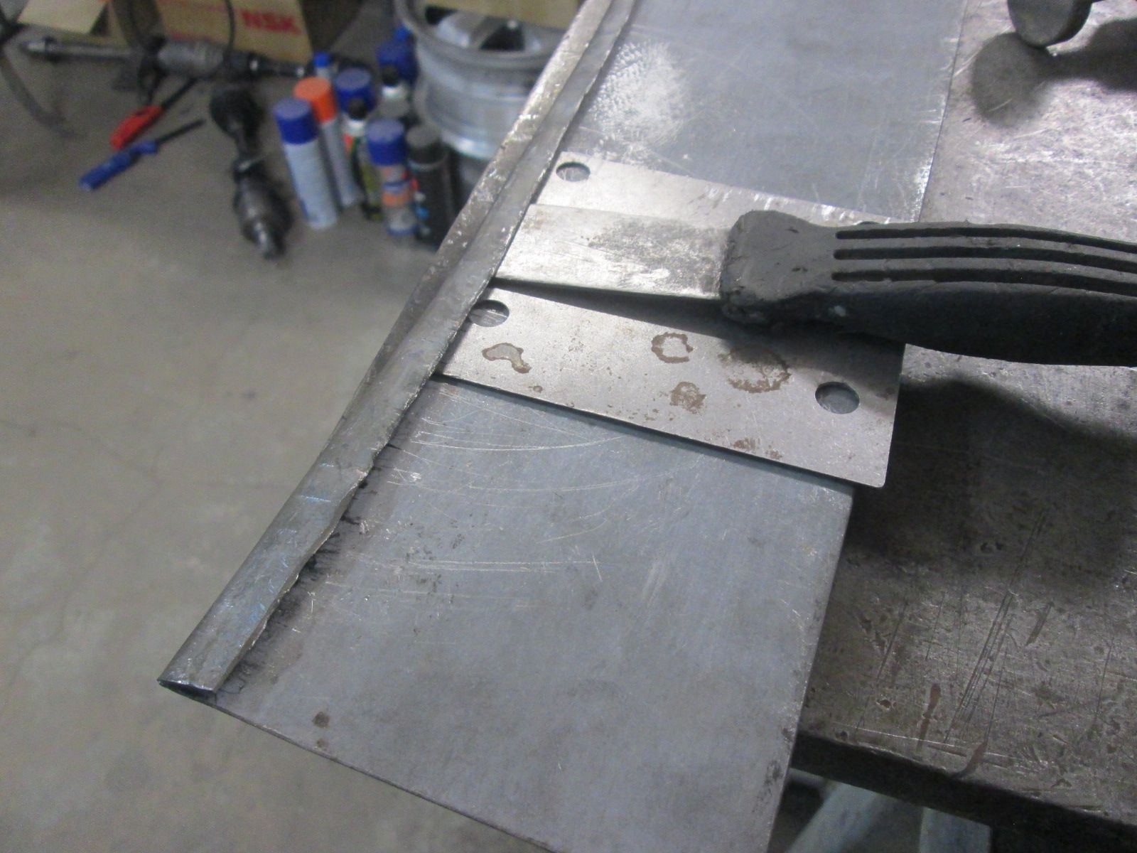

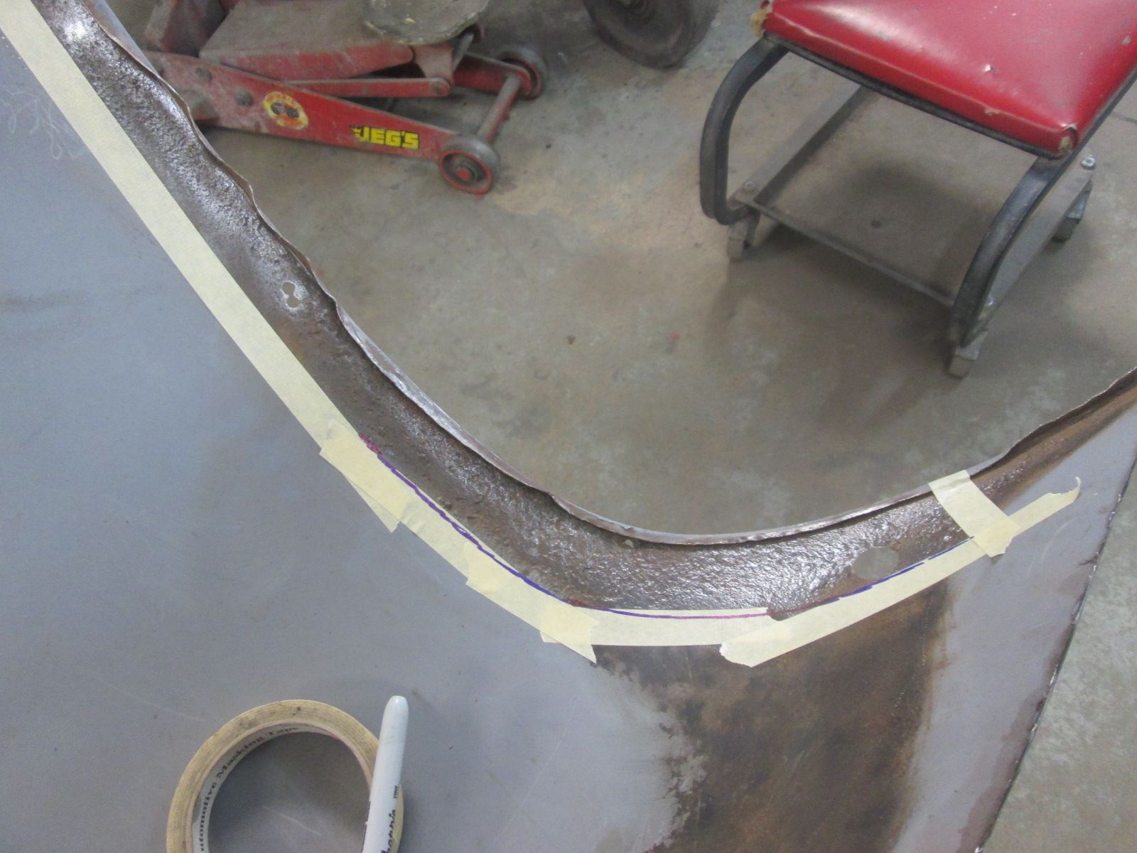

ID:	115024 Cut that corner off but a slight roll that led up to it remains. Marked with tape for the break line needed to hug the splash pans leading edge.
ID:	115026 Leading edge of the pan's mounting flange etched to backside. Flattening out this section for repositioning.
ID:	115027 Break repositioned. You can see whare it used to be down the center of the flange now. There was a gentle profile curve in through here but I had to reflange this area flat. Re-establishing that curve with my shrinker jaws.
ID:	115025 Section remounted snugly against the leading edge of the splash pan and now ready to begin healing this edge over past 90 degrees so I can test fit the door against it as fitment continues.
              • Click image for larger version  Name:	IMG_1695.jpg Views:	0 Size:	194.6 KB ID:	115029 Initial rounds of healing over the flange run for door clearance.
                Click image for larger version  Name:	IMG_1696.jpg Views:	0 Size:	196.9 KB ID:	115030 I can go a touch more as I want to define the leading edge as much as possible but not so much where its crimped down onto the mating flange. Not even close to that yet.
                Click image for larger version  Name:	IMG_1697.jpg Views:	0 Size:	187.0 KB ID:	115031 First test fit against the door. Promising start but lots of refining yet. A good starter gap shape against the door but runs a little tight at the upper corner.
                Click image for larger version  Name:	IMG_1698.jpg Views:	0 Size:	192.2 KB ID:	115032 Skin profile is a bit lumpy down this run and the upper corner crimp compels the skin to project outward too much. Like I said, lots of refining yet to go but I'm just shooting for a basic gap at this point.

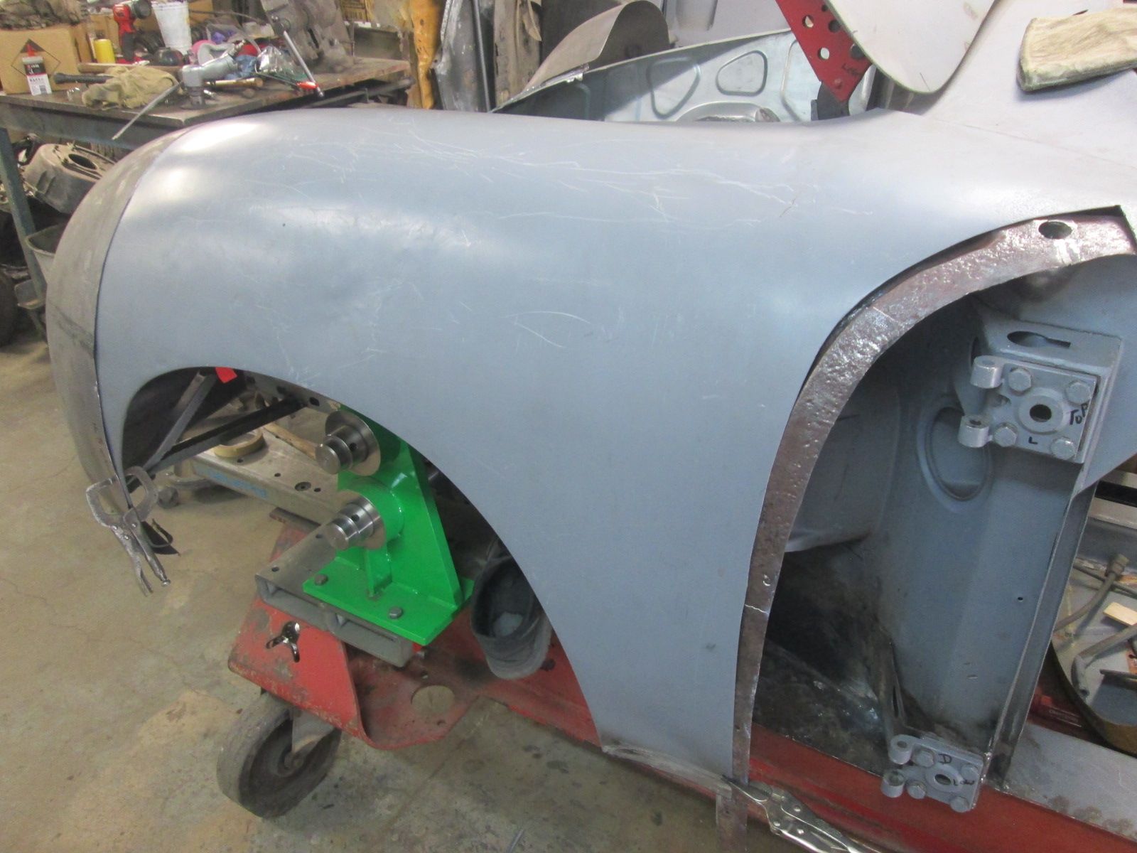

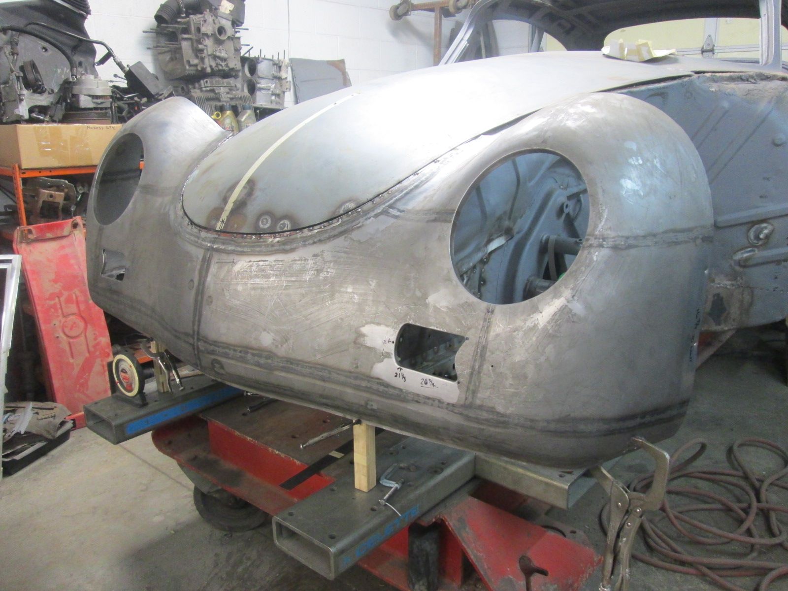

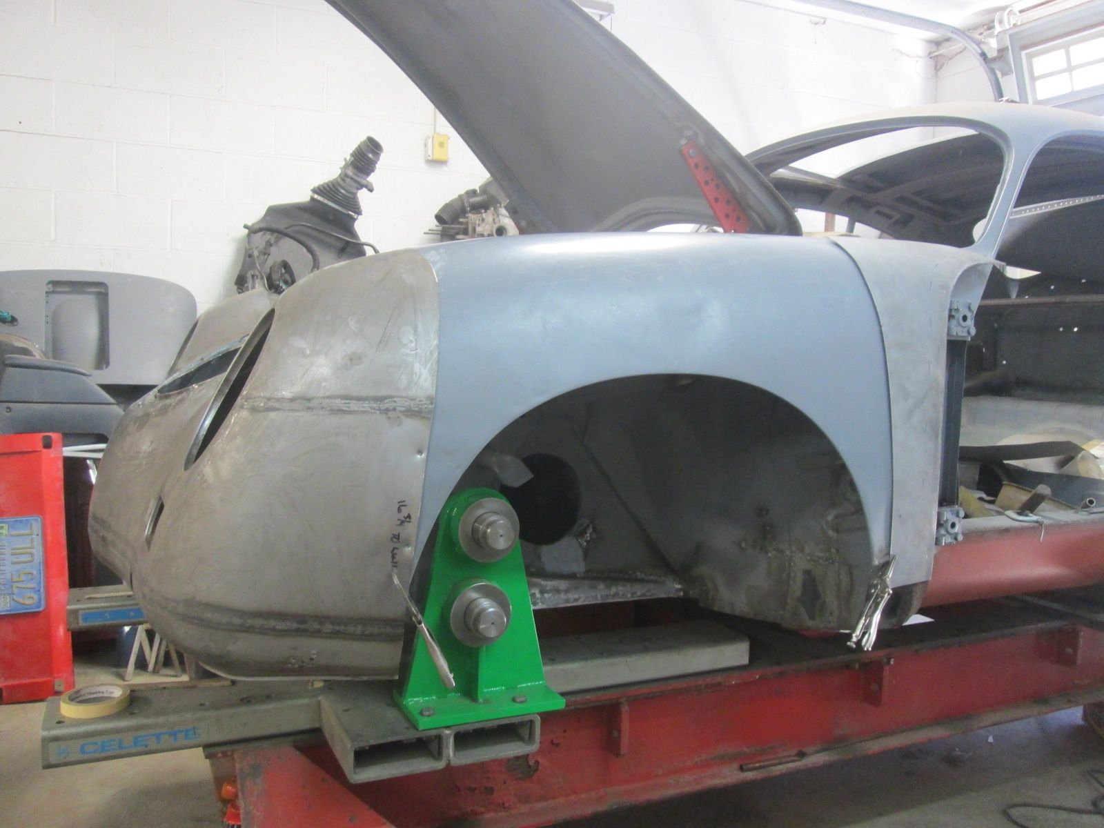

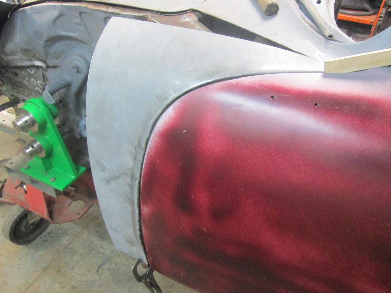

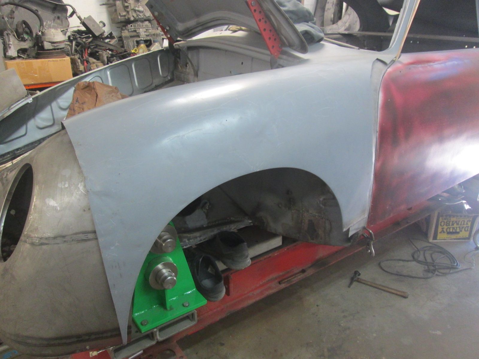

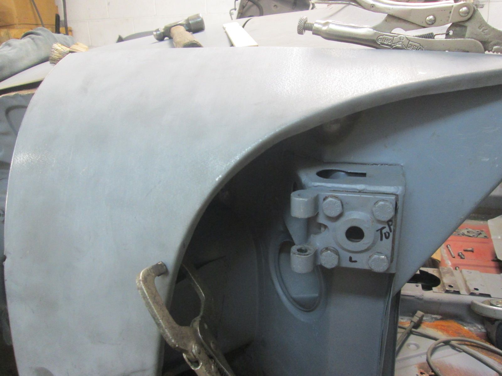

                  • Begin left fender refitment
                    Click image for larger version  Name:	IMG_1718.jpg Views:	0 Size:	205.1 KB ID:	115040 Trim line finalizing. Cutting just past the heavy pitting and saving as much original metal as possible.
                    Click image for larger version  Name:	IMG_1717.jpg Views:	0 Size:	168.0 KB ID:	115041 Approximate trim line and as you can see most of it won't be needed.
                    Click image for larger version  Name:	IMG_1719.jpg Views:	0 Size:	185.6 KB ID:	115042 Rotted leading edge trimmed off. I stopped short of the upper corner for now as its a good sight marker as refitting progresses. I may or may not use it, just keeping my options open.
                    Click image for larger version  Name:	IMG_1720.jpg Views:	0 Size:	197.4 KB ID:	115043 Time to start working it in with the new nose. Earlier photos showed the right side was a natural fit right out of the box. This side however shows some bigger alignment and contour issues. Since nose fitting began this side's headlight opening has always wanted to lean back about 5 degrees further than the right side which matches BTW my original references angle. This side really needed to stand up more and this bad overlap with this fender just laying over top highlights the problem.
                    Click image for larger version  Name:	IMG_1721.jpg Views:	3 Size:	225.3 KB ID:	115044 As fitting and experimentation went on I unscrewed and loosened this side of the nose from the trough. Once I tucked the fender under rather than laying over top these two almost magically came together. It now stood this headlight opening up and even with the other side eliminating that 5 degree discrepancy. Along with that the top profile shapes of these two sections are now blending together beautifully. To retain the fitment, the inner trough run will need some rework which I'll describe next. Anyway the body fitment continues in the right direction.
                    Thanks for looking.

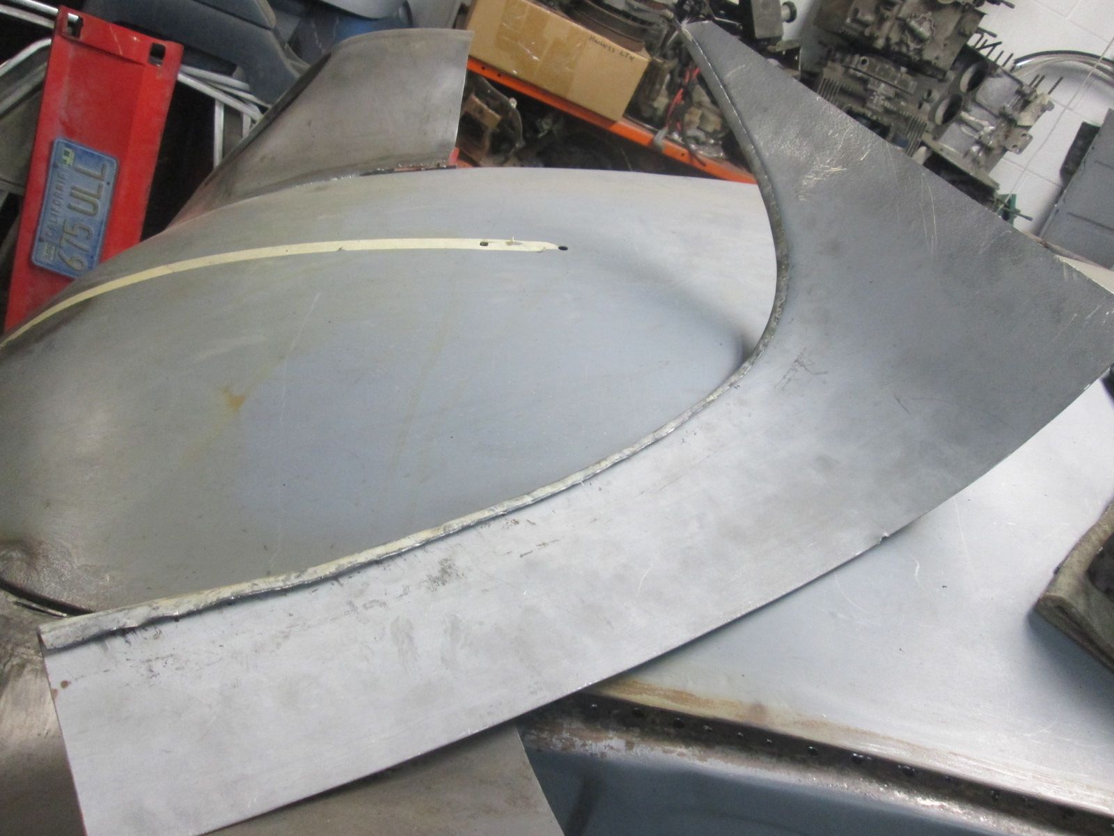

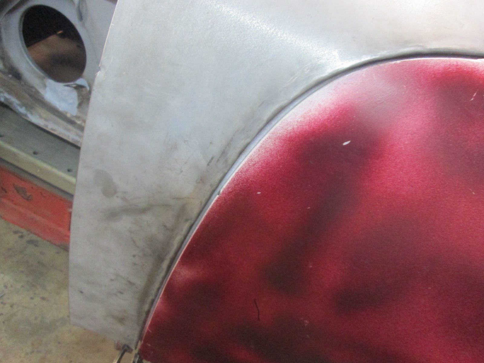

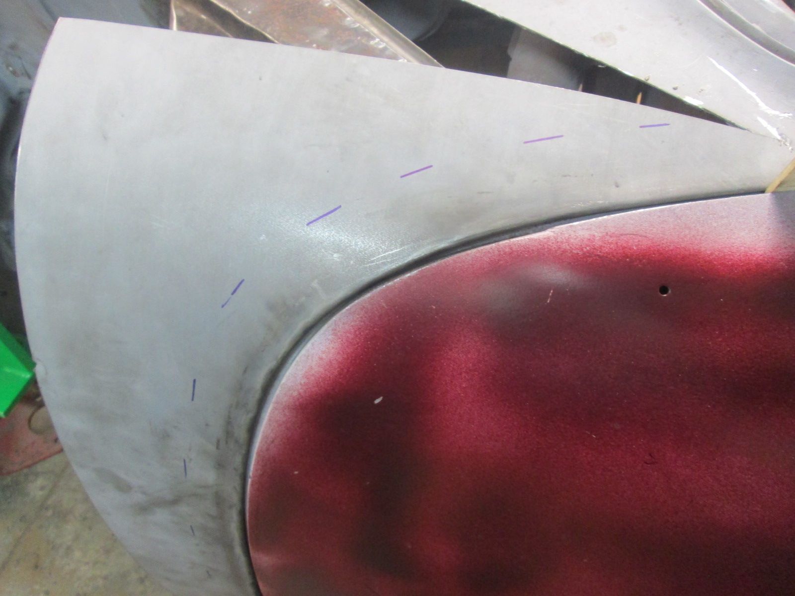

                    • Click image for larger version  Name:	IMG_1435.jpg Views:	0 Size:	232.4 KB ID:	115046 Again the lingering issue has been that the left side bucket opening insisted on leaning back an extra 5 degrees when mounted to the inner closing wall. You can just make out this discrepancy between the two openings. I thought I may have set the closing wall too low on this side but cross measurements confirmed they were even. Didn't have the answer as to why it insisted on laying back more so I left it loose for later.
                      Click image for larger version  Name:	IMG_1722.jpg Views:	0 Size:	199.2 KB ID:	115047 Now that I had a new confirmation with this fenders fitment and continued contour to the nose...
                      Click image for larger version  Name:	IMG_1725.jpg Views:	0 Size:	218.9 KB ID:	115048 I realized that the skin in through here is just short and too tight. It forces the bucket to lay back more in order to reach the trough and mounting surface of the closing walls. Once I cut it free again the bucket opening moved up to the angle where it should be and the panel shapes fell into line with one another.
                      Click image for larger version  Name:	IMG_1726.jpg Views:	0 Size:	182.2 KB ID:	115049 This shaped area is not only short but very ridged too it will not lay against the fender. Its going to require a bit of reshaping.
                      Click image for larger version  Name:	IMG_1728.jpg Views:	0 Size:	185.0 KB ID:	115050 That can wait. What's most important is that I have symmetry between the two bucket openings at the correct angle and a consistent body contour over these two panels. I can build on that and move forward from here.

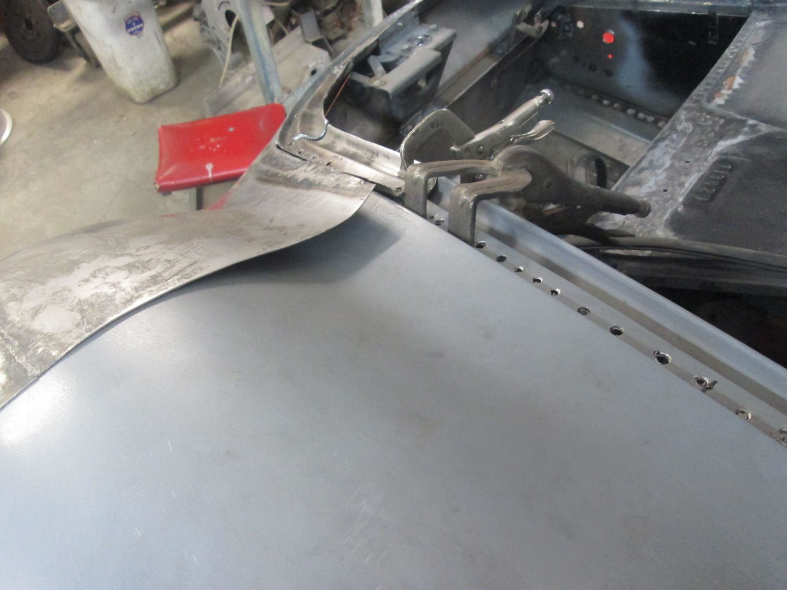

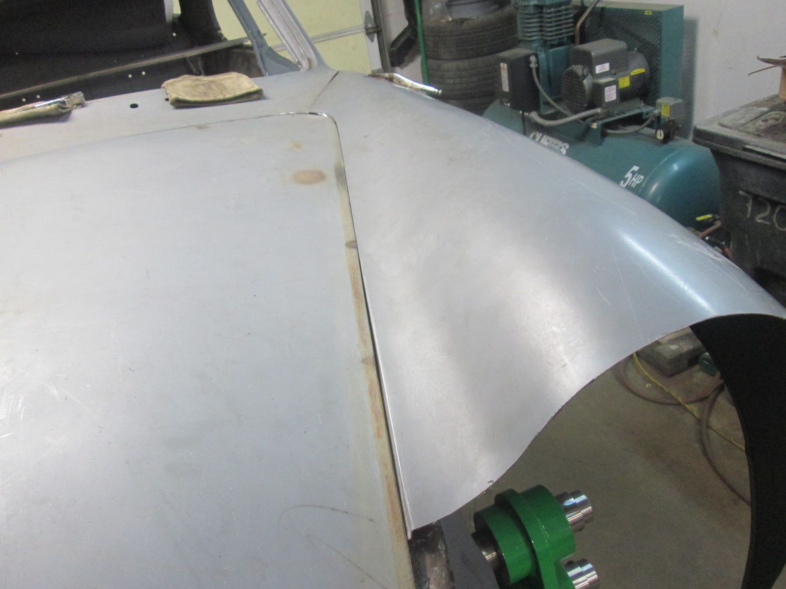

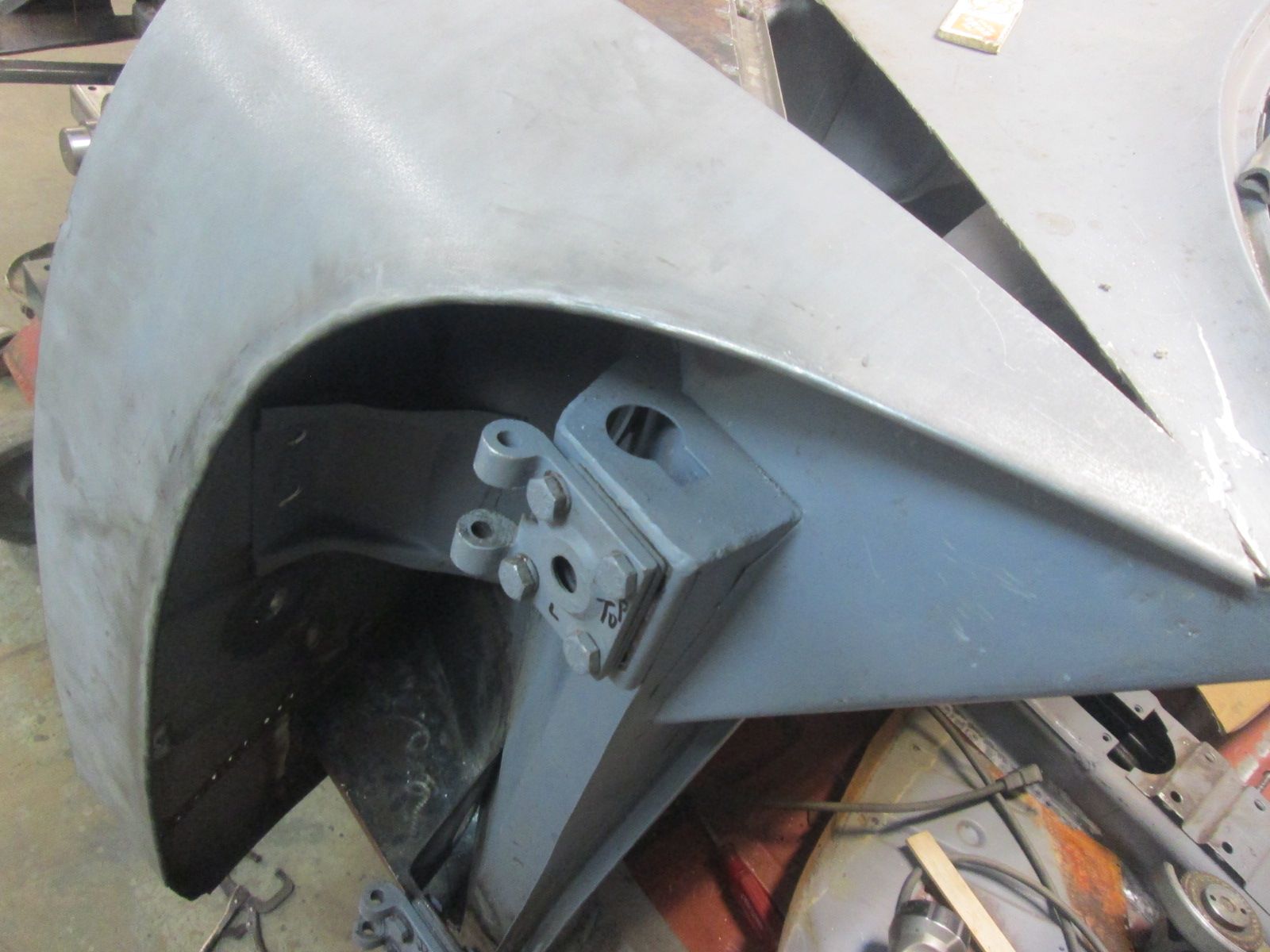

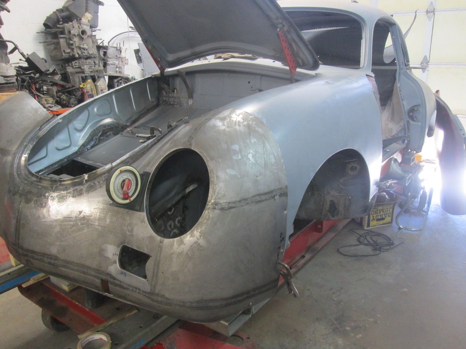

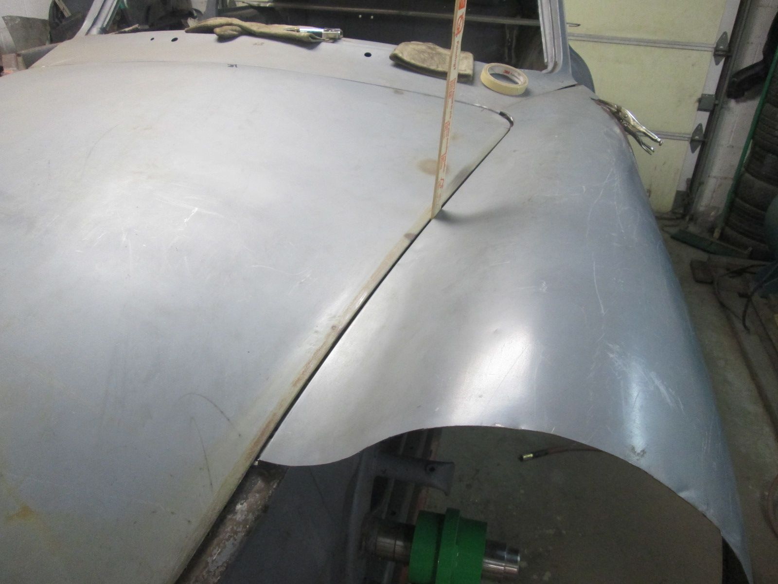

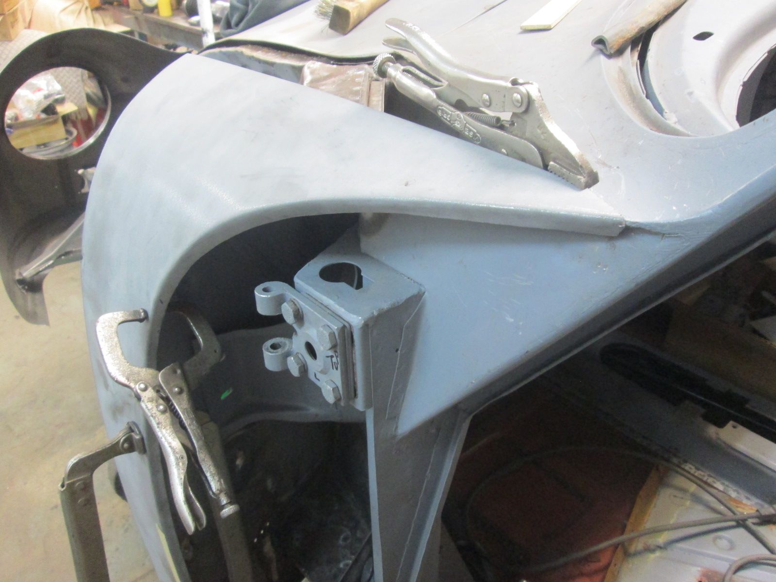

                      • Remounting the fender:
                        Click image for larger version  Name:	IMG_1730.jpg Views:	0 Size:	150.4 KB ID:	115052 The upper closing wall on this side had suffered a bit of deformation from the previous accidents. The upper mating flange had a bow and a slight kink in it up by the cowl. After some straightening I now have zero against the hood with this trial fit.
                        Click image for larger version  Name:	IMG_1729.jpg Views:	0 Size:	172.4 KB ID:	115053 The leading edge of the fender doesn't run consistently down the length of the hoods edge either. Tapering away about mid way down.
                        Click image for larger version  Name:	IMG_1732.jpg Views:	0 Size:	195.3 KB ID:	115054 Just shooting for a general 3mm gap at this point. Began by trimming back about 4mm out of the reshaped mounting surface to allow the shoulder of the fenders trough additional clearance.
ID:	115055 Improving but the mounting flange needed a touch more shaved off.

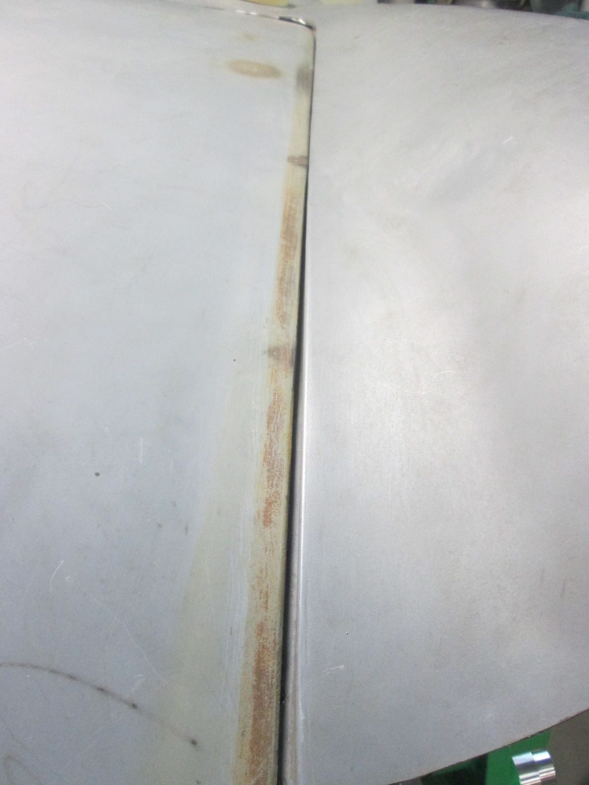

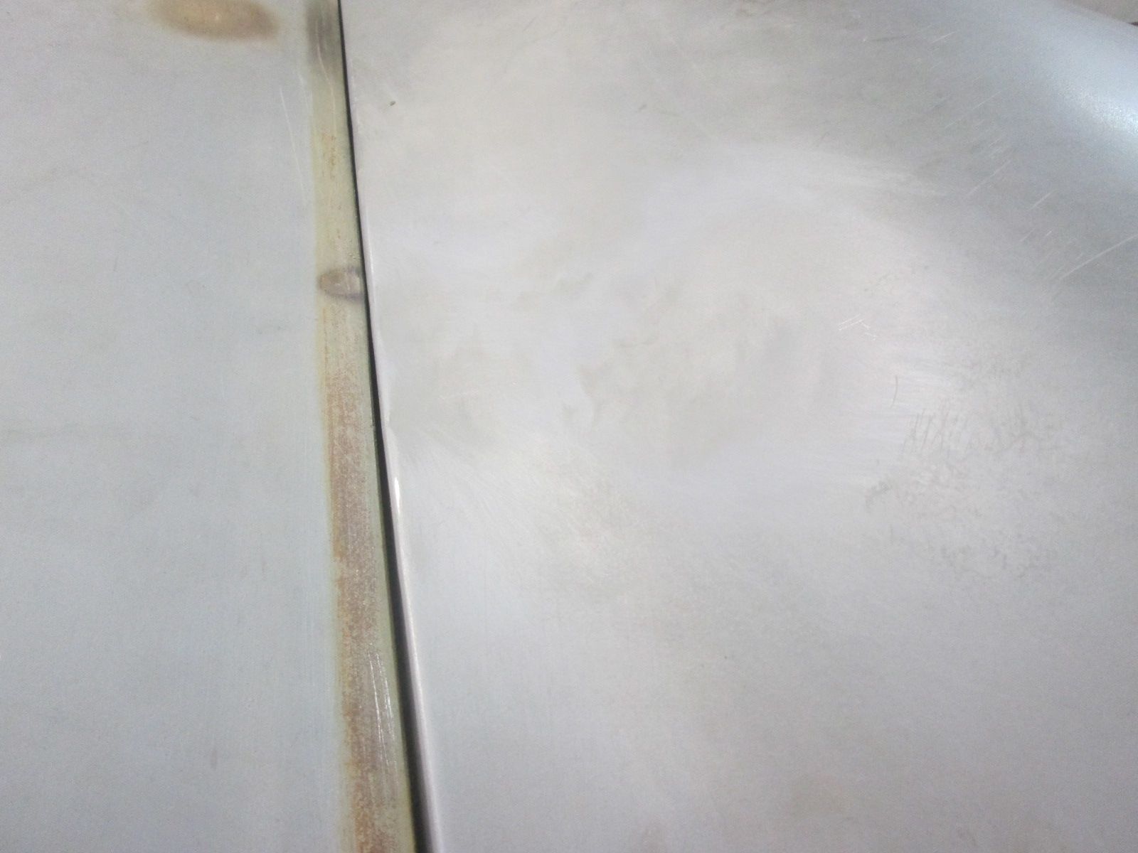

ID:	115056 But this tapering gap issue was really starting to bug me. More on this next.

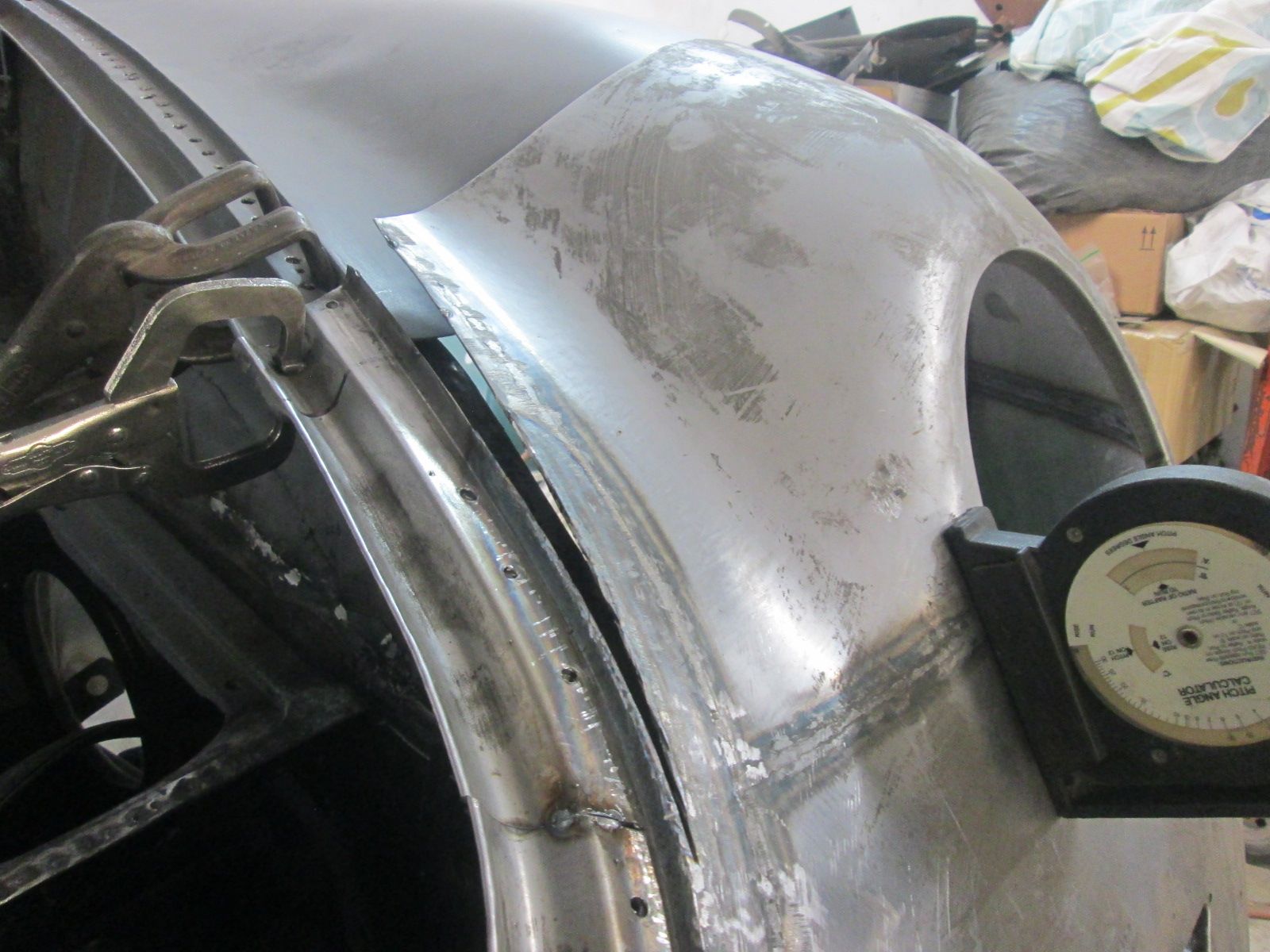

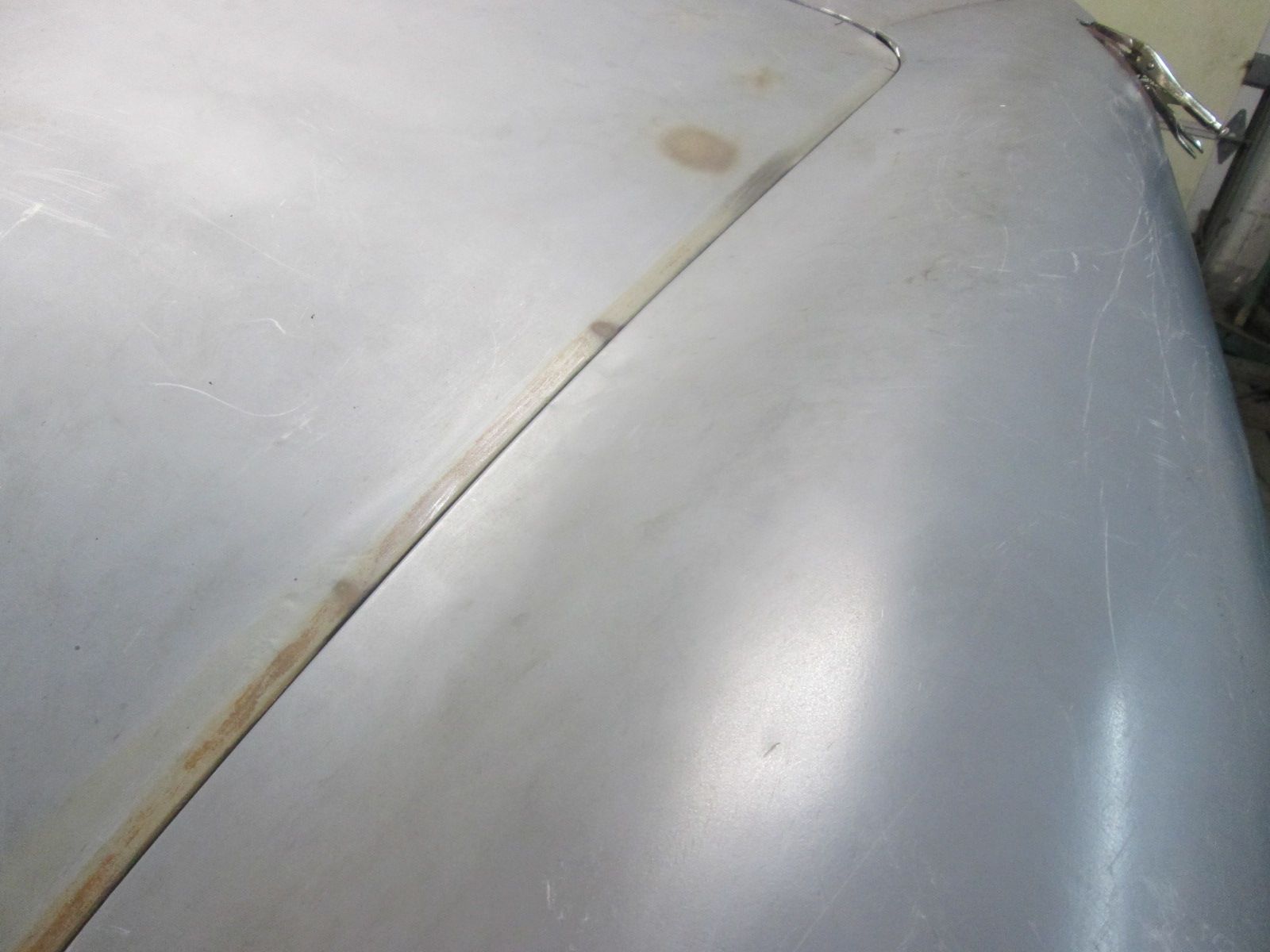

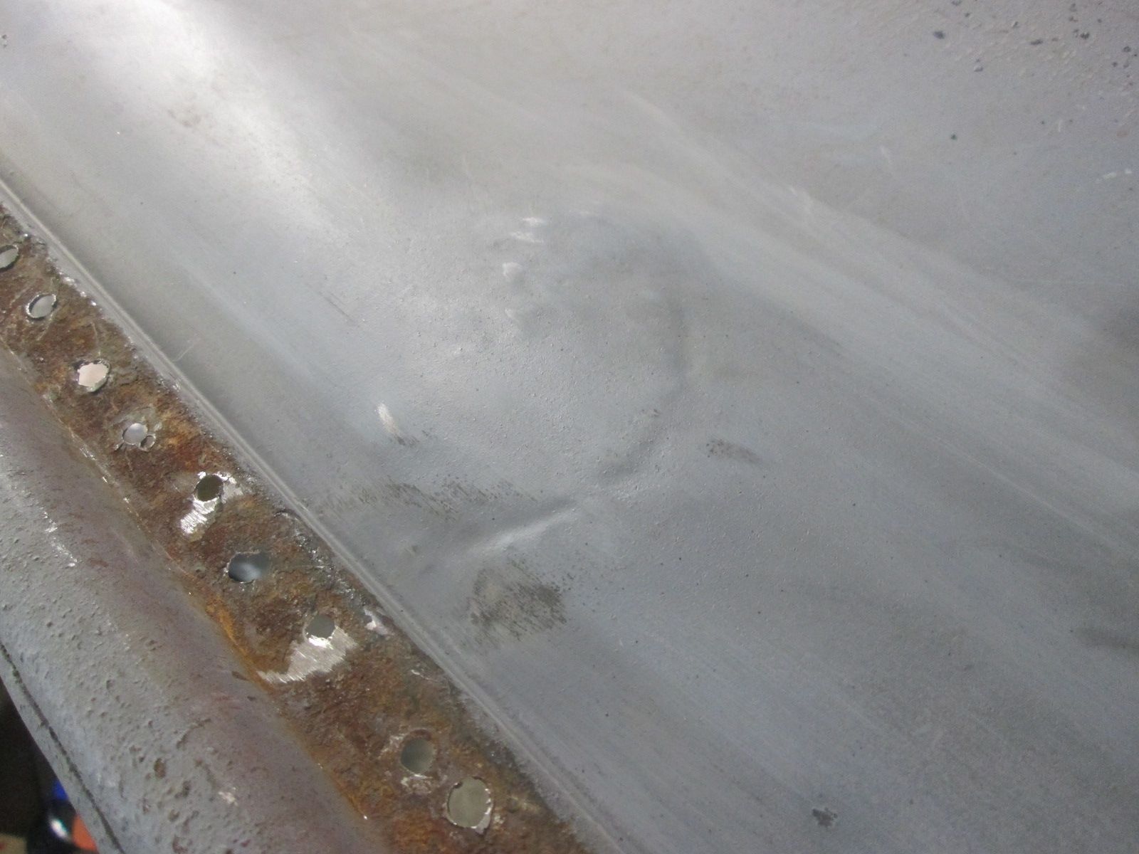

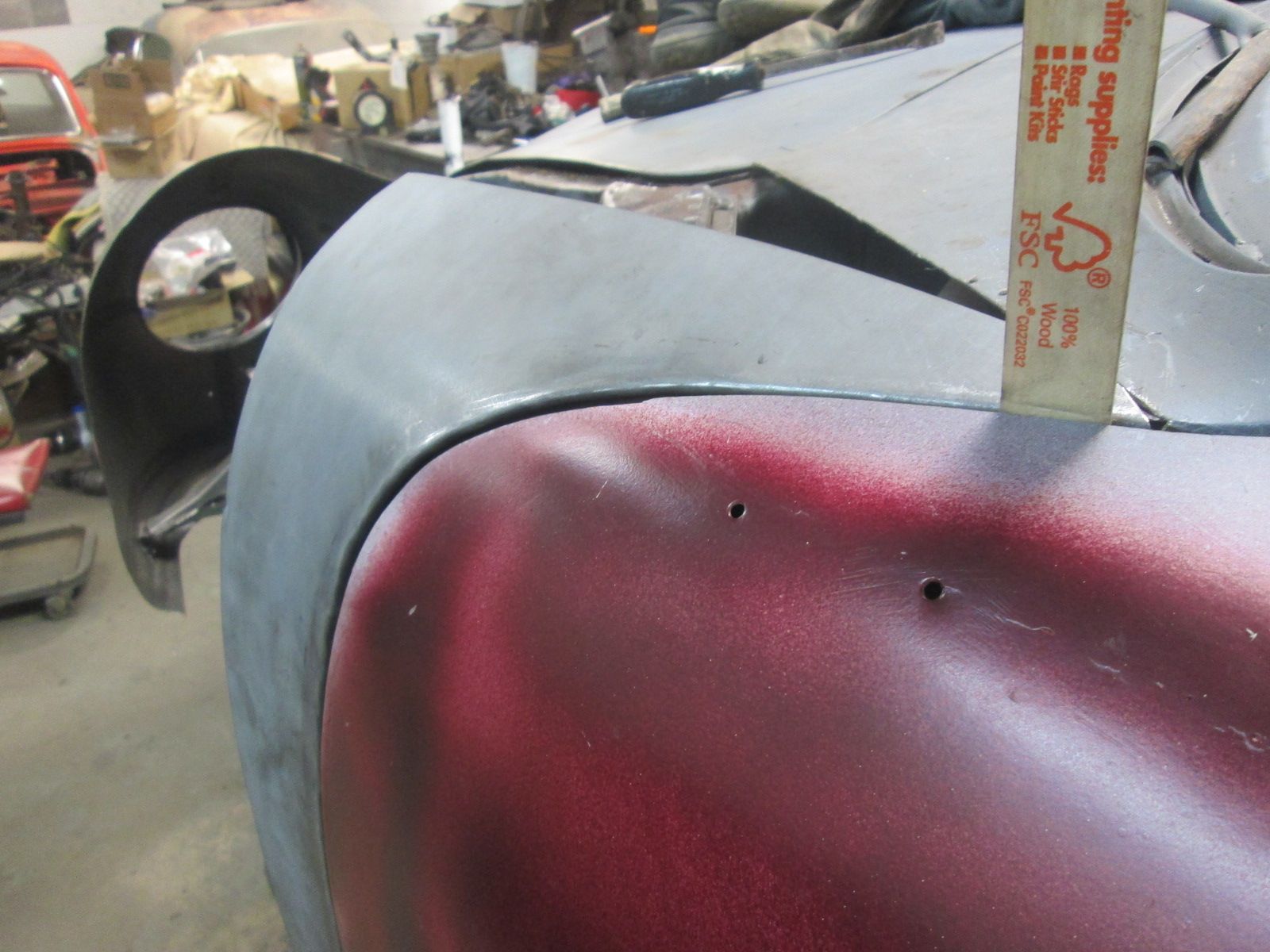

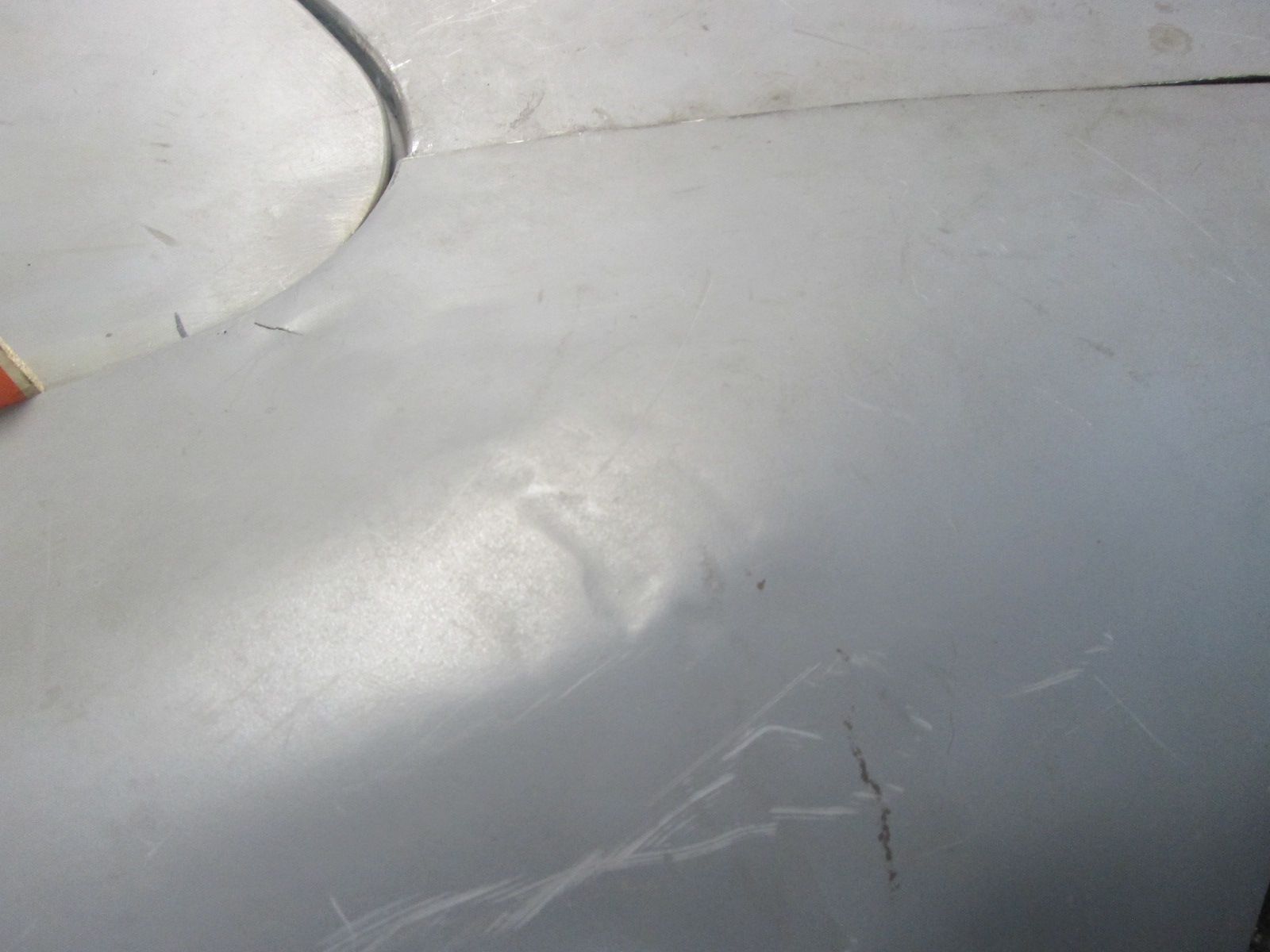

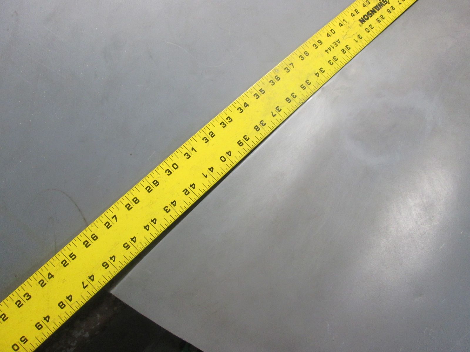

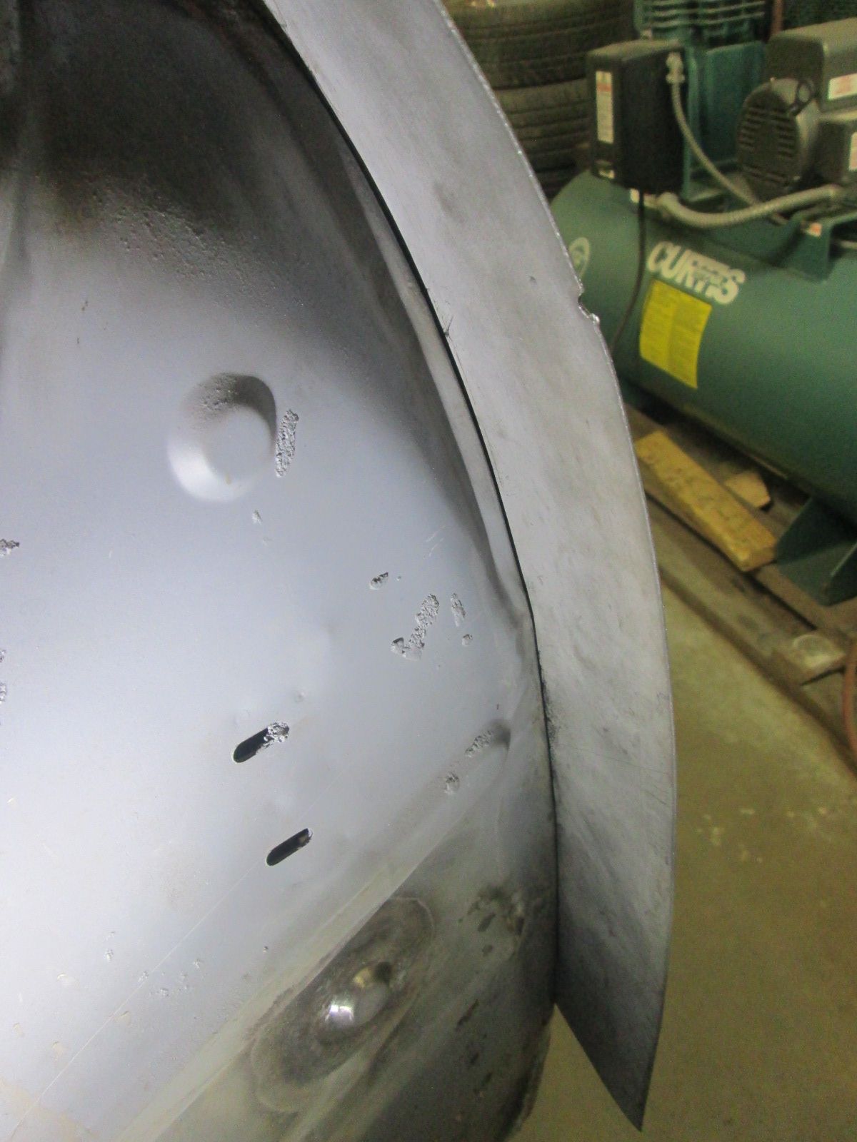

                        • Ironing out residual crash damage:
                          Click image for larger version  Name:	IMG_1735.jpg Views:	0 Size:	162.2 KB ID:	115061 The front group revolves around a consistent gap with this hood so this fender refitment had ground to halt until I could get this line cleaned up.
                          Click image for larger version  Name:	IMG_1739.jpg Views:	0 Size:	184.4 KB ID:	115062 My straight edge confirmed that the problem was not on the hood side of this gap. The gap issue coincides with that bit of damage that you can just make out by the 33 and 34 inch marks.
                          Click image for larger version  Name:	IMG_1737.jpg Views:	0 Size:	145.4 KB ID:	115063 The camara has trouble picking it up but this is old residual crash damage. The fender buckled here and was quickly pounded on but the shoulder was never brought back to true below this area.
ID:	115064 The underside of this spot shows where the kink was a little more clearly. Now that I'm really working with this fender it actually had buckled in two other places.
ID:	115065 It buckled at the crown here just ahead of the cowl. It even cracked the original factory weld joint up at the corner next to the hood. It was reversed but not completely ironed out.
