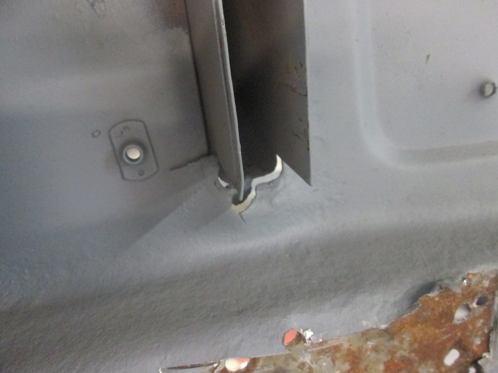

        • Rearward wall and ID panel loose ends:
          Click image for larger version  Name:	IMG_0327.jpg Views:	0 Size:	240.7 KB ID:	114125 Tube end fused to the wall as originally found. Extra care was taken to make sure this opening was as soft, smooth and blunt as possible as not to cut into or chafe the eventual wiring harness that will exit from it. Right now was definitely the time to address this before the rest of the battery box goes in.
          Click image for larger version  Name:	IMG_0325.jpg Views:	0 Size:	225.1 KB ID:	114126 Heading up both sides of the ID panel next to plug weld the old spot welds and finish out these leading edge corners.
          Click image for larger version  Name:	IMG_0328.jpg Views:	0 Size:	239.5 KB ID:	114127 Corner and leading edge fused with a gas weld as originally.
          Click image for larger version  Name:	IMG_0330.jpg Views:	0 Size:	255.8 KB ID:	114128 Then onto the right side. All that was left was the plug welds.
          Click image for larger version  Name:	IMG_0332.jpg Views:	0 Size:	248.5 KB ID:	114129 Welding duties all but completed on these two panels. Just have grind finish that long seam weld at the back where it was cut free and the plug weld heads along the sides. Then the new floor and front closing wall go in for good. Getting close.

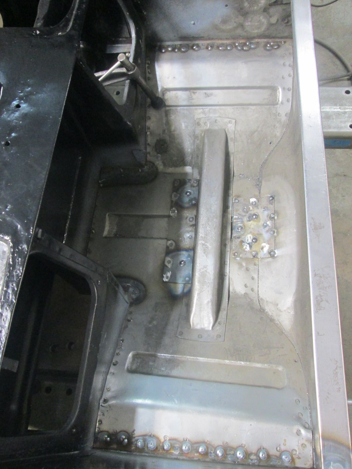

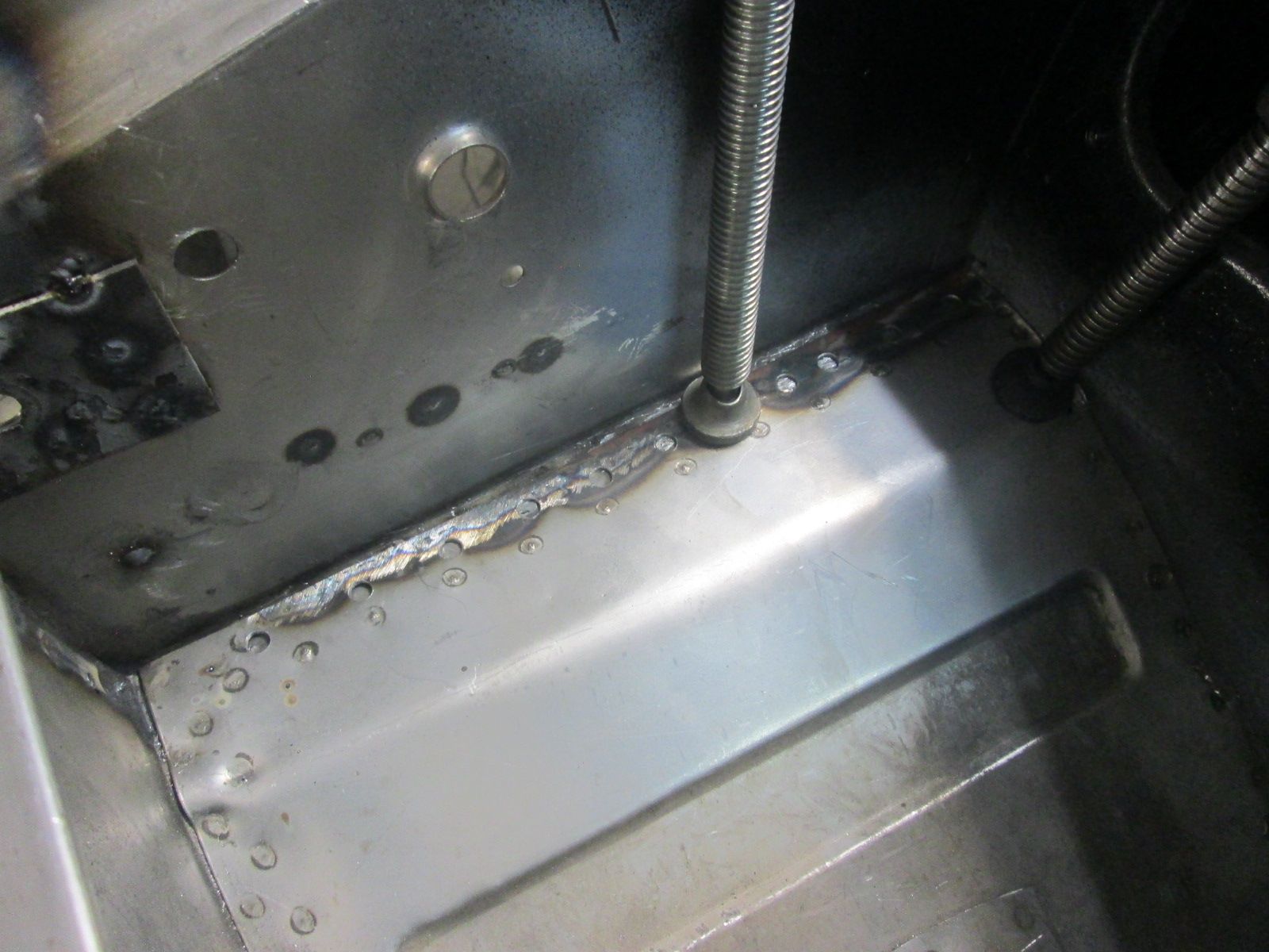

          • The last of the loose ends before the new floor and front wall go in.
            Click image for larger version  Name:	IMG_0334.jpg Views:	0 Size:	495.5 KB ID:	114140 Now was the time to finish removing the last of the remains of the original upper closing wall's double lap joint.
            Click image for larger version  Name:	IMG_0340.jpg Views:	0 Size:	193.0 KB ID:	114139 A PIA to remove but just about cleaned up here.

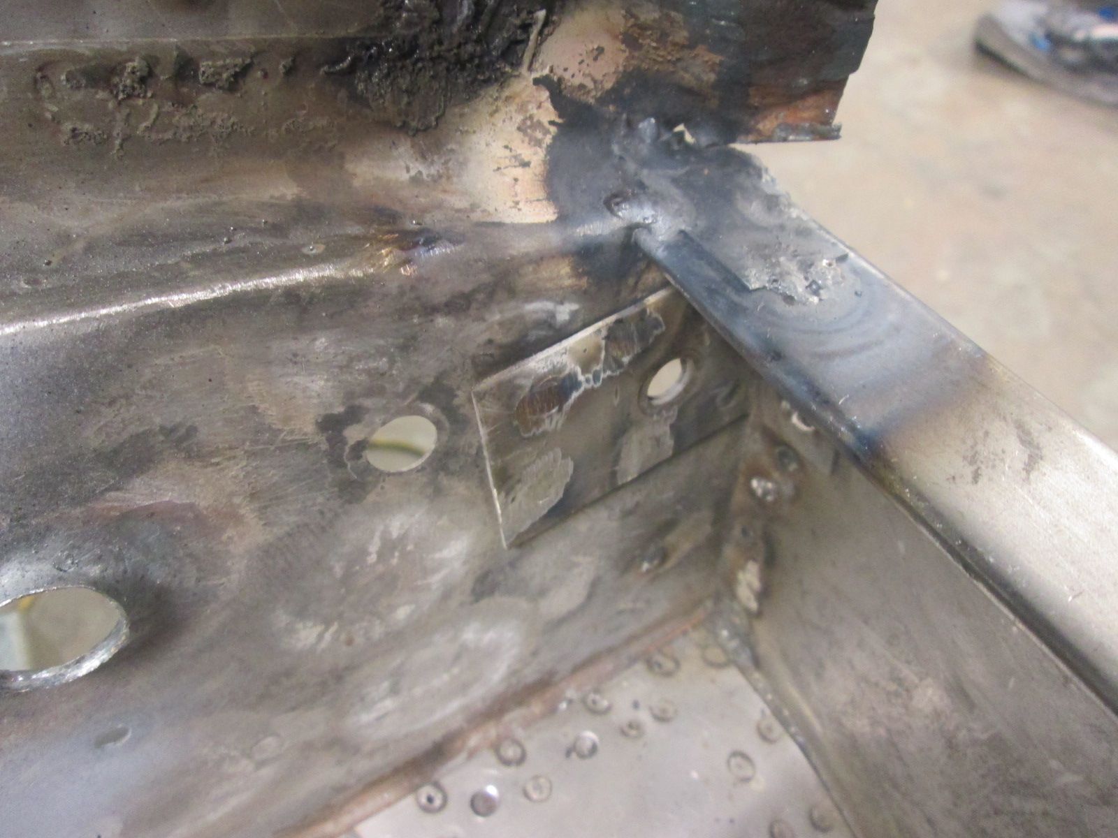

            Click image for larger version  Name:	IMG_0335.jpg Views:	0 Size:	196.4 KB ID:	114141 Adding back in more of the peripheral parts like these lateral wiring loom tabs.
            Click image for larger version  Name:	IMG_0336.jpg Views:	0 Size:	227.5 KB ID:	114142 Harvesting the original tabs from the right side wall. Easy enough to cut some new ones out of scrap but with only one spot weld it was just as easy to reuse these. I'd be adding the hole for a plug weld either way.
            Click image for larger version  Name:	IMG_0339.jpg Views:	0 Size:	219.7 KB ID:	114143 Went ahead and took the forward reinforcement bracket while I was at it. The plan was to always to straighten and reuse as well.
            • New battery box floor in for good!

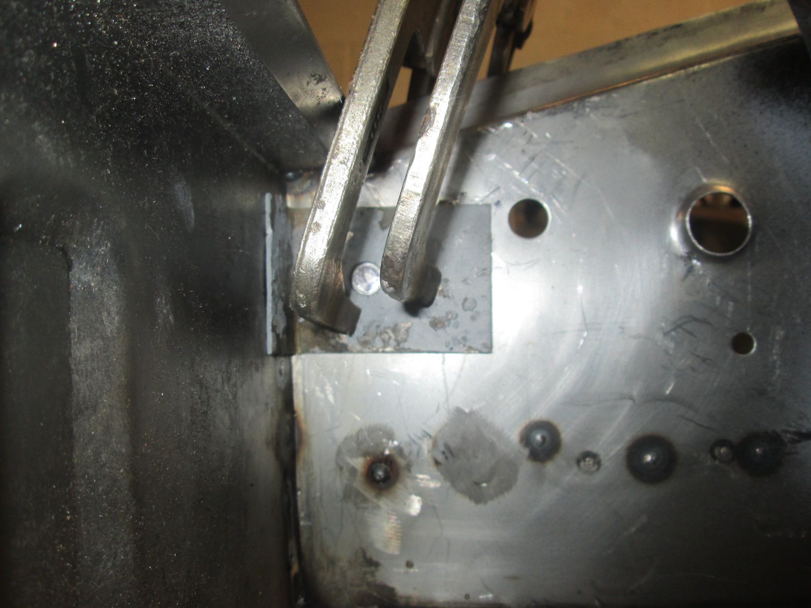

              Click image for larger version  Name:	IMG_0337.jpg Views:	0 Size:	173.9 KB ID:	114145 Tabs harvested measured for position from the left side and ready for a plug weld. Eventual harness runs downhill to the headlight conduit so I had to remember to angle the tabs otherwise they'd fight and not clamp correctly around the harness in the direction it needs to go.
              Click image for larger version  Name:	IMG_0342.jpg Views:	0 Size:	177.5 KB ID:	114146 Getting really close to final install time but I had one more thing on my checklist before I could put it in. I wanted to ensure a good coat of coverage on the underside lip of the VIN panel's leading edge so now was the time while I still had clear shot at it.
              Click image for larger version  Name:	IMG_0343.jpg Views:	0 Size:	219.0 KB ID:	114147 Then a quick top coat of semi gloss. Again my main concern was the underside lip at this point.
              Click image for larger version  Name:	IMG_0346.jpg Views:	0 Size:	232.2 KB ID:	114148 Now can I put this thing in? Double checked both the chassis and this last section to make sure I had all my "T's crossed". Plug weld holes, clean edges any other loose end that was easier to address before final installation.
              Click image for larger version  Name:	IMG_0347.jpg Views:	0 Size:	619.3 KB ID:	114149 It was finally ready...New floor and front wall installed for good. A long road but we now have a battery box again. Synching it into position and begin tack welding next.

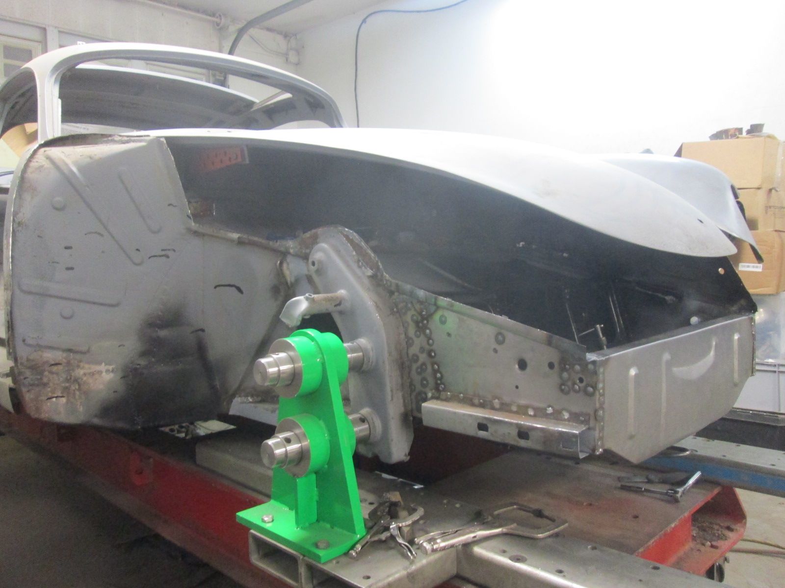

              • Battery floor fully seated and ready to weld.
                Click image for larger version  Name:	IMG_0349.jpg Views:	0 Size:	551.1 KB ID:	114154 I thought it was in for good but seating and clearance issues along the rear wall required another few more tries as it needed to be removed for additional fine trimming. The right side snugged right in after one small retrim but the left side fought a little harder. Eventually got it snugged down to the flanges working from the center outward as always.
                Click image for larger version  Name:	IMG_0353.jpg Views:	0 Size:	221.3 KB ID:	114153 As you can see I have very little clearance or access to the rear wall flange while mounted on this bench. The plug welding along this back flange will have to wait until its back on my rotisserie. However I'll have to weld and secure it where I can to ensure this box is sound enough to carry the weight of the car as it will be mounted off of the bumper brackets .
                Click image for larger version  Name:	IMG_0350.jpg Views:	0 Size:	356.1 KB ID:	114155 Entire floor was now synched down tight against the flanges; now its ready to weld. Double checking the box for both level and square. Its good to go!
                Click image for larger version  Name:	IMG_0351.jpg Views:	0 Size:	208.3 KB ID:	114156 With heavy lifting complete on the battery box I was contemplating the next phase. Heading into the next valley John...
                Click image for larger version  Name:	IMG_0352.jpg Views:	0 Size:	204.6 KB ID:	114157 These panels will require a ton of final shaping and adjustment before it is over but they are a nice place to start. The hood will be mounted, adjusted and latched first. The adjusted and set hood will dictate where these new pieces ultimately end up. That process beginning shortly.

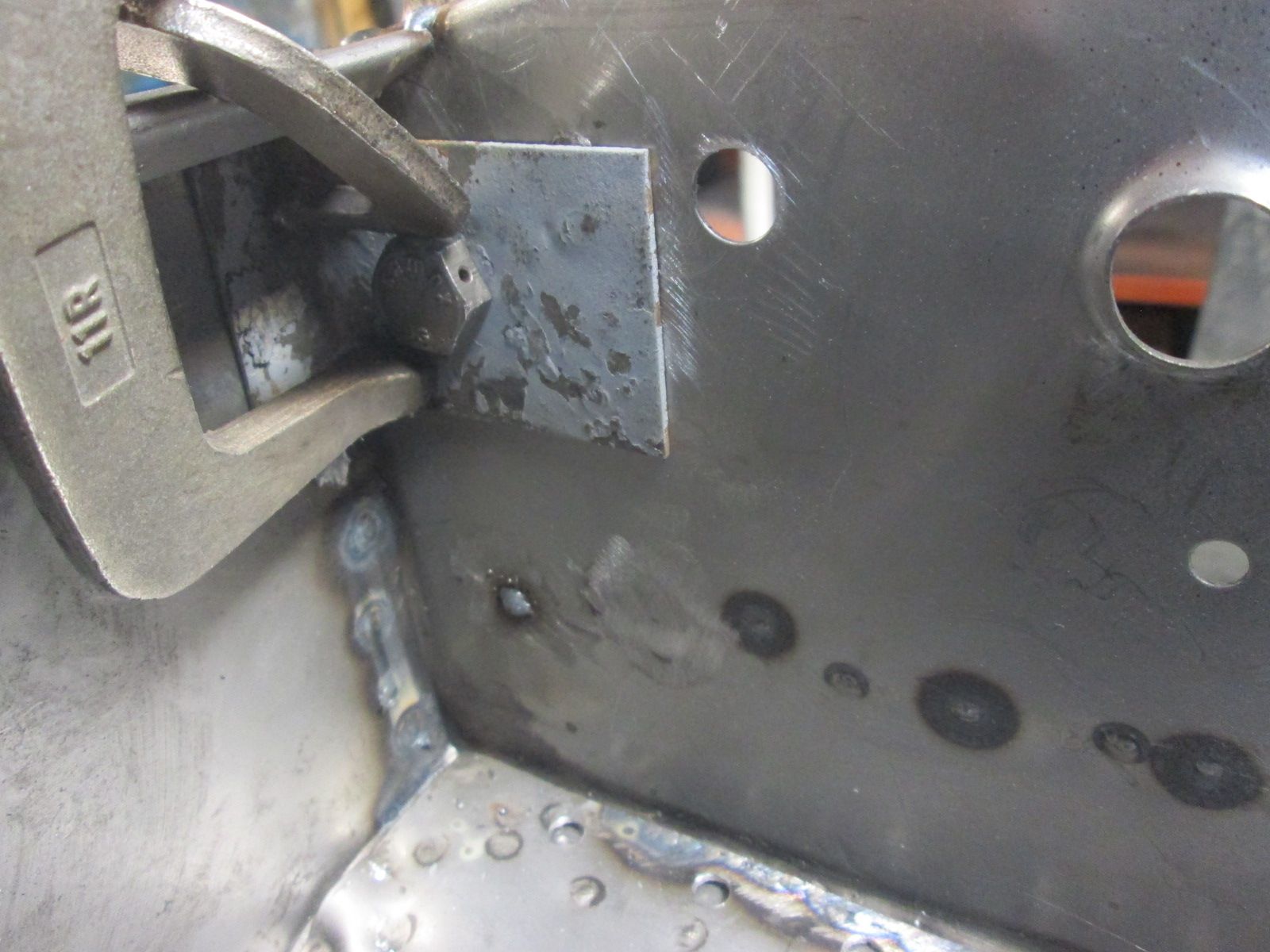

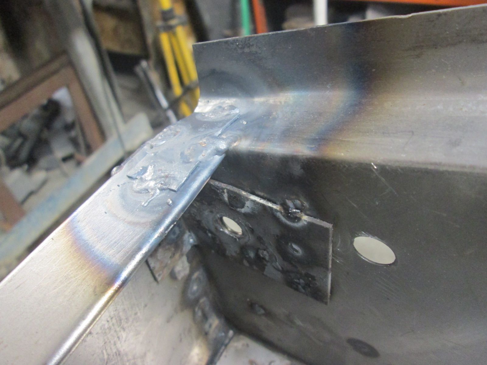

                • Battery box welding:

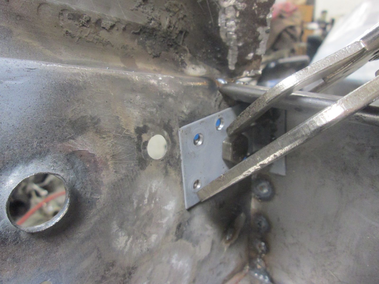

                  Click image for larger version  Name:	IMG_0363.jpg Views:	3 Size:	225.8 KB ID:	114164 After welding up the lateral flanges along the sides of the front wall it was now onto adding the reinforcing plates to the back side. Original plate nearly went back into its original position. The spot welds shifted slightly but was most important was the bolt hole alignment. All set and ready for welding here.
ID:	114165 Recycling the right plate. Fortunately the mount hole wasn't predrilled so positioning it to match the left was simpler.
ID:	114166 Drilled bolted, clamped and now ready to be plug welded from the outside.
ID:	114167 Then it was onto adding a lap plate across the top of the corner joint.
ID:	114168 Another build detail easily overlooked unless you have an original reference as a guide...

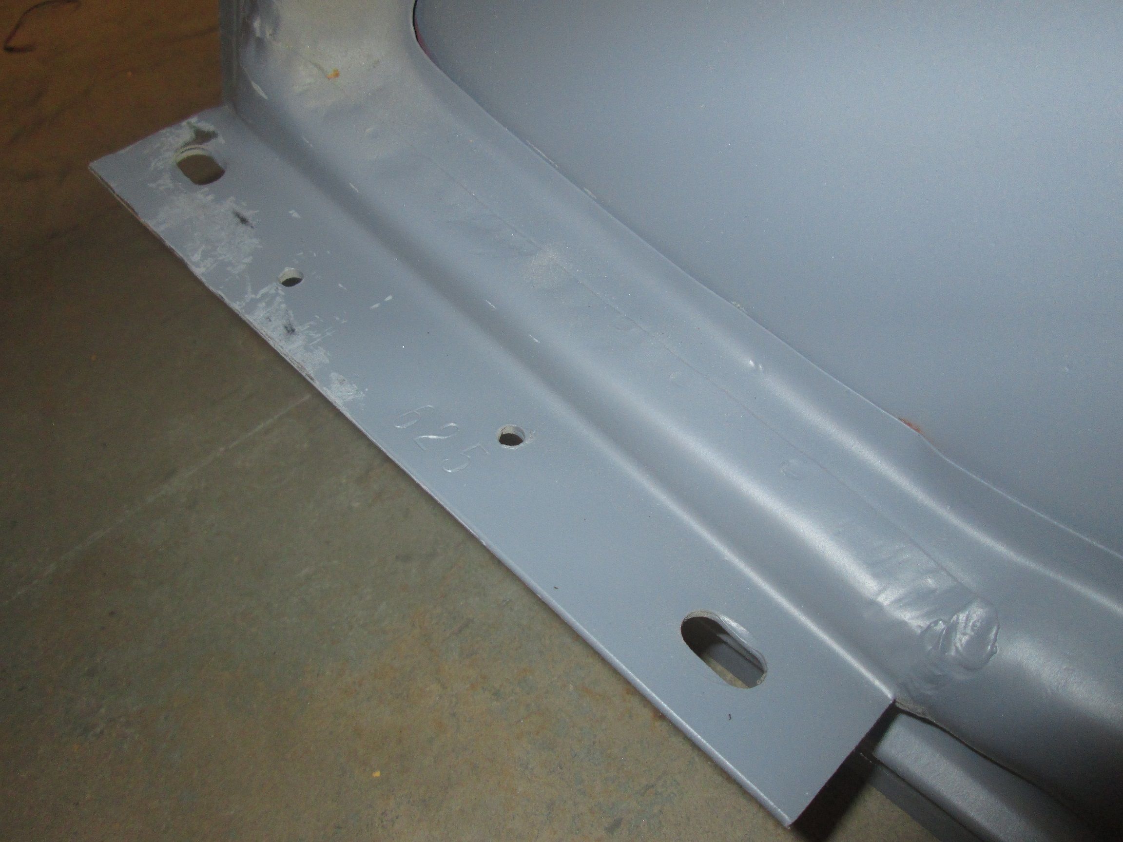

                  • Box welding continued:
                    Click image for larger version  Name:	IMG_0368.jpg Views:	0 Size:	205.9 KB ID:	114170 Then onto the left side. Gas welded on as the original shows.
                    Click image for larger version  Name:	IMG_0370.jpg Views:	0 Size:	189.6 KB ID:	114171 Then onto the later plug welds along the sides of the floor.
                    Click image for larger version  Name:	IMG_0371.jpg Views:	0 Size:	217.5 KB ID:	114172 Lateral plug welds complete except for some follow up finish grinding. I'm going to try and weld as many plugs as I can reach on the underside of the rear wall flange along the access hole areas next. I won't be able to weld up the center plugs until its on the rotisserie but I want to make this box as integral as I can before it goes on there and is asked to support the front of this car; Should be fine though.

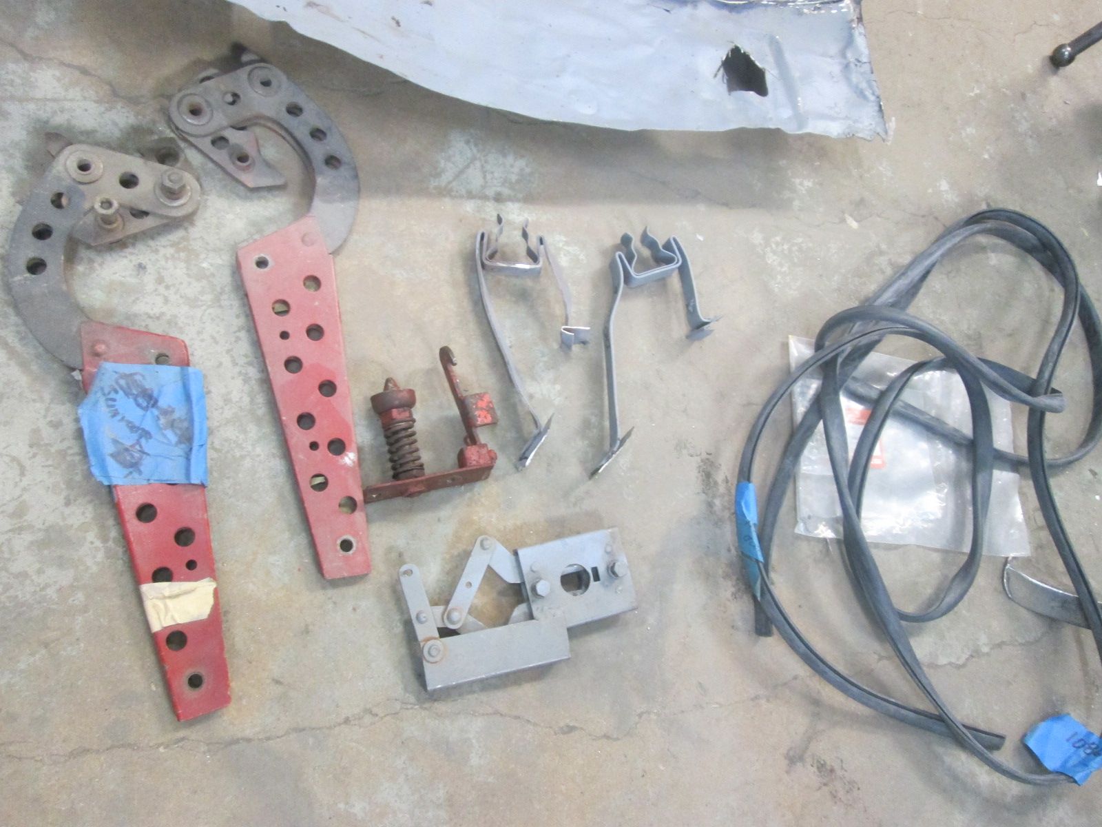

ID:	114173 With the battery box welding being nearly completed as far as I can go I'm switching gears and preparing for the next phase. I dug out all the related parts and components for the hood.
ID:	114174 Original latch base will need some rehab but savable.

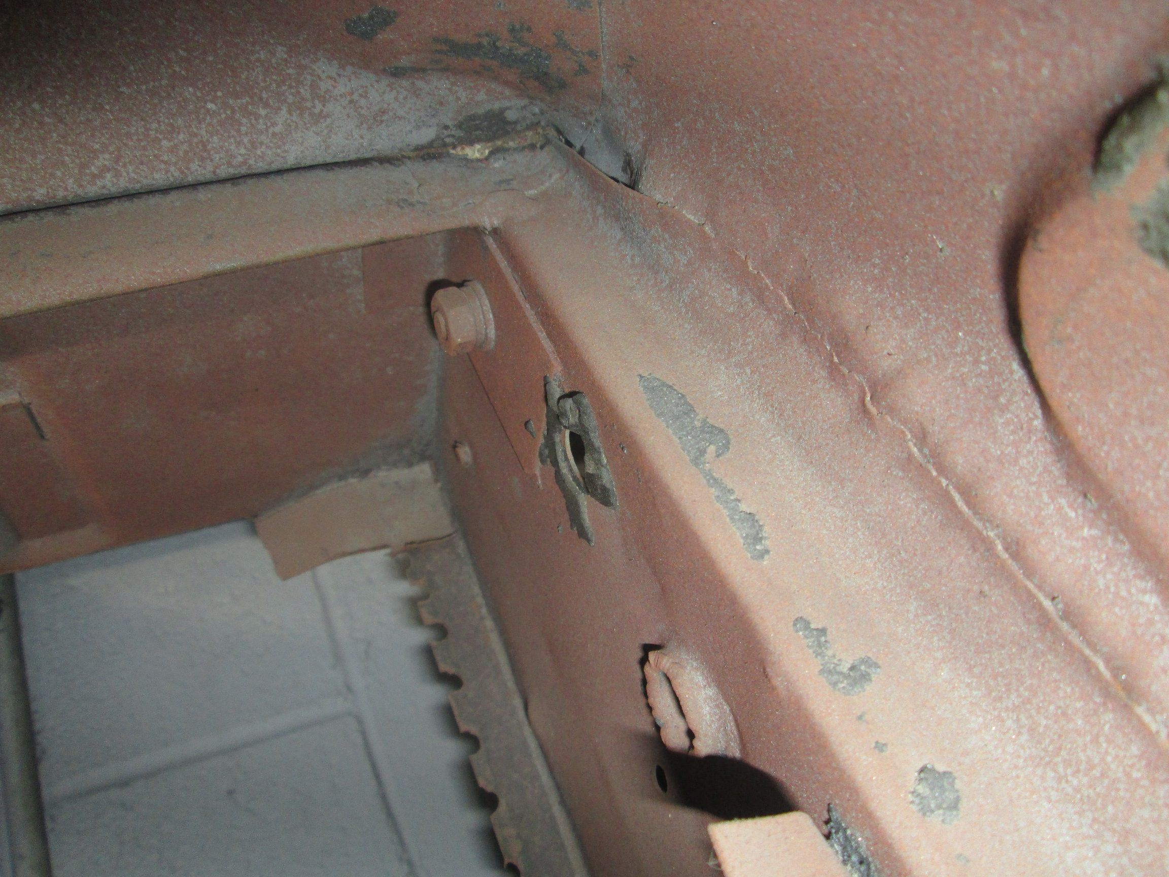

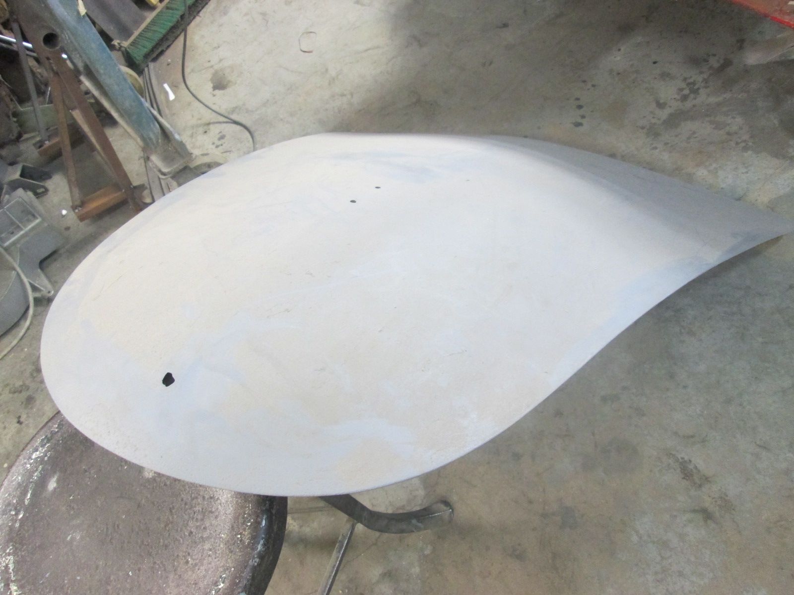

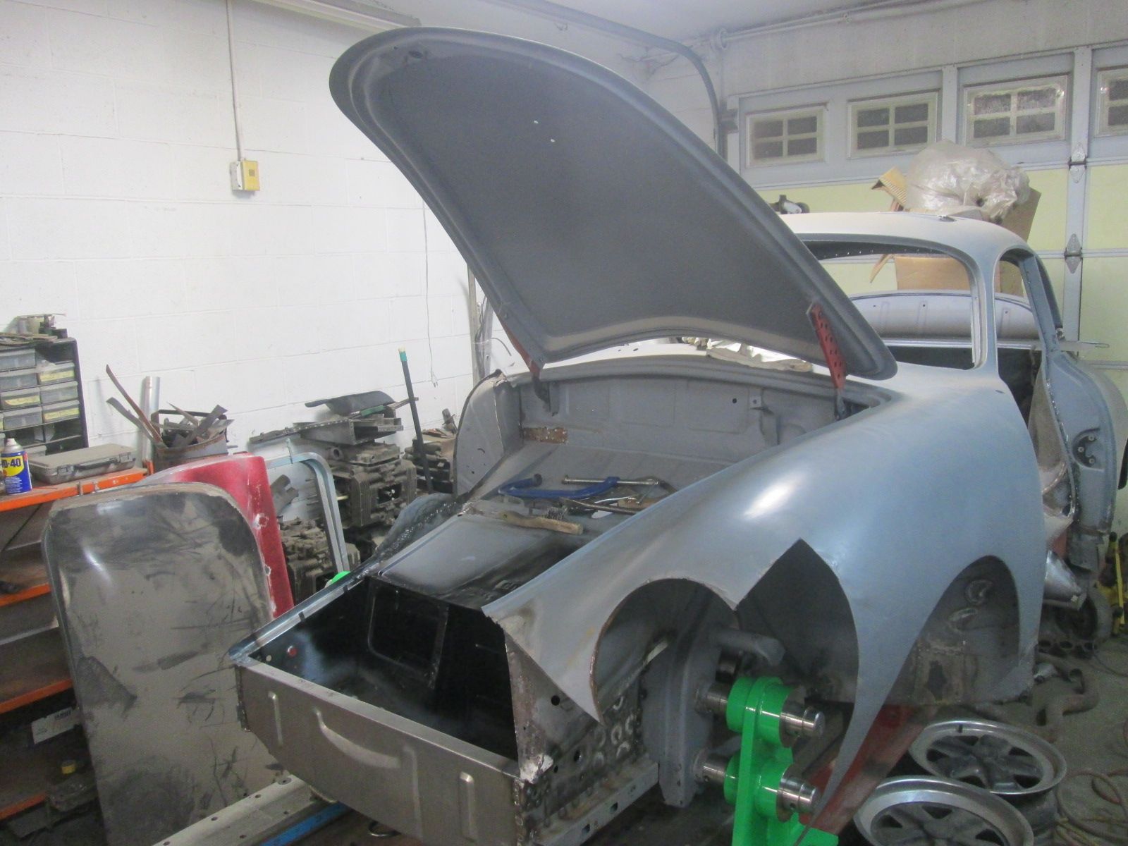

                    • Then the hood itself.

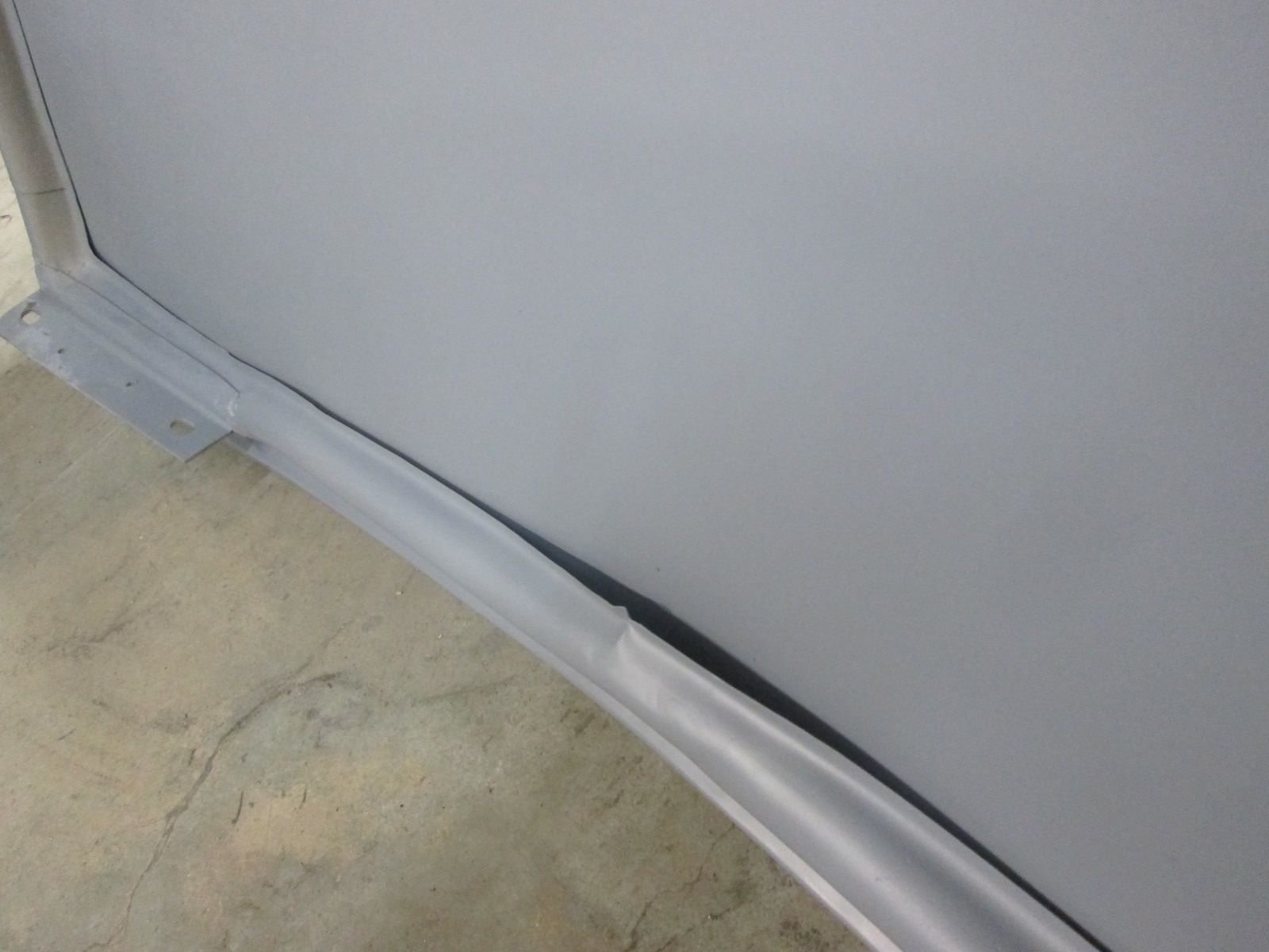

                      Click image for larger version  Name:	IMG_0357.jpg Views:	0 Size:	186.4 KB ID:	114176 Considering what the front of this car has been through its hood is in amazingly good condition. Some minor damage to the mount flanges and substructure but I would have expected the nose of it to be crumpled and traces of being badly folded in the middle but no. Whatever they hit must have been very low. It does have some minor rust and pitting but being how bad the rest of the car was it faired very well in this respect too. You can just make out some pin holes along the leading edge and the hood handle hole has rusted open a little larger but these are simple repairs.
                      Click image for larger version  Name:	IMG_0358.jpg Views:	0 Size:	152.5 KB ID:	114177 Only damage along the substructure is along this left side at mid-point where it kinked. Again the mount flange behind it is a little warped too but will correct it all as it goes. Definitely never been "gas station Attendantized", this is all old collision damage.
                      Click image for larger version  Name:	IMG_0359.jpg Views:	0 Size:	426.2 KB ID:	114178 And it is the original hood...625 clearly stamped in. An amazing survivor.
                      Click image for larger version  Name:	IMG_0360.jpg Views:	0 Size:	165.5 KB ID:	114179 As the refitting and adjustment of this hood goes there will be repairs required on the both sides of this closing panel. Right side pocket torn and tilted back slightly.

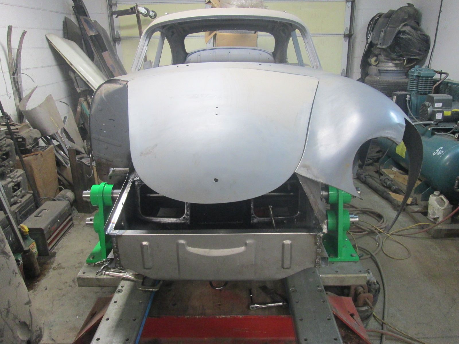

                      Click image for larger version  Name:	IMG_0373.jpg Views:	0 Size:	206.2 KB ID:	114180 But before I begin moving anything I wanted to do an initial mock up to see how bad it all was. The hinges didn't slide into the pockets very easily by themselves so some prying was needed. This I definitely have to have dialed in as it all must mount together as unit with the hood when its all over. I think I have the hinges switched as I could not get the drilled locating holes in the flanges to line up. Oh well, this was just the first of many mock-ups.

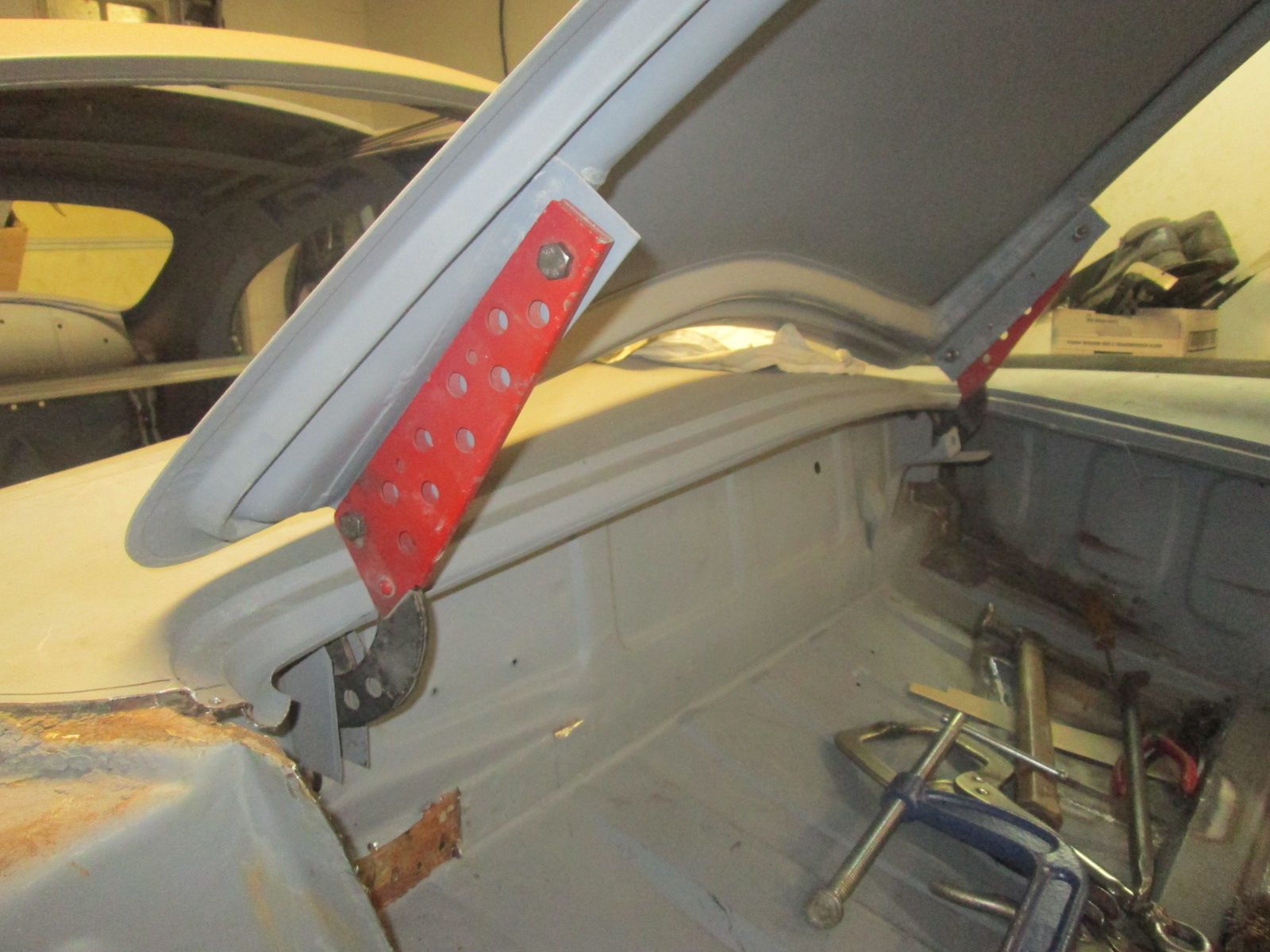

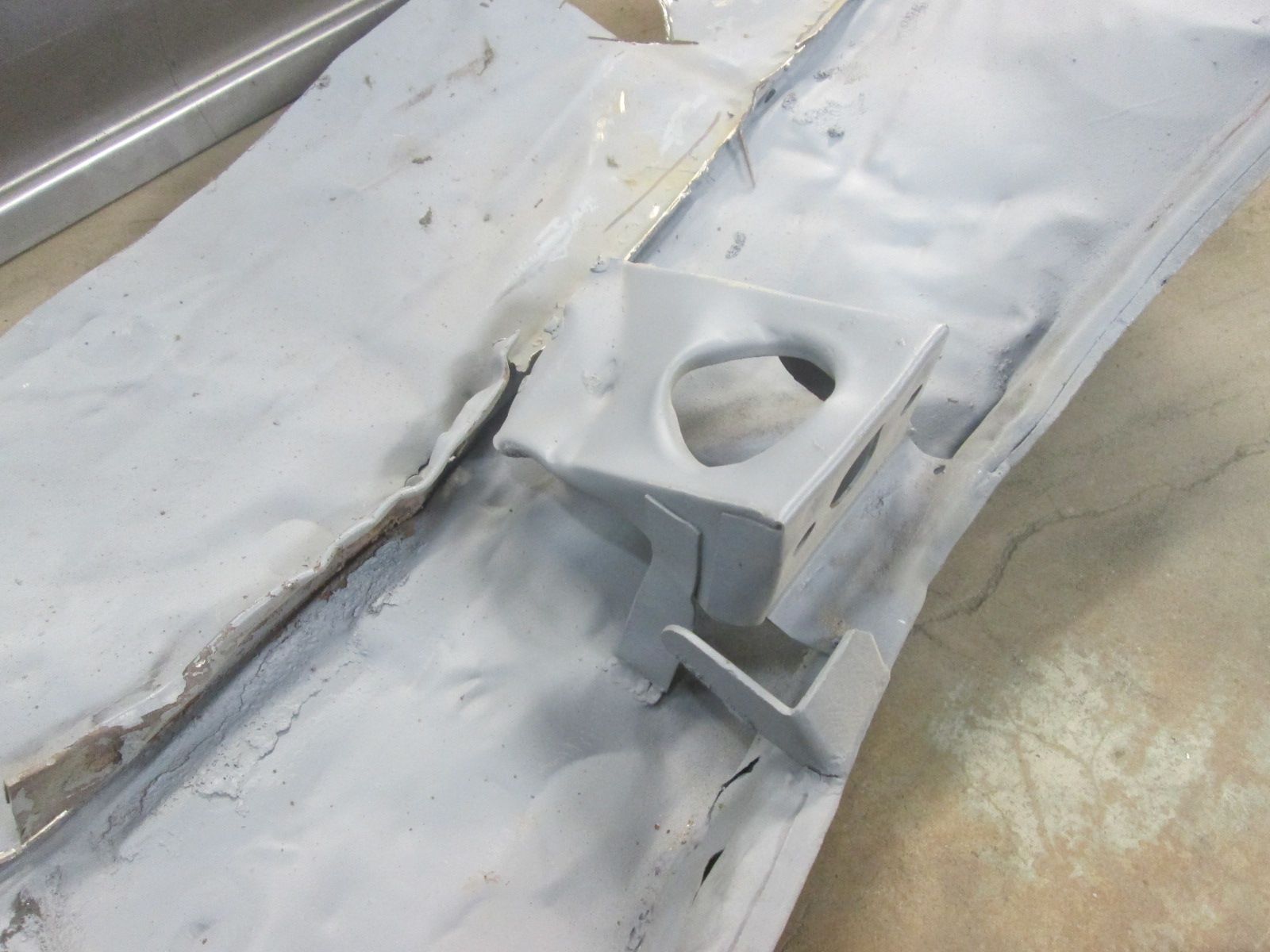

                      • Click image for larger version  Name:	IMG_0372.jpg Views:	0 Size:	204.4 KB ID:	114182 At least the hinge mechanisms operate like they should.
                        Click image for larger version  Name:	IMG_0376.jpg Views:	0 Size:	182.4 KB ID:	114183 Onto back filling this big hole.
                        Click image for larger version  Name:	IMG_0374.jpg Views:	0 Size:	222.5 KB ID:	114184 But everything up here revolves around a latched, adjusted and set hood first. Wading into these waters now.
