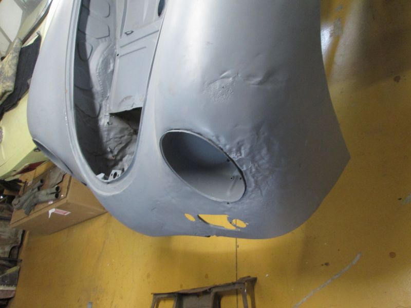

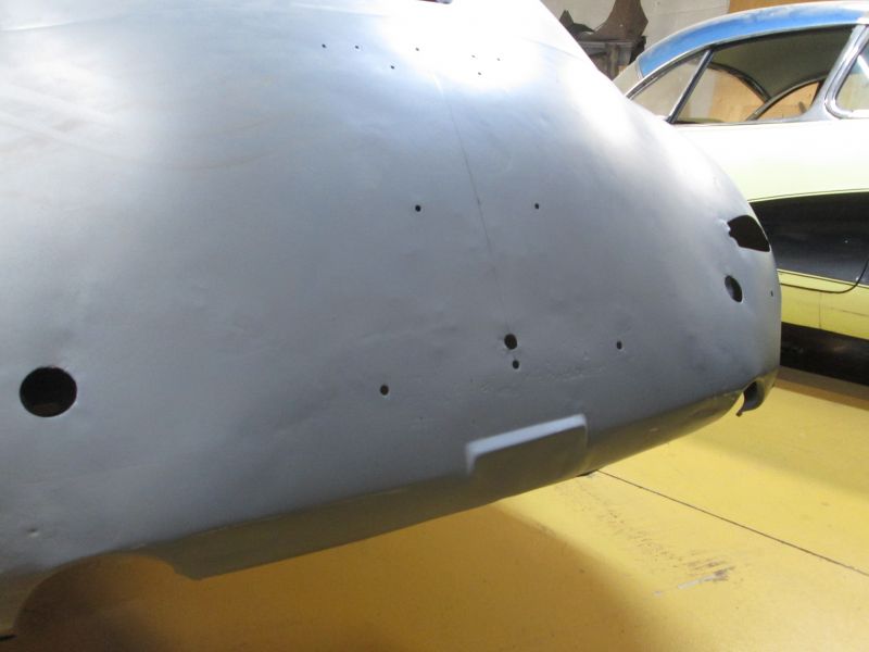

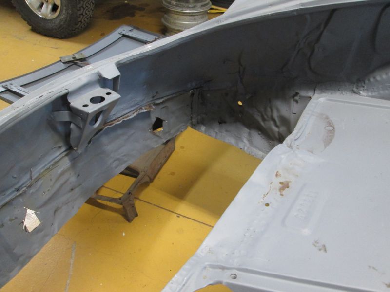

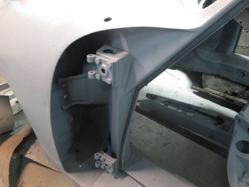

    Original nose appears to have been hit patched and hit again. Its pretty lumpy and mishapen at this point so a new nose from Trevor's was ordered.

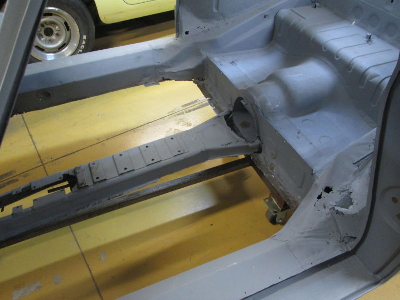

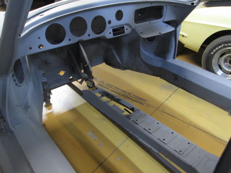

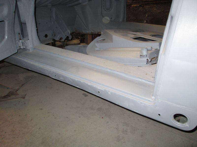

    Floors and longitudinals are of course gone and expected on a car with a large hole in the roof.

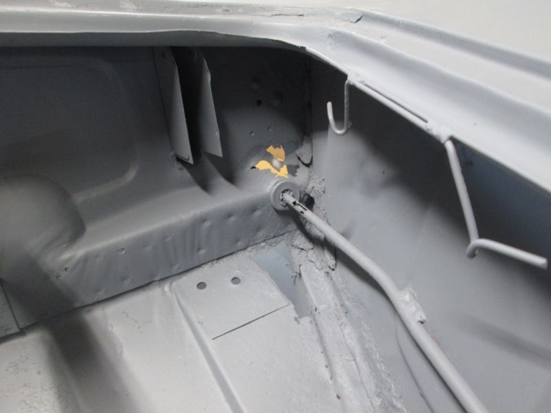

    However rot in places like this does tell me there will surely be some suprises along the way.

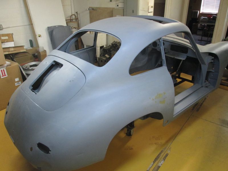

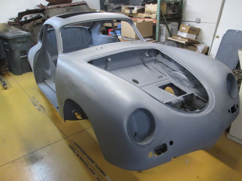

    Aside from the frontal damage and rusty floors the rest of body appears to be in pretty nice condition. No suprises under this primer as its already been media blast clean so what you see is what you get. All closing panels are matching numbers but the original doors will need some lovin'.

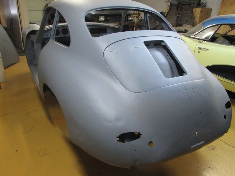

    This is a very late A and as you can see some B series details like this reverse light embossment where beginning to show up as Reutter began tooling up for the new production run.

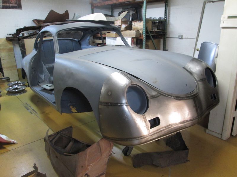

    Well this completes the intro for now as I won't be hitting it hard until the coupster is gone... Within the next few weeks give or take.
    Thanks for looking
    sure looks like a nice shell justin
      Justin,
      Looks like it needs more work than I thought after seeing that one photo. It makes me realise how lucky I am still to running a car with original floors, front nose, battery box and longitudinals. You tend to take these things as normal they just are not in the world of 356.
      Of course by the time you have finished with it, the underneath and body will be better than mine for sure. Look forward to the instalments when they come along.
        Looking forward as well. Never get tired of people fixing up these cars and learning and discoverying new tricks. No one car is ever the same.
        Scott

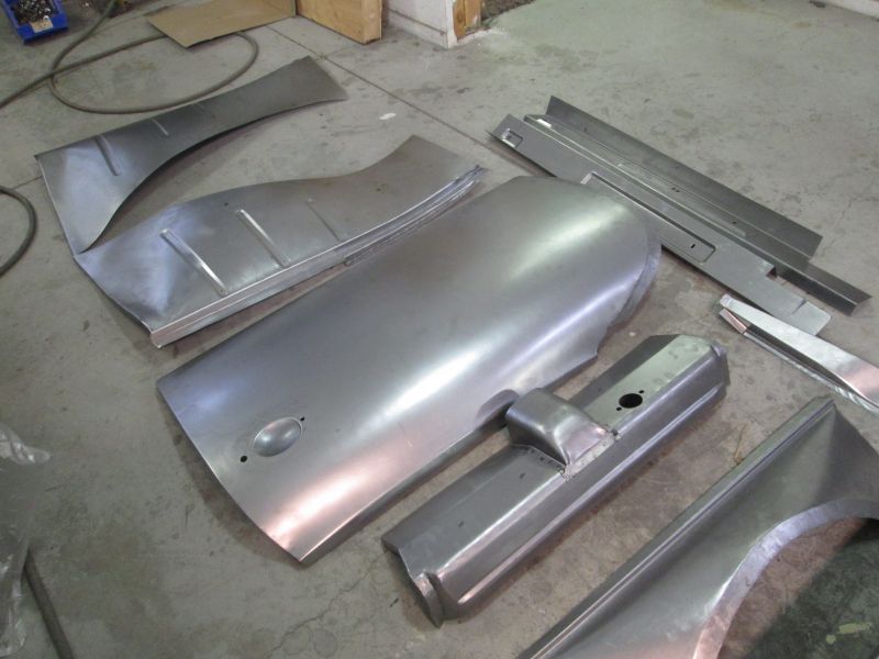

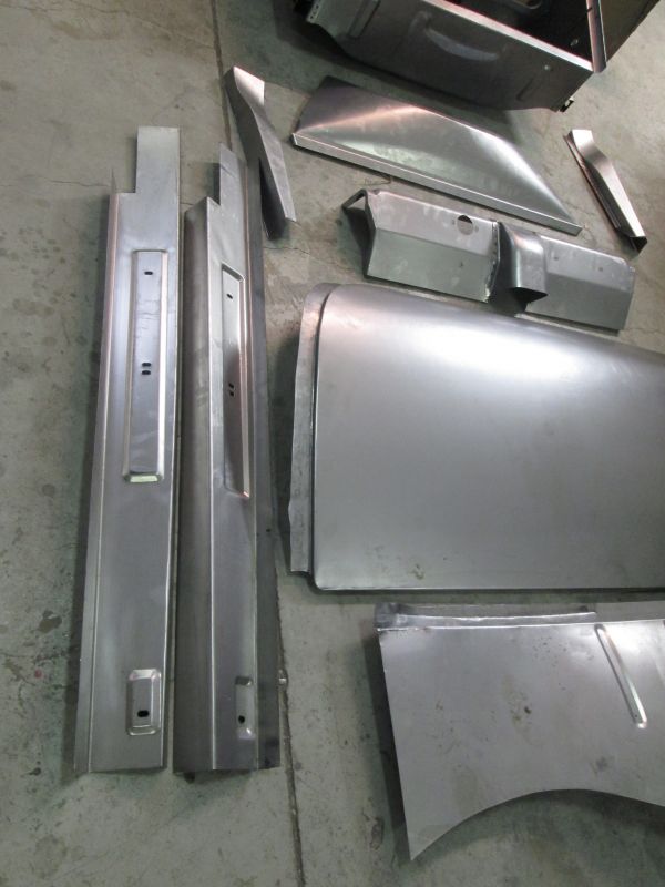

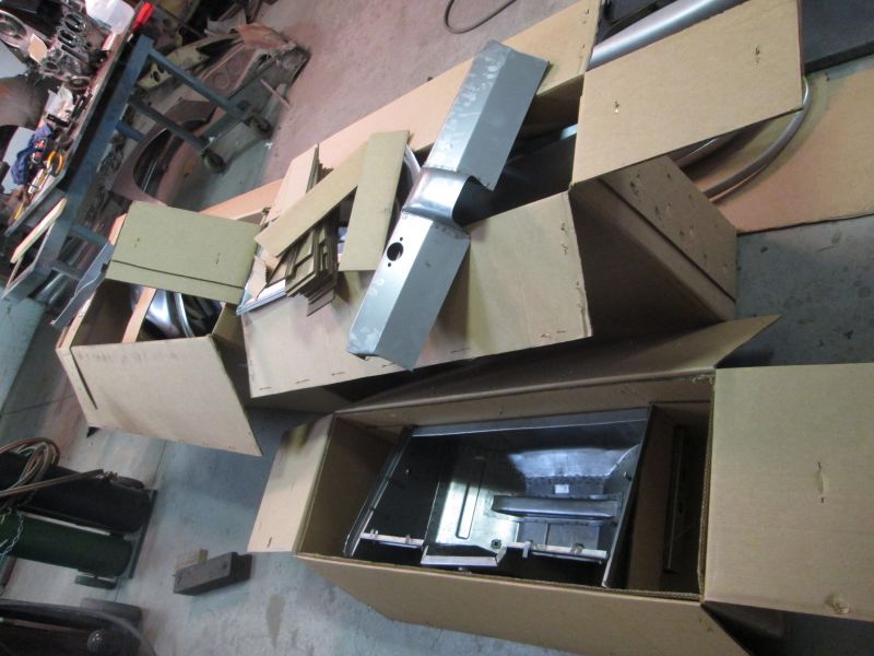

          New panels from Trevors.

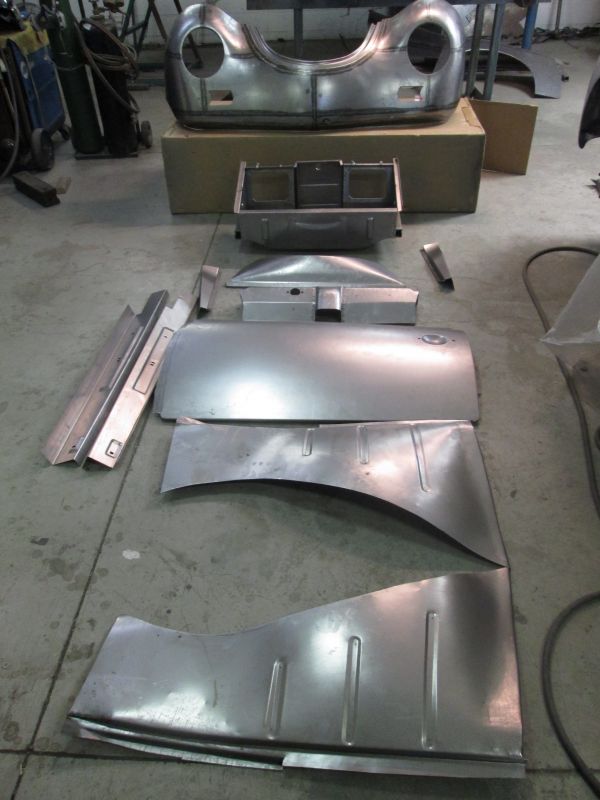

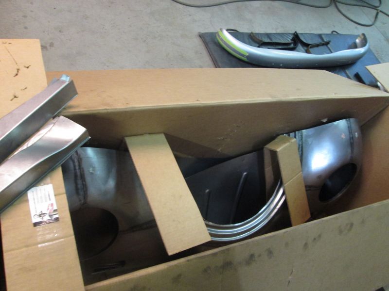

          Most of the new panels we'll need for this car arrived a few months ago.
          new nose section

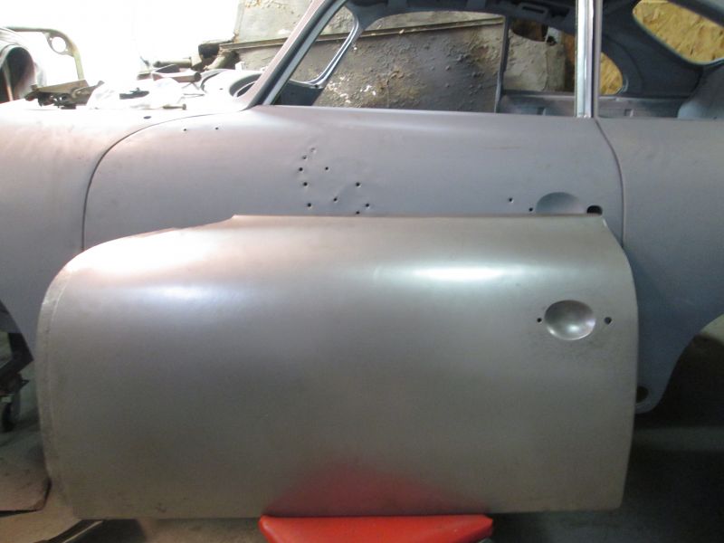

          left door will need reskining.

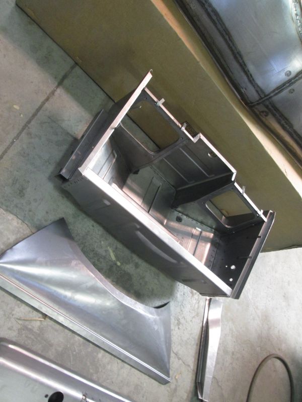

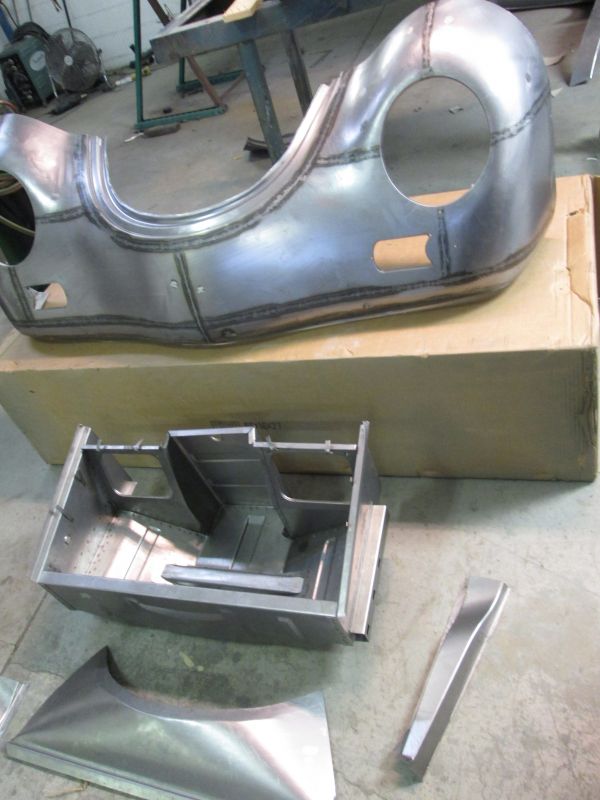

          New battery box unit and upper closing wall.
          A clean look at that pretty new nose.
          rear inner wheel house closing panels.

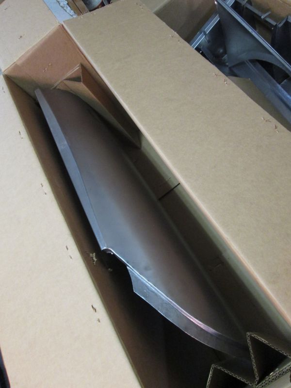

          both doors will need new bottoms.
          Nothing prettier than shiny new panels.
          Gave the new nose a quick test fit. Things were looking up almost immdiately.
            Oh my goodness Justin, those body parts from Trevor look so good. He has really done so well in producing those. When you look at the nose and battery box alone they look so good. and the view of the nose section placed in position is so close!!
            I guess? Trevor was quite young in the early 70's when I was working on my car. He really is a great help to the 356 community who have all the rust problems. Of course to fit these parts still needs such skill and the correct welding equipment. In the early 70's my gas welding set up with full size bottles, nice torch and nozzles, good long pipes were perfect for the time, providing you were really good at welding!! But now I know, I could never get the results you can obtain without being an expert on Mig and Tig. Progress I guess.
            Hope the front suspension was not twisted by the internal front nose damage.

                    Is that a '59 Corvette in the background of the pre-B reverse light out-dent picture?
                    Tony Daskeyman still has a late '59 (356) he bought when he was 15 and hanging around my first 'real' commercial shop in '73. A $300 (I think) "driver" with nerf bars, that stood out. New to the trivia, we thought it was a B clip that had the hole for the light filled. Pre-Internet nye-eve-ah-tay.
                    I have seen several Convertible Ds that had the reverse light bump without the punching of the hole for the actual (generic) light. Between all models, anomalies were common. Who would have thought that Porsche would build a Roadster with all the front T-6 features...and after all that trouble, only have made ~240 of them?
                      Hey Bruce,
                      No, its a '62 and the only American car I've really lusted after. The fit and finish does leave a lot to be desired especially as I look at it through the prism of exacting 356 standards. My next thought is, so this is when Detroit "made them" huh? Oh well it is what it is...

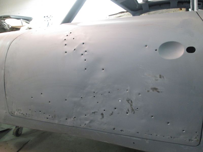

                      Prepping left door for metalwork starting with a baseline fitment.
                      To begin this project I'm breaking the ice with the left door. It requires a new skin and door bottom. Keeping in mind all that has to be done to the shell itself this might seem out of sequence but after the new floors and longs are in I won't be able to commit to the rocker reinstall until I have a finished closing panel to establish the final door gaps against. So either way it all has to be done. Besides the coupster project still occupies my rotisserie for the next several weeks so I'm working on what I can to get the ball rolling here.

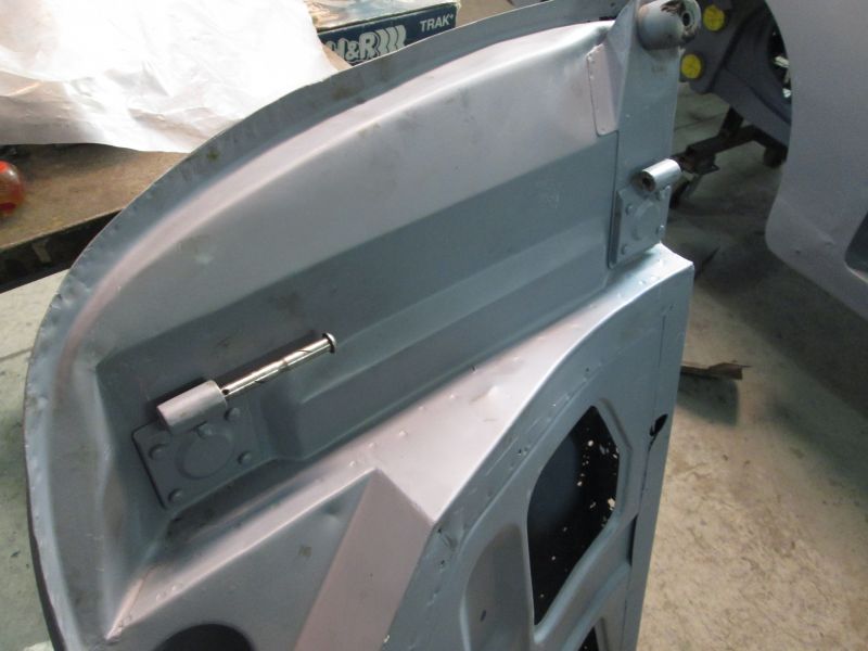

                      Car arrived with hinges mounted and shimmed "correctly" I can only assume? Going to know for sure here in just a little bit.

                      Of course it doesn't go right on as the pin holes are clogged with primer so some reaming was required. I learned on my coupe project to always mask these off for this very reason.

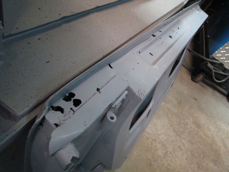

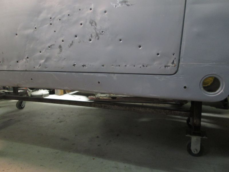

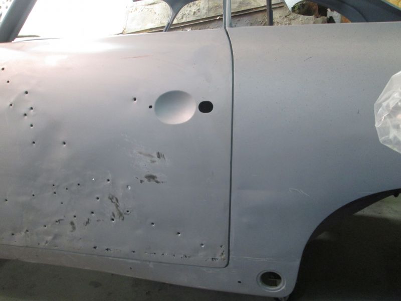

                      Bottom of the original numbers matching door in need of replacement.
                      Door hinge mounted and seats in nicely. This secondary bodyshop damage pretty much sealed its fate. These giant holes could pass for bullet holes but no its some geniuses way of pulling out old accident damage instead of just removing the door panel to get at it from behind.. Shit like this drives me crazy especially when it means the demise of an original panel.

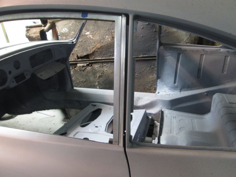

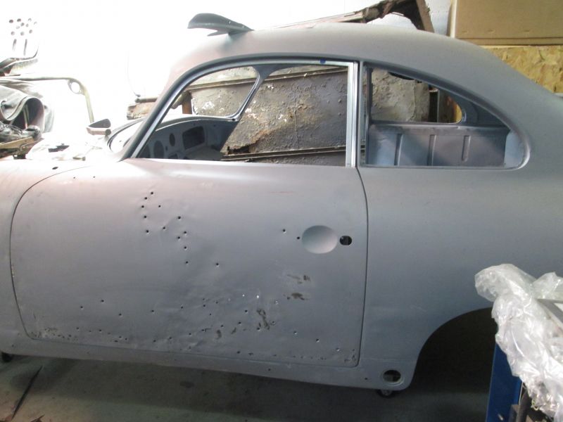

                      Rear gap is great with a nice transition off the top to the quarter window opening.
                      Lower gap runs slightly tighter as Bruce has said is what is normally found from factory.
                      Front gap also just as nice. So for sure factory undisturbed.

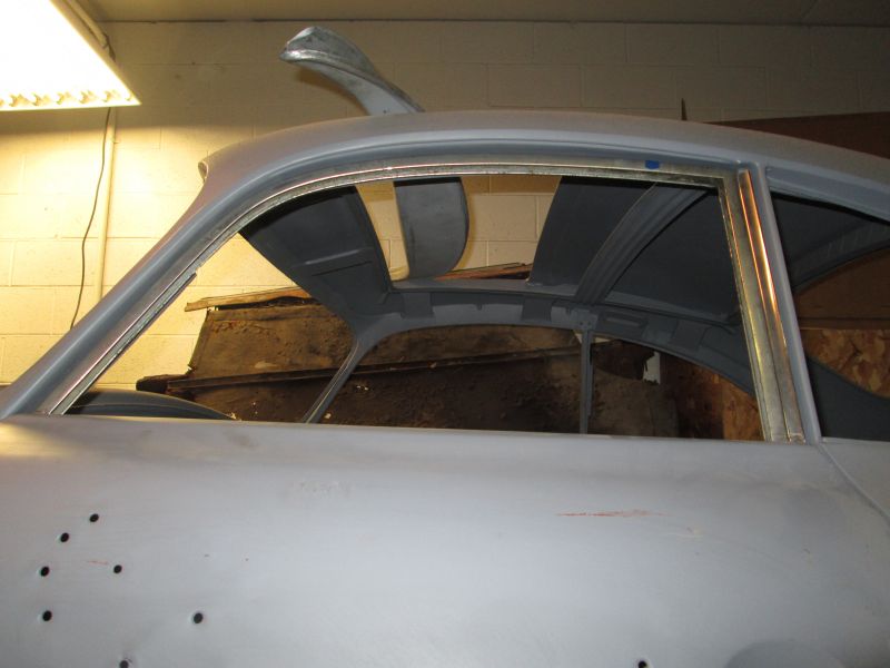

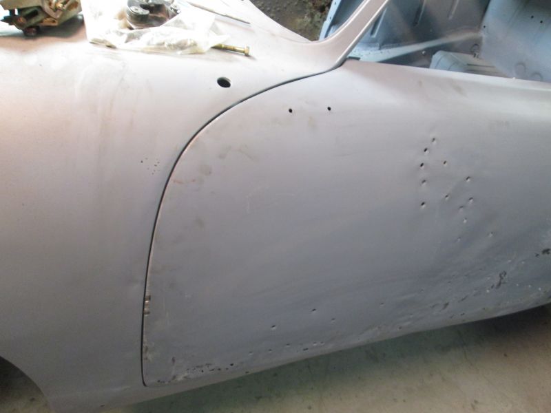

                      Original rockers have been rubbed a couple of times but are otherwise in surprisingly nice condition. These will be carefully removed and reinstalled eventually.

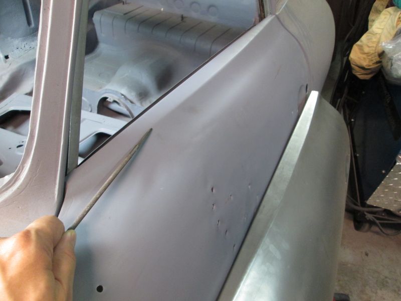

                      Original door frame installed next to check for clearance and contour fitment with the opening. Also very nice.

                        Justin,
                        You are so correct, the door gap is so good on this car. That really made me take attention. Wonder if the other side is the same?
                        I am going to enjoy this thread I reckon.
                          "Keeping in mind all that has to be done to the shell itself this might seem out of sequence but after the new floors and longs are in I won't be able to commit to the rocker reinstall until I have a finished closing panel to establish the final door gaps against. So either way it all has to be done."
                          My learning curve has eventually included the process of not finishing ANYTHING until ALL the parts are aligned as best they can be, then lacing the parts together, starting with the doors.
                          In your case, the door(s) may be considered "done" and can be left alone to be recreated after the other panels are added (with underside parts included)....UNLESS the replacement skin(s) are not of the same contours and affect the fore and aft panels.....a rock and a hard place situation.
                          Personally, since I build from the doors, I'd get the skin and rebuild the doors first and see how that fits and measures and perhaps tack/fasten the doors together with all their original or repro parts and go from there.
                          What I'm saying is what you know....temporary attachments are whole lot better than complete welding when the need to adjust comes up and seeing everything together allows the "eye" to get the preview of a finished job after the measuring and or jigging.

                            Taking a close and detailed comparison of Original and new to determine left door reskin plans.

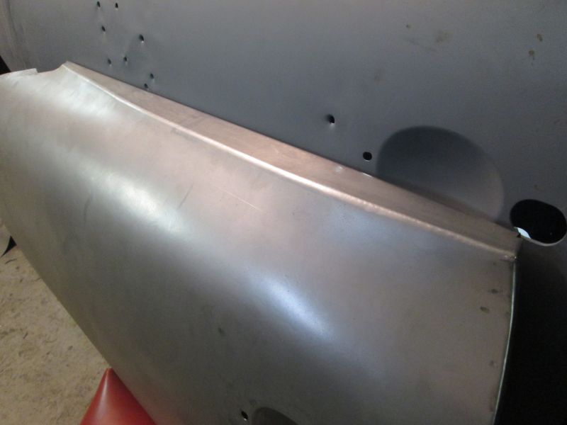

                            Trevor's new door skin is a beautiful piece and ideally I'd hate to cut up something so pristine but I needed to find out if using it whole or only a section of it will give me the best and most accurate end result for the least amount of work.
                            Everything below the door handle line is obviously going but whether I use it all rested on how accurate this top cap area and details match up with the original.

                              I have seen original cars with "numbers matching" doors on a Cab that were made from Coupe doors with obvious hammer marks and re-contoured with lead, "as needed."
                              Ergo, you could use lead to match your "original" door details and still be "original." It's just "sculpting."
                              Ya gotta love it.....the earlier the Porsche, the more latitude a restorer has to be "original."
