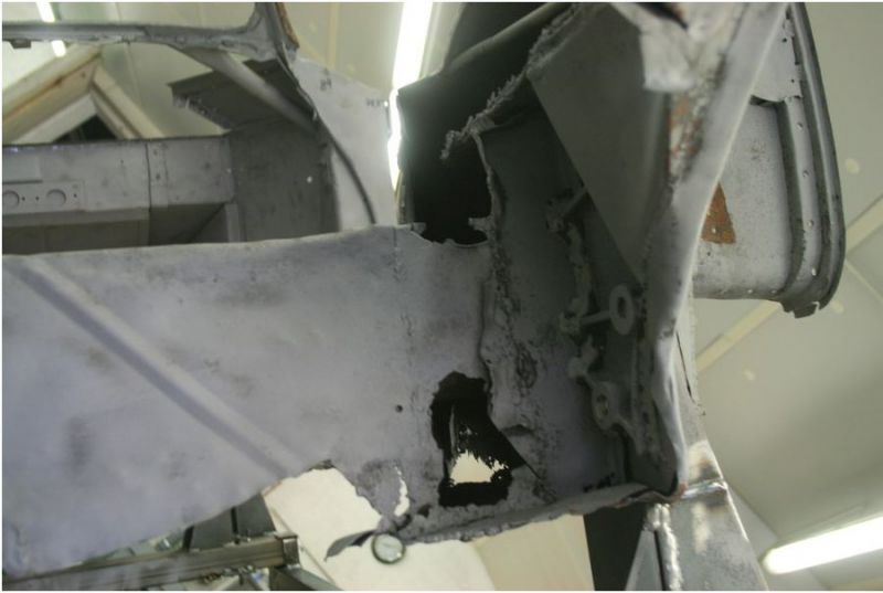

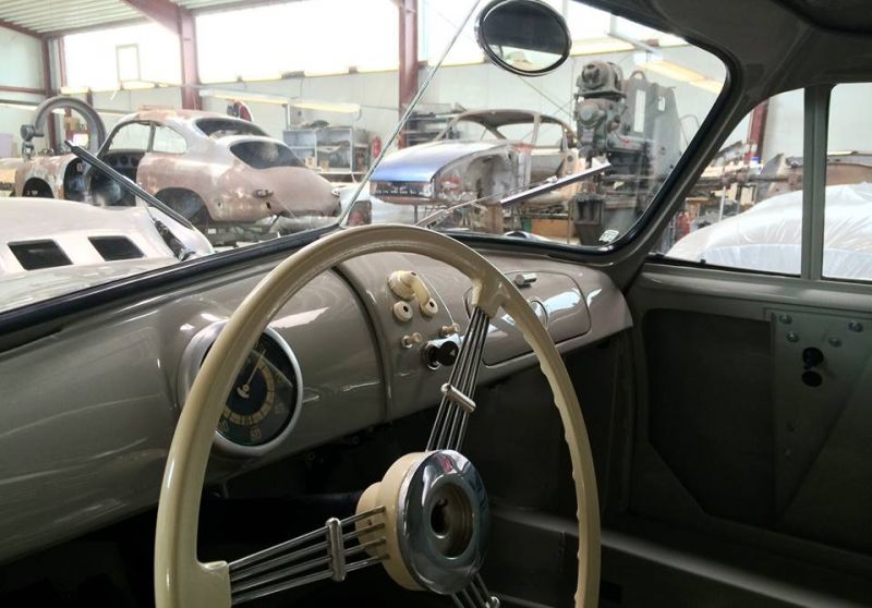

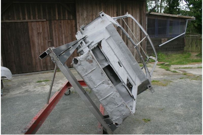

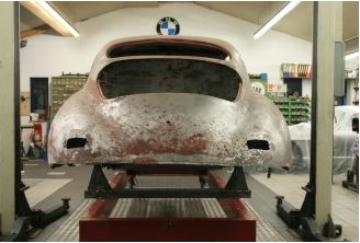

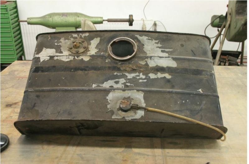

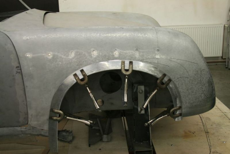

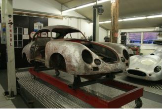

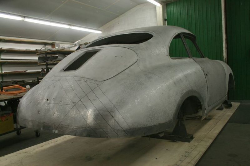

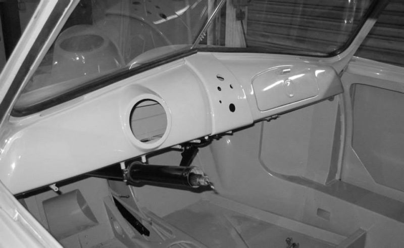

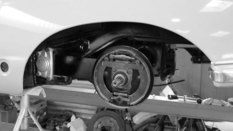

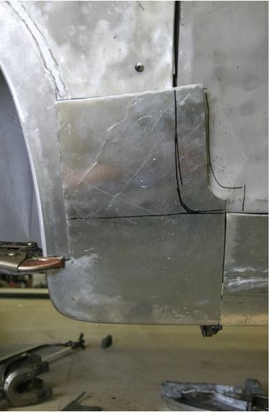

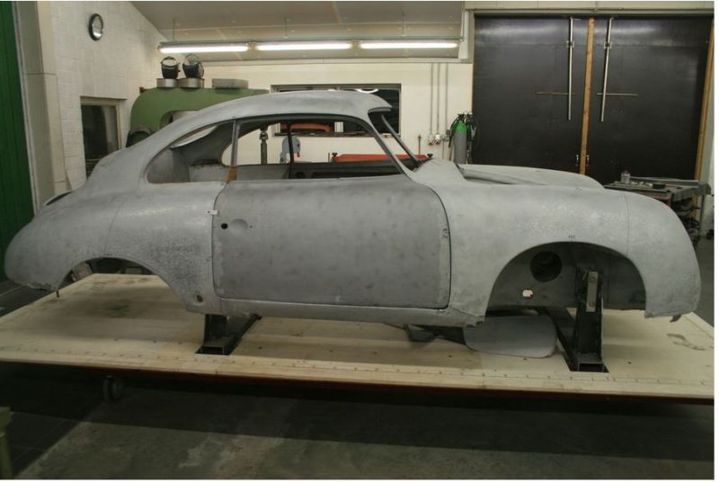

    • Working on the x---Porsche car topic I have found the following pics showing one of the very early 356 Gmund (016) being fully restaured at the Ulrich Wainberg restauration shop
        • Very cool Gerard! I really like their philosophy of repairing and saving as much of the original body as they can versus reskinning it.
          Don, I moved your question over here:

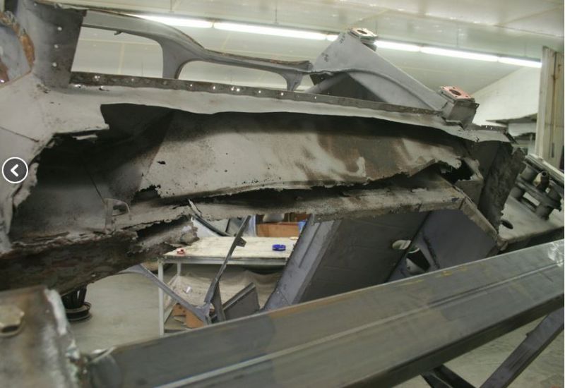

          I was wondering how they attached the aluminum bodies to the steel chassis on the early Gmund cars? Anybody shed some knowledge?
          Thanks,
          DC
          I've never seen how they were attached but either bolts or rivets. I'm guessing rivets...
          • Thanks Justin

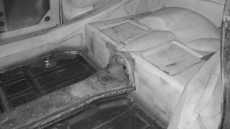

            Hi Don
            From the pics herewith I agree with Justin
            Apparently the aluminium body was riveted unto the steel chassis

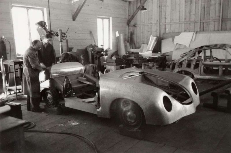

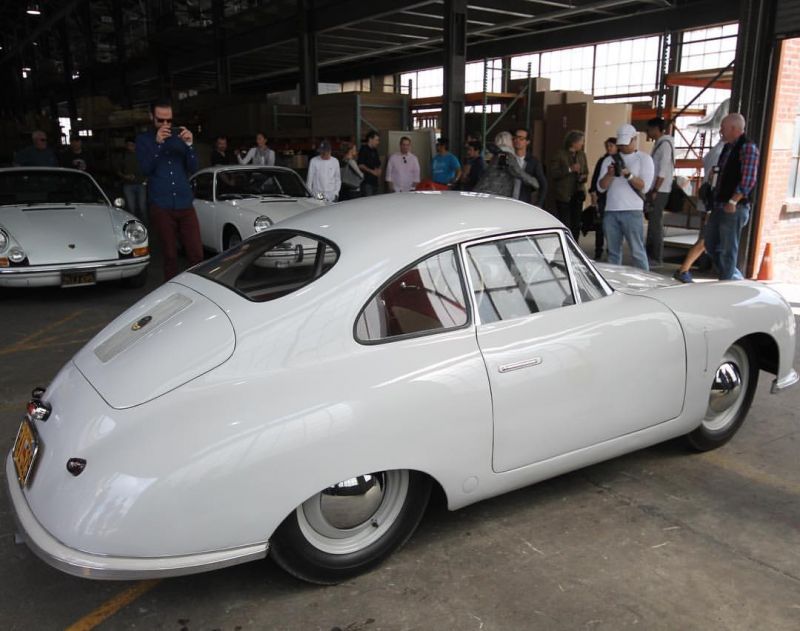

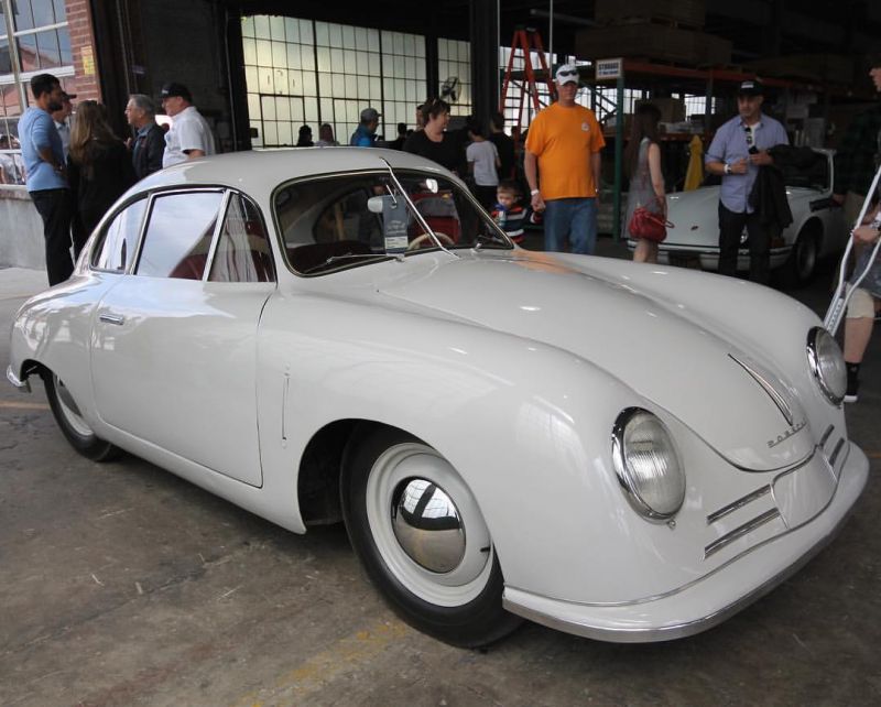

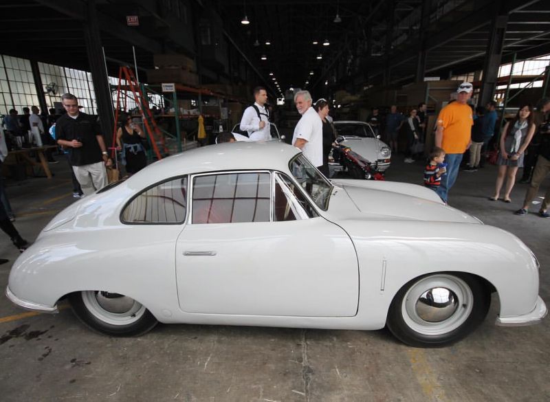

                      • Never gave these early ones much thought but I find this thread fascinating. Here's one~
