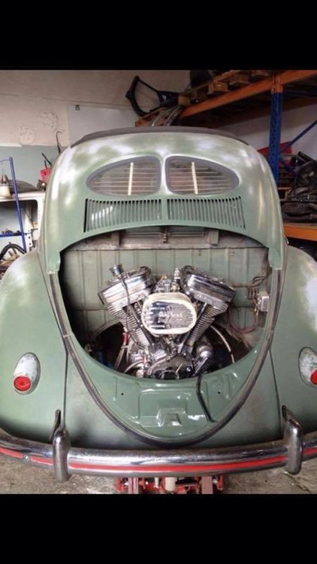

      Here's another option

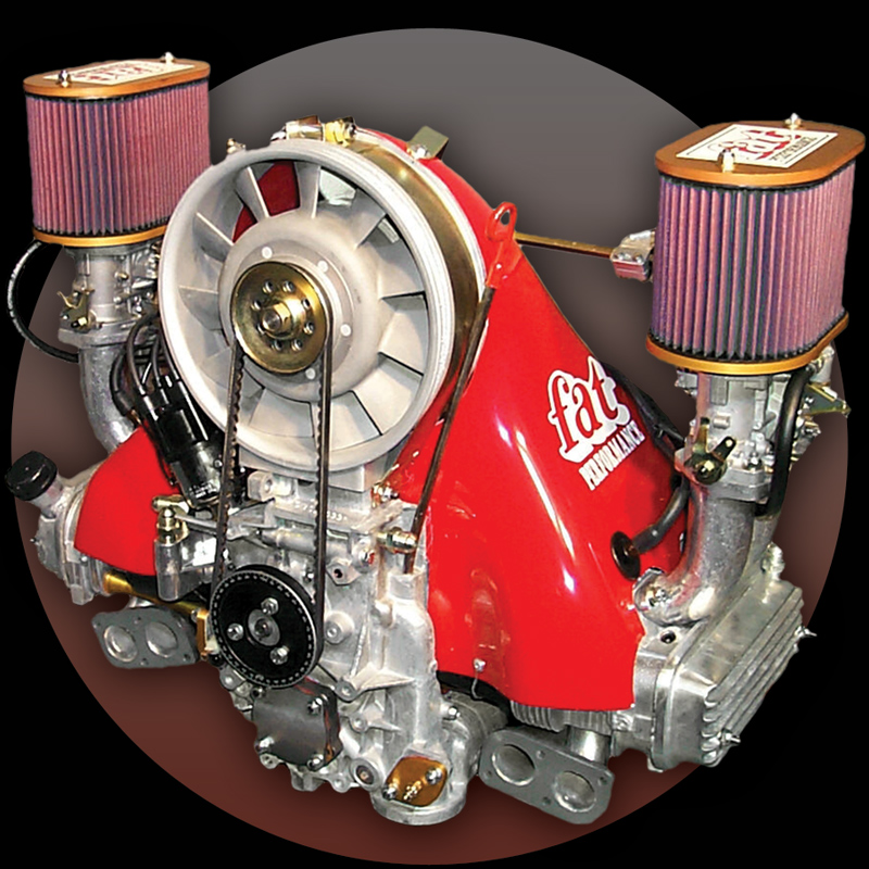

                  My original dream powerplant was a punched out type-4 with a 911 fan shroud assembly.
