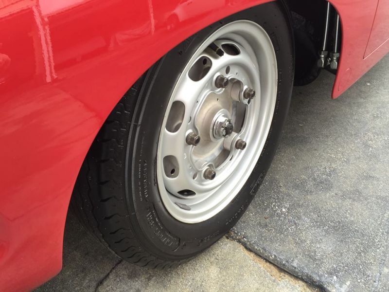

              today I tested the smaller arms on the rear train ( - 1,18in for each side), to adjust the offset of my wheels, great cause I have the place so I could fit more on the exterior and fit a bigger size on tyres perhaps 205 70/15 on 5,5 wheels

                If you want replicate the 356GT look think about these 20MM spacers. These where used to widen the rear track in compensation for the wider GT front racing drums. Opinions vary But I personally like the looks of the spacers in there. The fronts had the wider drum so these were not found up there but no rules in your case for running them on all four corners. I think it would look great and you could again adjust your offset to compensate for them. I believe Karman connection on your side of the pond sells the spacer and stud kit. Just a thought

                  But my rear wheels are not welded and not painted so I can do what I want. When the wheels welded and the tyres on, I ll fit spacer if I can but under the drumskins to be invisible, the complete wheels must be take all the place in the arches .
                  The problem for me now is to found what size I can choose the tyres , want to have the same effect like the emory s , with Dunlop Firestone or Continental. Perhaps in moderne profil mid racing like toyo or avon but for the front it will not good if I want the same manufacturer cause on 4 inches wheel I can fit max 155 larg.
                  Its a probleme to choose and decide for md now
