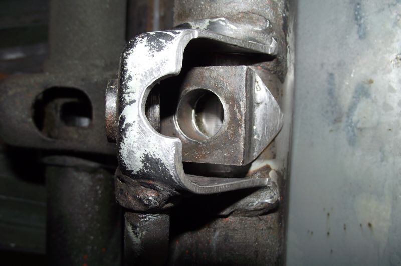

    I am ready to knotch my beam. Can anyone tell me how much I should grind out after I remove the nuts and bolts? I have seen others do it, but was wondering if there is a specific measurement of how far to grind back. Thanks
    Hi Mark,
    I notched out enough clearance to allow the collar block to rest against the threaded bung. This is as far as you can go without modifying the adjusters.
    The collar block opening will tell you exactly how far you need to go to allow it to bottom out. I suppose you can take a few MM's off of the shoulder of collar to go further but there will be interference with the jamb-nut at the bung. I'm finding it difficult enough to get the nut tight in this position. I'll have to make a special wrench to get in there to tighten it.

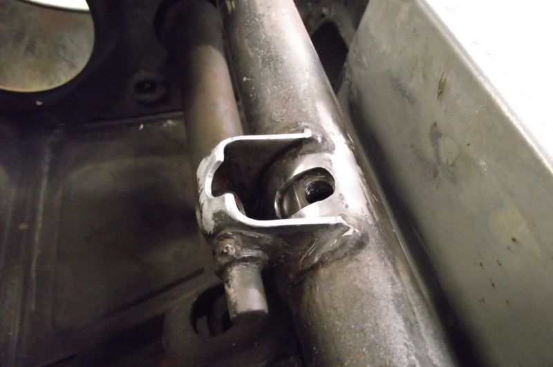

    Here is the new maxed out notch. This really is as far as you can go without opening up a brand new can of worms. Greg Scallon did a similar proceedure but not sure as to how far he went on his. Hope this helps! Keep me posted! Justin
