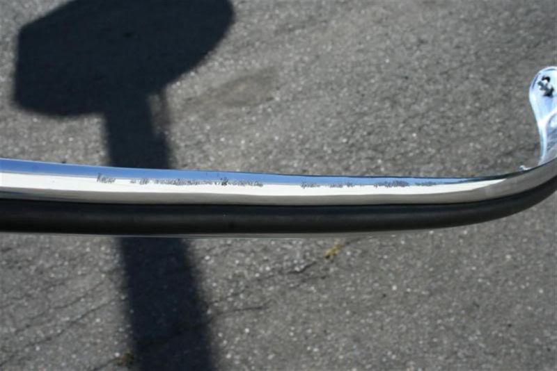

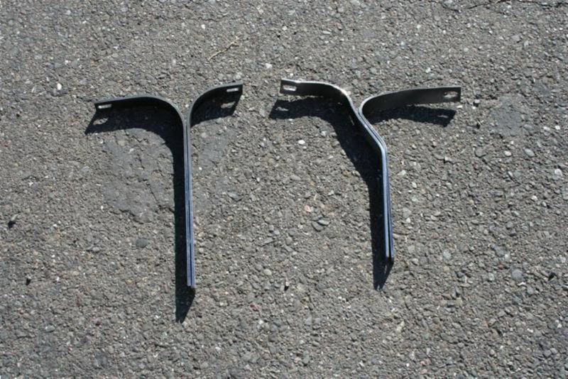

    I pulled the bumper off today to see what *exactly* I did damage-wise when I hit the curb.

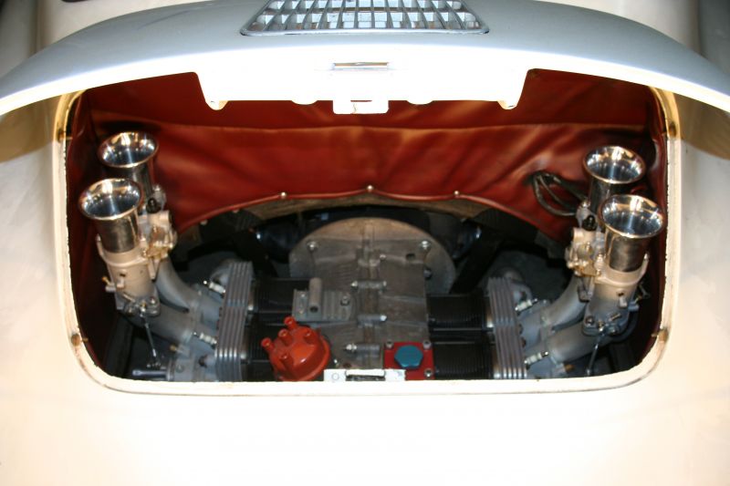

        This is what I dropped off to him....
        While it wasn't a show quality engine, it was clean and tidy.
