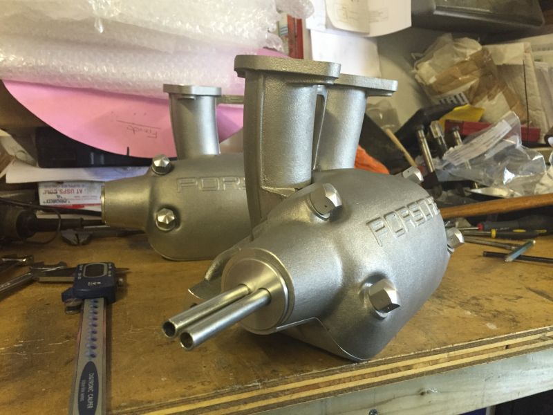

    On the subject of manifolds, I finished detailing one set of injection manifolds today.

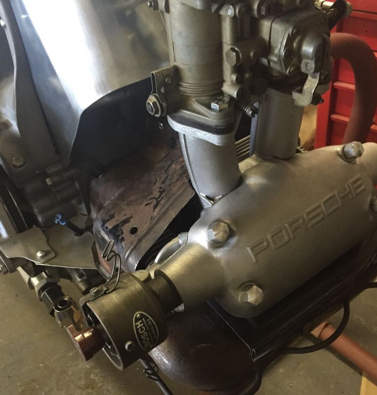

    For the spyders or pre A owners who want the early pre Vee drive look, one option is to run dummy distributors in the manifolds and hide the crank fire coil out of the way.
    I have been trying to get hold of a 4 cam distributor to 3D scan so to make an accurate body replica that could run an original cap,maybe one day one will show up.

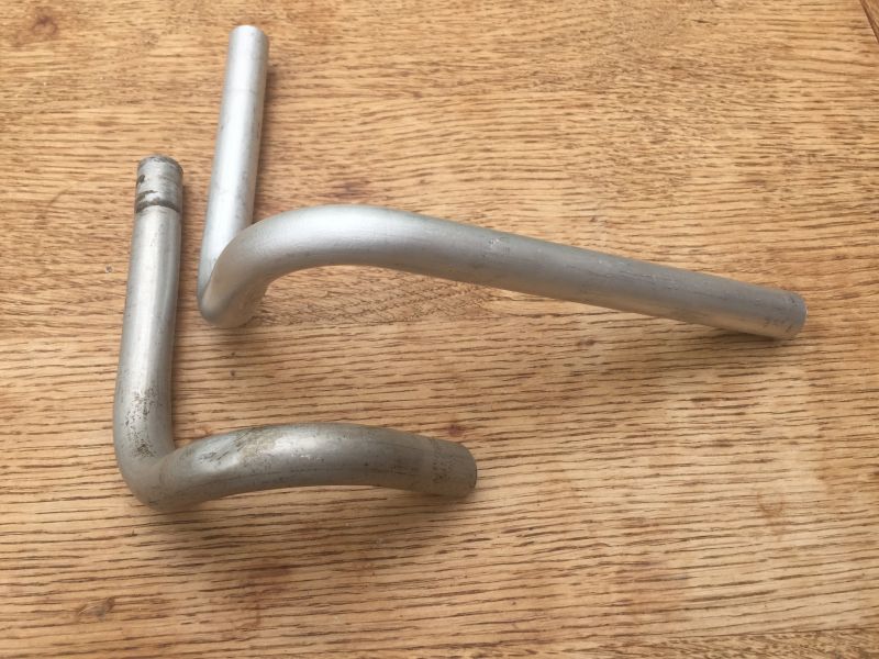

      While digging around today looking for some parts I found these. When I was first specifying the engine and reading all there is to be read about tuning a 356, I found reference in Duane Spencer's book about upgrading your early 3 piece case oil feed with a late style 912 16mm oil suction pipe. After putting out various failed requests on the Registry to source one. I decided to get some made, not easy as the two radii are very close to each other and cannot be formed on a standard bending machine. Luck was on my side though, Goodridge in Plymouth were making some development pipes for a Formula 1 team, which just so happened to be 16mm aluminium , so they were happy to do a small batch for me as the machine was set up for the pipe size.
      I have 6 spare if any body is looking for this small but very important upgrade to the oil system.

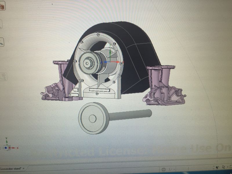

              Following the various calls for a type 4 version, I decided that the best place to start is in the virtual world. By creating exact 3d cad images of all the components, I will be able to see how the parts I have developed will bolt on to a type 4 case.
              To this effect I have started to create a digital library of each of the components, this will be added to with 3D scans of the 356 and type 4 engine cases over the coming weeks.

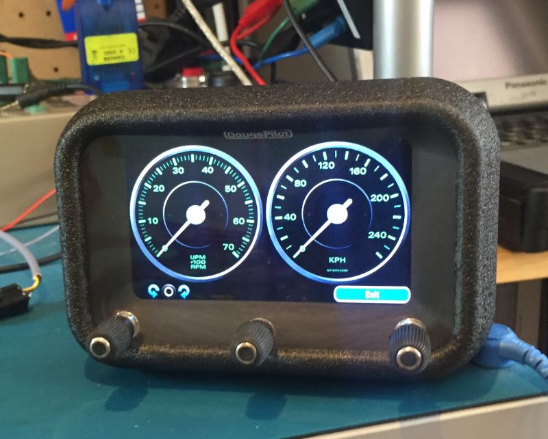

                    For the last 2 years I have been working on a gauge and monitoring system for my 4 cam engine project. Whilst designing the injection manifolds I realised that I would need a way to data-log and also monitor what was going on with the engine when in the car.
                    I would need to monitor oil pressure,oil temperature, ambient temperature, individual cylinder temperature, CHT and EGT all simultaneously in order to prove the cooling system. The option was "gauge fever" on the dash and I didn't want to start drill holes either, but it had to be in the car full time and therefor had to be period looking for a 58 car.
                    Through another Porsche mad car friend Paul Foreman, I got together with 356 enthusiast Simon Hambly, who is an electronics whizz and we pooled our knowledge and resources and created something to do the job. Not just for the 4 cam project but all classic and modified cars.
                    GaugePilot's body is based on the Halda Speedpilot a 50's clockwork computer for average speed. It was of period and the right size to get a good size screen into and a whole load of clever electrical components. It has a 32 channel data-logger, can display up to 25 gauges and you can set alarm points to be informed of danger against the key parameters i.e. CHT and oil temp etc . It has hour run meters and component service tracking, plus stopwatches and rally computers for competition use. It can interface with ECU's for aftermarket fuel injection and ignition systems and works 6V and 12 volt positive and negative earth.
                    I have attached a photo of a unit running 356 styled gauges for that little extra. Now I have the monitoring device sussed, I have no excuse and better get back to getting the engine finished, I've missed my Speedster, but creating this instrument has been good fun and lets hope it catches on. www.gaugepilot.uk

                        That is really cool Nigel! Does the speedometer run by GPS?
                        • #42

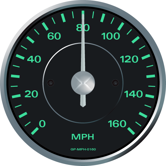

                          Hi Justin
                          Thank you for your positive feedback, yes the GaugePilot can work on GPS or from a wheel or speedometer cable pulse sensor.
                          The GPS we use is a GNSS device that connects to American GPS, Russian GLONASS and Chinese BeiDOU satellites simultaneously to give better receiver sensitivity and the ability to work in harsh Rf environments such as canyons and cities.
                          We have two inputs for speed and distance, this is important for rallying because quite often wheel probes get knocked off this allows the crew to just select an already installed second sensor.
