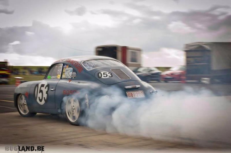

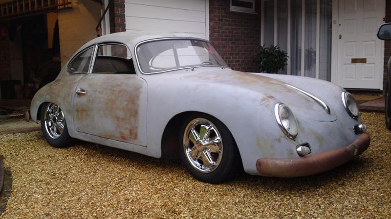

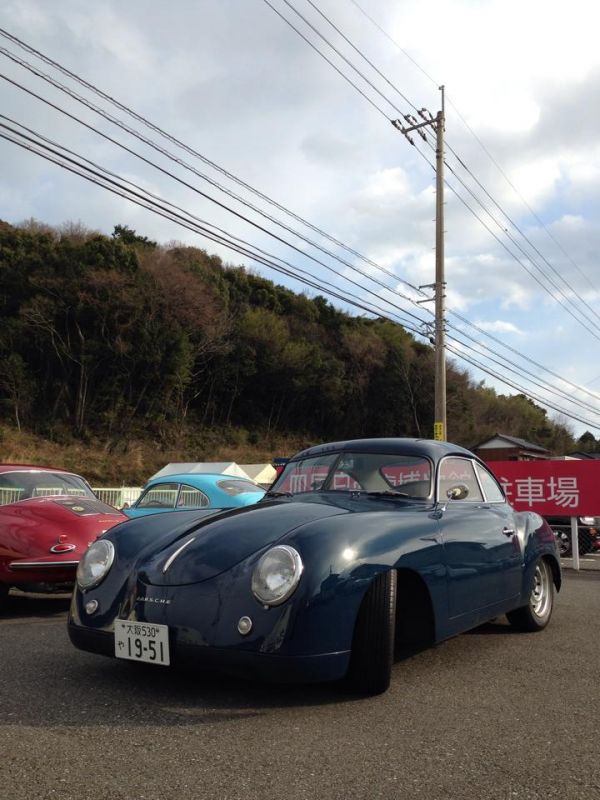

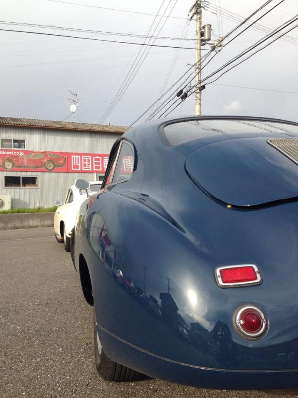

    Did you "pie cut" the rear fenders to fit those 16x7's? If so, do you have any pics of the car after the mod was finished?
    • My Pleasure Brian!
      Yes, the rear was pie-cut to make way for these wheels. You can see the filler strip between the taillights in the last photo. This car also has late model 911 SC rear torsion tube and alloy trailing arms so widening the rear skin was unavoidable. The car is not done and these are my best mock-up photos of the eventual conversion. If I did not say it before: Welcome to our forum and thanks for being part of it. If you're working on a car please share your build with us! Justin

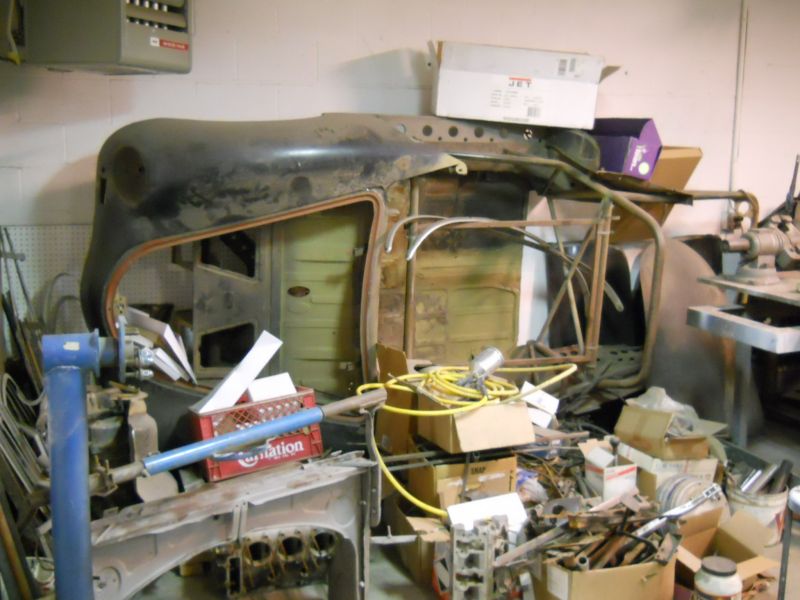

              Here is the build thread to it: http://www.abcgt.com/forum/6-Hot-Rod--Modified-356/23-HotRod-Coupster-57976-coupe-into-full-speedster.html
              I have a lot more old photos I need to digitize to update the thread; I've added it to the list.
              As of tonight its on its side against my wall behind a lot of my junk until I get my coupe finished.

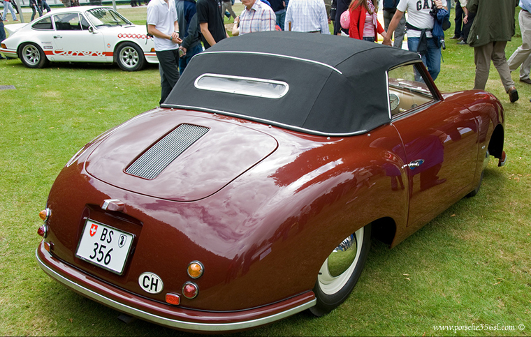

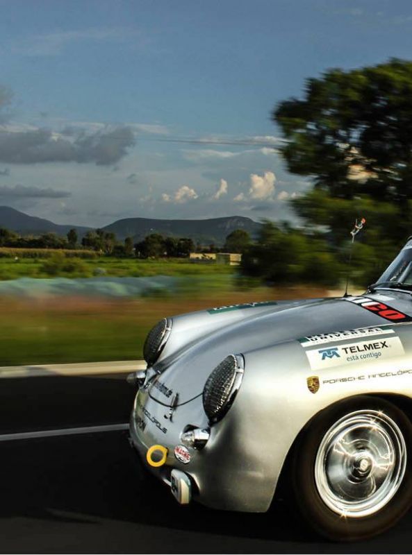

                      • Originally posted by 356" post=17288
                        Interesting quarter panel treatment. Reminiscent of the original Beutler cabs

                        • Nice catch on that one Jack! I think you're absolutely correct that Beutler was their inspiration. Justin
