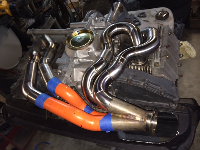

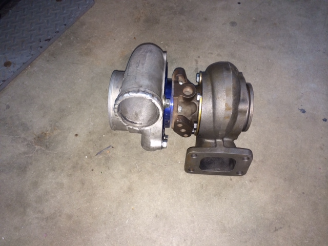

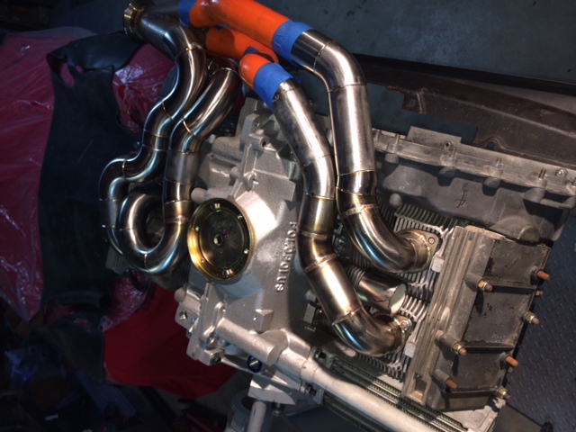

                    • #40
                      Got a few cool shots from Dean a few days ago.
                      Dean is currently installing a Turbo charger on a customers existing Polo motor that was in his Black A coupe.
                      For the design of the system he's working with a tuner that specializes in turbo charging Honda motors.
                      He's shooting for 300+ HP!
                      I've asked Dean to keep me posted.
