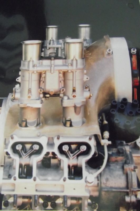

      Here's a photo Dean sent me a while back of one of his engines with some experimental heads a guy in Canada had built for him. They are 4-valve per cylinder heads. Dean said they flowed like crazy and made gobbs of horsepower but for whatever reason the motor ran HOT. They tried everything they could think of but could not keep the oil temp from soaring. When I went for that visit to his shop they were already shelved. He did say he would give it another try at some point. Very trick looking though.

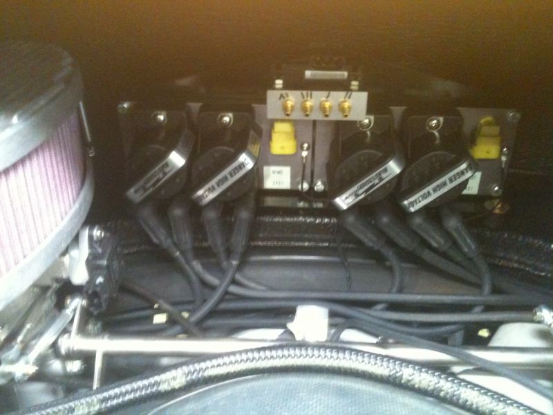

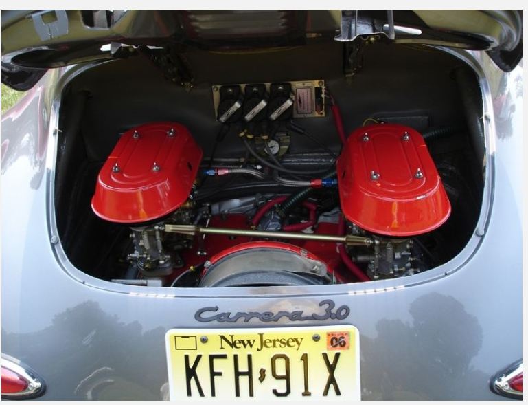

                Hi Justin I found this 356 engine picture
                Is it a Polopolus or a straight 991 6 cylinders ?
                Have you see this car yet ?
                  It appears to be a single plug 6. It has 3 coil packs, my POLO has 4 coil packs as it has 8 spark plugs.

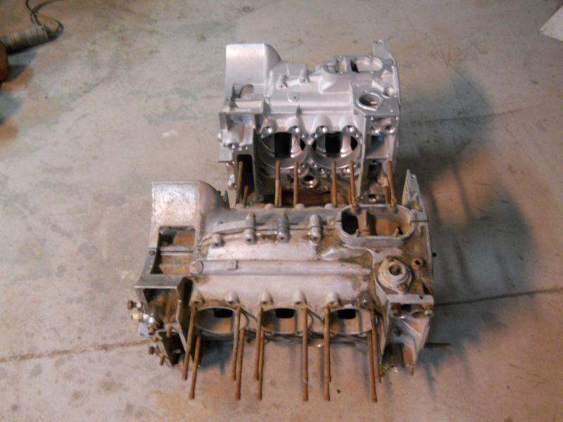

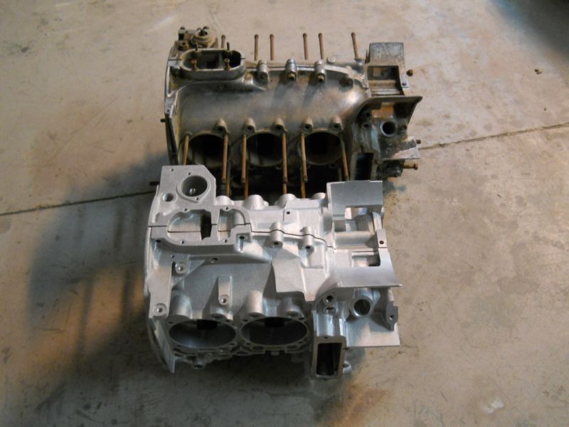

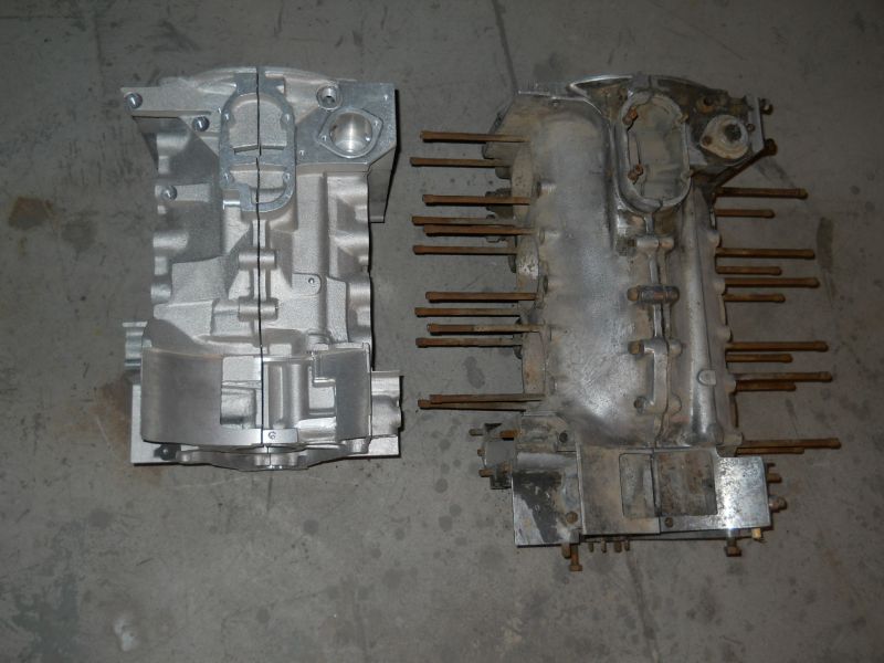

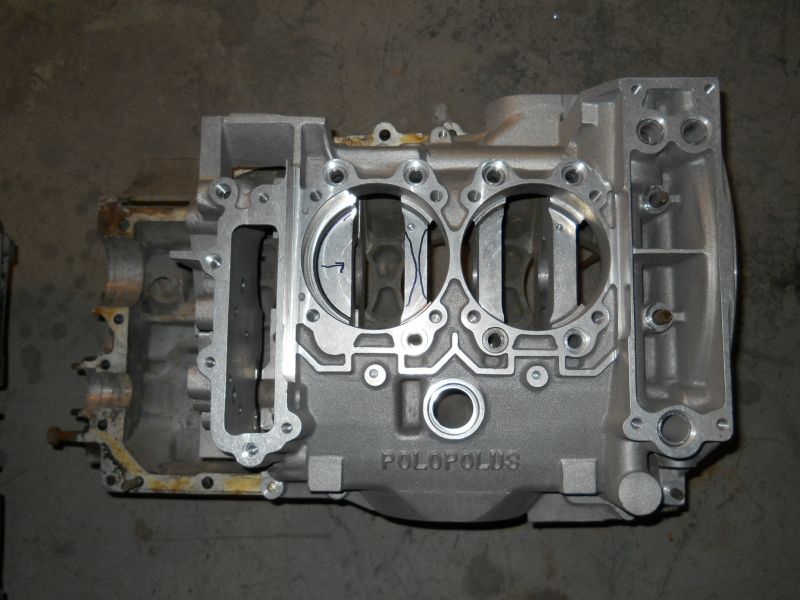

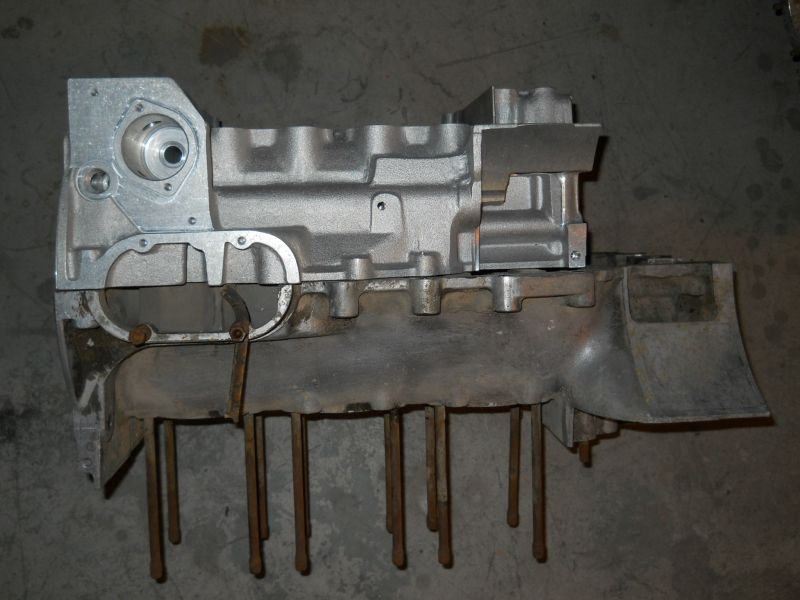

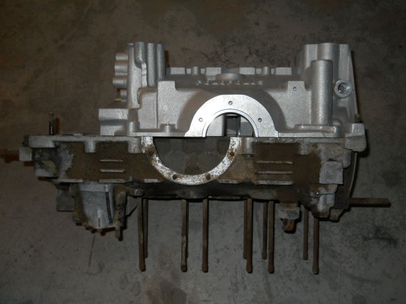

                        Well we know the Polopolus motor is obviously shorter and lighter than a regular 911 motor but I have yet to see a direct comparison to put it into perspective. After getting my fathers 2 liter 911 engine block back to my shop I was interesting in seeing a comparison and I thought you might be too. Here are some shots.

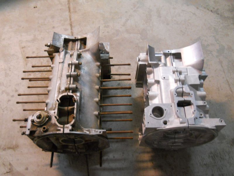

                          Now for a real comparison:

                          A lot of weight and more importantly a lot less leverage and mass hanging off the end of the trans. Just the right sized motor for a little 356...
                          Thanks for looking! Justin

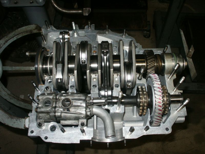

                            Gee, any chance for some shots of the Polo motor from the inside?
                            Maybe with notes?
                            Thanks in advance.
                              Here's one from back on page one of this thread SJ. Uses all basic 911 parts. Again it's advantage over all other VW or Porsche 4 cylinder engines push-rod or 4-cam is the extra crank support just like its 911 counterpart.
