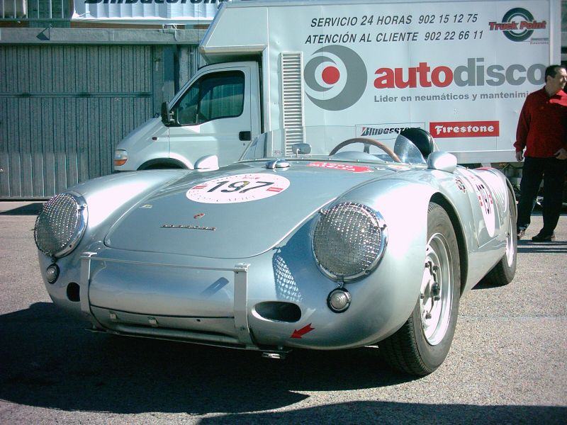

  • If you have the spyder as 550-0017, it is incorrect as it is a 550A (I am not sure how many came in white besides 550A-0132). Is it possible that it is Betty Shutes - I know she always drove under #193, but based on the time she bought the car, it would have been a 550A

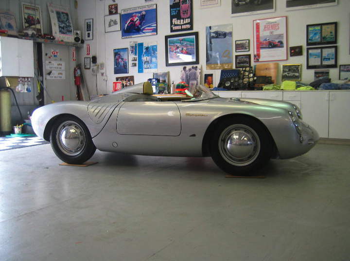

                • ... what, like these 550As...?
                  • Hi Andrew.
                    Both cars on your photos have the fender lid.
                    Both have the long nose.
                    The second one has definitely not the big oval fender mirror but the more angular version.
                    www.breuer.shop
                    • They are both 550As, which I believe is the same as #280. The side mirrors were changed by the owners to get better vision for racing. The standard mirror for the RS550 was small too. Many like this 550A had their mirrors changed

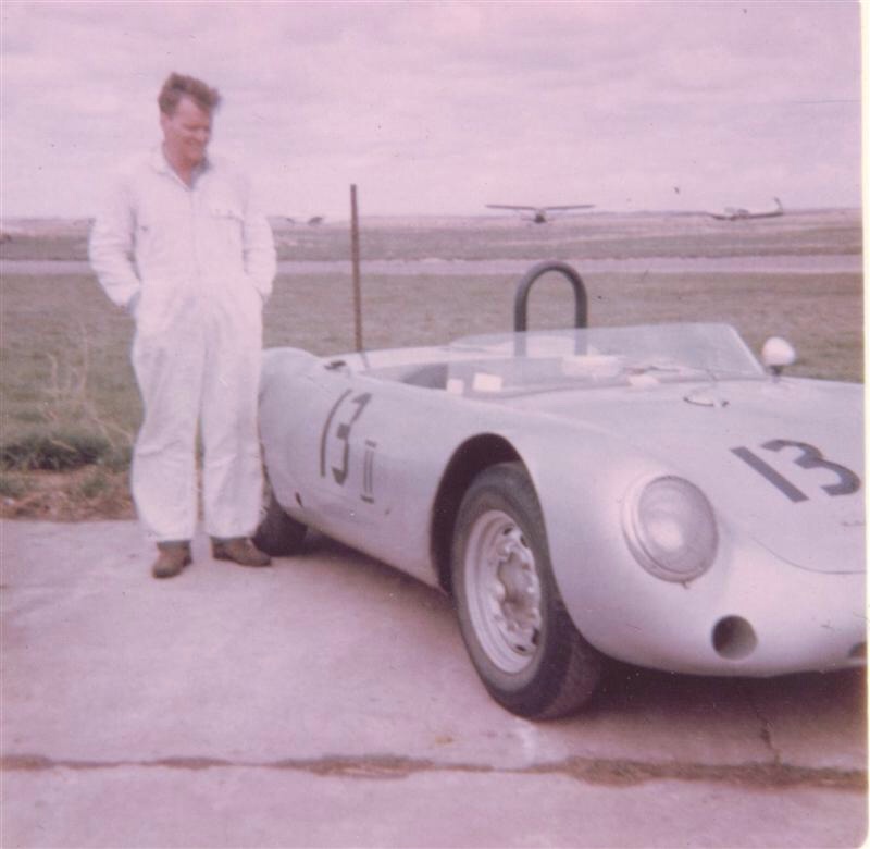

                                Thanks for posting this one Chad. What Chassis # is this spyder? It looks a bit odd to me. Sort of too long, the deck is very flat and has the feel of being an RS60 with a 550 nose?? Any info on this one guys?
