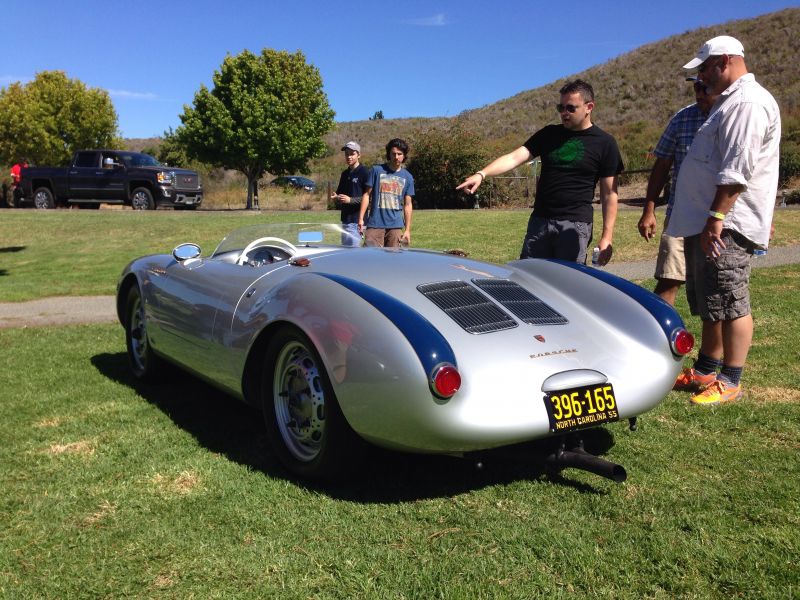

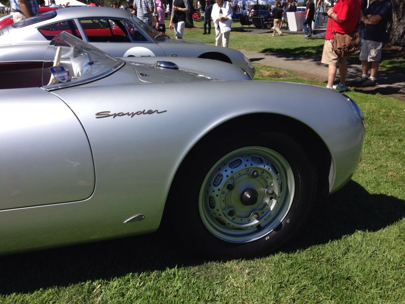

          • 550-073 at Werks Reunion 2015.

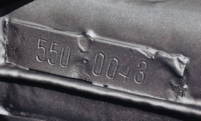

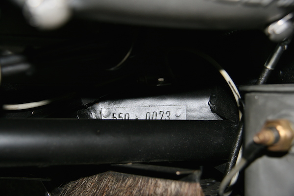

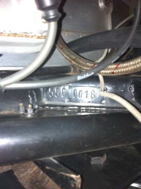

            • You are correct Justin (and yes, the file name was a giveaway!) I thought it would be a no-brainer for this forum. The tell tale signs are the welds and how it distorts the plate when fixed and also the condensed font used to stamp the numbers used by Porsche/Wendler. You can see a different font for the fake one. You do wonder why they go to so much effort to create a fake and the first thing you would check are the plates!

                    • Early frames (and frame plates) were not made by Wendler. And, the frame numbers are generally off by two as it relates to the car number----see book.

                          • re frame/other plates----
                            My bad. It is the Wendler plate that is off by two generally until late 30s early 40s...not the frame plate.
