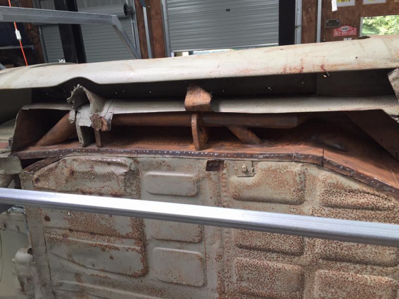

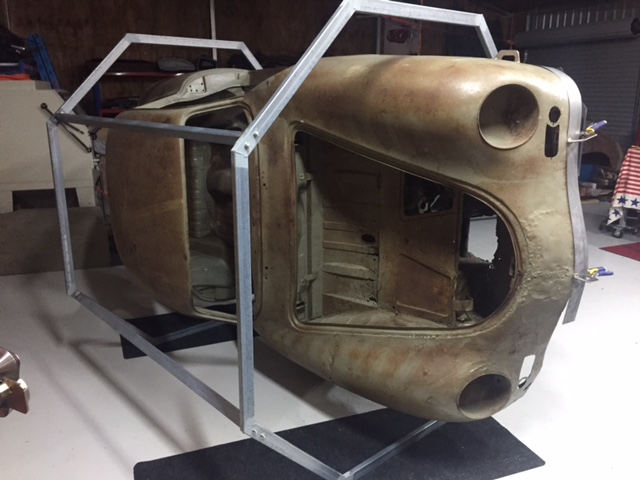

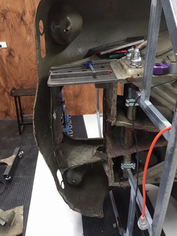

    • #32
      Looks like you're ready to start cuttin'. I see a little development time invested there shrinking and stretching that lower flange run for your body bumper conversion. Thanks for the update.

            • #36

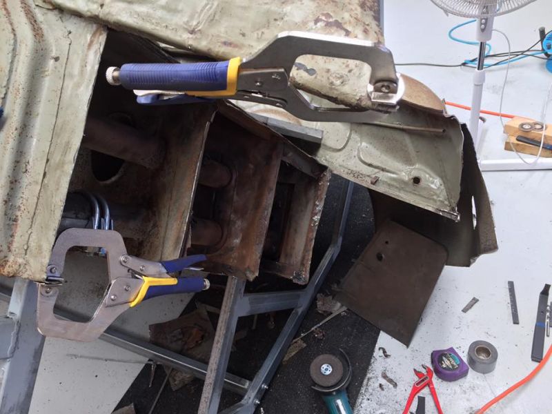

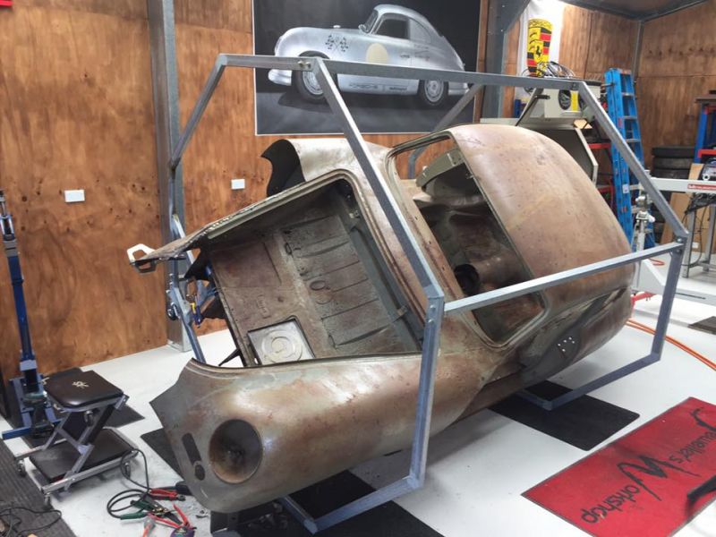

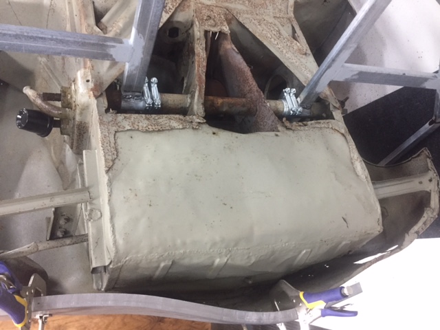

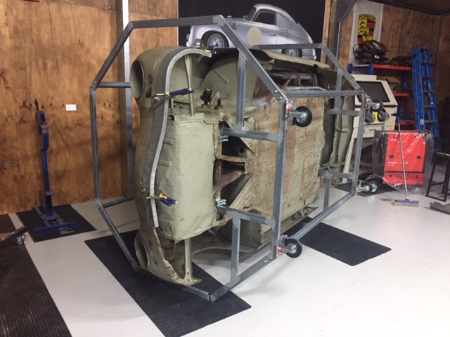

              started cutting still a lot of work needed.. un-stiching all the spot welds so the panels fit right

              • #37

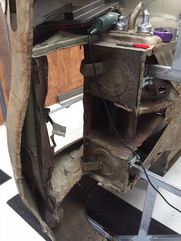

                • #38
                  Nice start Florian. A lot of old crash damage to cut past it seems. The floors strike me as being original, Are they??
                  Keep up the great progress!
                  • #39
                    yes the floor and all the pats except roof dash are original.. Floor is in great shape some dents very little rust.. tubes are in fantastic shape..
