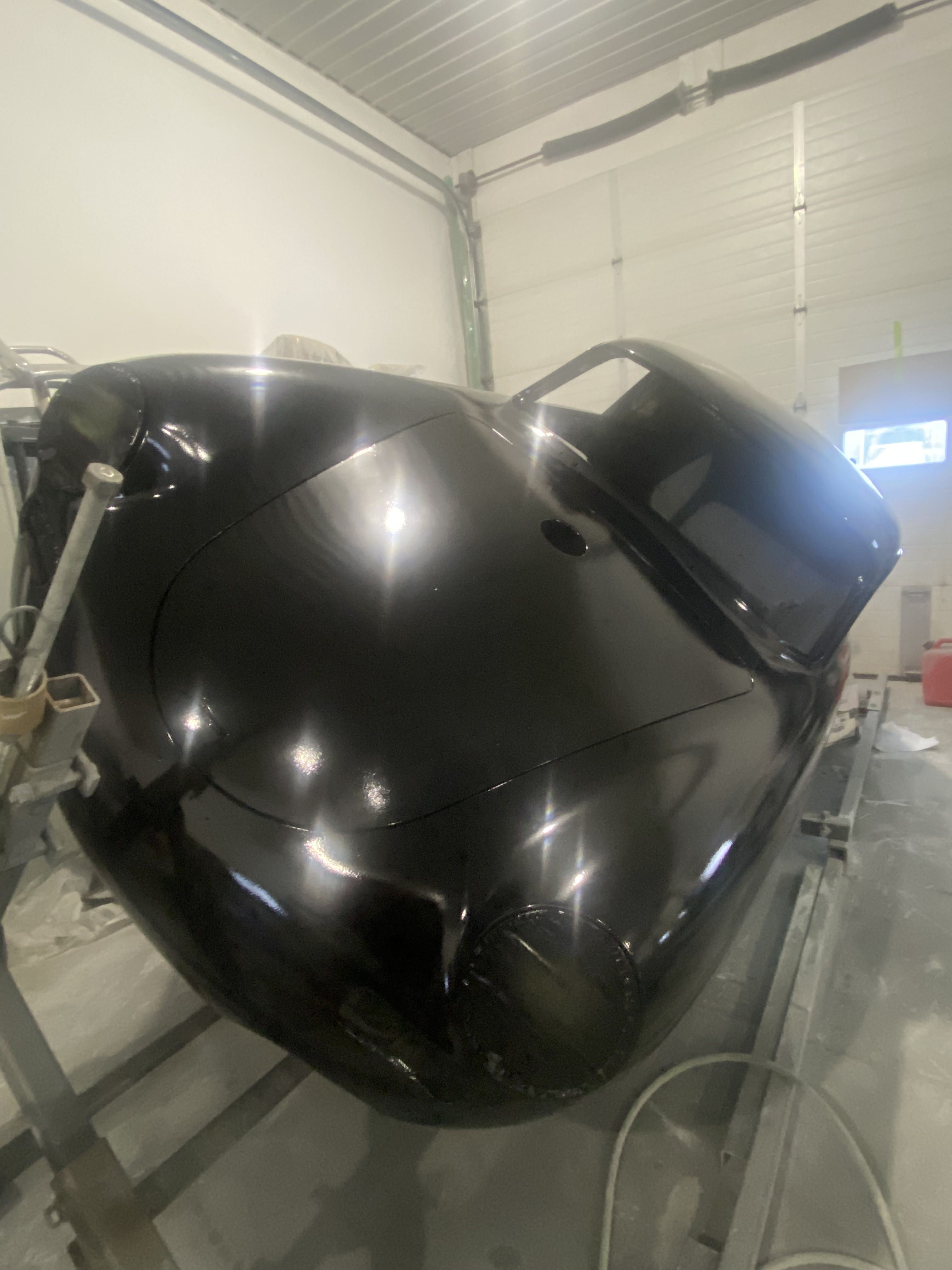

  • Car now resprayed with high build epoxy. Letting it cure a shrink for a few weeks. Click image for larger version

    356 Registry main thread;
      Looks great Scott! Liking that reflection across the door gaps and the clean finish down through the rocker. Gentle curve but not too much nor too flat. Your buddy knows what he's doing. The way the reflection terminates around the wheel opening edges is another critical one. These body's are not easy to get right and clean. I can fully appreciate all the hours of long boarding here.
  • Thanks Justin. Dave is taking his time and fussing on the details. We are Finding minor issues with the front nose I replaced in the front hood valley and lower front edge. Not as symmetrical as I thought in the metal work stage. He says it has been a challenge but feels he is winning. The rear sail panel leading up to the roof also fought him hard.

        • With final high build in grey Dave has now been wet sanding to 600 grit to fill in the 120 grit scratches in the black primer. Reducing material and not hitting metal just black primer underneath. Goal is perfect straightness while leaving as little material as possible. Cowl to hood to fender transitions are tricky to get right. Had to prime three times on top of current build to resolve slight issues that were revealed by check wet reflections. Also finally settled on mirror position on the fenders lined up with hood shape and then marked a body line from the headlight to the tail so mirrors installed on the apex of the line. I like where they have landed and look awesome hanging out on an angle a little outboard - from my perspective. Pics to large will try reducing.
