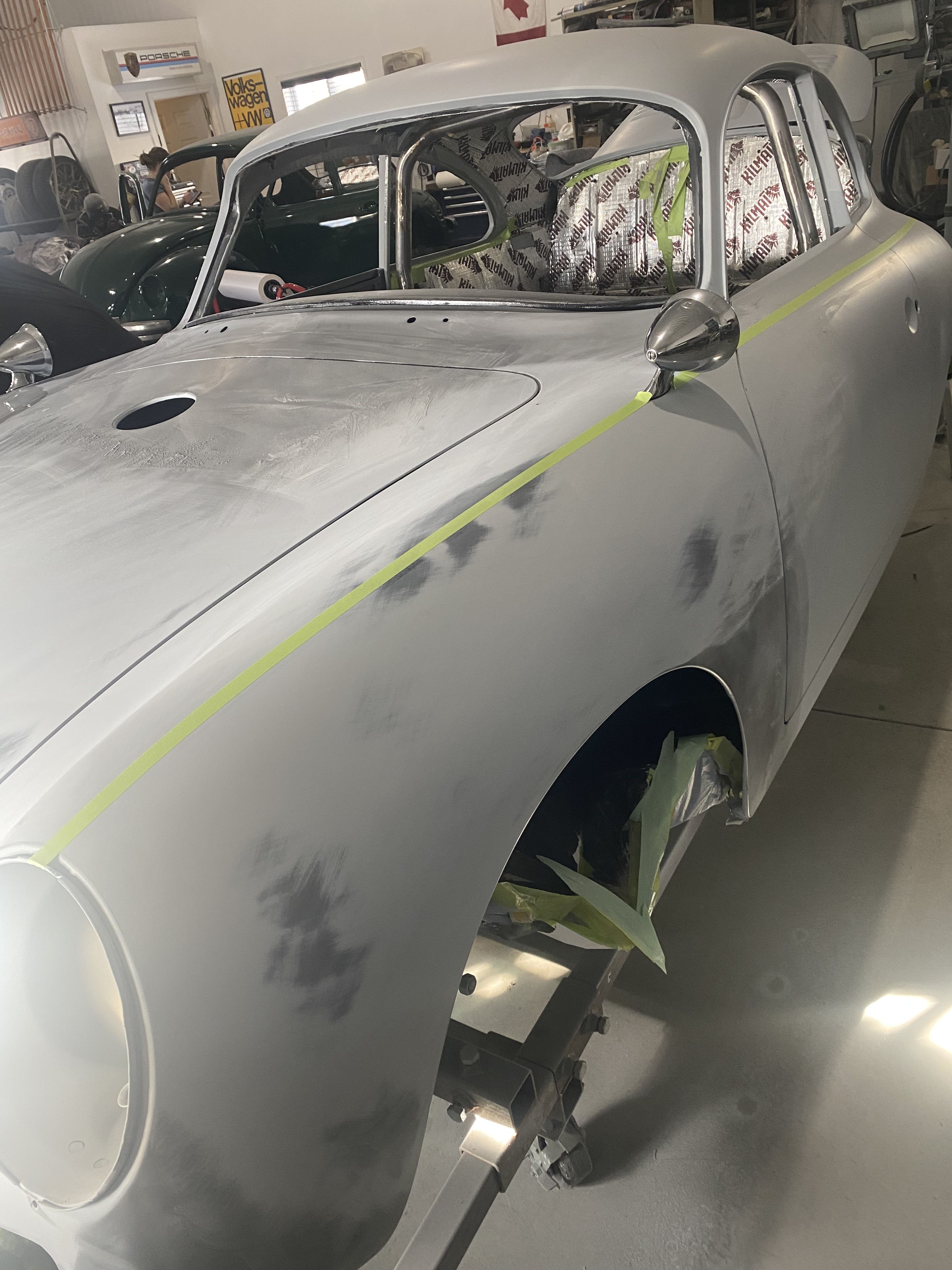

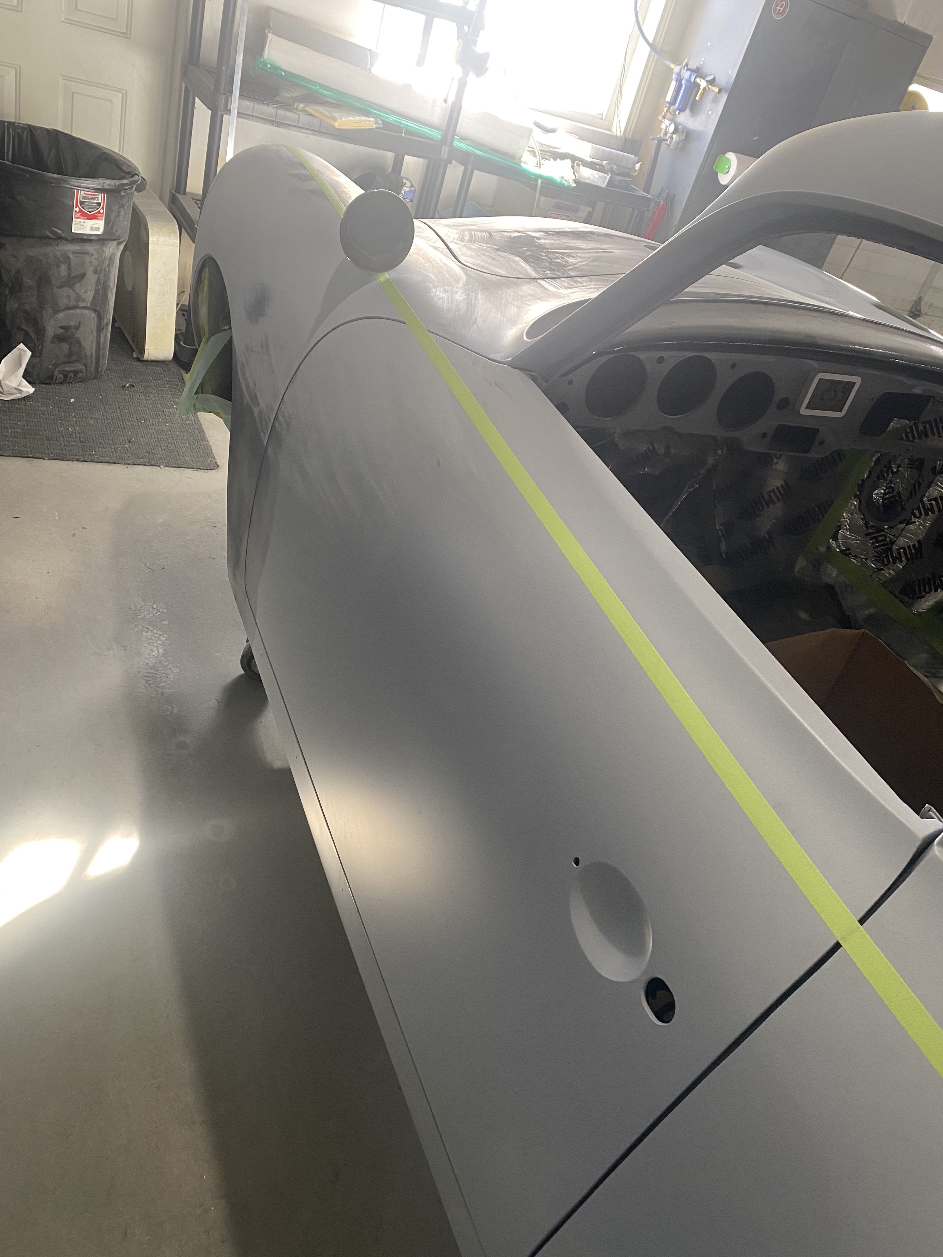

  • Work continues on getting everything straight. Most of Click image for larger version
ID:	116197 Click image for larger version
ID:	116198 Click image for larger version
ID:	116199 Click image for larger version
ID:	116200 the car is now at 120 grit and starting to see some correct reflections
    356 Registry main thread;
      Looking good Scott. I know that stage well. Blocking and obsessing over any slight wave or irregularity as the reflection moves down the side of the car.
