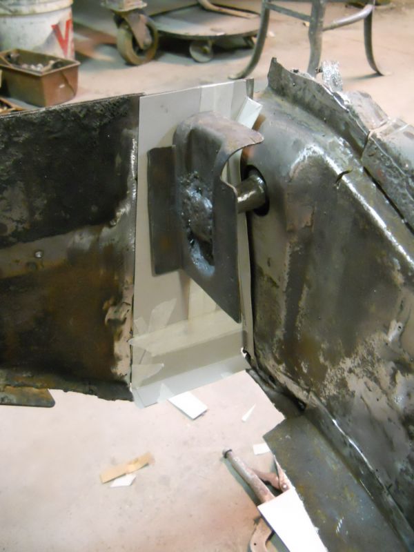

      Mine were rusted out also and I had to replicate the parts that I couldn't save. If your whole area is bad off then make a template of what you have left and make a new piece out of 14 gauge metal. Make it in 2 parts to go around the central mounting pin then punch a bunch of holes for rosette welds. The hardest part will be bending the edges up as the metal is pretty thick.
        Phil and Roy the part you mention is the bump stop. The part I'm after is the shock absorber mount. I'm going to slide by restoration design tomorrow and check but I'm pretty sure mike Delong said he does not make the part.
        I'm convinced it needs to be made by hand again with a little heat and mechanical help. I plan on removing the absorber bolt so the part can be made hole and a hole drilled later to insert the bolt, given the compound curves it may be best to make in two parts.
        356 Registry main thread;
          Resto Design calls it the shock mount. Go figure.

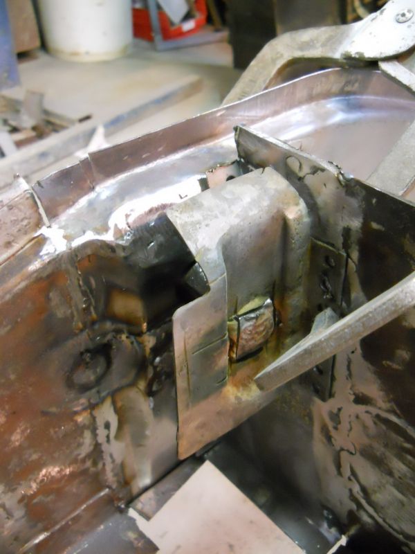

            Not sure how deep into the chassis on the other side of this plate you have gotten but
            there is another heavy gauge internal plate that ties into the cross-member and the top and sides of the frame runner closing panel.

            As you can see the tip of the shock mount ties into the center of it creating a double shear. I had to cut this one free to repair some rot it had. If your outer plate is that bad you better have a look at this anchor point too. The one above is an "A" version but I have to believe B/C's will be very similar.

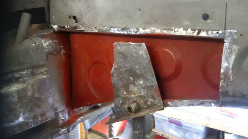

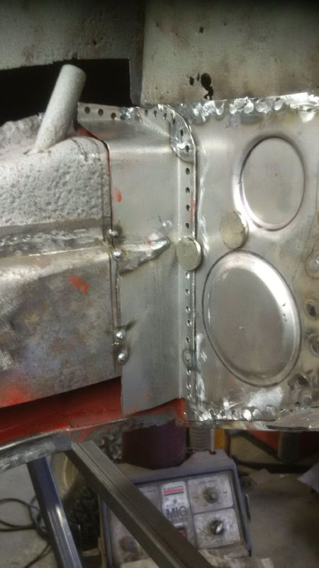

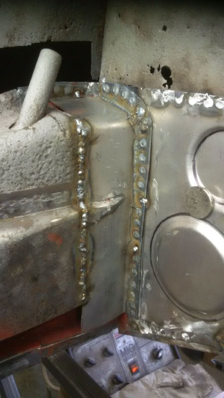

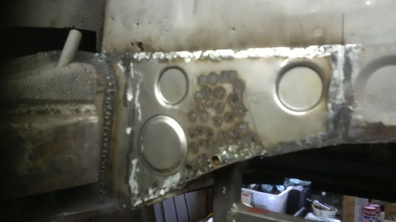

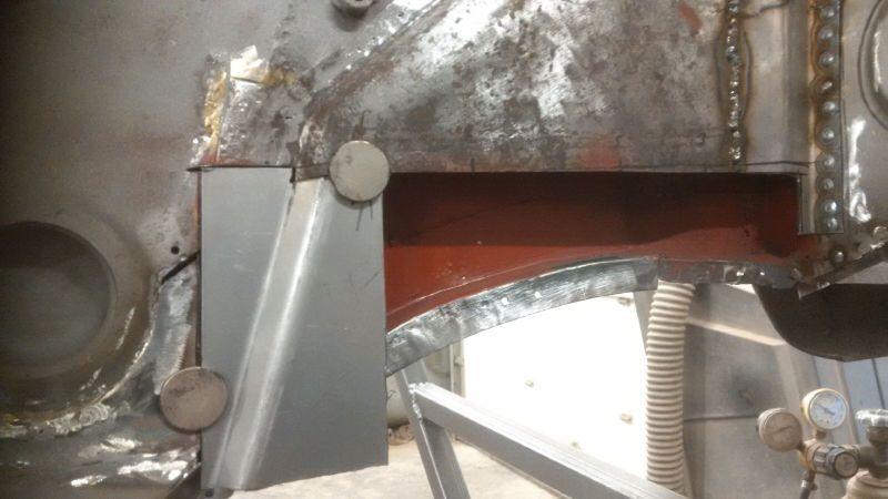

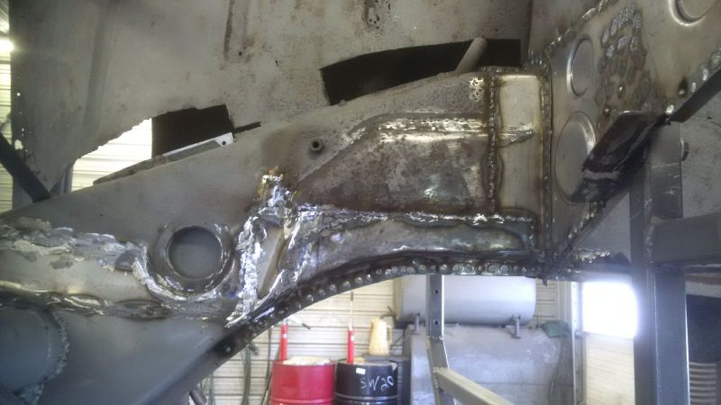

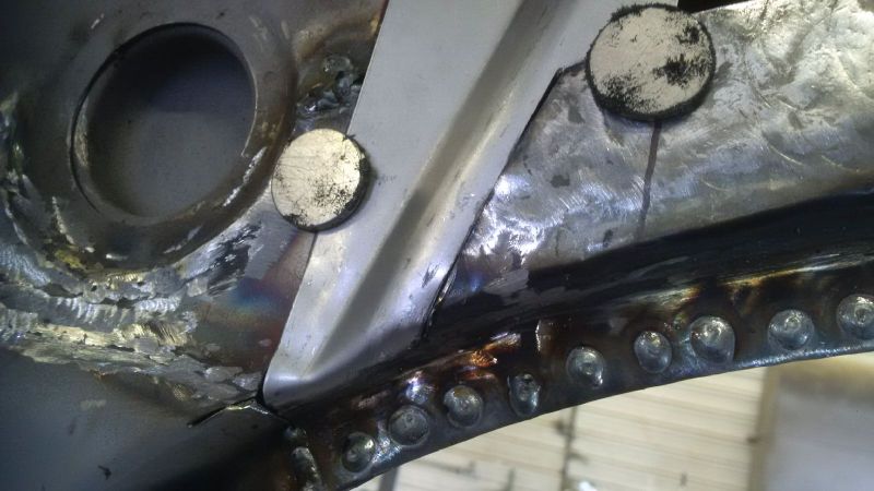

              made a little progress this weekend. passenger side transmission cross-member piece is complete. The drivers side is worse but I now have templates and a good example and knowledge on how to put together so hopefully will go a little quicker.

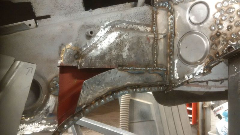

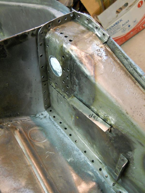

                                I have managed to get the passenger side inner frame rail sewed up. I am frustrated with trying to make as one large piece. It really looks like a patch work quilt doing this is smaller more manageable pieces but tackling one large piece for this area with all the curves and edges is just beyond my limited abilities.
