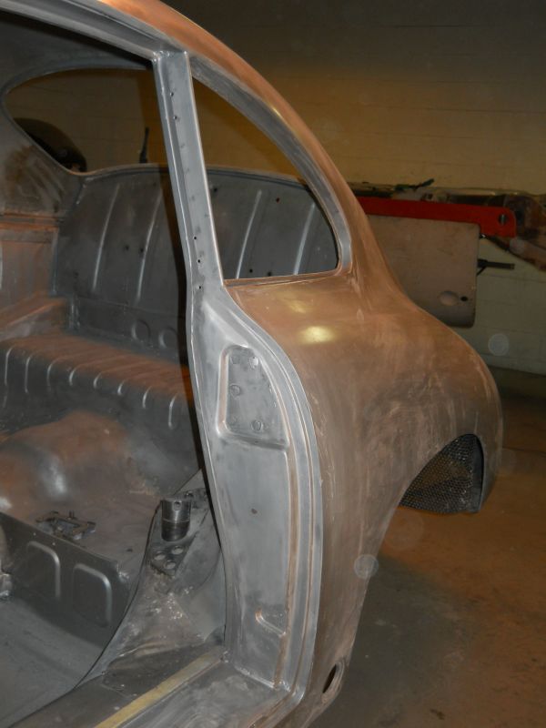

    I'm seeking help on how to finish off the transition from the top of the lock post (B-pillar)to the bottom leading edge of the quarter-window frame. This photo shows the position of the new B-pillar and quarter-panel patch.

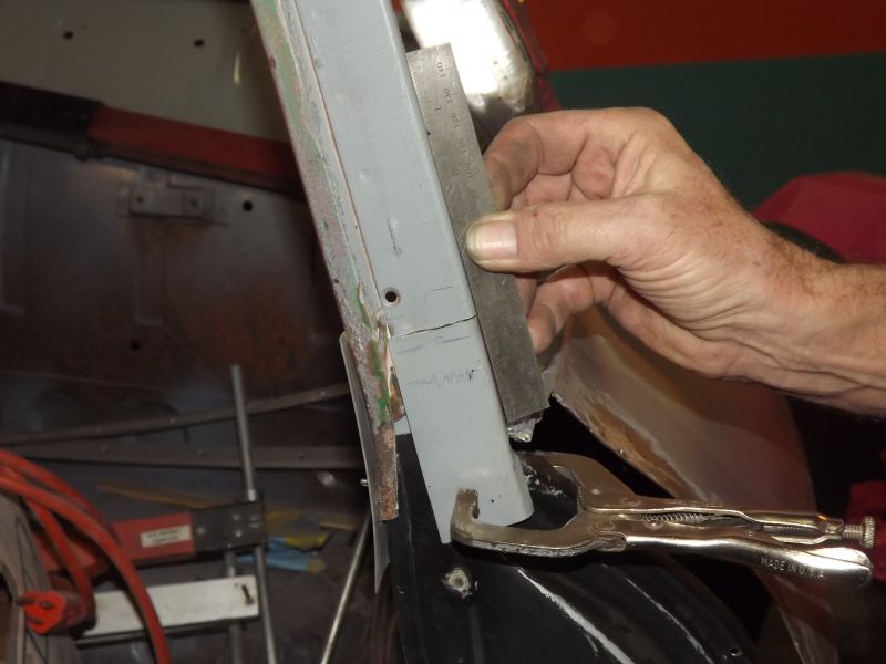

    Outside fabricated panel piece nearly ready to be tack welded.

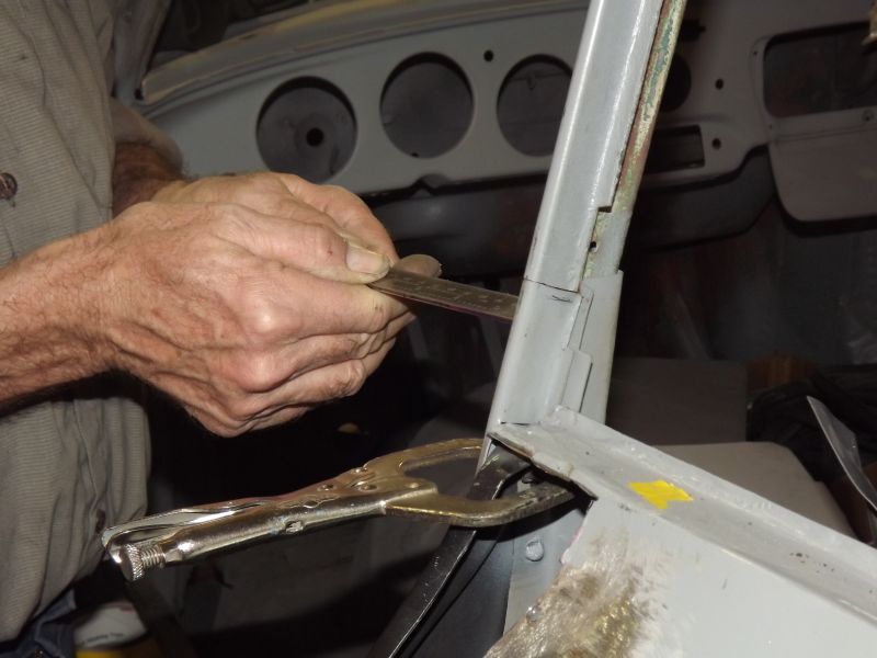

    Outside and inside fabricated panel pieces.
    If the door latches well, you appear to be just right. The cut-through of your overlaps will work for butting the pieces and parts but will still require filling and likely underside trimming up at the corner.
    Other than some drilling and forming the little outward horizontal step at the base of the B pillar that will match the rear top corner of the door and the 'by eye' creation of the steps as they flare up toward that step as they shallow and join into the flat toward the pillar...you are good to go from what I see in the pictures.
      Just for fun, fit the door and door seal to see if its gonna work to avoid heartache later. Be sure to jamb a bunch of tape in the seal channel to mimic the upholstery that will be behind the door seal. Bruce addressed this in another thread IIRC.
      Oh, window frame too!

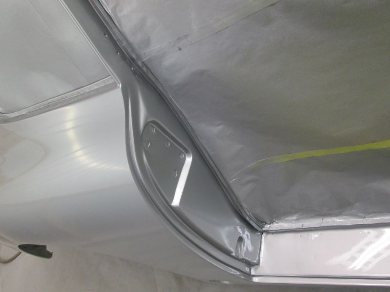

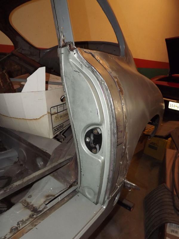

        Here's my coupe. Its a High striker but that transition into the B-pillar will be the same.
