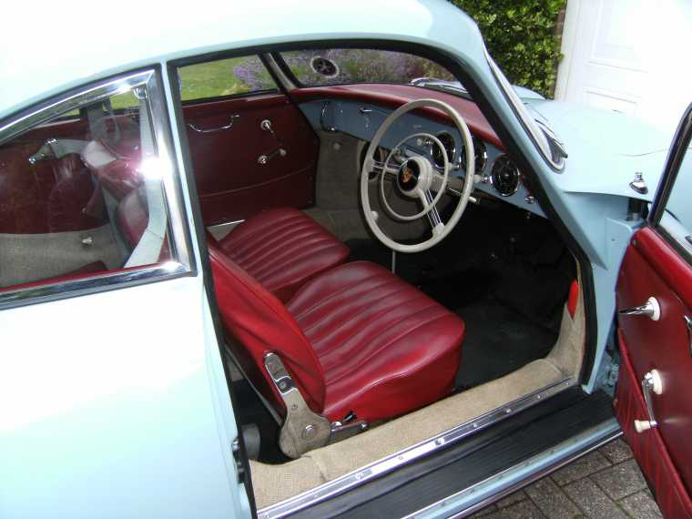

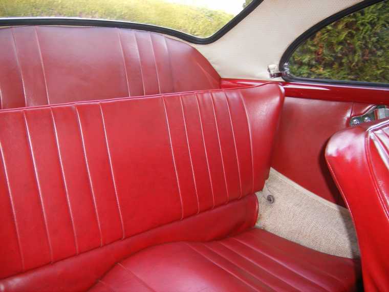

        A pic of the colour match I was so lucky with below. As your car Mic is like mine a 1959 I attach some pics of the still factory original rear seating just in case you might need to see how it compares with yours. I have detailed pics also of the rear seat upright and how it all works should you or others need to know.

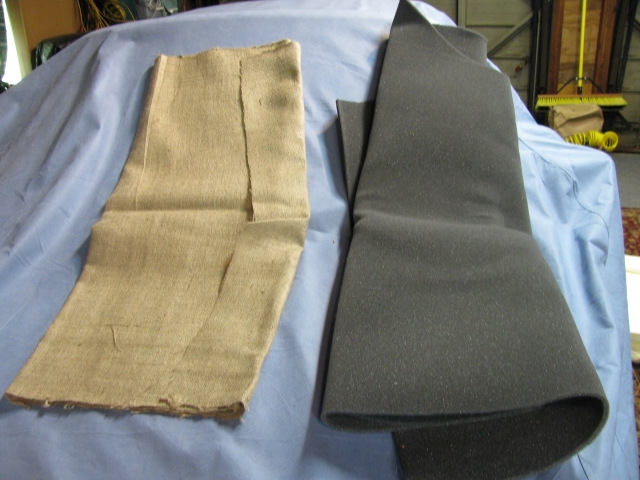

          They also sent me burlap and some foam.
          I think I still have that.

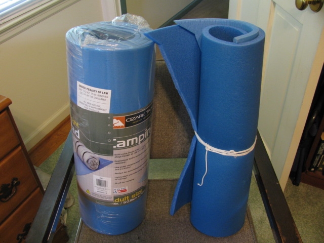

          On my seat bottoms I overlaid the burlap seat bottoms with some pieces of foam that I cut to fit.
          It was the expediant way to go to finish the job and it has worked out.
          I'm sure that I picked it up at a Walmart someplace.

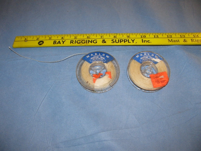

          I have a small sailboat that I occasionally race so I had a bunch of bees waxed whipping line that I used for securing the burlap etc. It lasts a long time on a sail boat exposed to the elements so I figured covered up and in a garage it would last 'MY' lifetime.
          Whipping line.

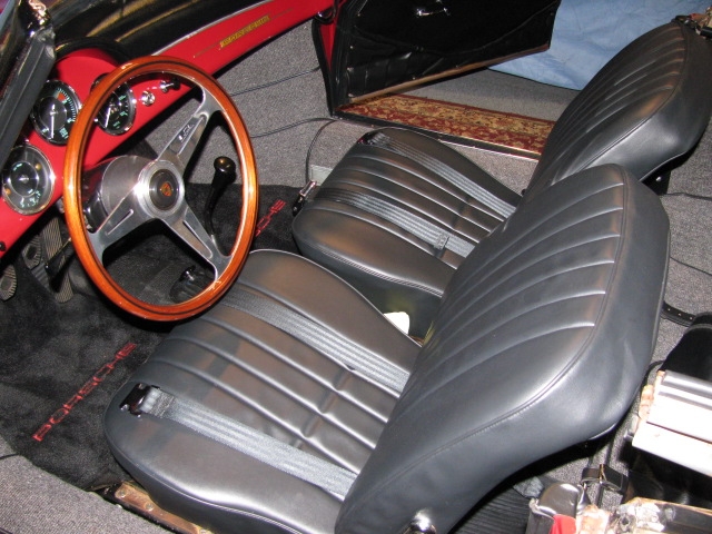

          Finished seats.

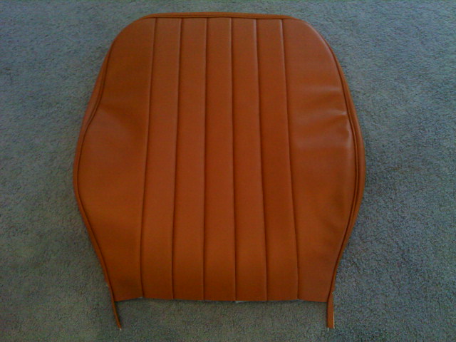

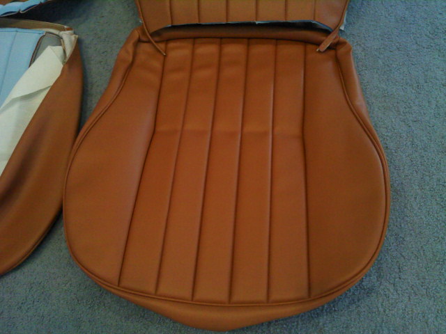

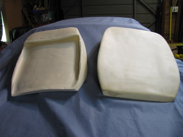

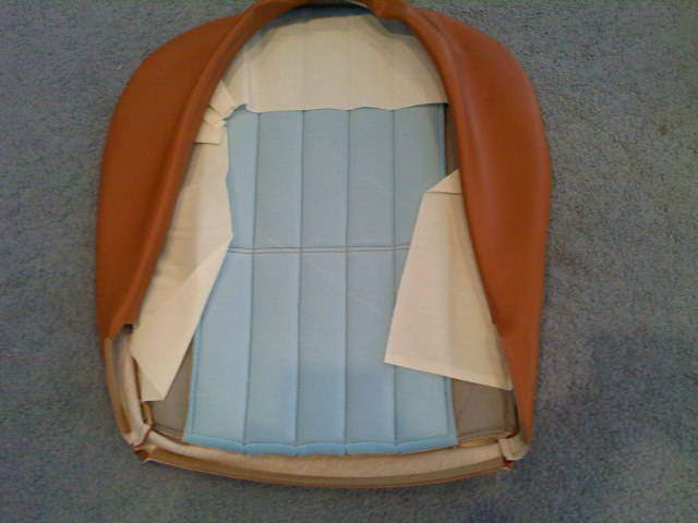

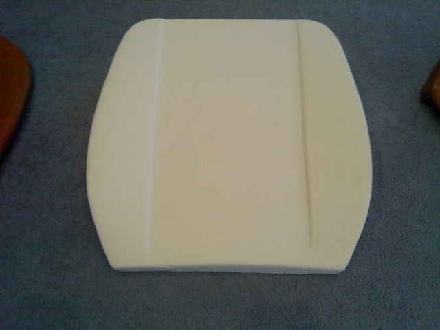

            Update. In looking at my last post here I can't believe it has been 7 weeks. Like everything I thought this would be done by now.

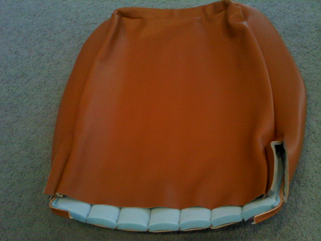

            Yesterday I received my covers from K&H. All looks very nice.
            top of seat bottom
            inside of seat bottom
            front of seat back
            rear of seat back

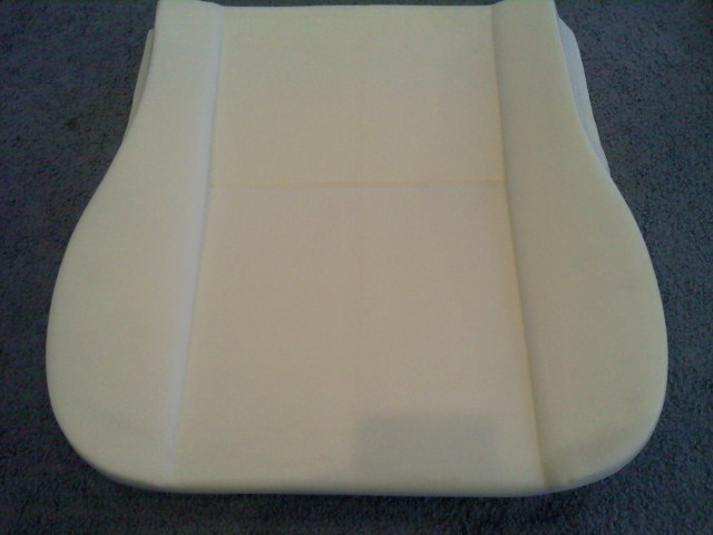

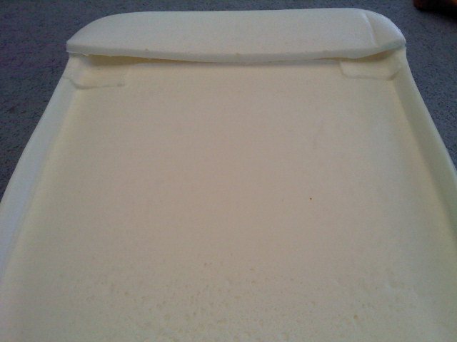

            front of seat back cushion
            rear of seat back cushion
            top of seat bottom cushion

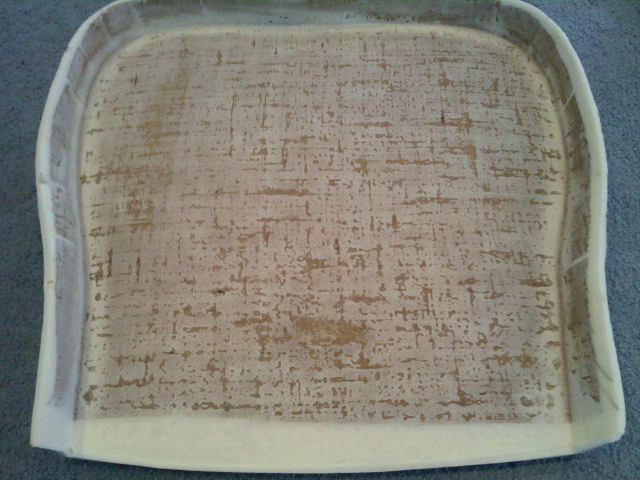

            bottom of seat bottom cushion. This pc. has burlap molded in.
            I have gotten the passenger seat parts painted & will attempt assembly as time permits. The drivers seat is still in the car. One at a time.
            I am most likely going to add some rolled up foam inside a few of the springs. This will be trial & error.
              Dick, I can't believe I never got back to you on the seat cushion offer. When talking to K&H they recommend I buy the cushions in sets (top & bottom) although they would have sold them separately. Being that this is from a different vendor I decided to get them from K&H in case of any discrepancies in molding/pattern etc. Thank you for thinking of me anyway.
              The only thing I question is the lack of a tie down area for the "smile/crease" in the lower seat cover. They have told me that since it is molded in it is fine. You can see it in the first picture.
                Hey Mic,
                Not to worry about the smile/crease area. They do not have to be tied down since they are molded in that way. At least that is the approach that I took. Good idea on sticking with the same vendor.

                          • #28

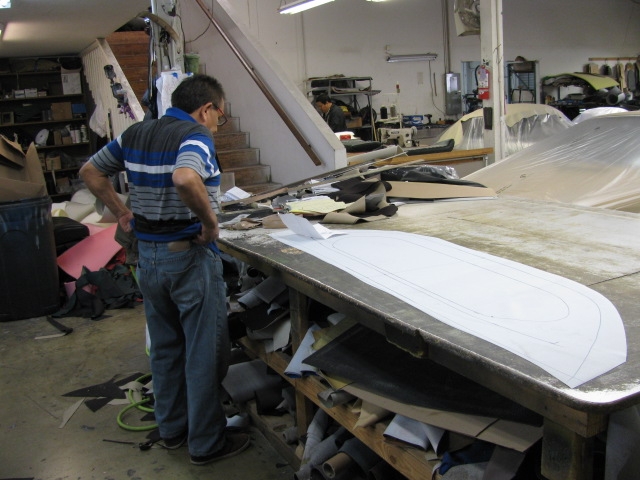

                            Hey MIC,
                            I perhaps incorrectly said that the creases in the seats do not have to be tied down.
                            I did not tie mine down.

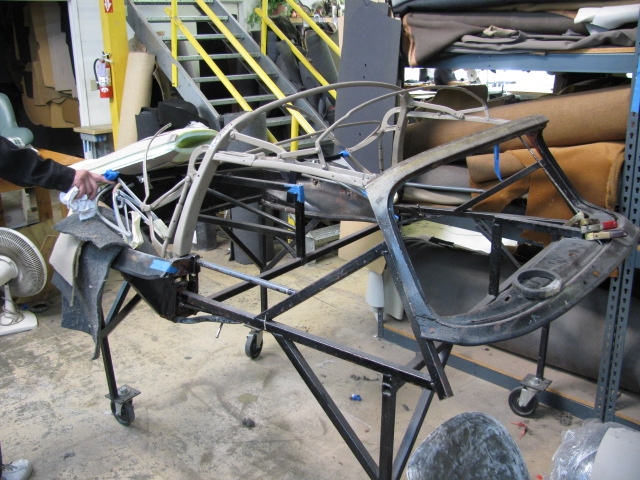

                            When I was on the West Coast last week I asked Agustin about that at Autos International.
                            He said that they do tie the creases in and that accentuates them more.
                            It was a very informative trip watching the pros do their professional magic and meet the folks who did my tonneau, boot and seat covers.
                            I'll attach a few pics from the trip.
                            Rafael Gonzalez working on Roadster top-rear window

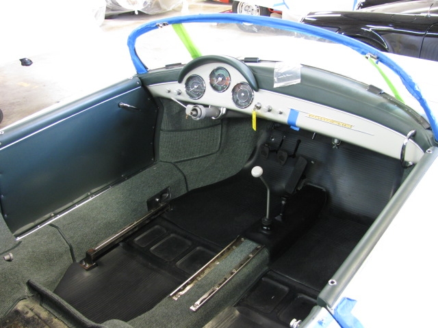

                            Speedster Interior
                            Top Jig
                            Rafael doing zippered rear window
                            Carolina, Me, Karen and Agustin Vidaurri-owner of AI.
                            They gave me a great reception and ley us roam the shop.
                            Lots going on!
                            • #29
                              Sorry guys I have no update on the seats. Work/family is getting in the way. Hopefully soon. I want to wait until I have some uninterrupted time instead of trying to rush it or doing a few minutes at a time.
                              The new covers are vinyl which was originally in my car.
                              I'm going to take a closer look at the covers tonight in regards to tying the bottom cover. I don't think there is any thing to even attach something to but I'll see. I just don't want to have to do it again. I know I should just do it & not worry about it. It's got to be better than it was.

                              • #30
                                MIC,
                                I couldn't find anything to tie the crease to either.
                                Maybe thats why I didn't tie mine!
                                Good luck and good idea-take your time!
