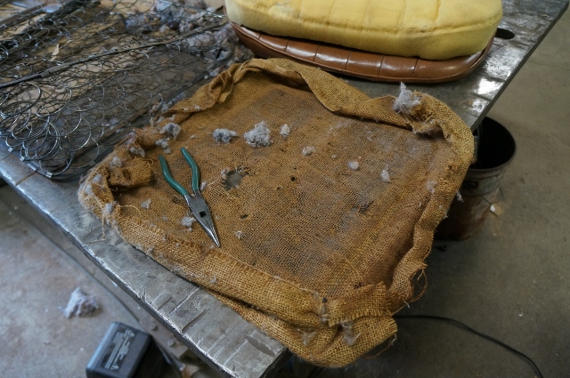

                    Had some time today so I disassembled my passenger seat. I have never done this before so I don't know what is correct or not. It looks like the seat back was never touched but the base had foam added to it at some point.

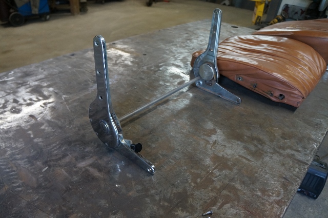

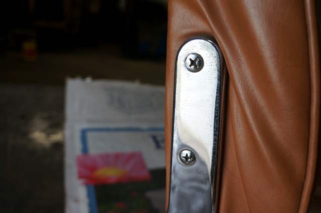

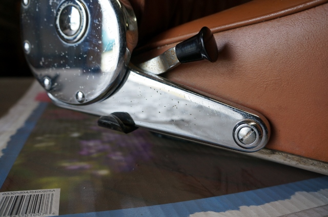

                    First I removed the two hinge screws from the seat base. Slightly "pried" the hinges to separate the top & bottom.
                    Note non metallic spacer between hinge & seat base.
                    Removed six screws that hold hinges to seat back.

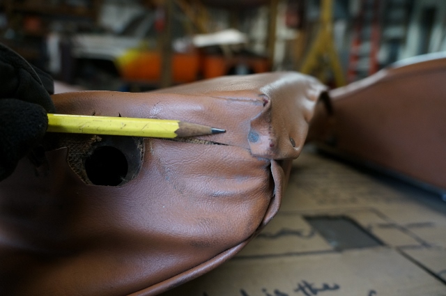

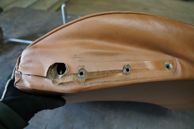

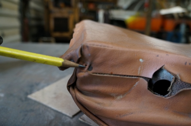

                      Note upholstery was cut under hinges. Factory or not, I don't know.

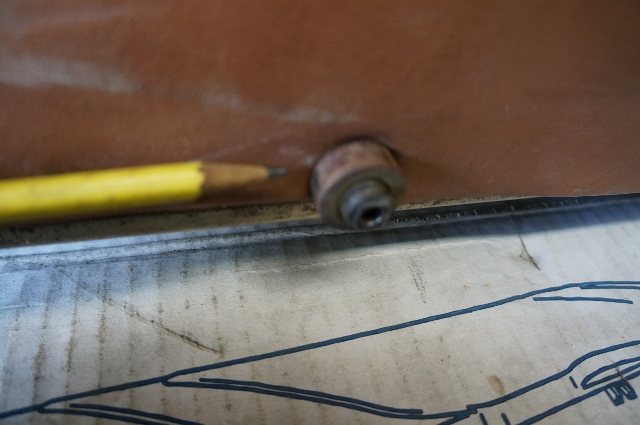

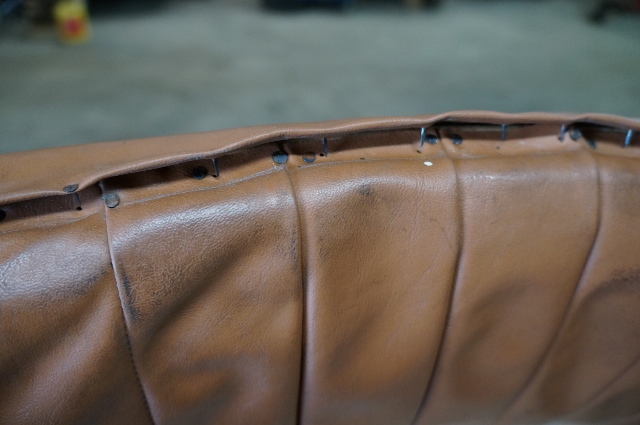

                      Next I removed the nails hold on the upholstery to the seat back. Order of removal was rear, front & sides. I was able to use a small straight bladed screwdriver under the vinyl & nail to gently pry them up/out.
                      So it seems that the sides are nailed first, then the front is rolled under & nailed with the rear being the last part to be nailed.
                        Then the vinyl slides off. Now I have the horse hair which was nailed a few times at the bottom front & one hog ring at the top back.

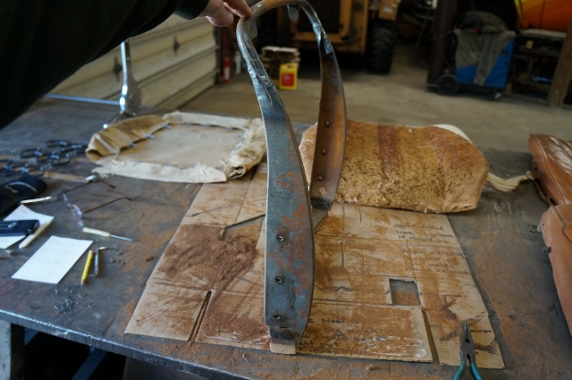

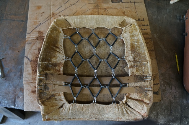

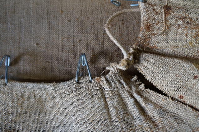

                        Removed the belts & bands.

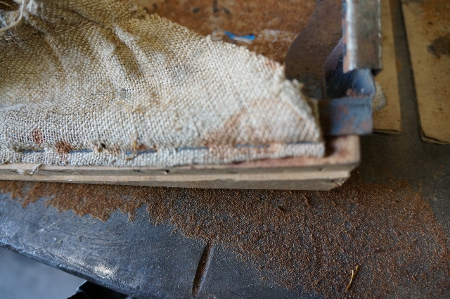

                        Removed the burlap.
                        The metal frame was in good shape other than being about 3/4" out of square when measuring corner to corner. Easily tweaked back into square. This photo makes it look twisted but it does sit flat on the table.

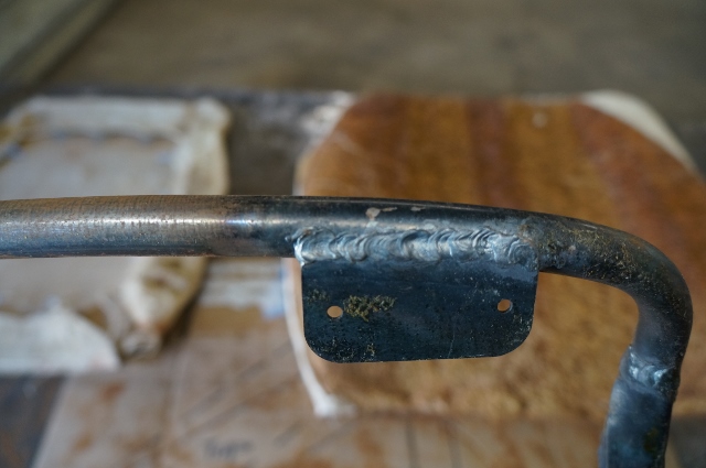

                        Two tabs that I assume are for headrests? Nothing was attached to them on my seats.

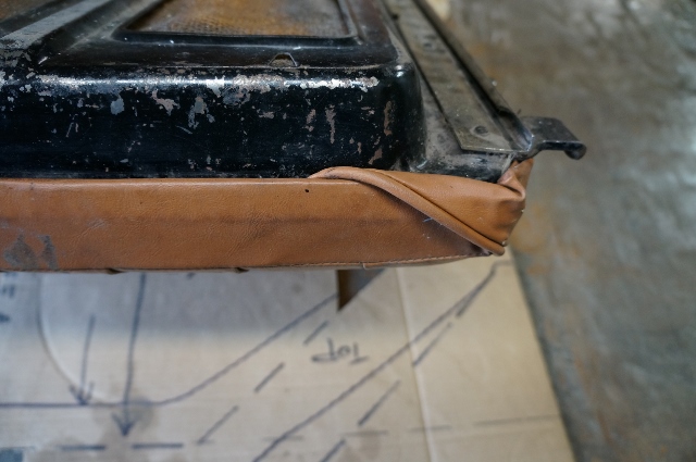

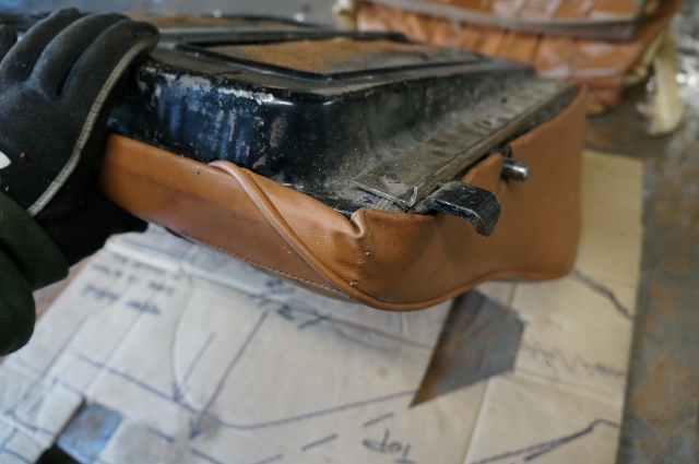

                          Bottoms, Inserted screwdriver to "open" the channel where the vinyl slides into. Pushed down on the seat to remove vinyl from channel & removed.

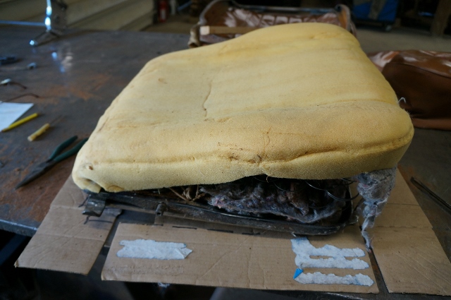

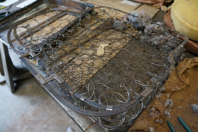

                          My seat base had foam put over the horse hair at some point. Once I figured out that the horse hair was held on by hog rings I clipped them to remove.

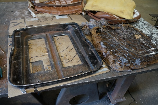

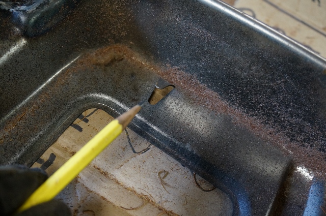

                          Then there are tabs on the base that need to be bent open to remove the spring assembly.
                            There was burlap between the pan & spring assembly.
                            Now I will clean & paint the metal parts. No paint from the factory. Still haven't decided on the vinyl color to order. I have narrowed it down to two. It's just that each one looks like a match but in different lights.
                              Very nicely detailed post Mic! This will most definitely help someone down the road. Yes, the tabs on the back are for the headrest's. In looking at your photos the covers don't strike me as original. The grain looks like a domestic offering and the tacks at the bottom seem too few. The original tacks on my seats are even smaller and are placed almost side by side. The burlap and guts look the part but the vinyl looks questionable. Looks like your ordering new foam pads; at least the bottoms anyway. Great post and Keep 'em coming! Justin
