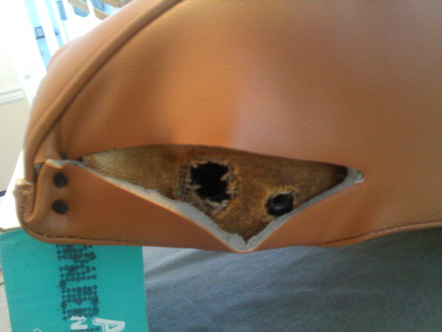

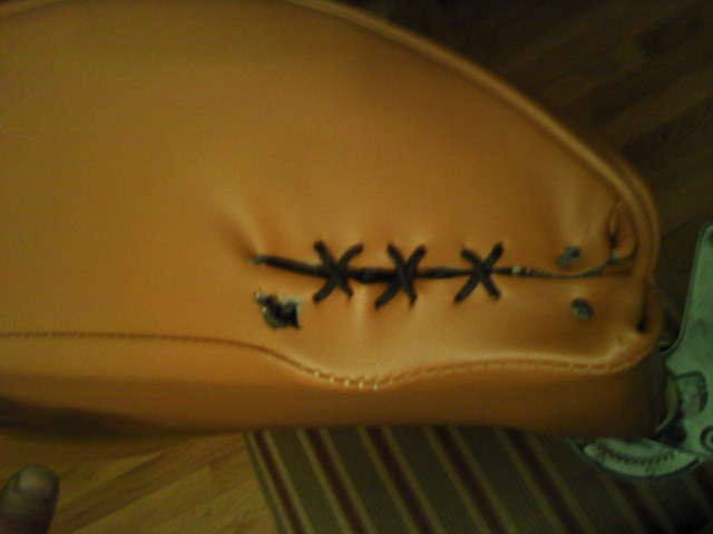

        Finished one back. I un-tacked & stretched it a little different. It helped but not perfect. I already spent to much time on it so I decided to lace it together. Came out good in my opinion other than I couldn't find the right color cord so I got black. It's all covered by the hinge & it is secure. I'm sure an interior guy will laugh.
        From this.
        To this. I laced from top to bottom & tucked in the knot. I first had the knot at the top but it interfered with the hinge sitting flat.

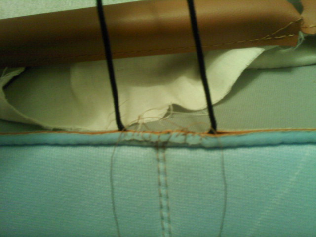

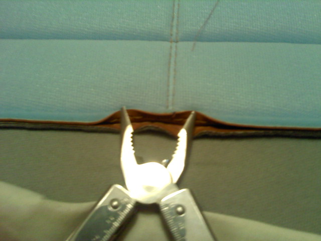

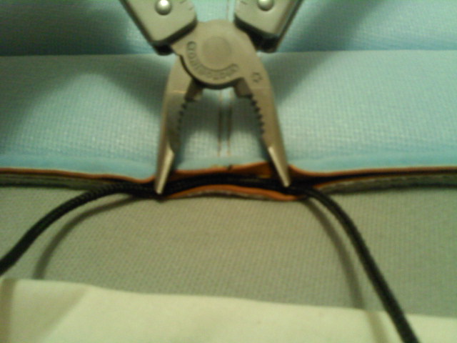

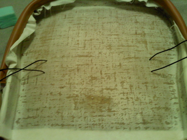

                Got one seat back together. The bottom will need to come apart for a re-tie as the crease is not pulled down enough. As it is now it's going in the car as I have a few events the next three weekends. Only wish I had time to get the drivers seat done right now. Oh well.
                To tie down the crease I sewed in strings where the crease meets the bolsters. I understand that the factory also had strings attached toward the center more. I couldn't figure out how to sew it in there. Where the two seams meet I was able to insert a string & sew it. I cut the strings 24" & doubled it over so once sewed I ended up with two strings 12" each. I then fed them through the seat pad which I put into the cover & both of them over the springs. I pulled one end through the loop on the base & tied it to the other end on the same side.

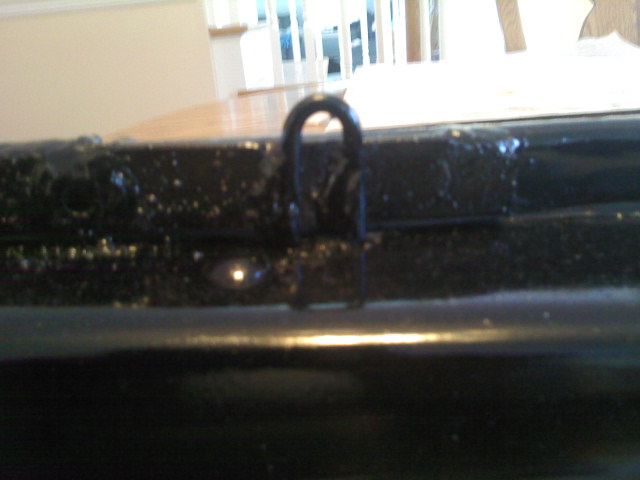

                Here is the tie down loop on the seat base.

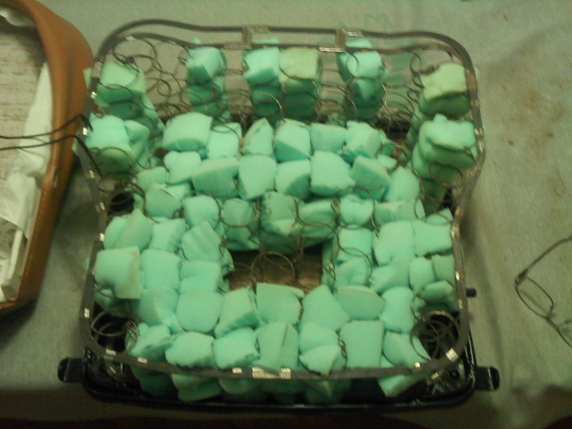

                  A little out of order but here is the foam arrangement now. Again I took Jacks advice of adding to the bolsters & removing some from the center. These are cut from 3" thick foam. The center/inner pcs. are 3" tall by 2" x 2" cubes stacked as needed. Usually three per spring. The outer ones I cut strips of the same foam to make 2" x 3" x 6" pcs. It feels a little stiff to me like you sit on it more than in it. Not bad at all though, nothing like a park bench. My son who is 6'2" & a little over 200 pounds says it feels great. When I do the drivers seat I will use a little less foam in the center area to see how that is. There is no magic here, just trial & error.

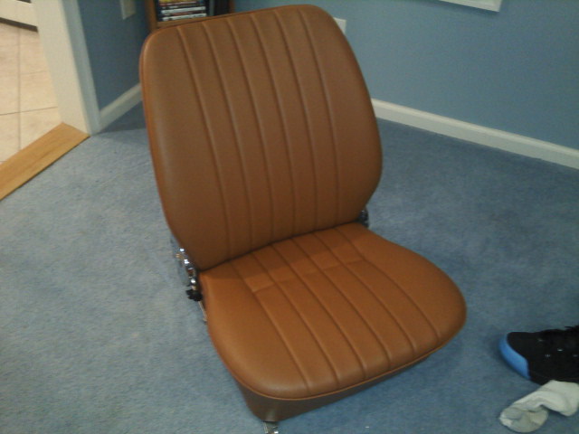

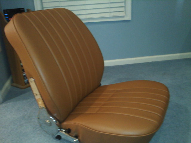

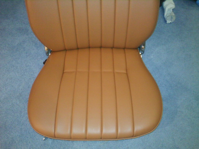

                  Here is the finished seat. Took longer than expected but now the second one should go much smoother.

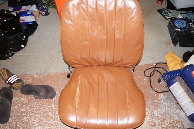

                  Here is the before pic.

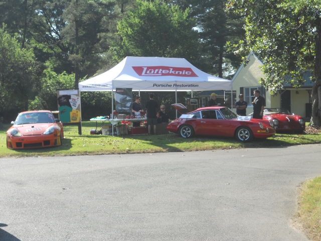

                          Hey MIC,
                          If they take it it will be at their tent (booth)!
                          This was their tent display at last years RPM here in Richmond.
                          Chris Speedster is on the right, but it is down getting a new Autos Int interior at home.
                          Back of Chris Speedster
                          'Talking' with 'The Lady Of The House' after RPM 2013.
                          Its a rotten job guys, but somebody has to do it!

                            Mic, of course it depends on the foam density used, but if I was asked for a comment (and I realize I've not been) I would say you have a little too much green foam as shown in the picture above. I used as much a long time ago and as you say, it's trial and error and I had to remove every other one or shorten most. It's like the 3 bears thing....some can be too much, less can be too little...it needs to be 'just right.'
                            Now and for 36 years I have had Jim Quartermus do those seats for me. He bought covers from Autos and dissected them to see what they did and made a compromise so they look good but are not too stiff and yes, he uses foam 'rod' or pieces in the coils as needed.
                            They (and we) sag some after 50 years with gravity.
