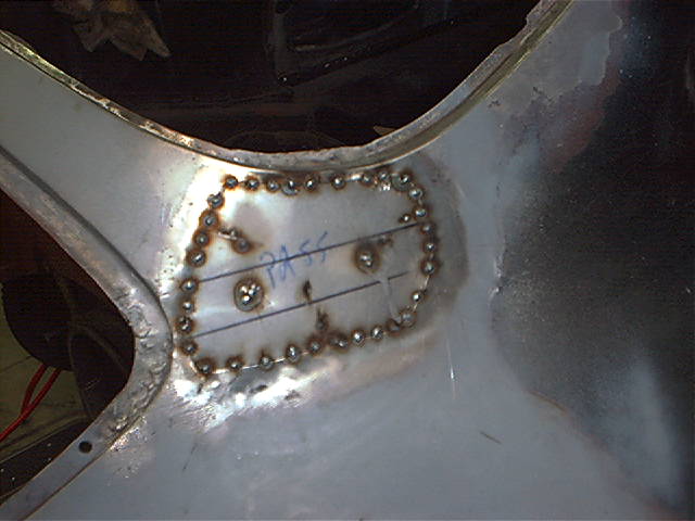

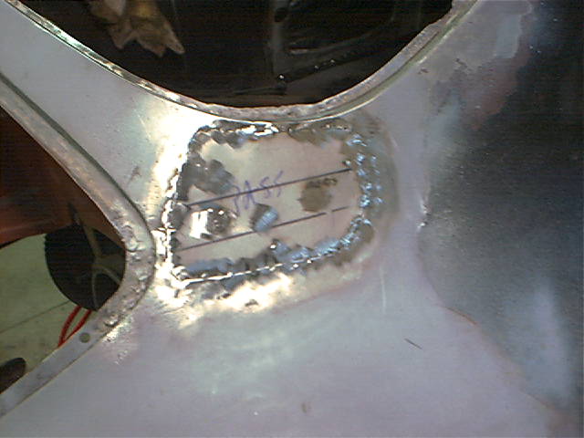

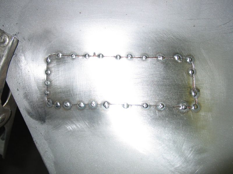

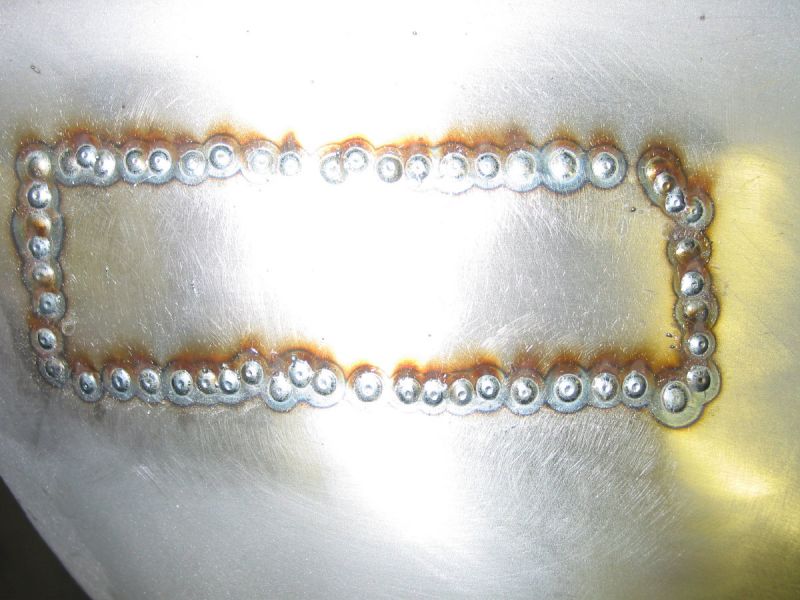

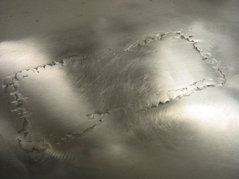

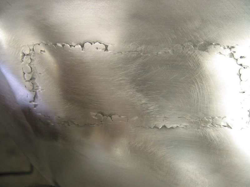

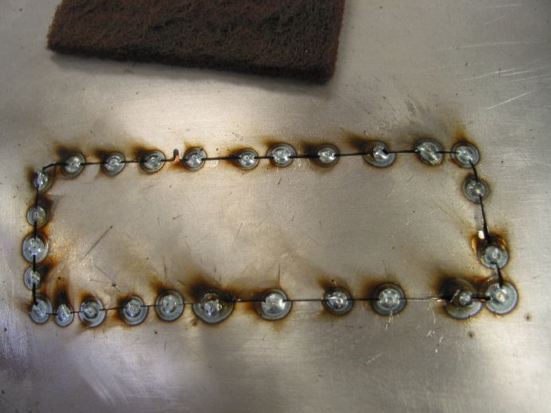

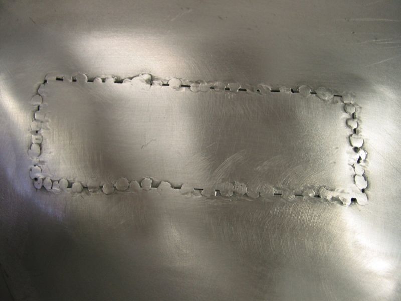

    OK... so I finally got up the nerve to patch that hole in the back of the upper fender area (passenger side). This is one that will "show" (I've been practicing underneath the car for the most part).
    I'm just goint to post a series of phots, but this is my main question: how do you know how long to "chase" low spots versus move on to the next area. In my case, I will not e using lead. That is for absolute perfectionists like Justin! At some point I will be handing the car over to a paint / body work professional for finishing. Which will no doubt involve some plastic filler.
    At any rate: when do I stop "massaging" a given area? I stopped exactly where the following phots end. Give me some advie: where would you go from here on this area?

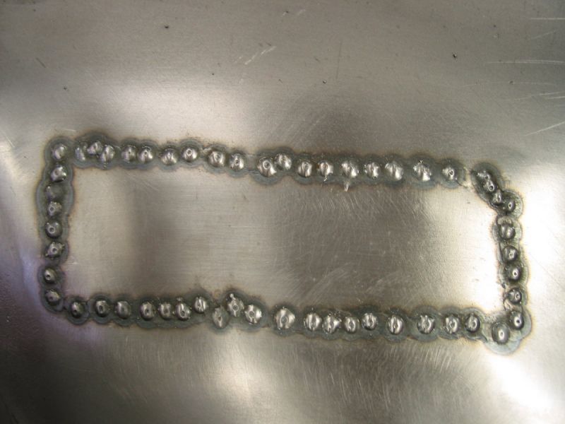

        Bill

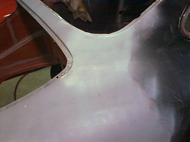

        When you referred to chasing low spots I assumed you were talking about low metal from shrinking, but looking at your pictures, I now assume you are talking about spots not filled with weld. I would try to fill all of those. If you can get a bright light on the back side, look for light coming through. At a minimum you don't want to see any light leaking through your welds. My goal would be filler for sheet metal low spots that can't be raised for whatever reason. I will try to post some pictures of work I did near that area.

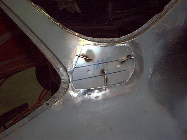

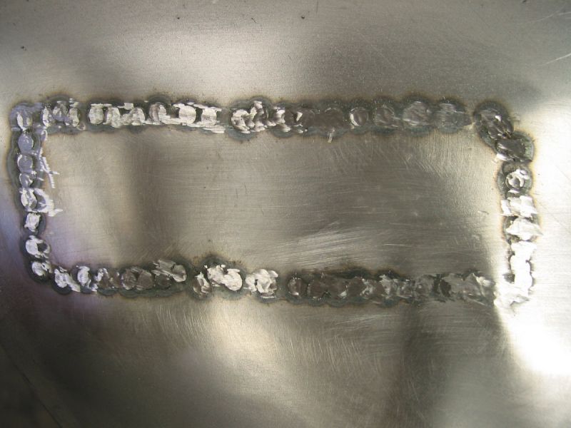

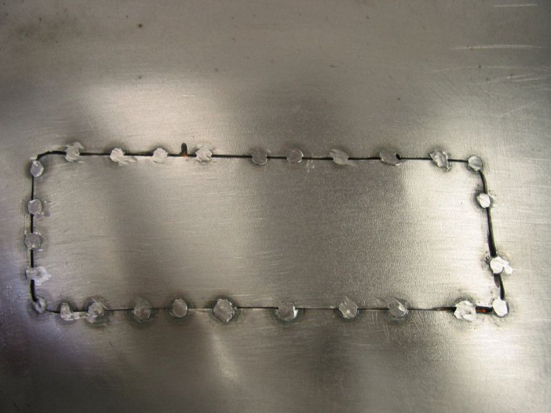

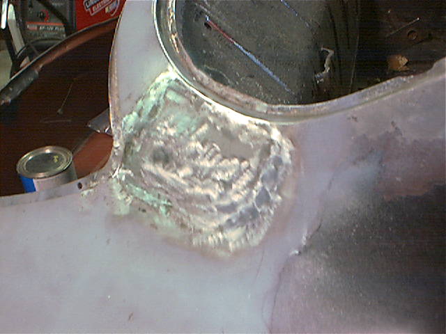

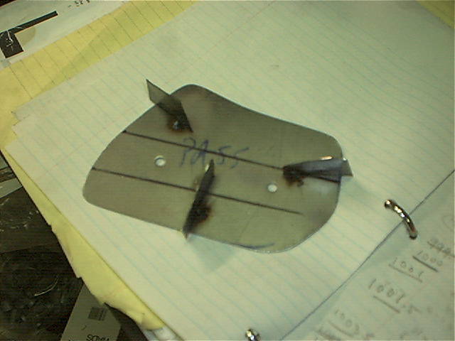

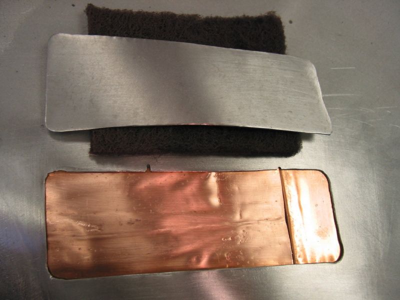

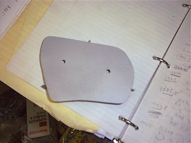

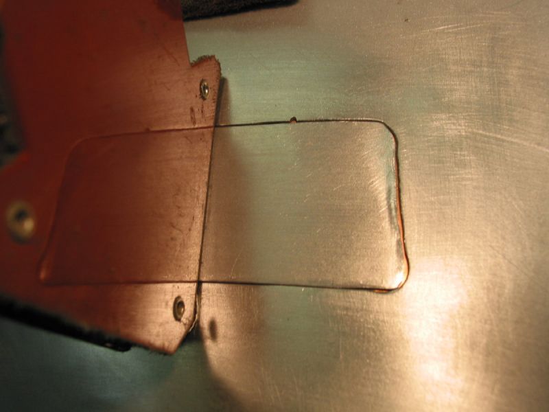

          This is a sequence from a similar hole on the rear quarter in a common rust area. I welded 3 alignment tabs to help locate the patch flush. This repair was done some time ago, before I learned to smooth the welds as I go. Looks similar to yours, but I did a complete fill of each 5/6 to 3/4" gap between the tack welds using the "stitch" technique I told you about. Basically a series of tacks, with the next one starting about 1/3 back in the previous tack while it is still red. I think doing this would reduce the amount of re-filling of pin holes and missed weld areas instead of tacking about(not as in sailing). The primer is over the bare metal and welds and you can see there are no low spots. This area was coverd by a lot of lead by the factory, so filler will be needed to make it look right.

            WOW Bill! Boy are you patient doing all the those series of spot welds in stages. I have to admit I would have stitched longer sections. I would have gotten so impatient by the second round; Nice job! Looks good! I think you were asking how far you should go on taking the heat distortion out. correct?
            Really nice work Phil! Alot of thought and prep went into that patch. The alignment/holding tangs were a good idea! Justin
              I "chickened out" on the stitch welding... worried about deformation. I will follow Phil's suggestion and use that approach on the next patch I do.
              Yes, Phil I was talking about how far I should go re. the small "holes" (actually just low spots). Sounds like you are suggesting I try to eliminate all of them rather than rely on the painter's application of plastic filler.
              I'll post a photo later today of the "final" product (subject to you guys telling me I've gone far enough).
