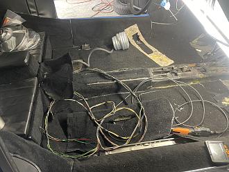

              Went back to get another look at the wiring. Have not paid much attention to it, up to now, minor mistake. Previous restoration guy, let’s call him “Boob” did so many things wrong it hard to catch up. Wiring is original but the harness is routed through the wrong conduits, and all the sheathing has been removed. Lots of wires hanging out in the weather. Even the ground straps are wrong . Then there is no positive (+) cable to the starter. And both cable conduits have loose wires in them already. Note there is a couple pieces of whistle tube, but I am still getting a brain hemorrhoid every time I look at something.

              now looking like a engine & trans drop, remove the seats, carpets open up the tunnel and start fixing wires. On a new leather interior carpets and floors. The main power cable to the fuse box is cut too short to use,, I can’t wait to see what it looks like under the dash, or behind the fuse box. Well the saga drives on ( I wish it could drive)

              Did the Happy Dance today. After pulling the aft half of the wire harness, back up into the tunnel. We were able to finally get a good inspection on the wires and the damage done by Boob. I can fix most of it. Then we installed the (+) battery cable today. It was not fun at all but we got it. 3/0 or 35mm2 cable is not easy. This is usually the first wire you put back in after blasting. I used welding cable with a rubber jacket. It is softer than the original PVC, and has a larger friction point, but will do better than the OEM. Y&Z wanted twice what it cost to make one, and I have extra length fo male it fit the starter better for future work Boob did not for some reason. But we found all he wires, now it just remove all the splices, spade used for splices and extra wires. Not sure about the Red 10Ga that feeds the fuse box, that was cut up by the conduit. Needs to be replaced also. There would have been serious lighting issues the way it was. I have a full set of Greg Bryant’s wiring diagrams, having a windshield size color diagram is a life saver.
