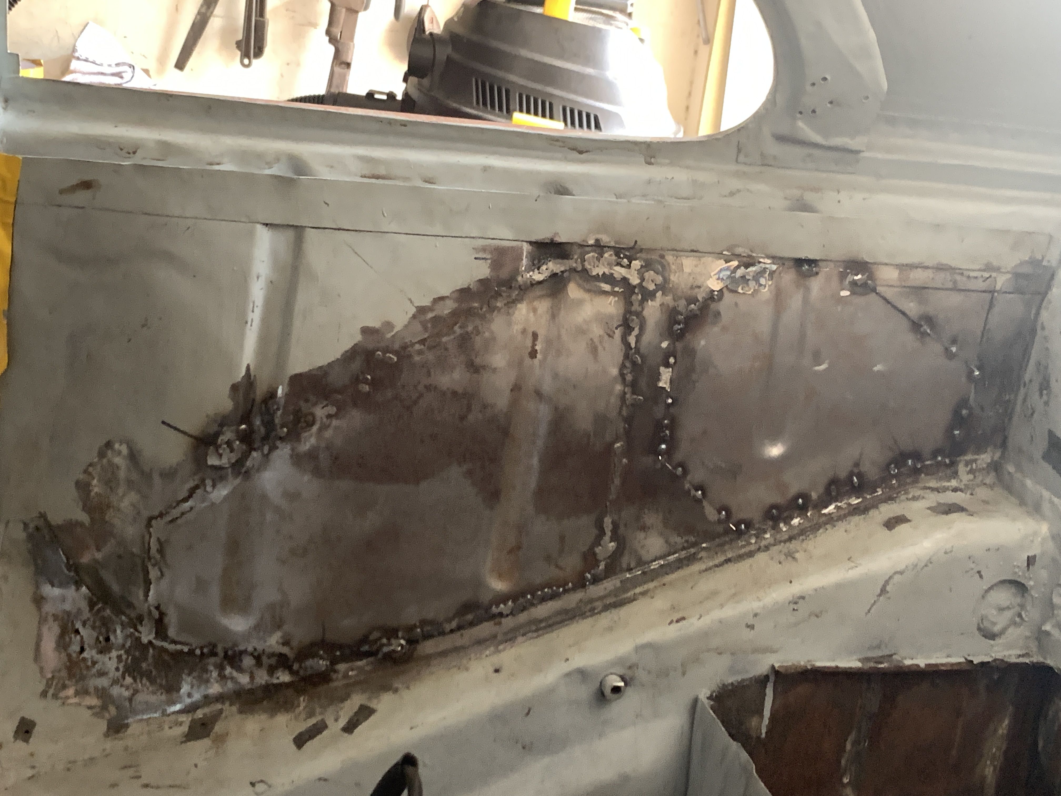

                Patch panel installation progress photos. Went ahead and purchased the full panels and then cut out the pieces to patch the rusted areas.Exposed some rust in the back seat area that I'm removing and sealing before replacing the panel that goes over the top. Slowly but surely and learning a lot along the way. My brother has been helping me which gives me a lot more confidence in what I'm doing than flying solo.
                  Looking good, tedious repairs for sure. How bad is the seat pan in those corners?
                Well done Marvin !
