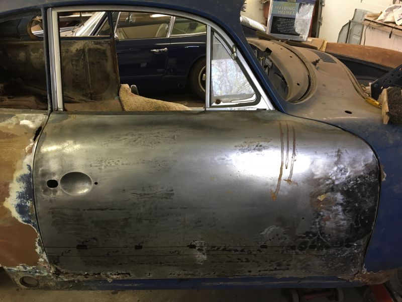

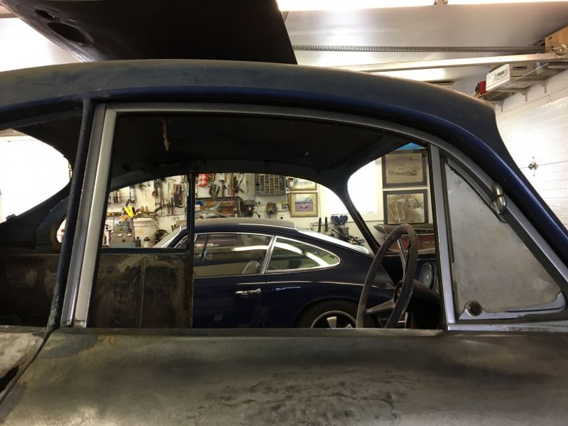

                  Hello all,
                  Since I live in Rhode Island by the Atlantic Ocean, we just got Spring last week. I have been busy with yard work, so now that is done and the chipper has been paid to truck away all the thorns, I can get back to the doors.
                  Thanks to this board and the gentle comments, I have decided to start on the passenger door to make sure that door fits. I learned that you should install the window frame to be assured of the proper fit prior to beginning. Looks good.
                  Rear gaps are pretty good.
                  Front door panel leaves a lot of love, but gaps will be possible with luck.
                  Window frame fits well too.

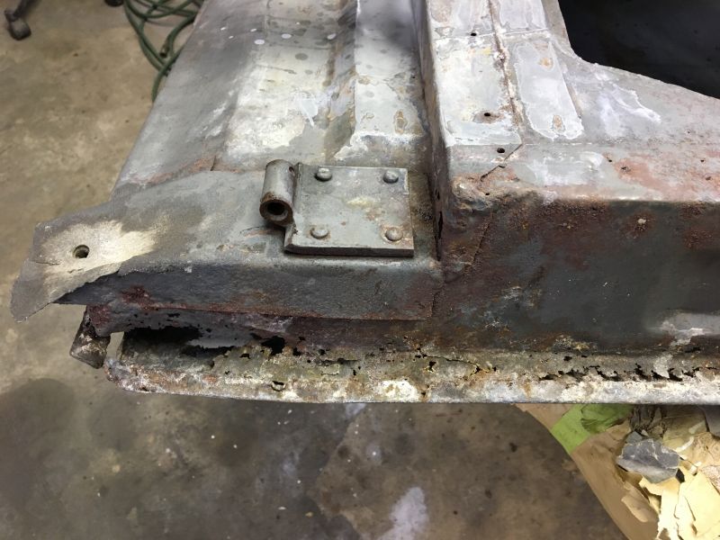

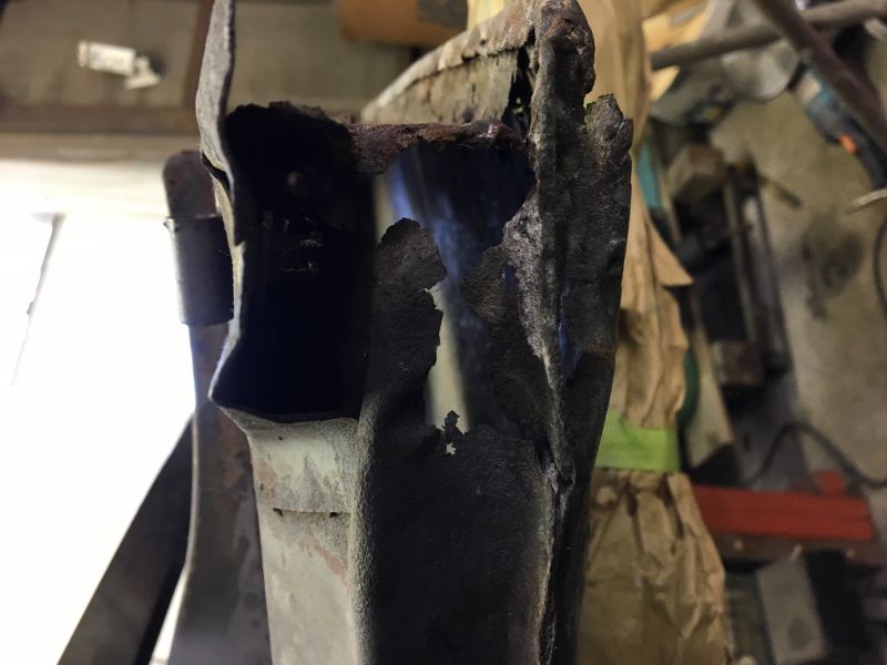

                  The door bottom will be replaced now. I have a Restoration Design door bottom and lower door skin. But, first a lot of very rusty metal needs to be removed and the door bottom attached after much repair work.
                  Here is the door bumper with the normal crushed and torn metal.
                  At the other end, it is no better.

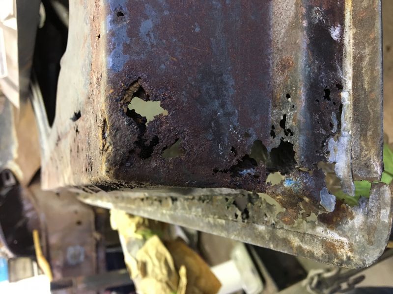

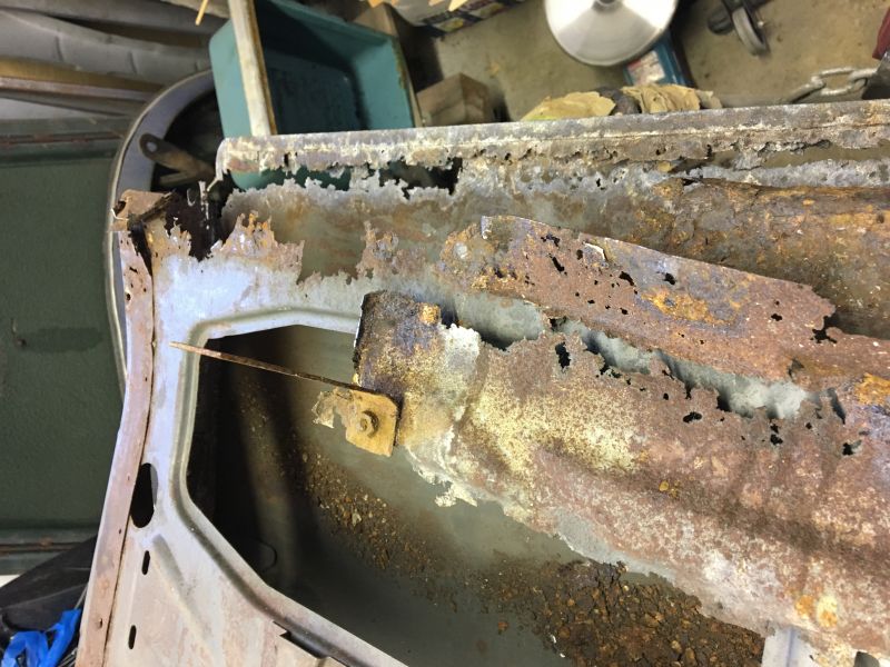

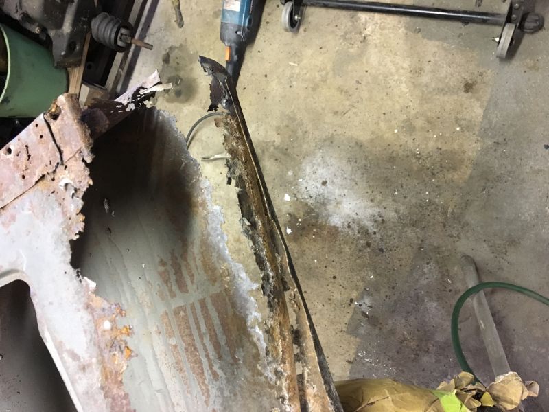

                    Back again with the removal of the rusty door bottom parts.
                    Rounding the corner from the bottom, we find more Swiss cheese to replace.

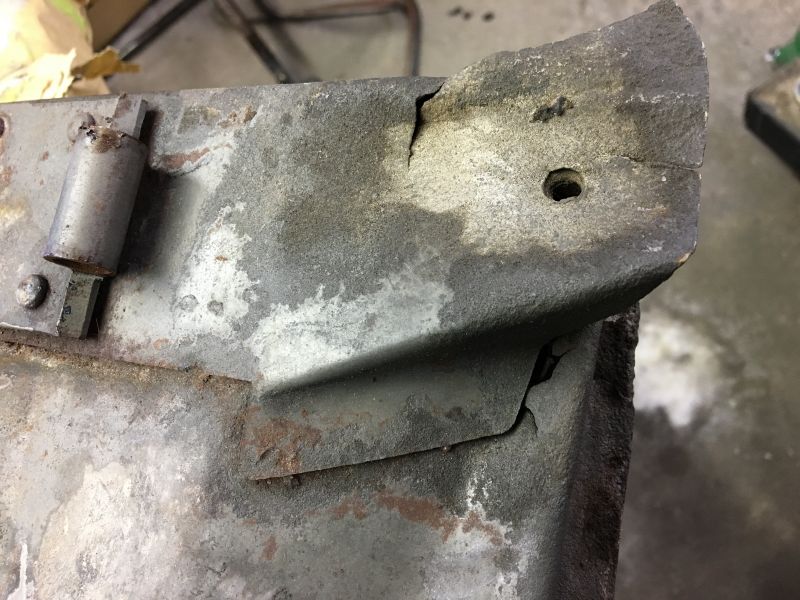

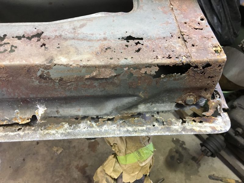

                    A closer look at the soon to be loved door stop. I liked Tom's idea to weld in a reinforcement part, so that will be done.

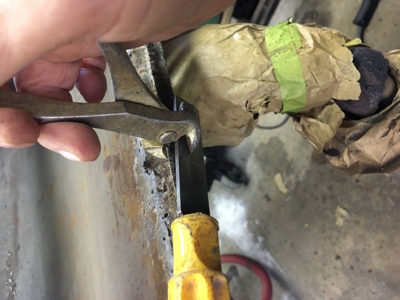

                    Starting to cut away the old door bottom. The opposite end from the bumper.

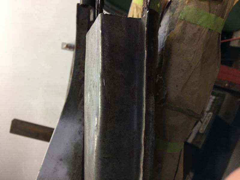

                    To put on the new RD door bottom, I will try to keep as much of the old door skin for alignment purposes, so I used a cutter and a chisel to back up the cutter to pry way the door skin.

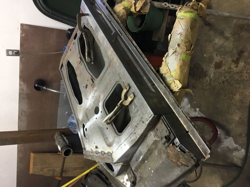

                      More door bottom removal process.
                      If you have watched my door skin straightening earlier mess, the lower door skin has parted with the upper door skin. But I can use the flange that I opened up in the last posting to capture the RD door bottom for practice fitting on the car.

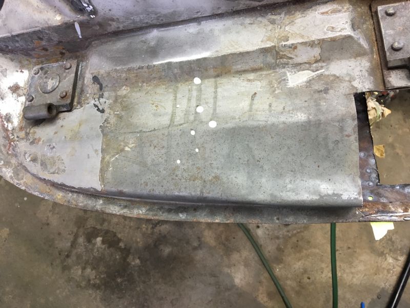

                      Here is the RD door bottom ready for some cutting and fitting.
                      Time for a cold beverage and to carefully read Tom's three part blog on repairing doors and rereading Ron Roland's book on door bottom and skin replacement.
                      Thanks for shedding a few tears for my rust. Gone, but not forgotten.

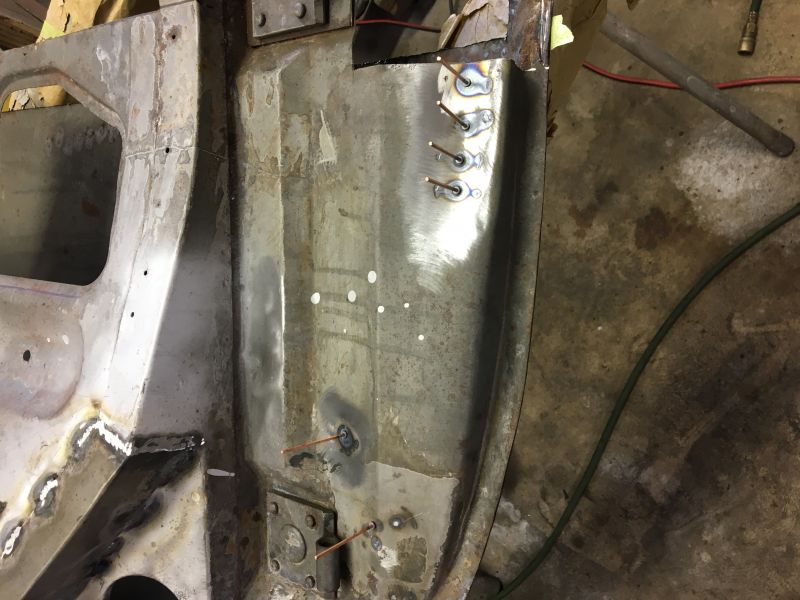

                        Hello all,
                        I began to mock up the door bottom today.
                        I removed most of the door opening brace as it is well bent and cracked.

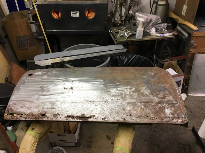

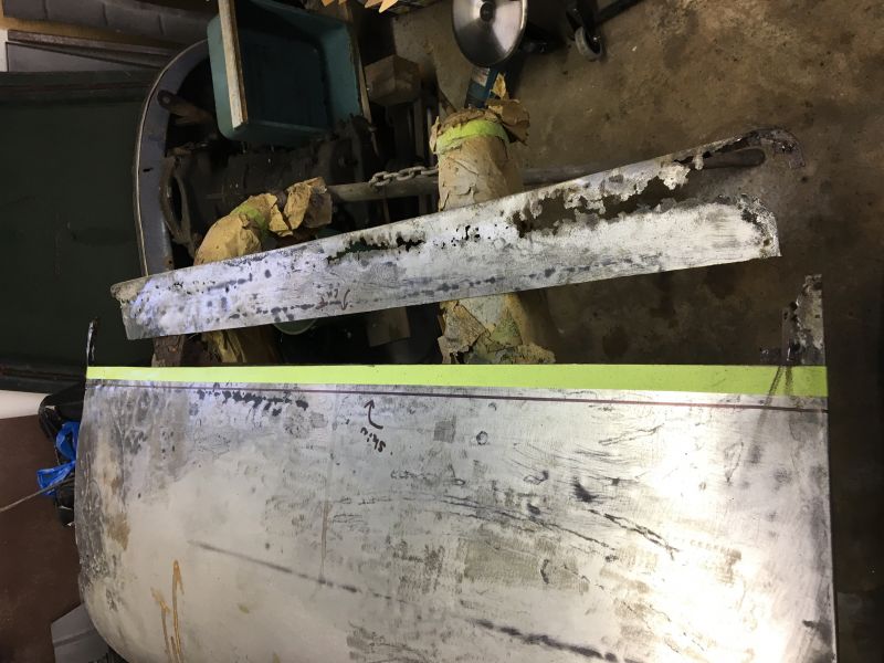

                              Hello all,
                              Here is a photo of the door that was in rough shape.

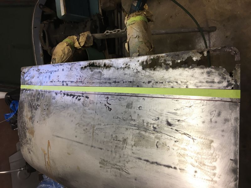

                              Hopefully, after my commentary about what I did today, you can see the door is perhaps worth saving.
                              I cut off the bottom of the door skin using a strip of tape stretched across the door skin to keep the cut straight.
                              Too late to stop now.

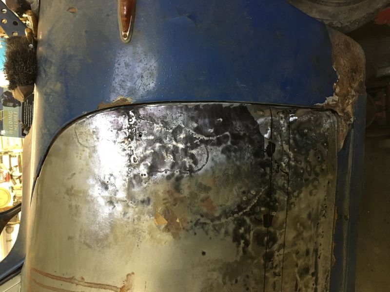

                              With the bent door bumper removed along with the attached rust to get to good metal, I saw a nice valley in the metal that I wanted to get straight when the new bumper holder goes on.
                              With some porcupine quills, and my new puller, the valley came out along with some dents.
                              Cleaned up and the valley is gone.
                              More in a moment.

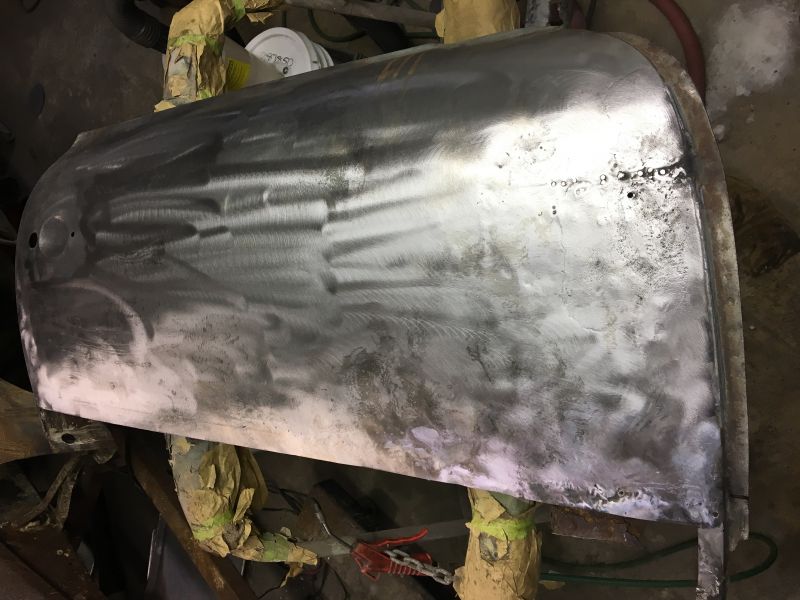

                              • #60
                                Hello all again,
                                Here is a photo from the side of the valley showing the side is now straight.
                                For the remainder of the day, I metalworked the door's dents. Here is how it looks now. Compare to the first photo of the previous post.
                                I'll keep the door now.
                                Tomorrow, more metal work and then installing new 18 guage steel for keeping the door strong and the hinges aligned.
