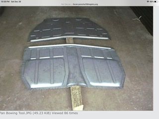

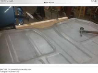

  • I’ll check my car which is a B however the floor is a bit of a “v” to the tunnel. The floor is not flat from side to side to each longitudinal.
    356 Registry main thread;
    • Red911
      Red911 commented
      Thanks Scott. I put the RD floors on the garage's concrete floor and the perimeter is flat all the way around, so I am confused.
  • I will check measurements. To install floor you need to bend it a bit then use jacks underneath to bring it snug to the underside of the tunnel. I also made a block (two pieces to sandwich the end) to reshape the floor at the end to get the correct curve as well.

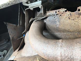

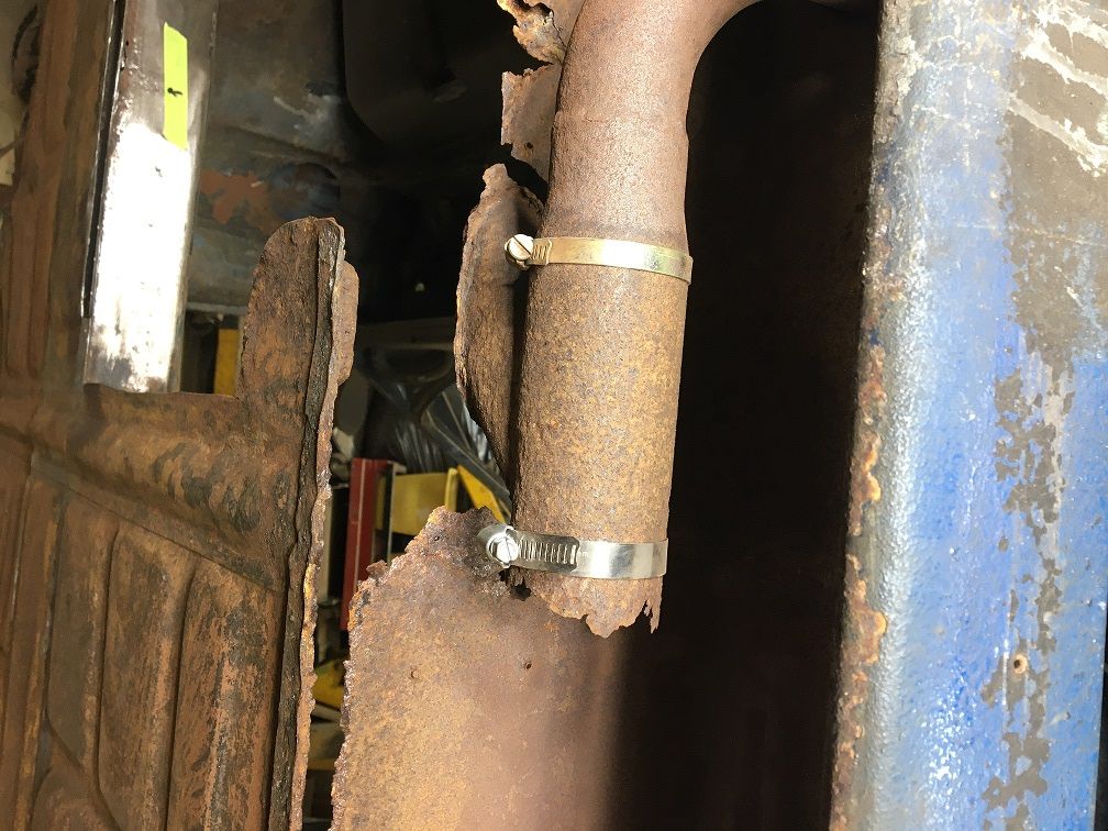

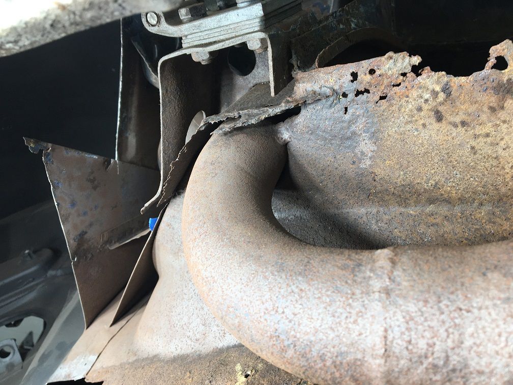

    To tidy up the heater system, I wanted to remove the front heater pipe that turns vertical to the defroster. I ground off the two welds on the chassis and it seems to go all the way up to the defroster.
    Has anyone taken this off? Click image for larger version
ID:	111248 Click image for larger version
ID:	111249 It is # 55 in the PET.
    Where are the welds?
    [ATTACH]n111247[/ATTACH]
      Glad to see you back at it Tom!
  • Hello all,
    I used the PET and traced the pipe up to the rubber connector to the defroster system. The pipe is attached to the inside panel and the pipe is curved at the top, making the removal impossible.
    Time for another approach.
    Thanks for watching.
      None of that old tubing strikes me as original Tom....
