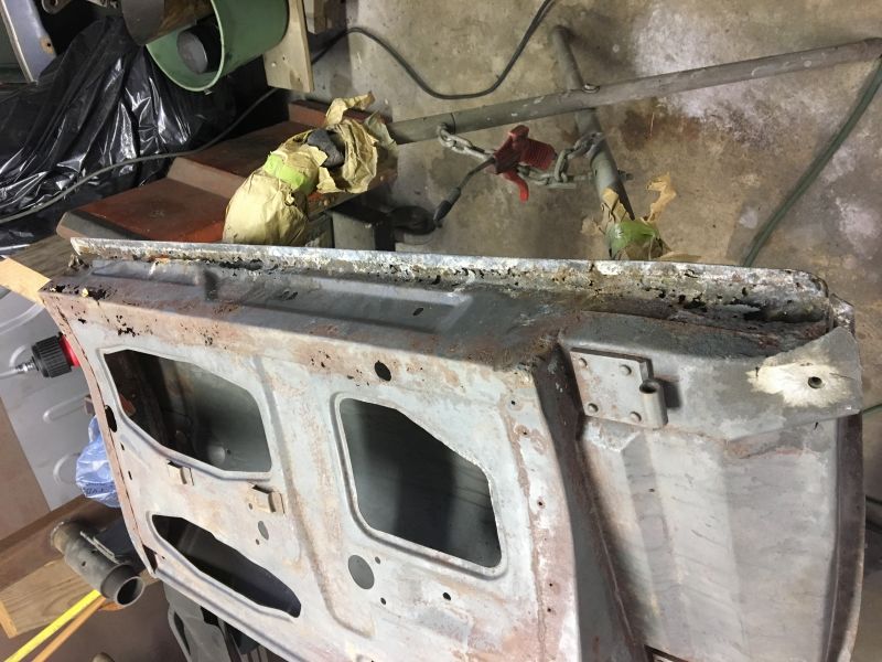

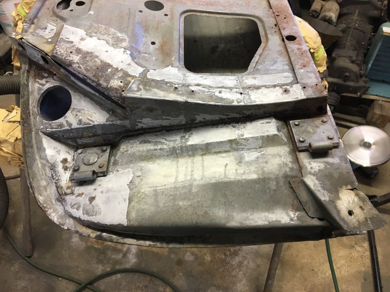

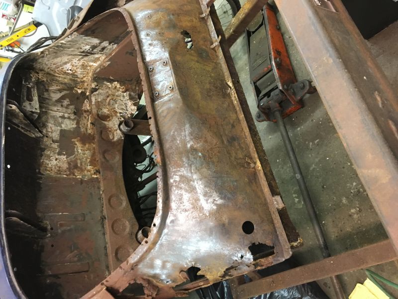

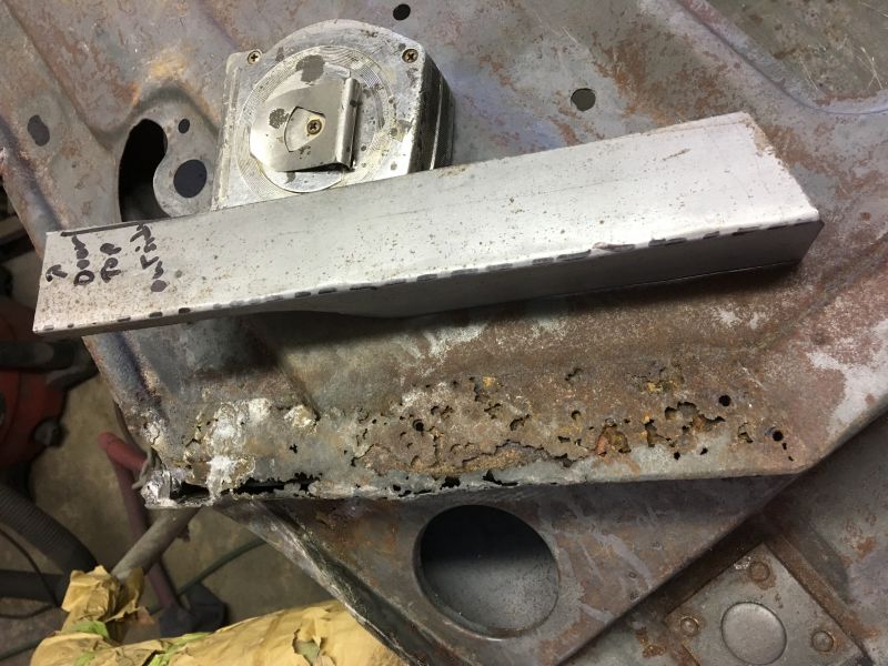

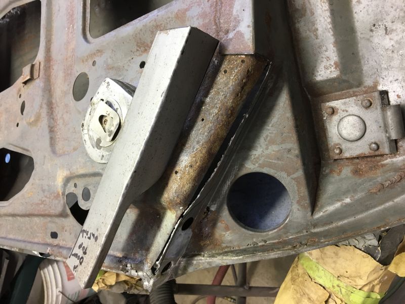

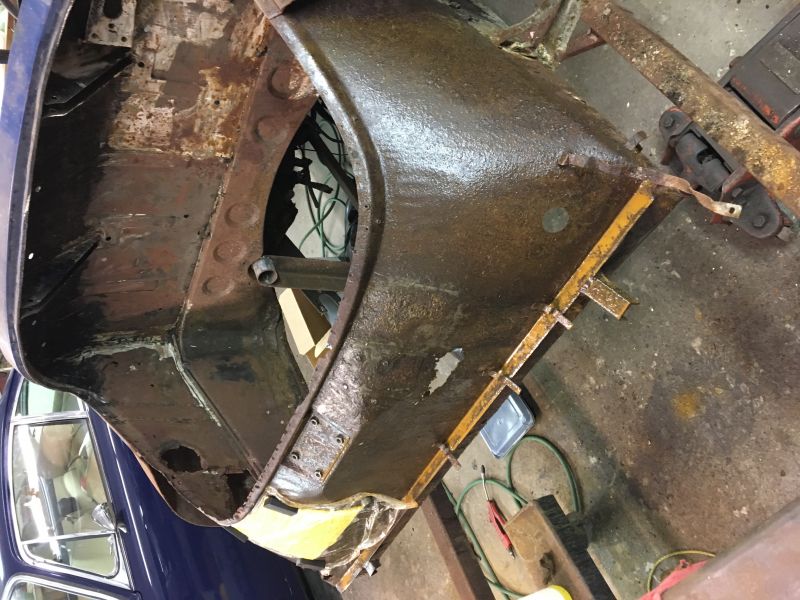

    Now it is time to strengthen the frame work of the door so when the skin is cut off, no movement will take place.

    That is where I am starting.

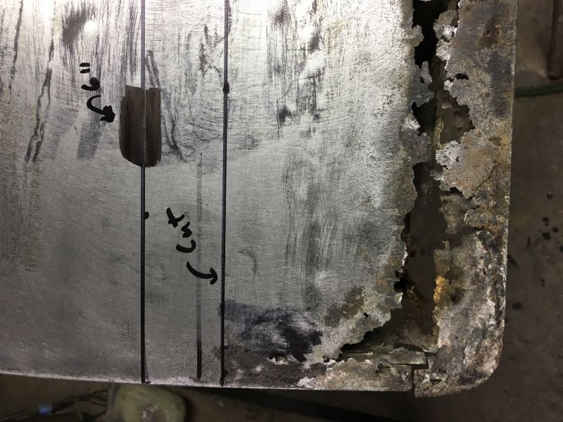

        Thanks John, but I will continue to learn on this door so the rest of the car will be better. Time to forge ahead.
        I liked the three part door repair Blog by Tom. The Restoration Design lower door skin is six inches tall from the bottom, so I scribed some 6" lines. I also marked where to cut at 4 1/2" so I can continue to smooth the door skin and get inside the door without worrying about over cutting.

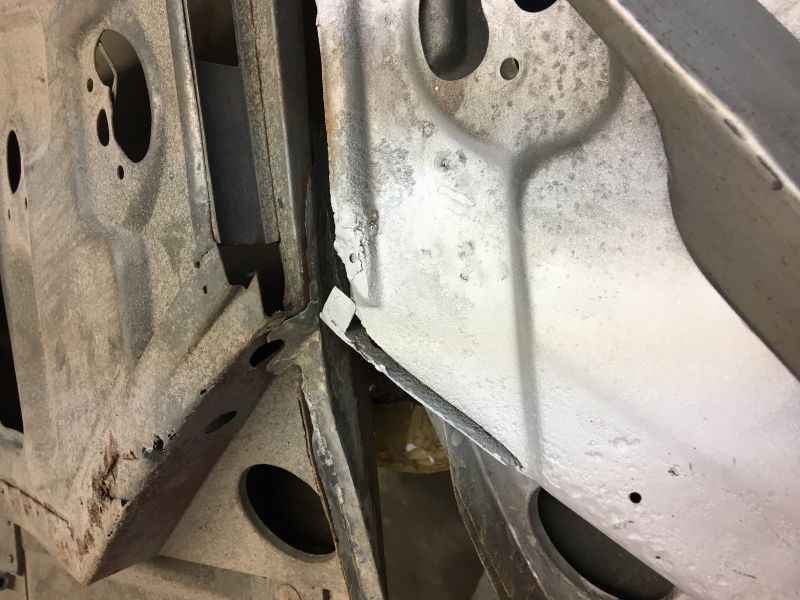

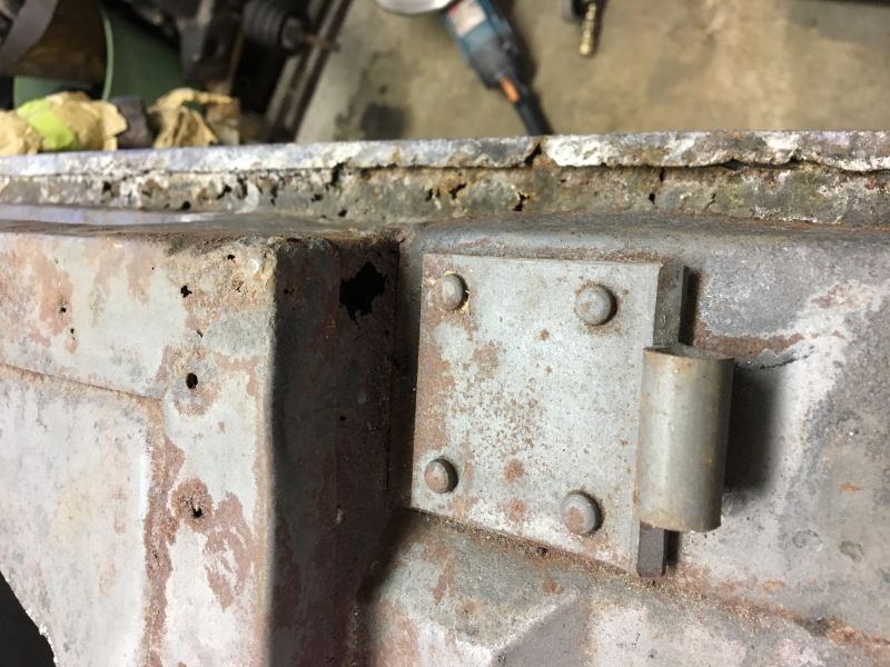

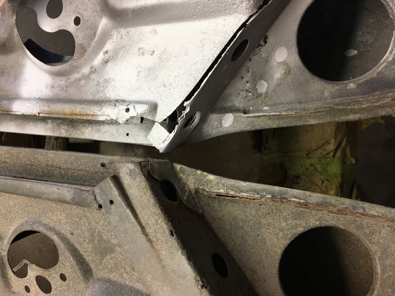

        • #34

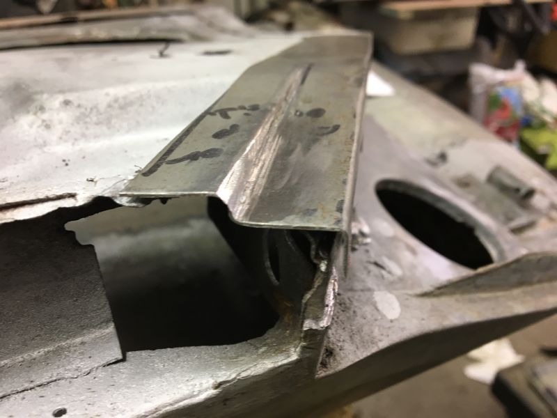

          Hello all,

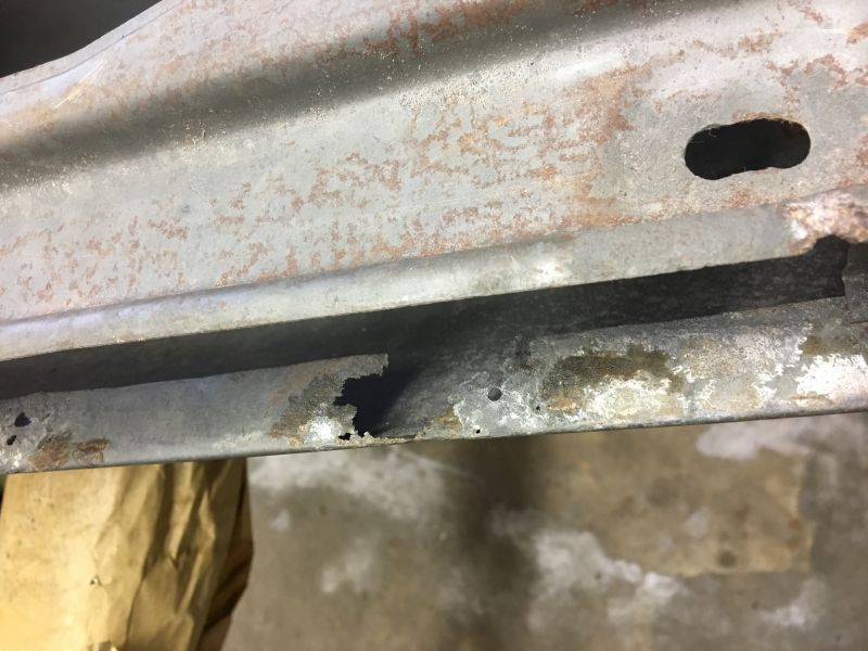

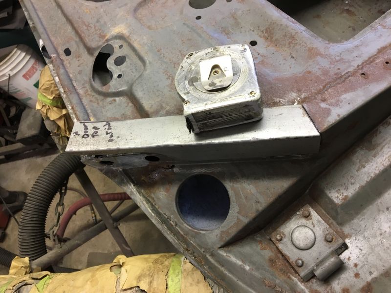

          Now time to work in the inside door frame and replace the rusted framework as needed. I have purchased the 6" door skin and the door bottom from Restoration Design.
          I made a patch to replace the vertical framework.

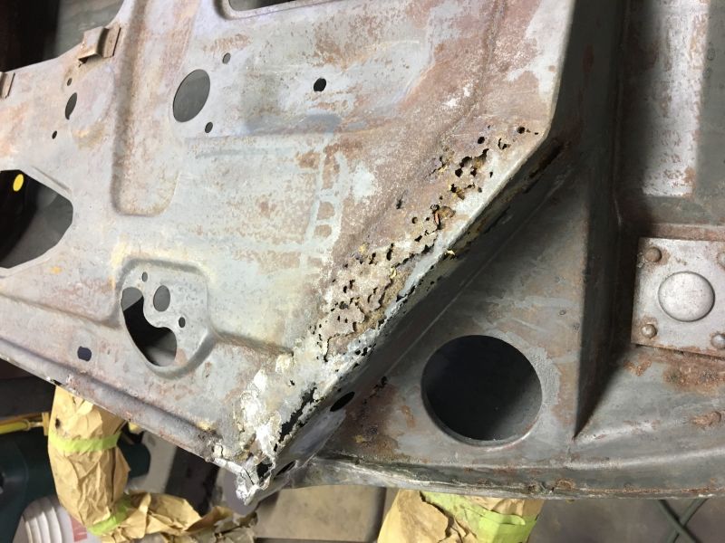

          I cut off the "holy" steel and below it was mostly enough solid steel to put the patch on top.

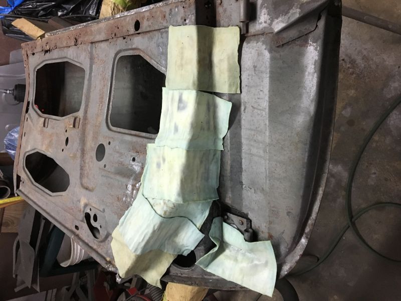

          I soaked the steel with my chamois and POR-15 Metal Prep to take the steel down to bare metal.

          • #35
            Time to protect the clean steel from further rust.
            To match the patch, I compared the other door and matched it.
            The other door has as relief that is 1/4" deep, so I added that touch. I also had to shrink the top thin part of the patch so it bent slightly.
            I also removed the lead on old frame so I can weld in the patch.

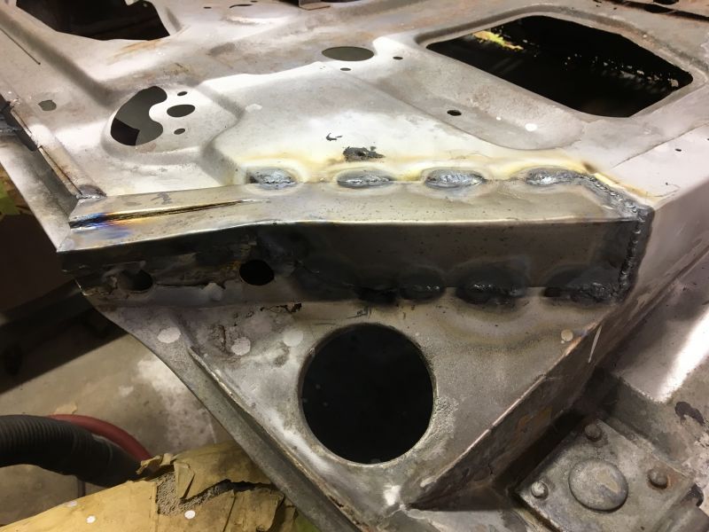

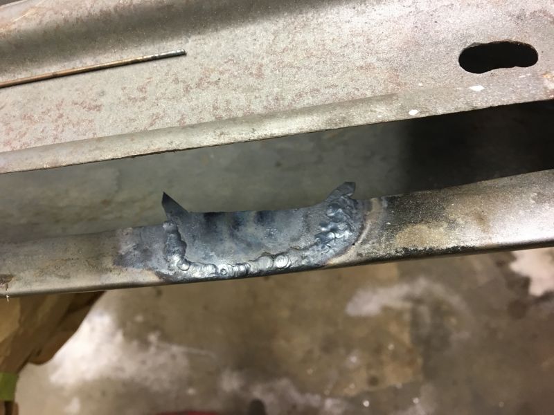

            • #36
              Hello all,
              Welded two panels in today. I am using a Henrob gas torch.
              Here is the larger one. I Googled how to remove lead (read solder) from steel. 1 part hydrogen peroxide and two parts white vinegar, use an acid brush to apply. let sit for ten minutes then wash off with water. The steel welded just fine.
              I liked Tom's writing about the inside of the top of the door and leaving some "ears" on the patch so the ends will not burn off. Thanks Tom.
              As you can see, I need a lot of practice to have cleaner welds, so I am happy these went as well as they did. As they say, "Practice makes perfect".
