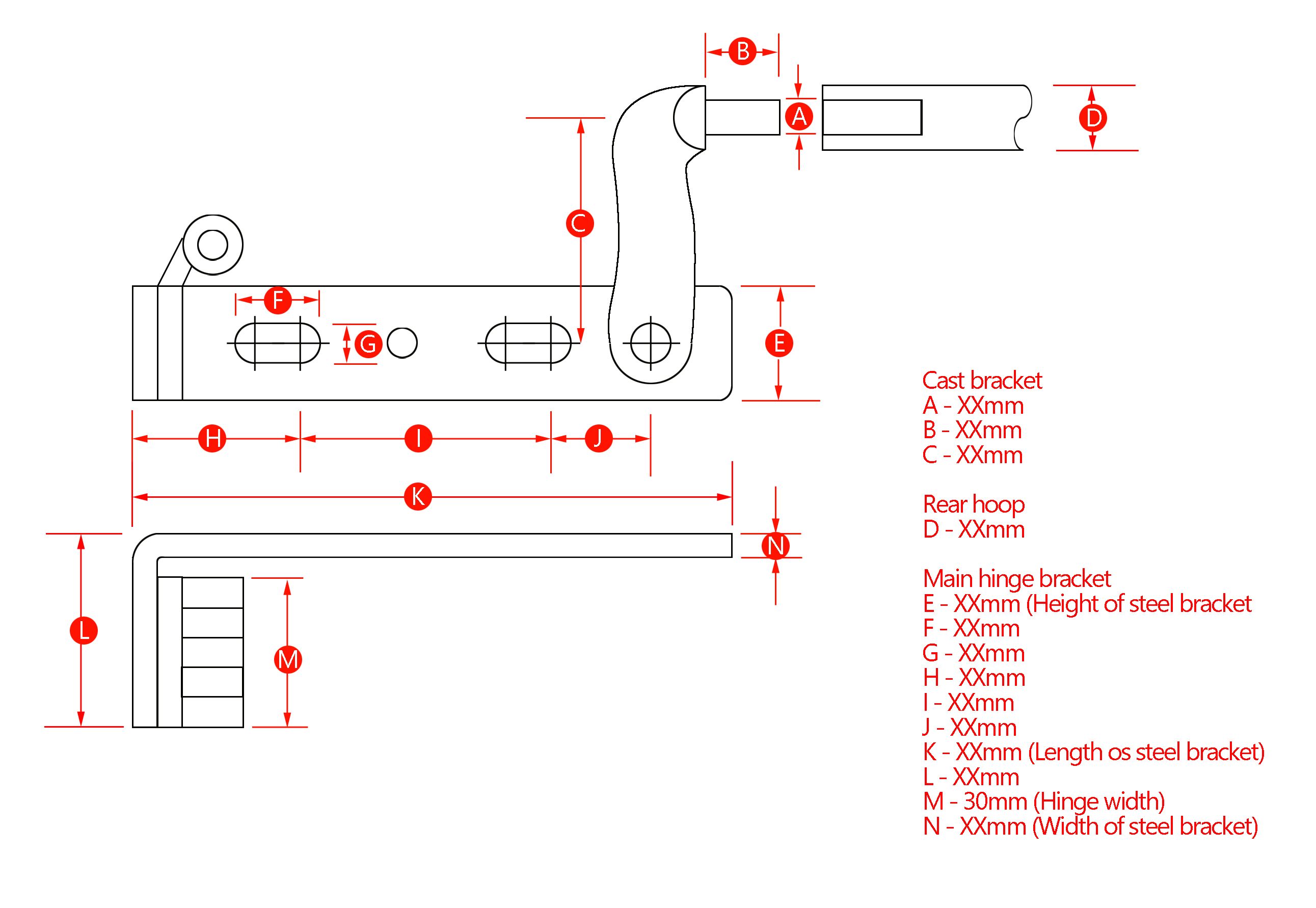

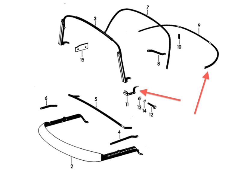

    This is where I need your help, I could do with some clear high resolution pictures of the part from the top and the side (as straight on as possible).
    I also need some key dimensions (see my diagram).
Name:	Convertible D top frame bracket.jpg

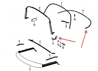

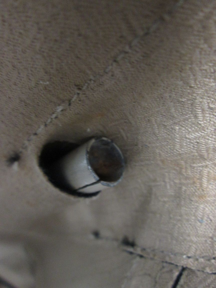

    And lastly is the rear bow (the one that is bolted to the rear bodywork) a hollow tube or is it solid and drilled out either end?
    The cast piece that holds the rear bow is going to be a real challenge so if anyone has any of these pieces lying around please let me know.

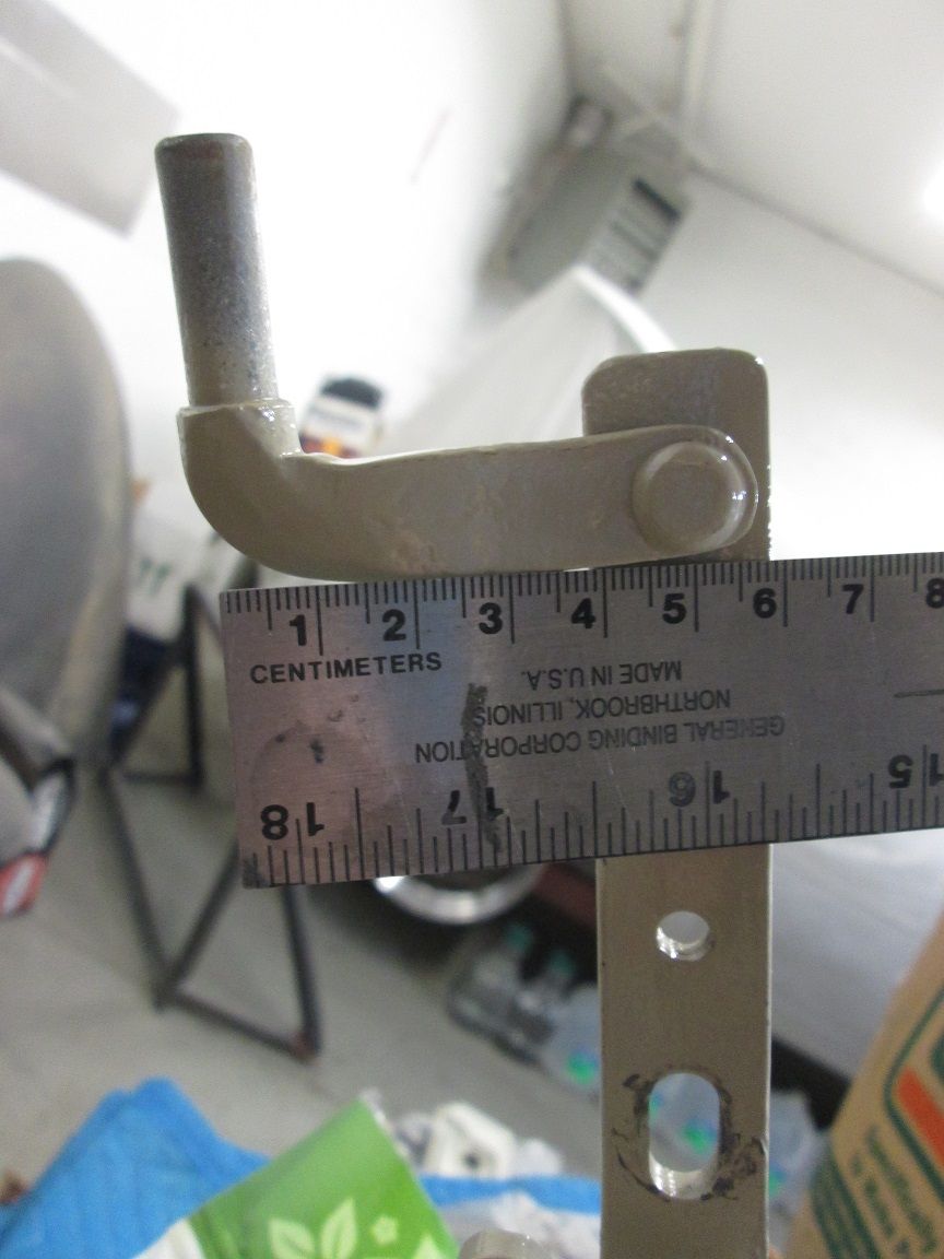

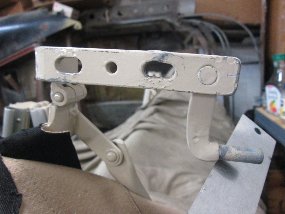

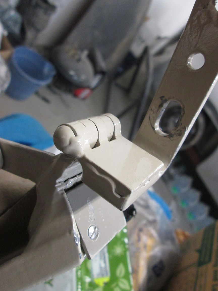

    I'll get you some detailed shots of this early D top frame I have here Drew. As for the base bow its just hallow tubing. Contact Ric as I sold him an original D base bow a few years ago and he still might have it.
ID:	108074 The hinge joint is simply a lopped off Speedster seat hinge.
      Gas a little gas weld tack to keep the pin from walking out.

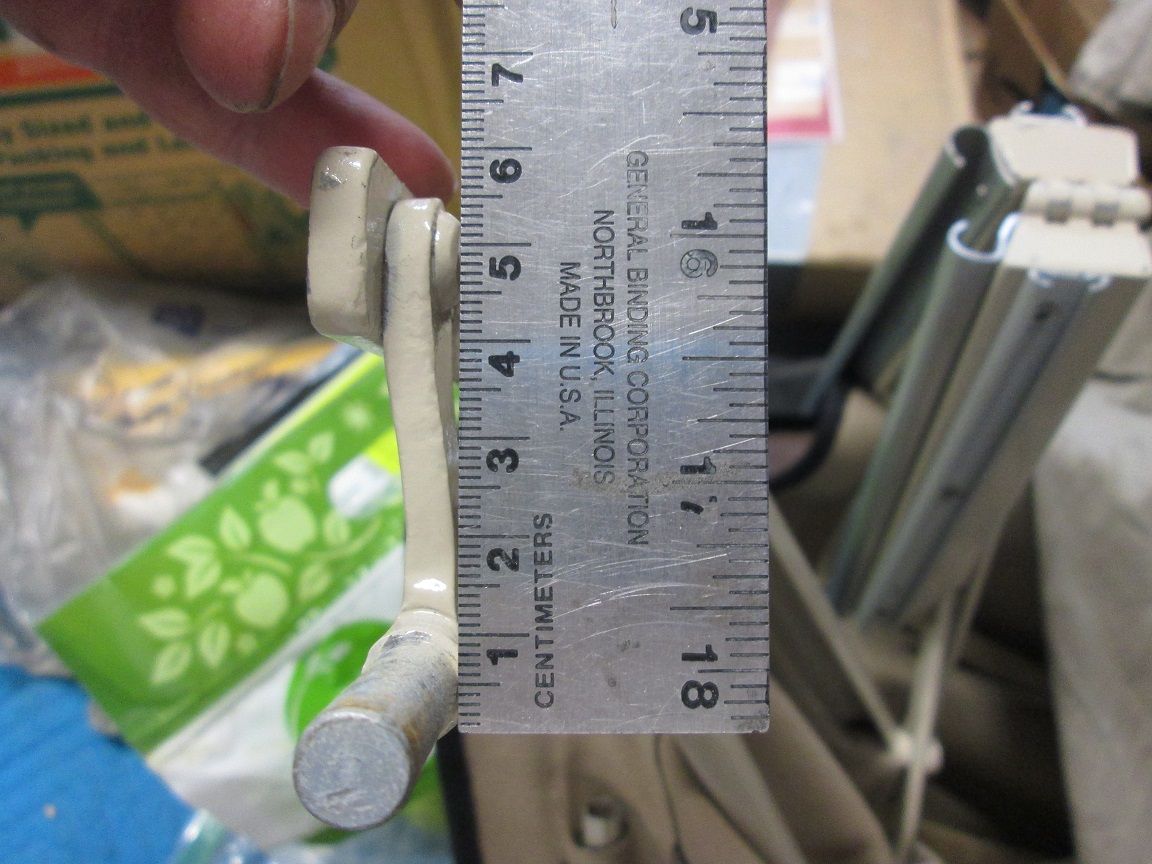

ID:	108076 Call Stoddard and get a pair of brand new ones and you're off and running.

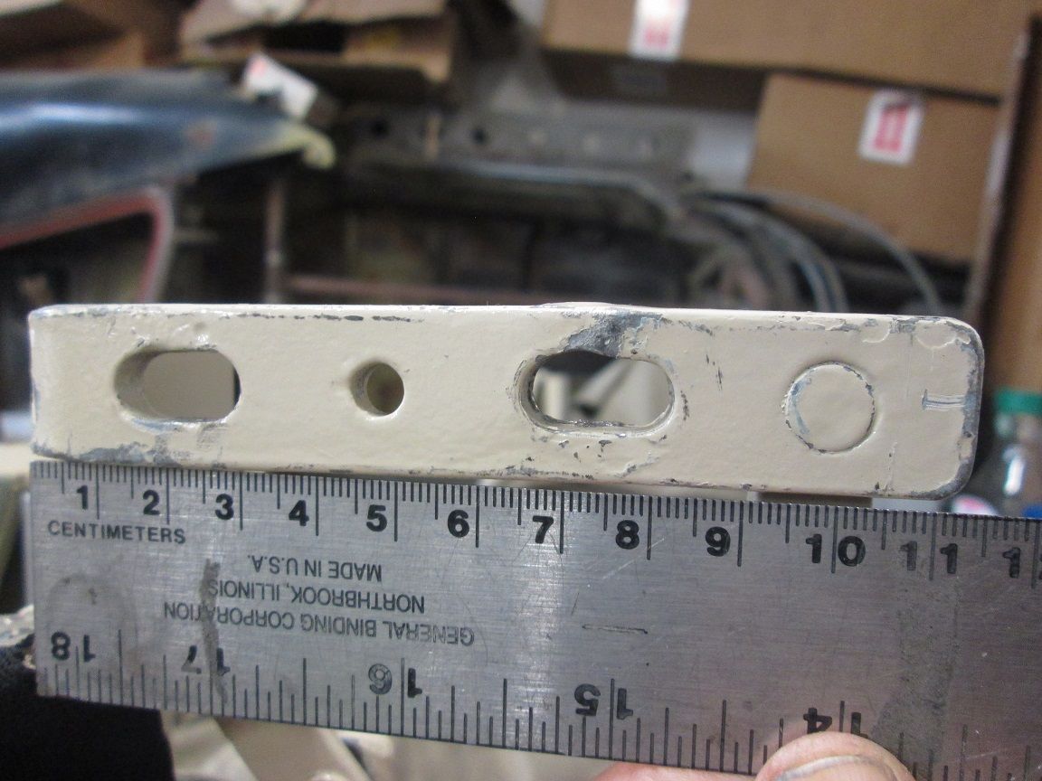

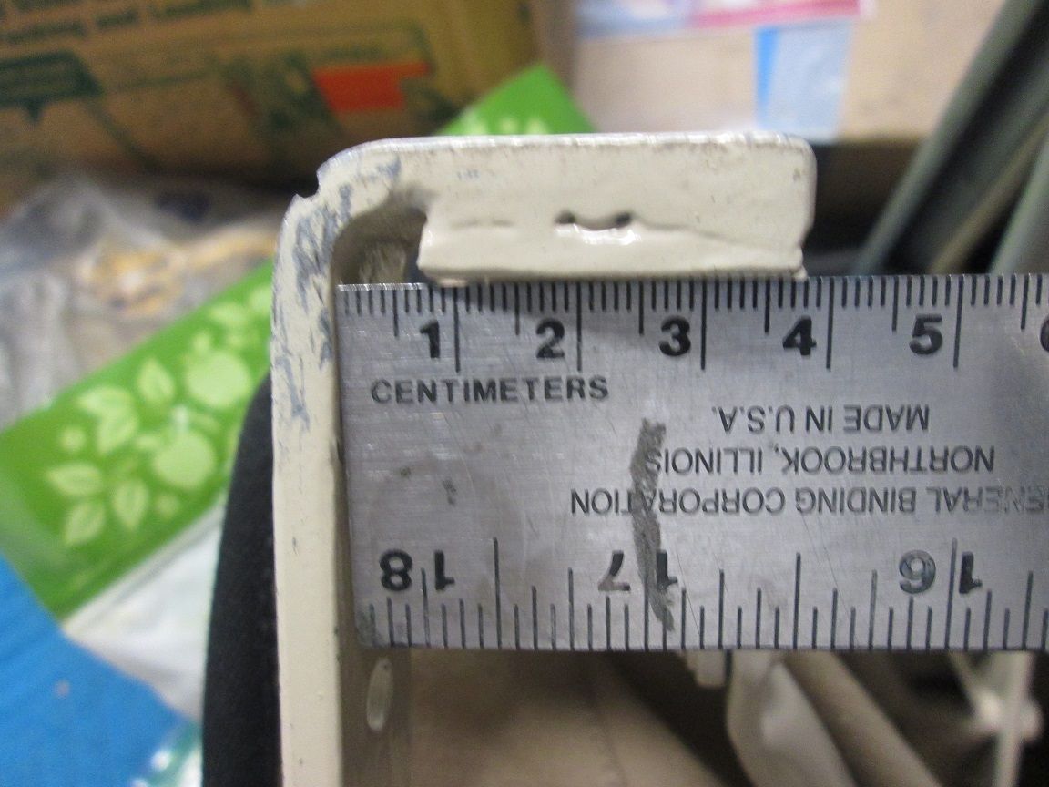

ID:	108077 Width of bracket where the hinge welds to.

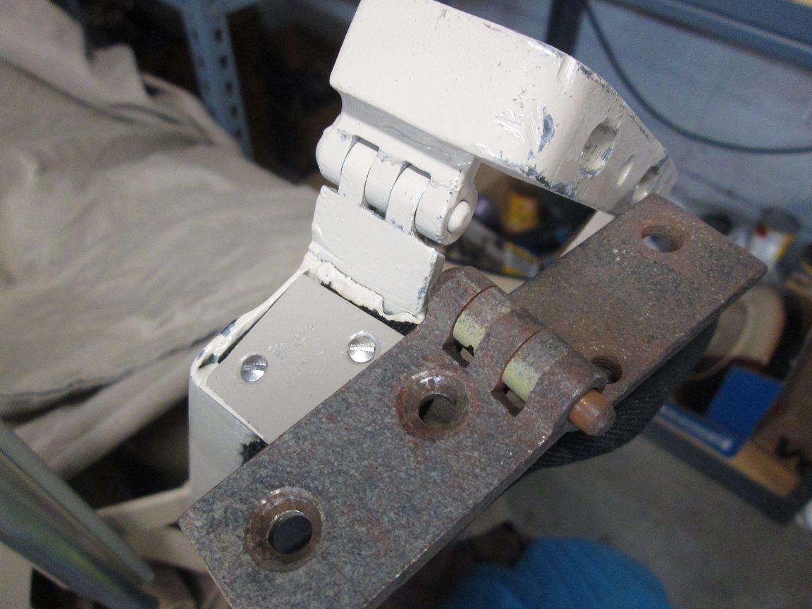

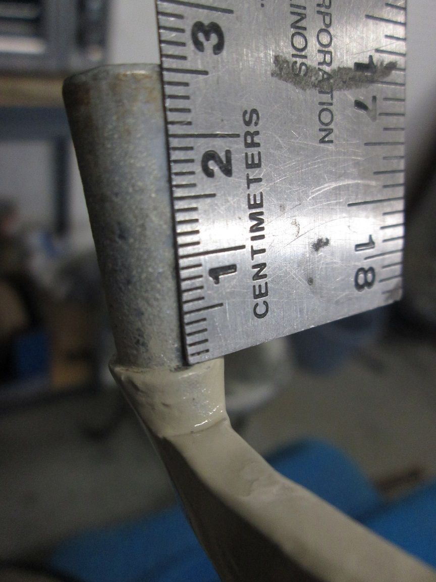

      Base bow tubing is very thin gauge tubbing as you can see this one is split from the tension.
ID:	108080Click image for larger version
ID:	108081Click image for larger version
ID:	108082Click image for larger version
ID:	108083Click image for larger version
        Hope these helped...
