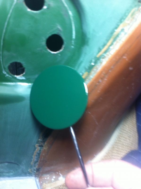

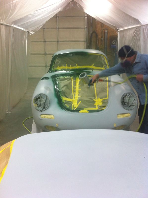

      The Color Cards came from John Willhoit, Irish Green. (IRISCHGRUEN 6406) I have never done this color before, but it is a match for the original paint under the door latch. Shot in a temporary plastic booth. Not much over spray or fumes with this PPG product.

      Here is the torsion bar cover in front of the door latch
      • #33
        A good match there.

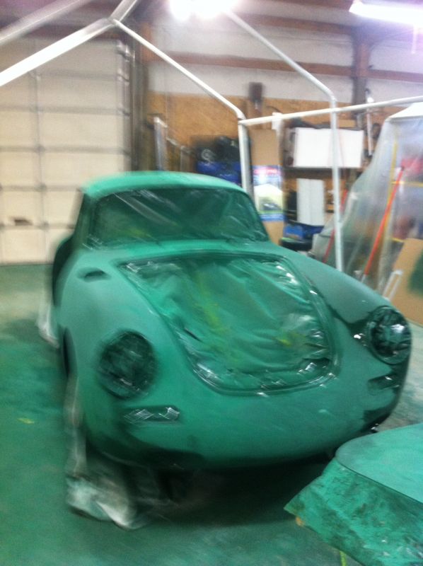

          Kinda maybe, green soon. Got side tracked by a engine build for Tom Olsen.
          • #35

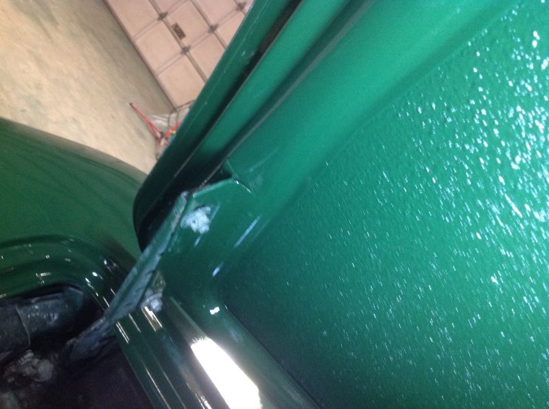

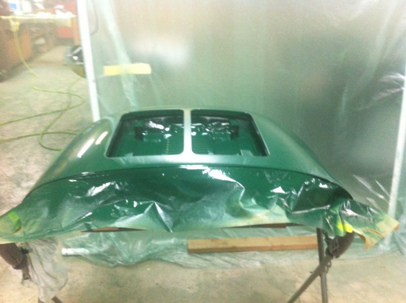

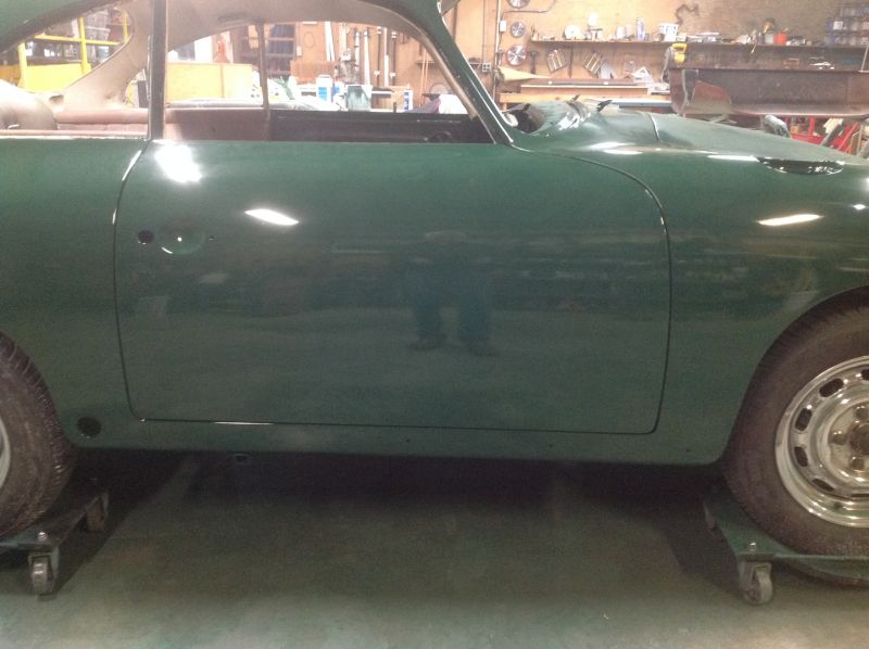

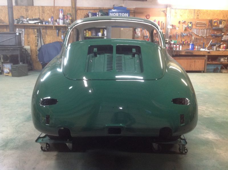

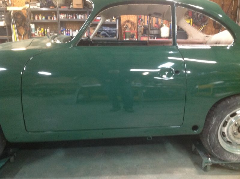

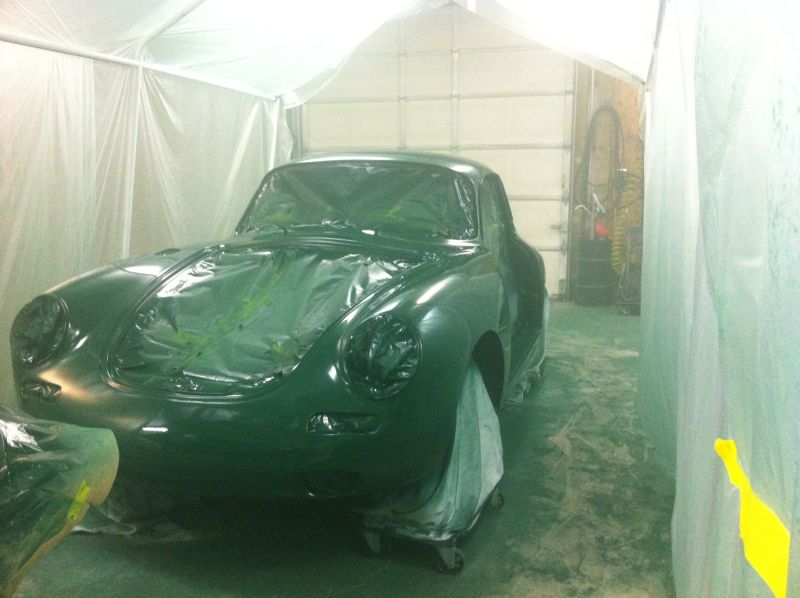

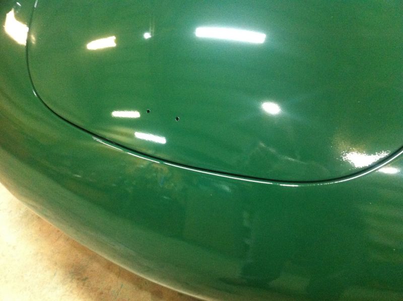

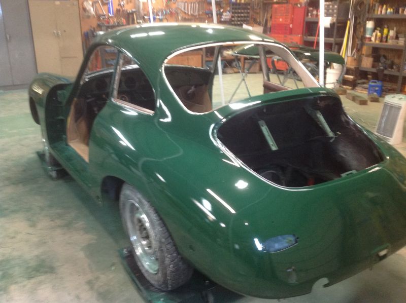

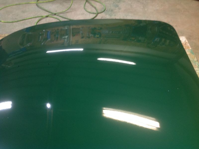

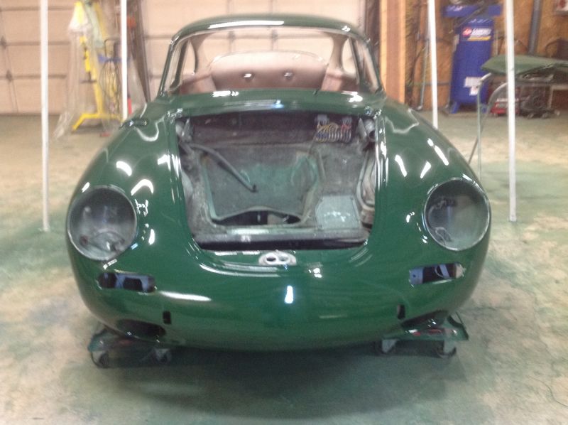

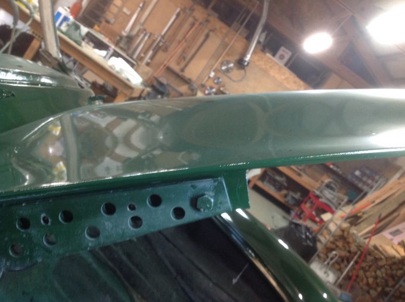

            Well it's green, 3 liters of paint in multi coats. I can't say I was overly pleased with the single stage PPG paint, but it looks good. Wet sand and reassemble next week. Should be ready for glass by the end of the month.
            You can count the screwdrivers 15 feet away on the wall in the reflection.

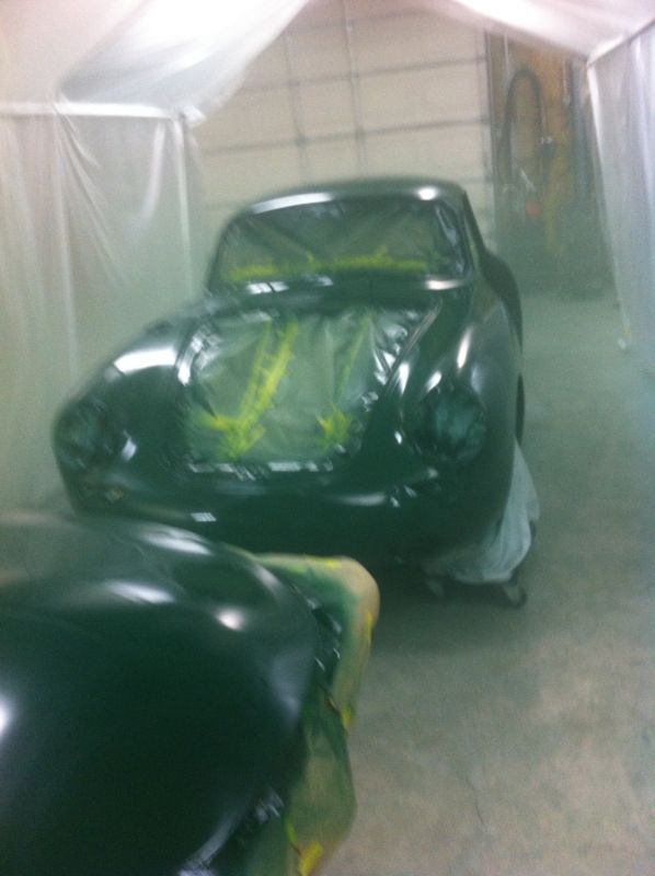

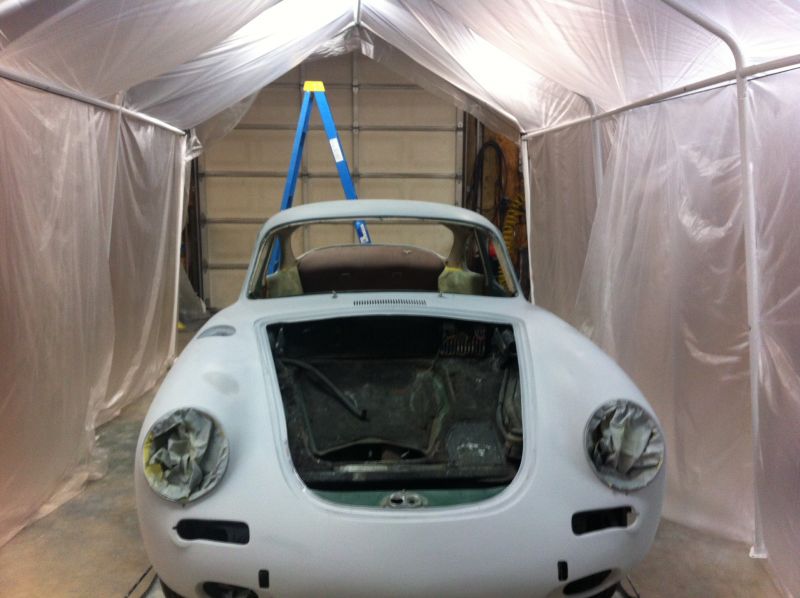

              Nice job! I really like the color. Is the mist in the air from the overspray or something on the camera lens? Did you use any fans to get rid of the fumes? The reason I ask is that I've got the same type of set up and issue.
              • #37
                Jon
                It's a little dusty. Looks bad because of the defused light from the plastic.
                Make a board from plywood about a foot tall, to fit at the bottom of the garage door,. Mount a couple small fans in it. Little ones 6" or so, like computer power supply fans. Not much air flow required, especially in the winter. It was about to snow here and the shop was 85 inside when we started, and low flow on the exhaust to keep the heat in.
                Cut some holes, Mount the fans , slide the unit under the door seal and close the door. I have also used cheap window fans and filters, but the process a lot of air. If the plastic tent is close to the garage door it exhaust fine. Get a fist full of those little Chinese rare earth magnets to hold the plastic sheet. Tie down the bottom of the plastic with a 2x4s or the fan will suck the walls in toward the car. Also look at where your makeup air is coming from, keep the velocity low to prevent too much dust from being stirred up.
                If you only do this every now and again it works fine. I have dome this under a drive on lift in a pinch.

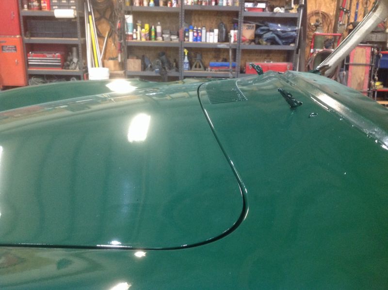

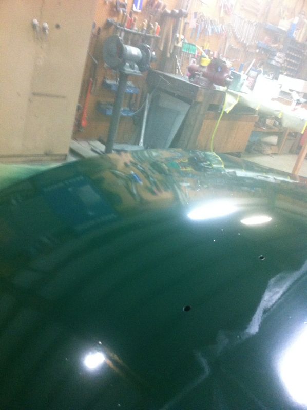

                  It's been a few weeks to cure the PPG paint, can't say I like it over the normal Glasurit. Does not flash or gloss like older paint formulas. It's nice and after the sand and buff it will be fine
                  I have been helping Tom Olsen, building a motor. But back to re assembly of the fresh green coupe.

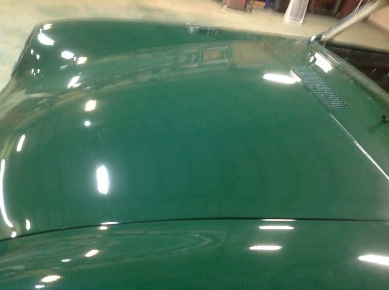

                  The reflection of the tool board gives you and idea of the gloss, not bad at all, will be better after the wet sand.

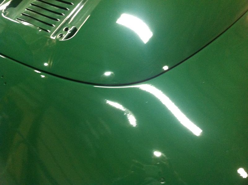

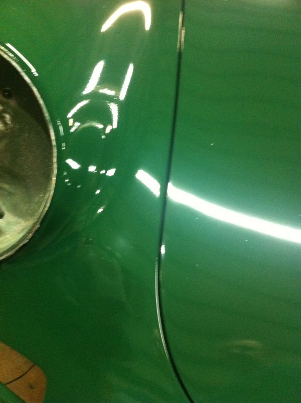

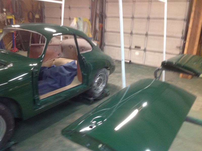

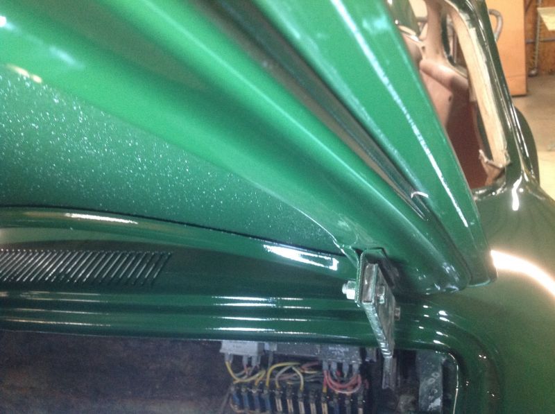

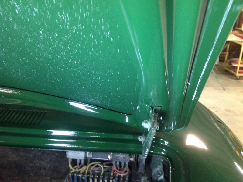

                        Well the kink is complete. 2.5mm gap and the alignment holes in the hinge line up
                        • #42

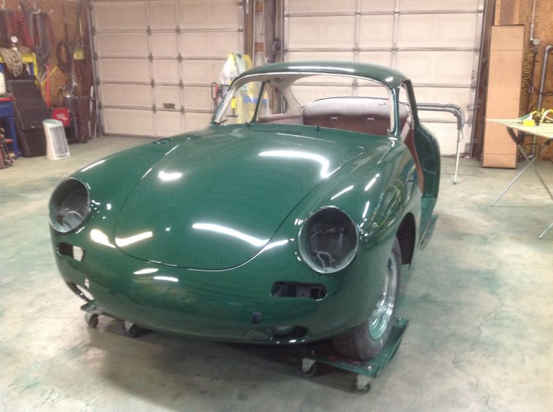

                          Now for the rub and polish, over all it came out very well. All the gaps are equal and everything fits. Few more weeks and it will be back on the road.

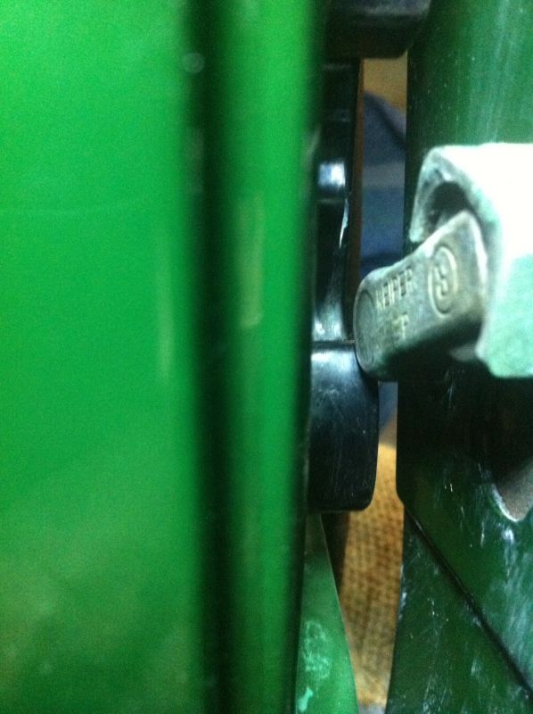

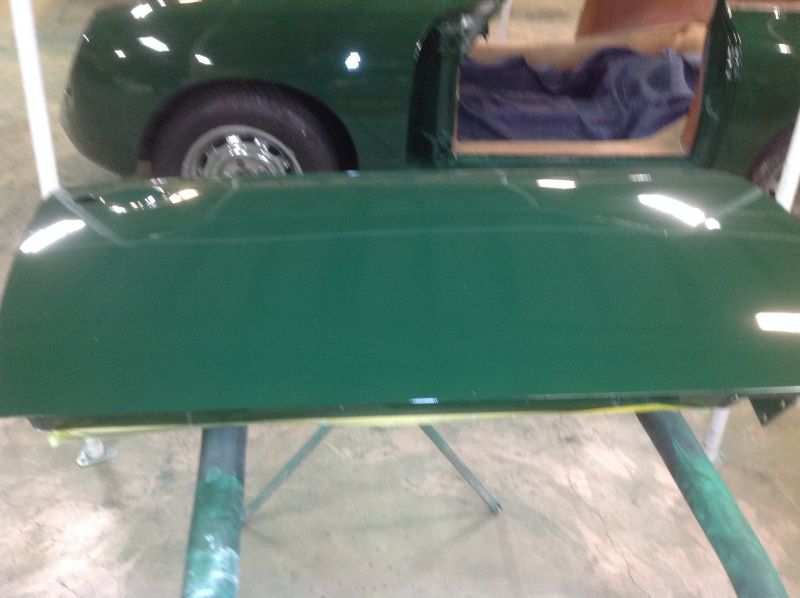

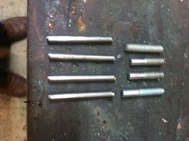

                            Doors hung, gaps done. 2.5 mm everywhere. Also made a couple guide pins to hold the hinges and guide the doors, makes it much easier
                            The longer pins are just drill rod, they are for the trunk and deck lid alignment. Makes the trunk lid much easier
                            After setting the gaps, the door latch bracket needs another small shim around 3mm to get the latch to engage fully. Stock location is sitting aft, only 1/3 of the door latch is engaged when closed, After setting the hinges, be sure to check this. The original plastic latch jam was cracked, This misalignment alignment is probably why. All the door weight was on the front edge.
                            But it progresses, thanks for looking. We are complete.
