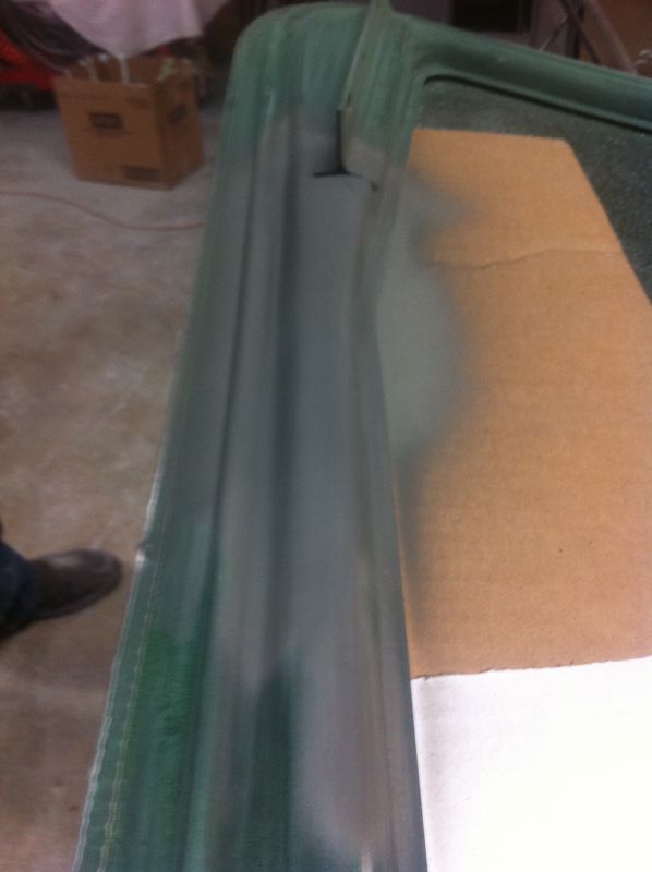

    Both sides are the same, 1/2" gap and collapsed doubler.

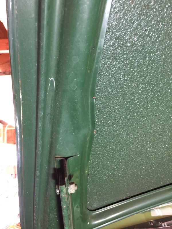

    Not too bad but ugly

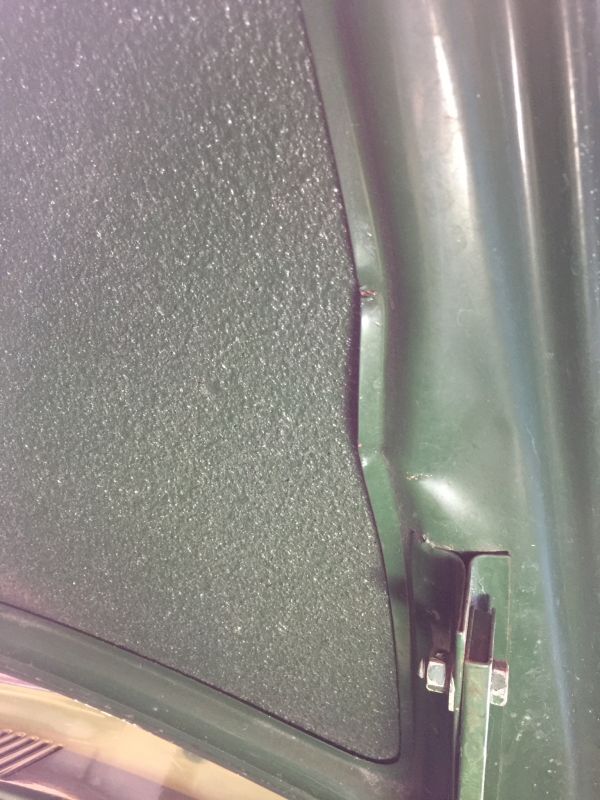

    Original paint, no flexibility left. Flaked off on both sides

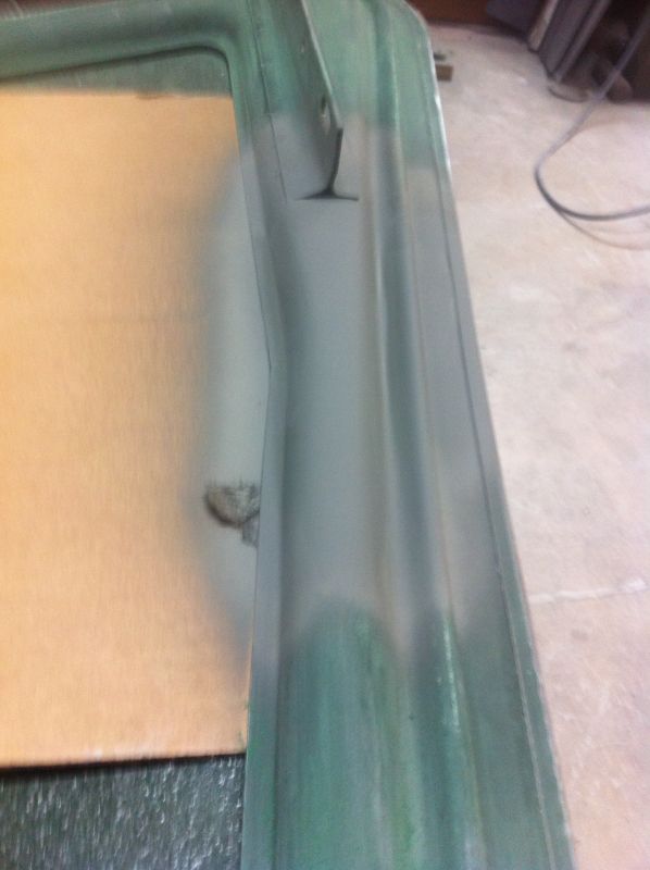

        Was back in N. Carolina for a month but finally got around to the hood repair. The hood must have had 4 coats of paint and primer on it and about a corvette's worth of plastic. Thought it would be pretty easy fix looking from the inside, the inner doubler kink was as expected, but wow the amount of paint and plastic in the nose was impressive. The more forward you went the thicker it got. The entire car is now probably 25-30 mm shorter than when we started. Trams correctly now.

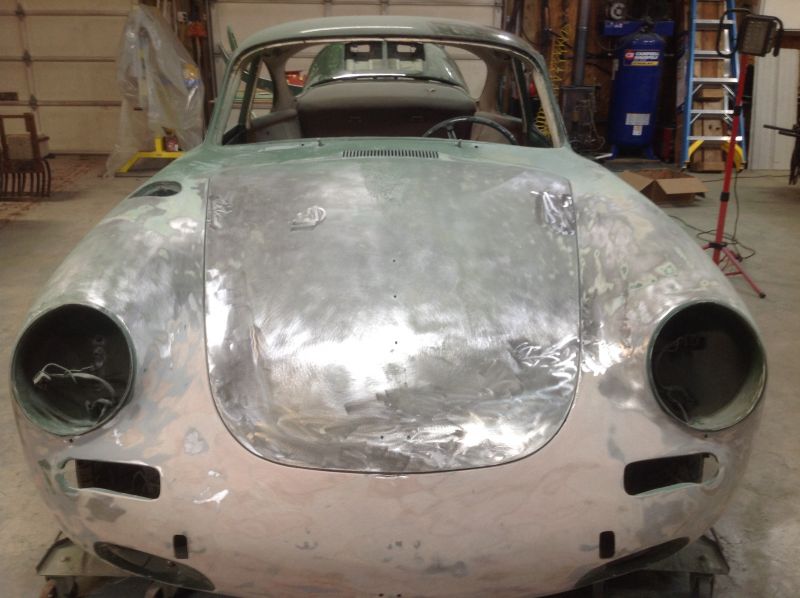

        Gaps look good after the repair, much better that before

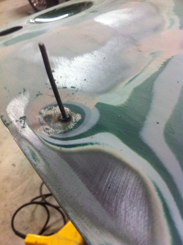

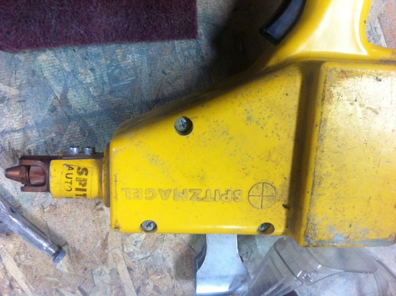

                To answer your question Bob used a stud puller on the stiffener kink. He has a marvelous eye after 40 years of collision repair. He can look at a kink bend or fold and see how it formed. He says " you just pull it out in reverse from the way it went in". Last in first out. On the hood it was two studs on one and three on the other side. A couple pulls while tapping it on the side and the just popped out. It happened so fast I did not get photos. It's a German tool and I guess it speaks 356
                He put the hood back on and with a twist and a elbow brake straightened the skin out. Fit is well, gaps equal, and the hinge pins both line up now. Lots of old repairs to redo now but the major kink and deflector from 10 feet is done. Fitting the doors and repairing the previous errors now. But lots of paint and bondo to bring through.

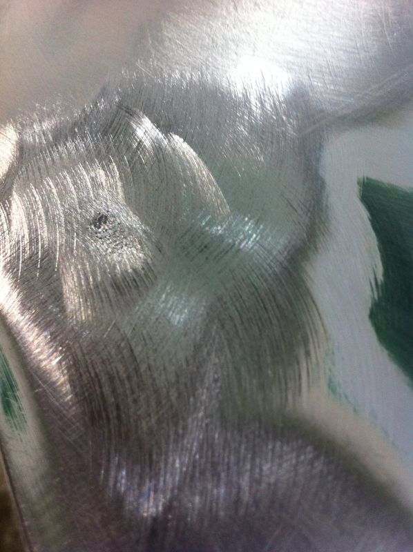

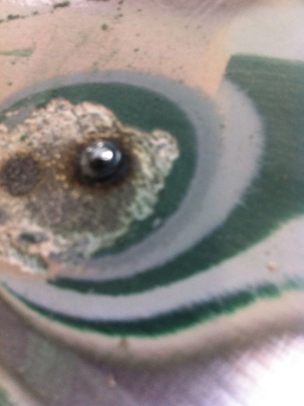

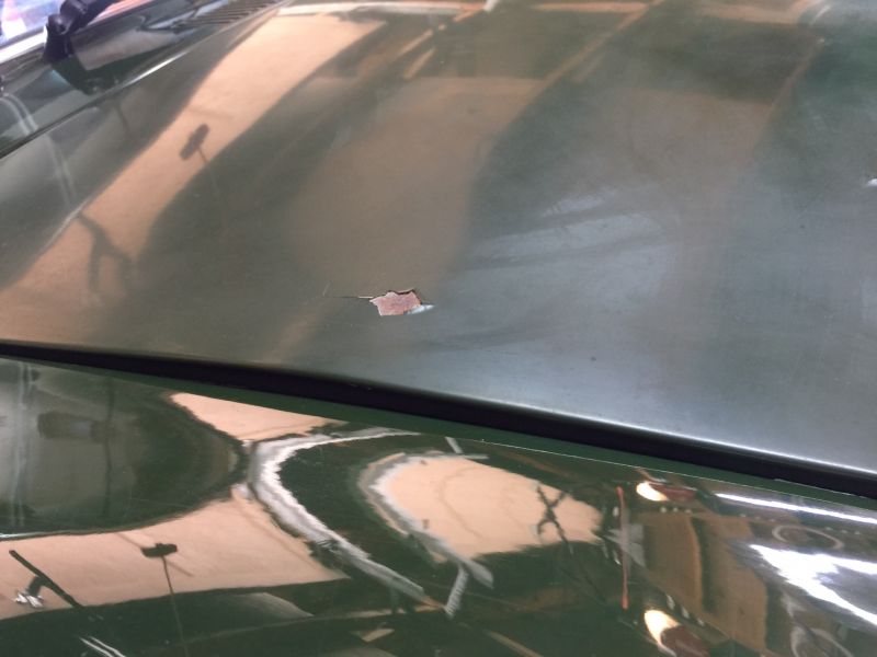

                Here is a shopping cart dent, right at the pinch weld repaired before with mud, about the size of your thum and 1/4" deep. One stud, two pulls and shrinking the crater rim. Less that a minute start to stop.

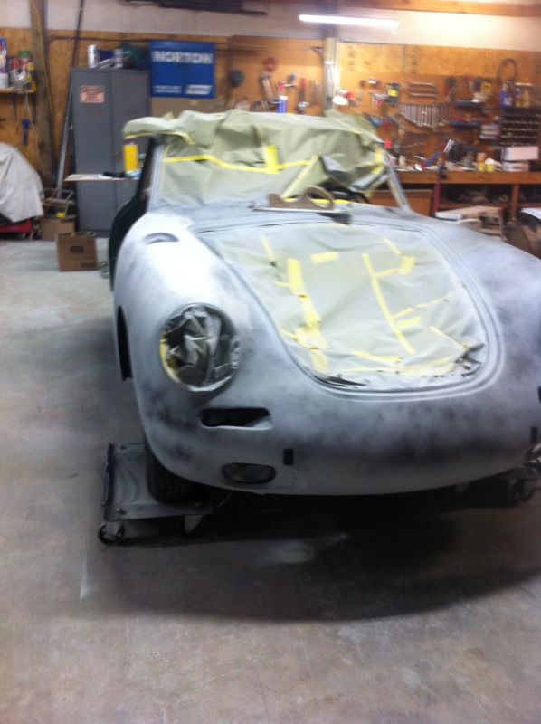

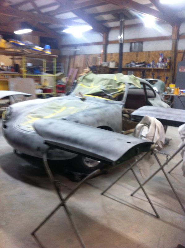

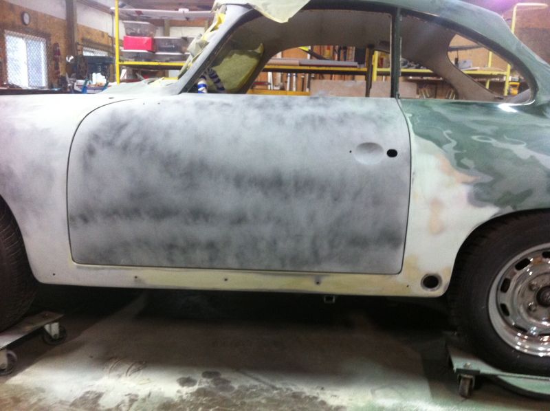

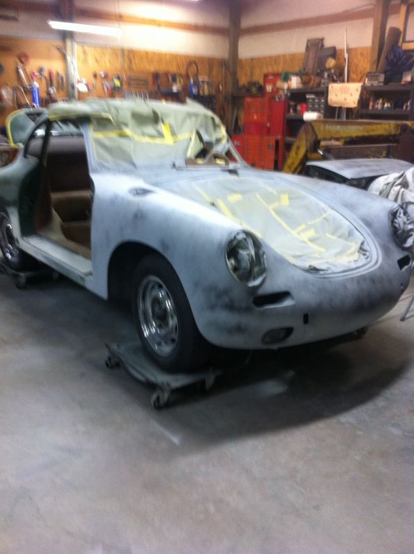

                          Front end now in primer, doors and hood gaps set, now for the long boards, my favorite part.

                            For best results, install the doors and block across the gaps.

                              Thanks Jack. We do that, they were on when we did the fenders and removed all the old plastic, got them flat and gaps adjusted, then took them off to prime and work the shipping cart dings and old repairs in the door skin. I have about 15 pounds of plastic remnants for years of old insurance repairs from the 70's. Some of the plastic was 1/2 thick and cracked because some one did not want to do hammer and dolly work on the metal, they just scuffed, smoothed mud over the dents and repainted it.
                              But it does have good bones, under the 5 layers makeup.
