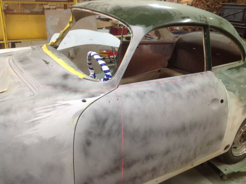

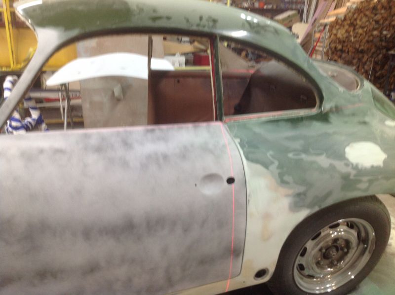

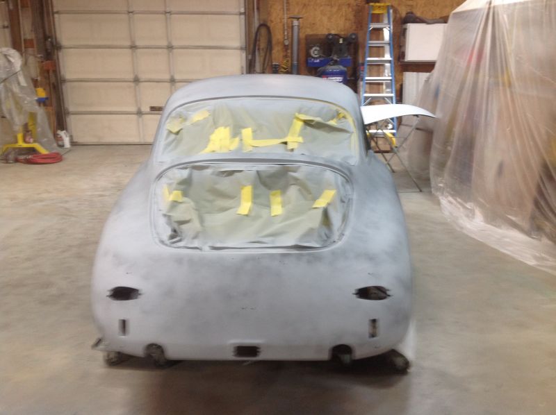

65 C hood kink, new projct
    Gaps done, laser is out to tram and check distances.

    Laser water line to measure panel positions verticals

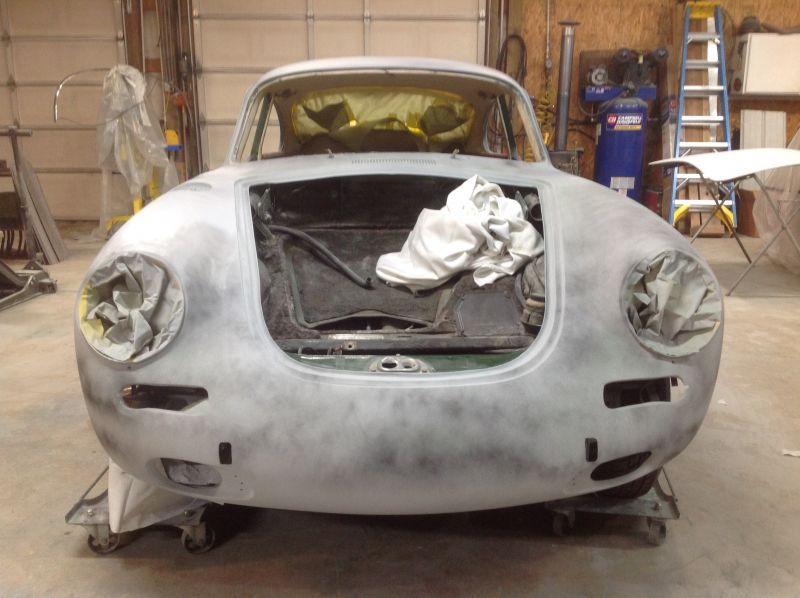

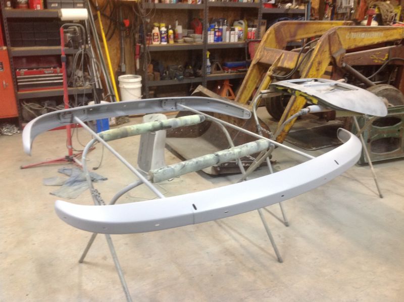

    Looking well overall, now off to order the paint. Have Johns color card to computer match
    IRISCHGRUEN 6406. If it was my car it would be AURATIUMGRUEN 5712 my favorite green on any porsche. I had one in the 60's it polishes up well and does not show dirt. But it's not mine.
      Staying Irish Green? If so, great color! Thanks for the update John.

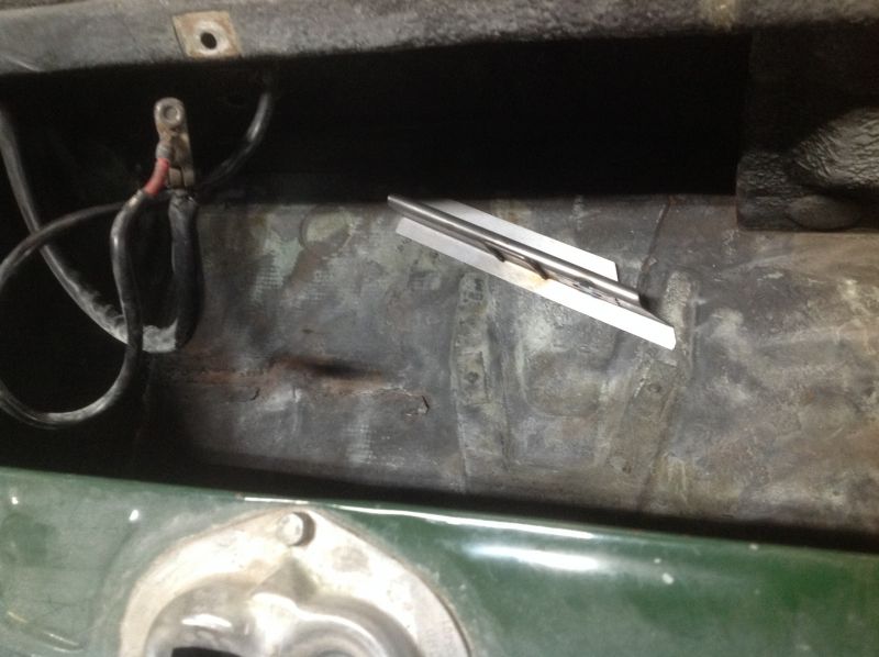

        All the body metal work is finally finished. Have to replace the battery bracket, "oh by the way". But no sweat easy to get at and have a new bracket in hand. Irish Green next week.

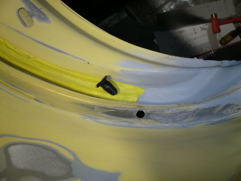

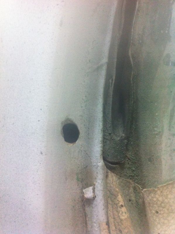

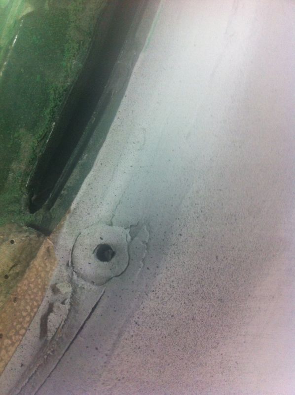

          The saga progresses. This is a Karman coupe, so it has some extra rubber drain plugs that I have not seen before. Under the rear vent windows and a pair under the windshield.
          They are in the lower corner under the windshield seal. The just drain inside, under the dash, outboard of the defroster duct and have no drain hose. It would appear to just drip on your leg or puddle on the mat.
          Passengers side is still there but the drivers was missing. I can not find them in my parts book, anyone have an idea of the nomenclature or part number on these drains? I am thinking these are more of a dam than a drain. Thinking about just countersinking the hole a little using a little seam sealer and leaving the plug out. This is a dry area so it should be OK. Your thoughts.

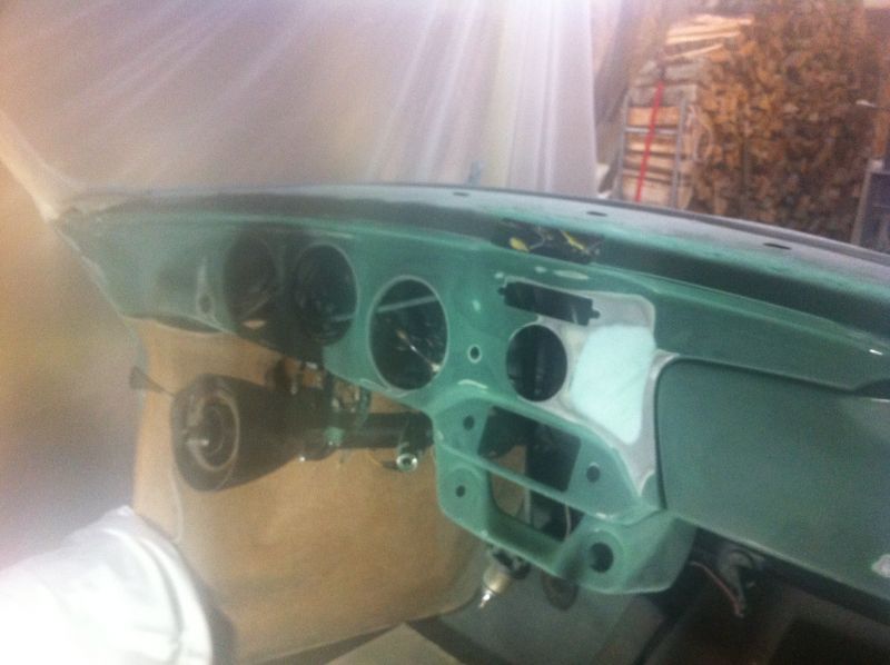

          The good news is there is no shinny green paint remaining on the body now. Dash is repaired and sanded. My fingers are sore from the edges, inside radius on the radio and ash tray. Paint is a week or so.

            John, I added drain holes in the front and rear corners of my A coupe a few years back. What little rust it originally had was directly due to water finding its way back in there with no place else to go but in which rusted out my Original dash topper and the upper left inner corner of the engine compartment. Regardless of how new the seal is some moisture will get in between there so I prefer the idea of giving it an exit. On your car I'd make the existing windshield holes functional by either soldering or welding a nipple to the inside then run some small diameter rubber hose out into the door wells. This is what I did.

              Hey John,
              Karmann added a whole lot of drainage holes and plugs throughout their cars to try to prevent the rapid rusting that these cars experienced. I documented these changes that were unique to Karmann as compared to the other karosseries on my build here on ABCGT. Below is a picture of an OEM windshield drainage hole and plug.

              Unfortunately, they drained into the cabin, so Justin's idea to add a nipple and tube is very good.
              HTH.
                Thanks, I agree. This little hole caused the package shelf on my 912 to rust out. Fixing that was the window corner replacement adventure and new woven interior last winter. Looking to see if I can design a tube or hose from this drain to the wheel well. I like a metal brake line tube welded at both ends, it's just so tight inside to get to.
                  If you use a break line, might be easier to attach a fitting at each end, then bolt like to the fittings.
                  I dread looking under the parcel shelf on my 69 912.
                    if you use a brake line tube I would coat the inside with something to keep it from rusting on the inside and eventually plugging. to install, drill the hole in the proper place then use panel adhesive to hold it in . this way its all sealed up no bare metal were the hole was drilled and no leaks. I've done this with other cars and had excilent results.
                      Holes are there already. I may flare the brake line top and weld it, then grind and polish it on top, exit out the side high aft of the speaker dome. Then cut it flush in the fender/ door well. That way it would not draw the attention of the authenticity police. Probably not see too much water, it's not like a sunroof drain, and no rubber hose to crack.

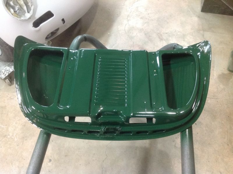

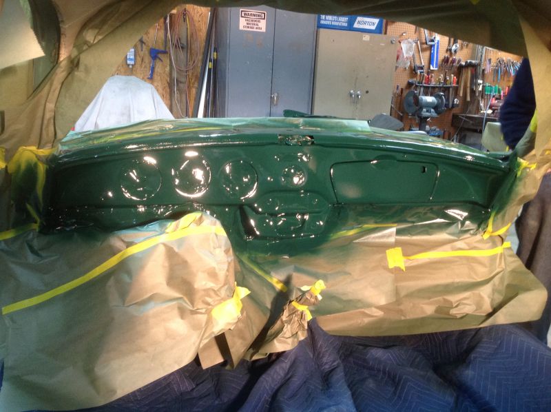

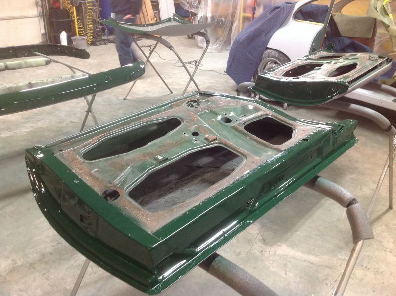

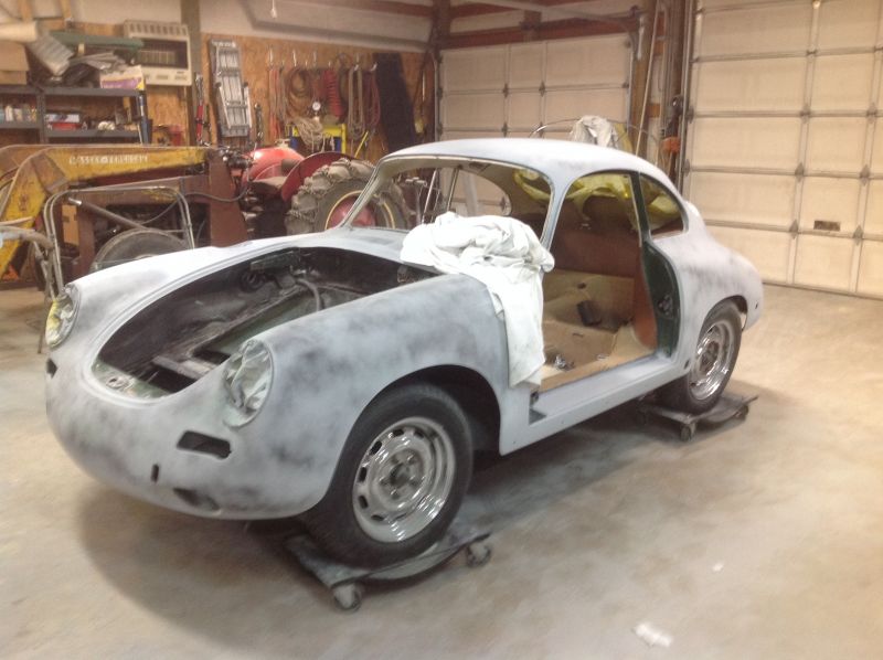

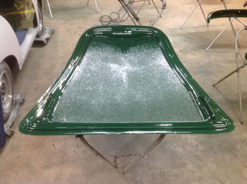

                          Finally got the paint, starting to green up a little. Cut in and drying for a few days. We progress. The PPG DDC Acrylic Urethane goes on quite nice and covers well. Flashes in a few minutes. Works fine, but I still prefer the Old single stage Glasurit
                          Color the body next week sometime. Thanks for looking
