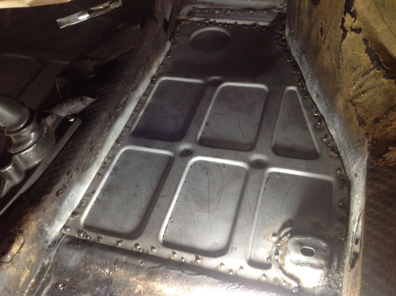

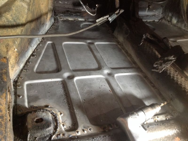

    Plugs in, grinding begins. We are having a heat wave, got up tp 72 in the shop today. Not fun welding with all the heat.
    Both sides fit tight and we progress.

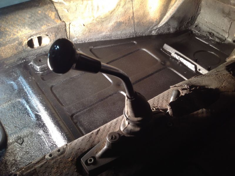

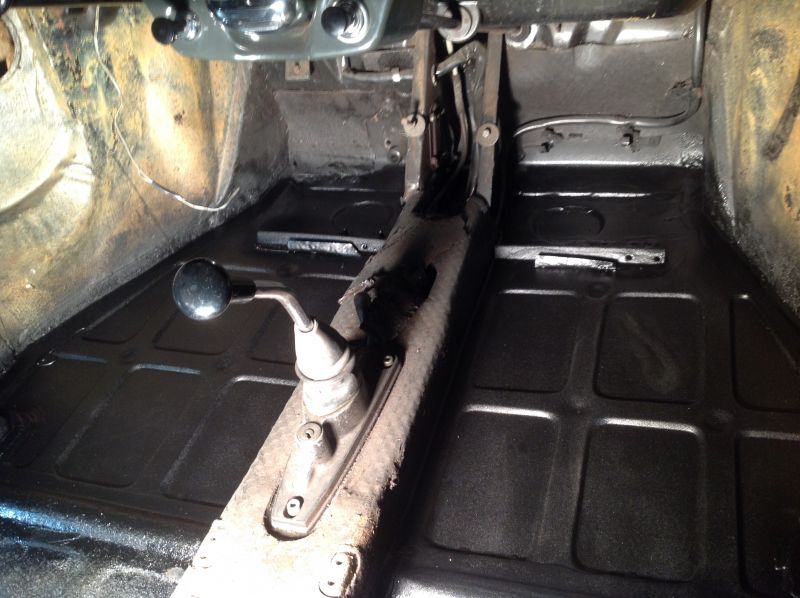

                All done but the pedals. Bob Brooks is just fantastic with metal.
                Use a 3m self leveling seam sealer for the edges. We like it since it's a 2 part, clear and fairly liquid so it flows well into the gaps. Has. 10 minute work life and smooths it's self out. You can brush it for a minute or two but when It's looks like epoxy, and sticky you step back and watch it glaze

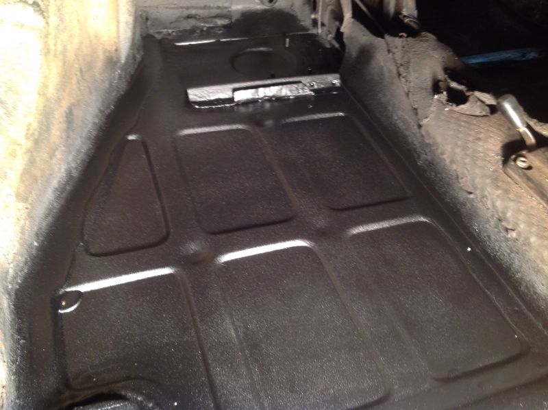

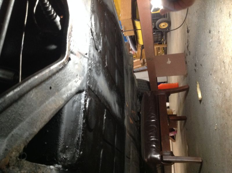

                Under side is sealed primed and painted, awaiting an altitude change for the rest of the under coat removal and treatment. Not doing that on my back.

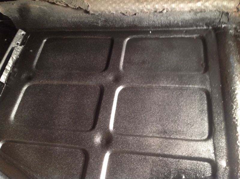

                After the prime, seam seal, a coat of Utethane Truck Bed liner. Not heavy but enough to keep the rain and snow drippings from your feet away form the metal. This I believe will work better than the Shatz. If you do this just be sure you get all the rust first. I will tell you in twenty years how it worked.

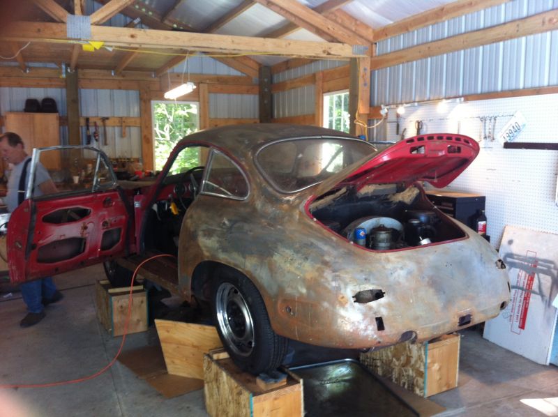

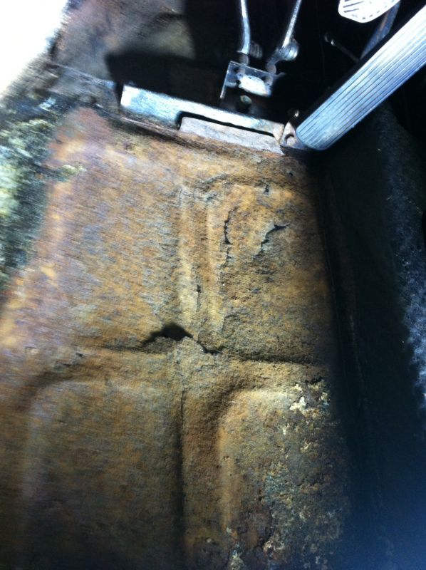

                      Where is it? Bring it over before We reconfigure the shop for terrys 64C coupe repaint. Its not hard, but takes the right tools. We have only worked a couple hours a day in the evenings, this one was not too bad.
                      Next
                      This one will take longer. Terry started the floor, and last fall put aircraft stripped on it it's been sitting in an un heated building for a year. Surface rust and stripper balls. Will be interesting.
