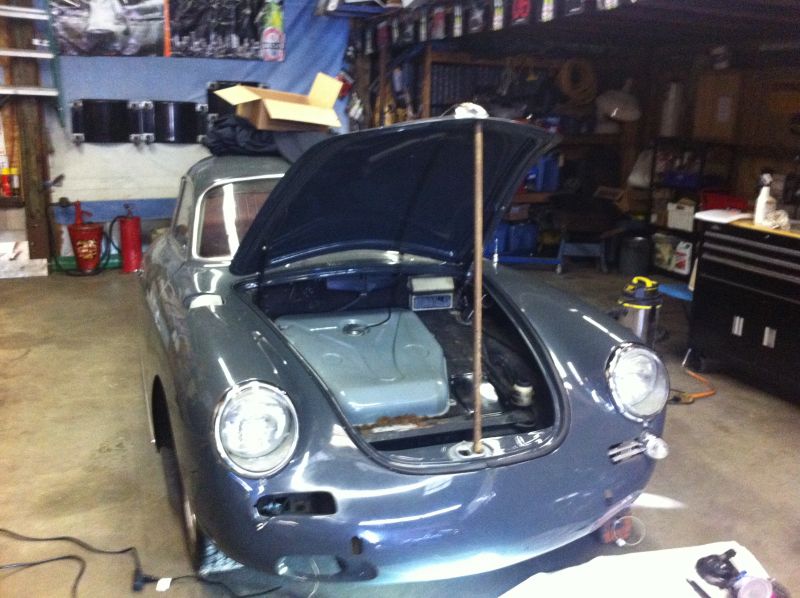

    Well Folks, the 912 Interior is finished so Its back to real cars. A few months back a local guy found a Slate Gray/ red 65C in a friends new wife's garage. Her dad had the car for 15 years started a restoration,got it to 90%. He fell ill and pushed it in the corner of the garage south of SFO, put the loose bits in boxes and threw a cover over it.

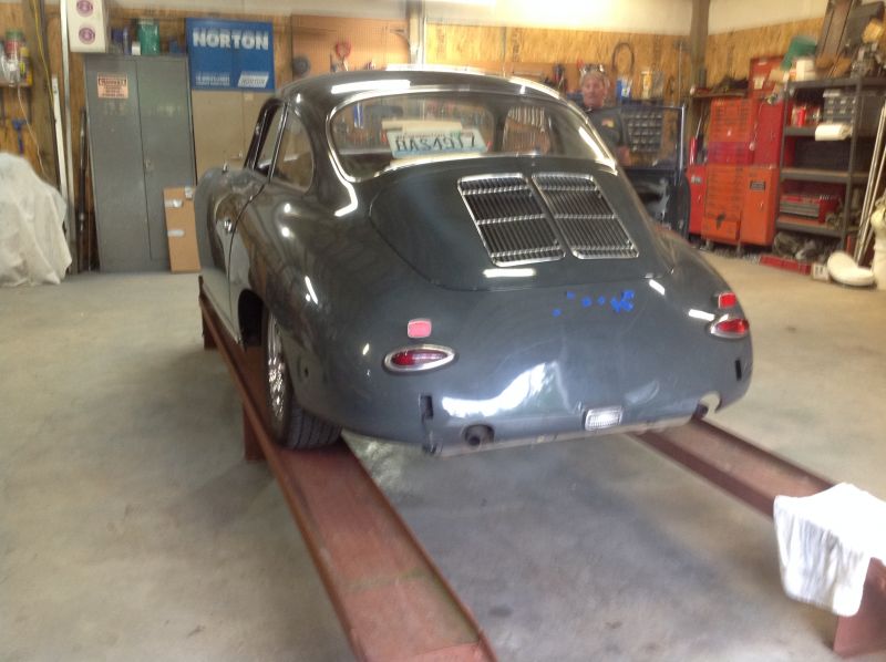

    15 years later he daughter inherits the house, contents and car still sits in the corner. She marries a friend last summer, he wants it out to make room for his Miata, and Cliff Buys the car sight unseen.
    I looked at the car after he brought it to the island. Its a Jewell. Straight, dry, complete,it took me 45 minutes to verify it had been painted. I had one small drip inside the reflector hole inside the rear fender. It sat undisturbed so long there were little dust dots, from between the weave in the cotton cover. Absolutely an amazing find.

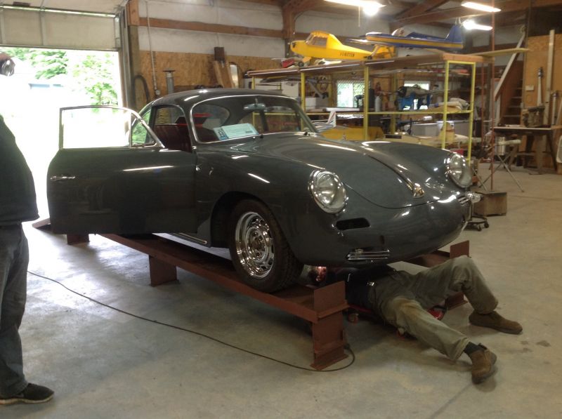

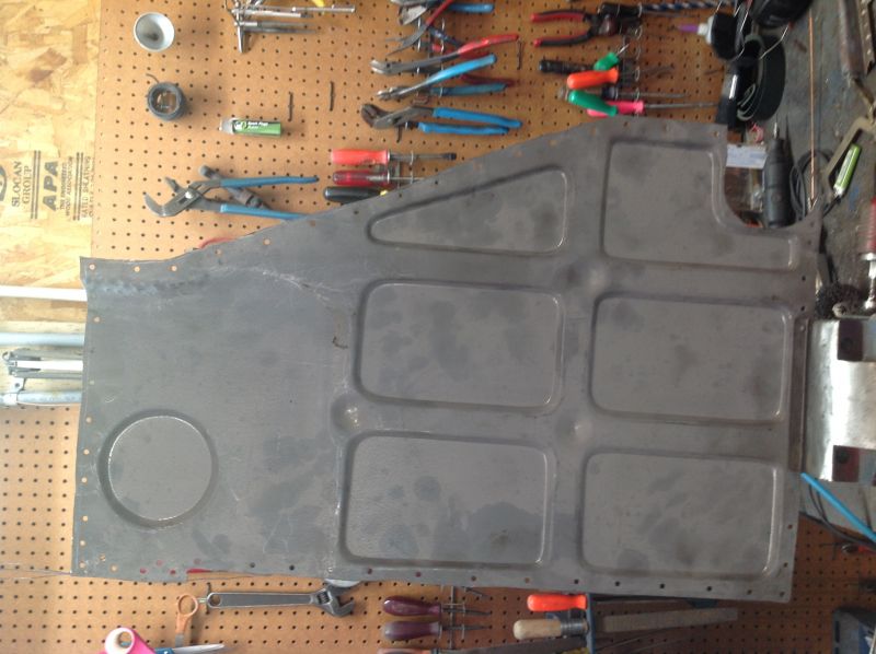

    Floor came in, looks good. Drove the car down to Bob Brooks for the hot work

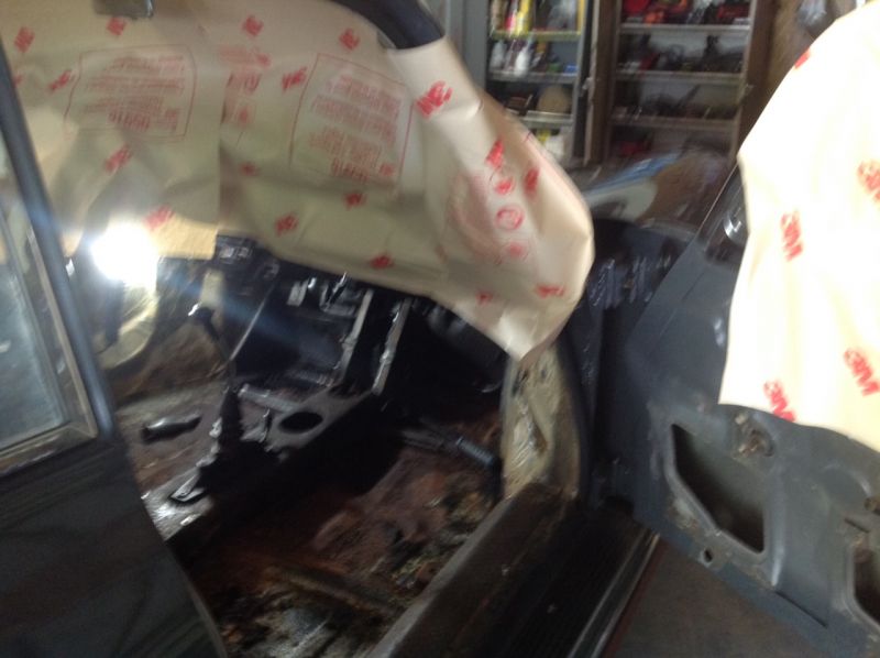

    Up on the rack for better inspection

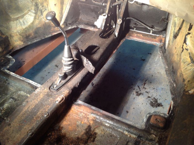

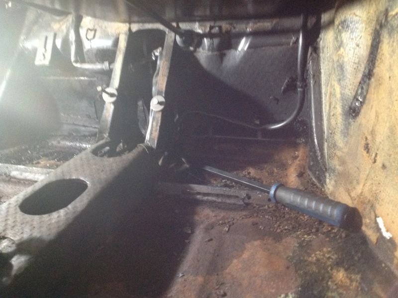

    Inside drivers floor, not all that bad. Only thin under the drivers feet, pedal area good, aft of the doubler still original and bright under the sound deadening

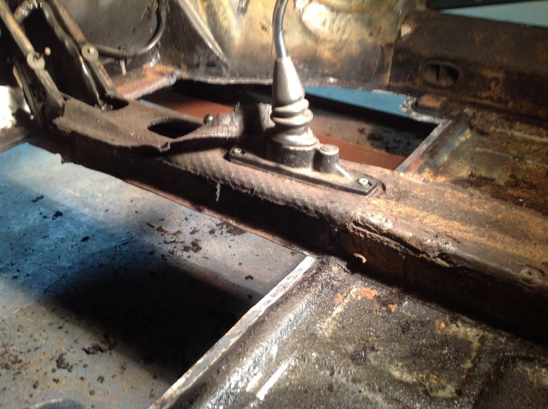

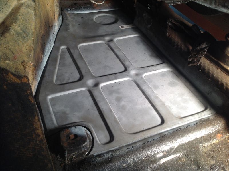

    Passanger side is still intact, bright under the tarpaper. Debating if to do the front half complete or just the drivers half

      My $.02...just do the drivers side.
      Lets see what the pros say.
        Damn, I thought Mr. Brooks is a pro......so I'm gonna say what he already knows.
        Here's what I think, not 'know'; (1) if I had it to do over again, I would have cut out and replaced the same quarter of the floor in the C-2 I'm finishing now, but stupid amounts of time went into straightening damage and bad prior 'repair', not rust, and it was to be able to say honestly..."The whole underside is ORIGINAL." That rust doesn't allow that honesty unless it's wire-brushed, coated every which way from Tuesday with POR-15 and a stop sign is riveted on the inside, under the mats...like 'back in the day.'
        (2) I have NEVER said..."damn, I didn't need to cut that piece all the way to over yonder, it's better than I thought." It's always worse than it looks.
        (3) good 356, so do it at least 'half' right and use the whole front half you'll need to buy. Before pressings or 356s had enough value to buy a Factory part, under the tutelage of Jack Heron, I made each section over a block of steel and joined like quilting, just fixing what was bad AT THAT TIME. That was then, this is now and the parts are cheap compared to labor, but I'd do a very detailed search of the whole floor, based on the iceberg theory of what's seen at first.
        But that's an opinion...and thankfully, "it's not my job."
        It will be good to see what others think.

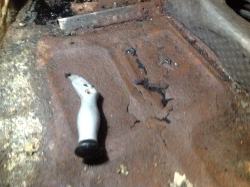

          I am not a pro, just old. I bought the front half of the floor from Al. I plan to wire brush the underside today and tomorrow, if that's good I may splice in part of the drivers side. Its good forward of the toe board, and about 4-5 inches around the perimeter, seat mounts etc. Looks like I have good bones to tie into.
          Their only cracks from the tire. No flakes or exfoliation scales just rust dust. The photo has some of the padding chunks, but if you look close, its just cracks. I am in a quandary, I want to keep it as original as possible, but stop the rust. I am thinking about Formic acid and the POR before the Wurth Schutz on the entire underside when we are done.
          The damage is not all that bad. It just flexed from the weight concentrations. If it were my car, I would treat it and Put "All Metal Filler" over the cracked area re undercoat and keep driving it.

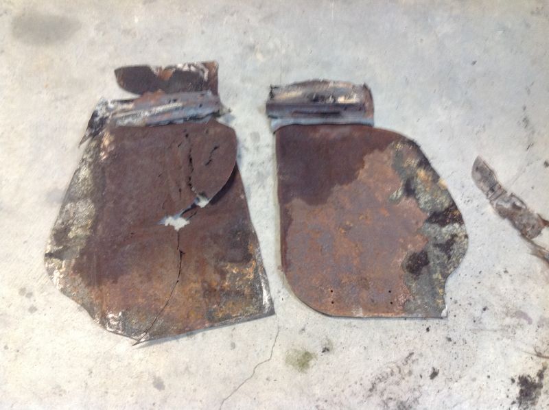

            Floors were not too bad. Drivers cracked and the passengers was thin forward of the toe board. So off to work we go. Pushed up the floor and the cracks filled but not weldable, .15-.25mm remaining. Cut out both side so they will match.
            Remnants

            Looks like most of the damage was trapped water under the sound deadening or between the under coat and floor pan.

                  The interior and seats were pulled for cleaning. While doing the brakes and hoses we put the spare tire in the drivers side and sat on it to reach the pedals. Over a couple hours of squirming around on the tire, it flexed the floor. The wheel was on the cross brace, tire sidewall on the center of the floor. It was foil thin where it cracked, less than 1/4 of a mm. The original sound deadening was still in, we did not notice any flex until there was a 2'x2' black and rust pile of dust under the drivers side on the floor.
                  The original inspection and tap test, spring loaded center punch test were fine. Floor seemed solid and original. Turns out in a couple places 3/4 of the original thickness was powder.

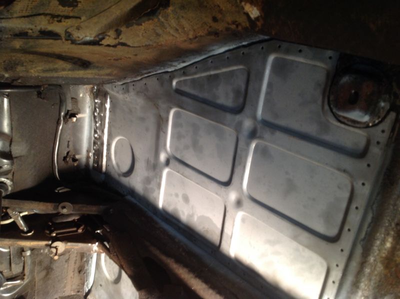

                        Took yesterday off to do a couple sets of carburators. I love building Solex's Today fit the patch panels. Did the final filing and fit.
                        Panels were a little different than original floor but not enough to make a difference.
                        Welder up tonight, a little hammer work around the seat pads but so far so good.
