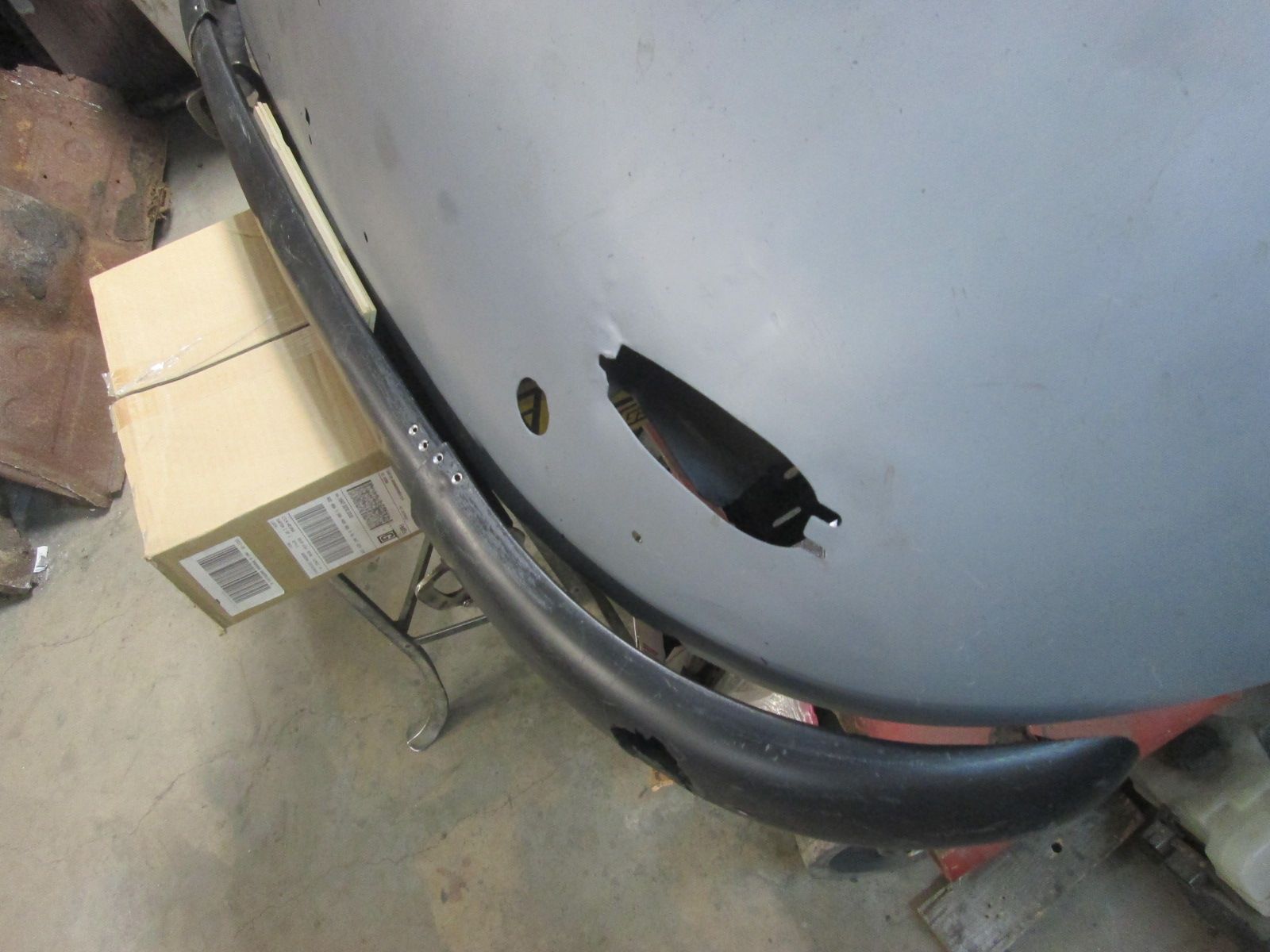

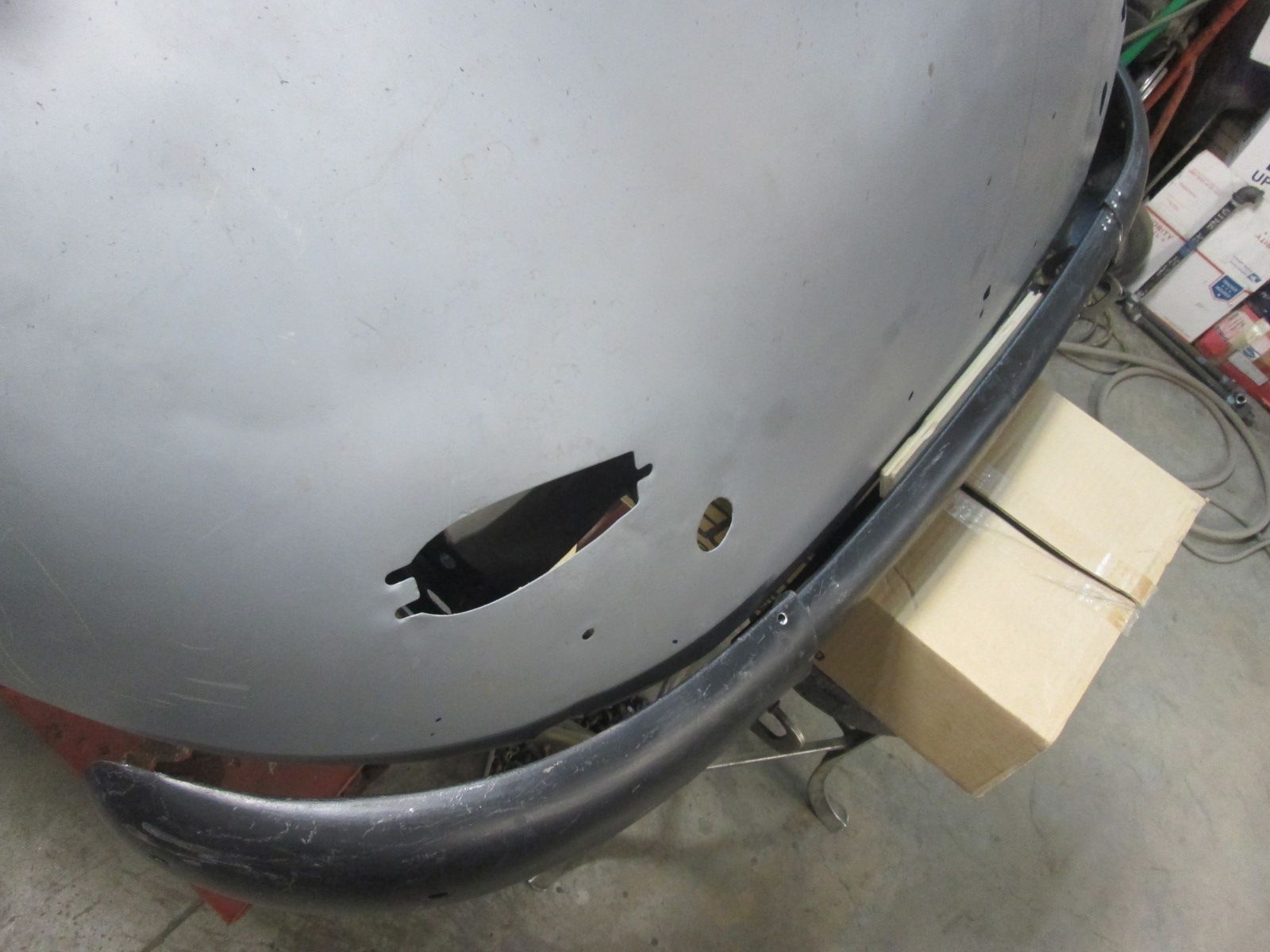

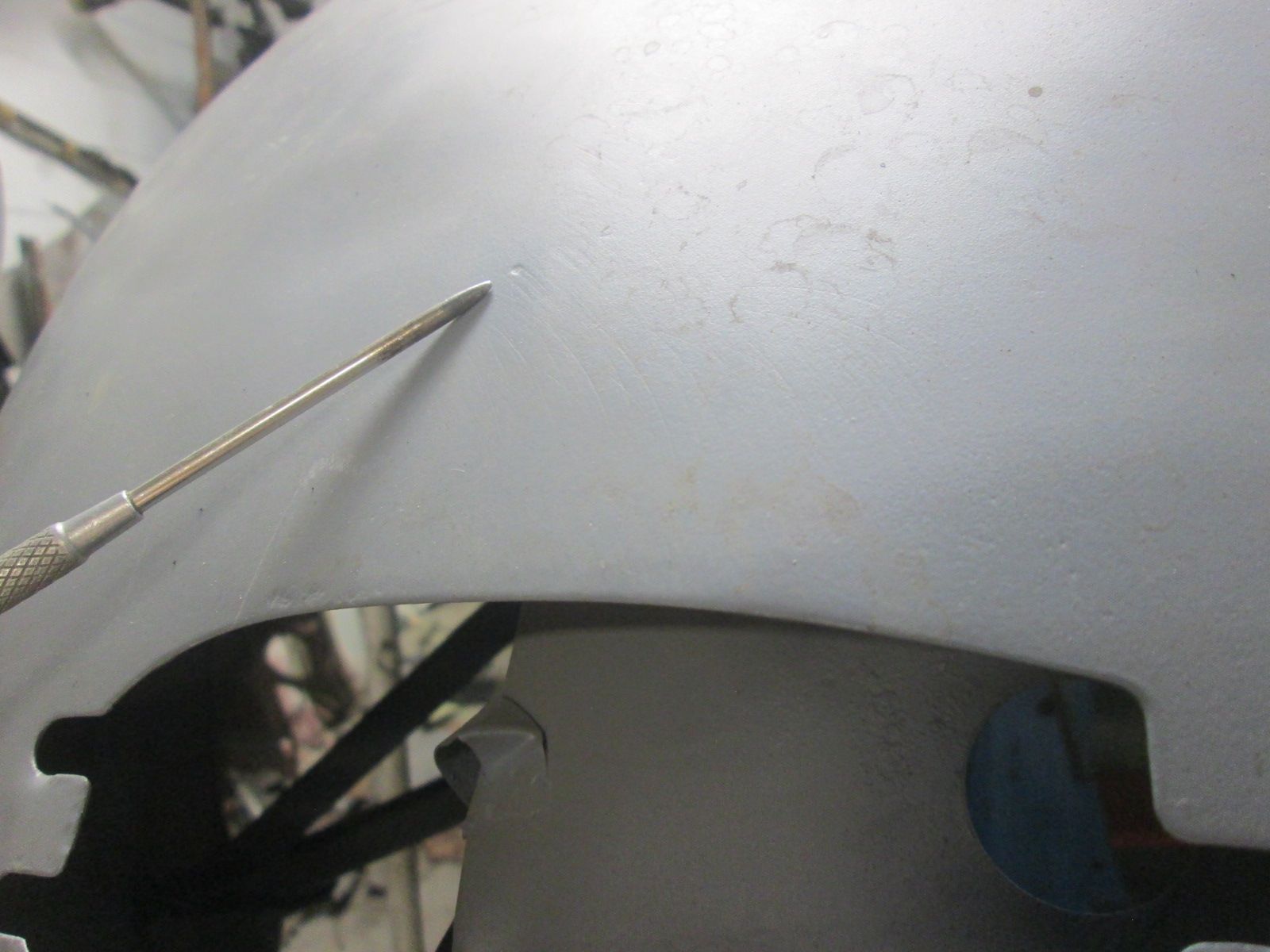

    Took a hard detailed look as to why this factory T2 rear bumper was so oversized in its fitment against this particular tail. Again, the example 356AT1 does swing wider at its corners but not to this degree.
    Click image for larger version  Name:	IMG_2918.jpg Views:	3 Size:	178.9 KB ID:	116694 The embossment for the coming T5 reverse light is the obvious "transitional" detail but there is more to it as this rear bumper issue began to highlight.
    Click image for larger version  Name:	IMG_2928.jpg Views:	3 Size:	158.6 KB ID:	116695 Again, after taking a really hard look at it I finally noticed the detent markings for the eventual T5 reflector bases above the tail light; both sides.
    Click image for larger version  Name:	IMG_3196.jpg Views:	3 Size:	162.4 KB ID:	116696 Then there are these later drain holes in the corners. Definitely an evolutionary thing.
    Click image for larger version  Name:	IMG_3031.jpg Views:	3 Size:	225.2 KB ID:	116698 Confirmation against this loose T1 tail section with the typical teardrop update from way back in the day. The tail is relaxed of course but it still fills up and sits well into the profile shape of this bumper. So the problem isn't with this rear bumper.
    Click image for larger version  Name:	IMG_3000.jpg Views:	3 Size:	170.1 KB ID:	116697 By contrast this tails' profile tapers and narrows much quicker; its different. You could easily assume this was just an A rear tail with a simple embossment add on change to the middle but coming to find out that the entire tail section is subtly different. The bumper is 356A and this entire tail is 356B. It was beginning to make sense as to why the fit was so off. More on this next...
    Thanks for looking.

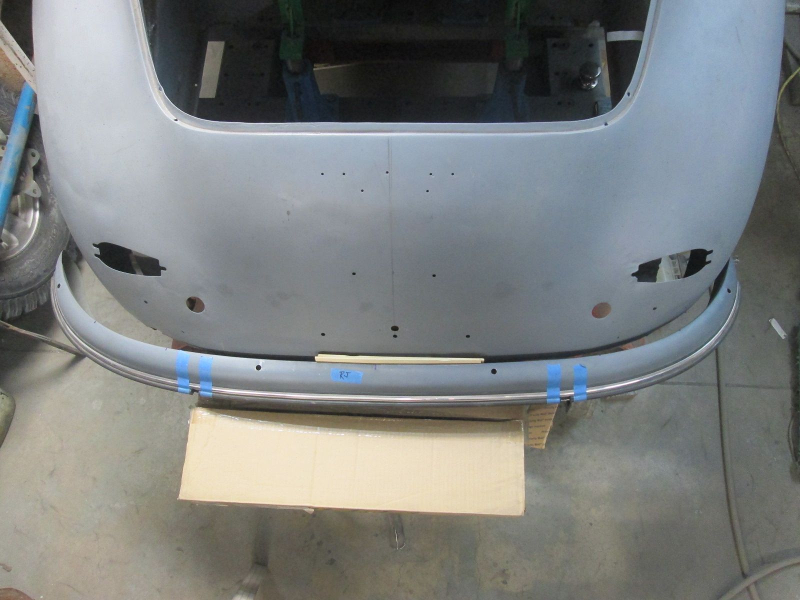

    • Direct overlay for comparison:
      Click image for larger version  Name:	IMG_3032.jpg Views:	0 Size:	236.5 KB ID:	116700 356A tail skin clamped directly to this T5 tail for further confirmation regarding this shape discrepancy. Clamped tightly at the edges in closest position.
      Click image for larger version  Name:	IMG_3036.jpg Views:	3 Size:	228.2 KB ID:	116701 At the center the panels nearly touch so no real changes there.
      Click image for larger version  Name:	IMG_3034.jpg Views:	3 Size:	217.3 KB ID:	116702 Out at the corners is where the differences begin. There is a good inch of space between these two panels out at the tail lights.
      Click image for larger version  Name:	IMG_3035.jpg Views:	3 Size:	218.4 KB ID:	116703 And a good half inch of space between the aprons. There is some light damage to this tail so this is just an average. A good upward view into the right tail light opening showing the same distance discrepancy that was found on the left side.
      Click image for larger version  Name:	IMG_3037.jpg Views:	3 Size:	188.2 KB ID:	116704 Though a bit wrinkly the general discrepancy between these two corresponds with the bumper spacing and reveal issues we are having. Though very subtle these tail skin profile shapes were changed from 356A to BT5. The 356A tail is slightly more bulbous and blunt around the corners whare by contrast a 356B tapers quicker and is slightly narrower; about two inches narrower overall than a 356A version. Always learning something new about these cars...
      Thanks for looking.

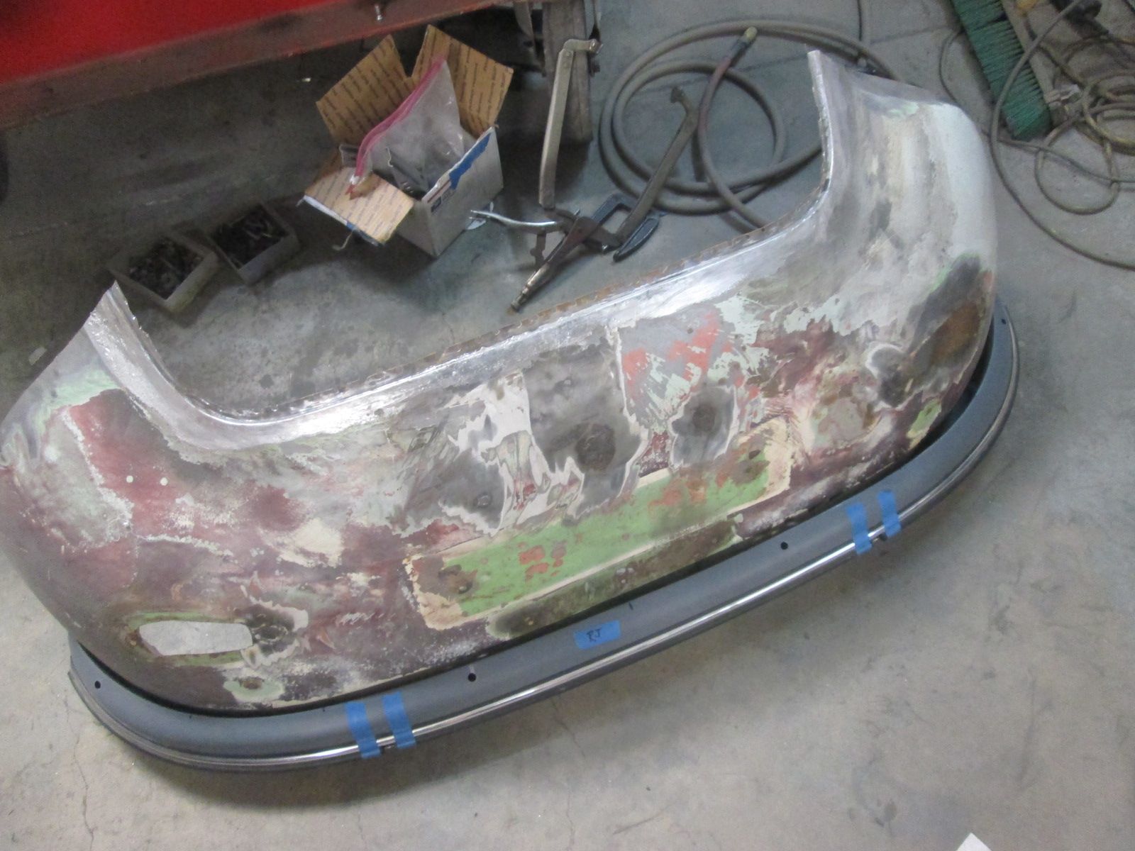

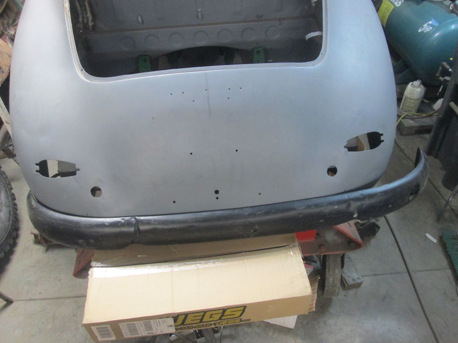

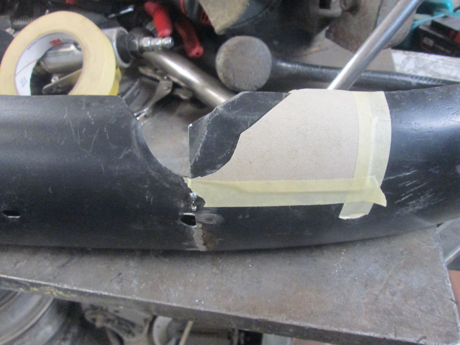

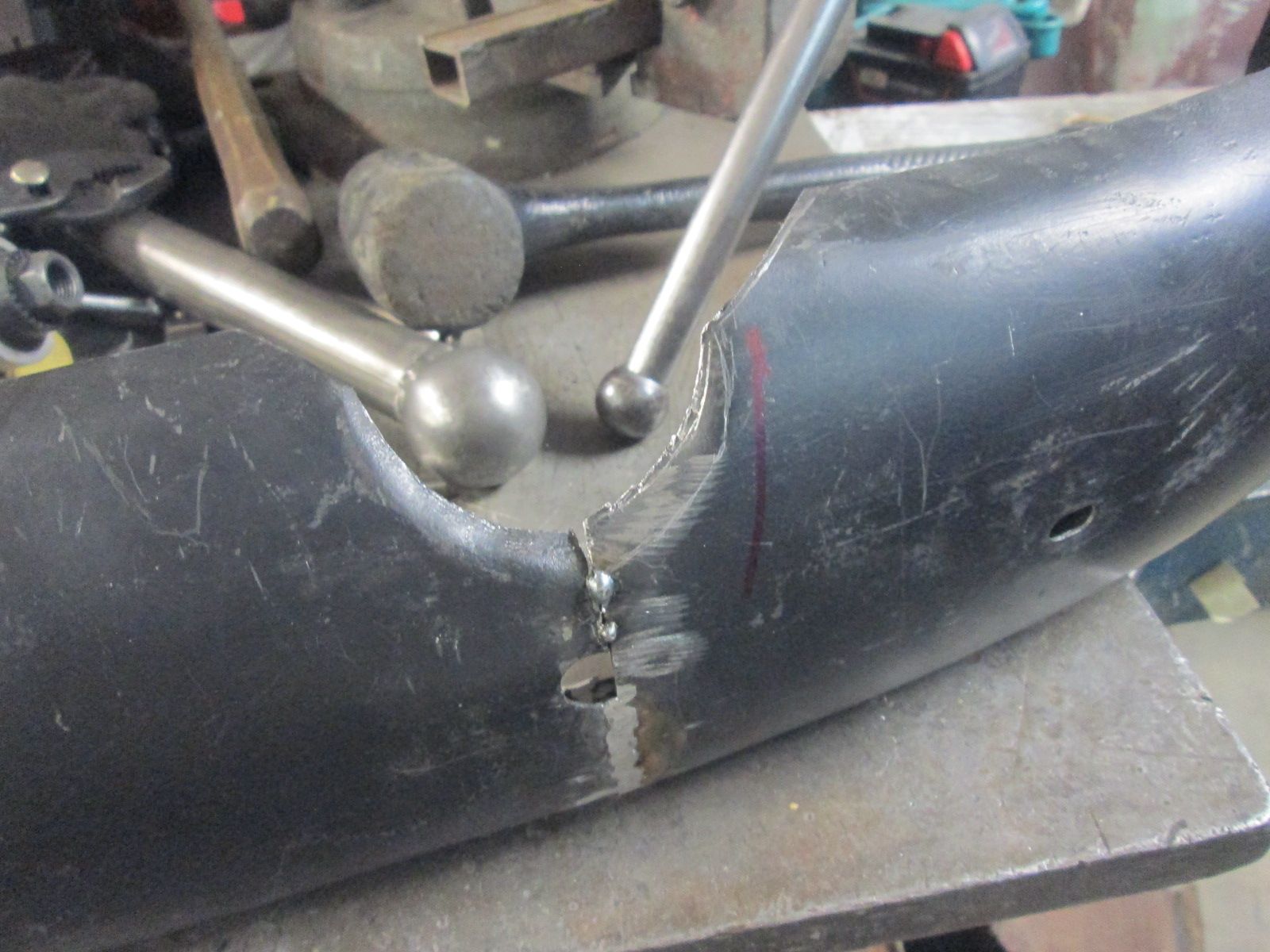

      • Chopping and recontouring the rear bumper to suit:
        Click image for larger version  Name:	IMG_3001.jpg Views:	0 Size:	177.0 KB ID:	116708 We had this rough T2 bumper on hand so I decided to use it as the test bed for the best places to cut and for the needed contour changes. It was punched hard in the left upright causing that buckle but looking past this damage you can see its overall width shows the same fitment issues we are having with the gray bumper.
        Click image for larger version  Name:	IMG_3008.jpg Views:	3 Size:	172.5 KB ID:	116709 The T2 exhaust arches are a limitation as their locations cannot be changed so the best place to start cutting was though the center of those existing arches. During the direct tail skin comparisons earlier I was able to confirm that there was really no notable differences in these panels between the tail lights except for that reverse light embossment of course. The reveal and its shape through the middle matches well here so all the needed changes of narrowing and contouring will be out at the corners.
        Click image for larger version  Name:	IMG_3002.jpg Views:	3 Size:	171.0 KB ID:	116710 For this initial mock up the corners were lapped over the center by one inch.
        Click image for larger version  Name:	IMG_3003.jpg Views:	3 Size:	175.8 KB ID:	116711 And moved over one inch on this side. While not perfect the improvement against the width and shape of this skin was immediate.
        Click image for larger version  Name:	IMG_3023.jpg Views:	3 Size:	174.1 KB ID:	116712 Bumper is clamped directly to the body to better dial in a matched contour fit. Two inches of overall width out of this bumper is turning the trick. Doesn't sound like a lot but in reality its changing things quite a bit, especially how it effected the chrome trim which I'll show a bit later.
        Thanks for looking.
        • Making changes requires more changes:
          Click image for larger version  Name:	IMG_3017.jpg Views:	0 Size:	176.9 KB ID:	116714 One inch removed from each side is our magic number to achieve that uniform fit and reveal with this tail that we're looking for.
          Click image for larger version  Name:	IMG_3007.jpg Views:	0 Size:	161.3 KB ID:	116715 But once we make the bumper shorter and tighter to fit this car the existing deco is going to be too long. The tips of it are going to end up about here; way too long to look right. This deco would have to be cut and shortened and the best place would be under the upright mount area where this bumper was cut.

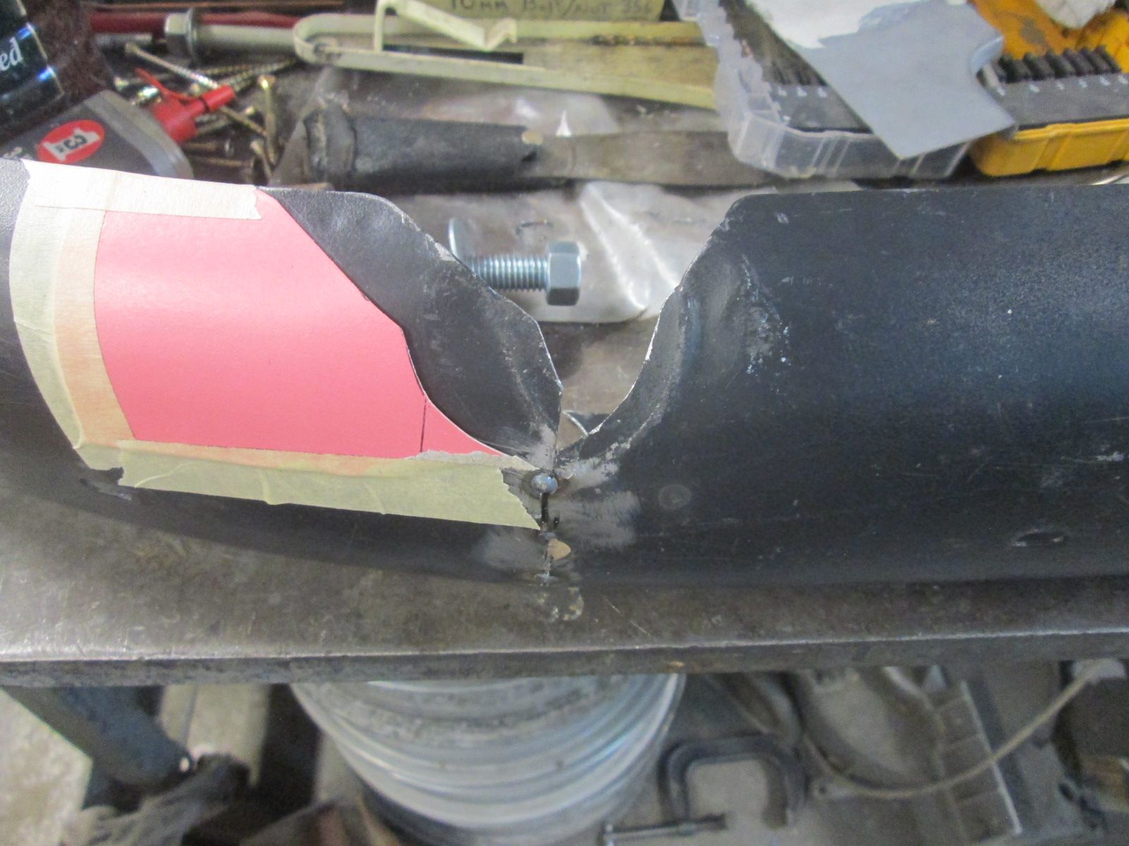

            • Rust and old collision repair:
              Click image for larger version  Name:	IMG_3044.jpg Views:	0 Size:	204.9 KB ID:	116728 Here is how a stock 356A deco now fits. Like the bumper it would had to have been cut and sectioned just like the bumper.
              Click image for larger version  Name:	IMG_3049.jpg Views:	0 Size:	193.9 KB ID:	116729 By contrast here is how short that deco ends up being on a stock 356A bumper. Its no wonder the guy sent it back to me.
              Click image for larger version  Name:	IMG_3025.jpg Views:	0 Size:	197.5 KB ID:	116730 To make the needed changes to the bumper all the internal mounting backets needed to come out. The previous rust and collision damage made this bumper an even more viable candidate for the application.
              Click image for larger version  Name:	IMG_3027.jpg Views:	0 Size:	245.7 KB ID:	116731 The left side inner double bracket was cut apart so I could straighten the residual crash damage back out. This bumper was chemically dipped clean with only some trace amounts of old rust remaining in between the joints.
              Click image for larger version  Name:	IMG_3038.jpg Views:	0 Size:	222.2 KB ID:	116732 The right side lateral mount became packed up with moisture holding muck at some point and completely rotted both it and the skin pictured here. A new bracket would have to be fabricated.
              Thanks for looking.

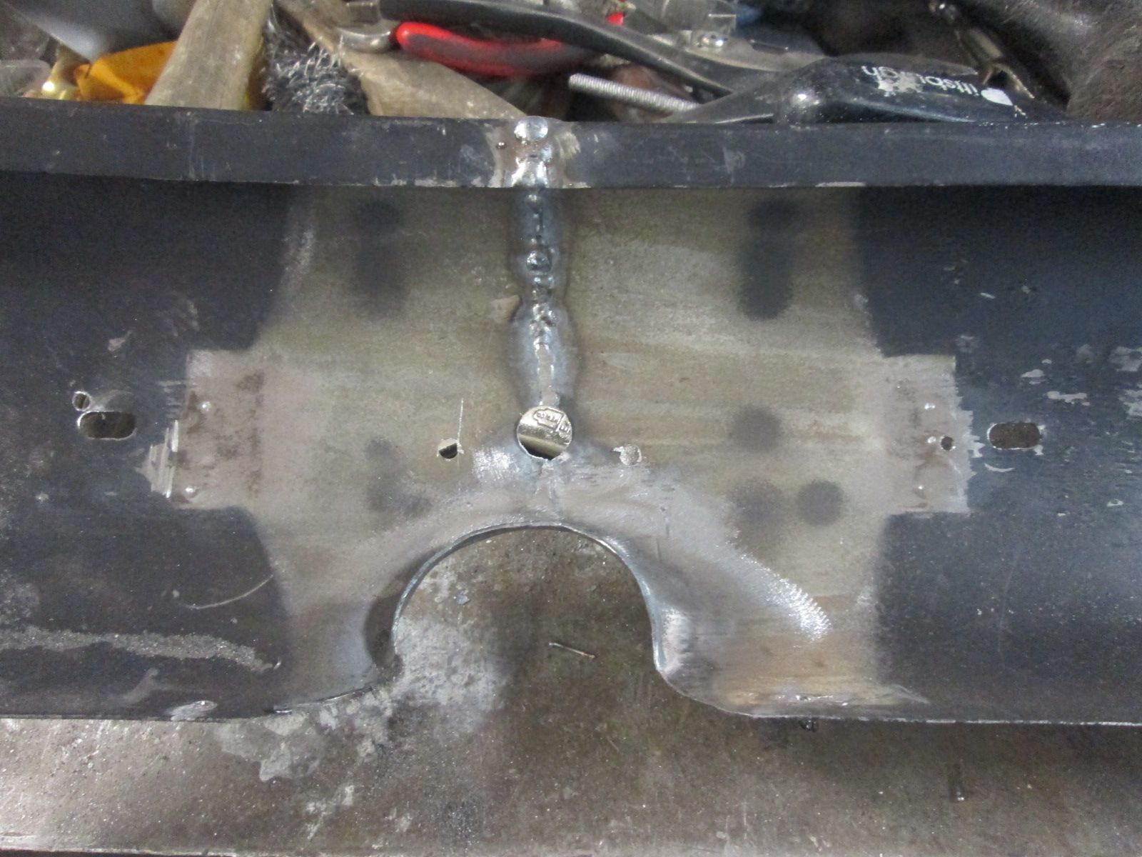

              • Rust repair patch:
                Click image for larger version  Name:	IMG_3050.jpg Views:	0 Size:	201.9 KB ID:	116734 Began with a flat piece of 18 gauge.
ID:	116735Gradually planishing in a soft rounded shape to match the bumper profile.
ID:	116736 All stitched in then onto picking and filing in the final shape.
ID:	116737 Most of this patch will always be visible from the backside so some extra work was required to get it close and as clean as possible on both sides.
ID:	116738 Onto a quick work coat to high light the lows and high spots that still need a bit more finishing.

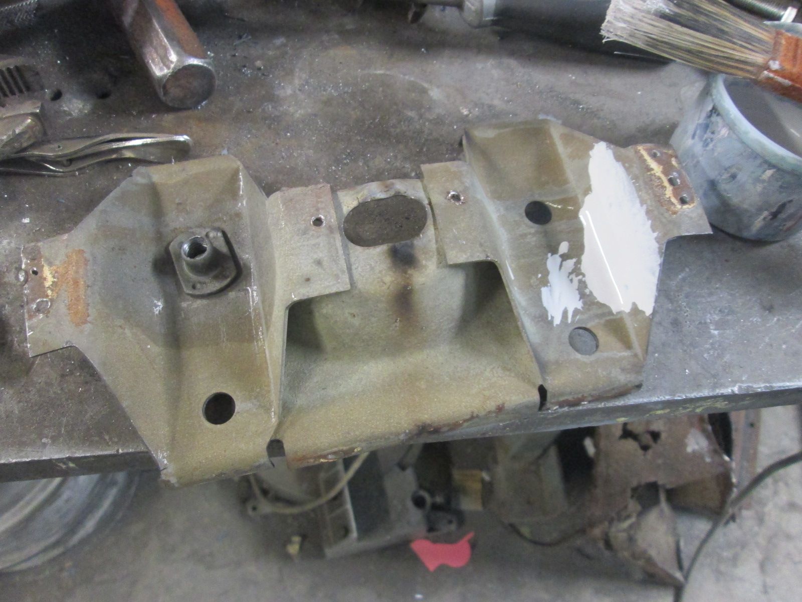

                • Repair patch complete. New bracket mount fabrication:
                  Click image for larger version  Name:	IMG_3055.jpg Views:	0 Size:	230.2 KB ID:	116740 After several rounds of hammering and filing I had chased it about as far as I could. Deco mounted for a test fit against its final shape.
                  Click image for larger version  Name:	IMG_3056.jpg Views:	0 Size:	223.1 KB ID:	116741 Will only need a swatch of filler to get that last 10% out. Onto the bumper mount bracket, second half of this repair.
                  Click image for larger version  Name:	IMG_3079.jpg Views:	3 Size:	225.9 KB ID:	116742 The brackets are a heavier 16 gauge and the thickest I had on hand was 18 gauge and that's too thin to make these out of as these brackets deal with and mount directly to those really heavy gauge bumper irons. In desperation I was onto digging deep into my scrap metal box and eventually ran across the perfect donor. This is an old deflection shield from my bench grinder. Turned out to be the right thickness, with just enough width to cut out a complete part. It even had a shouldered bend at just the right spot; it was meant to be. New part traced out here for cutting.
                  Click image for larger version  Name:	IMG_3081.jpg Views:	3 Size:	218.4 KB ID:	116743 Remains of the donor shield, paper template based on an original and the newly finished replacement bracket.
                  Click image for larger version  Name:	IMG_3082.jpg Views:	3 Size:	221.7 KB ID:	116744 All set, only some final trimming and bending on the flanges left to do and the capture nut. Looks like the originals but most importantly its thicker like the originals.
                  Thanks for looking.

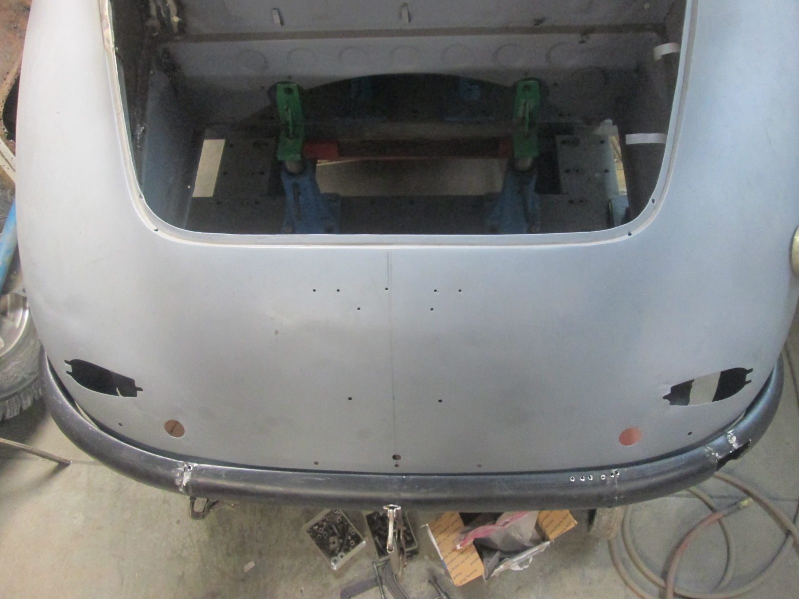

                  • Reestablishing the exhaust arches.
                    Click image for larger version  Name:	IMG_3059.jpg Views:	0 Size:	215.3 KB ID:	116746 Paper template traced out from the original shape. You can see the remains of the old arch has just been moved over that one inch.
                    Click image for larger version  Name:	IMG_3061.jpg Views:	3 Size:	222.7 KB ID:	116747 Trimmed back with both sides of the arch flanged over.
                    Click image for larger version  Name:	IMG_3060.jpg Views:	3 Size:	262.5 KB ID:	116748 Time to reinstall the bracket temporarily so I can mock up the bumperette with funnel to check for clearance.
                    Click image for larger version  Name:	IMG_3065.jpg Views:	3 Size:	221.6 KB ID:	116749 Initial mock up confirming ample clearance with the funnels' neck and out at the sides with the "bell".
ID:	116750 Flipped the template over and repeated the process.
                    Thanks for looking.

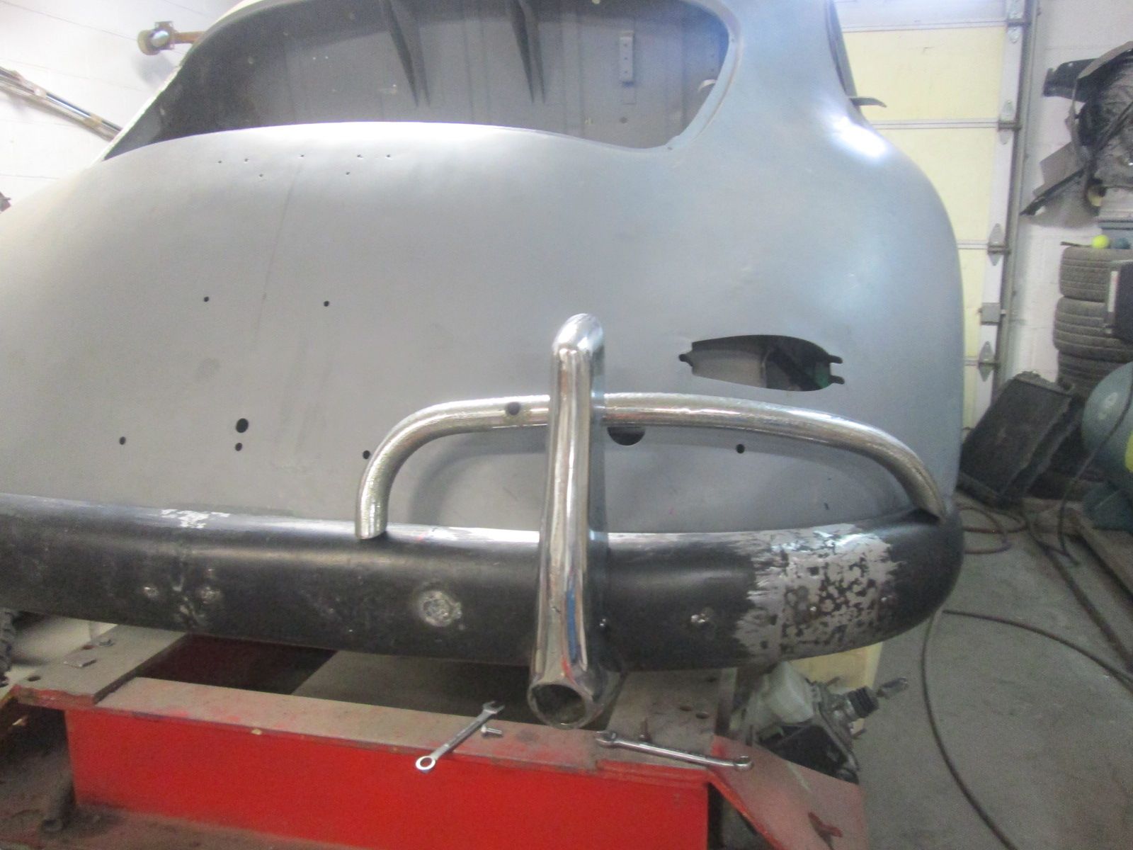

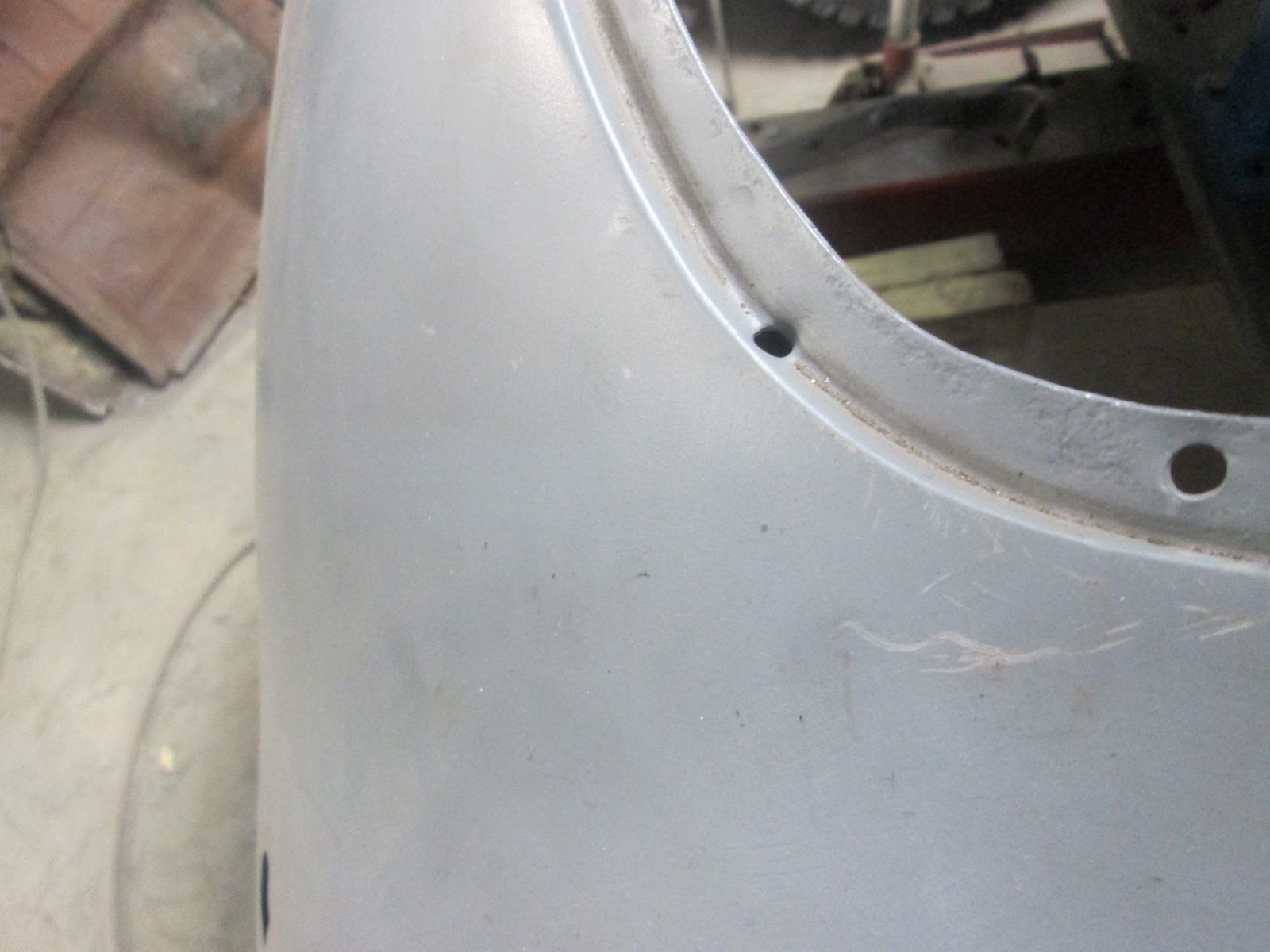

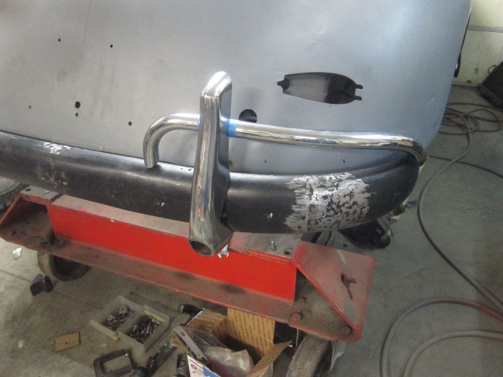

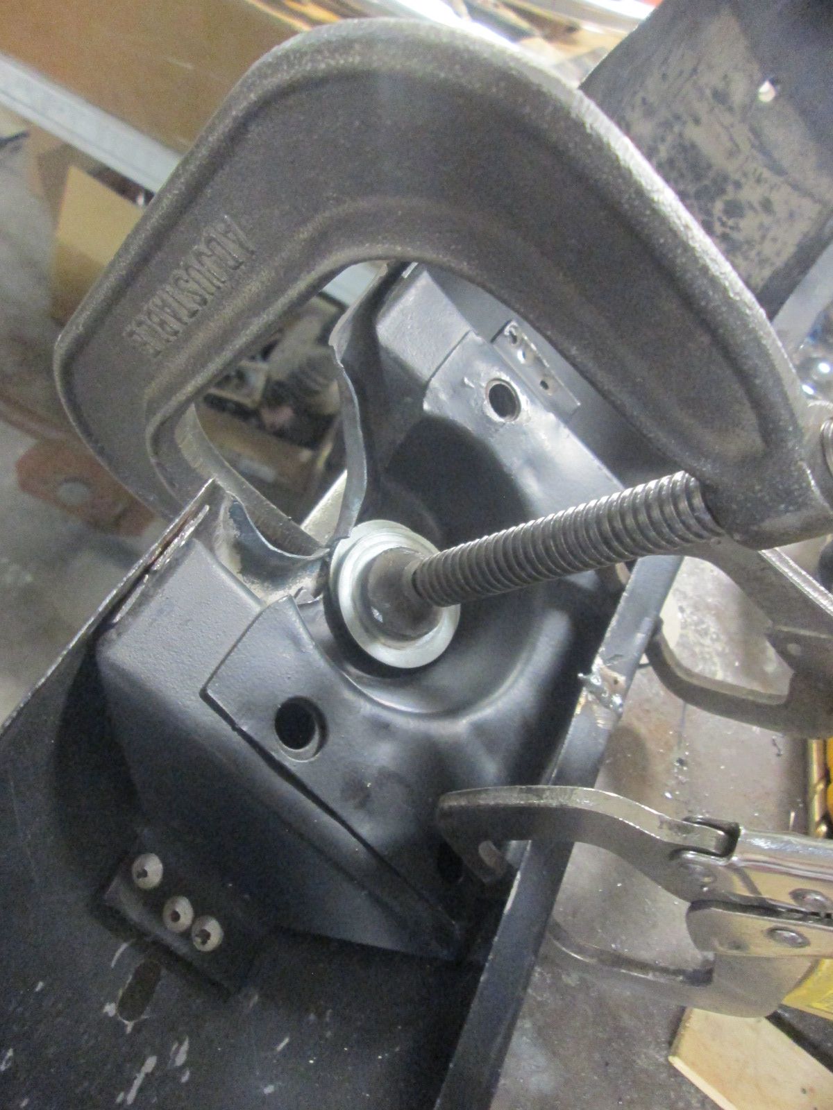

                    • Next issue raises its head:
                      Click image for larger version  Name:	IMG_3078.jpg Views:	3 Size:	221.4 KB ID:	116762 Excess removed then onto shaping and heeling over the arch flange.
                      Click image for larger version  Name:	IMG_3069.jpg Views:	3 Size:	203.0 KB ID:	116763 Locating the best bumperette profile shape fitment against the bumper. Confirming whether the existing mount hole for it was still in the right spot.
                      Click image for larger version  Name:	IMG_3075.jpg Views:	3 Size:	236.5 KB ID:	116764 Bumperette hole redrilled slightly over into the needed location. Welding complete with the exhaust arch in nearly completed form. Getting dangerously close to being done on this side.
                      Click image for larger version  Name:	IMG_3076.jpg Views:	3 Size:	225.5 KB ID:	116765 Again the bumper was dipped at some point so all the inner surface are clean and ready to go. Applying a quick coat of sealer to these surfaces before this mount goes back on for good.
                      Click image for larger version  Name:	IMG_3103.jpg Views:	3 Size:	201.8 KB ID:	116766 We have both shortened and tightened the radius on this bumper so now the overrider tubes themselves became the next fitment issue. That next...
                      Thanks for looking.
                      • Justin, my original 59 356A has no embossment for the rear light as you show in your 30/6/25 photo. Actually I had a question on the rear bumper when I went to look at my car in the late sixties.
                        I was told by the previous owner my car would have had exhaust pipes going through the chrome overriders but the first owner did not want that as he disliked the way the chrome became black with exhaust smoke and he wanted anyway a two pipe sports exhaust system. All could be returned to the 59 exhaust system if I wanted but I prefer also the sports exhaust. He also advised me the first owner wanted the smaller 400mm diameter steering wheel the same as a Speedster. This has of course remained on my car.
                          Hi Roy, I can understand wanting that small change. Those exhaust ports can get very sooty if you don't stay on top of them.

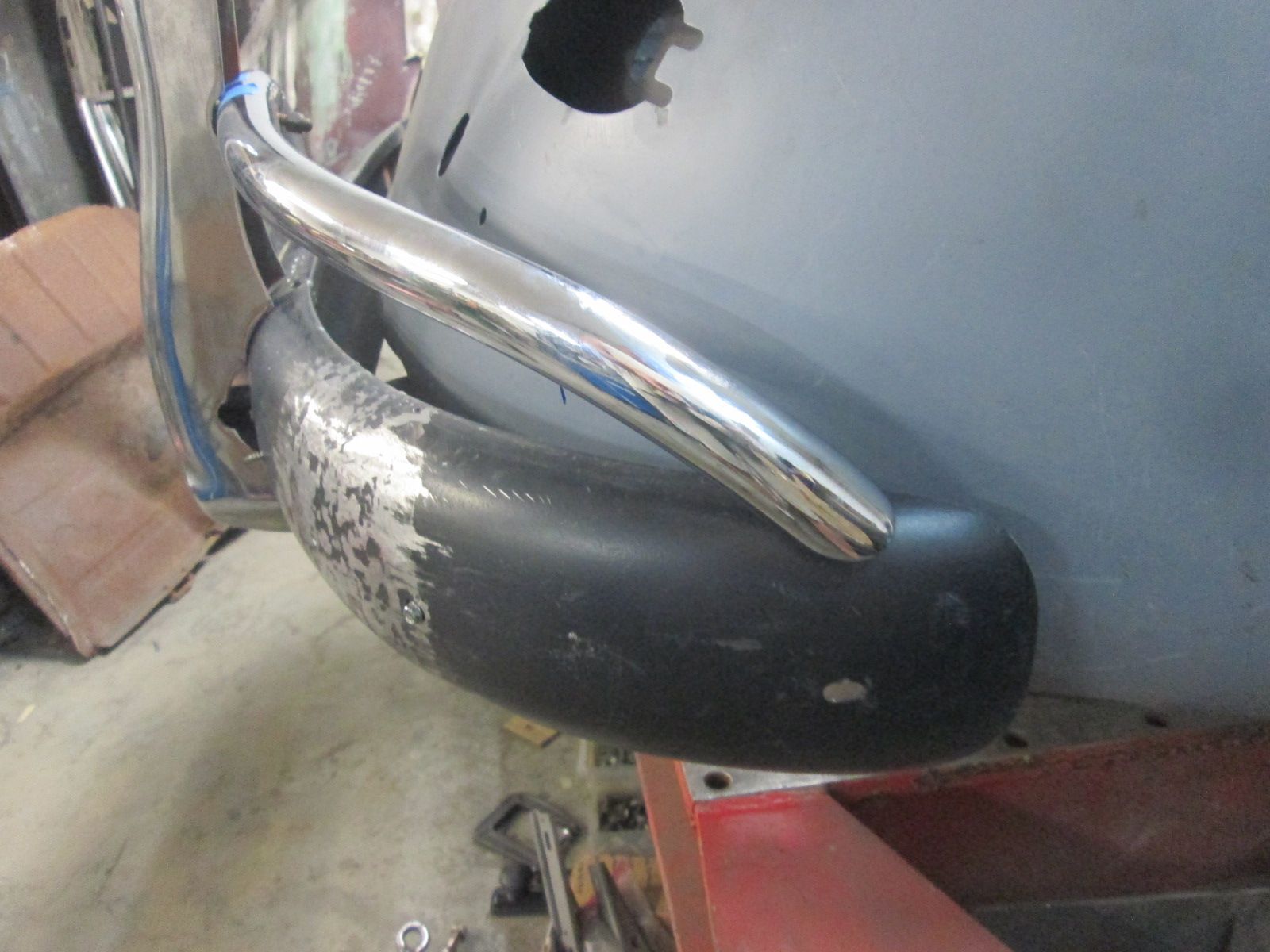

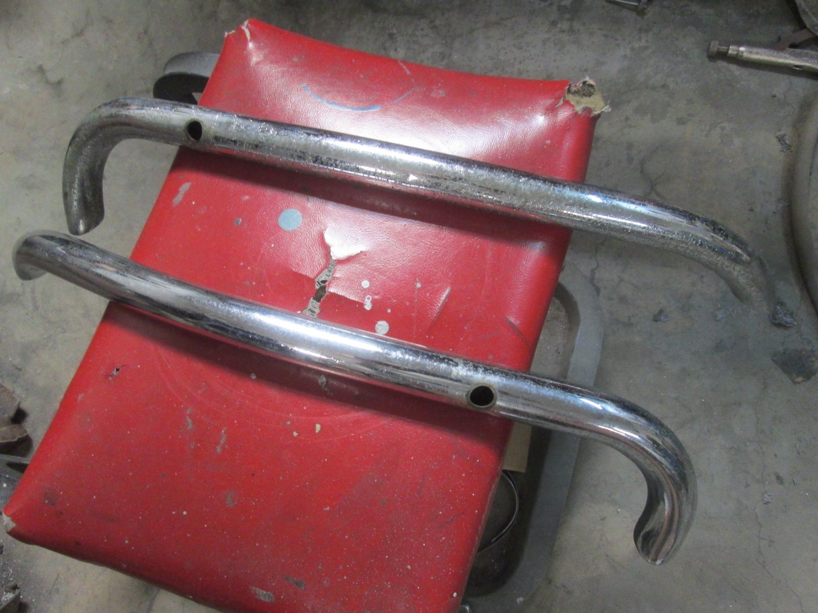

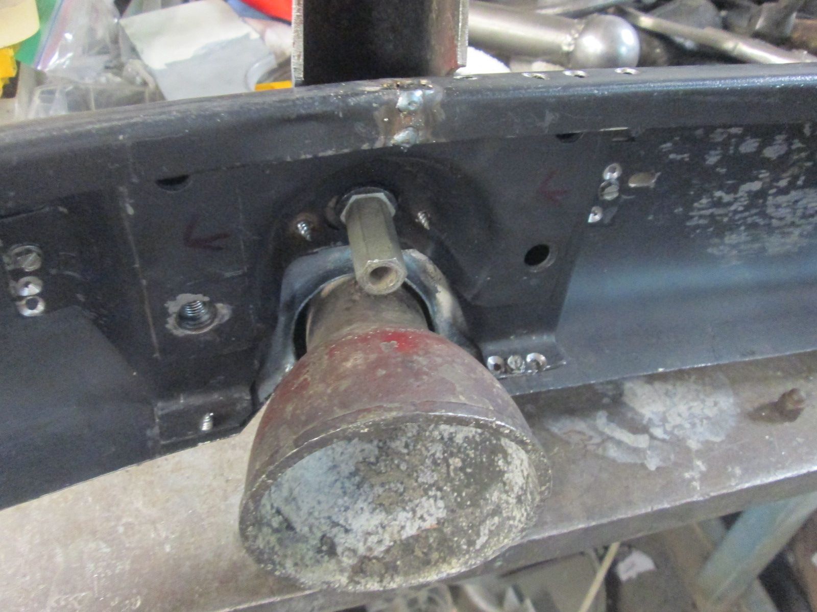

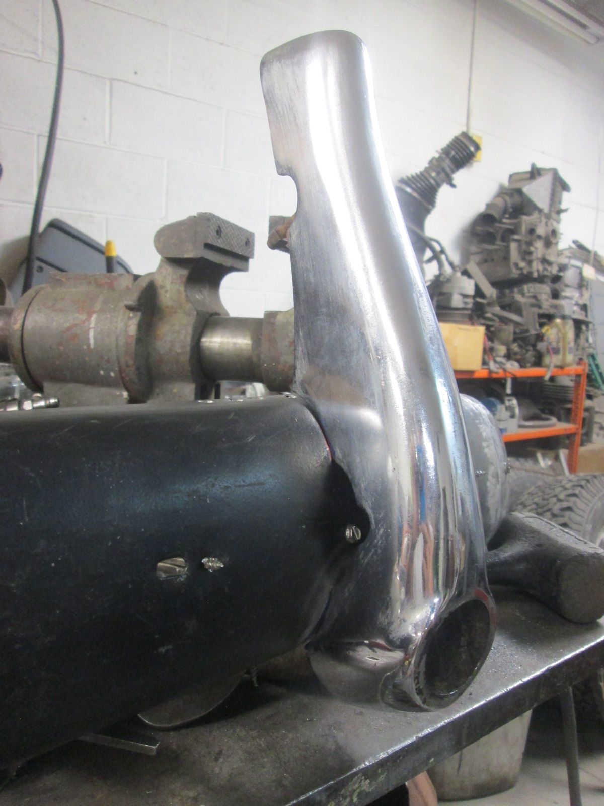

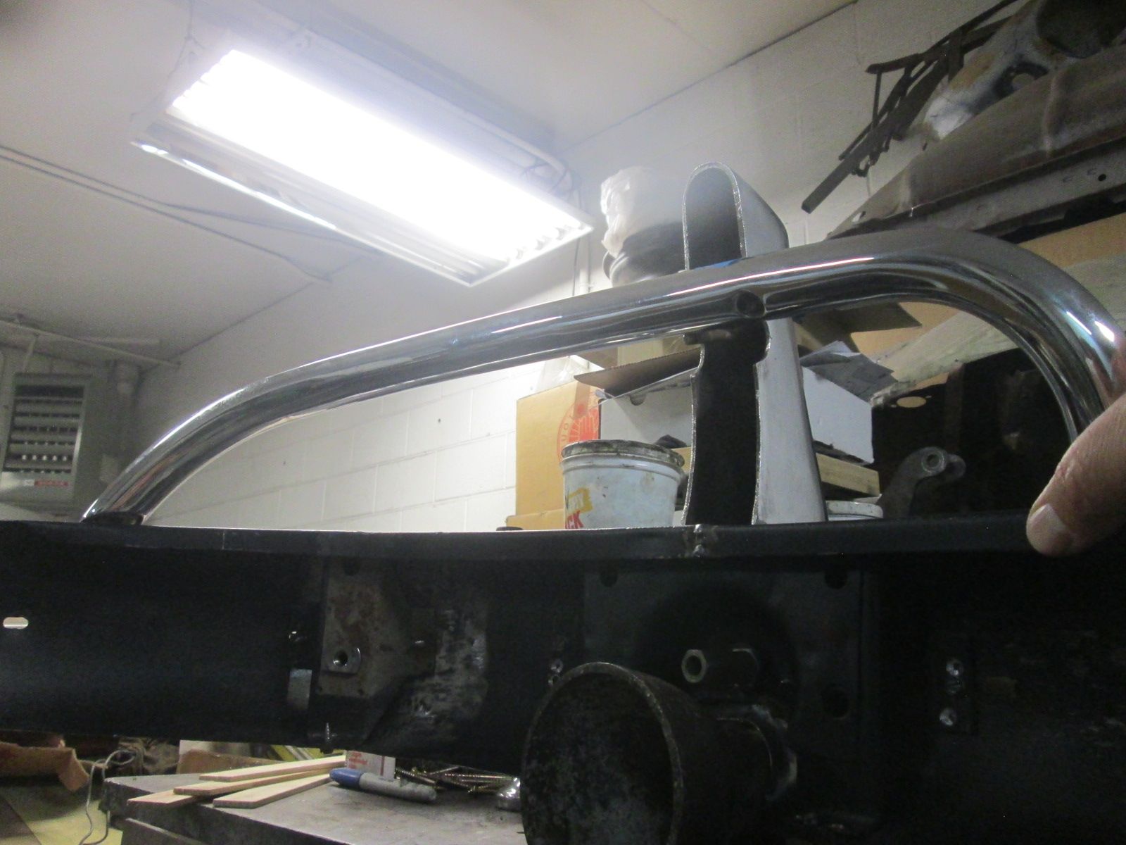

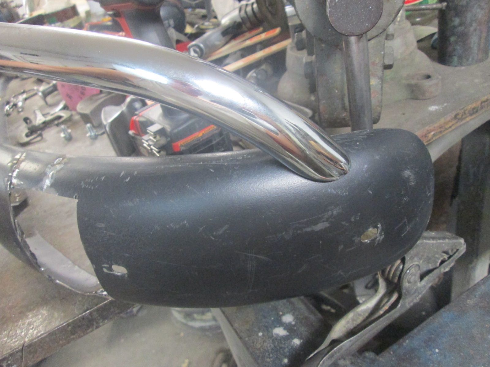

                      • Going to have to cut the overrider tubes.
                        Click image for larger version  Name:	IMG_3104.jpg Views:	0 Size:	192.8 KB ID:	116778 The bars at the stock length mounted into the bumperette with the stock hole reach way too far now making the end of the bumper look stubby.
                        Click image for larger version  Name:	IMG_3068.jpg Views:	0 Size:	179.5 KB ID:	116779 Exploring different options like sliding the tube inward an inch...
                        Click image for larger version  Name:	IMG_3112.jpg Views:	0 Size:	178.9 KB ID:	116780 but the shoulder would crowd into the shine up light "window". It wouldn't collide or touch it but would just look too busy and not correct.
                        Click image for larger version  Name:	IMG_3047.jpg Views:	3 Size:	224.9 KB ID:	116781 No matter how we sliced it the required modifications will require rechroming once its all over. The tubes provided are new with perfect chrome so it seemed such a waste to start cutting on these.
                        Click image for larger version  Name:	IMG_3107.jpg Views:	3 Size:	243.2 KB ID:	116782 What made the best logical sense was to acquire a donor pair of good originals with tired chrome for our purposes. Fortunately our buddy Matt Howard from Deluxe had a nice pair of donors for sale at just the right moment. Now the cutting can begin.
                        Thanks for looking.
