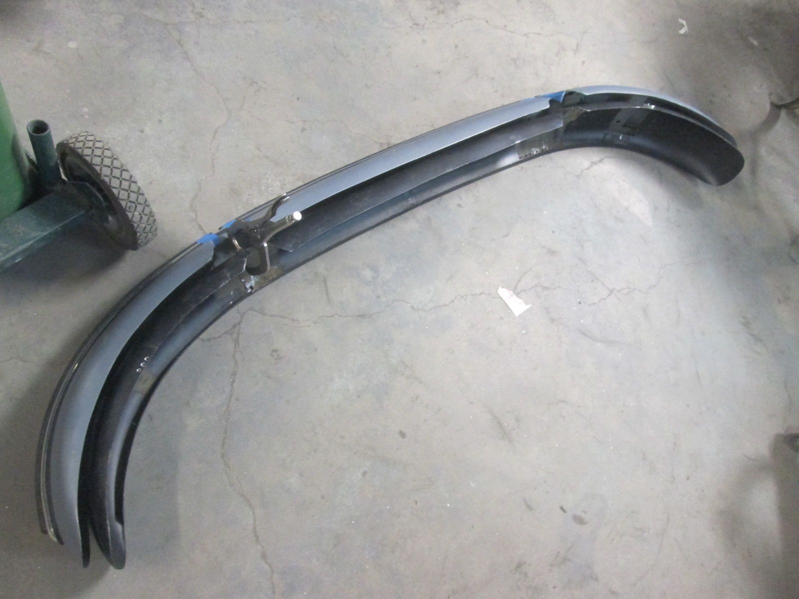

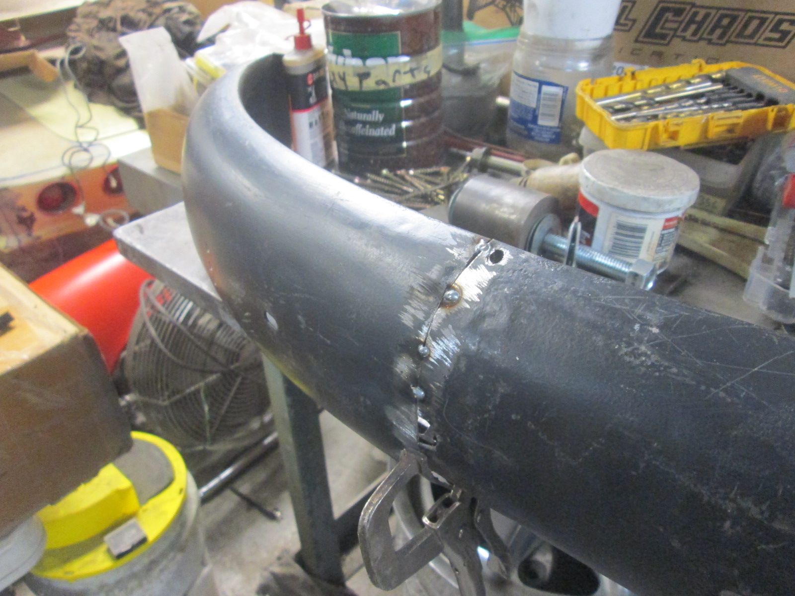

      • Chopping and recontouring the rear bumper to suit:
        Click image for larger version  Name:	IMG_3001.jpg Views:	0 Size:	177.0 KB ID:	116708 We had this rough T2 bumper on hand so I decided to use it as the test bed for the best places to cut and for the needed contour changes. It was punched hard in the left upright causing that buckle but looking past this damage you can see its overall width shows the same fitment issues we are having with the gray bumper.
        Click image for larger version  Name:	IMG_3008.jpg Views:	3 Size:	172.5 KB ID:	116709 The T2 exhaust arches are a limitation as their locations cannot be changed so the best place to start cutting was though the center of those existing arches. During the direct tail skin comparisons earlier I was able to confirm that there was really no notable differences in these panels between the tail lights except for that reverse light embossment of course. The reveal and its shape through the middle matches well here so all the needed changes of narrowing and contouring will be out at the corners.
        Click image for larger version  Name:	IMG_3002.jpg Views:	3 Size:	171.0 KB ID:	116710 For this initial mock up the corners were lapped over the center by one inch.
        Click image for larger version  Name:	IMG_3003.jpg Views:	3 Size:	175.8 KB ID:	116711 And moved over one inch on this side. While not perfect the improvement against the width and shape of this skin was immediate.
        Click image for larger version  Name:	IMG_3023.jpg Views:	3 Size:	174.1 KB ID:	116712 Bumper is clamped directly to the body to better dial in a matched contour fit. Two inches of overall width out of this bumper is turning the trick. Doesn't sound like a lot but in reality its changing things quite a bit, especially how it effected the chrome trim which I'll show a bit later.

        • Making changes requires more changes:
          Click image for larger version  Name:	IMG_3017.jpg Views:	0 Size:	176.9 KB ID:	116714 One inch removed from each side is our magic number to achieve that uniform fit and reveal with this tail that we're looking for.
          Click image for larger version  Name:	IMG_3007.jpg Views:	0 Size:	161.3 KB ID:	116715 But once we make the bumper shorter and tighter to fit this car the existing deco is going to be too long. The tips of it are going to end up about here; way too long to look right. This deco would have to be cut and shortened and the best place would be under the upright mount area where this bumper was cut.

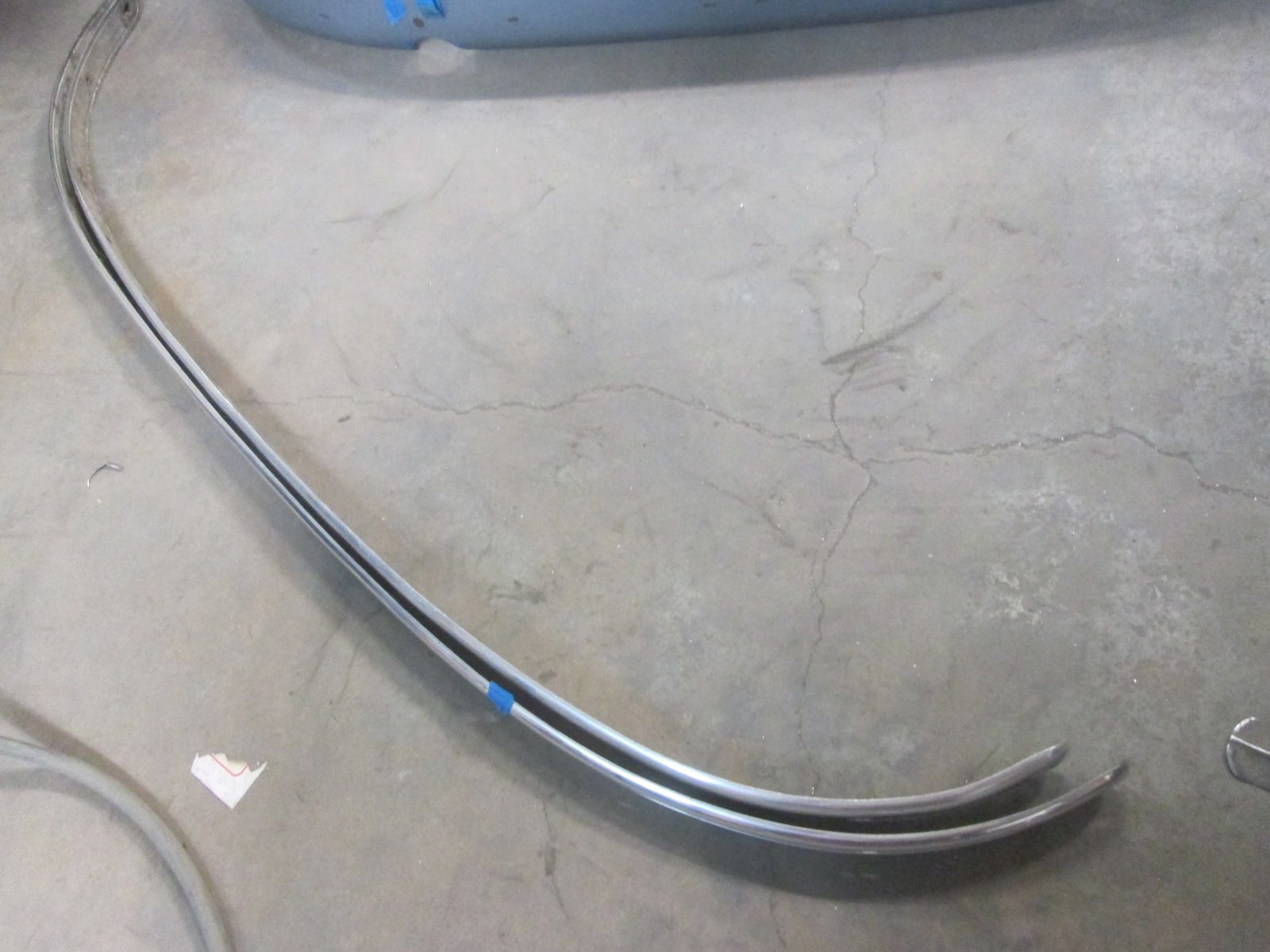

          Click image for larger version  Name:	IMG_3004.jpg Views:	0 Size:	188.3 KB ID:	116716 Then I remembered I had two super short original decos up on my storage shelf. I dug out the best of the two to see if it would work. I had sold this one years ago but the buyer returned it as it was way too short to fit the original bumper he was building.
          Click image for larger version  Name:	IMG_3006.jpg Views:	0 Size:	183.5 KB ID:	116717 It coincidently is an inch shorter at both ends making it the perfect part for this alteration. I was told by someone that this shorter deco was for Pre-A but after all of this I am not so sure about that. I can't imagine Porsche letting these late T5 tailed A-cars go out the door with such poorly fitting rear bumpers. Perhaps they made a Late '59 specific rear bumper assembly for these cars and this deco was once a special component of one? Just a theory of course.
          Click image for larger version  Name:	IMG_3024.jpg Views:	0 Size:	197.7 KB ID:	116718 At this stage a lot of prep and effort had already gone into this bumper for the mock up so decision was made to just keep building it. The alteration had eliminated most of the old accident damage leaving a pretty nice shell save for a large localized rust hole at the right corner. (where the big square hole is) Moisture holding road grime had accumulated in between the lateral bumper mount and this area severely rusting out both. That repair up shortly. Anyway, we now had our basic bumper and a deco.

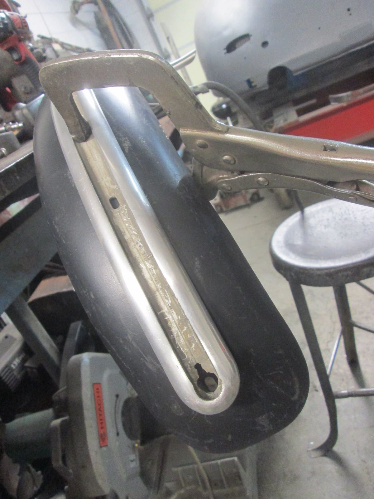

          • Test fitting deco:
            Click image for larger version  Name:	IMG_3039.jpg Views:	0 Size:	227.7 KB ID:	116722 Locked in the needed shape and just about ready to commit to welding up this run. 90% of that buckle from a previous old accident was removed once the excess width was removed. It was meant to be.
            Click image for larger version  Name:	IMG_3029.jpg Views:	0 Size:	182.7 KB ID:	116723 Now fits neatly inside of stock A-T2 bumper.
            Click image for larger version  Name:	IMG_3042.jpg Views:	0 Size:	207.0 KB ID:	116724 Promising fit so far with the center bolts lining up along with the bumperette hole. Original inside exhaust port arch remains and will hammer in the other half once all the welding is finished.
            Click image for larger version  Name:	IMG_3040.jpg Views:	0 Size:	222.7 KB ID:	116725 The lateral holes don't line up so well. This was no surprise as everything at the corners of this bumper have been shifted. The important thing was that the tip of this deco terminates in the right spot.

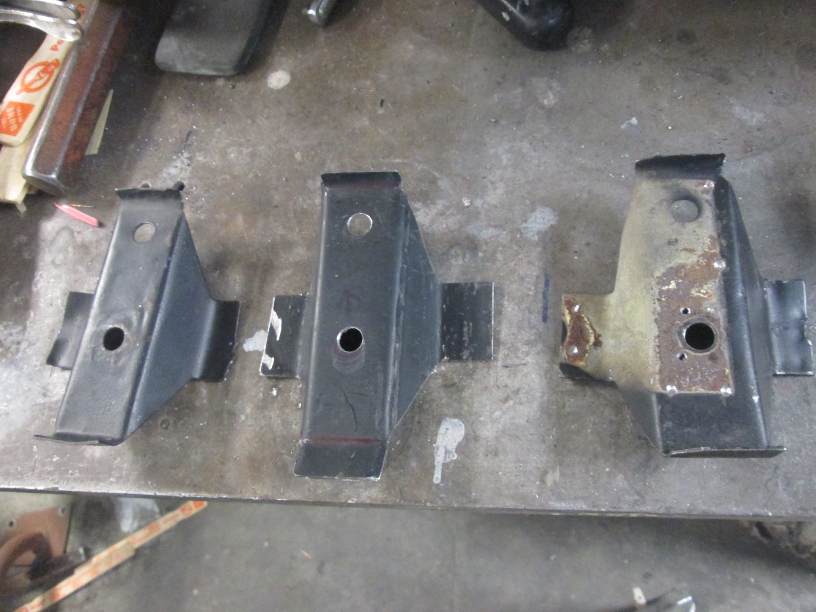

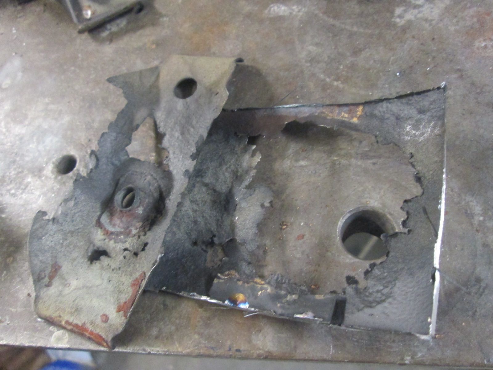

            • Rust and old collision repair:

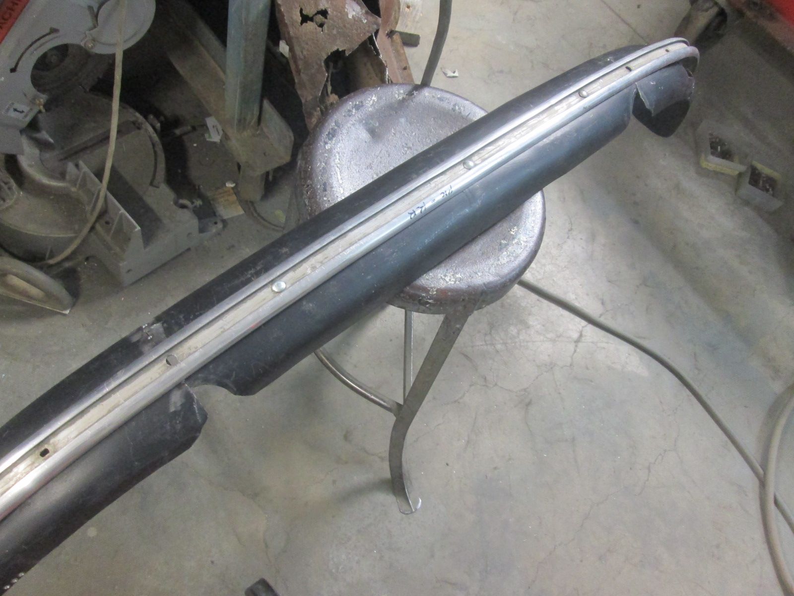

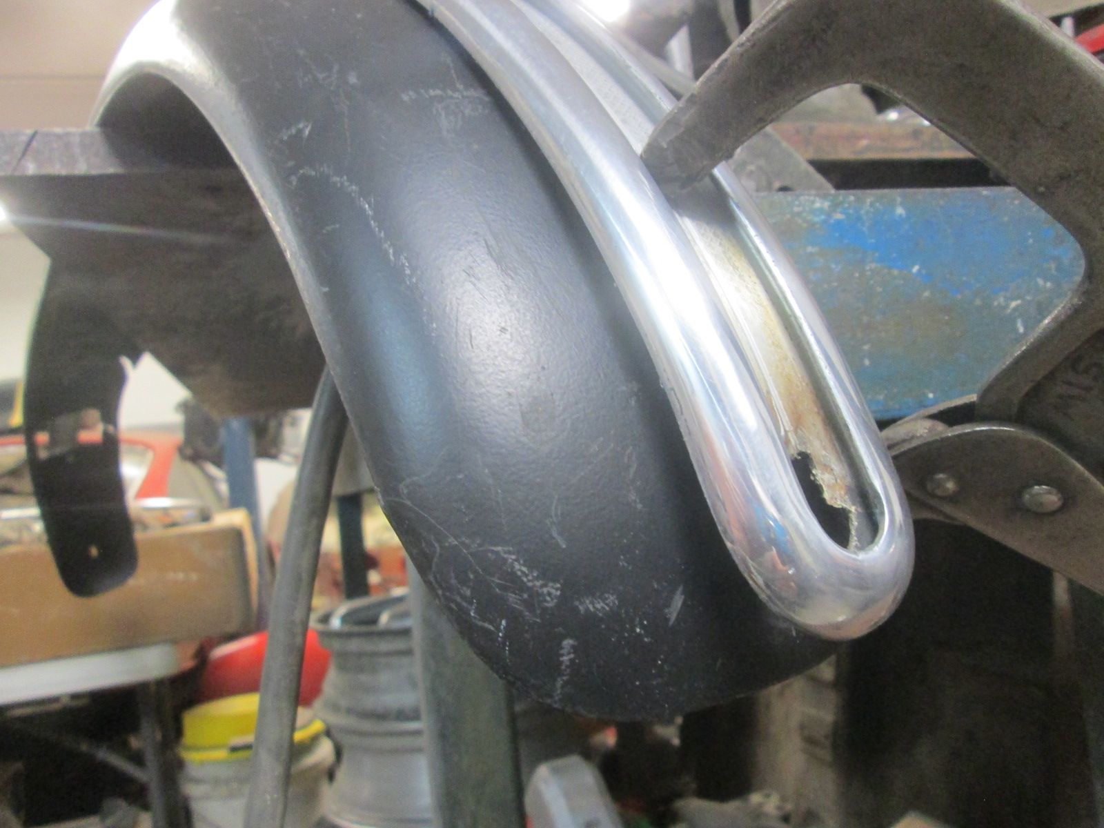

              Click image for larger version  Name:	IMG_3044.jpg Views:	0 Size:	204.9 KB ID:	116728 Here is how a stock 356A deco now fits. Like the bumper it would had to have been cut and sectioned just like the bumper.

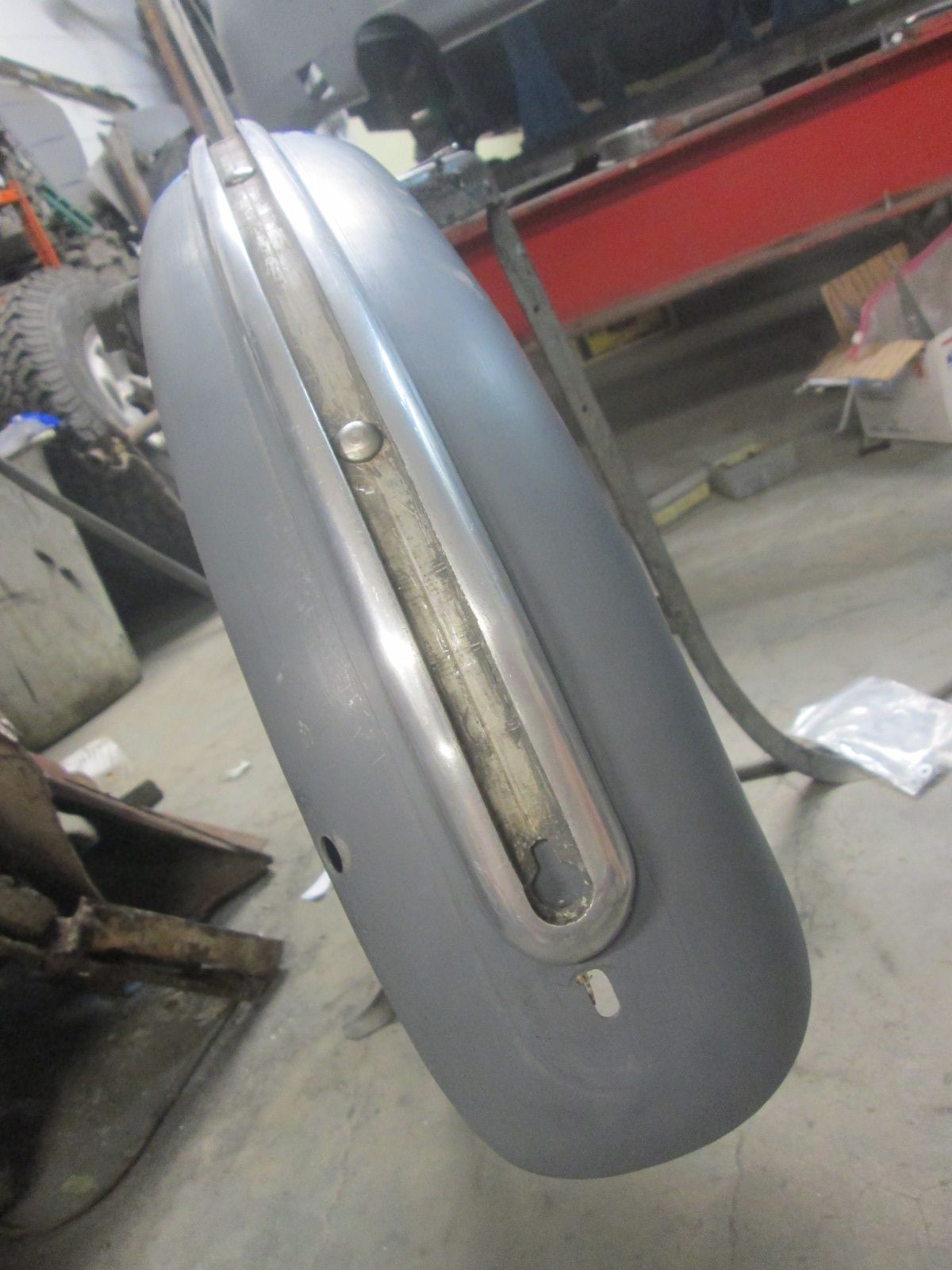

              Click image for larger version  Name:	IMG_3049.jpg Views:	0 Size:	193.9 KB ID:	116729 By contrast here is how short that deco ends up being on a stock 356A bumper. Its no wonder the guy sent it back to me.

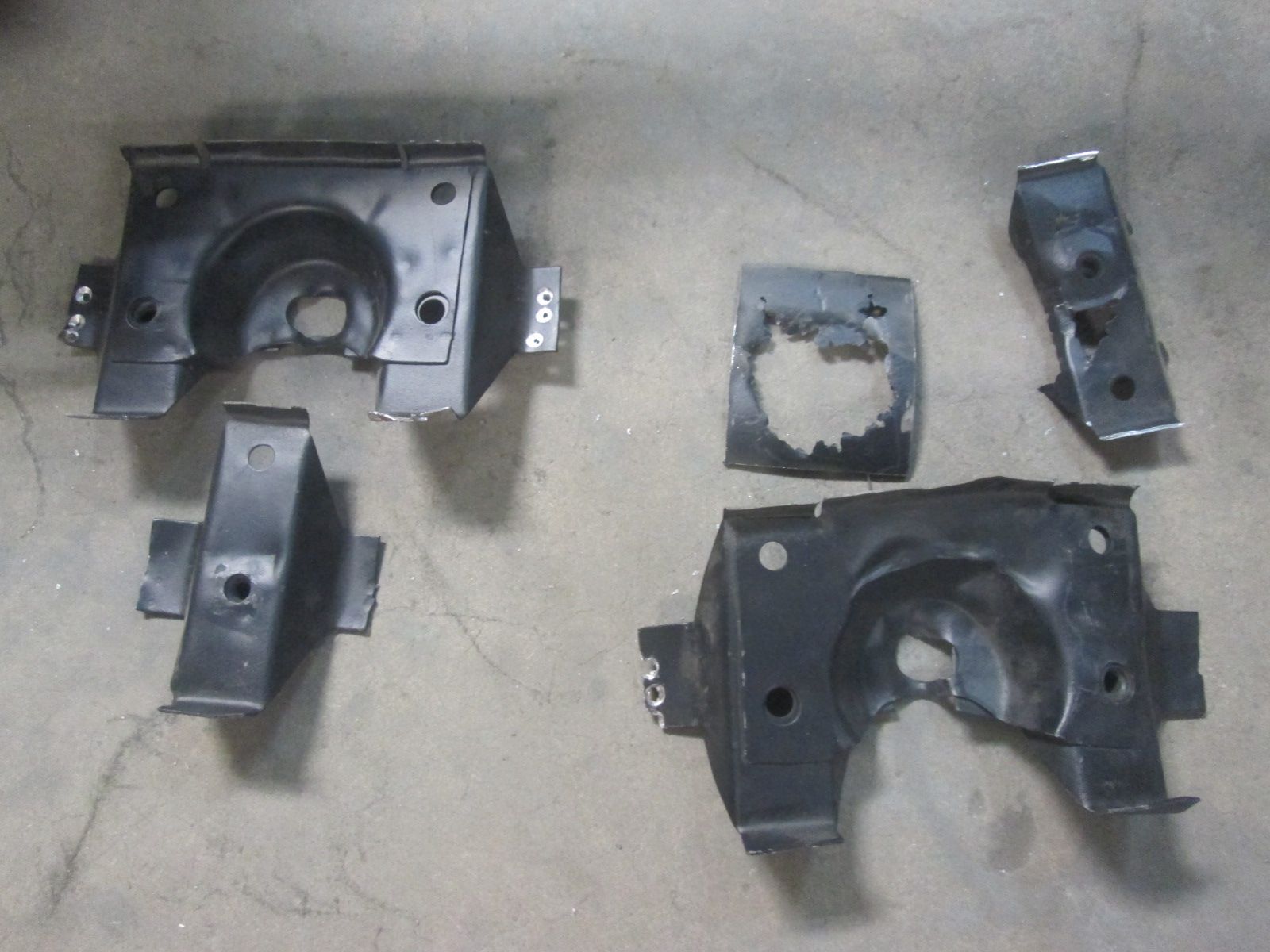

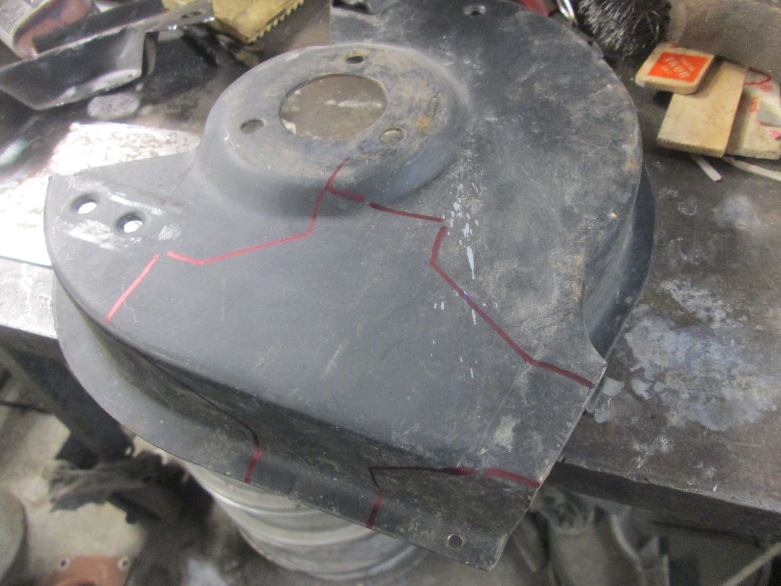

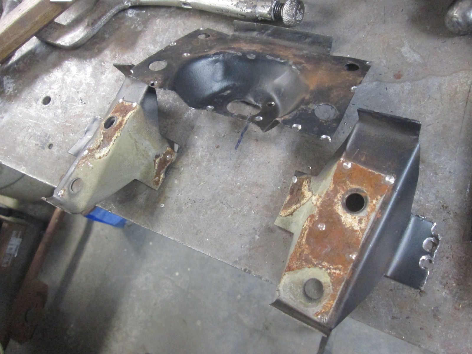

              Click image for larger version  Name:	IMG_3025.jpg Views:	0 Size:	197.5 KB ID:	116730 To make the needed changes to the bumper all the internal mounting backets needed to come out. The previous rust and collision damage made this bumper an even more viable candidate for the application.
              Click image for larger version  Name:	IMG_3027.jpg Views:	0 Size:	245.7 KB ID:	116731 The left side inner double bracket was cut apart so I could straighten the residual crash damage back out. This bumper was chemically dipped clean with only some trace amounts of old rust remaining in between the joints.
              Click image for larger version  Name:	IMG_3038.jpg Views:	0 Size:	222.2 KB ID:	116732 The right side lateral mount became packed up with moisture holding muck at some point and completely rotted both it and the skin pictured here. A new bracket would have to be fabricated.

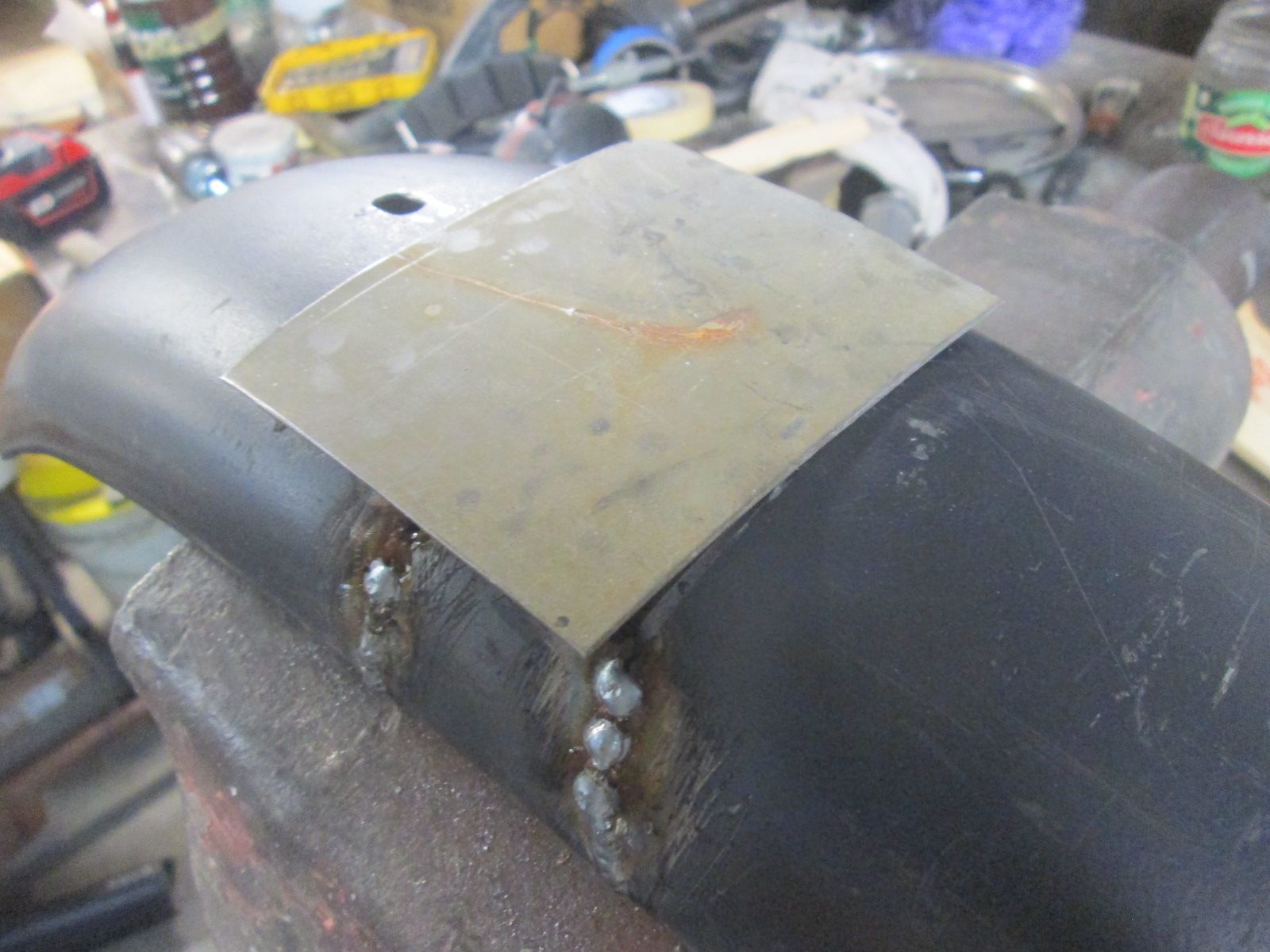

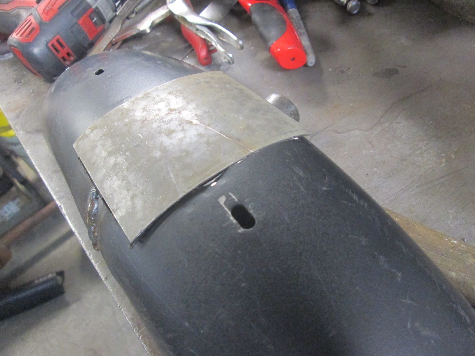

              • Rust repair patch:
                Click image for larger version  Name:	IMG_3050.jpg Views:	0 Size:	201.9 KB ID:	116734 Began with a flat piece of 18 gauge.
ID:	116735Gradually planishing in a soft rounded shape to match the bumper profile.

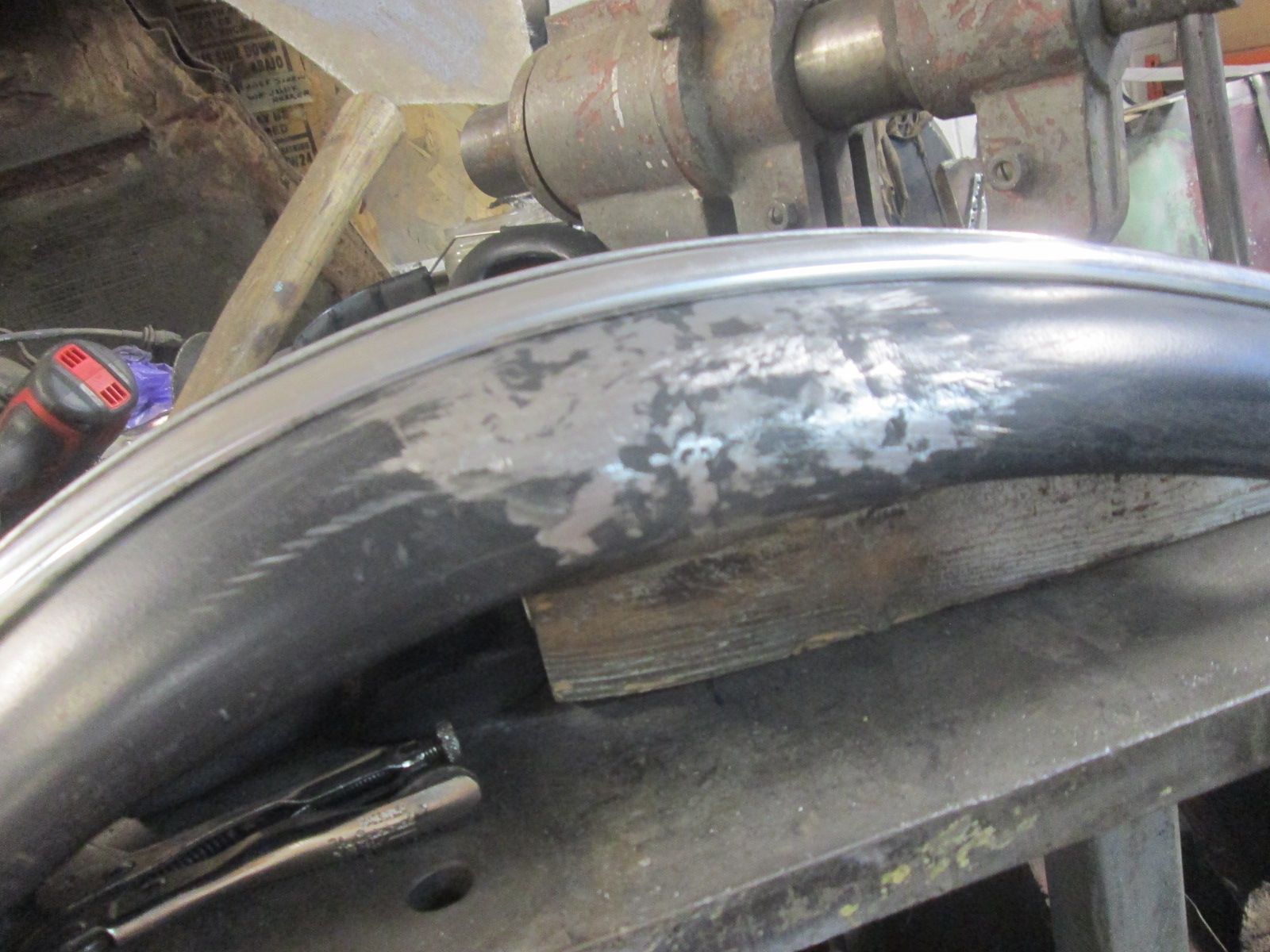

ID:	116736 All stitched in then onto picking and filing in the final shape.
ID:	116737 Most of this patch will always be visible from the backside so some extra work was required to get it close and as clean as possible on both sides.

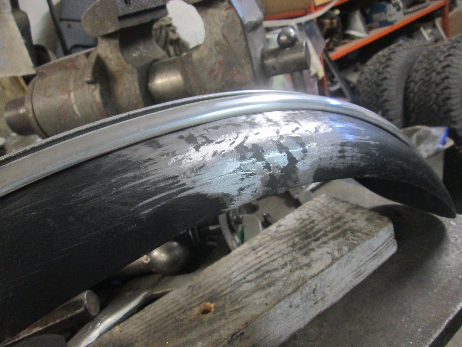

ID:	116738 Onto a quick work coat to high light the lows and high spots that still need a bit more finishing.

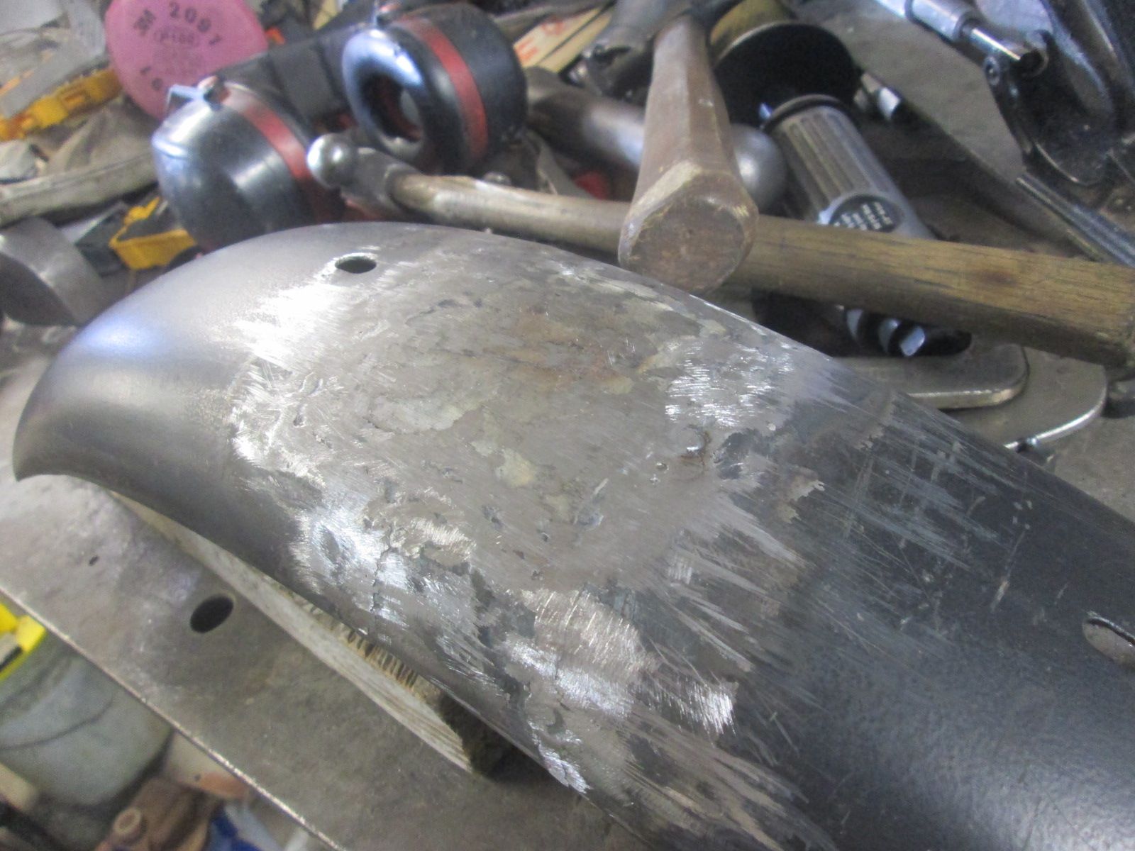

                • Repair patch complete. New bracket mount fabrication:

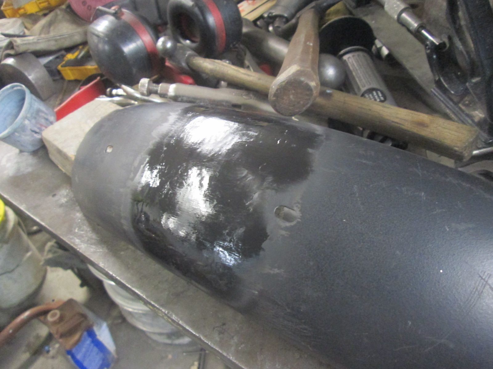

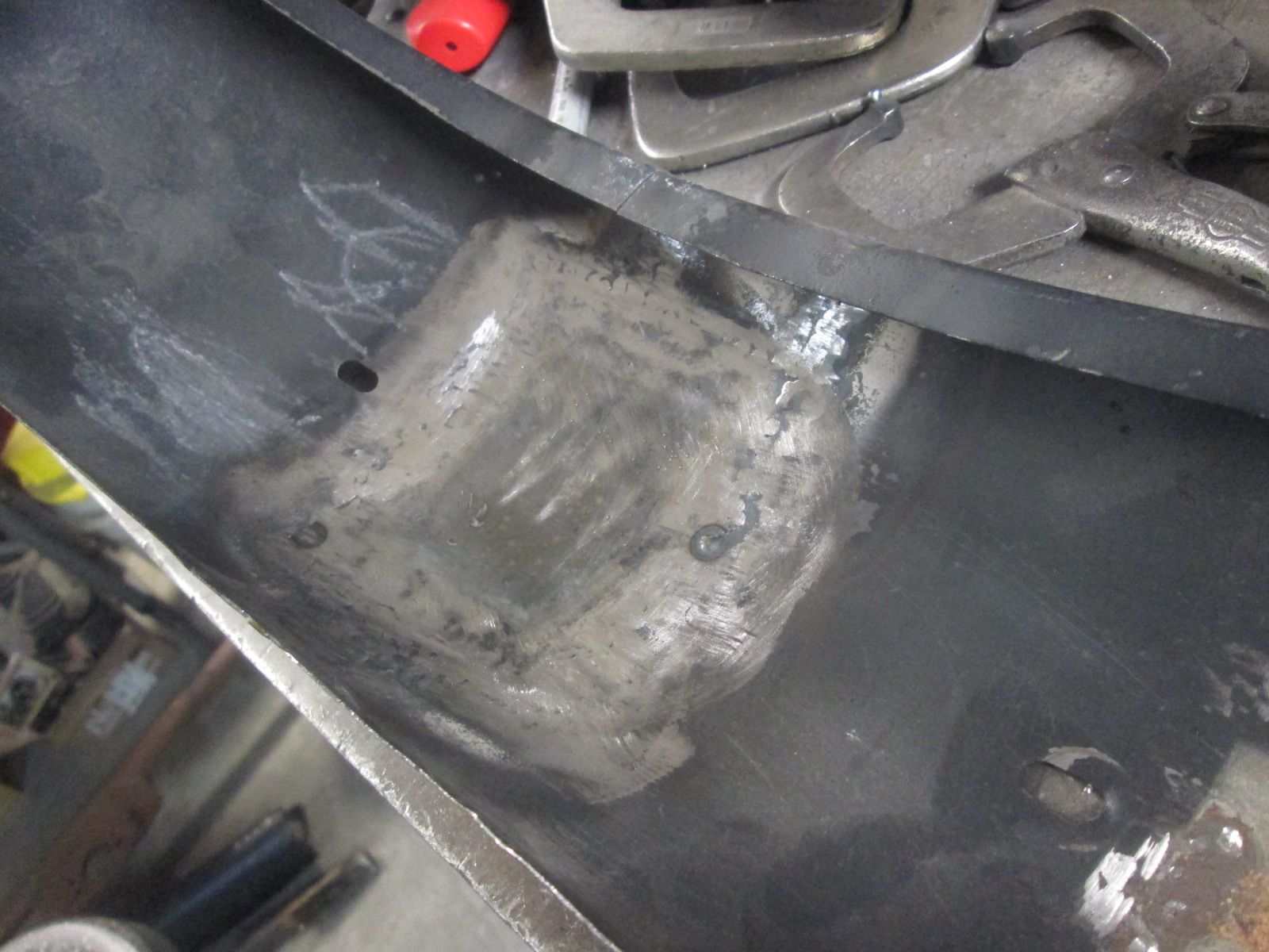

                  Click image for larger version  Name:	IMG_3055.jpg Views:	0 Size:	230.2 KB ID:	116740 After several rounds of hammering and filing I had chased it about as far as I could. Deco mounted for a test fit against its final shape.
                  Click image for larger version  Name:	IMG_3056.jpg Views:	0 Size:	223.1 KB ID:	116741 Will only need a swatch of filler to get that last 10% out. Onto the bumper mount bracket, second half of this repair.
                  Click image for larger version  Name:	IMG_3079.jpg Views:	3 Size:	225.9 KB ID:	116742 The brackets are a heavier 16 gauge and the thickest I had on hand was 18 gauge and that's too thin to make these out of as these brackets deal with and mount directly to those really heavy gauge bumper irons. In desperation I was onto digging deep into my scrap metal box and eventually ran across the perfect donor. This is an old deflection shield from my bench grinder. Turned out to be the right thickness, with just enough width to cut out a complete part. It even had a shouldered bend at just the right spot; it was meant to be. New part traced out here for cutting.

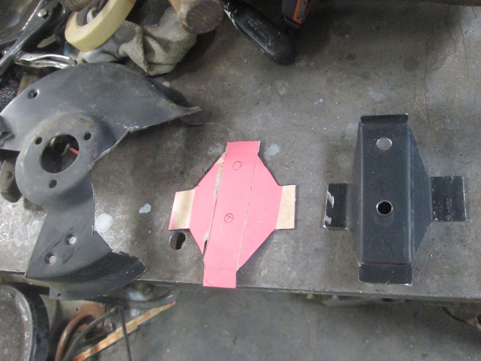

                  Click image for larger version  Name:	IMG_3081.jpg Views:	3 Size:	218.4 KB ID:	116743 Remains of the donor shield, paper template based on an original and the newly finished replacement bracket.
                  Click image for larger version  Name:	IMG_3082.jpg Views:	3 Size:	221.7 KB ID:	116744 All set, only some final trimming and bending on the flanges left to do and the capture nut. Looks like the originals but most importantly its thicker like the originals.
